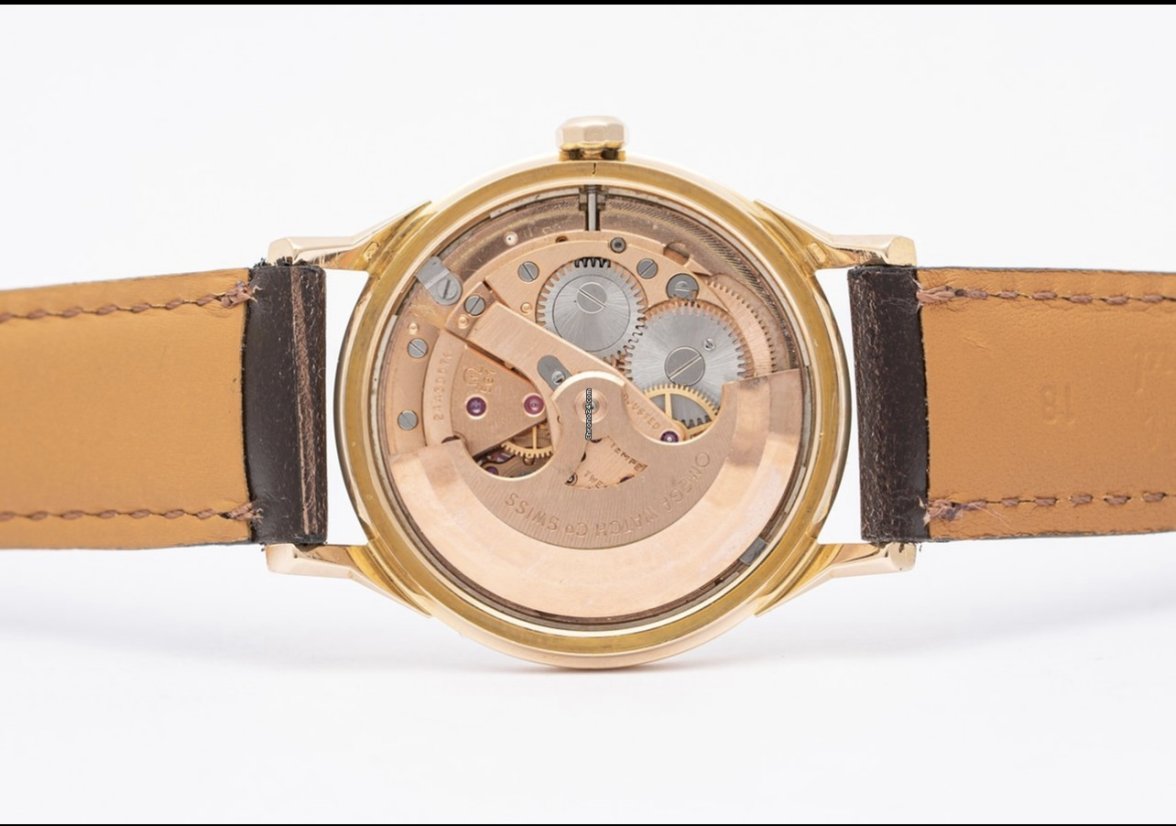

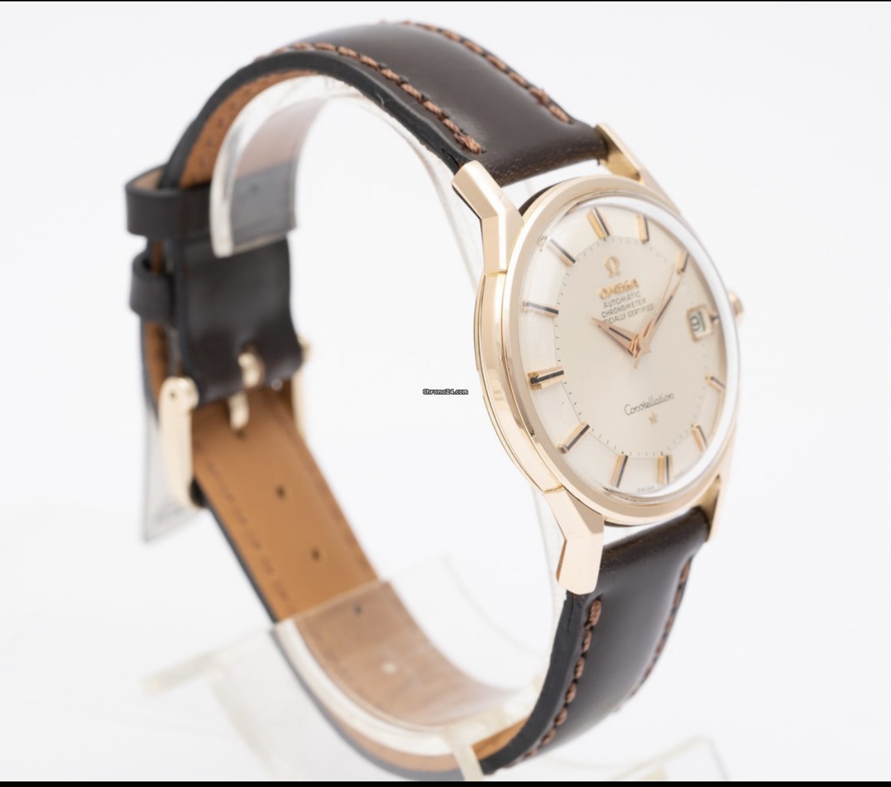

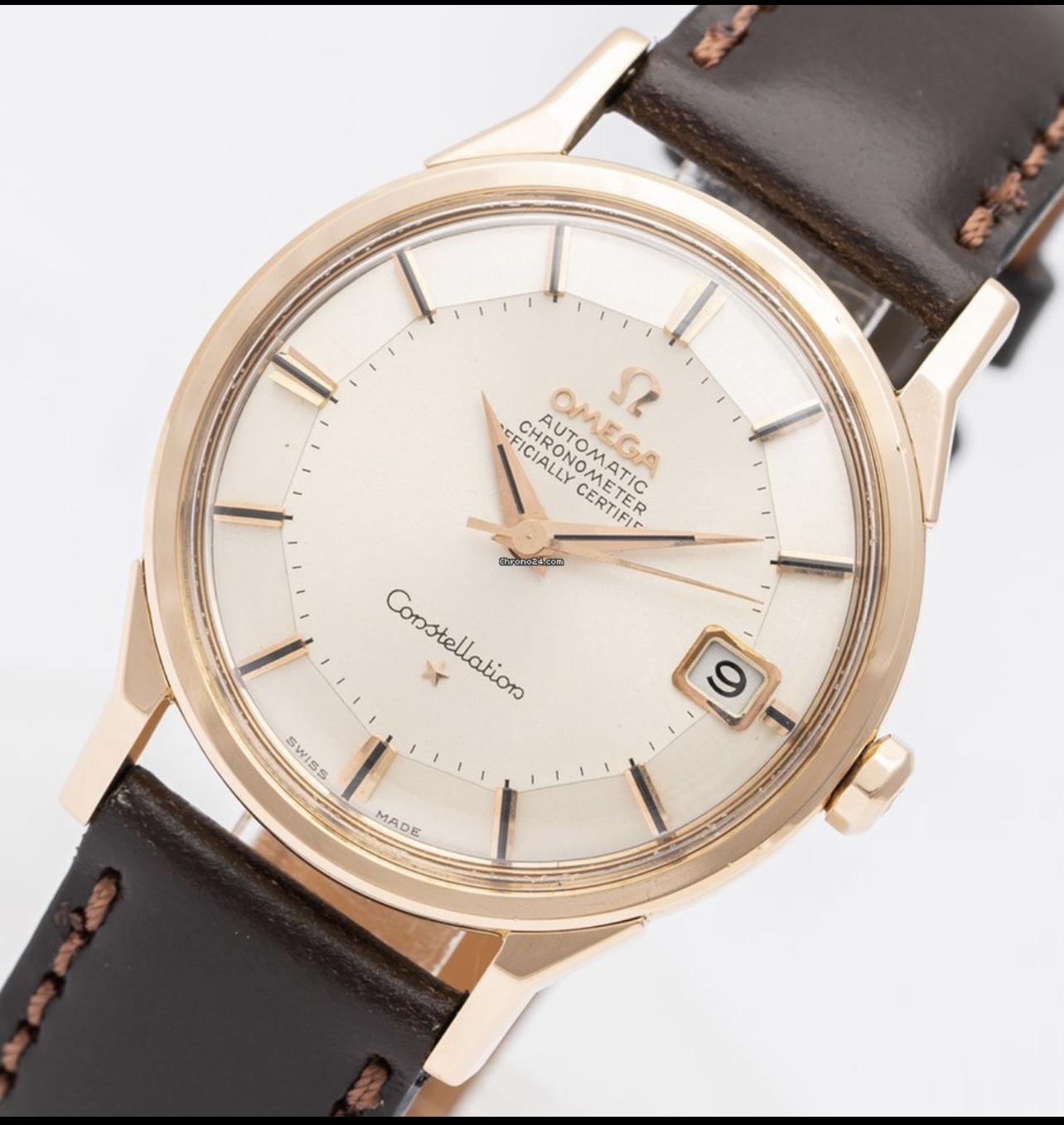

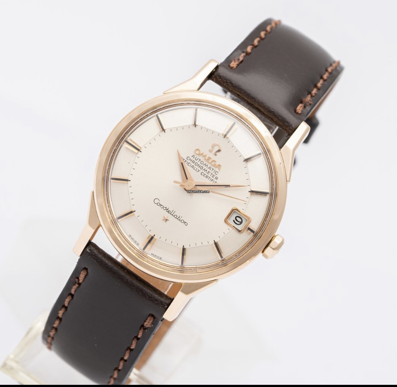

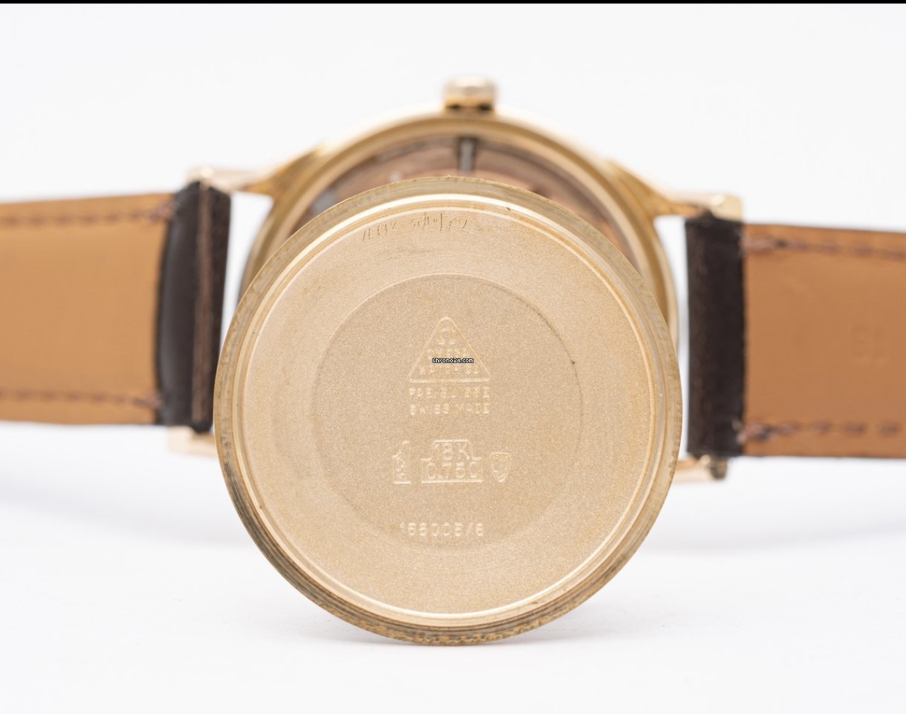

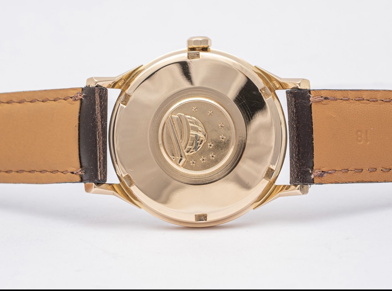

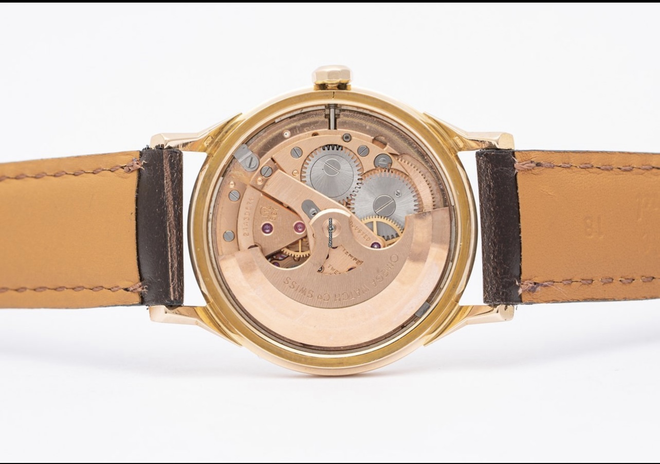

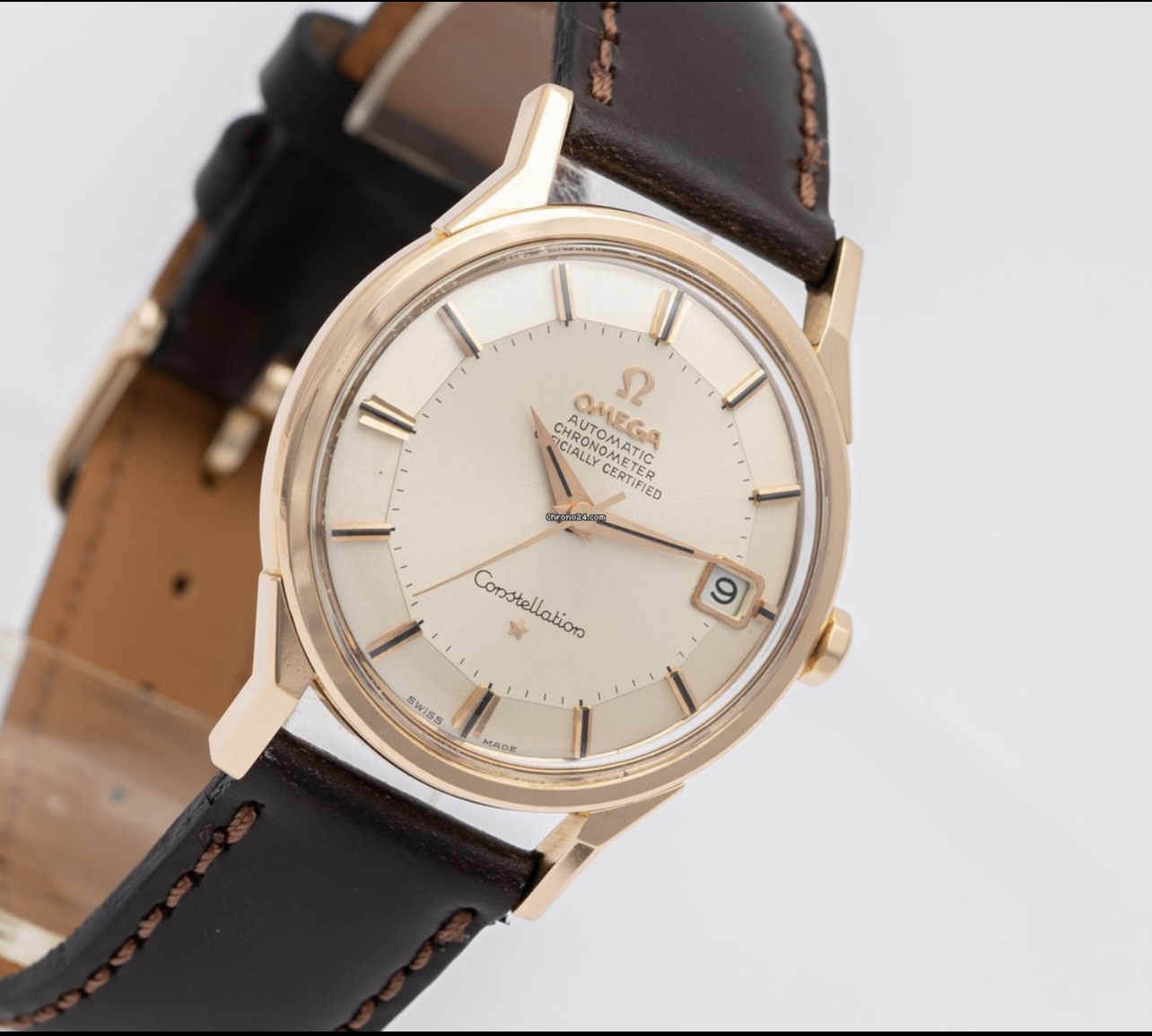

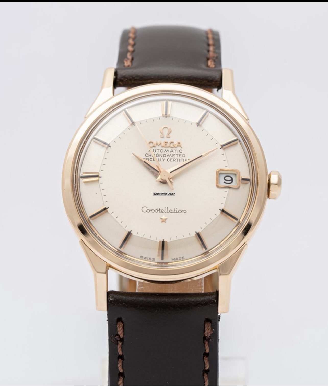

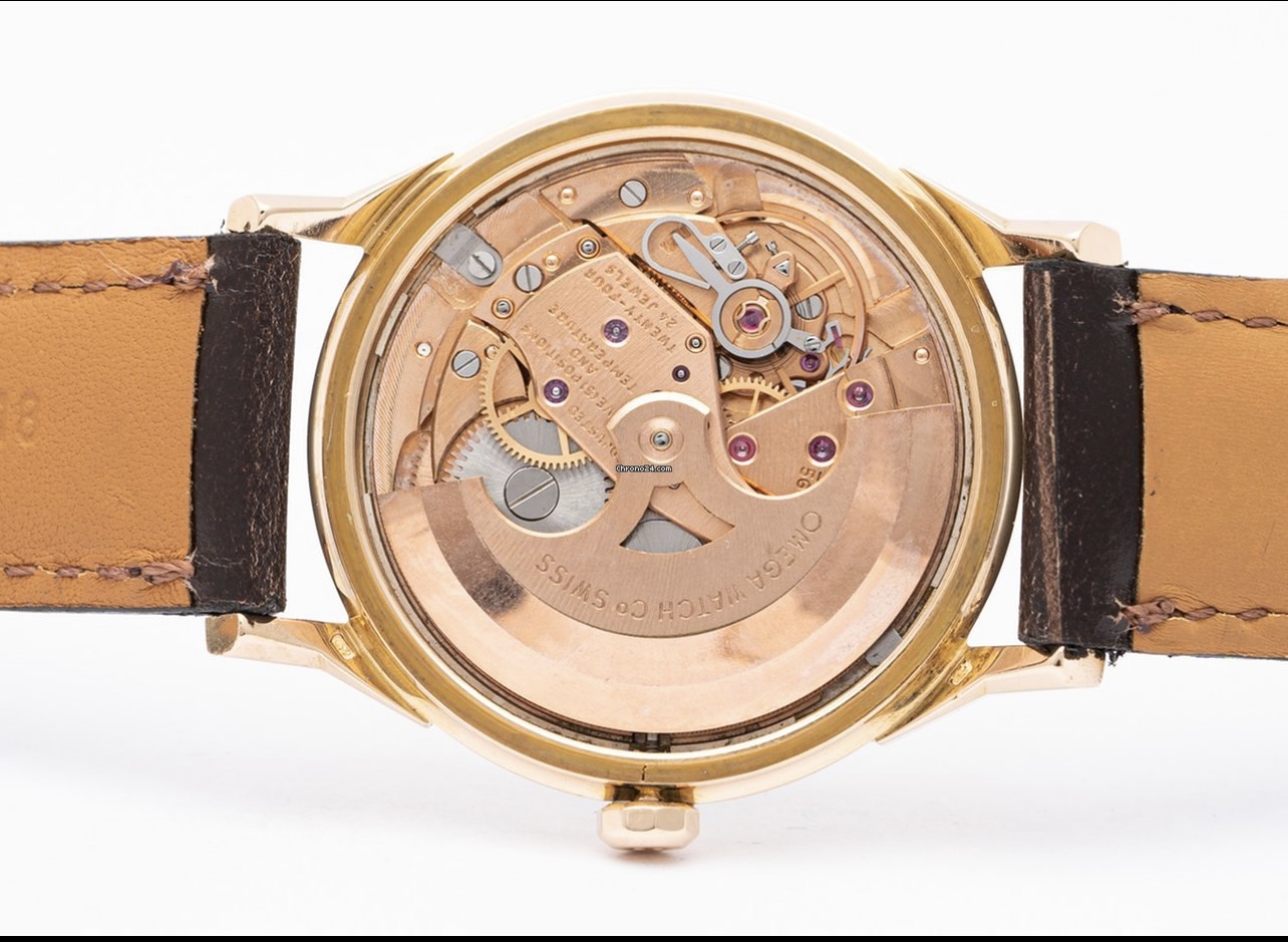

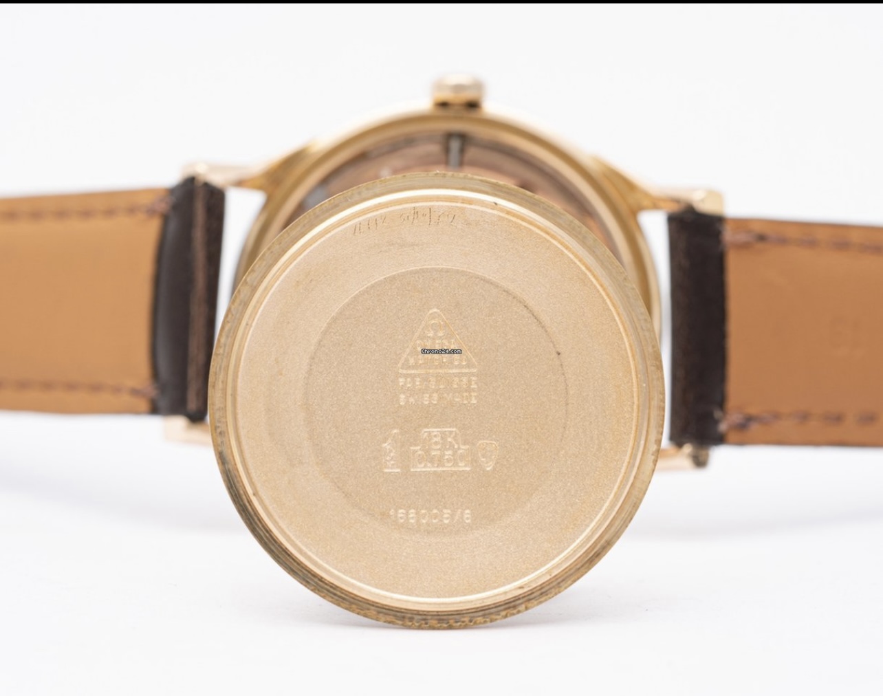

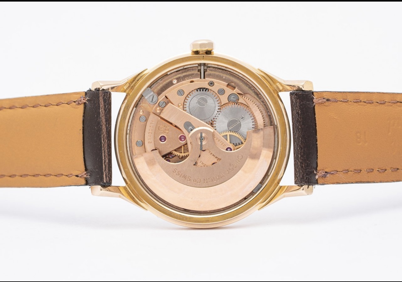

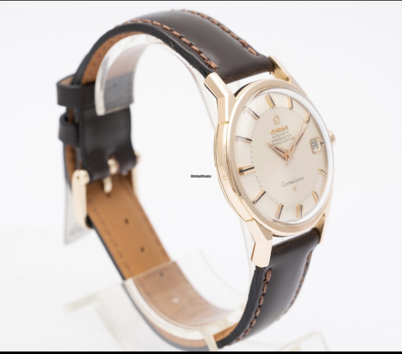

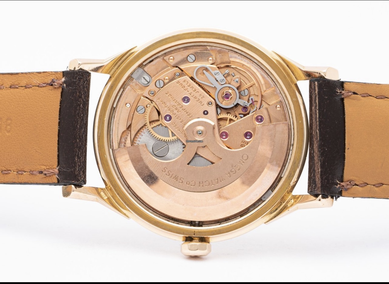

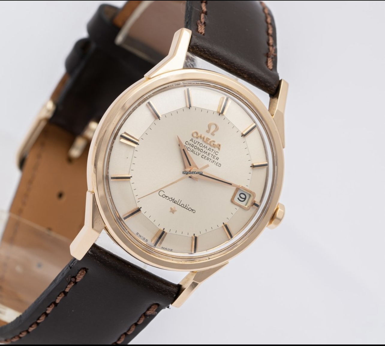

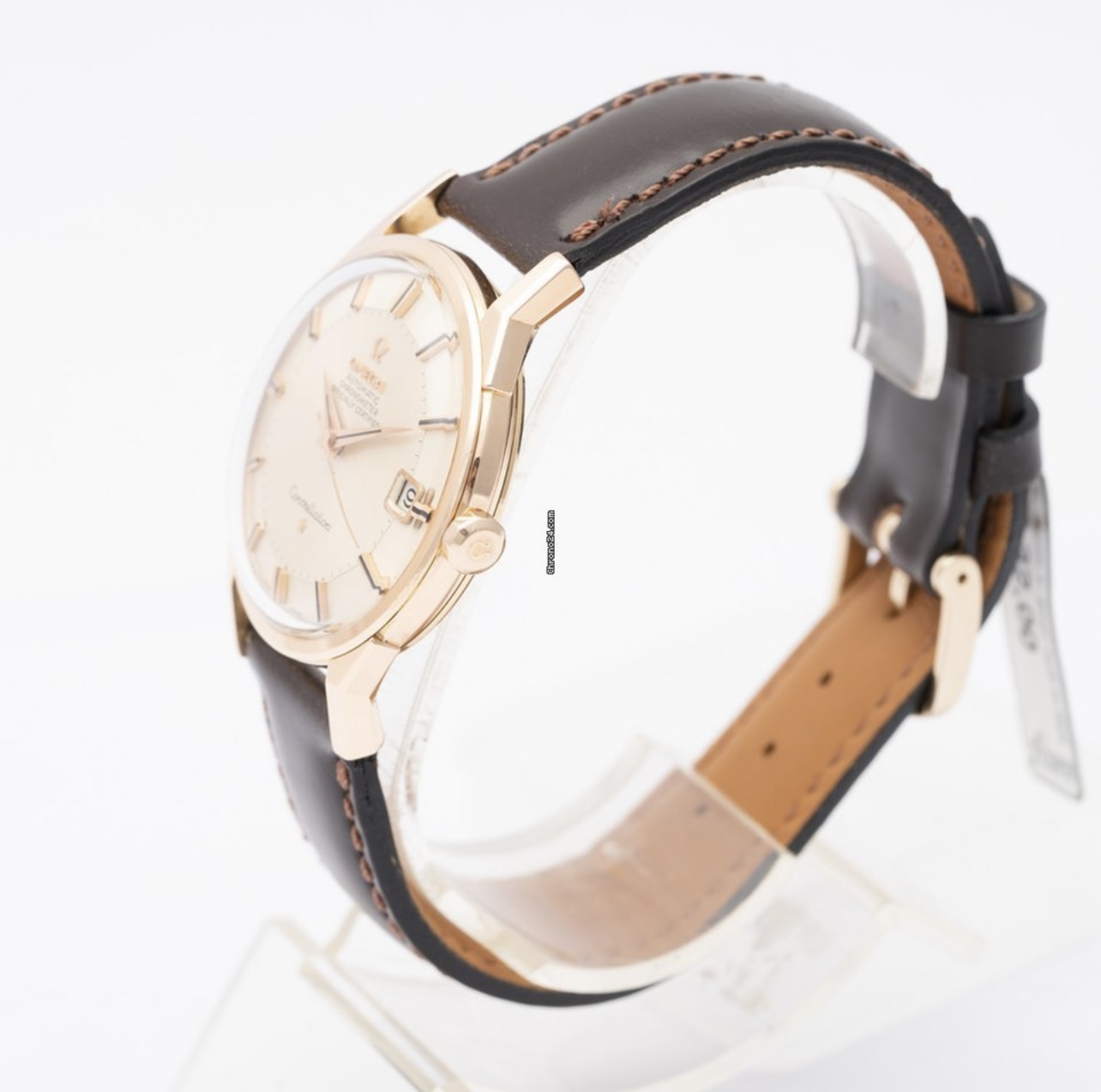

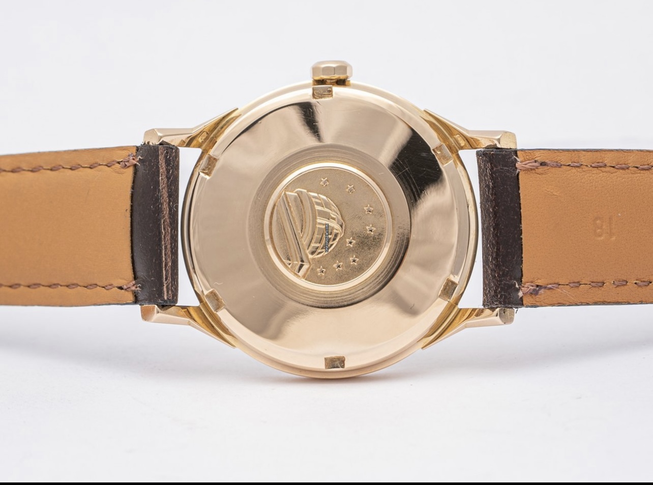

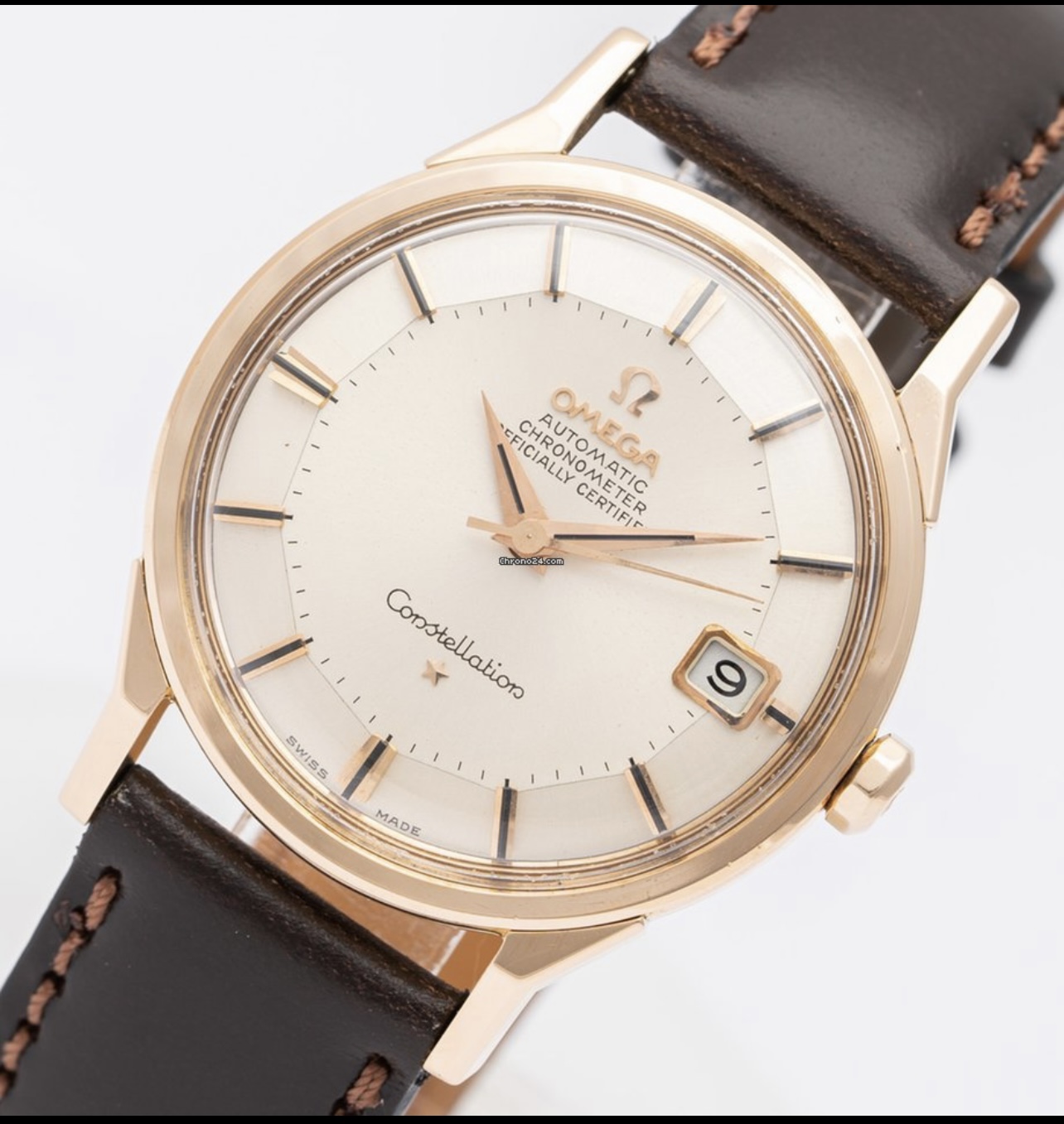

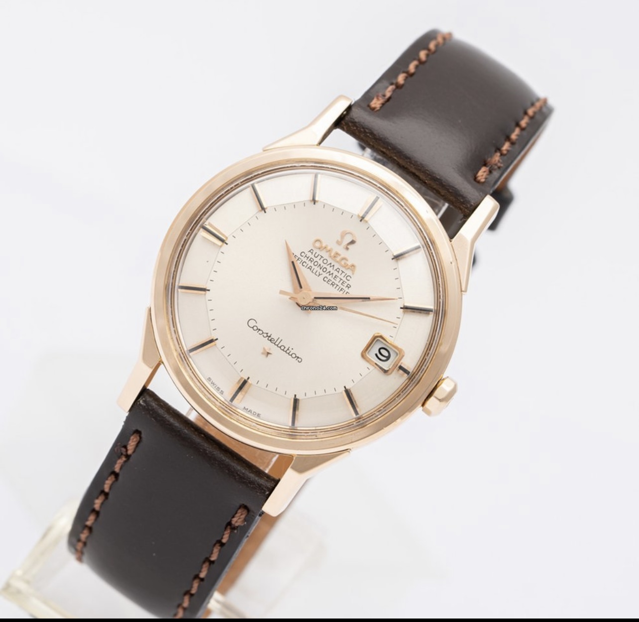

I haven’t received the watch yet, but these are the photographs from the sales listing:

I'm blinded, but can see a change-of-direction on the lugs, somewhat. These 18kt cases can get a bit soft after 50-60 years.
Post pix when in hand and in natural light.

Rotor has some wear so chances are it is rubbing on the caseback. If the photos weren't so horrendously overexposed it would be easier to see things like that.

It has not been serviced. No watchmaker of any repute would leave an old yellow gasket in a watch that is clearly not in good condition, if they serviced the watch.

@Archer says it hasn't been serviced and you really don't want rotor rub spoiling the inside case back of what looks to be a beauty.
It would be unseen but you'd always know it was there!
