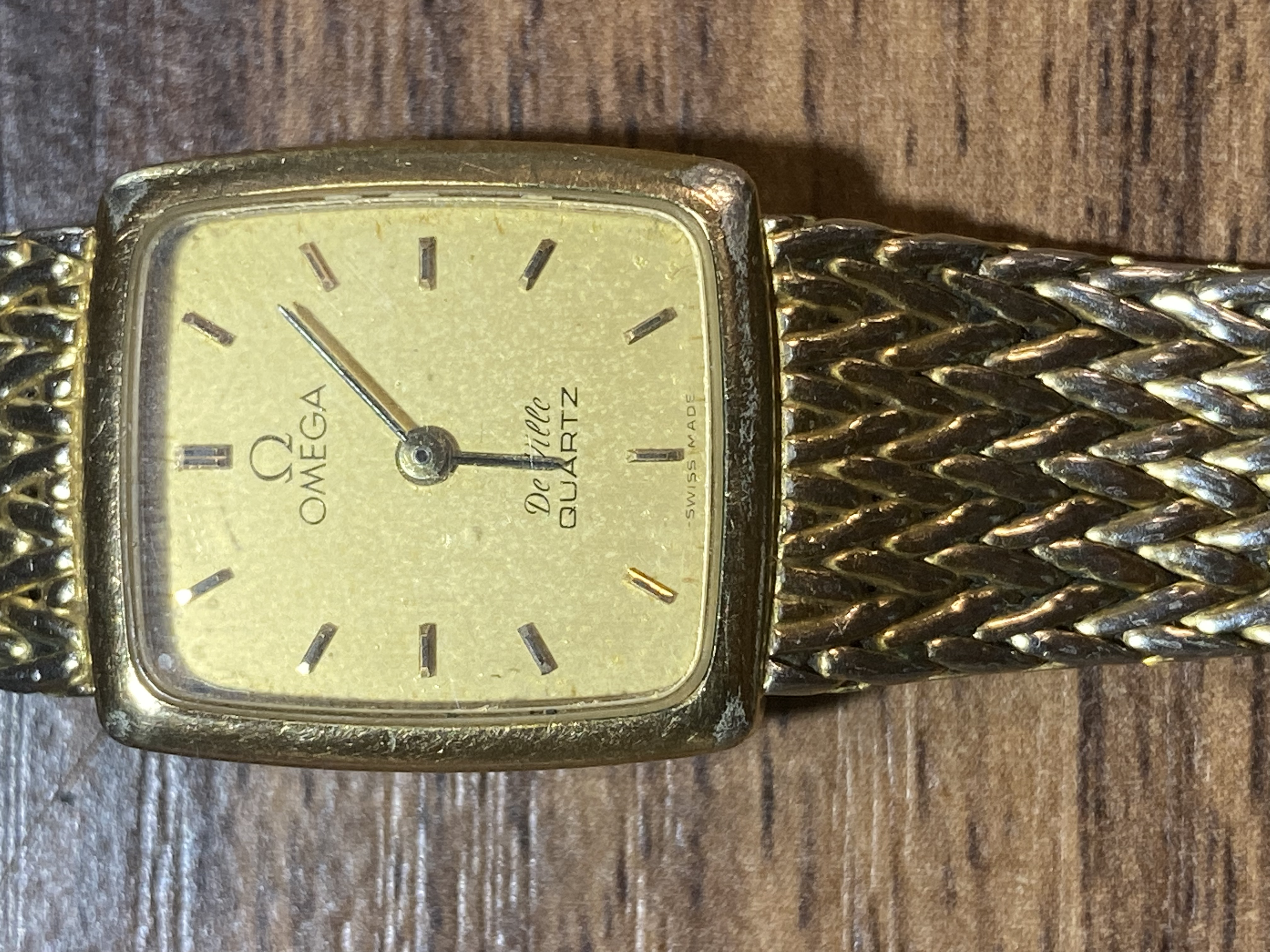

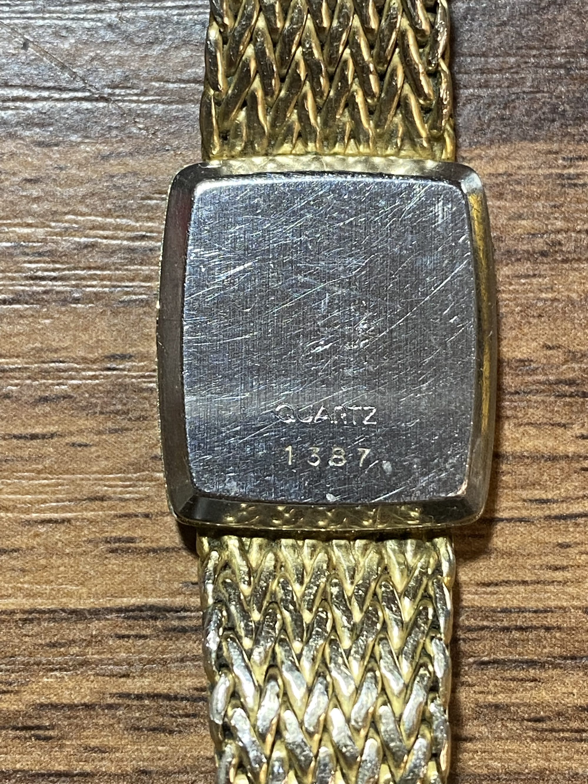

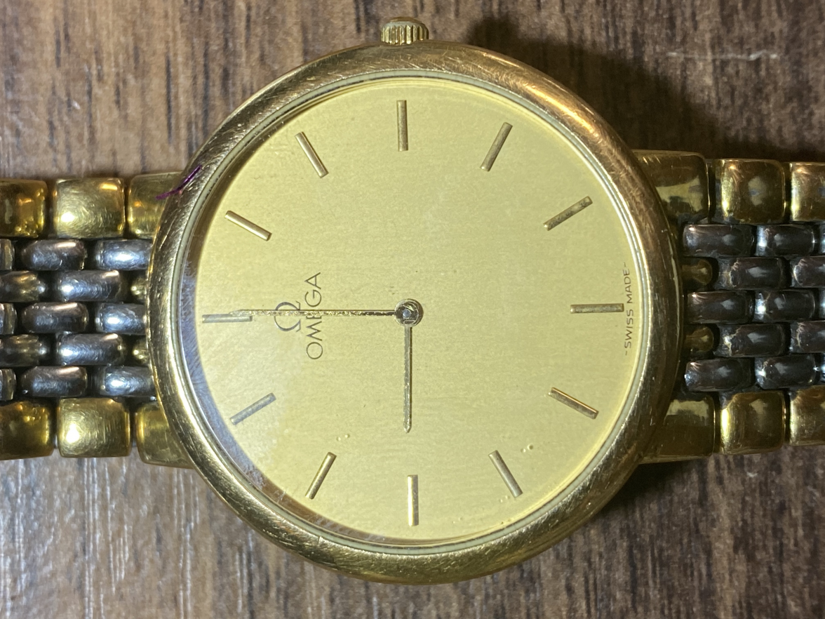

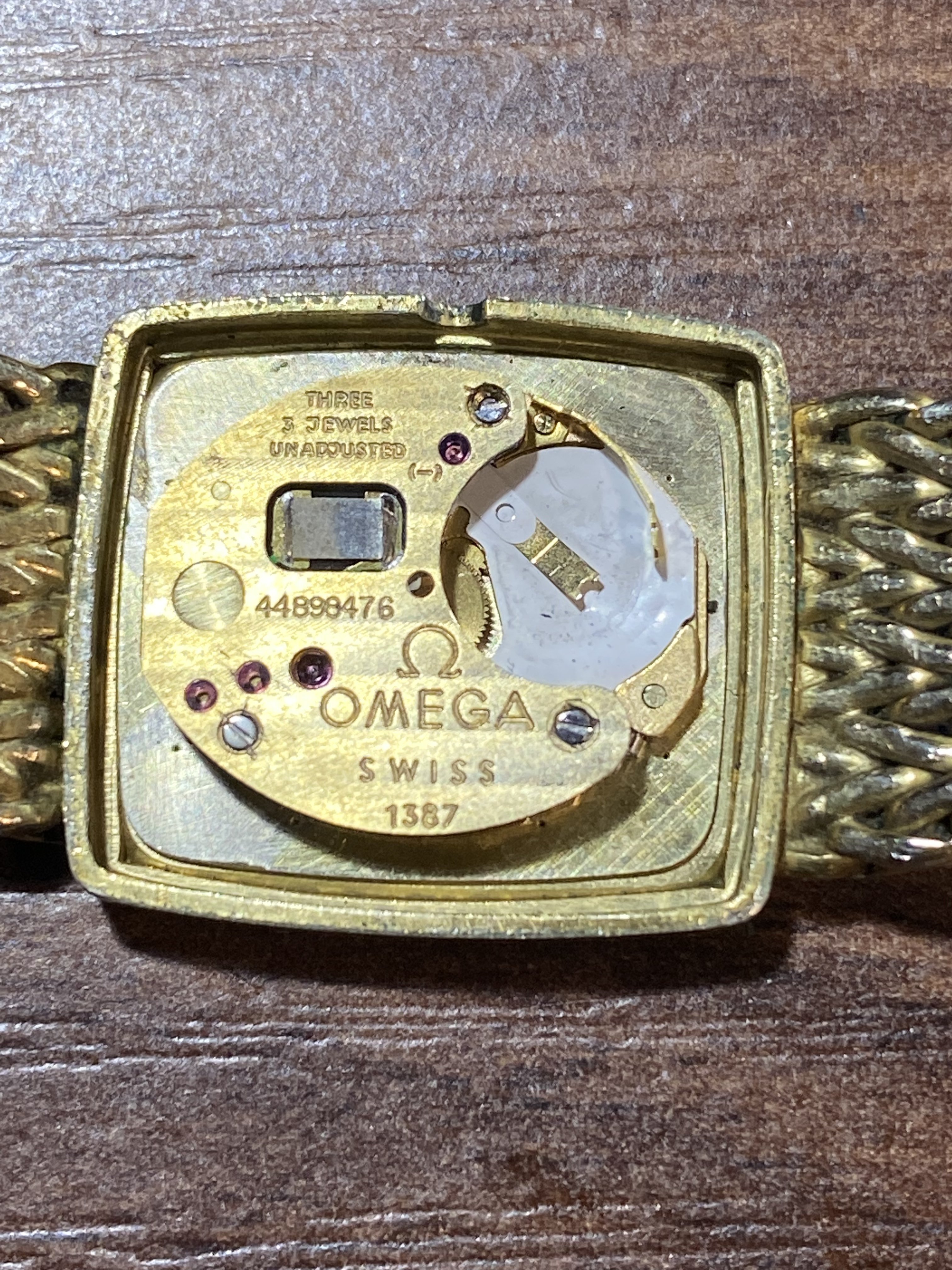

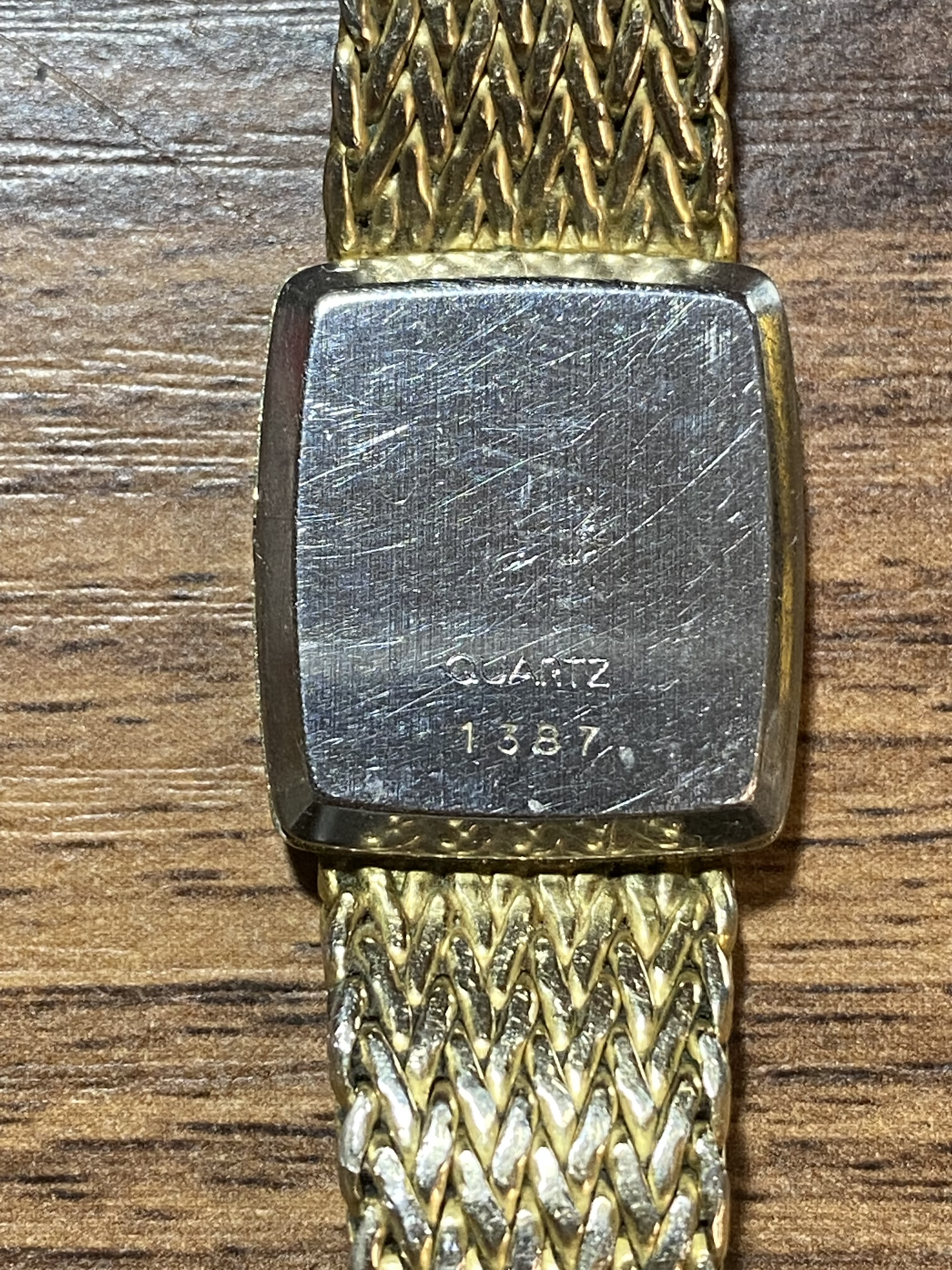

I have two watches from my grandparents both are Omega De Ville and both are not working as they didn't have batteries, I tried couple of batteries but they didn't work. I wonder what batteries are needed for both of them as I know that Omega watches sometimes requires specific battery models. Could anyone please advise? I would be thankful.
Here is my granddad Omega De Ville watch:
And here is my grandma's Omega De Ville watch:
HI
The first round watch, you schould have battery number: 341 / SR714SW
The second watch with caliber 1387 should have battery 321 / SR616SW

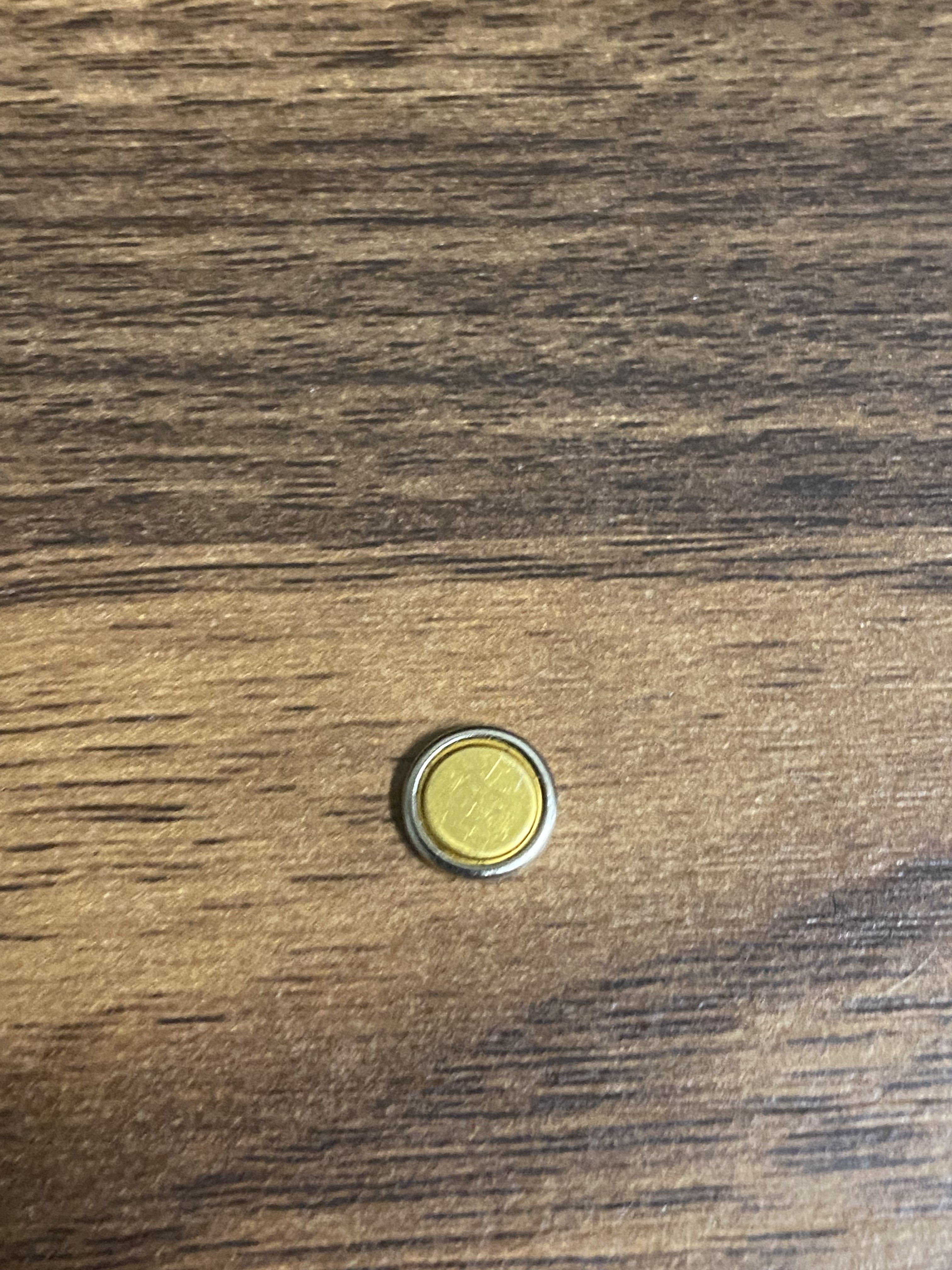

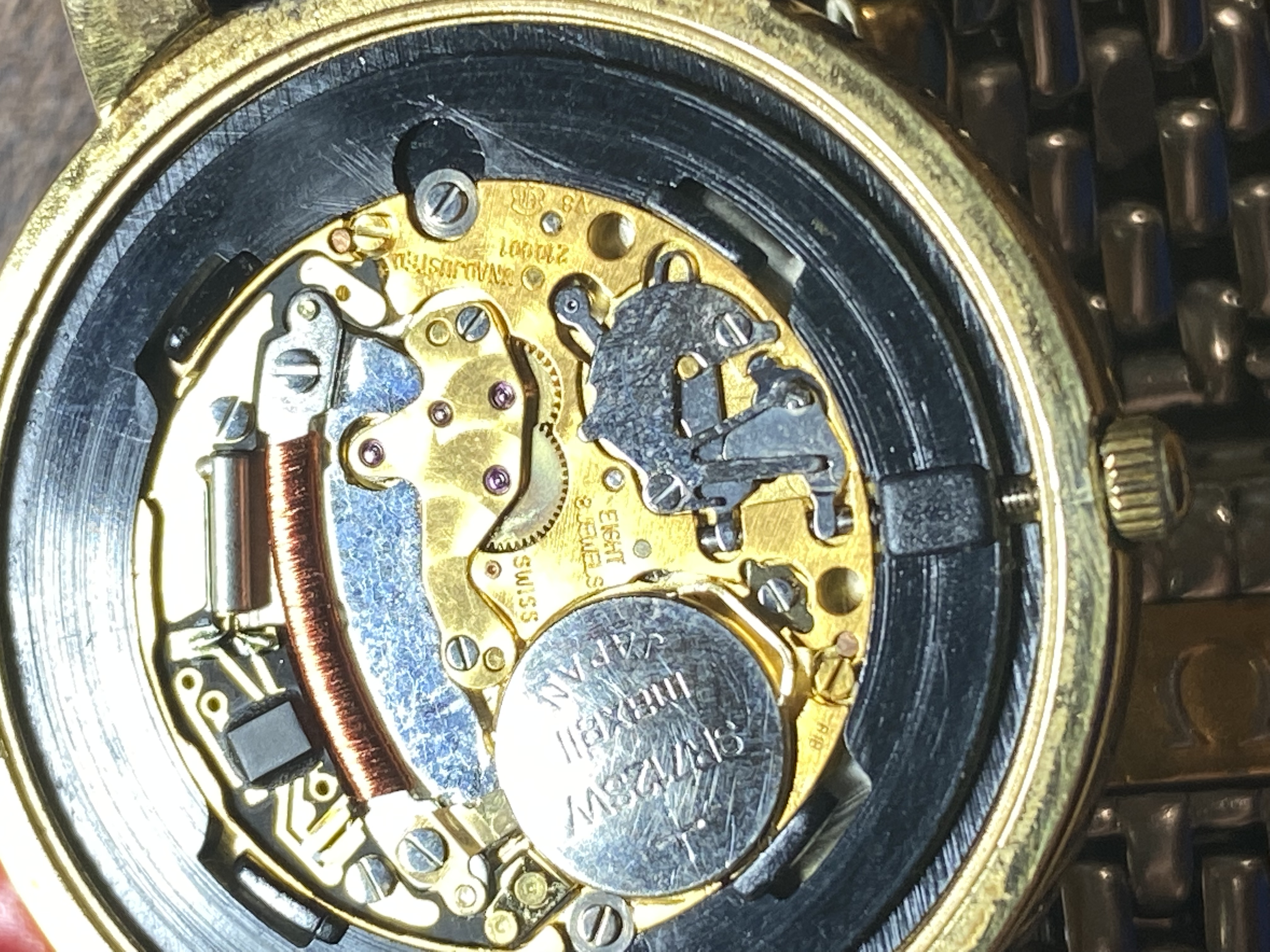

Do they need to be specific brand like seiko or maxell? The reason I am asking is because as shown in the attached photo the rounded watch had a battery inside which on one side was like bronze so I am not sure why? Does this golden thing in the battery means anything? Like is it true that some omega watches has very specific batteries to be used and only sold in Omega Or any battery with the numbers you send should work?
Thanks a lot for your help.
18,862
39,236
A button battery is a button battery, it doesn't matter who makes it. Well, maybe don't use Renata or cheap unbranded batteries.
Good reliable brands are Seiko, Seizaiken, Maxell, Varta.
As long as the battery from another brand complies with the OEM specified battery it will work.
If your watches do not work after inserting a battery in the correct manner, a visit to the watchmaker would be recommended.

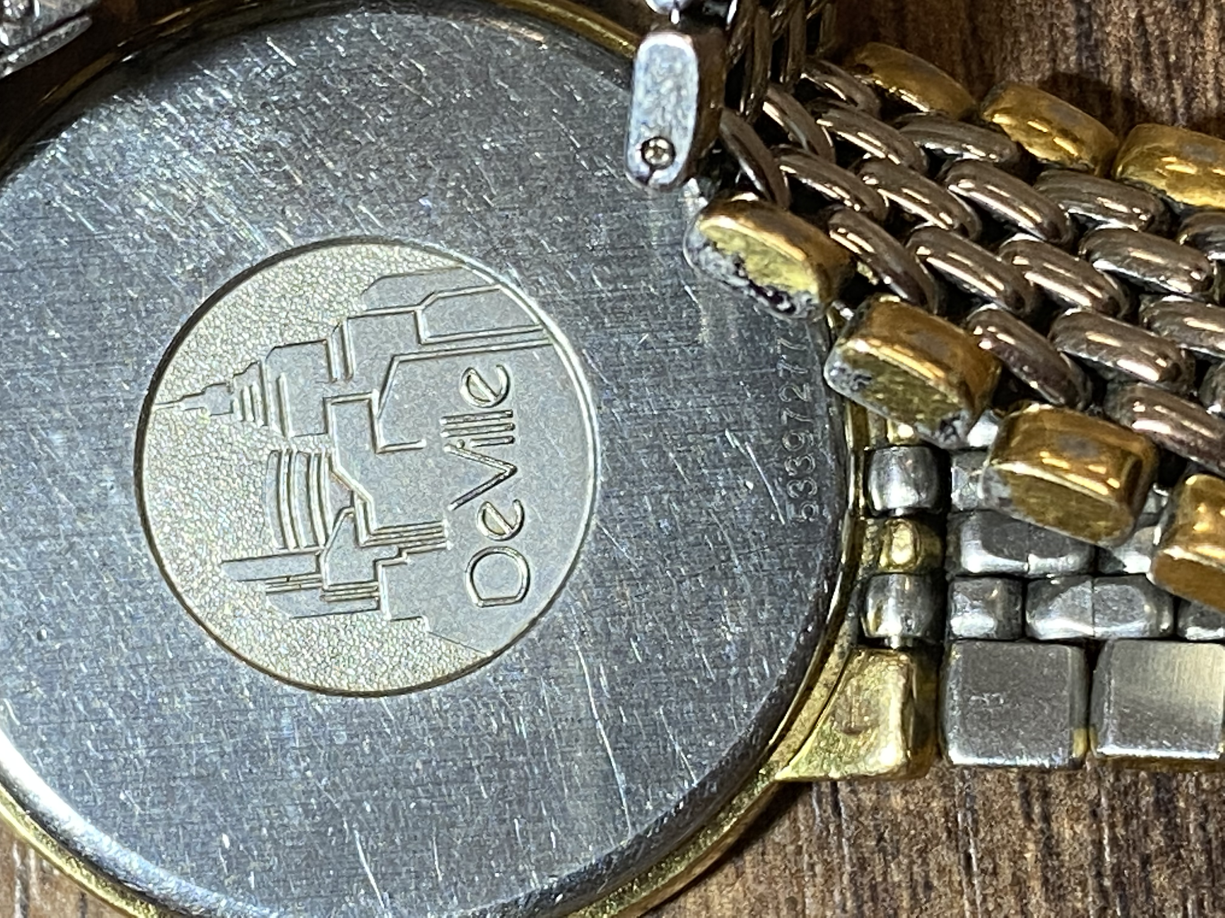

First watch...
Serial number: 53397277
Article ref: 63001100
341 is the correct cell.
321 is correct for the second watch.

Sort of. Sometimes differences in the shape of the cell (how rounded the corners are for example) can make a big difference in how the battery fits. But as you correctly state, sticking with the major brands is the way to go.

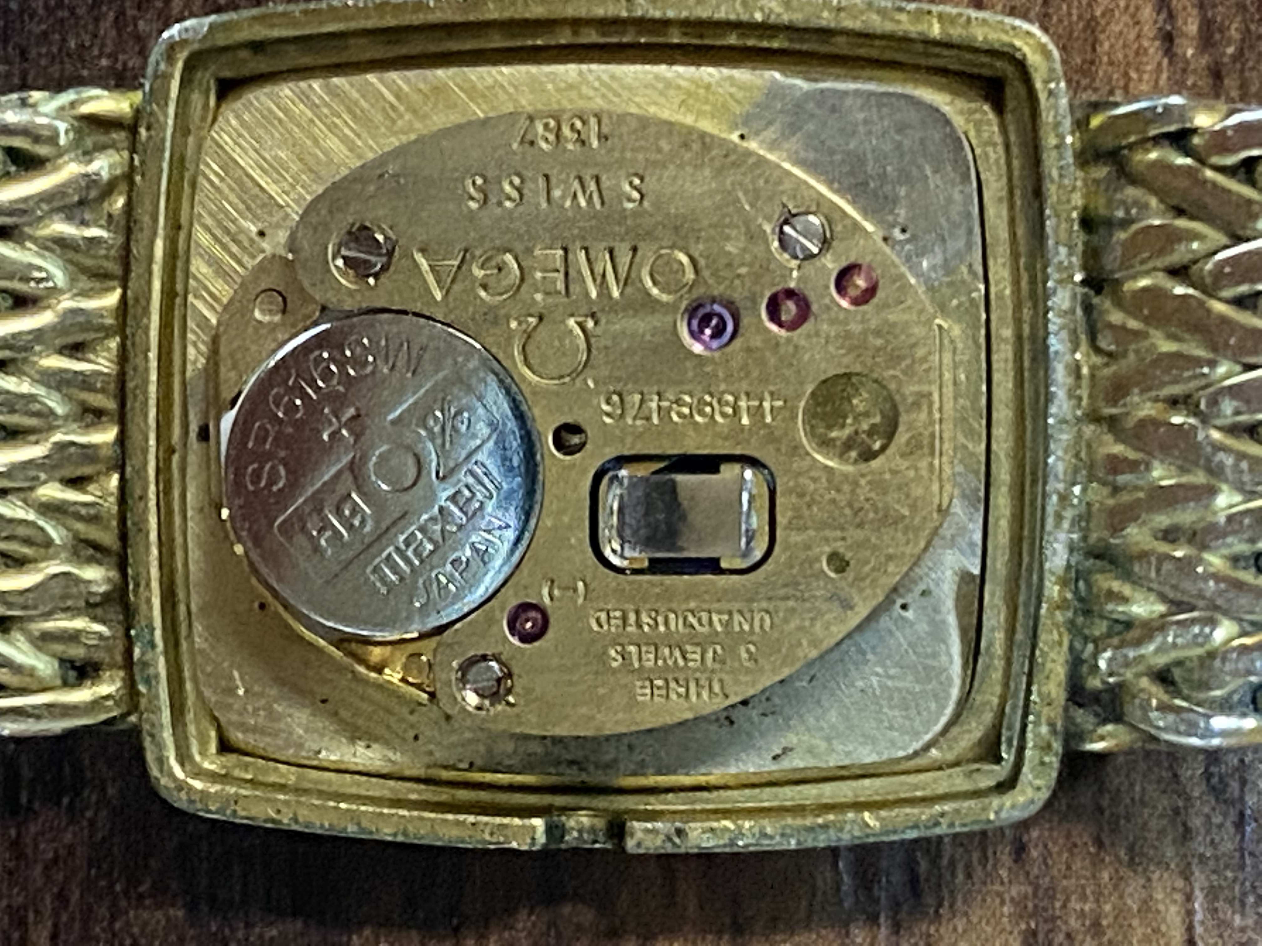

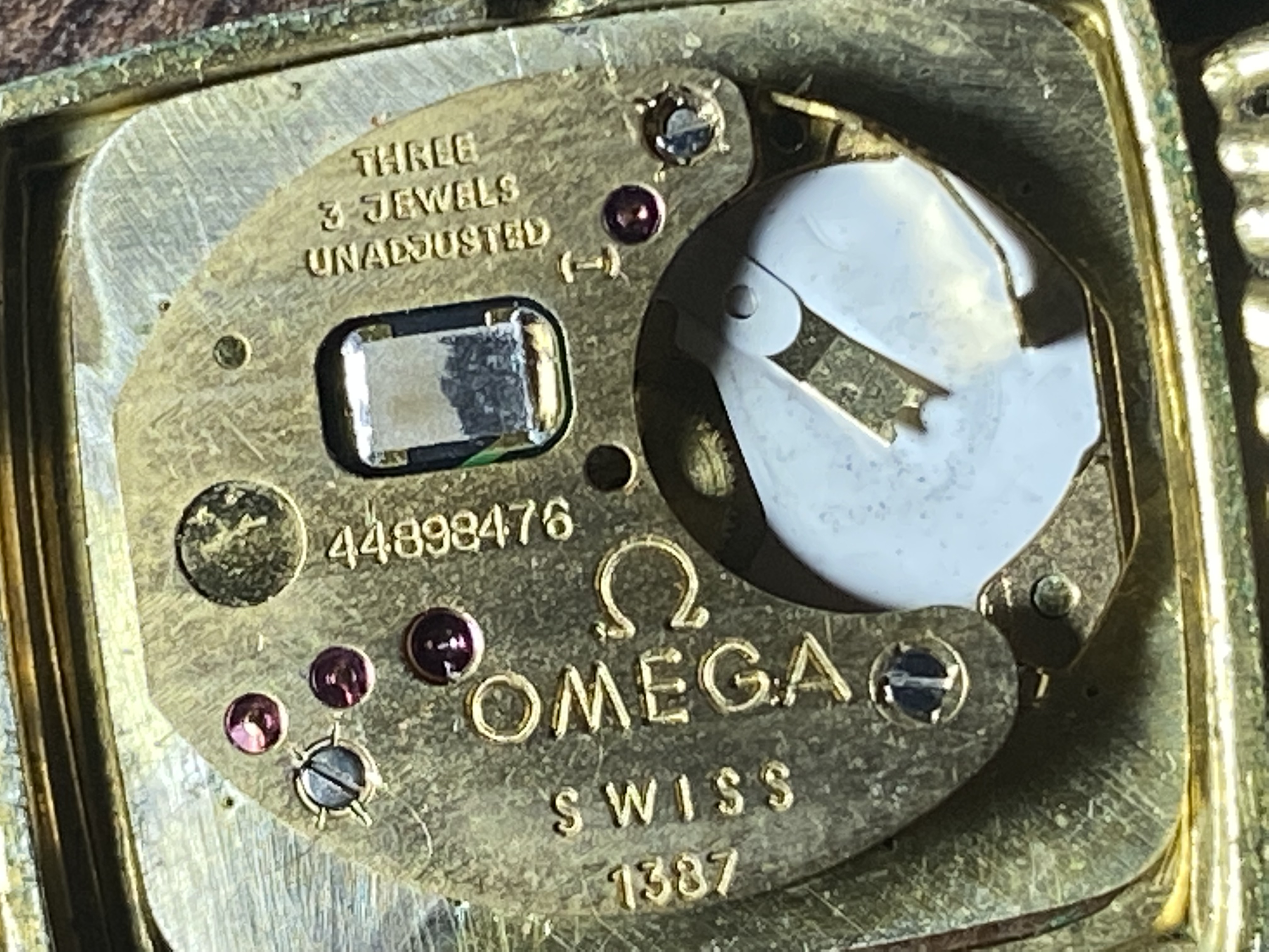

I've just bought a new Maxell 321 battery and placed it in my grandma's De ville watch but when pressing on the button it's not working, I even placed it on the pulse detector and no pulses is detected. Any idea what could be the problem? or any advice with steps of troubleshooting? here is how it looks from the inside:
30,353
78,309
There is often an insulator that goes under the battery - if it is missing the watch won't work.
If the contacts are corroded and there isn't a good connection, the watch won't work.
If the movement is dirty or the train is blocked by debris, the watch won't work.
If a coil has been nicked during a battery change, the watch won't work.
There are many reasons, so unless you have the equipment and knowledge to diagnose this yourself, you should probably take this to a watchmaker who can give you some clear answers.

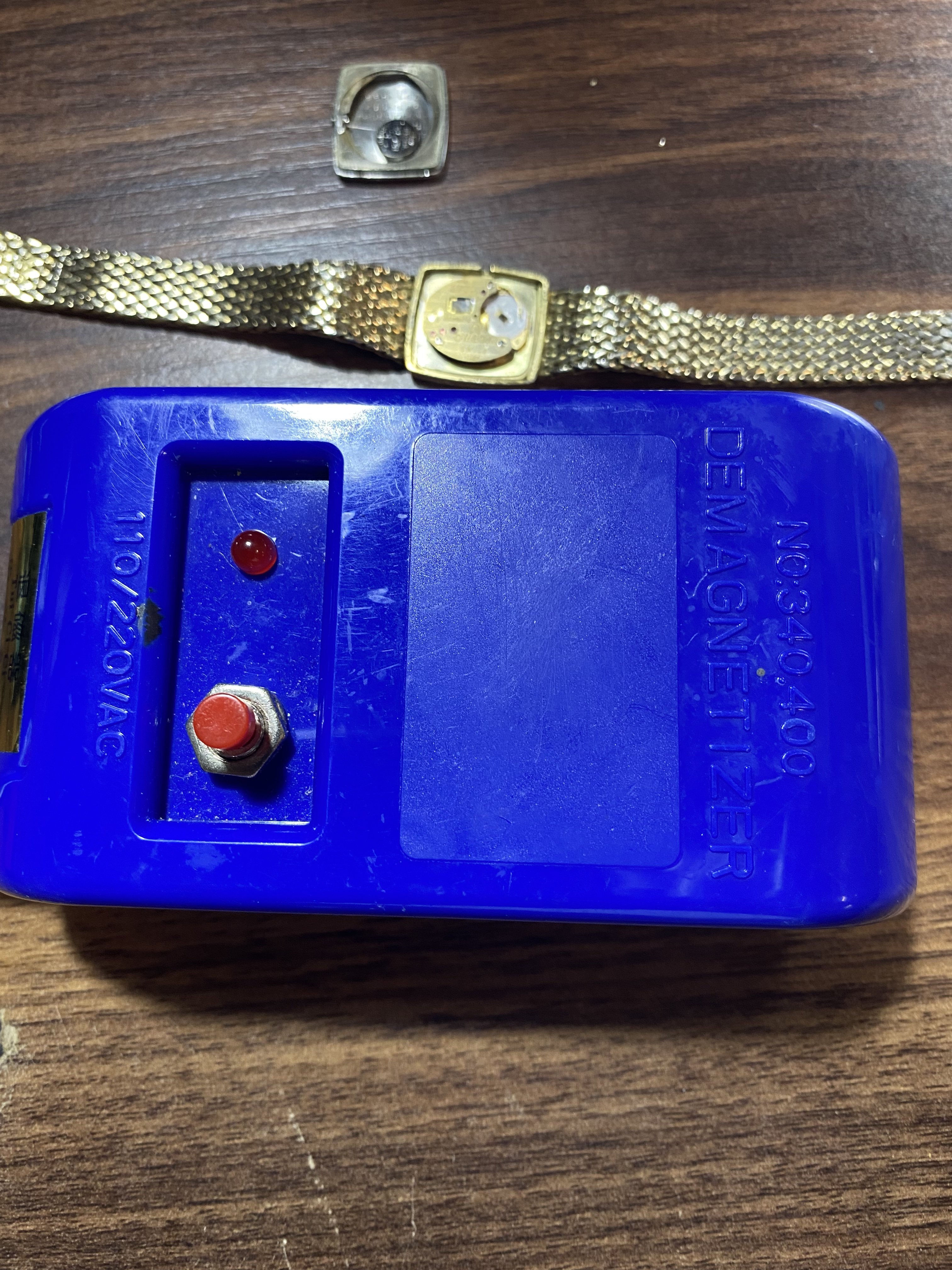

Thank you, I already checked the movement using the tool in the photo and the watch arms works and moves when placing it on top of this device (without a battery, it doesn’t work when the battery is there).
What do you mean by the insulator? I attach a photo of how it looks without the battery, does it look normal? Thanks again
30,353
78,309
The insulator is the plastic part you can see under the battery contact.
The “tool” you are using is a demagnetizer, which is not a tool for use on quartz watches. Using this on a quartz watch can damage the movement, since there is a permanent magnet in the movement that is part of the motor.

You have a battery resting in a metal watch case, so it will probably be shorted.
You are using a demagnetiser to fry your movement.
I suggest you consult a watchmaker to see if you can replace the movement or circuits block, maybe an ETA replacement is an option.

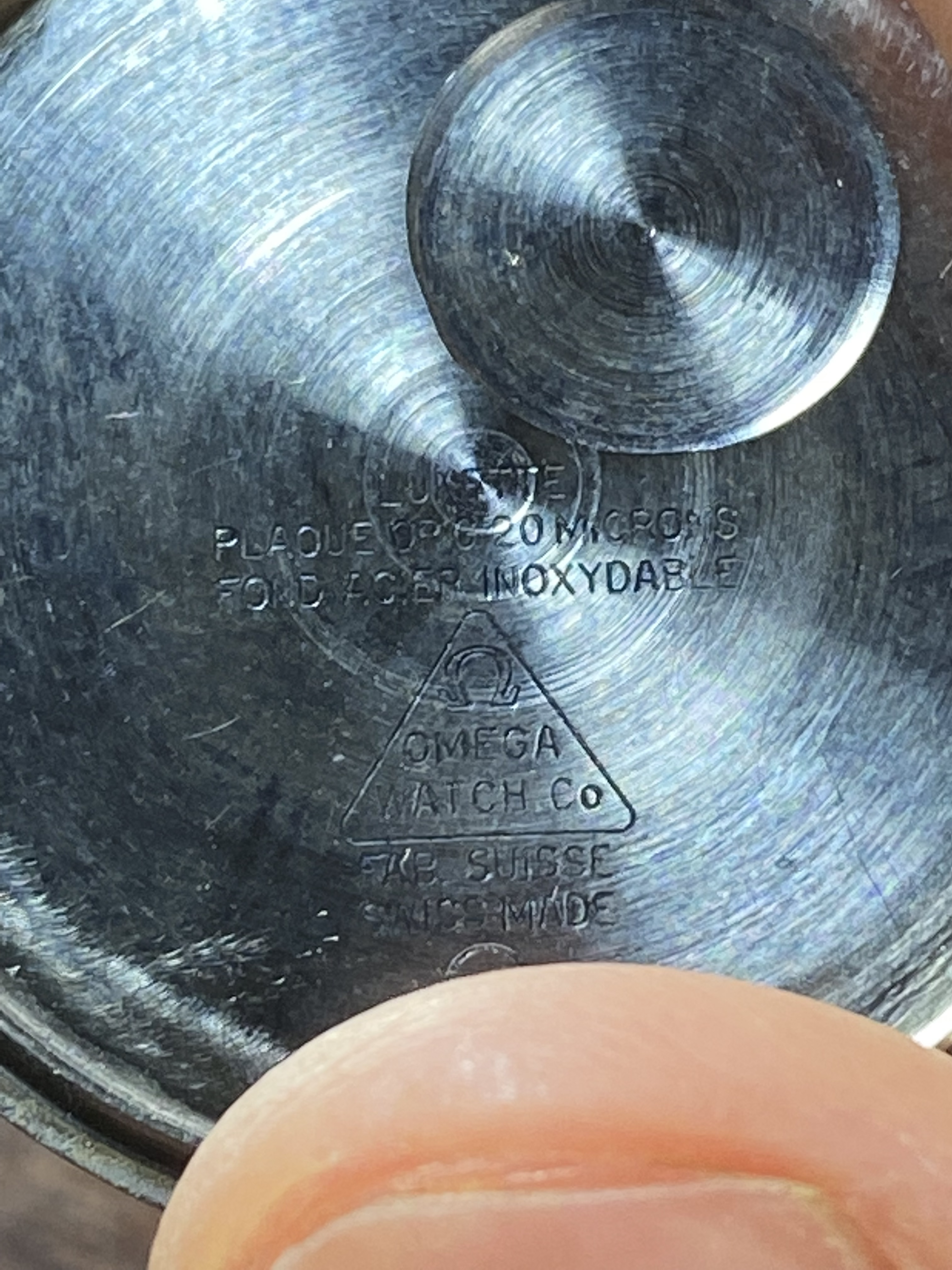

Hi, I have a Omega DeViile similar to the first round watch. On the inside is the number 45950793 & below that 1417, while on the inside of the back cover is 1950038 & 3950824. Will it take the 341 battery or can you please advise the correct battery.
30,353
78,309
373
30,353
78,309
Many thanks; I did try a GP373 without success. Would this indicate a malfunction in the watch itself?
If the battery is good, yes...
16,013
48,226
Having exposed a quartz watch (or any electronic watch) to a demagnetizer means you have likely just added to your paperweight collection! How on earth did you think that was a good idea?
