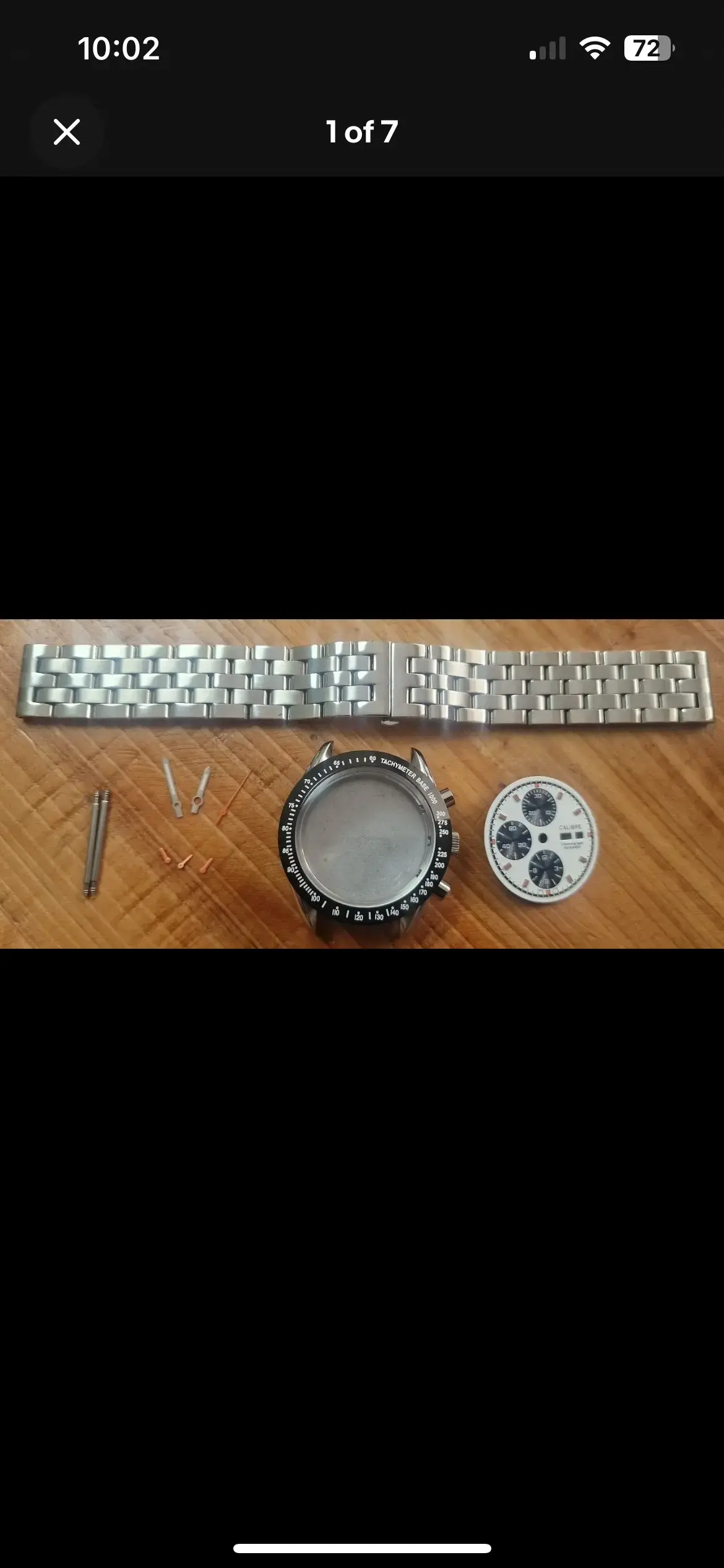

I ended up buying a “kit” for “7750” I suppose it’s one of those things manufactured to house Chinese 7750 clones like Shanghai or Dandong movements, nonetheless I like the look and was surprised with how economic it was
