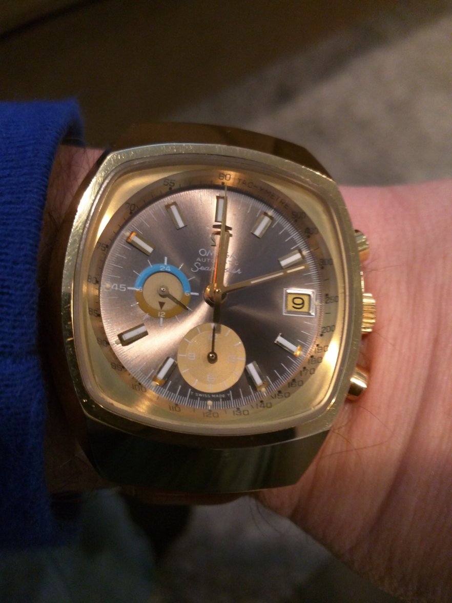

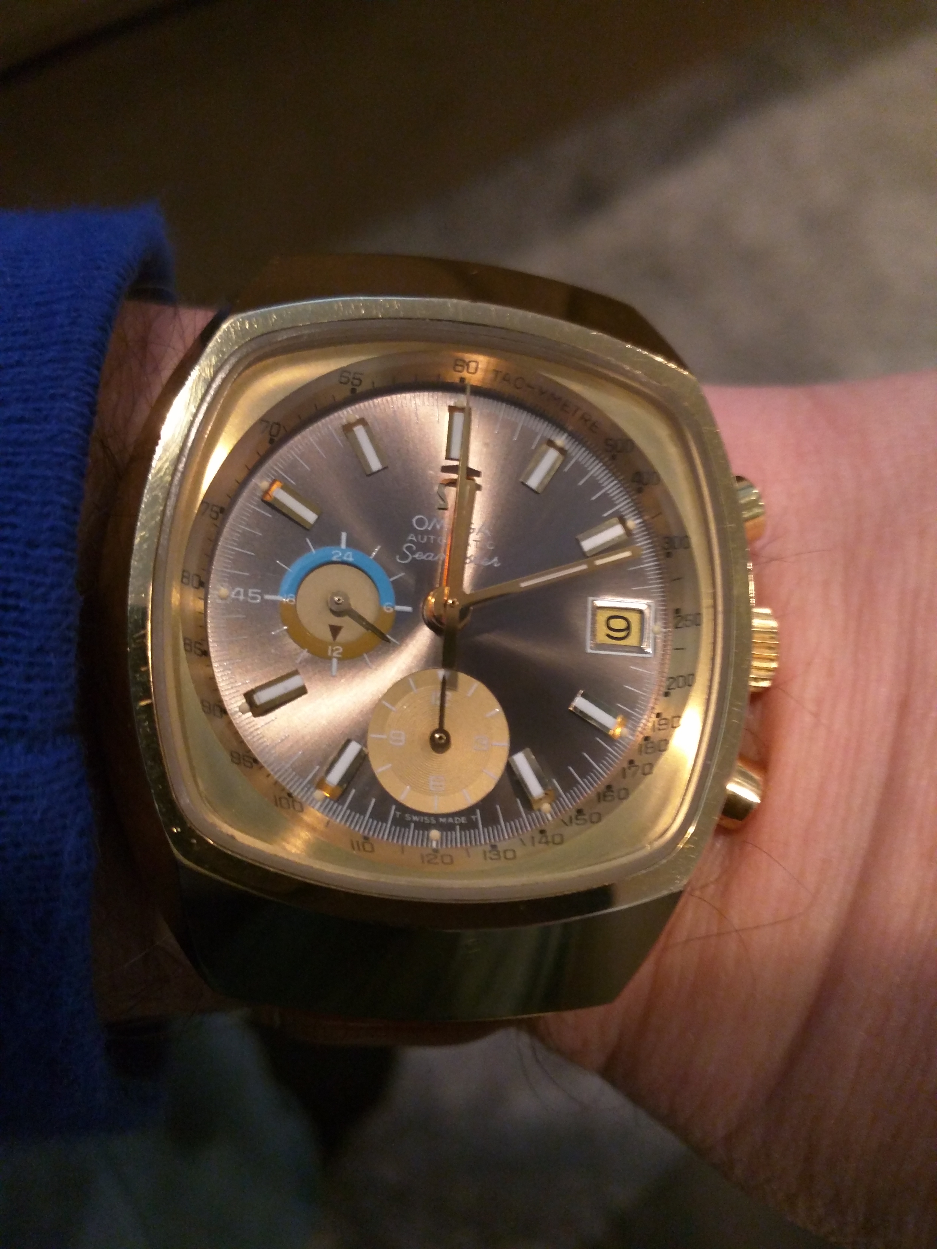

Thank you.
A picture of mine. I know the chapter ring isn't the correct color (should match the dial), but I like the way it looks...plus I can't find a chapter ring that matches the dial.

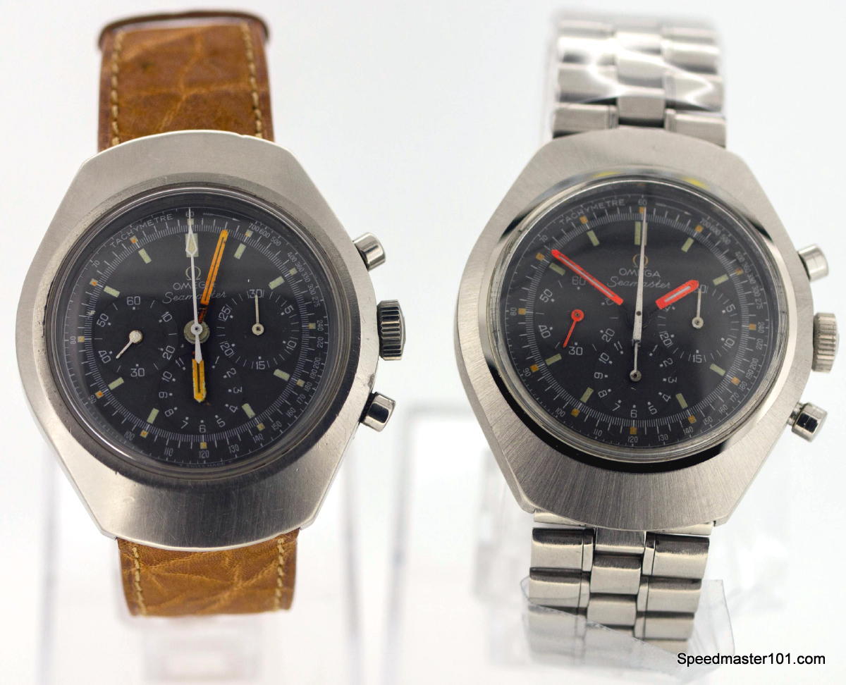

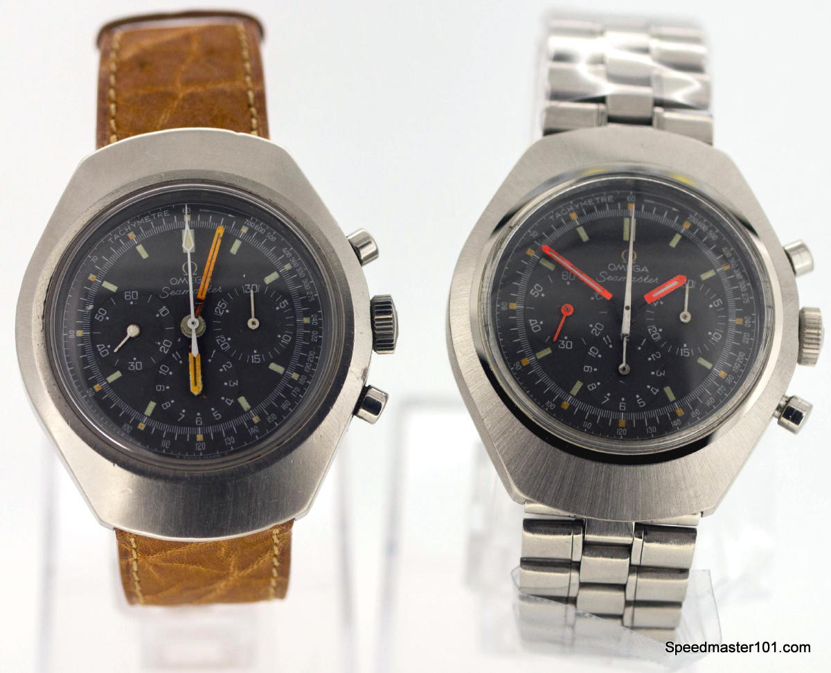

I cant believe we have let this slide so long....
THESE ARE NOT JEDI !
As coined by the late Chuck Maddox, who allocated pet names to watches he enjoyed, the jedi is a small 861 seamaster.
Here is a beaten up $600 one next to a NOS.
2,876
1,963
Yours are the real Jedi's. The others are imposters. 😉
