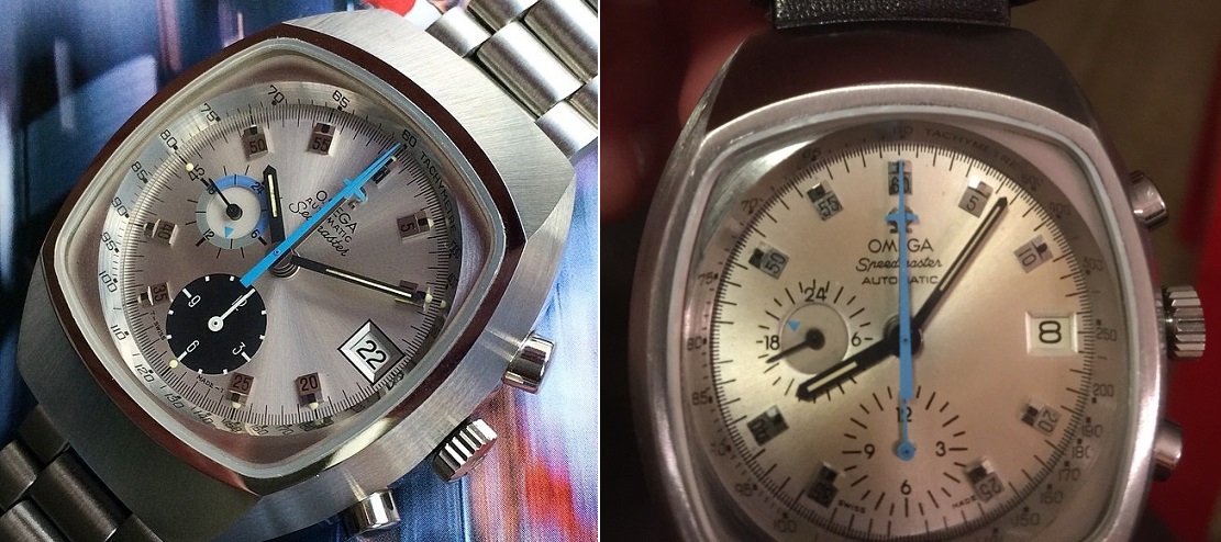

I have a few , the nos 176.005 thread is on the forum
89
37
The thing is guys, I have only seen one other dial like this (a picture on the web) and so have nothing concrete to compare it to. I don't know about the Guy in New York, but the auction houses in London don't really have any in depth knowledge, their watch specialists have a lot less knowledge that one would hope. Most of it is bravado.. They rely on others, and keeping your watch for weeks before a sale, and those others never have as much credence as Omega or Rolex anyway.
If e get into "s is iffy" or the "24" gives me issues il have to say again that actually it's been back to omega this month. They said it's an original dial to the case.
Shall we get into the "it's an iffy O" for a Rolex sub?? It doesn't really stand up.

Not sure if this is the source of this watch, but it seems to be the same "prototype", note the origin of Romania as well as flaky info and conclusion about "prototype": http://www.ebay.com/itm/261501131239.
Two more iffy points on this dial: No index for the 9 o'clock and no 45 chrono minute label - which, from all I've seen, is present on all the dials for all models with the 1040 movement. Of course, I've never seen a true prototype dial for this movement yet, but the quality of the OP's dial doesn't seem to be up to Omega's standard on vintage dials, prototype or not.
2,269
4,263
I must say that I´m stunned to read the speculations in this thread, about OP´s watch being all other things than what it obviously is, a really sloppy redial... I cannot see anything interesting in it at all, and besides a sloppy redial, a really mediocre case job too. 😲
Just look at the details, compared with Stefan´s NOS specimen:

That watch is new old stock. Mine had been used for 40 years! Let's not get offensive marturx.
If it was a "real sloppy redial" why would an "omega credited service centre@ and the accepted vintage service centre for omega in the UK (where there are thousands of vintage omegas) not say anything about it.
Let's not get into mud slinging. It's just rude.
In the UK, when you send a watch to the Omega service centre, (where all ADs send the watches for service) if they are vintage they go to STS. They then come back to the AD with the correct omega paperwork. You can own a Mercedes franchise, your not actually Mercedes but your repairs all carry a Mercedes warranty. Your customers expect Mercedes customer service and when someone drives in a merc 500SEL with a fake engine, you would refuse to work on it or at least, refuse to give a merc warranty when it's fixed.

Look very carefully and you will see that the 20 to 40 markers have been put on upside down ::facepalm1::

The original airplane hand is orange on black and the chrono seconds white
It belonged to a friend since new yes. I've owned it for 10 years, but not used it for the last 7 or so.
Isn't it the same as the one from Romania I linked to above?

I think it's exactly the same, including hands, missing 45 and flat subdial.
2,876
1,962
Hands arrangement, before your recent change, doesn't follow Omega's convention either, besides the weird dial. I don't think anyone would take this watch seriously, except those who can take your money.

20 to 40 markers upside down has done it for me sorry but redial
