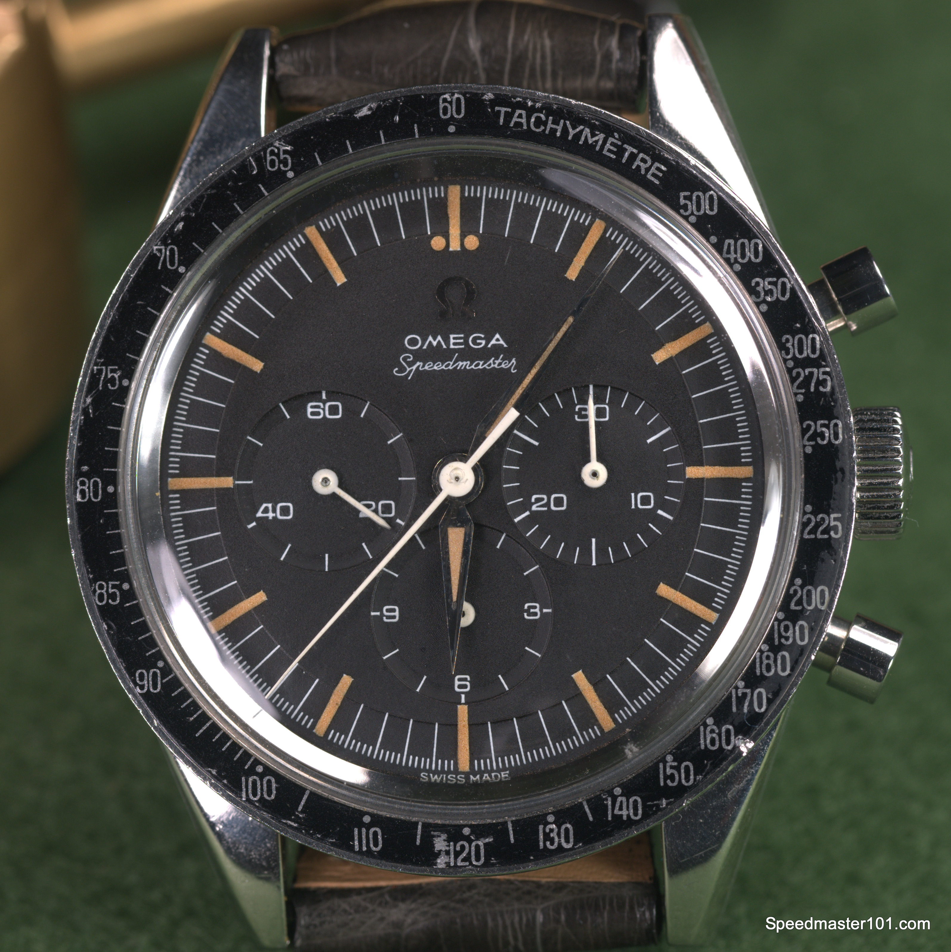

If I bought this at the advertised price at this point in time, any enthusiasm I had for this watch would disappear each and every time I took a glance at the lugs (and the bezel)
The lugs, in my opinion are irretrievable. The curved planes have been flattened, the lug ends are rounded and it seems to me from these photos that on the upper faces, enough heat has been generated through polishing as to have altered the composition of the metal surface finish. Looks more molten than polished.
Removing any more metal is not going to fix this problem.
I don't think the lugs are quite that bad, the general shape looks good (although I haven't seen the original listing). They just have some surface scratches, which prevents it falling into the collector category.

I know I am being picky, but the exorbitant asking price demands that of me.
The photos indicate that there is more than just wear when it comes to the case.

The OP watch is not what I thought of when I coined the "collector" level.
This isnt either, luckily, because I have been wearing all day.
5,861
16,791
On closer inspection, I have to agree that the watch has some faults. I think I was blinded by the dial and fell in love.

Is it a big deal this 2998-4 sub dials' hands are straight and not leafed???
5,861
16,791
I think not. According the MWO, either type of sub register hands was used.
572
419
agree. wouldn't prevent me from buying this watch (i tried) but i prefer leaf hands.
9,217
24,057
agree with Gemini4 and E-diddy, both are fine. it's like the FOIS, but better (excluding the second subdial which had a leaf hand for some reason on the FOIS).

At what point would you consider it overpriced
114
211
Market price of sold watches in ebay is aproximatley 15000usd for similar grade. Speedmaster101values them at 14000usd. Therfore asking 22900 is 50% higher.
5,861
16,791
Remember that speedmaster101 price chart, which is from May I believe, is for the head only. You would have to subtract the value of the 7077/6 ($2,000 ish) from the store asking price.
