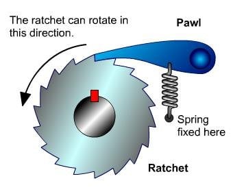

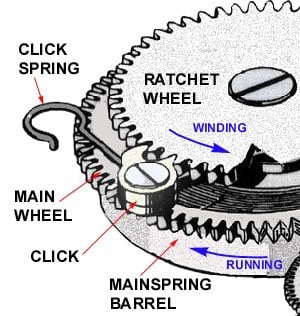

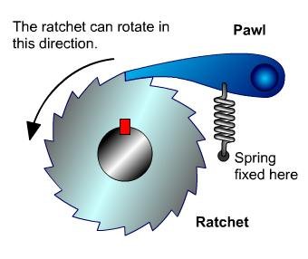

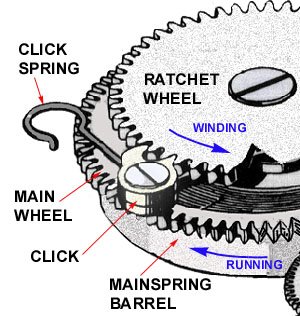

When winding a watch, you engage something called the ratchet wheel. If you're ever used a ratchet tool, you'll be familiar with the backward give.
As the spring barrel is wound tighter, it increases the tension, leading to what Annapolis mentioned.
3,323
24,479
I took a quick video showing the interaction between the click and the ratchet wheel. You can see the ratchet wheel (and by extension the crown) wind backwards a bit as the click springs back to engage the ratchet wheel preventing it from unwinding.
