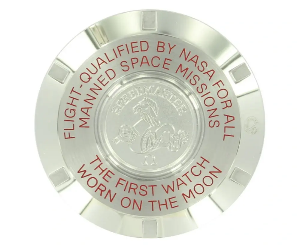

would Omega manufacture a service caseback with this flaw?
Well, here is the photo of the case back on the Extranet...
While I won't say it is impossible that Omega would make a case back with improper spacing, with many years of buying cases and case backs, I've never seen anything even remotely as far off as what you are showing. I would certainly be sending it back immediately if I ever received one like that, but I doubt I ever would.
Honestly to me the case back shown in that eBay advert just has so many small things that don't look right, I would advise anyone thinking of buying it to avoid it. It just looks sloppy overall, from the things I've already mentioned to just the quality of the finish all over, it just doesn't look right in those photos. The fact that the same vendor is selling flawed case backs makes this whole thing even more flaky in my view.
For your case back, since this is an exchange only item, to get a new one that definitely comes from Omega, the one you have would have to be sent back. My guess is if you do that, they will tell you it's not genuine.

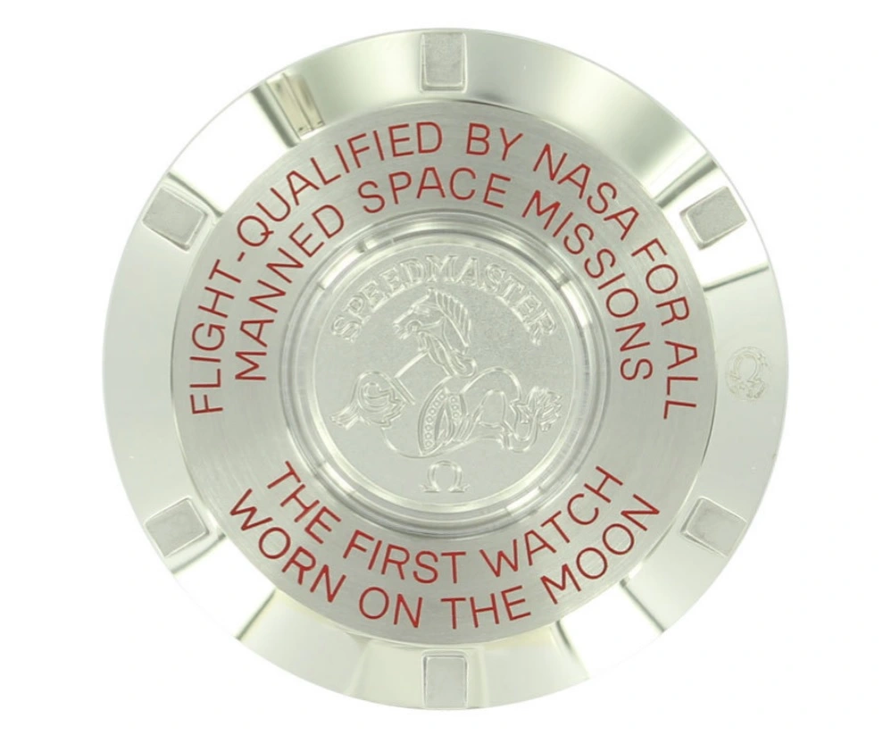

The guy who sells this mid case also sells a complete case - mid case, pushers, bezel, caseback, etc. It has the caseback with the obvious spacing issue (“MISSIO NS”) in the lettering. As I noted earlier, I stupidly bought one for my Speedmaster Tintin Mod (and changed the paintfill to red):
At some point I’ll replace this … it annoys the hell out of me. Here’s the question, though … would Omega manufacture a service caseback with this flaw? And if not - meaning that the caseback is bogus - wouldn’t that call everything else he sells into question?
I’ve only just realised what you’re saying. Yours isn’t a tin tin caseback. It’s the standard one they sell and you changed the text to red.
Yeah I agree then that’s concerning unless anyone can present a caseback with the same spacing from a trusted source.
It does start to feel like there’s too many questionable parts from this seller.

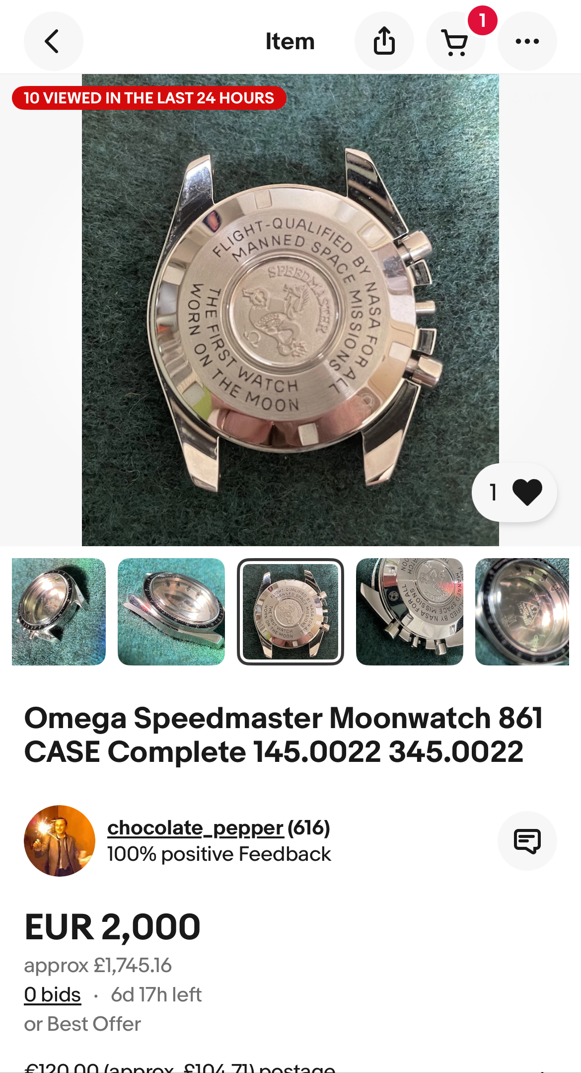

Here’s another of the Speedmaster cases with questionable case back for sale on eBay (at an opening bid of €2k). Took exception to me questioning its authenticity but could only say he bought it from an “omega seller”.
https://ebay.us/m/Goux5C

I'm in a similar position where I can't really speak to the authenticity of this seller's midcase from a technical standpoint, although I initially raised red flags due to other parts coming from the seller. In my case the seller advertised speedmaster bezels in the same way (i.e. genuine NOS parts from the 70s etc), but the one I received was conclusively fake. I've also seen this seller posting full speedmaster cases which marry the midcase in question to the fake bezel I received.
I find this example particularly worrying as the seller has been posting these items for several years (I think I flunked out on the fake bezel about 5 years ago), I'm aware he's sold an awful lot of them, and have seen they're starting to recirculate through to resellers, private sellers' project watches etc

Well I reached out to the seller to ask straight out if the cases are legit. I pointed out the gap in 'MISSIO NS' and the blurry case lines and was told the claims were 'Erroneous and misinformation.'
337
279
That doesn’t surprise me. I wonder what it would take to get Omega to investigate.
