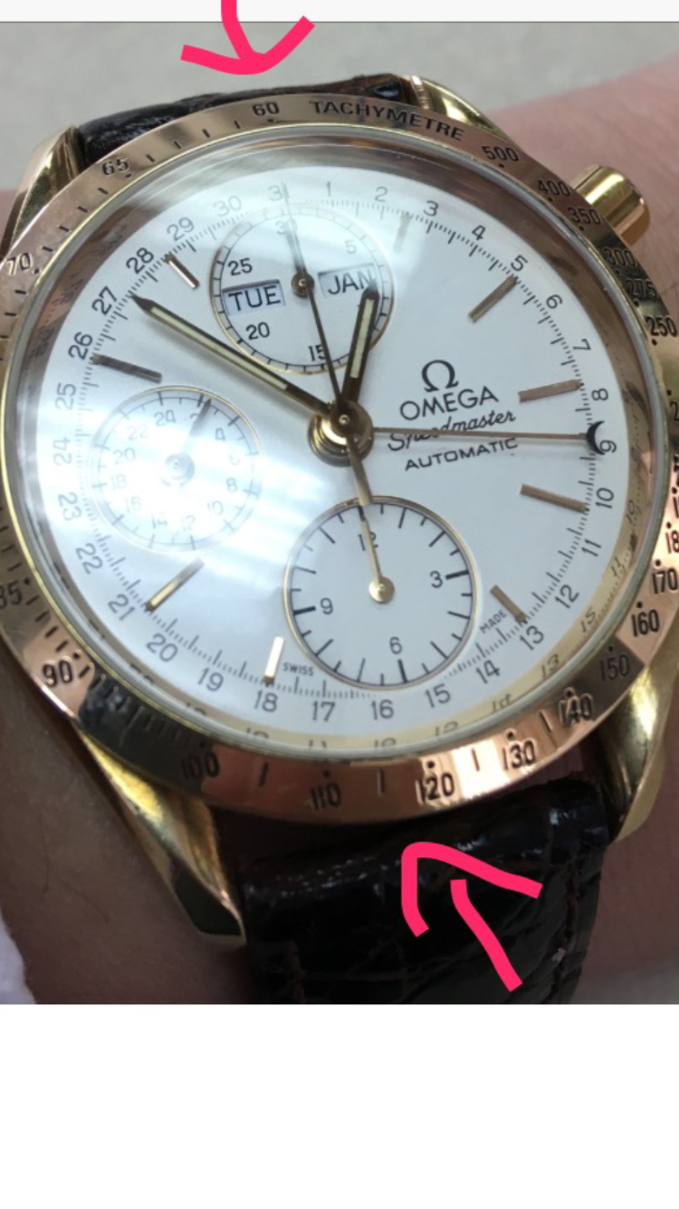

Omega Speedmaster 18k Gold Triple date (day date) missing hallmark on case

Honestly it's not possible for a gold case not to have a halllmark it has to be somewhere!

On my gold Speedys the hallmarks are where Al indicated fwiiw.

It seems a picture was removed from the first post by the OP (the one posted and annotated by Archer here https://omegaforums.net/threads/ome...e-missing-hallmark-on-case.69294/#post-871986) so it's rather confusing now...
Per Archer's annotation it seems he spotted two hallmarks on the actual case, top left and right, although I can only see the one in the top left.
EDIT : actually he pointed the arrows to where they SHOULD be per the Extranet...it seems to me there could be one on the OP's watch where the left arrow points ?

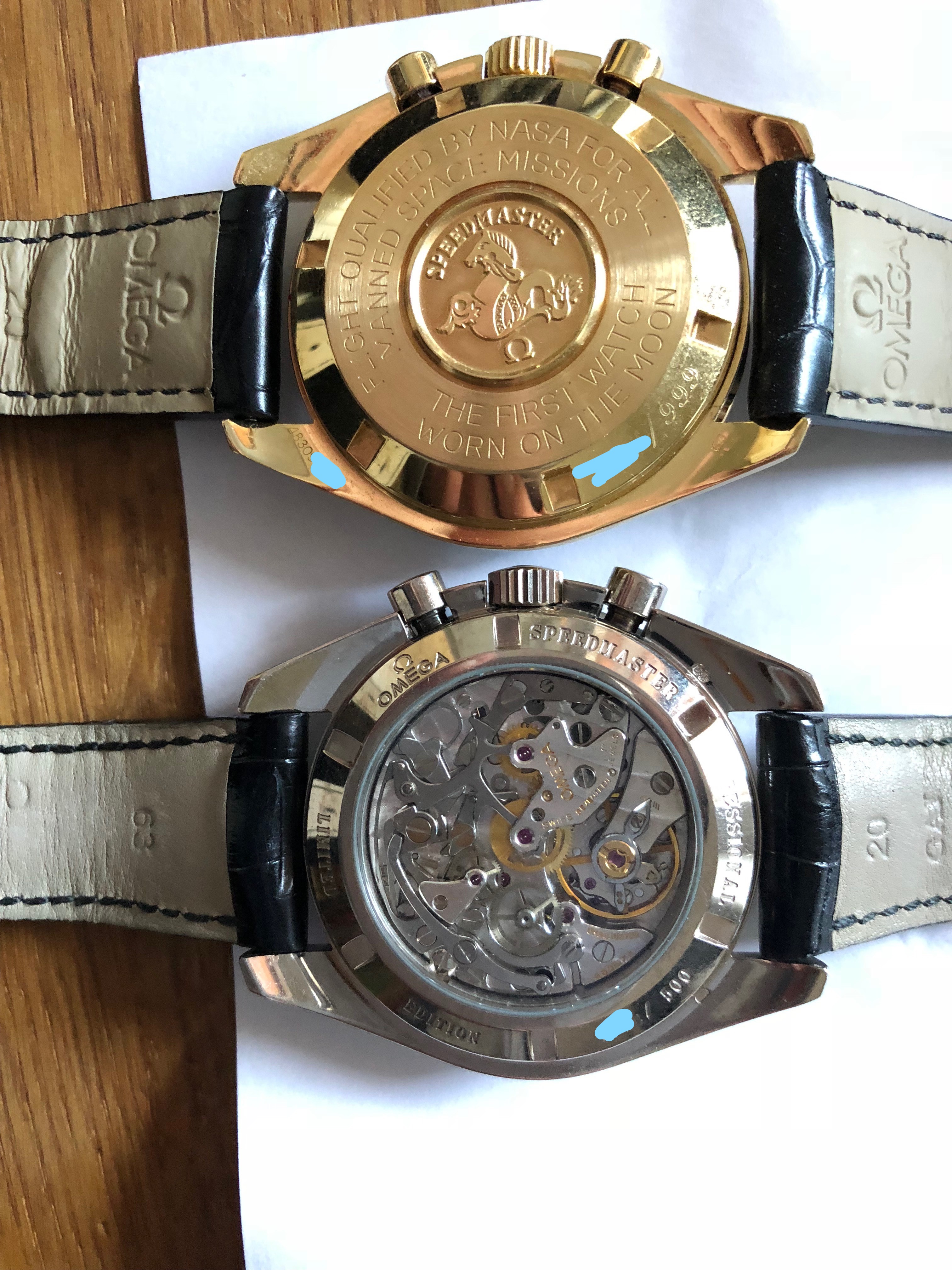

Two of mine for reference, yellow gold one has seen a bit of polishing...

Do you really checked this point?
Reziprozi, was not notified of the posts following for some reason.
Yes checked there. There were no marks.

I removed the original photo, because it had the serial on it, was told that some people might steal the serial, so I removed that picture.

I have been to an omega authorised dealer, and she said that the mark might be inside the case, she said that some of the older watches might have it that way. She said the weight feels like gold. I have from since then seen some watches on the bay as well as on chrono24 that had speedy without the hallmark at the back.
Drhex! That's a very nice speedy, is that a 321 cal?
537
898
These are an 863 and 864 (Chrono certified 861) respectively. Don't think there is a gold Speedy with 321 inside, the first gold one is the BA145.022, which has an 861.
