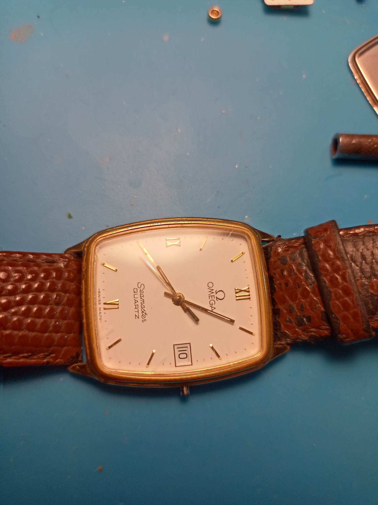

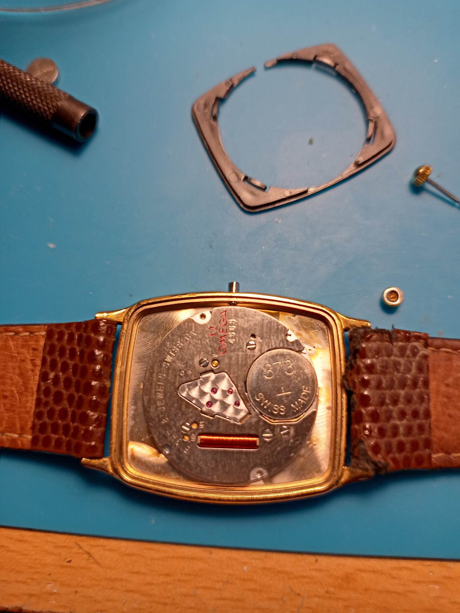

O Posts 2 Likes 0 ohspecial1 ·Mar 15, 2023 Hi folks Omega seamaster all seems genuine Until the movement which says 8 jewel 4563 but cannot find any details about it Watch case has 1430 on it
Posts 1,561 Likes 3,672 Gav1967 ·Mar 15, 2023 I think the 4563 movement was a replacement for the 1430 when that was discontinued. Suspect it was replaced during a service at some point
Posts 18,840 Likes 39,184 JimInOz ·Mar 15, 2023·Melbourne Australia As @Gav1967 noted, the movement is a modern replacement for the discontinued 1430, so not a fake watch. If it had been serviced by Omega, they would have used that caliber.
Posts 18,326 Likes 27,696 Foo2rama ·Mar 15, 2023·Nowhere near as grumpy as he used to be... Real and as noted service movement.
O Posts 2 Likes 0 ohspecial1 ·Mar 16, 2023 Many thanks folks Just couldnt find any details or matches to this movement Any idea im looking for stem replacement
