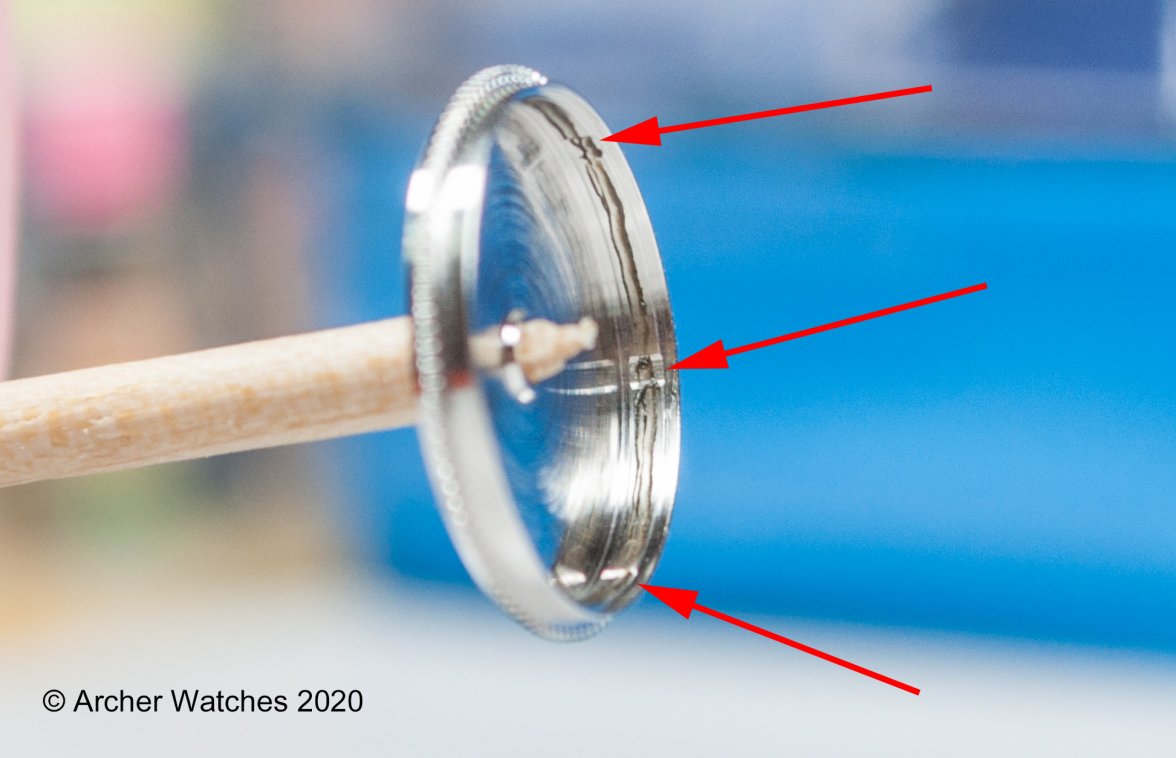

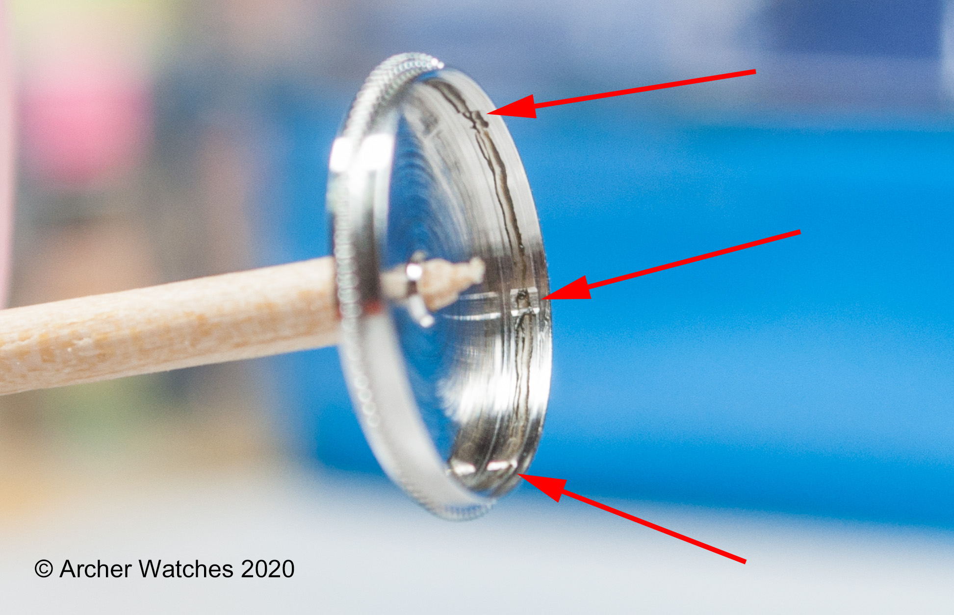

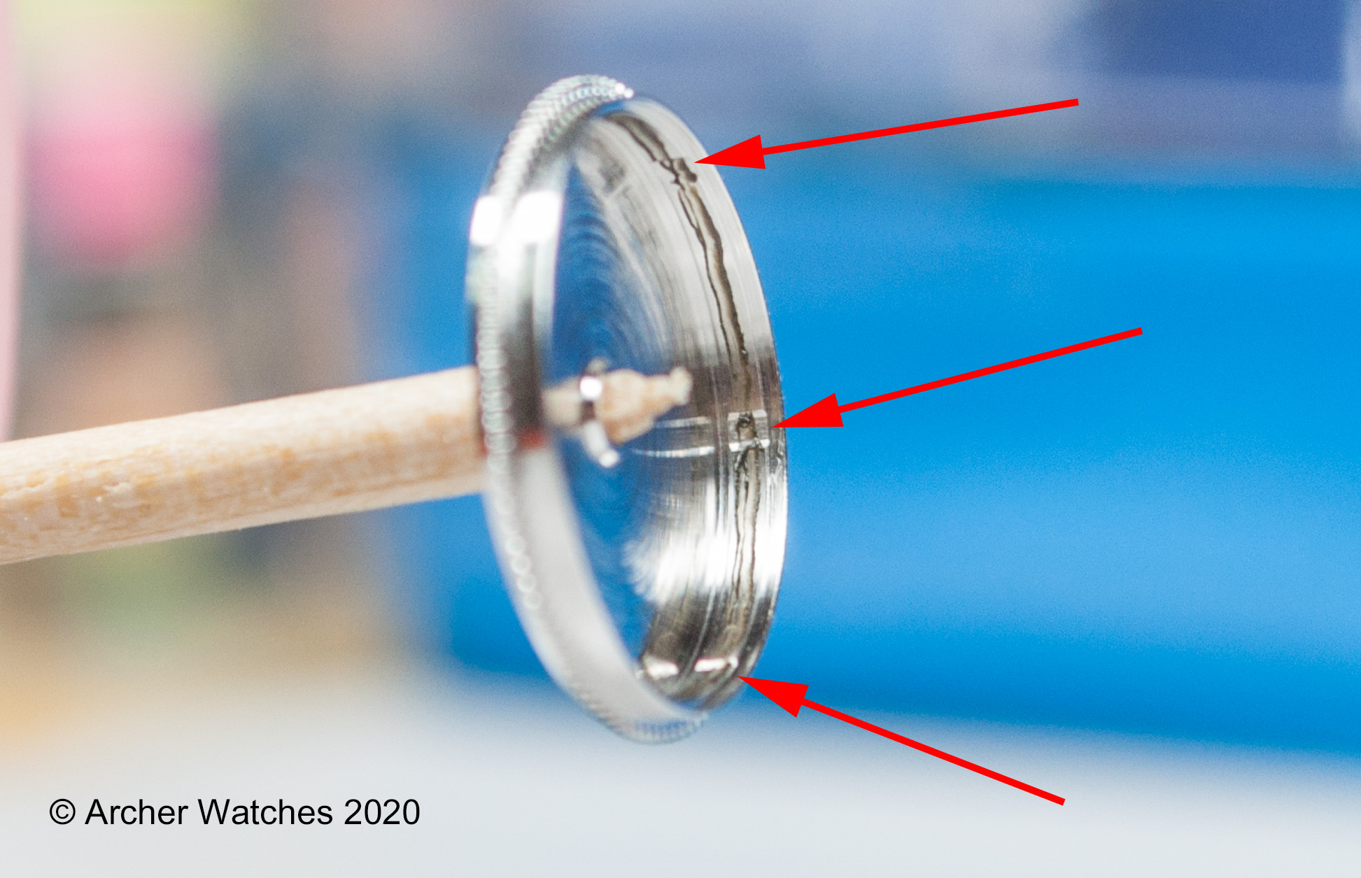

You can't over wind any correctly functioning automatic watch. They're all built with a clutch on the main spring or some kind of over wind protection (assuming there are other forms), otherwise the rotor would seize once fully wound.
Just to explain the clutch and clicking sound you hear when you reach full wind...
This is a photo of a mainspring barrel I've prepared for the installation of a new mainspring:
The black grease you see smeared on the inside of the barrel wall is braking grease - this grease prevents the mainspring from slipping too much once you reach full wind. You need the spring to slip, but not slip too much, and this grease controls the amount that it slips.
The 3 red arrows you see point to notches made on the inner barrel wall. These notches also help "catch" the mainspring as it slips, and the spring riding in and out of these notches is what causes that additional clicking you hear when the watch is fully wound. So what people refer to as a "clutch" makes this mechanism sound much more complex that it really is - one end of the spring just isn't attached the way it is in a manual winding watch, so it slips - that's all the clutch is.
The barrel drum shown above is for a Cal. 1120, but all modern Omegas that I am aware of use the same system in the barrel, so although I have not personally had an 8800 apart, I would be very surprised if the notches were not present, as this is a pretty universal design. So they are most likely clicking, but how loud it is can be affected by how much braking grease is used, if the notches are slightly worn, what the case material is, the depth rating of the watch, etc. So I have watches I've serviced where I can clearly hear the clicking when the movement is out of the case, but you can't hear it when cased, but it's still happening.
Hope this helps explain the clutch and source of the clicking.
Cheers, Al
