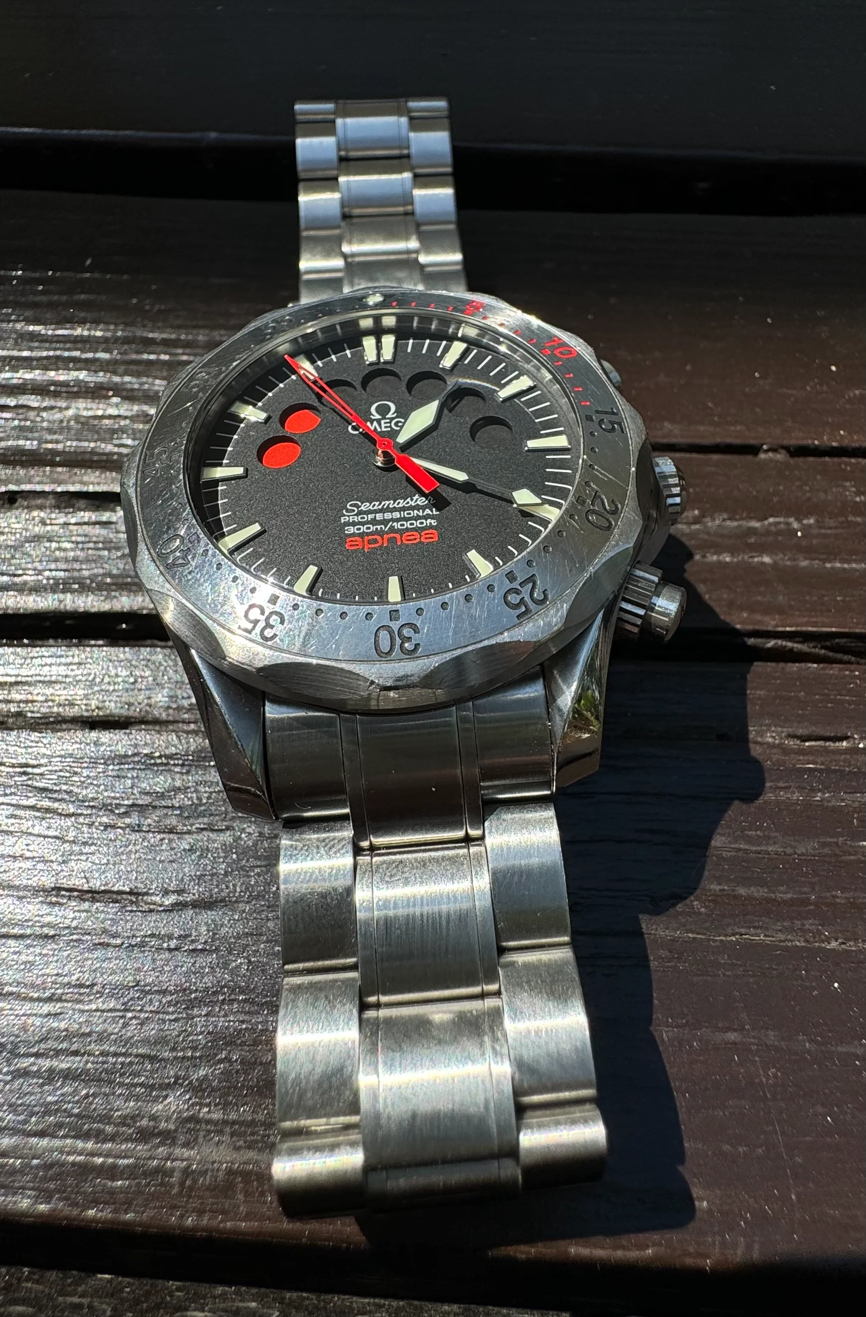

Dear forum members,
I own a Seamaster Apnea (2595.50.00) with the caliber 3601 which has an ETA 2892-A2 base with a Dubois Depraz 2029 Chronograph module (to the best of my knowledge and the limited info available).
Lately the watch started to lose 1 minute per day while having a power reserve of 2-6 hours (from being manually fully wound). When the watch has stoped, I though to activate the chronograph. Turns out that the when the chronograph runs, the watch is accurate from -5 to 0 seconds per day (as it used to be) and the power reserve is more than 44 hours (Omega advertised 44).
Any ideas why this happens (especially from @Archer )?
Many thanks 馃榾

Sounds like it鈥檚 time for a service.
35,770
40,046
The watch is probably 20-25 years old now so if it hasn鈥檛 had a service lately it鈥檚 probably very overdue at this stage. Being a piggyback movement you鈥檙e probably looking at going with an Omega service through a boutique or something as parts for the chronograph module are not made available even to Omega certified watchmakers.

Thank you for your responses. It is definitely time for a service!
I only service my Omega watches through boutiques or directly with the national service center if allowed.
Do you know if the movements with a Dubois Depraz chrono module are disassembled or they just replace the module?

Possibly a mainspring problem, but if it's due for a service anyway ...

Hello fellow Apnea owner! I could be wrong, but I think they would disassemble and service the module?
NM: Google tells me that a replacement of the module is often the course of action, FWIW.

In my experience the chrono modules are routinely replaced on the Reduced, Dynamic III chronograph and similar like this but this may be a special case. The GMT layer in the Great White etc for instance is AFAIK repaired rather than replaced. Replacement isn't IMO a bad thing here.

Often the entire movement is swapped, but I鈥檓 not sure if this would be the case with this model. But anyway Omega is the best place for these.

These are a very cool and unusual reference. The bright red is sharp!
But I'll echo everyone ese: this needs clean lube and adjust with a new mainspring (at a bare minimum).

6 months later, the watch runs 4 seconds slow per day. Not yet serviced but will go to Omega in the future!
