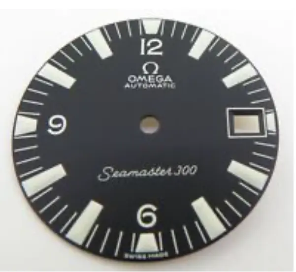

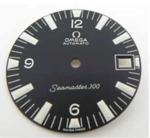

I’m looking to replace the dial on my Cal.565 Omega Seamaster. A bloody expensive exercise as I’m sure most can understand. However this is a forever watch and I’d like to get it right.
I have found a NOS dial for the Cal.565 but I can’t confirm the dial dimensions. Can anyone help? My original dial looks to be 28.5mm but that’s a basic measurement in the case, I’ll do a better one when I take the movement out to do some work on it.
Does anyone have a resource to help me understand the dimensions on an Omega part?

You need to go by the case ref, not caliber. That dial is for seamaster 300 165.024 / 166.024.
What reference is your watch?

So it should fit.

Whilst not cheap, I’m in talks to purchase this dial. The short term pain will be offset by long term enjoyment of my watch.
It opens up questions of how to match the hands I have to the dial and keen to have people’s thoughts on this.
Does anyone know how these dials were lumed and the appropriate options I have to match?
1. Relume the hands I have using modern materials
2. Send the hands to someone to have them professionally matched
3. Find a source for OEM hands and go through the shock again of buying OEM Omega parts 😒

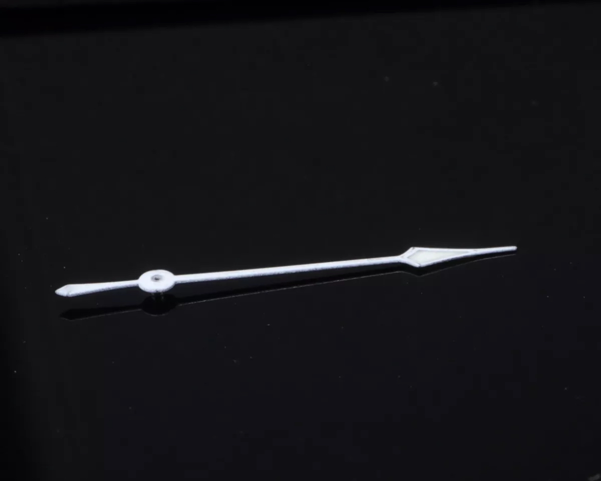

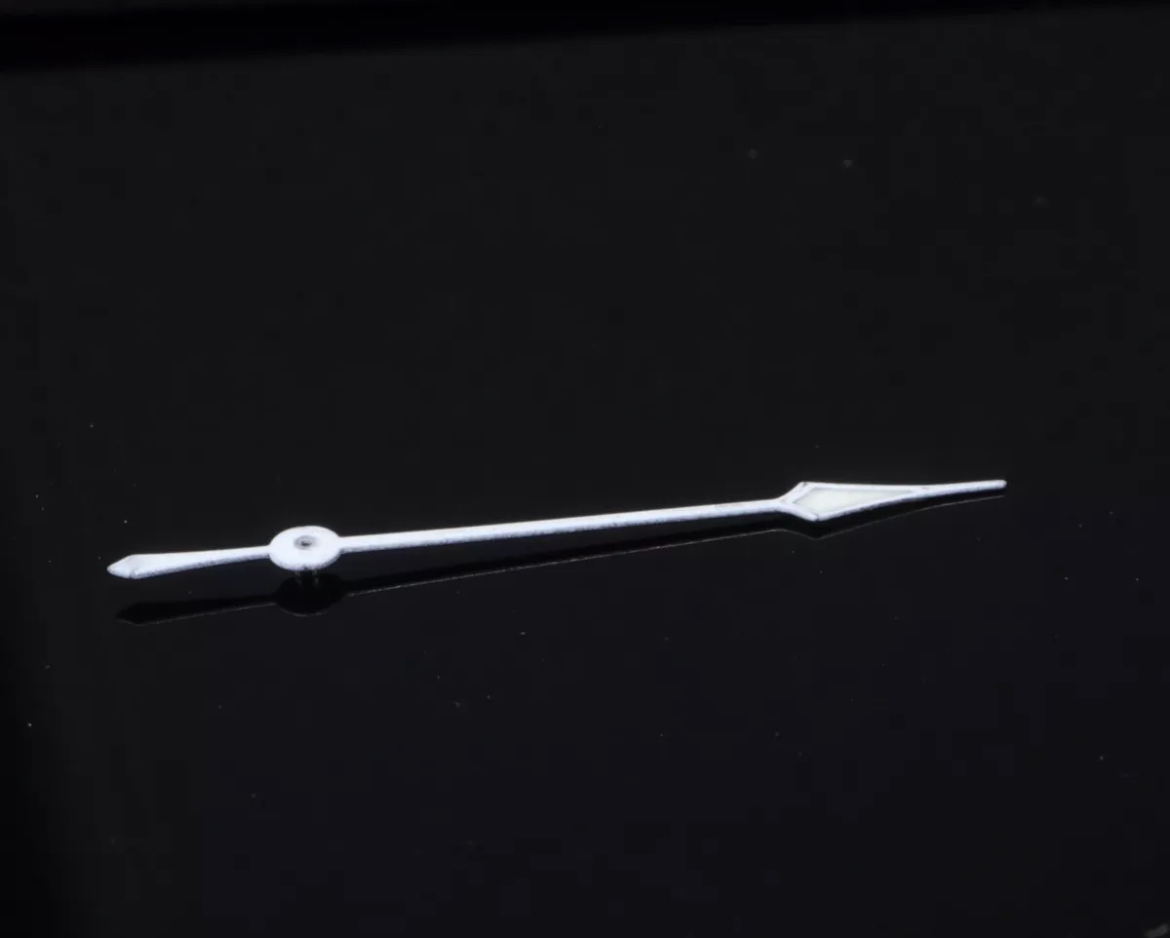

I’ve purchased the dial and the same vendor has a supply of OEM hands for sale too. Seems like a retired watch makers stock.
The hands look very close to the dial but I’d want to triple check before buying as they’re also not cheap.
The seconds hand however seems to be painted white with lume on the end. Is that normal for a 1968 166.024 watch?
I’m not sure I like that vs having silver.

Judging by the dial, the hands won’t be vintage, they’ll be modern service hands.

I’m actually fine with the replacement hands being modern ones. I was just hoping to match the dial which also will be a modern replacement I assume.
I just wanted to match the hands with the dial on the lume as much as possible.
I’m just not sure on the white seconds hand which appears to be period correct for a 1968 300 in a 166.024 case.
The reason for replacing the hands and dial is because I’m building a homage watch (a la watchco). The movement is Omega, but the case is not as I couldn’t fine a genuine one without paying $4k which was way beyond my budget. So I bought a reproduction case and for not much extra I could also get a dial and hands, but the lume on them is too fake looking.
So I’m in the process of replacing all the parts I can with genuine Omega and given I don’t care about authenticity as I could have left the factory, I’m building it as I would like it to look… which is with the beautiful white/green lume.

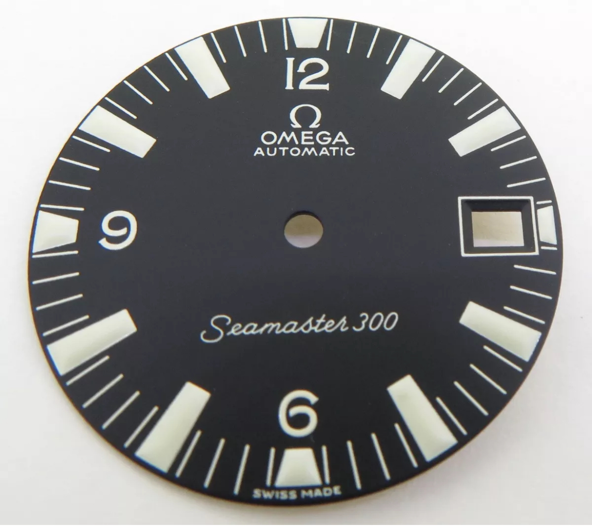

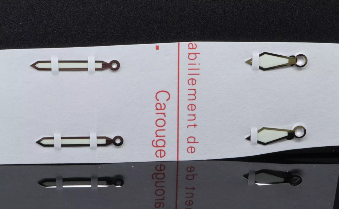

This is the dial and hands I can find. They look like they all match but it’s hard to tell from photos.
