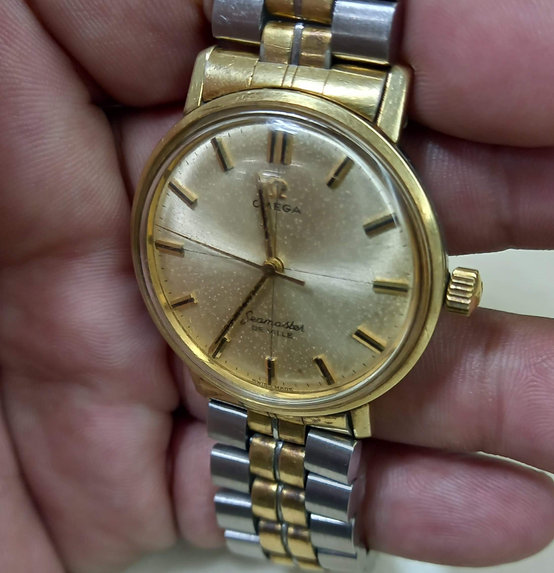

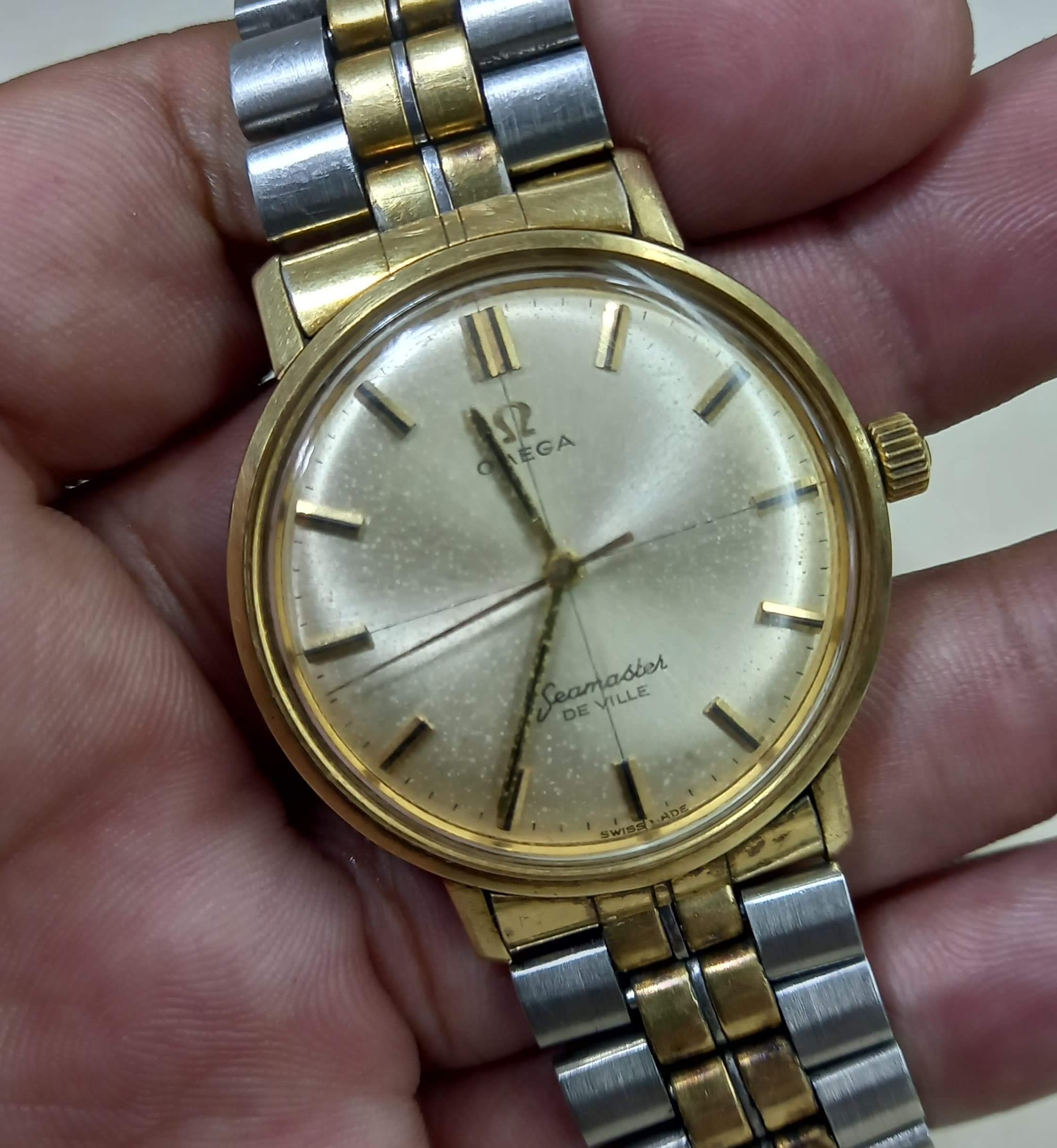

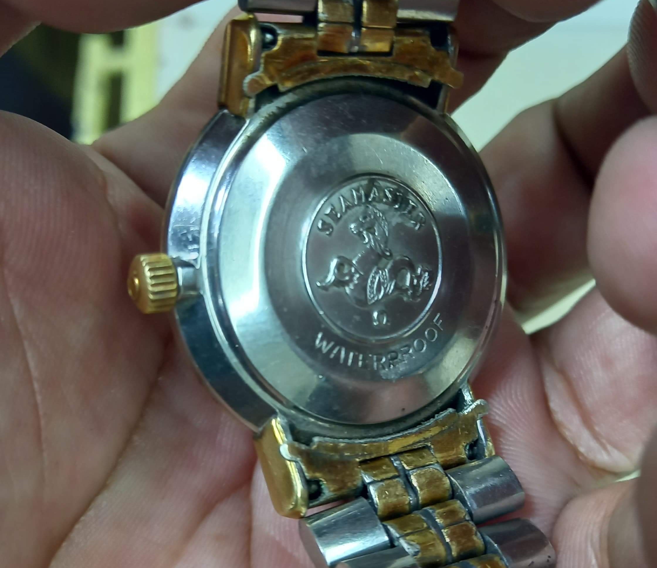

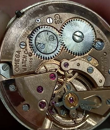

Hello everyone

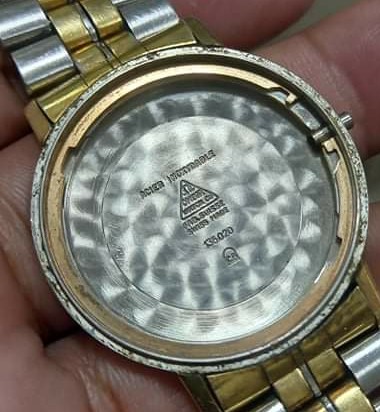

I am wondering if this an all original Omega head and not redone. Except for the crown, I think everything else is correct. Serial dates it 1962. Caliber 600 and case number 135.020.
Would like to seek your opinion please.
1,534
3,248
Yes, the watch is correct, except the crown. I can't tell you about the bracelet, as I have not seen one of these before. I would look for a gold plated 7-row BOR. To me the two-tone does not pair with the case style.
188
41
yes bracelet is not original as well.
7,359
25,869
Everything looks authentic but I’m not sure that movement belongs in a De Ville. The 600 series of movements belong in these watches...
188
41
Everything looks authentic but I’m not sure that movement belongs in a De Ville. The 600 movements belong in these watches...
Oh, good catch! I completely forgot the printed 600 on some of these Omegas. I'll research further. Thanks for the heads up!

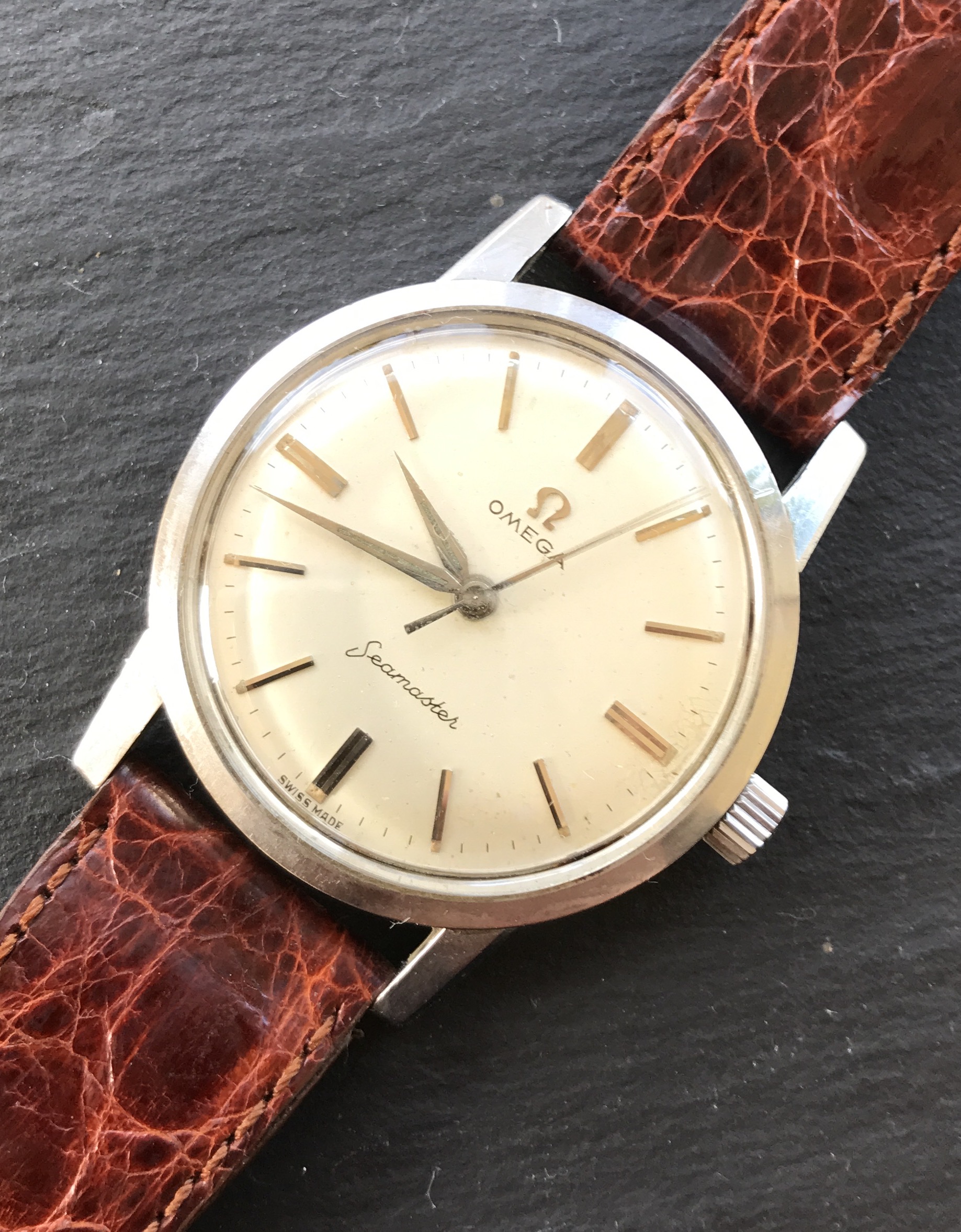

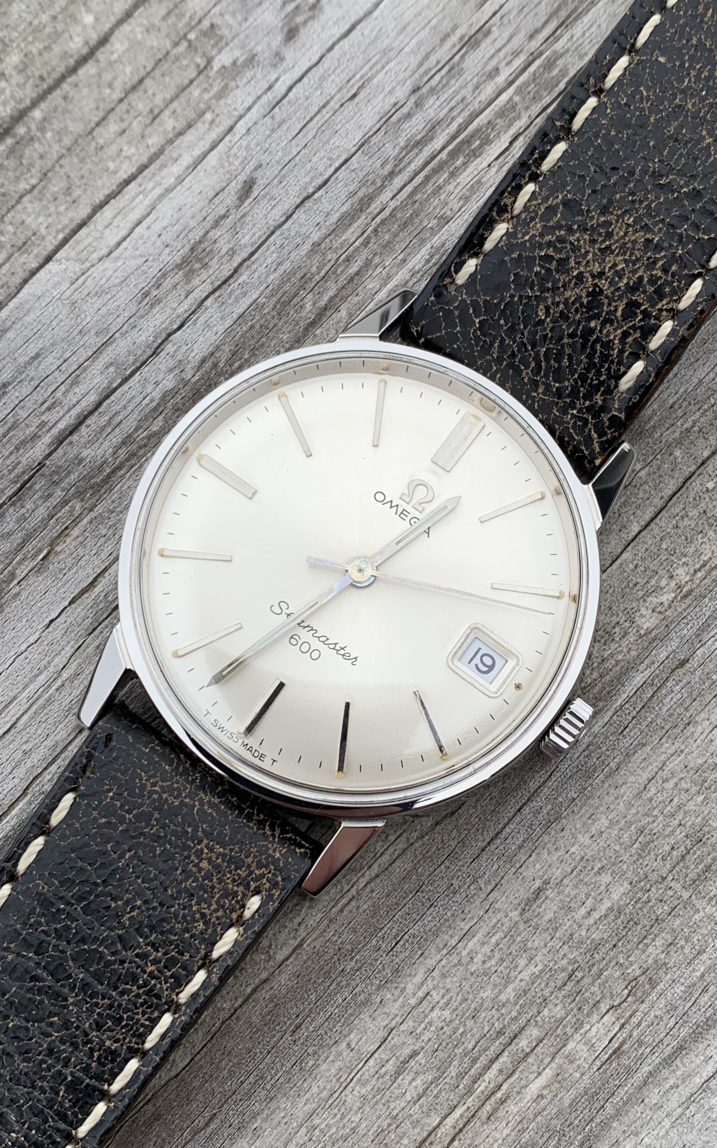

I have a 1961 seamaster with a 600 movement but no "600" on the dial.
188
41
And the plot thickens! Would highly appreciate a photo sir, if you have the time.
7,359
25,869
It’s not a De Ville though, some of these “600” watches did not have dial marked but were same style. Similarly there were some De Ville style Seamasters without De Ville on dial.
7,359
25,869

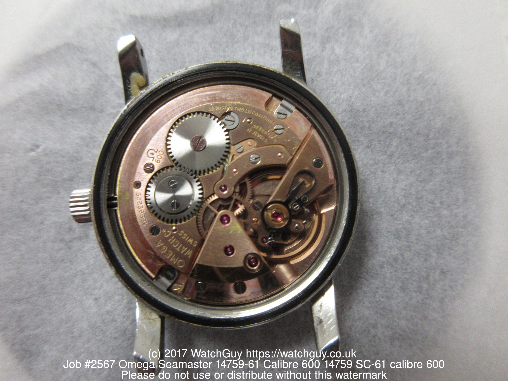

here it is - model 14759-SC-61 with a cal 600 movement
Your watch, like the 600 models has a screw on case back, as where the De Ville models had a fixed case (back doesn't open)...the movement came out through the front/crystal. IMO the movement in OPs watch didn’t start its life in that case.
432
634
I can't comment on that and I bow to your superior knowledge! Mine certainly has a screw on case back as you say. When were the De Ville models introduced?
7,359
25,869
Omega used the De Ville moniker on the Seamaster from 1963 to 1967. I have a 1963 Seamaster De Ville and a 1964 Seamaster 600, pictured above. The De Ville is an automatic movement (cal. 552) and 600 is a cal. 611 manual wind (as all 600 series were). The De Ville name however is still used to this day, in fact I also have a 1968 De Ville Chronograph with a cal. 861.

Ref 135.020 correct with cal 600/601.
1 - Gent's watch
3 - Manual winding center seconds
5 - Water-resistant

I stand corrected!😀

So the cal. 600 is correct for the watch, and not all vintage Omegas with cal. 600 should have the 600 printed on the dial? 😀
