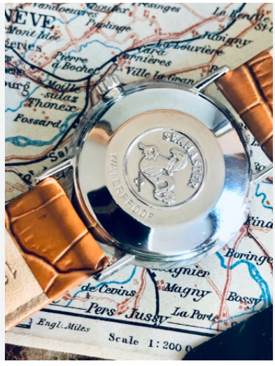

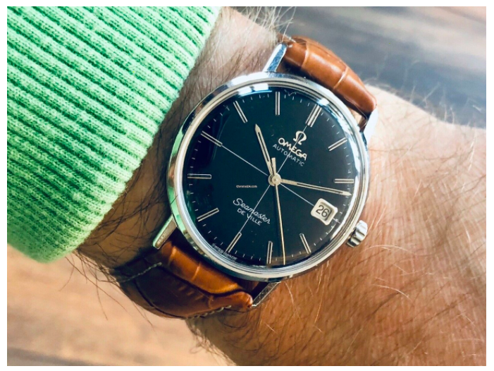

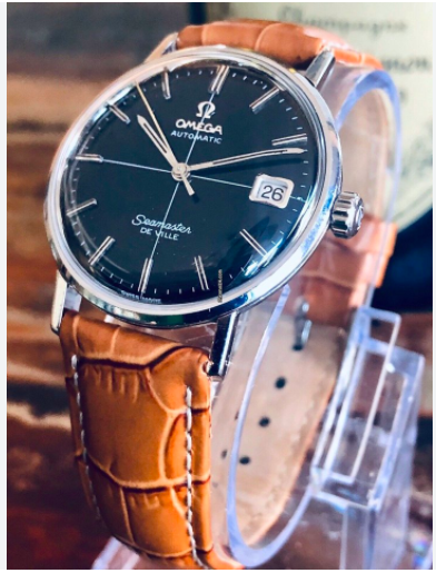

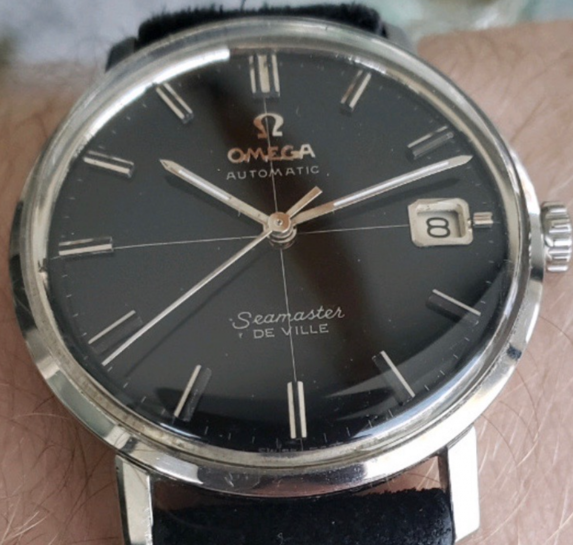

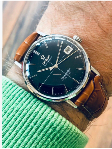

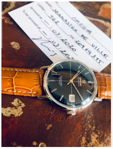

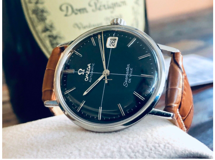

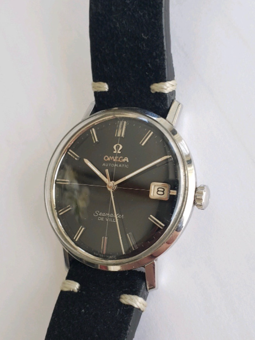

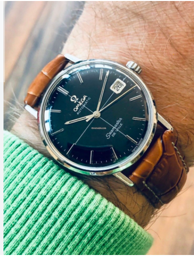

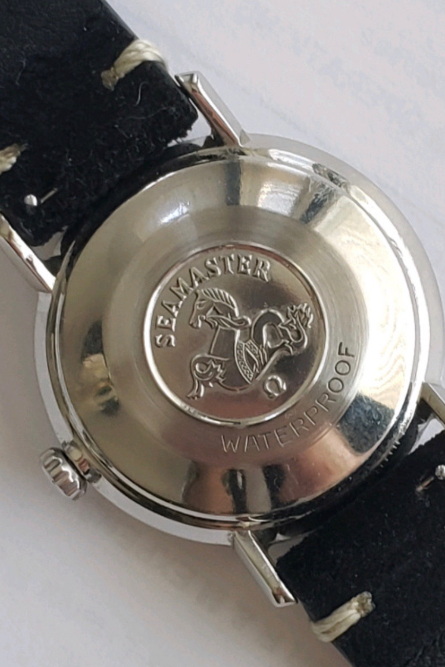

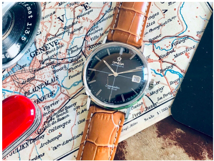

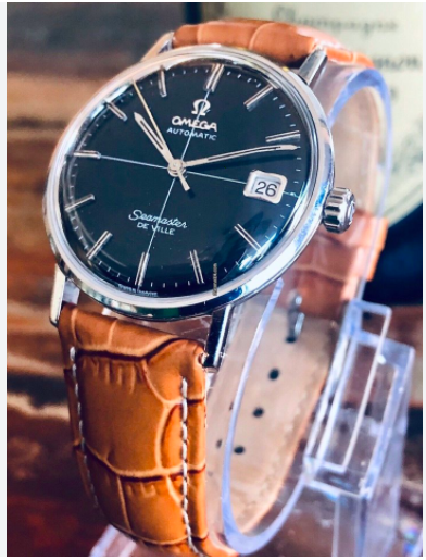

Hi all,
I found this watch and need your input. I know it's a repaint dial and I think it's overpriced (EUR 1500), but I'm not an expert as you guys. It's from a trusted dealer in the UK (Fine Watch Club).
Could you please have a look and tell what you think ?
I'd really appreciate it !
I put the main characteristics just below :
- Case Width: 34mm
- Dial: Black crosshair (repainted)
- Metal: Stainless steel case
- Year: 1963
- Movement: Automatic Cal 562
- Serial Number: 20969315
Thanks in advance !
Thanks in advance
2,086
2,899
I agree with you.
And the case looks overpolished as well.
I wouldn't buy this watch.

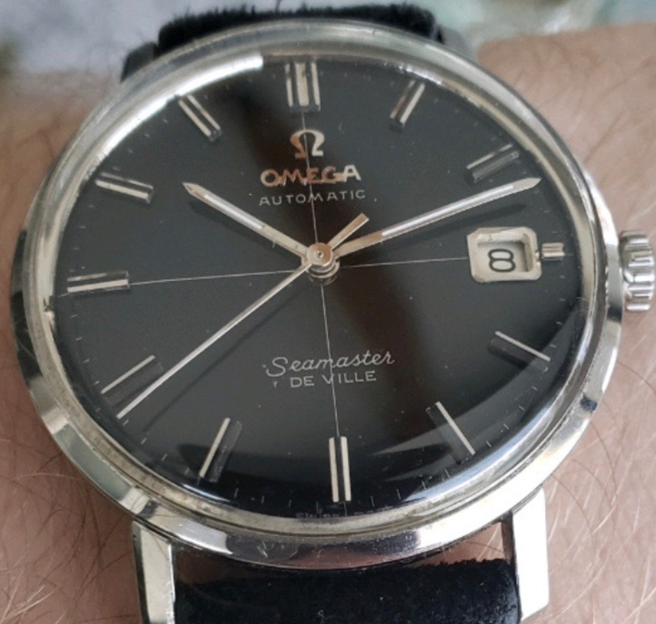

Someone will correct me if I'm wrong, but I'm pretty certain that Omega never made a black, crosshair SMDV. So any watch you see matching that description is a redial
32
9
I think you're right. No original models with crosshair black dial.
