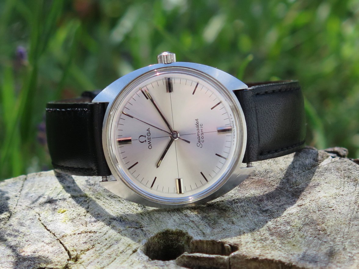

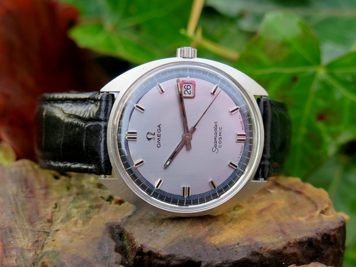

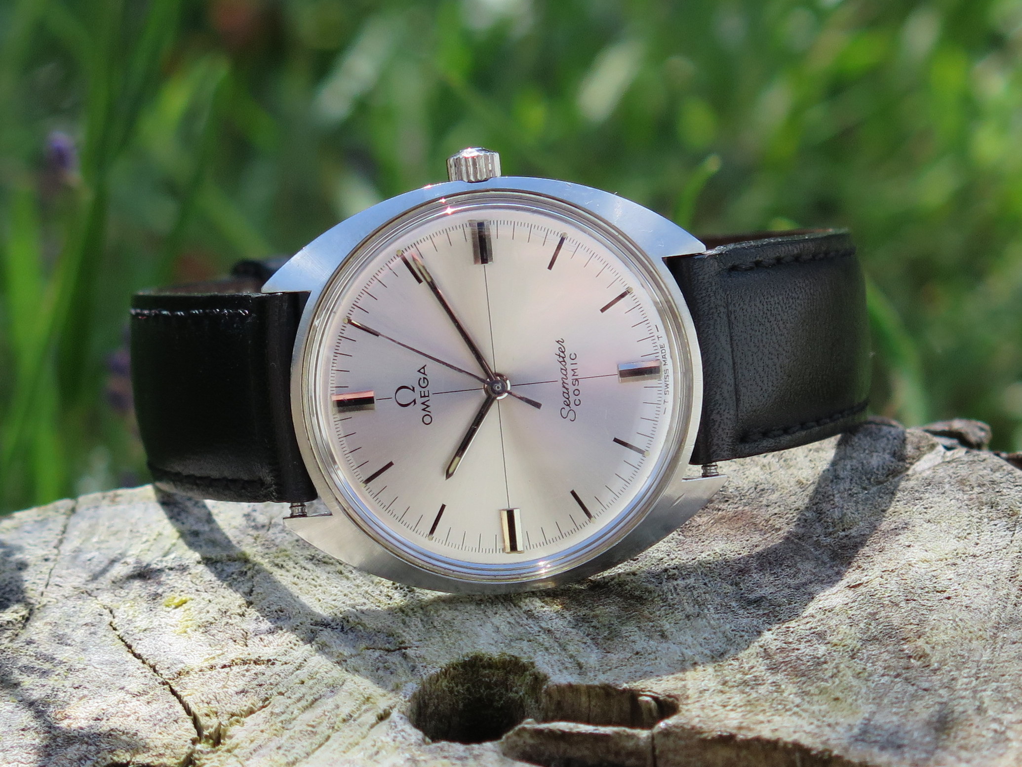

I personally love the 5** and 6** calibre Cosmics that X350 XJR mentions. Nice variety of case shapes that have excellent wrist presence and plenty of dial designs to suit ones taste. I may be wrong, but I understood that these calibres were pretty highly regarded?
Just my opinion but I care less for the Cosmic 2000 aesthetics, however it has plenty of fans that I’m sure will be able to offer advice. Best of luck!

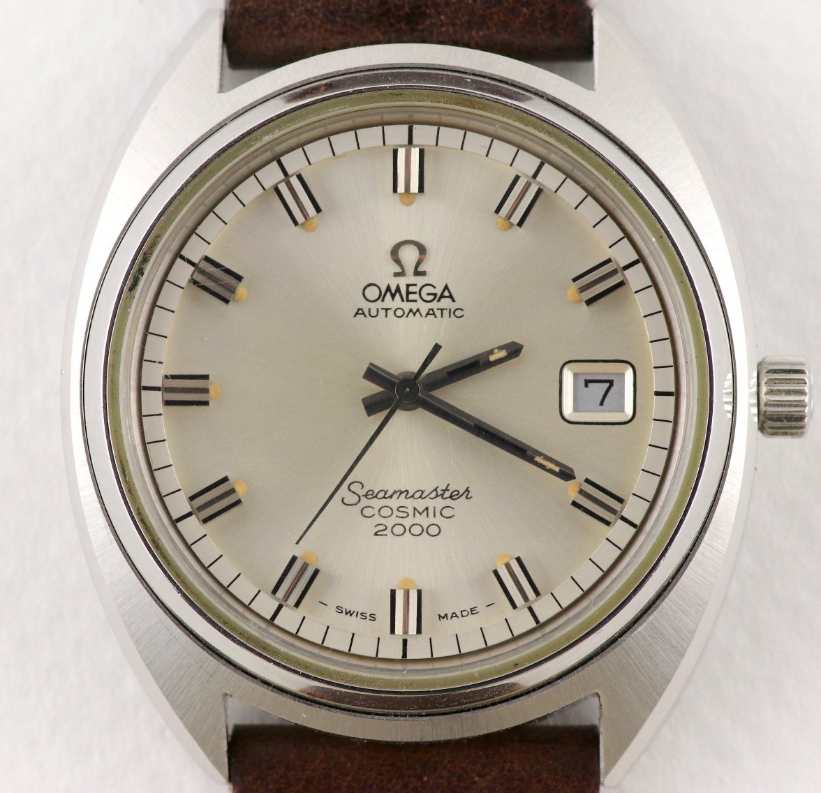

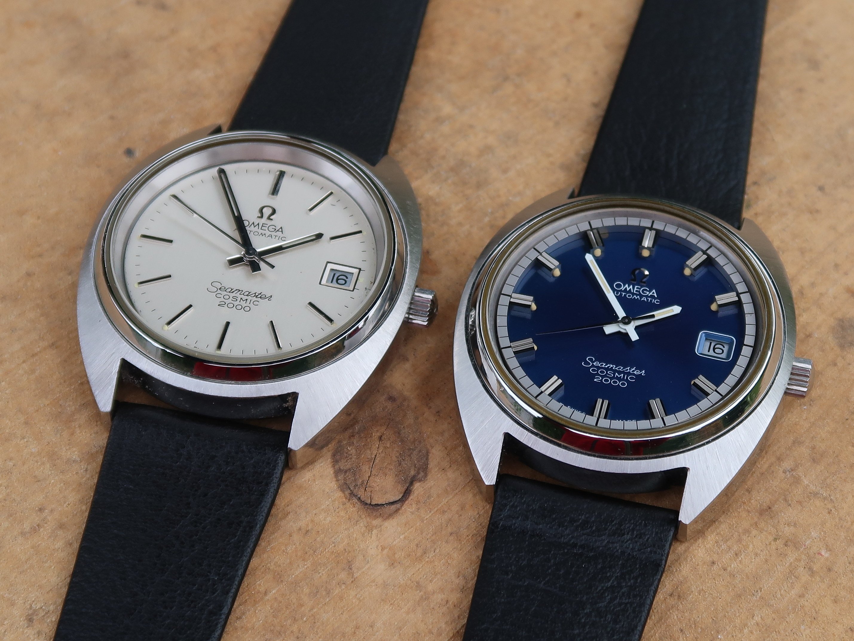

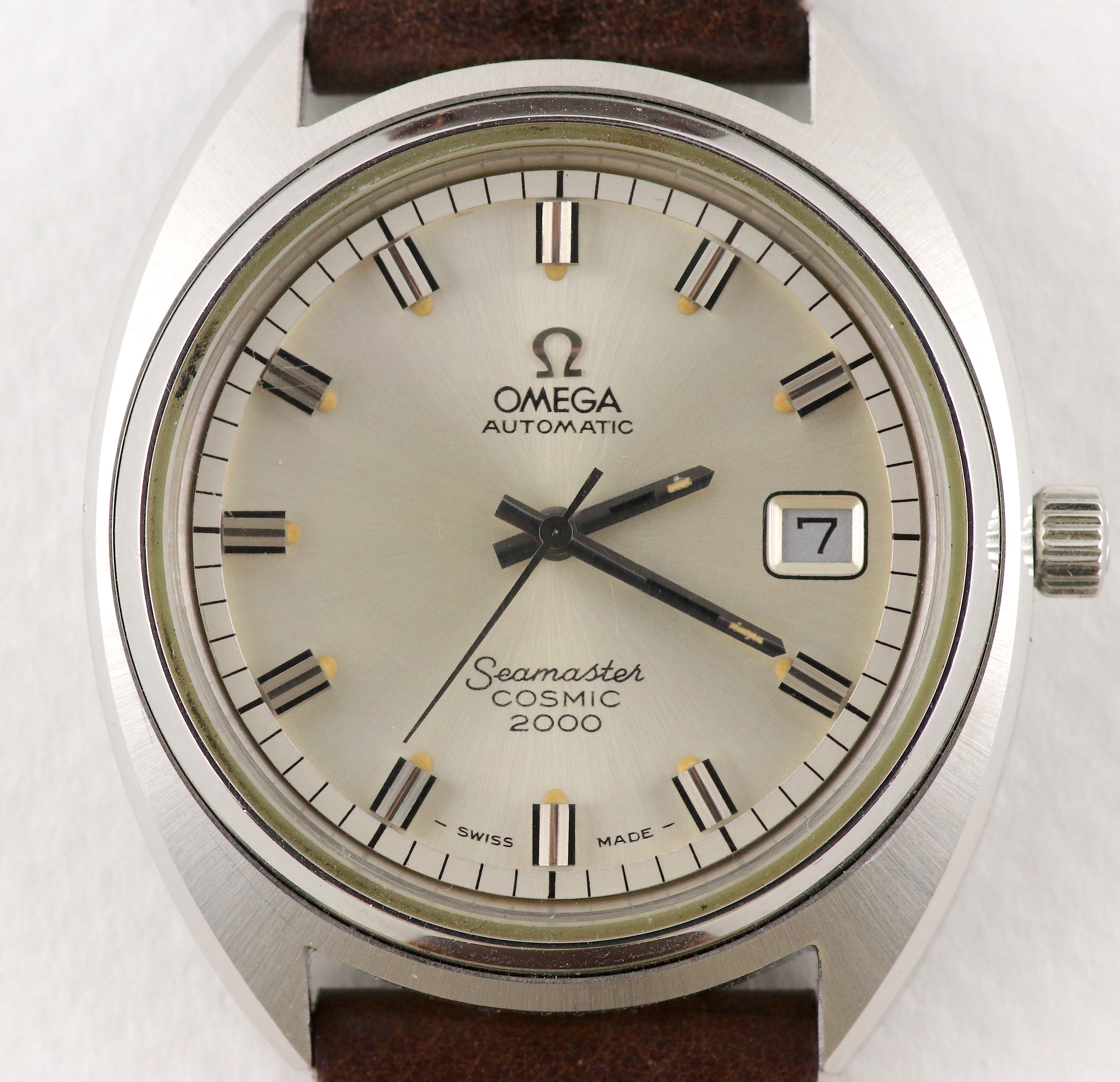

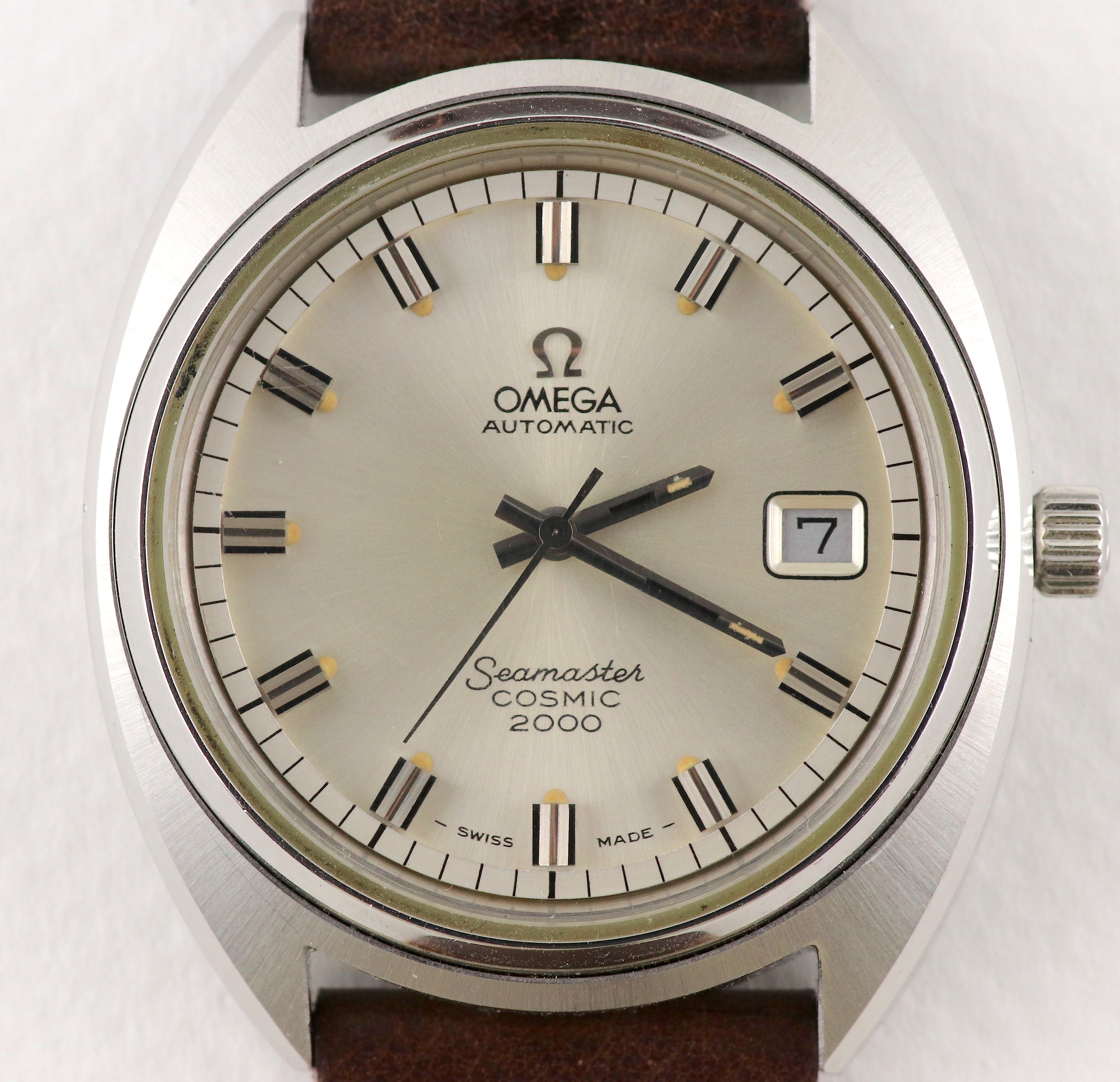

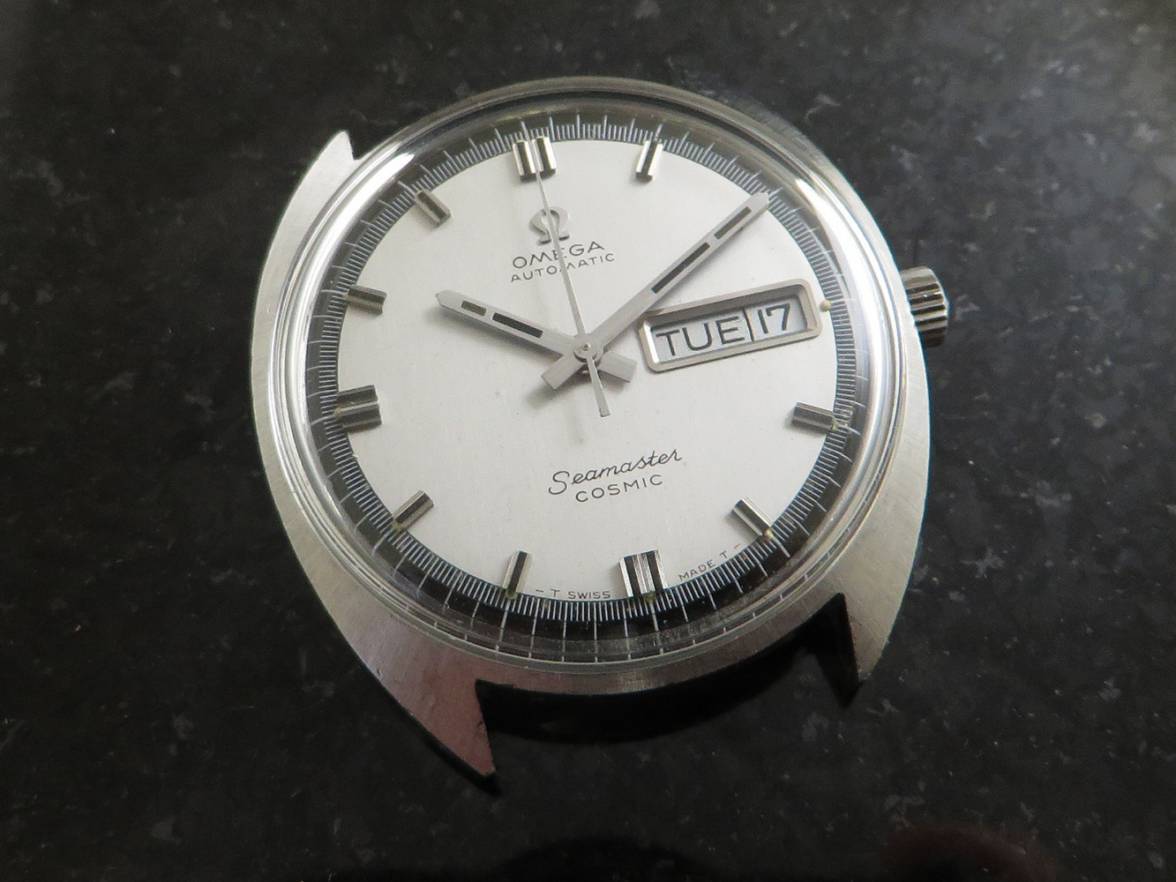

I don't have any of the technical expertise @X350 XJR has in regards to the calibers the cosmic uses but I love the Cosmic 2000 and I think its probably one of the better vintage Omegas in terms of usability. It wears very well and can be still purchased for a decent price.
The only downside for me is the fact that I can't open the case and I need to go to the watchmaker every time.

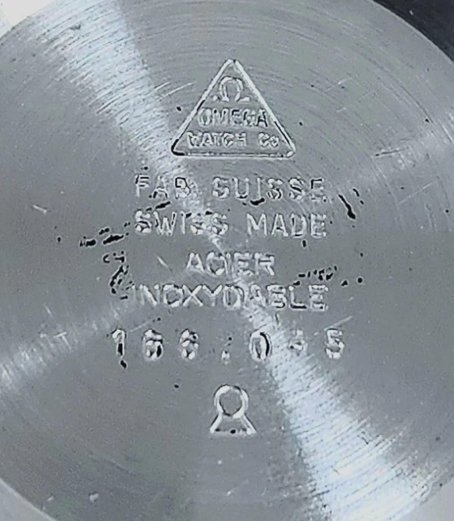

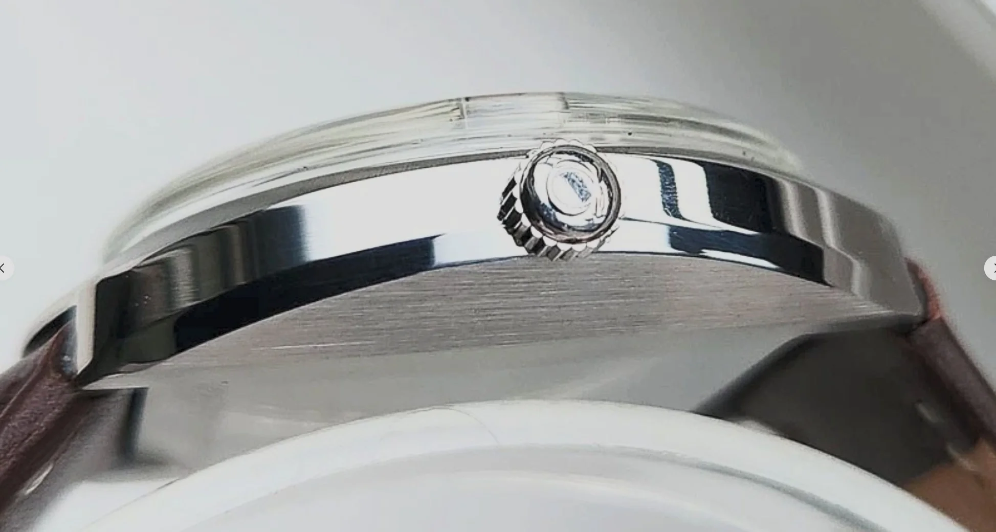

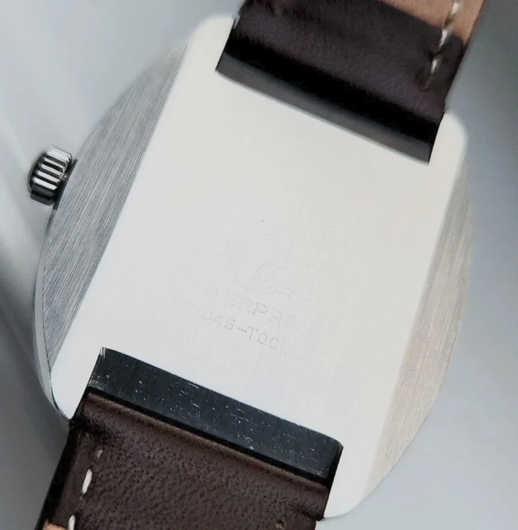

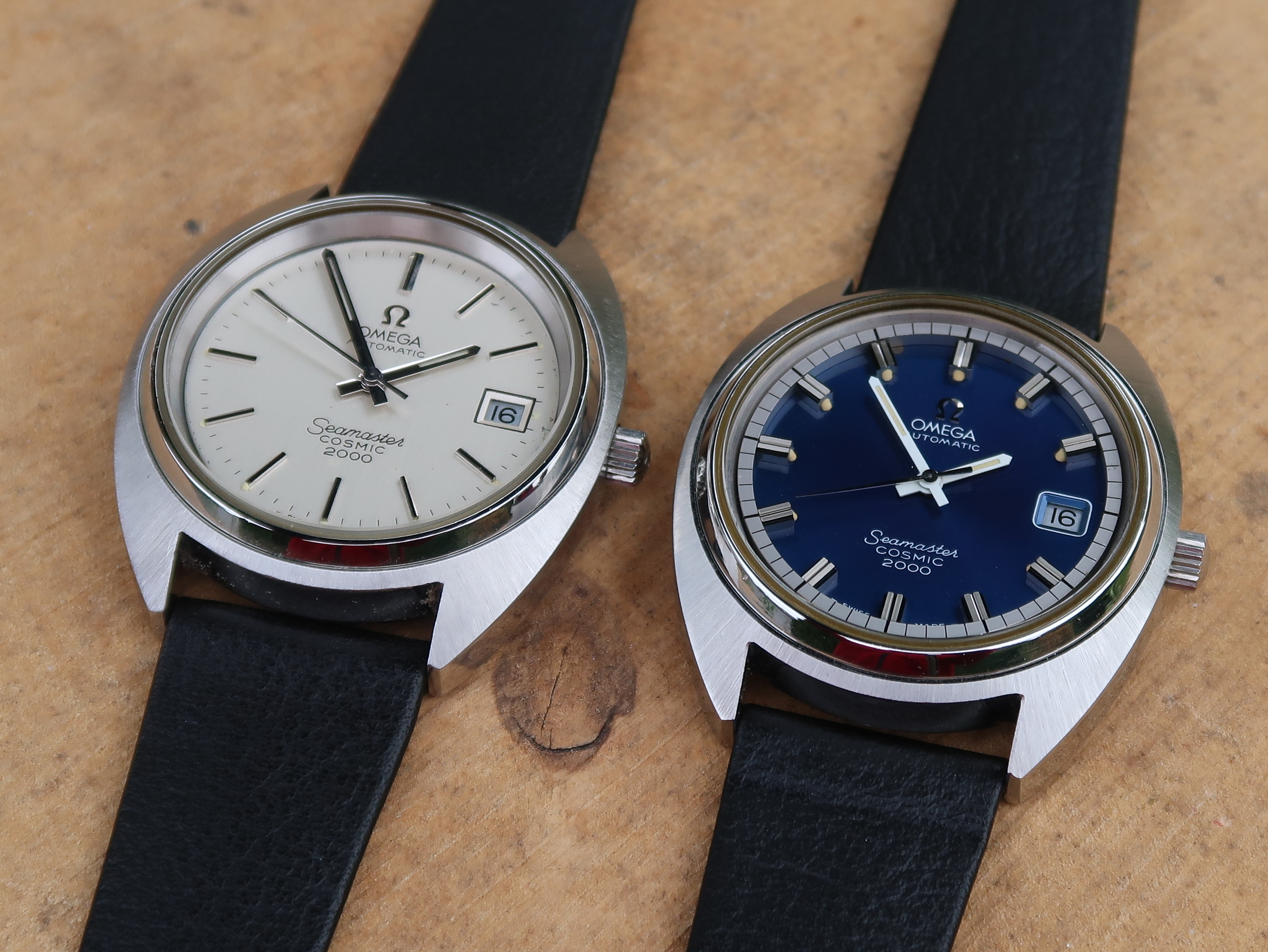

Seamaster comic 2000, these are ref. 166.0130 cal. 1012:

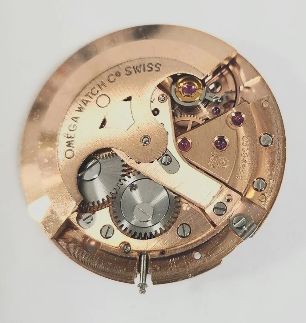

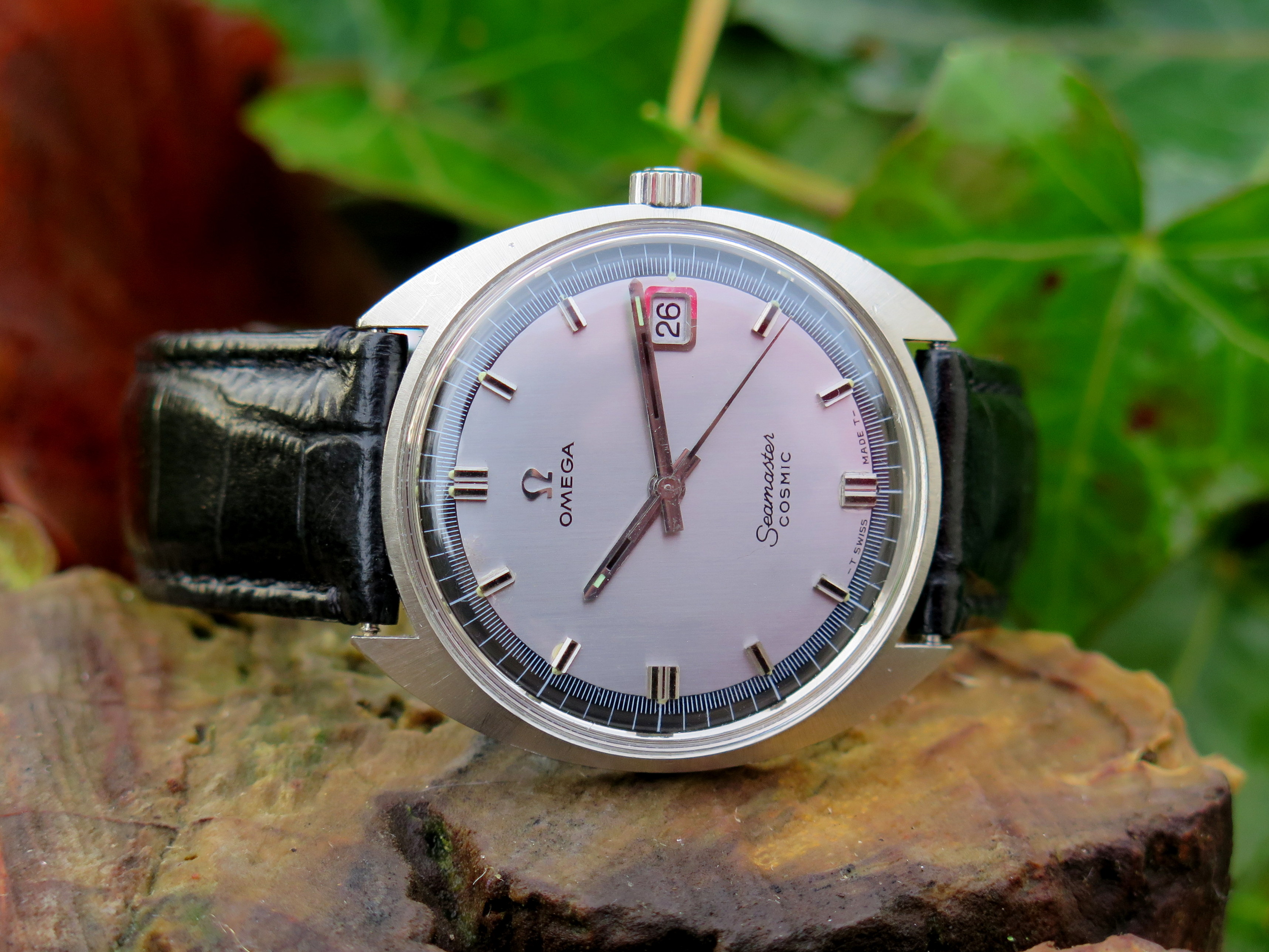

Seamaster Cosmic, they came with cal. 5xx, 6xx and 7xx :

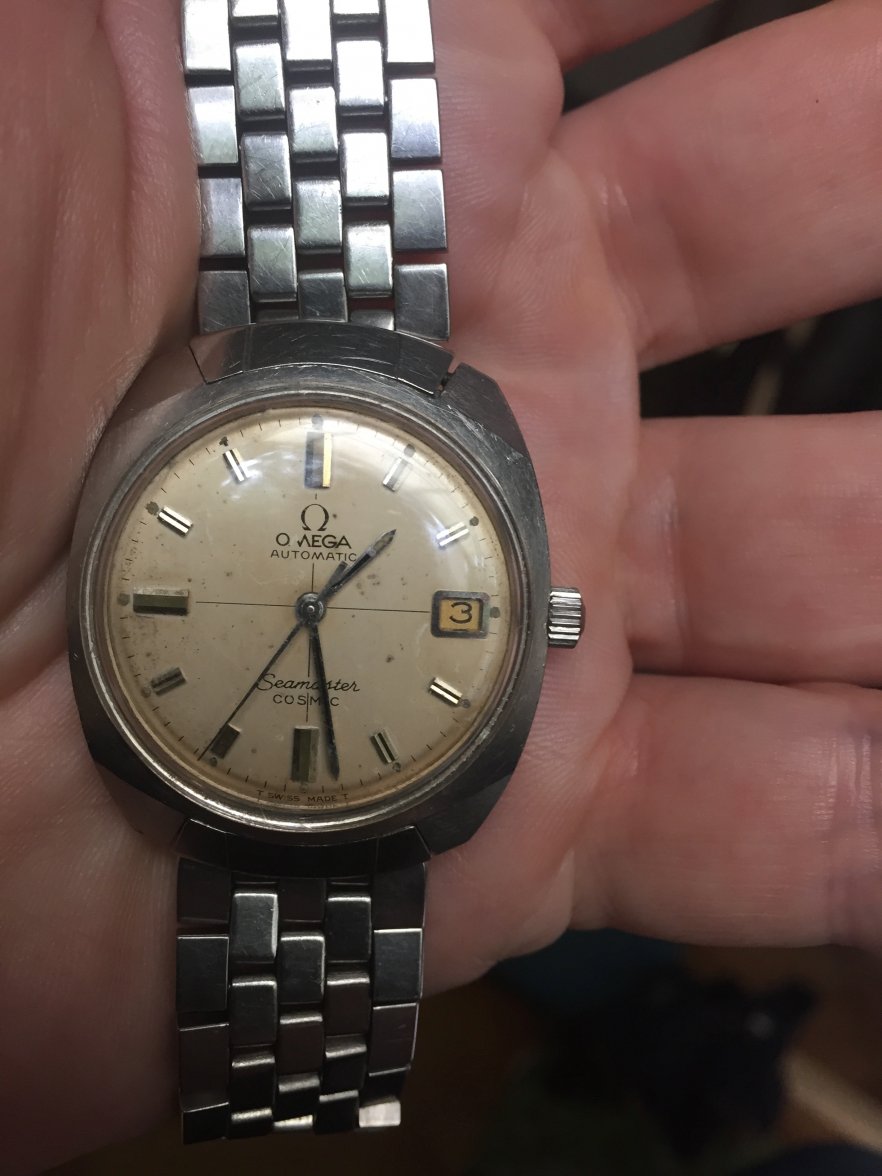

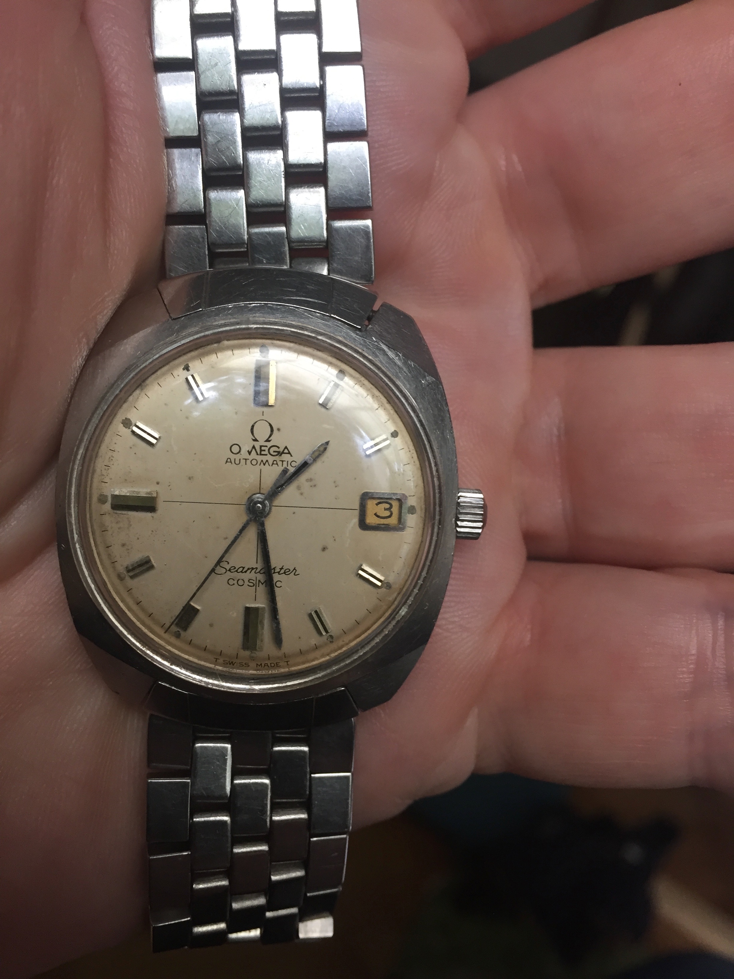

This cosmic was my first Omega purchase.....Newbie tax meant I missed the signs and had to get a replacement 8XX movement as water had got into the old one. On a plus side, I got it with the original brick bracelet. I still like it and wear it, even in it's slightly tatty state... Has a real vintage vibe!
I would definitely go with the earlier series..I don't find some of the Cosmic 2000 dials quite so appealing.

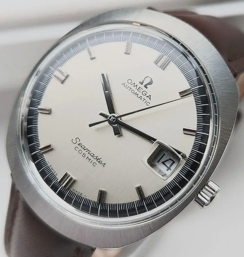

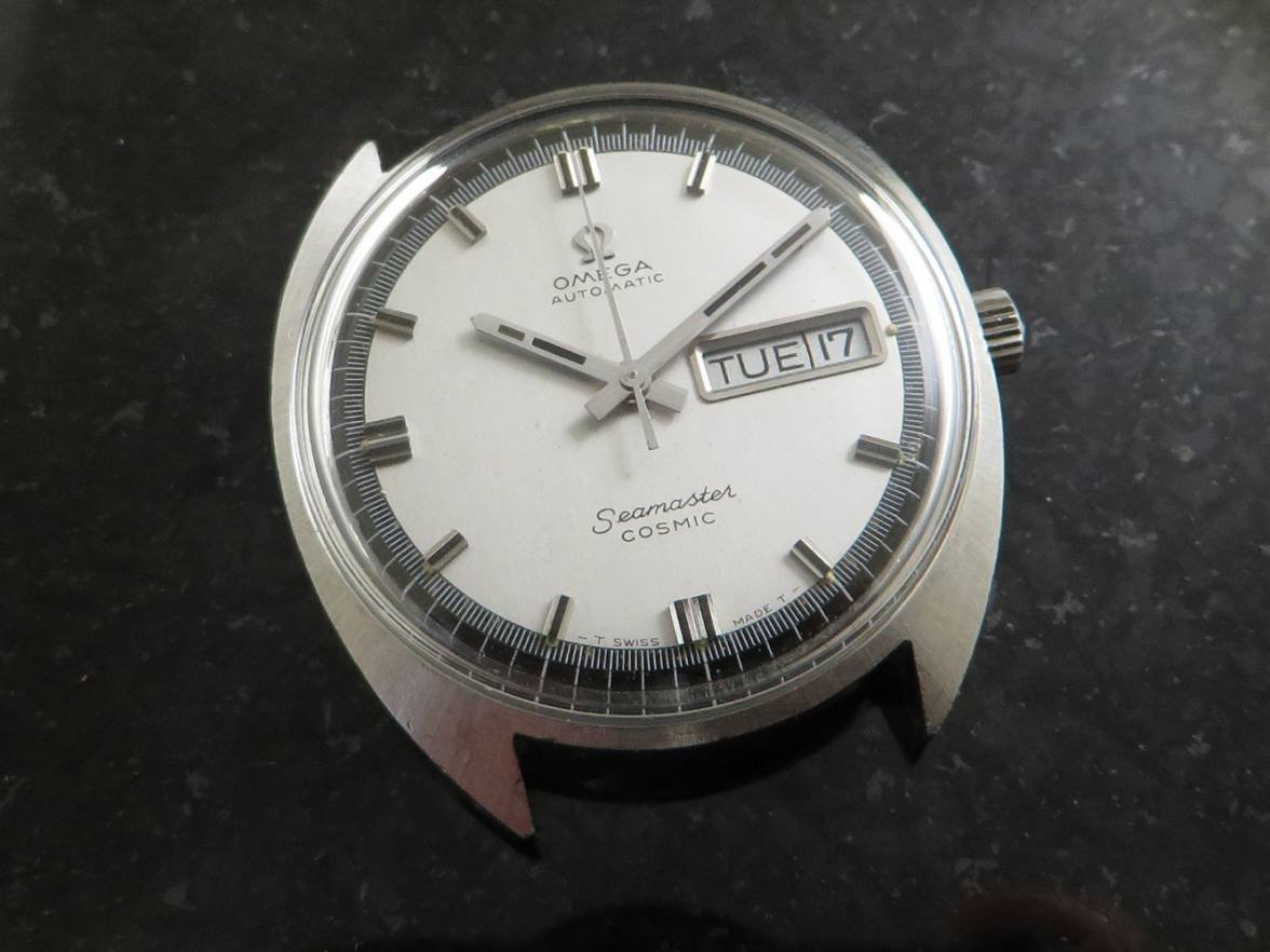

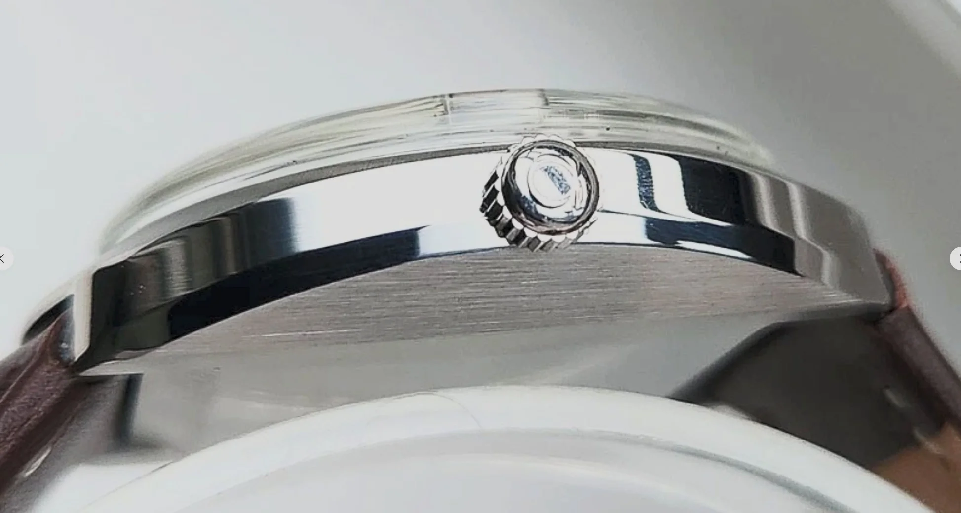

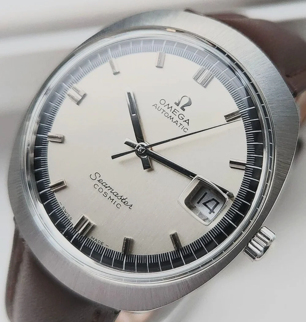

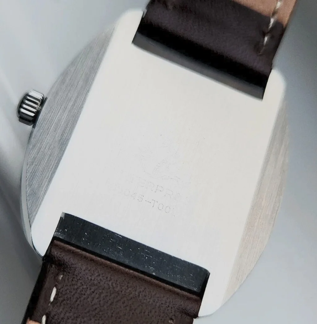

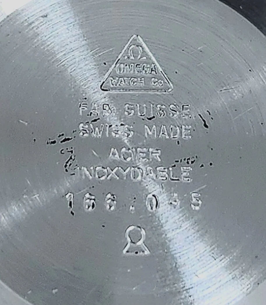

Bit of a zombie resurrection thread, but I feel it's a good place to post this, given the Cosmic love here. My question is, was there ever a 'non-lume' version produced as per the photos here? No lume anywhere, and no Swiss Made 'T' - should there be? Or is this one just another South Korean redial? Thanks for thoughts, Cosmic luvvers.
