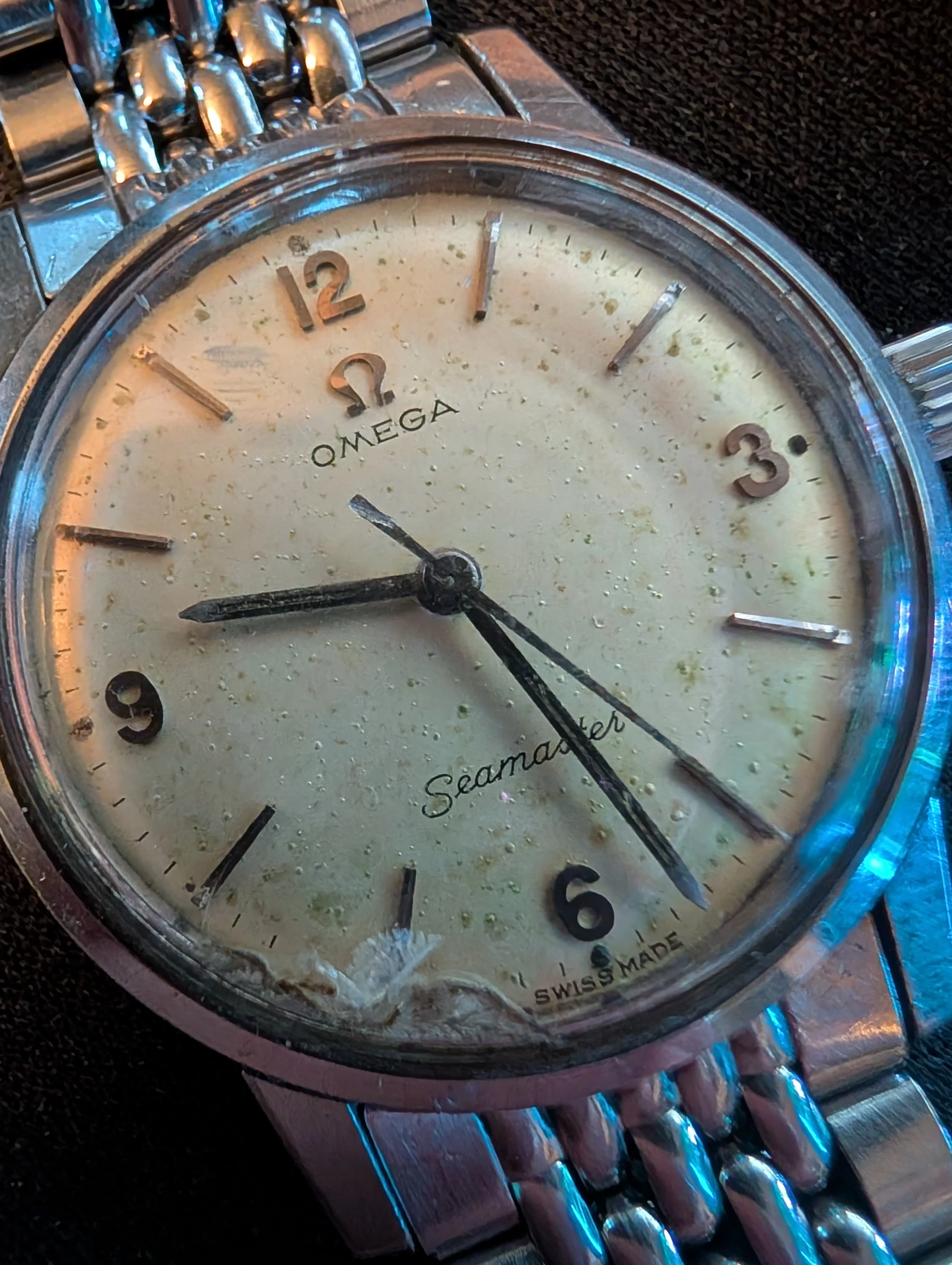

Hi all, please could someone advise me what seconds hand i would need as a replacement for this seamaster? The current one is broken.

Need the case number inside the case back...

I would suggest running a google search using the specific reference number. Use google images and look for an example with the same dial and handset.
BTW, in what way is that sweep hand broken?

It has snapped at the end since taking that photo, must have been when i changed the crystal

The hand you need is part number 066UX1365.
