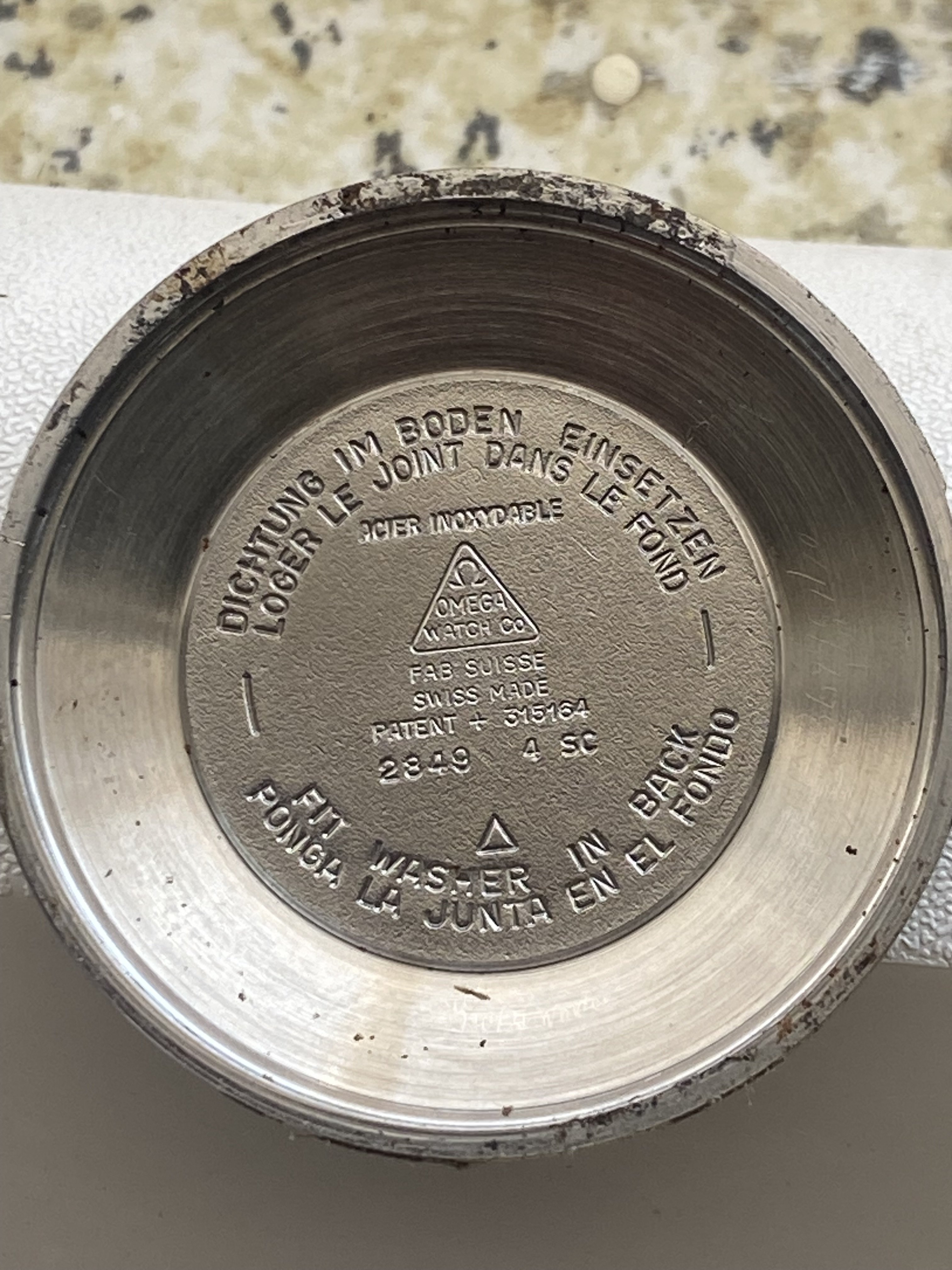

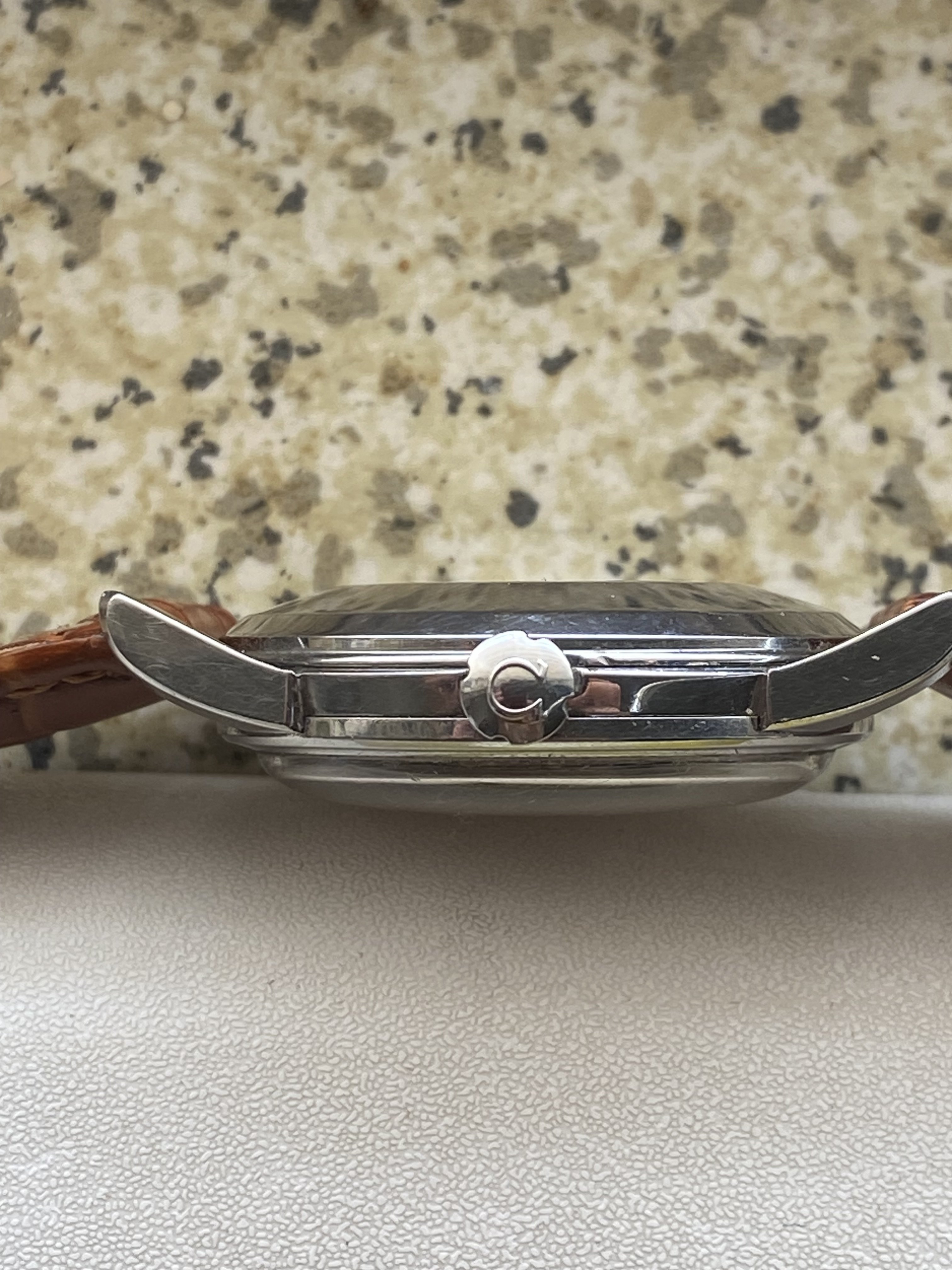

Hello

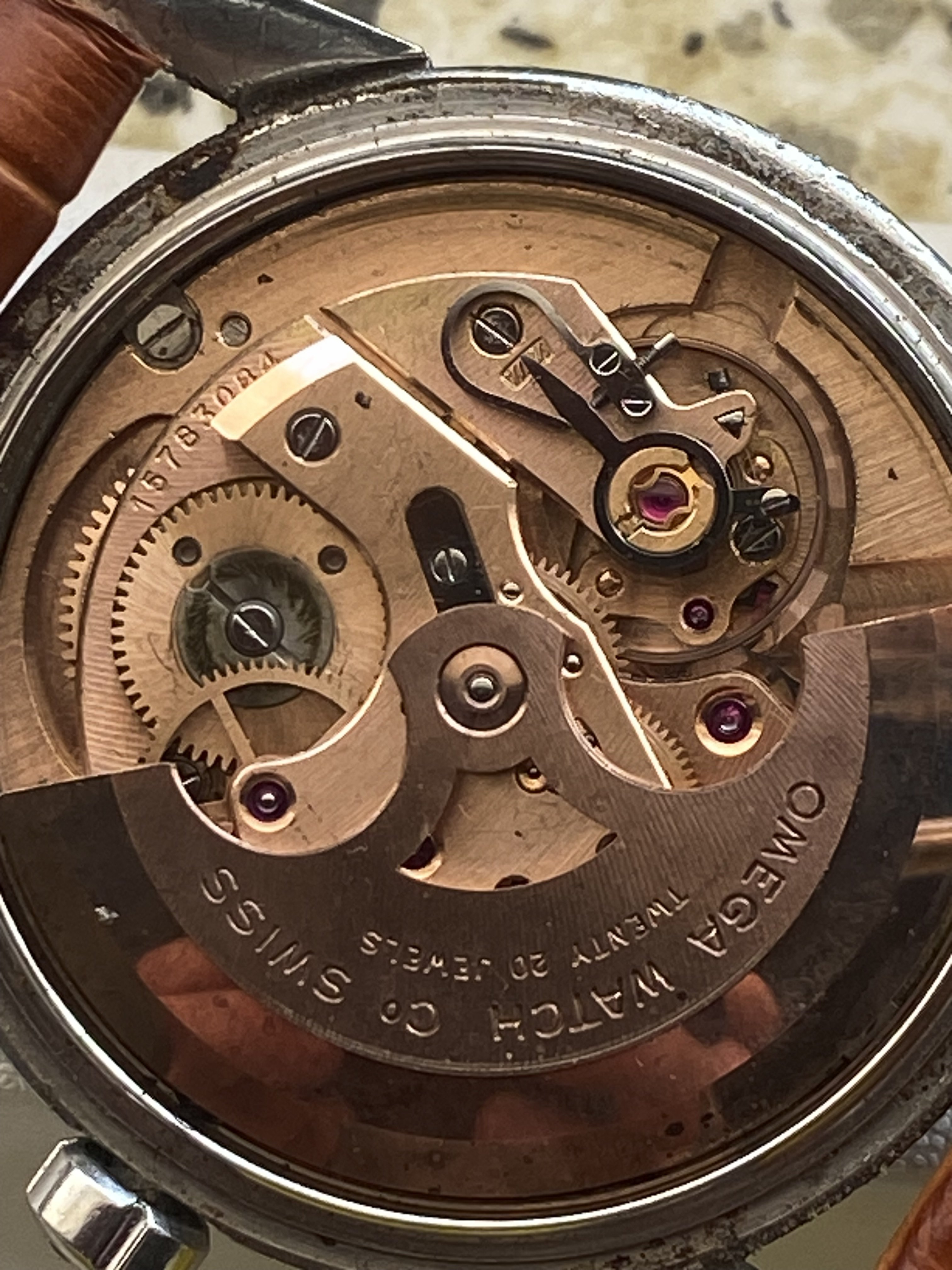

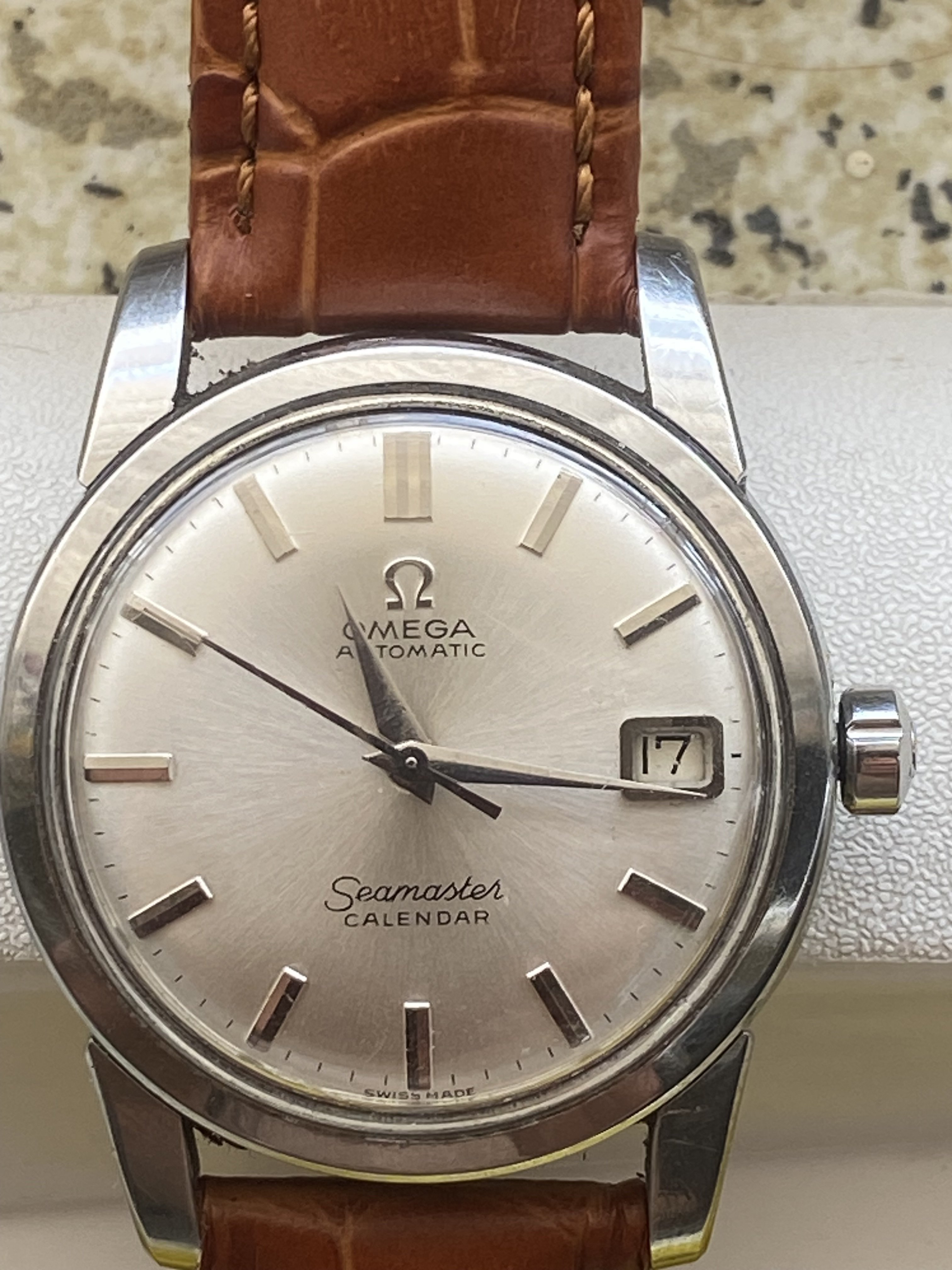

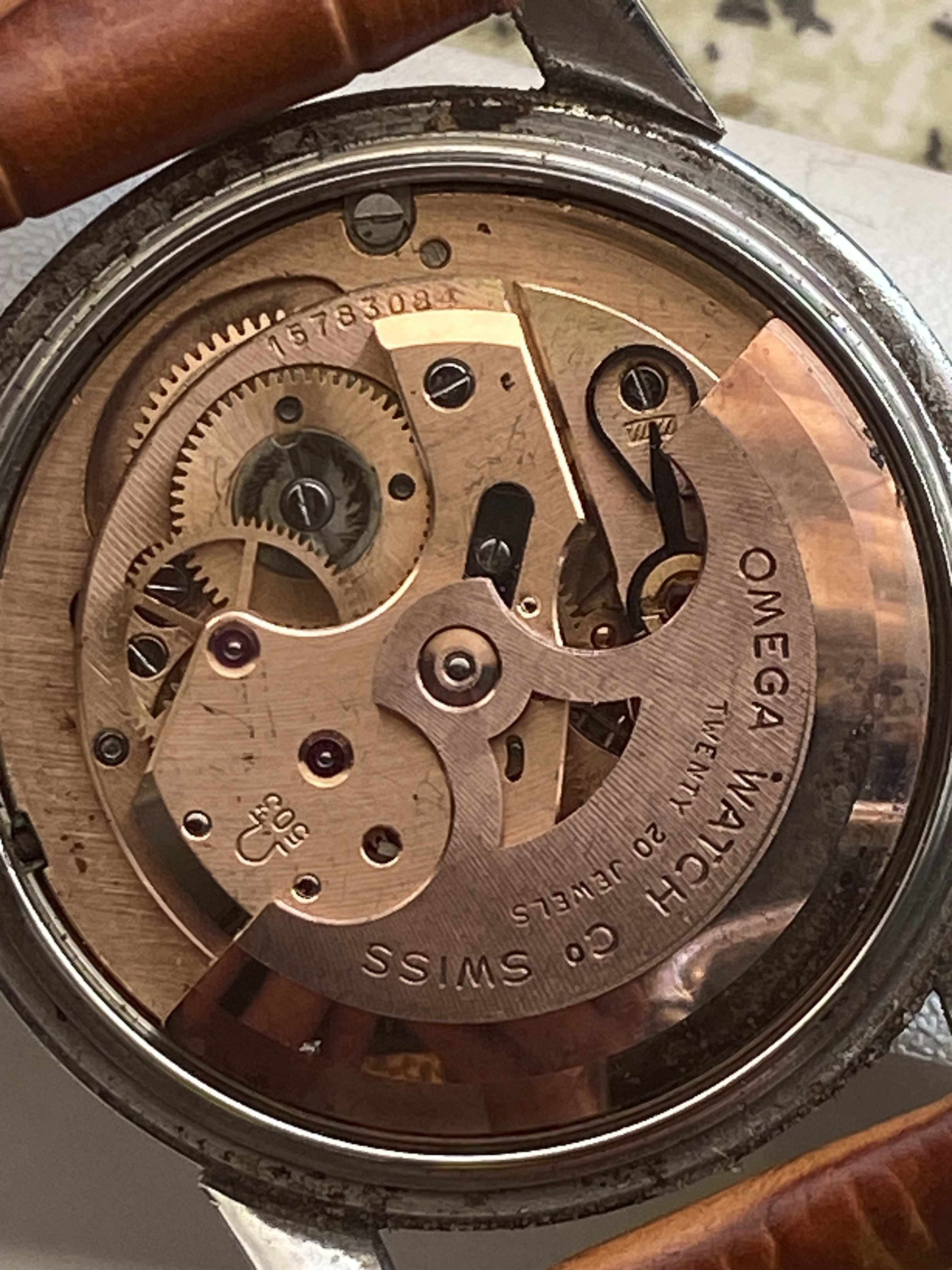

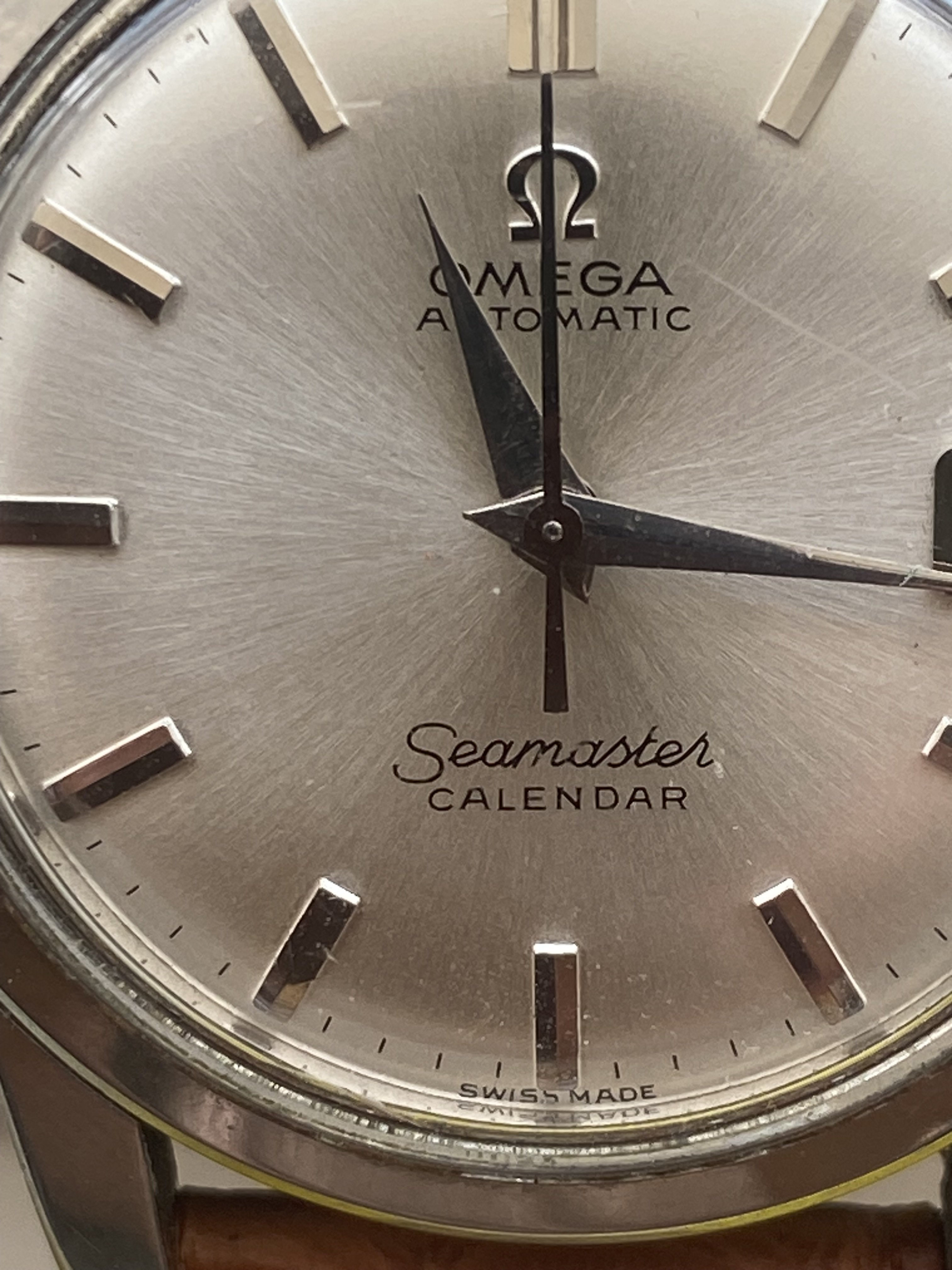

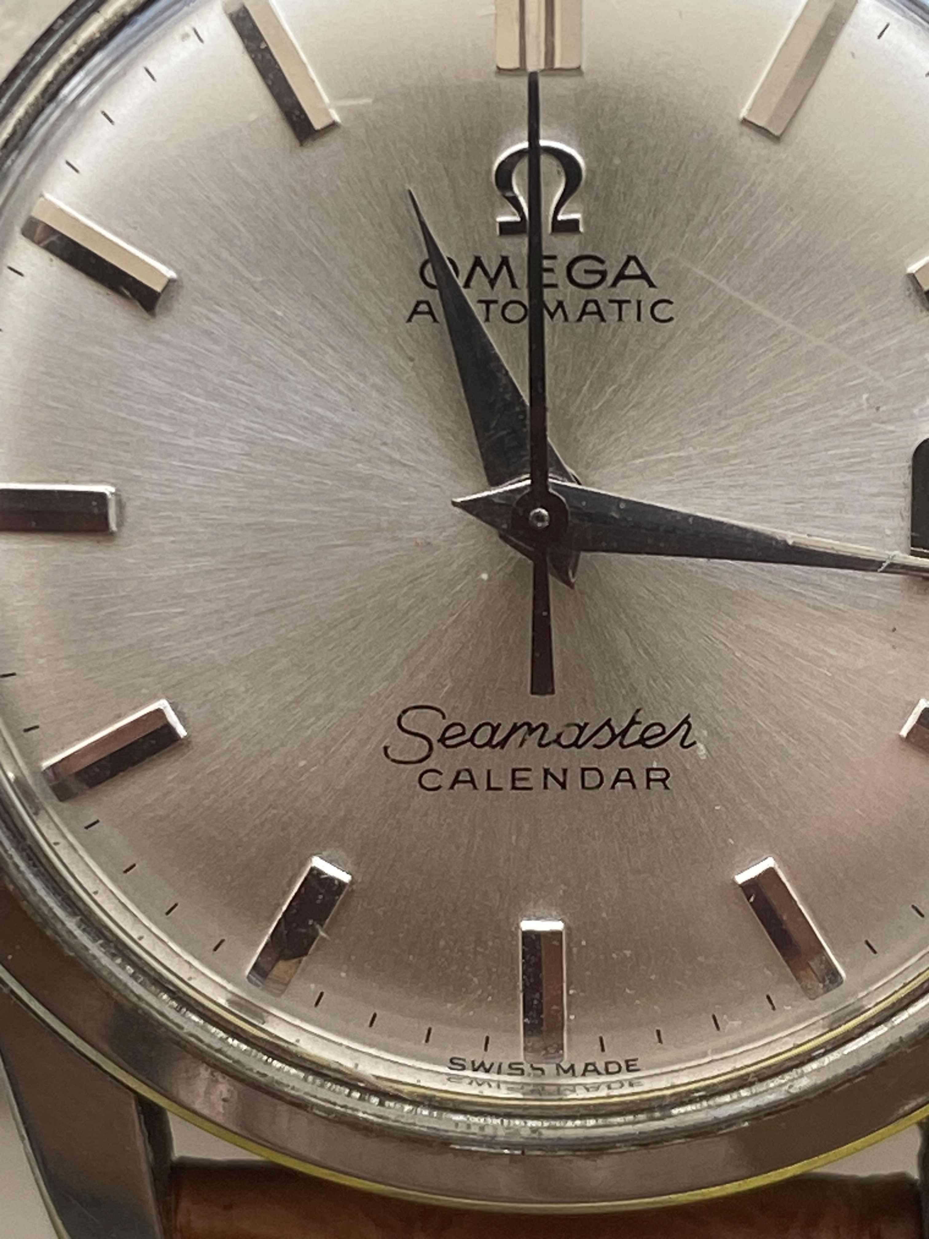

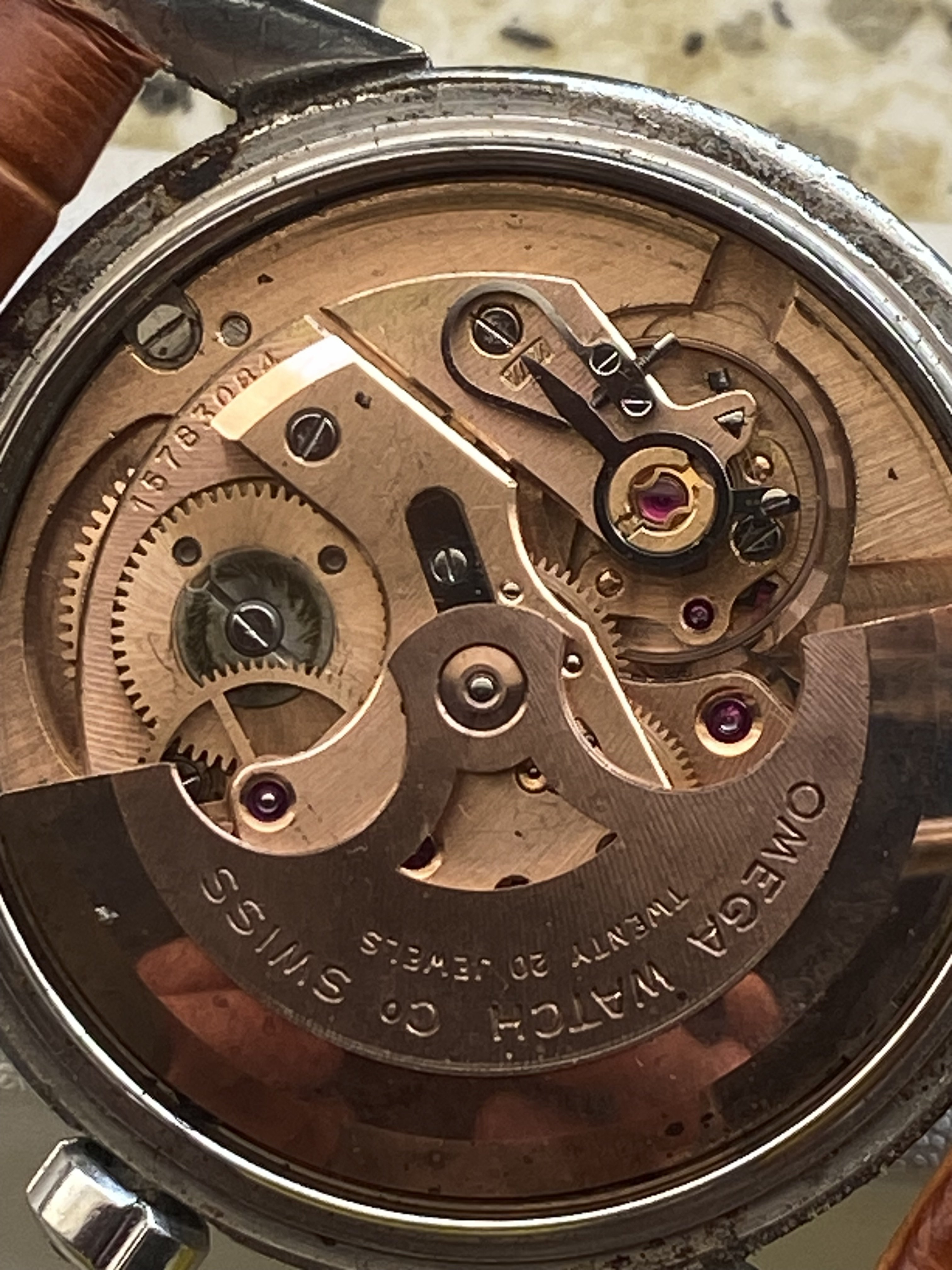

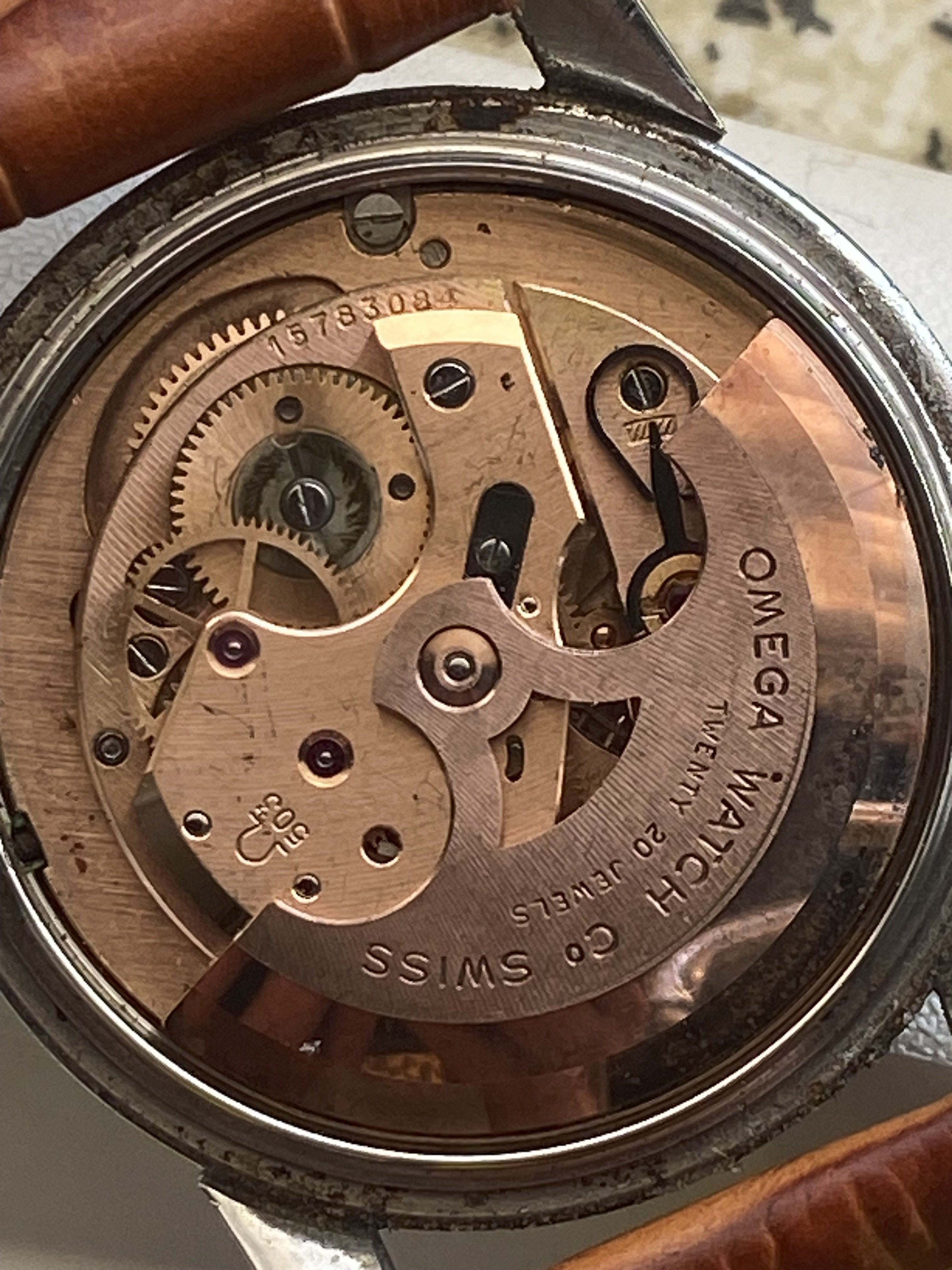

I hope you can help me learn more about my watch which my Dad had as his 21st birthday gift from his parents. It was bought from a jeweller in Liverpool in late 1956.
My Dad died many years ago and the watch lived in my Mum's jewellery box until I started to wear it about 8 years ago. It worked straight away and it keeps relatively good time but recently it seems to be getting a bit more erratic, losing perhaps 90 seconds a day.
Removing the back it looks quite dirty and I want to get it properly serviced, something I'm not sure has ever been done. I have no idea where to take it and would appreciate any advice and the likely cost.

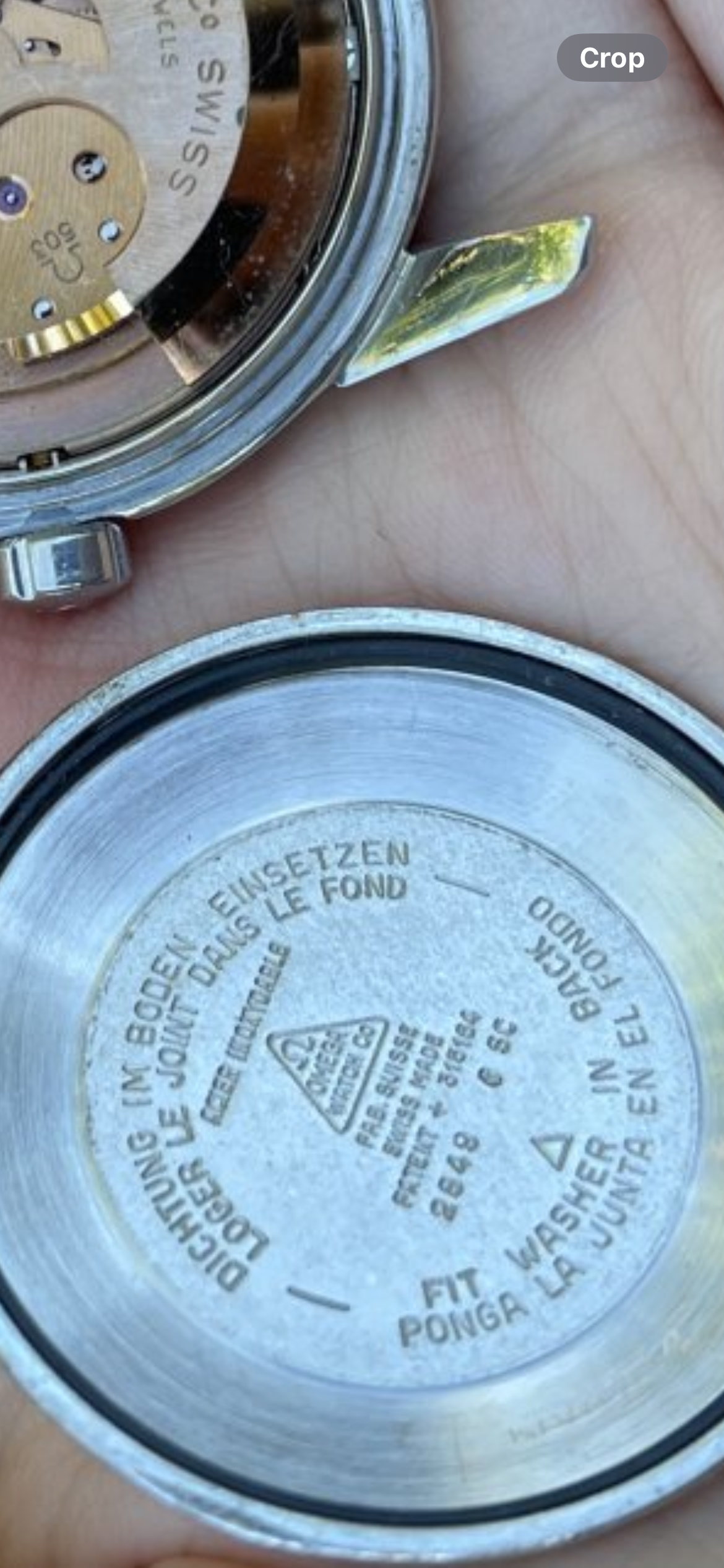

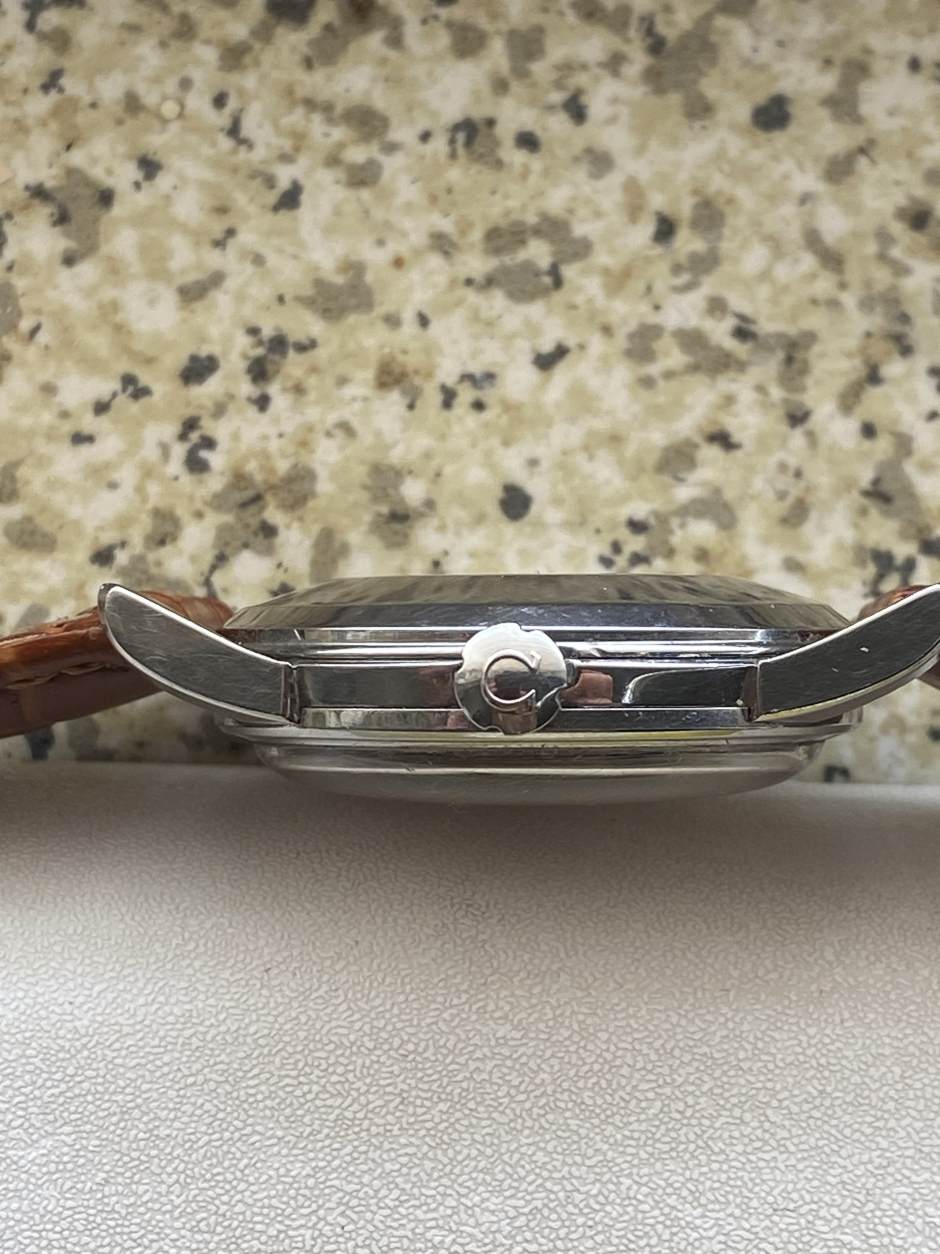

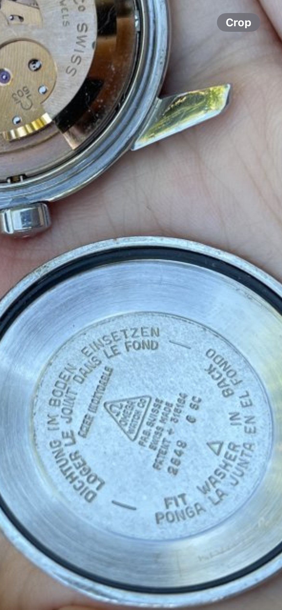

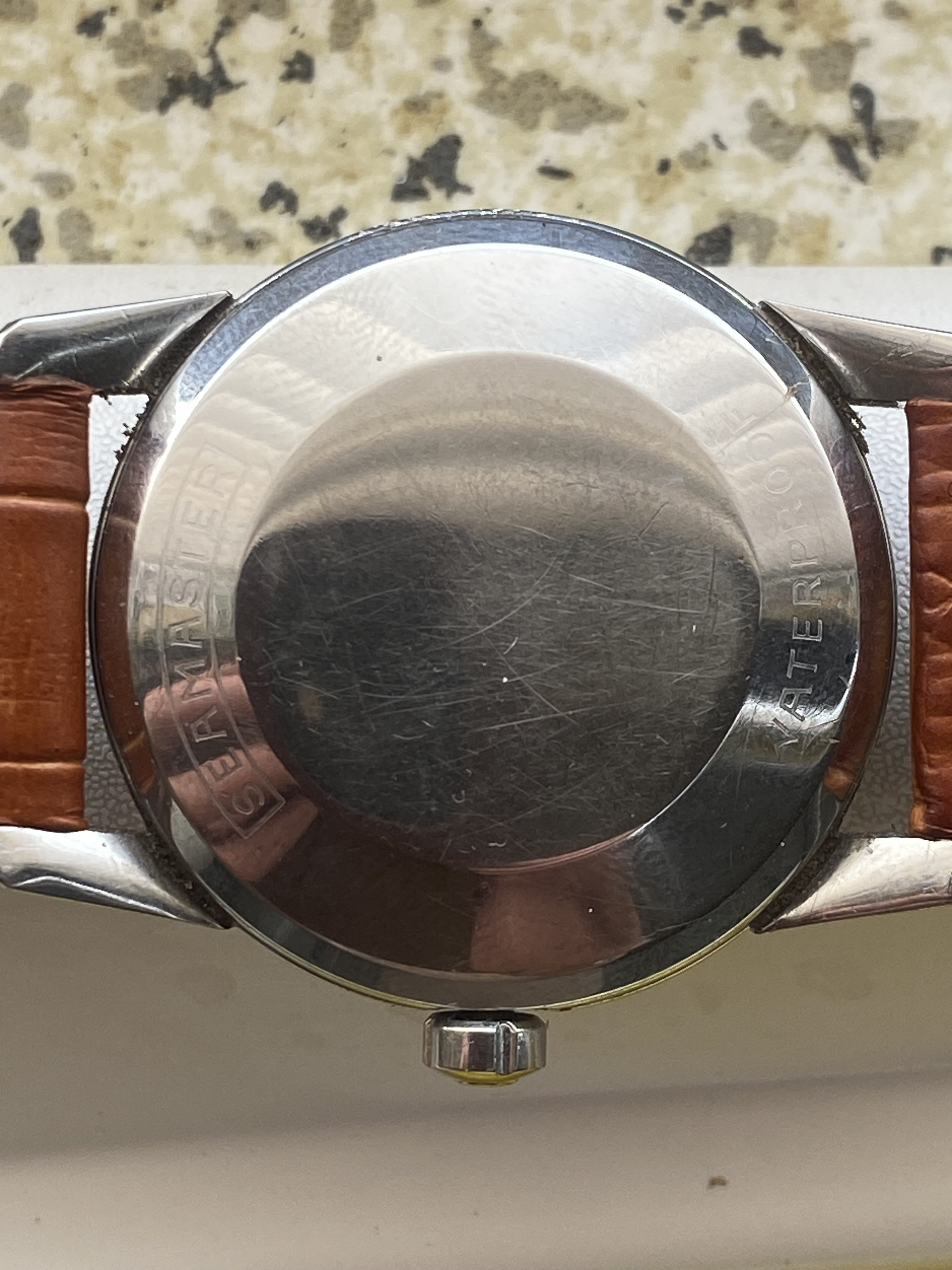

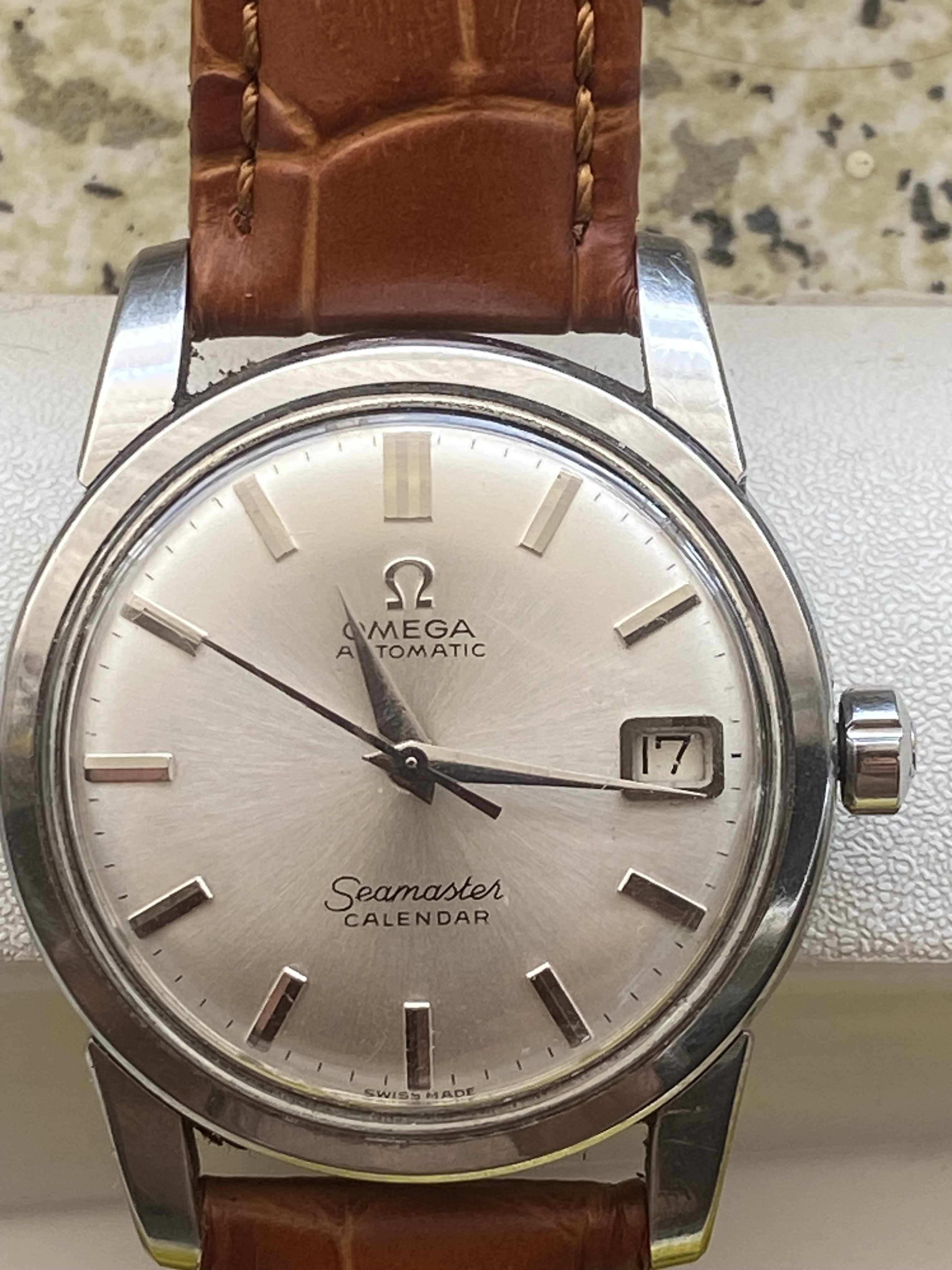

I would also appreciate your help on identifying the watch and if it looks ok; I've just copied the watch name from the dial.
I've added some pictures of the watch including one of my Dad wearing it whilst holding me as a baby in 1967.

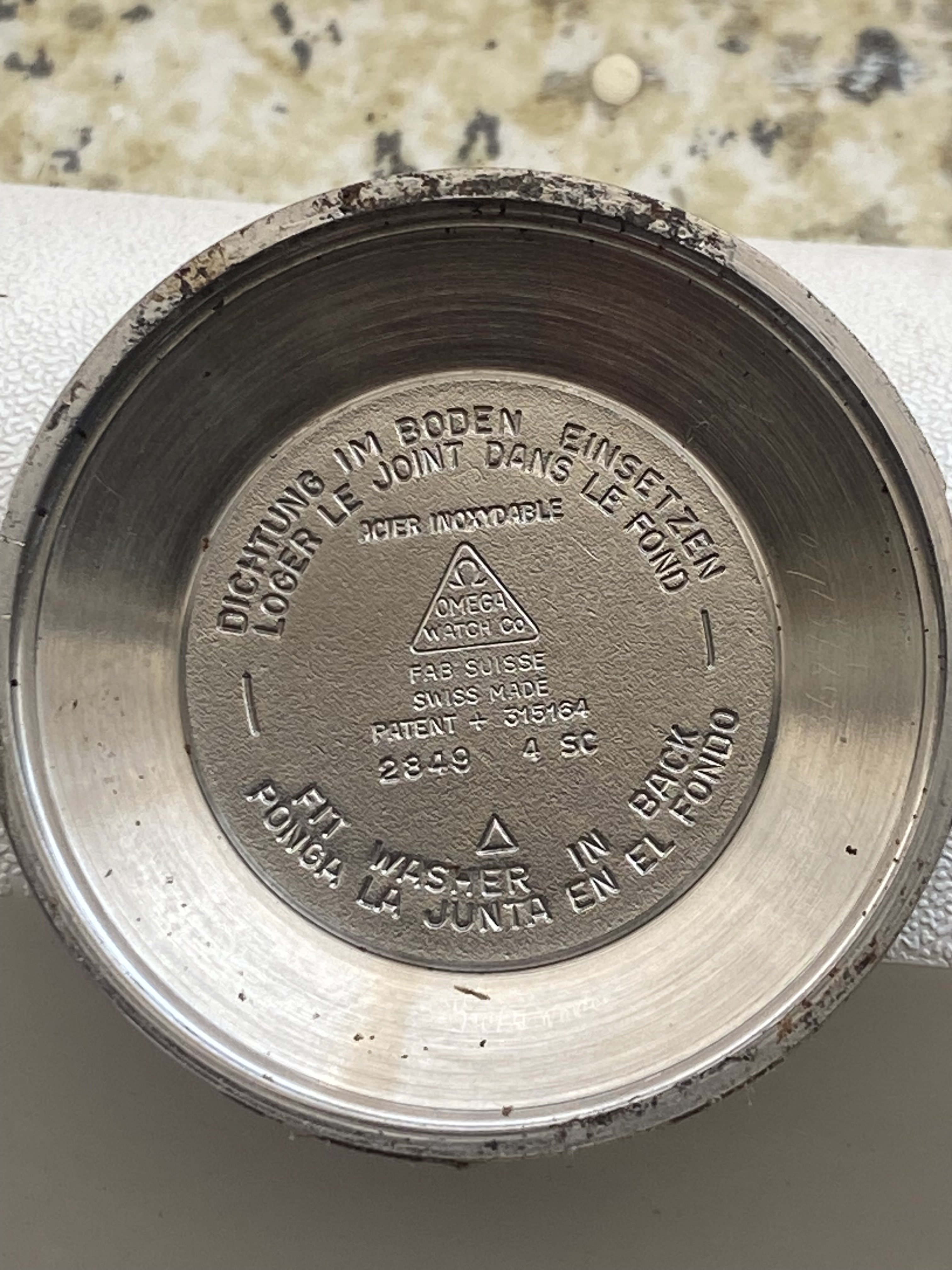

Very nice heirloom. There is lots of information about this watch type available on the internet. Do a little research yourself and let us know what you find. Just look up Omega 2849 to see similar examples. As for service options please let us know where you are based and I am sure you will get recommendations for a reliable watch guy in your area. Good luck.

A Seamaster with movement serial number in 15 million coming with that S makes me think about a wrong redial done in the past.

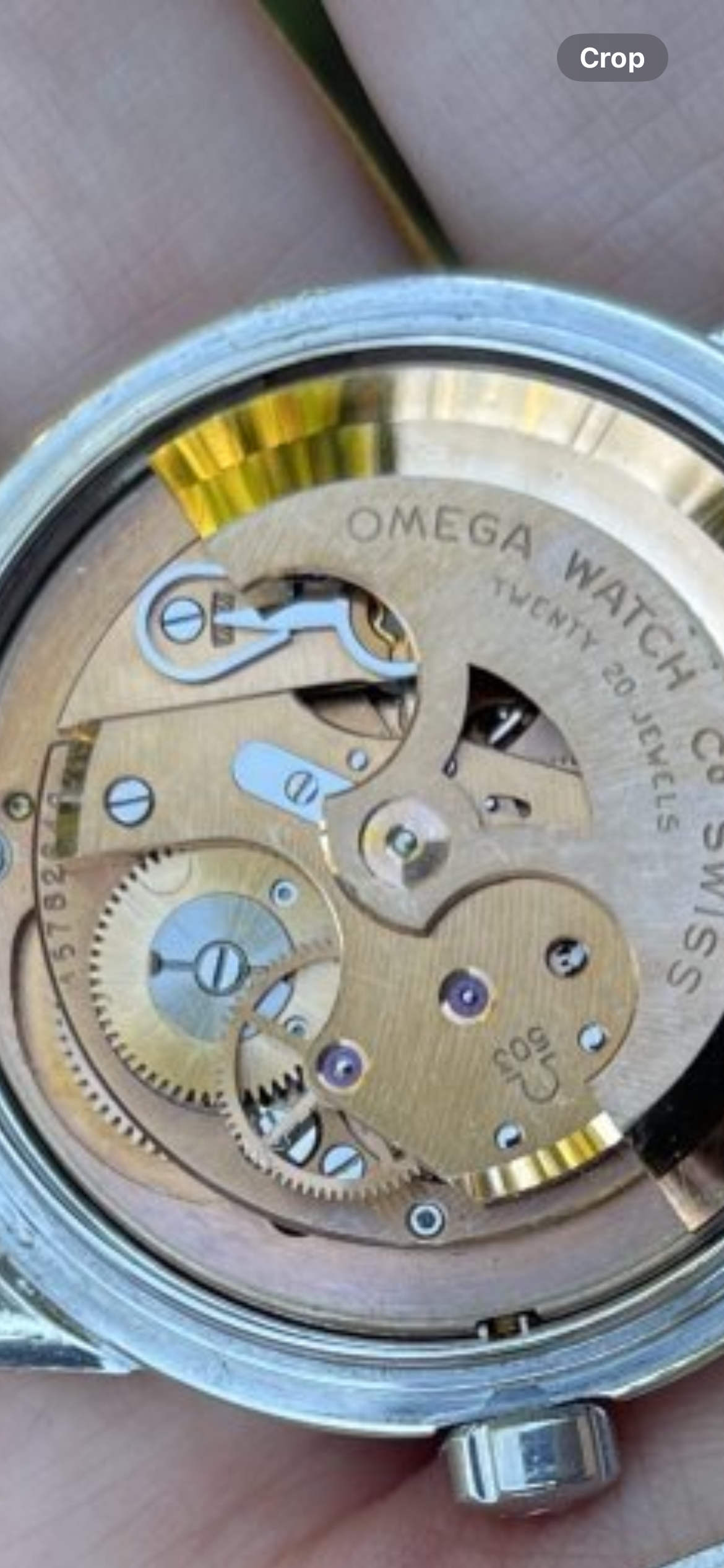

One of the best movements ever made. Unlike the 550 series the 470/500 series has a full bridge on the sweep seconds pinon. These are a bit thicker. Diameter is a bit smaller.
Probably the easiest movement out there to service.
Looks like a service dial to me, not refinished.
BTW, great first post.
I’d agree 😉 yep and great watch anyway!

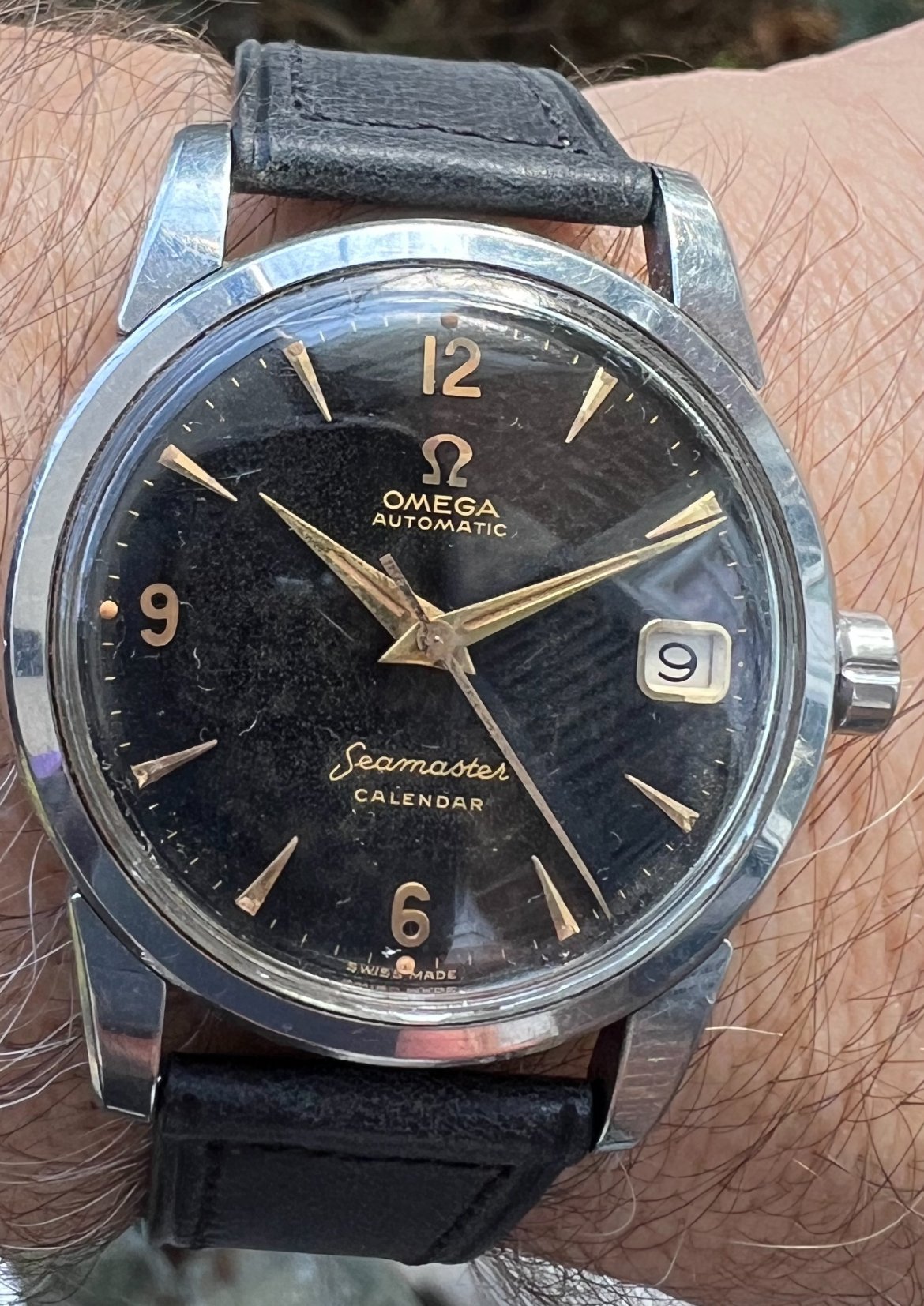

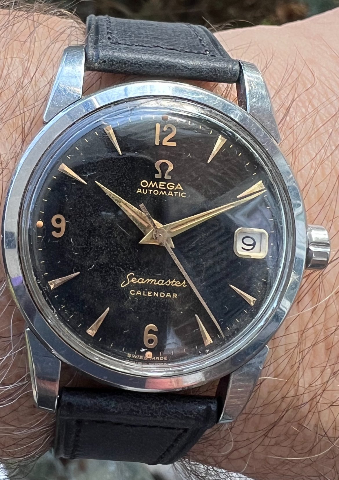

Looks like nice original 2849 If you move the rotor you will probably see cal 503. Black dial cousin says hello. Very nice heirloom if you share general location someone can recommend good vintage watchmaker. Welcome to OF
edit- looks like I’m a little late to the party didnt see the extra photos and posts! Enjoy the watch
