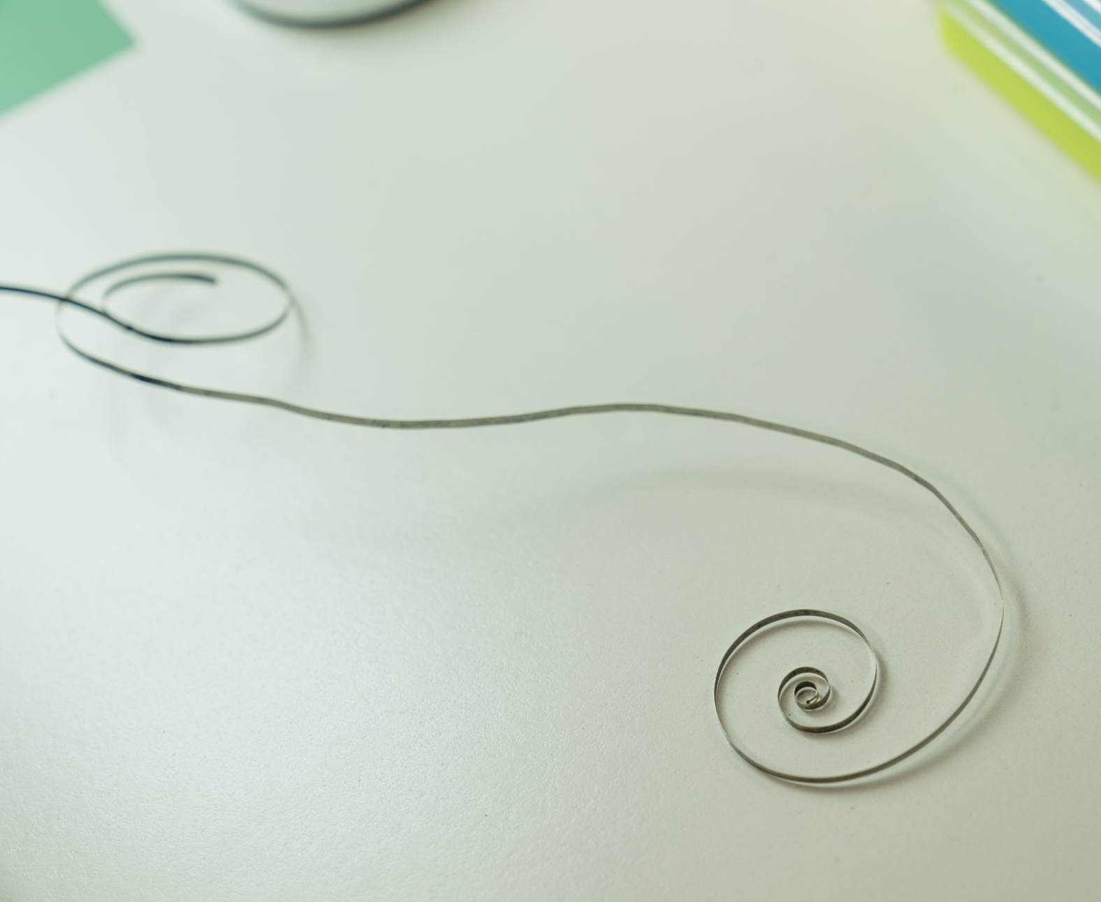

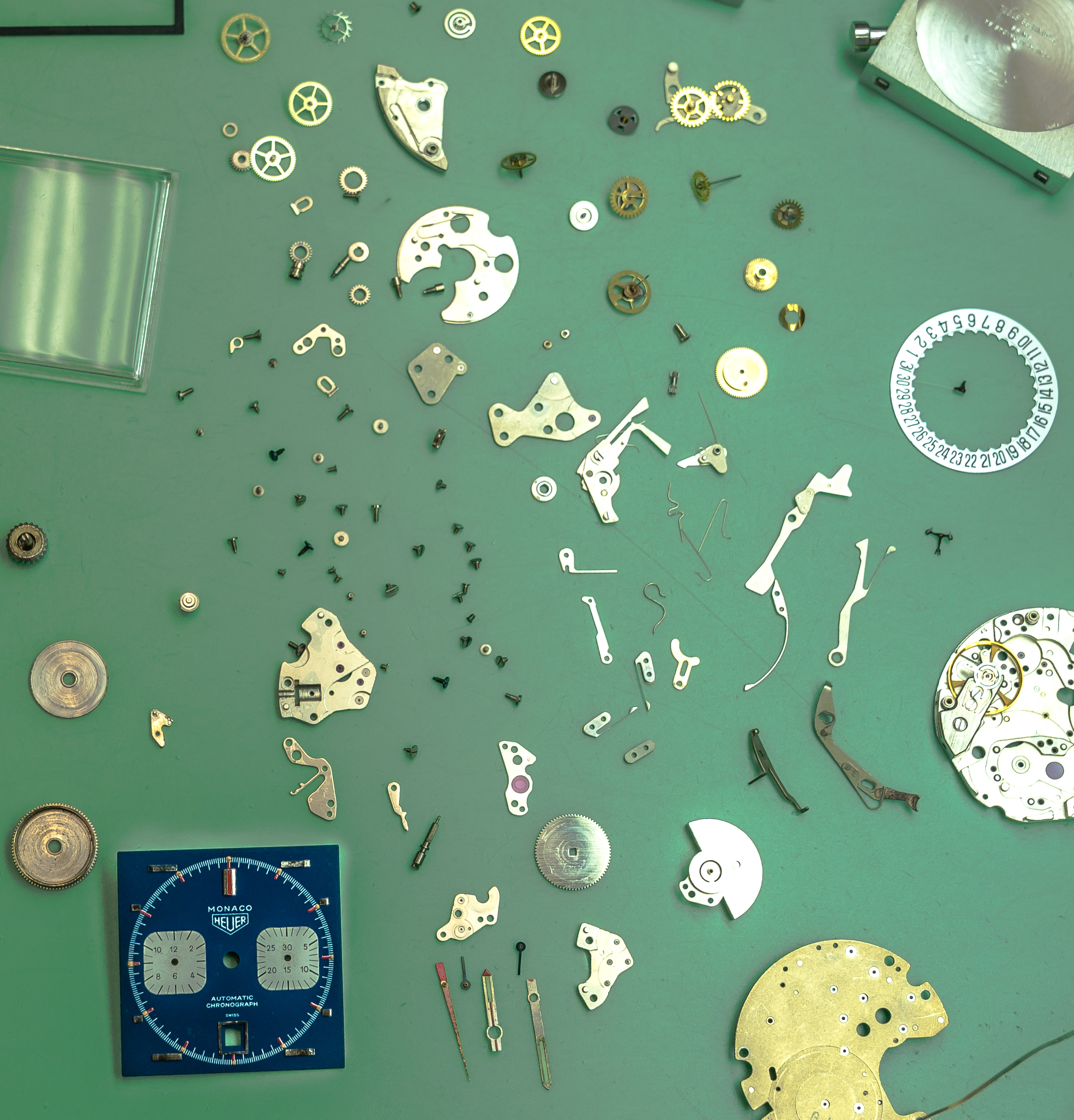

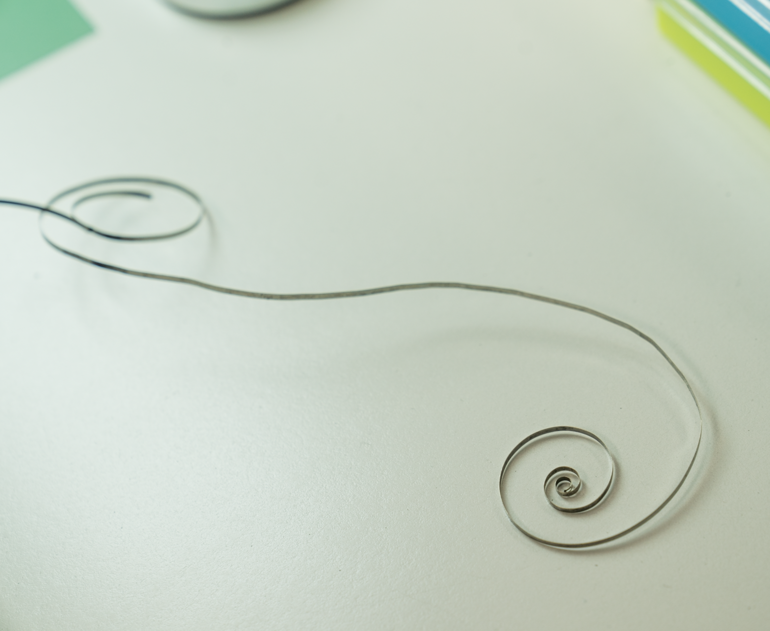

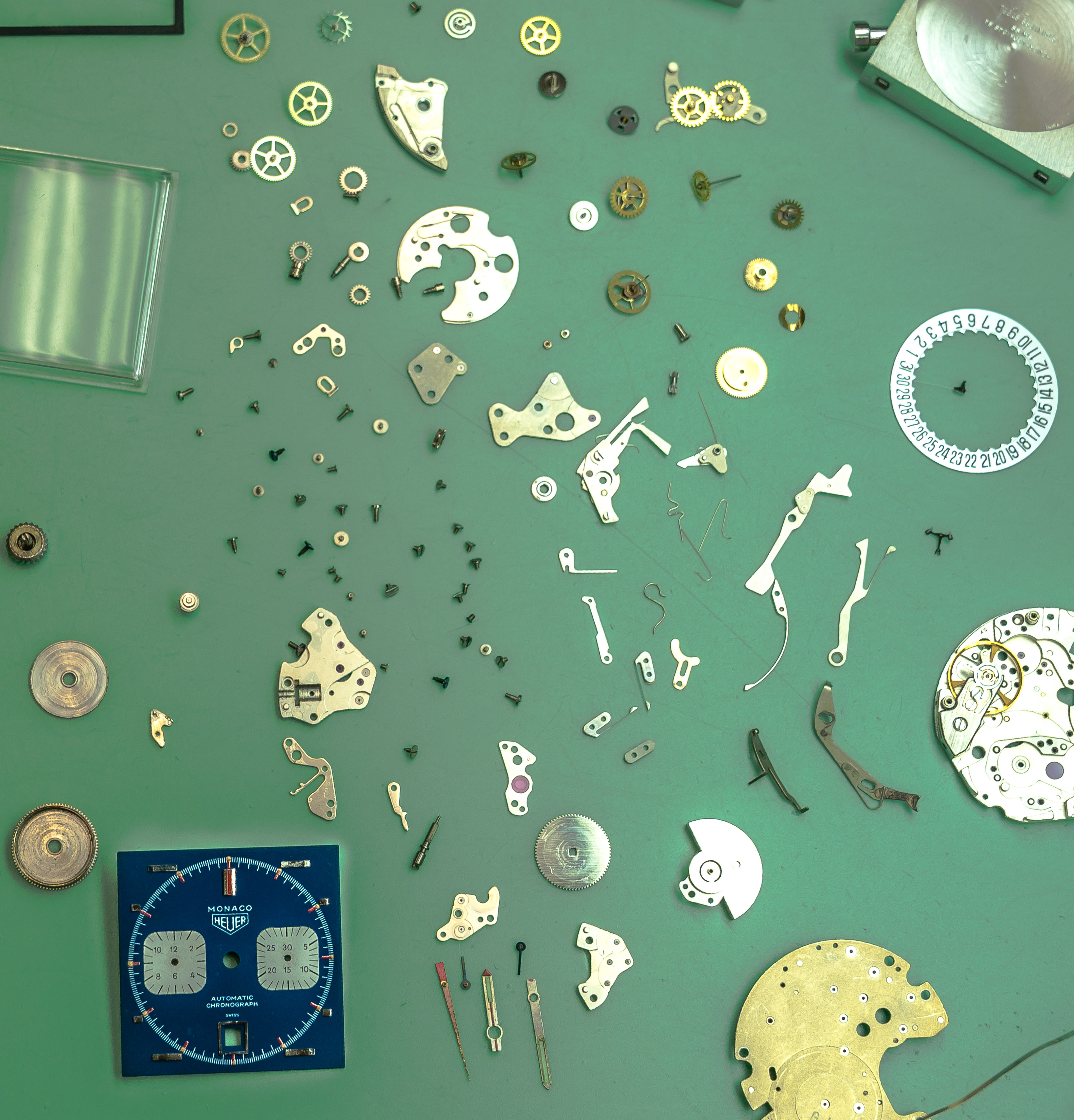

Here a 20yo main spring from my recently serviced Monaco.
Just giving this thread a visual.
