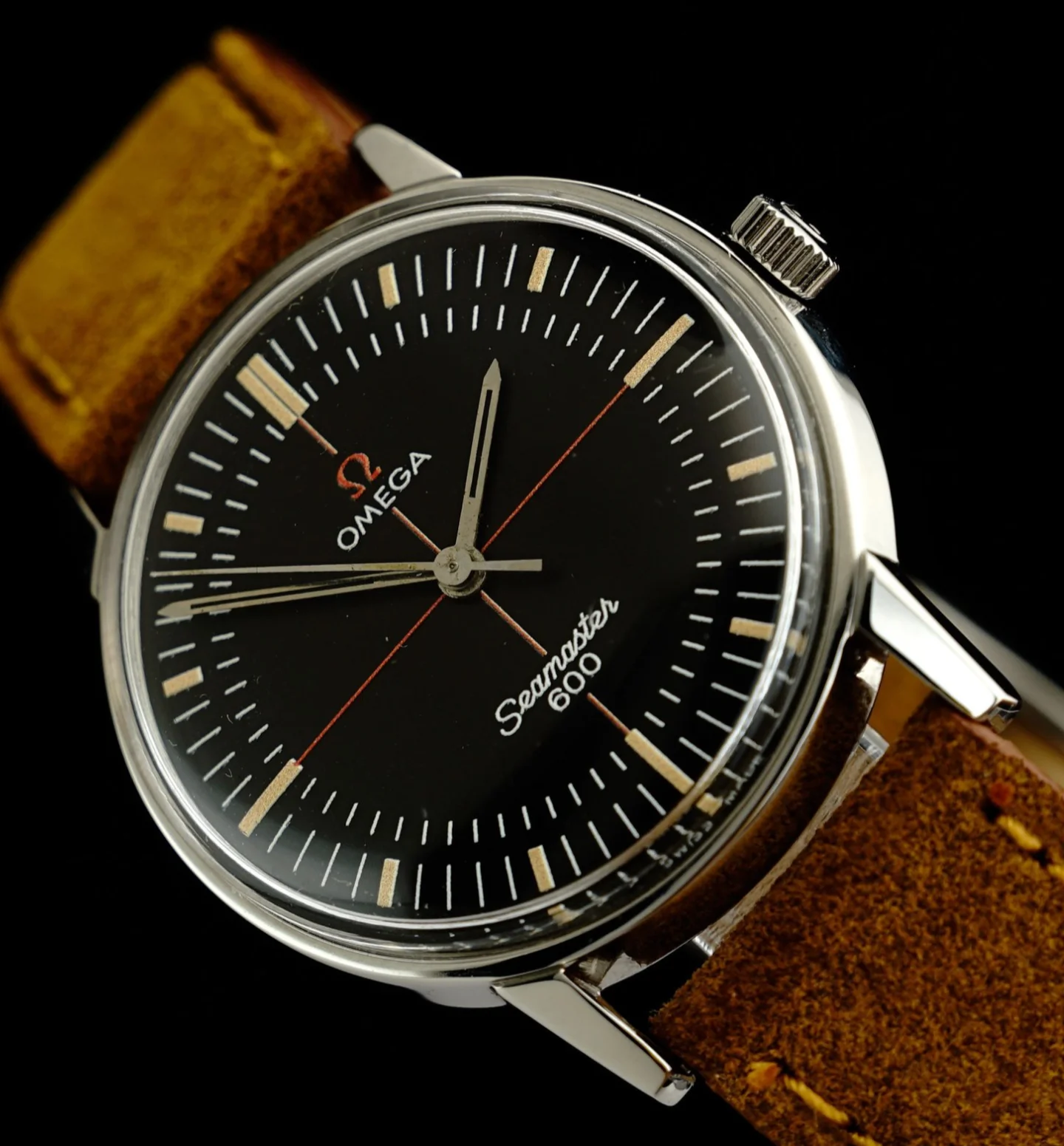

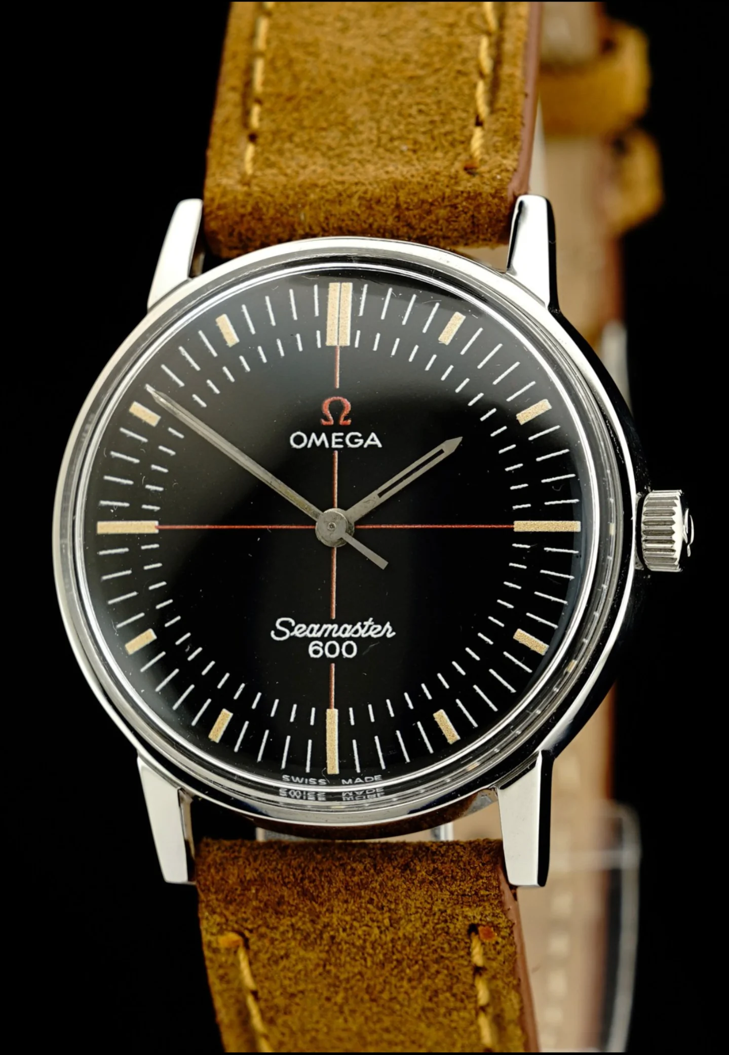

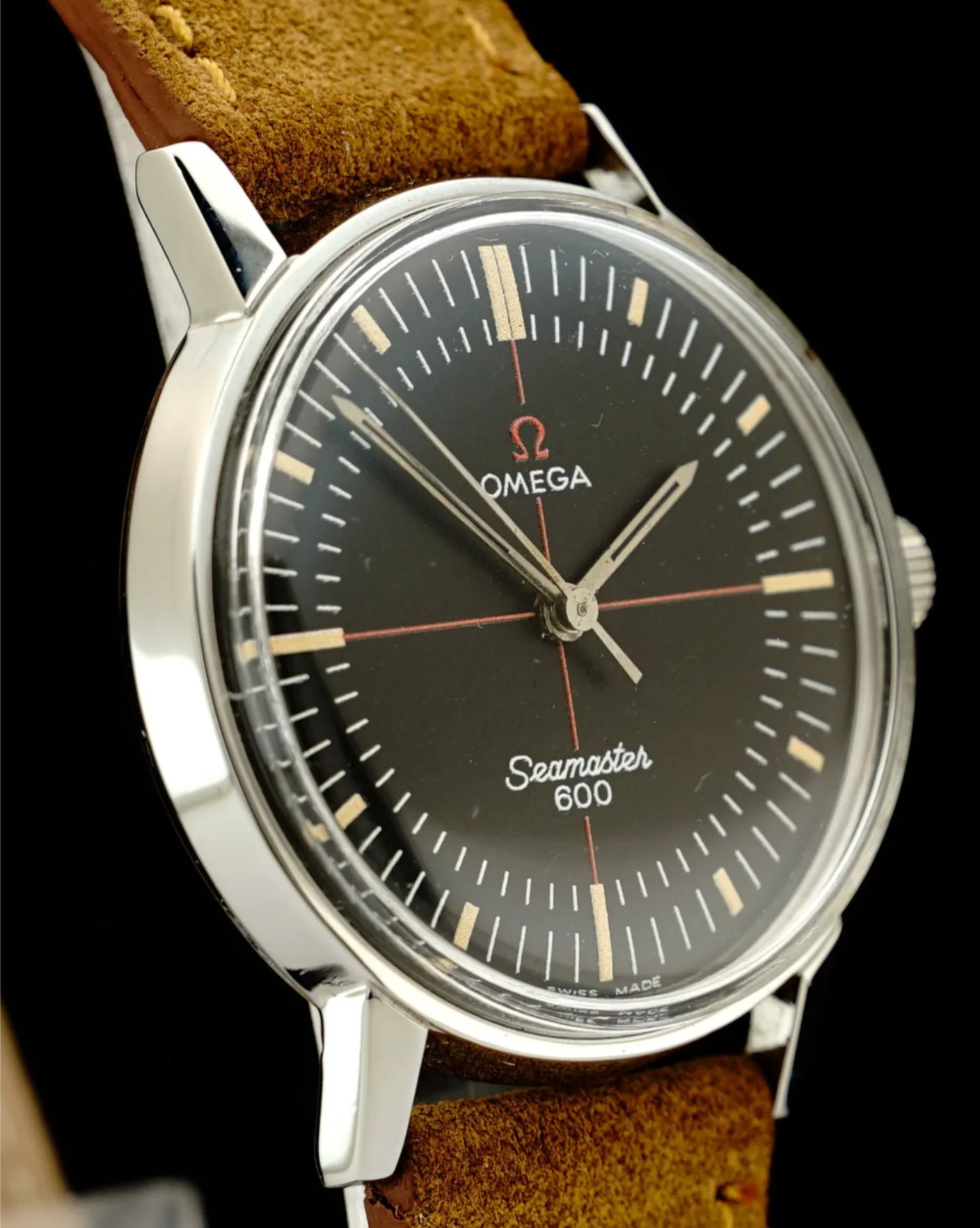

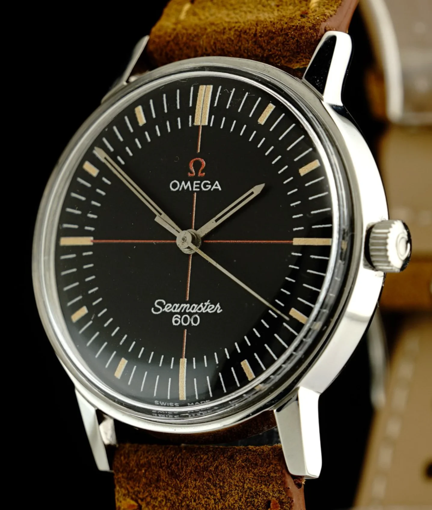

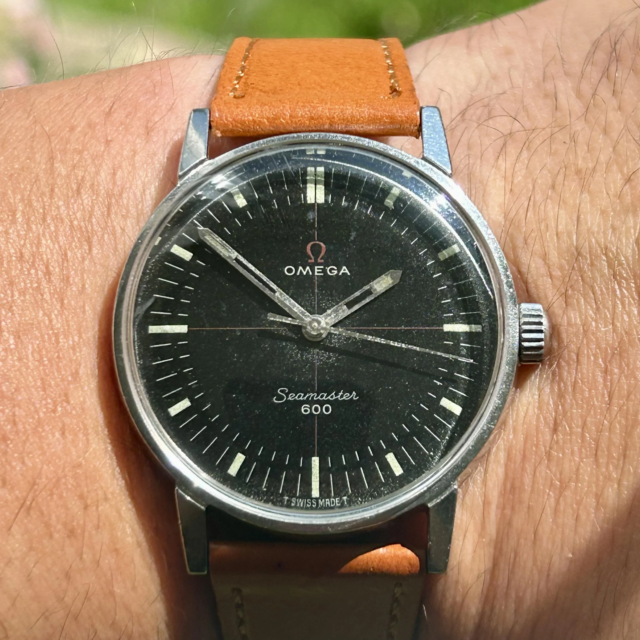

Hi everyone,
I recently won an auction for an Omega Seamaster 600 ref. 135.011 from the 1960s - to my surprise, at only €550.

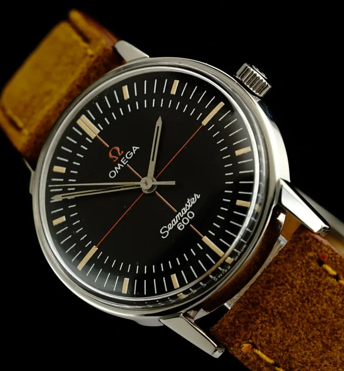

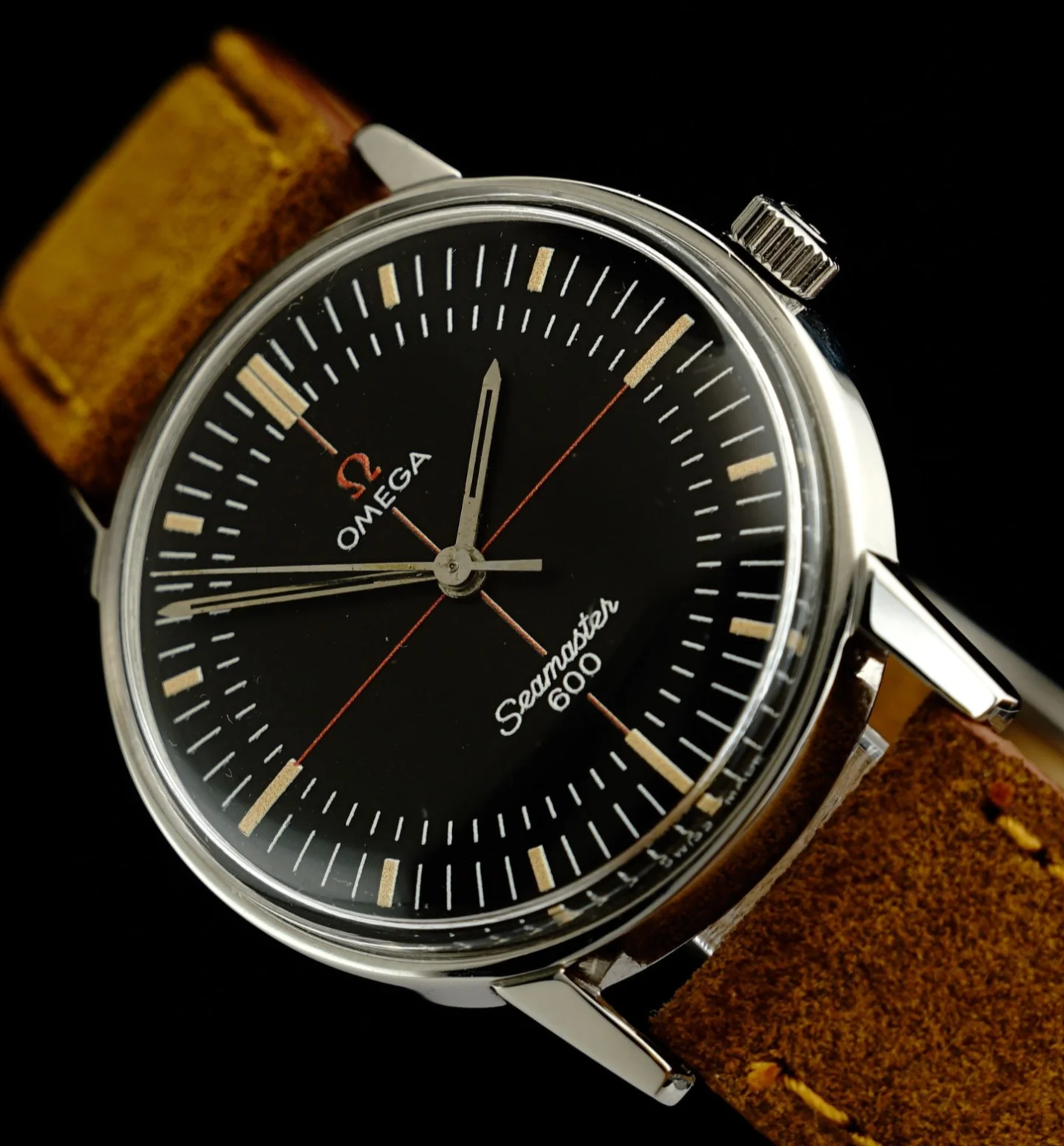

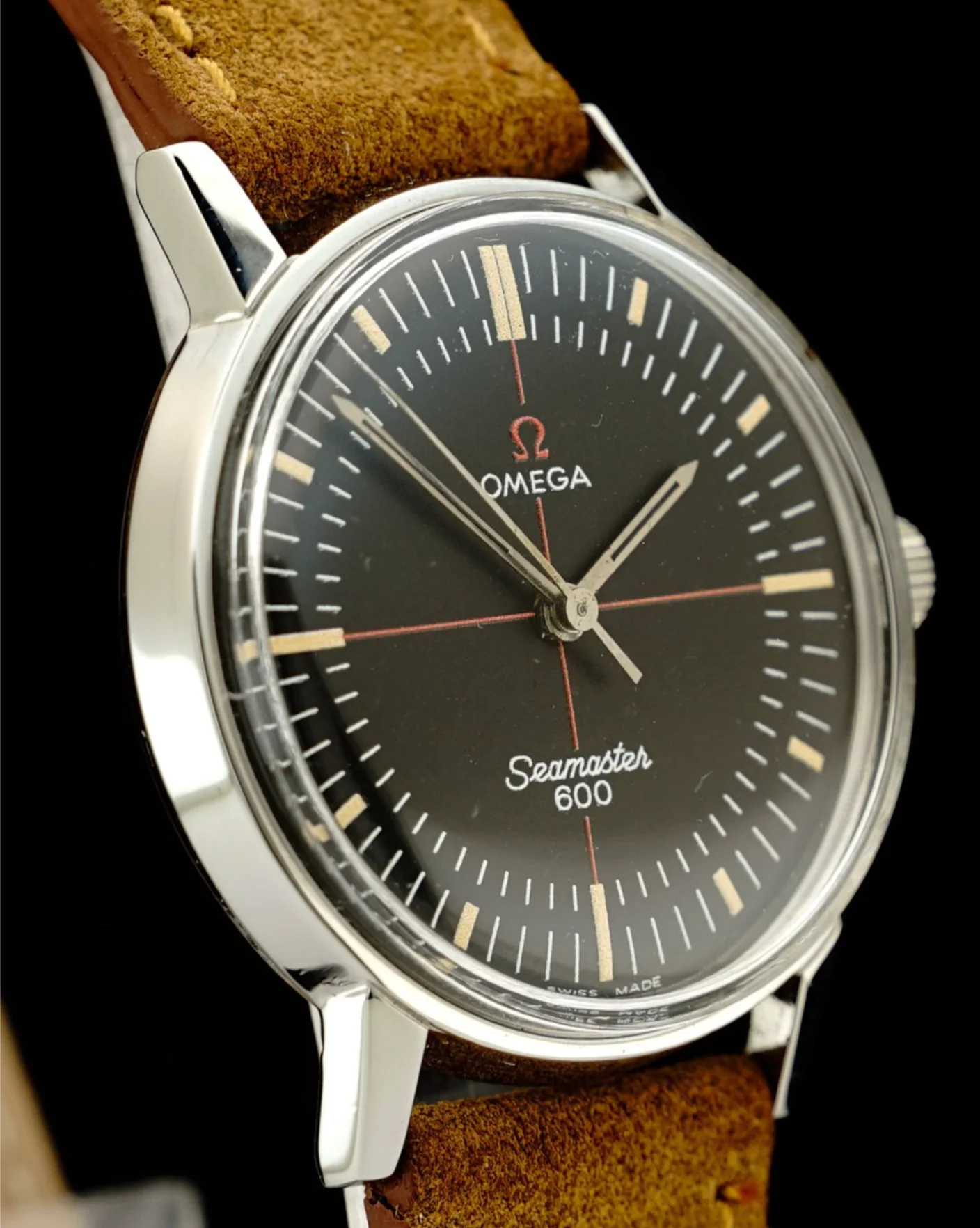

The listing states that the watch has been "restored," but doesn't specify what that entails - it doesn't mention repainting. The dial looks very vivid and clean, so I'm wondering whether it might actually have been refinished. Still, it looks great overall, and if the restoration was done properly, I wouldn't necessarily mind at this price.

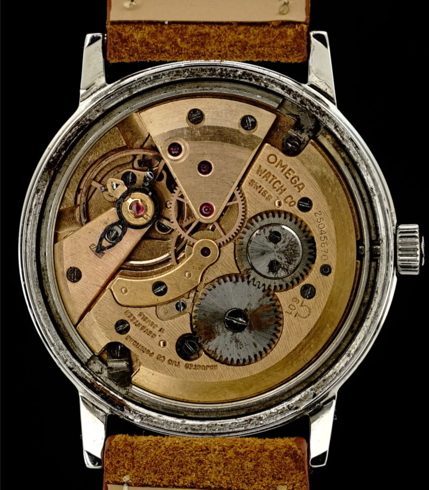

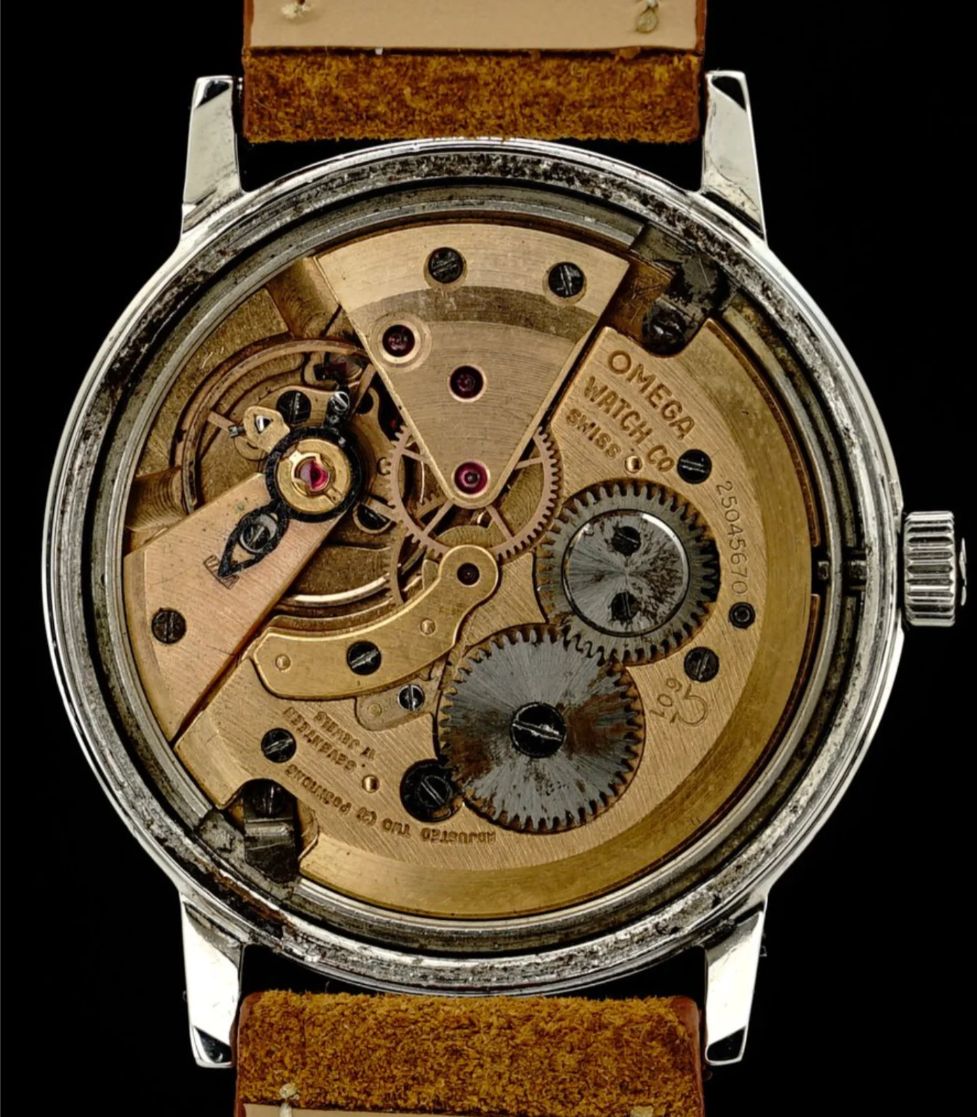

According to the listing, the watch has been "checked, cleaned and tested" (not fully serviced). The movement is a Cal. 601, serial 25,045,670, and the case reference 135.011 checks out. However, the movement doesn't look particularly clean to me from the photos.

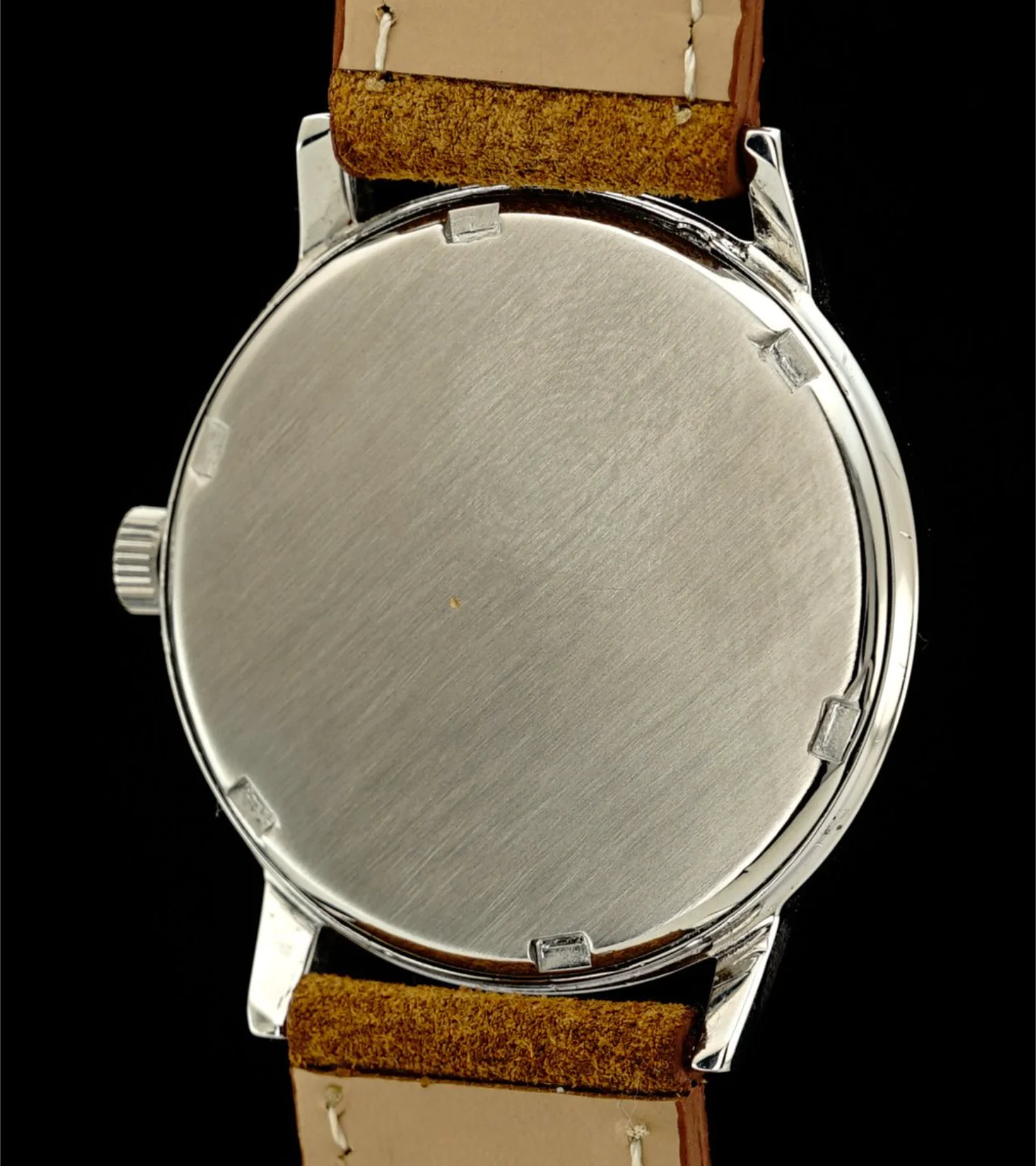

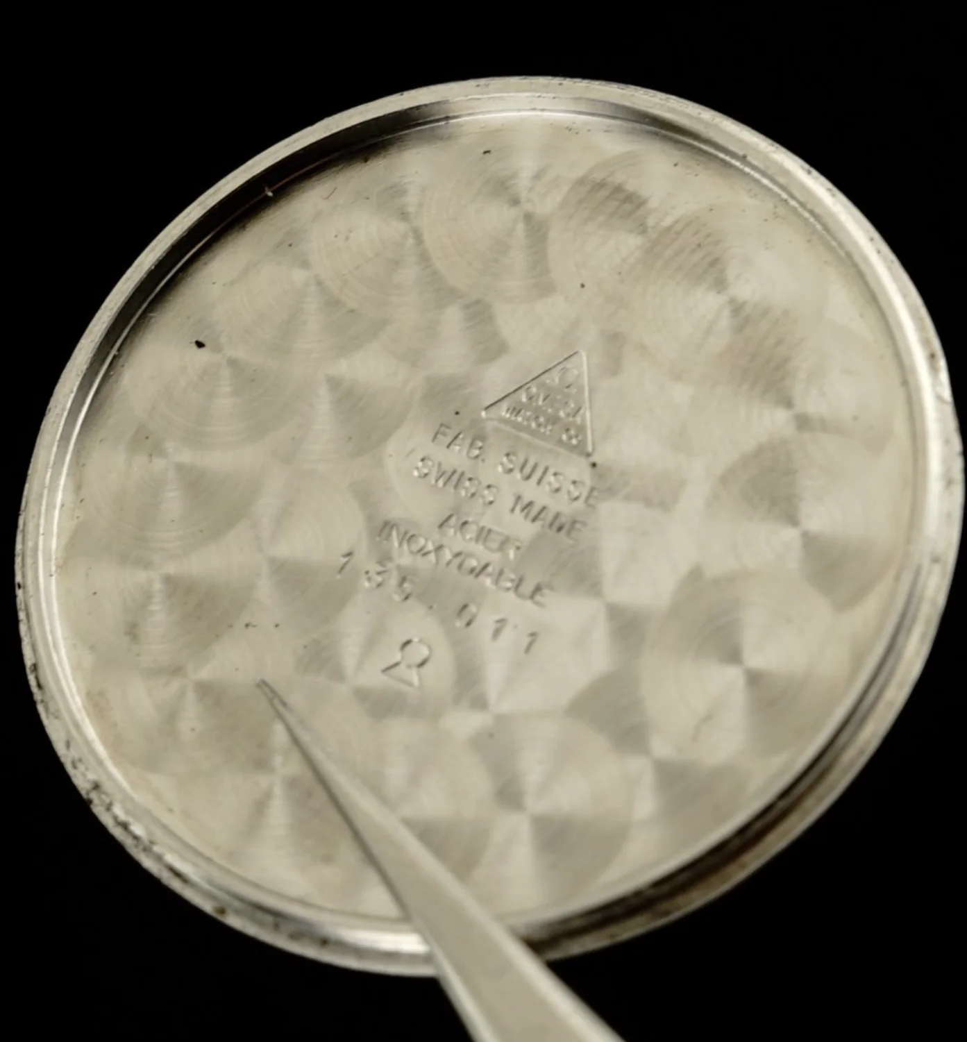

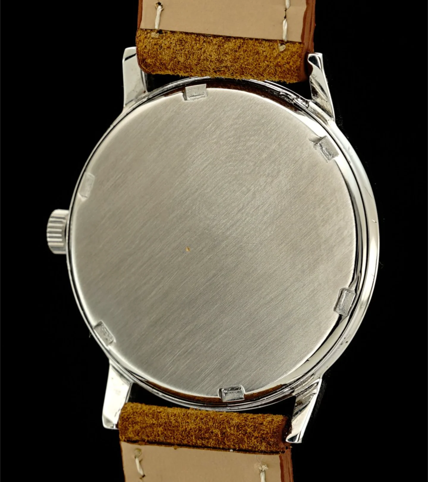

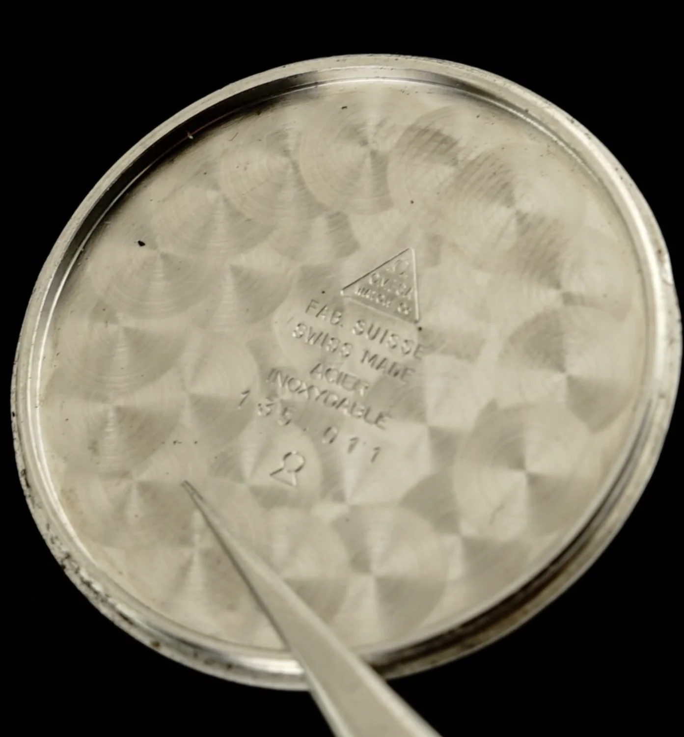

The seller also claims there's a Hippocampus logo on the case back, but in the photos it appears to be plain (no logo) - which makes me wonder if the case back might have been replaced or over-polished.
I haven't provided payment details yet and would like to make sure everything matches the description before committing.
You can see the full listing and high-resolution
I'd really appreciate your help and opinions on:
Whether the dial looks original, restored, or repainted.
If the movement appears correct for this reference.
Whether the plain case back is a red flag.
And if this is still a fair buy at €550, given these details.
Thanks very much in advance for your insights!
BR Anders

Repainted dial, case very aggressively polished and refinished. The shallow indents for the opening tool in the back suggests that the back was polished down and re-brushed. I can't see a hippocampus. No lume in hands. Case and movement pitted and corroded.
13,538
23,482
It’s utter crap I’m afraid.
The dial is repainted - I can say with 99% certainty this had a standard silver dial before it was refinished, the case is corroded and overpolished and the movement looks tired.
Absolutely return if you can but really you should ask these questions before you bud, not after you’ve won.

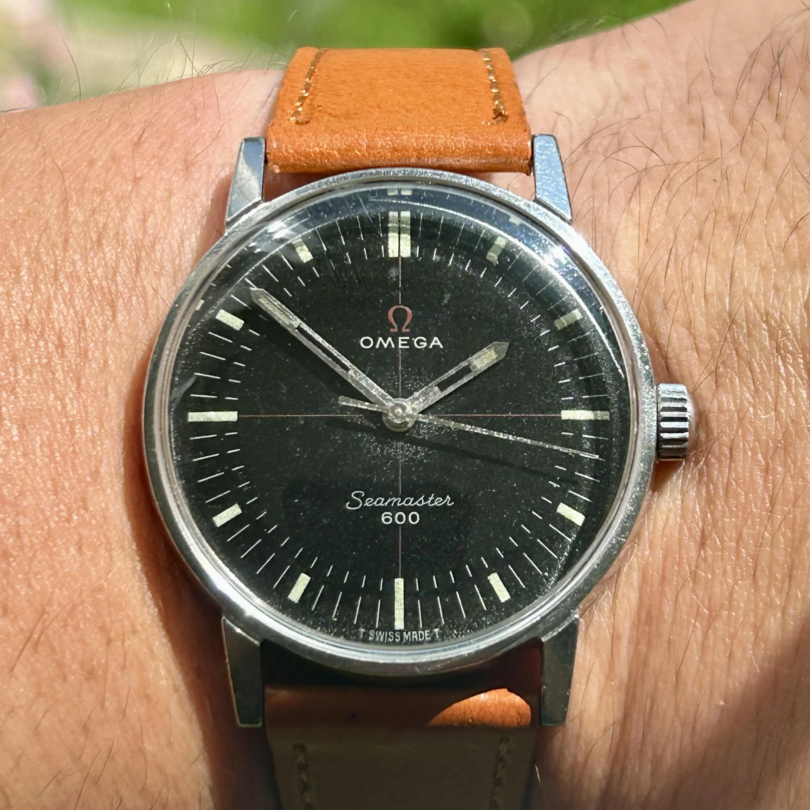

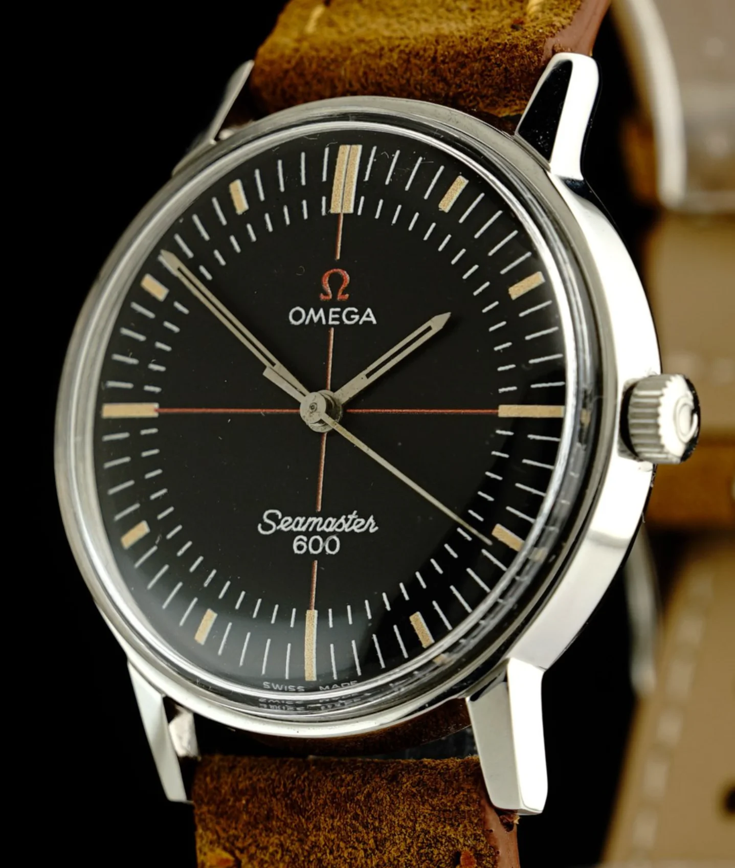

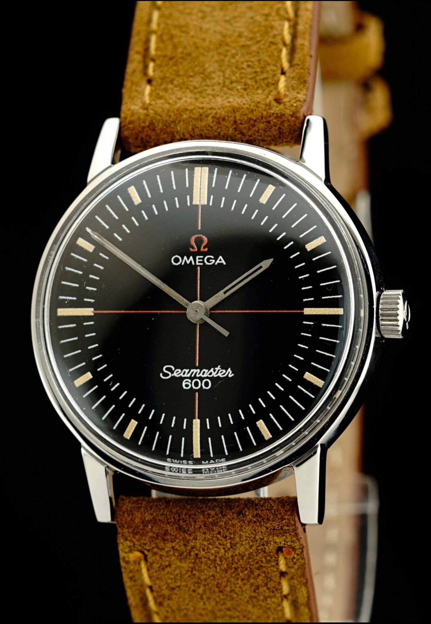

Here’s a picture of an original dial for comparison.
It’s actually not a huge difference here. That alone is scary.

Thank you very much. Definitely has been repainte.
9

It’s an assumption based on:
1. There are probably 30-50 silver dials to every 1 technical dial.
2. Even a patina’d, original technical dial is worth more than one that’s been repainted.
3. Sellers often buy dirt cheap, crapped out silver dialled Seamasters and repaint them with black/technic dials.

If the movement has obvious signs of corrosion like this one,but the dial is immaculate,it normally means the dial isn't authentic.

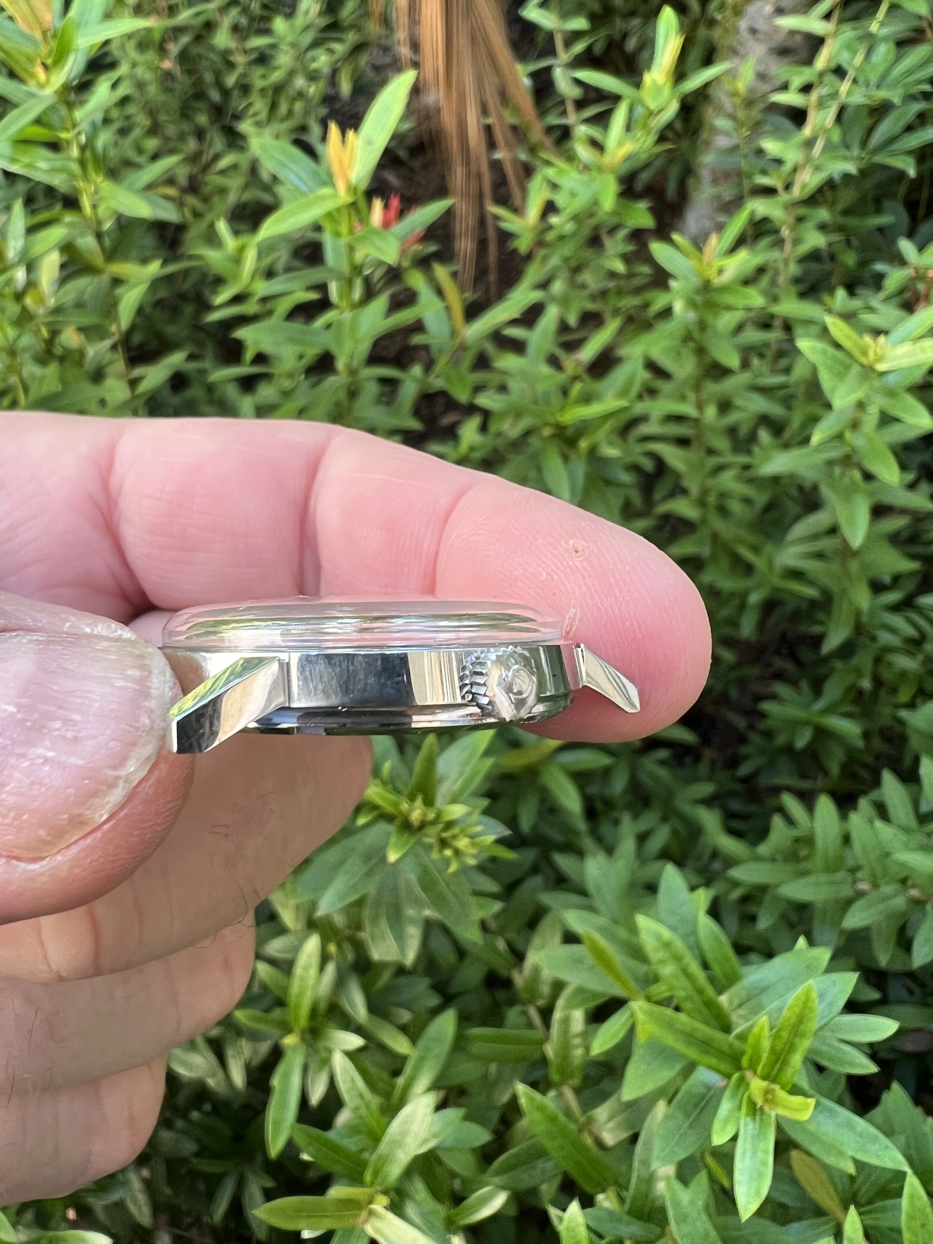

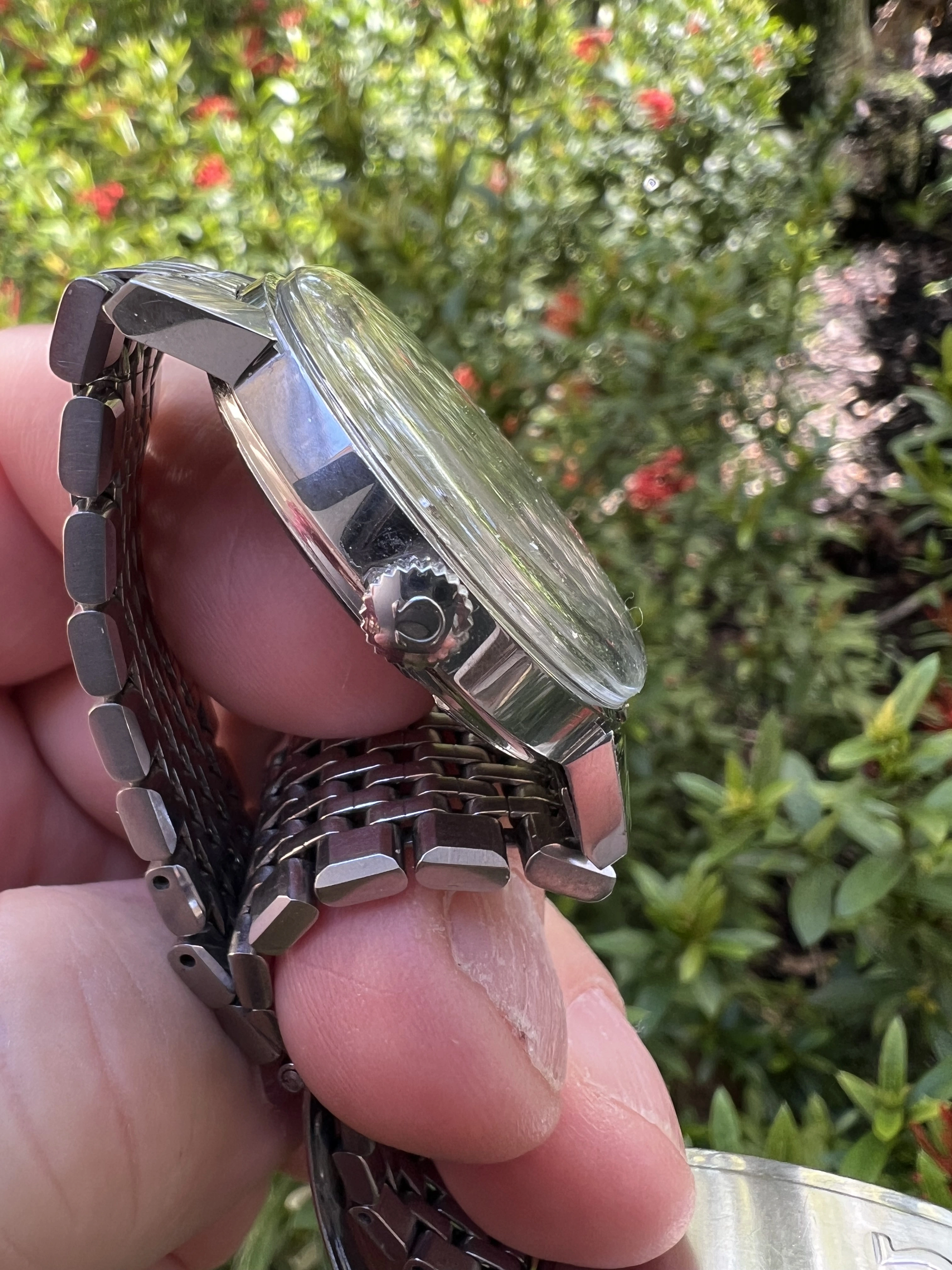

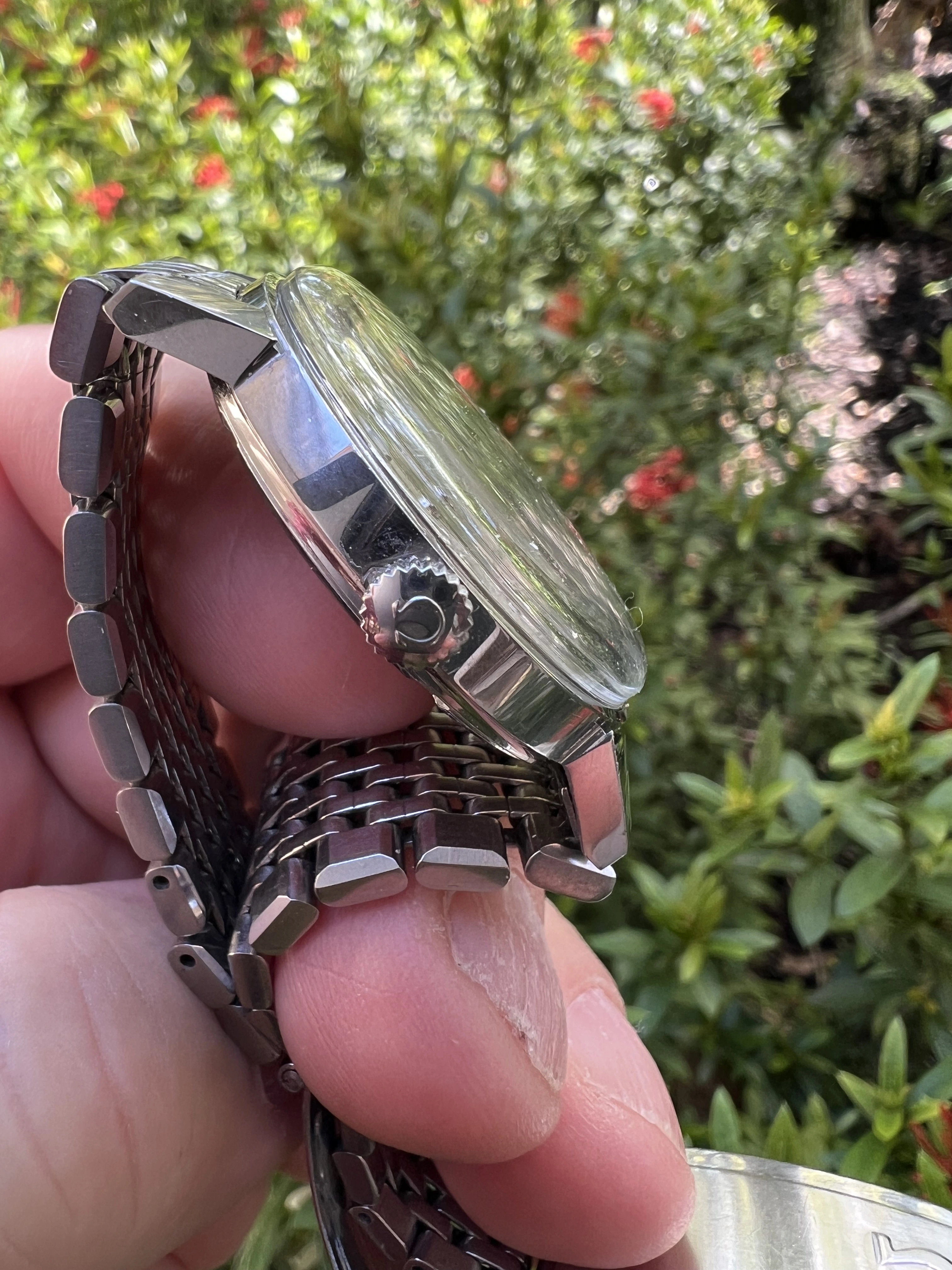

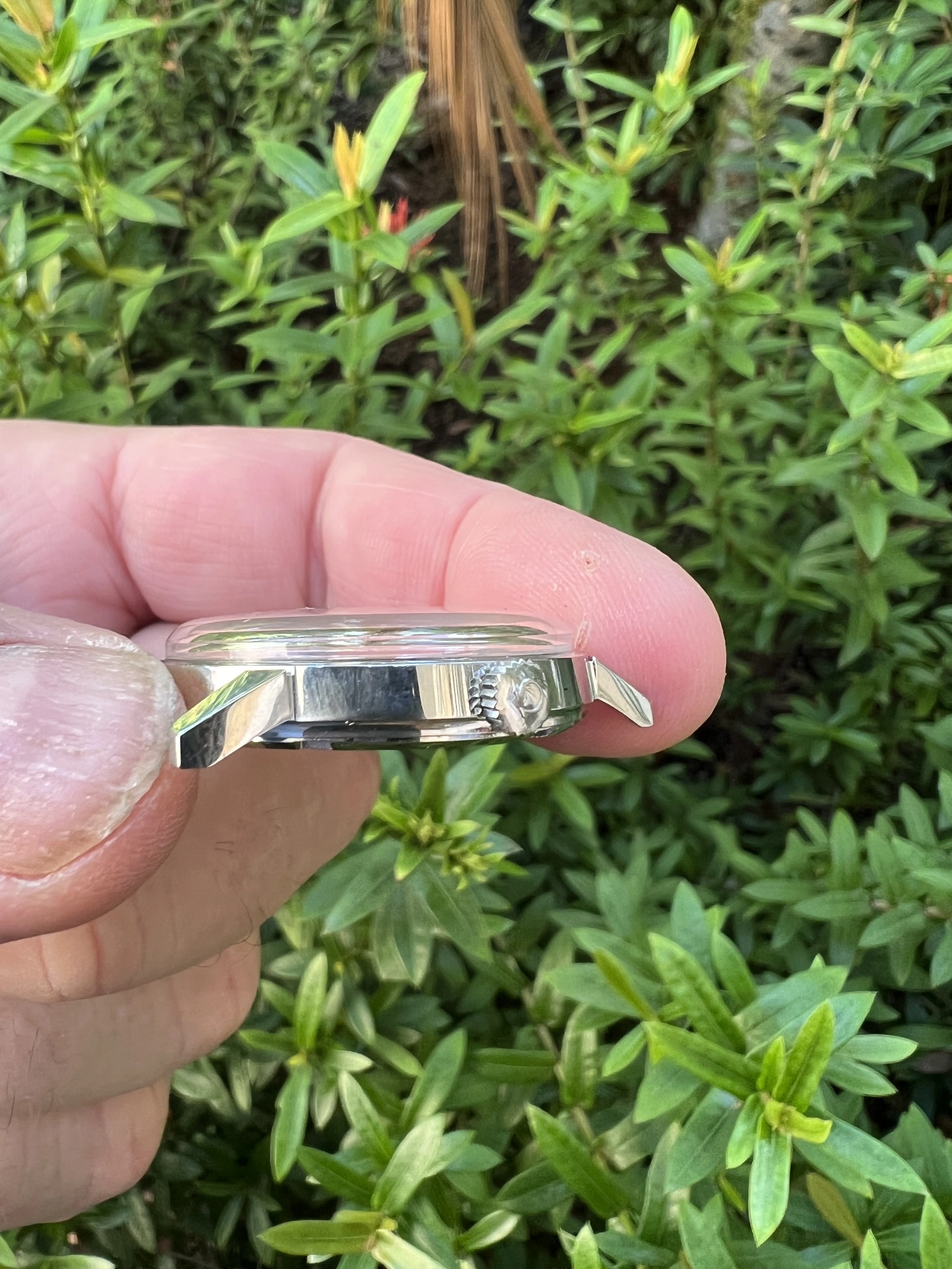

For future reference the lugs on this reference should be quite sharp.
