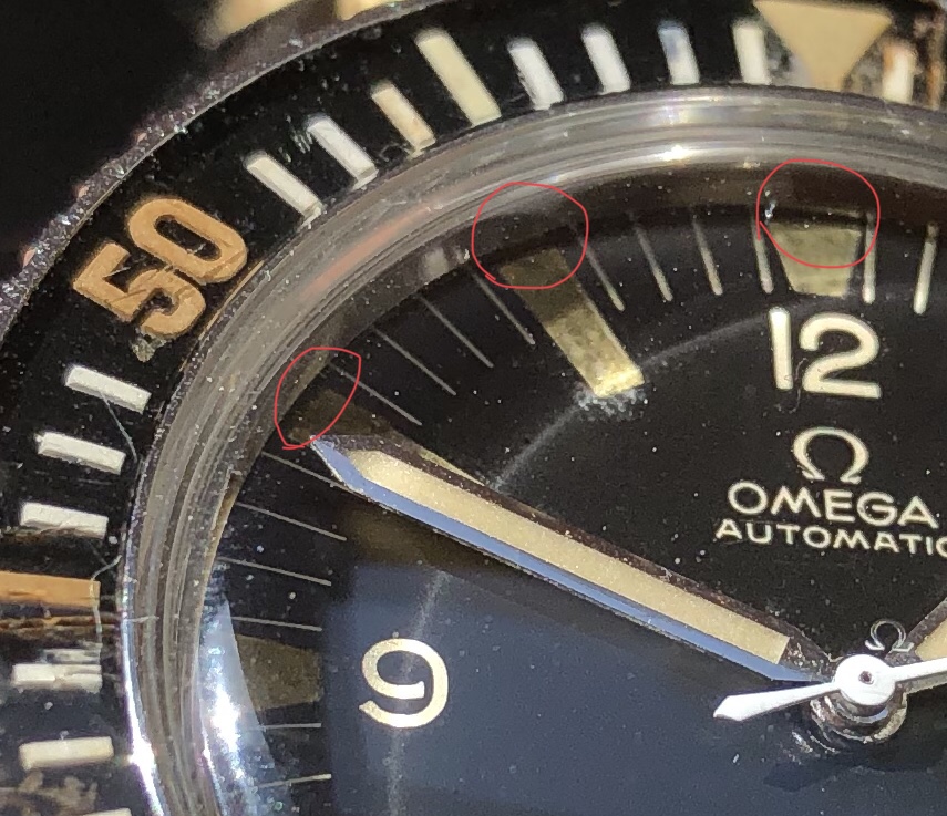

But You said that the watch is not original. But You didn't give examples for dial.
So I think what is with this dial not ok . Few person said that the Dial looks like original .
I have tomorrow deadline to buy this watch or not buy. So I know that the Bezel is not orignal , movement original ,
Envelope - I don't know
And Dial - I don't know what is wrong with this Dial.
That's why I request for examples what is wrong with Dial .
I think is that good think to buy it and looking for oringinal bezel ( if for example dial is ok ) or it is not good way.
Thank You
I am not an expert but I will try to explain you the issue with your dial. I marked the relevant areas in red.
This is an original dial without stubbies:
This is your dial with stubbies:
I hope this helps.

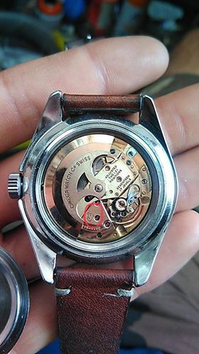

Btw. The movement of your watch appears to be a Omega cal 550 (picture isn’t very shrap) . An Seamaster 300 with the reference 165.024 should have a cal 552.

Very nice analysis on the dial. I believe that cal 550 can be correct for this reference.

You are right. I almost forgot about those produced for the US market. :whipped:
The best thing would probably be checking the serial number with Omega.

Thank You Everybody for every opinion.
You help me to not to do a big mistake.
That is situation that You are looking for some model and suddenly is chance to buy it in good money and You BELIEVE that everythink with it is ok.
I think better will be looking for Omega Seamaster 60 or 120, these model are cheaper and very nice too and maybe there is not a lot of fake.
