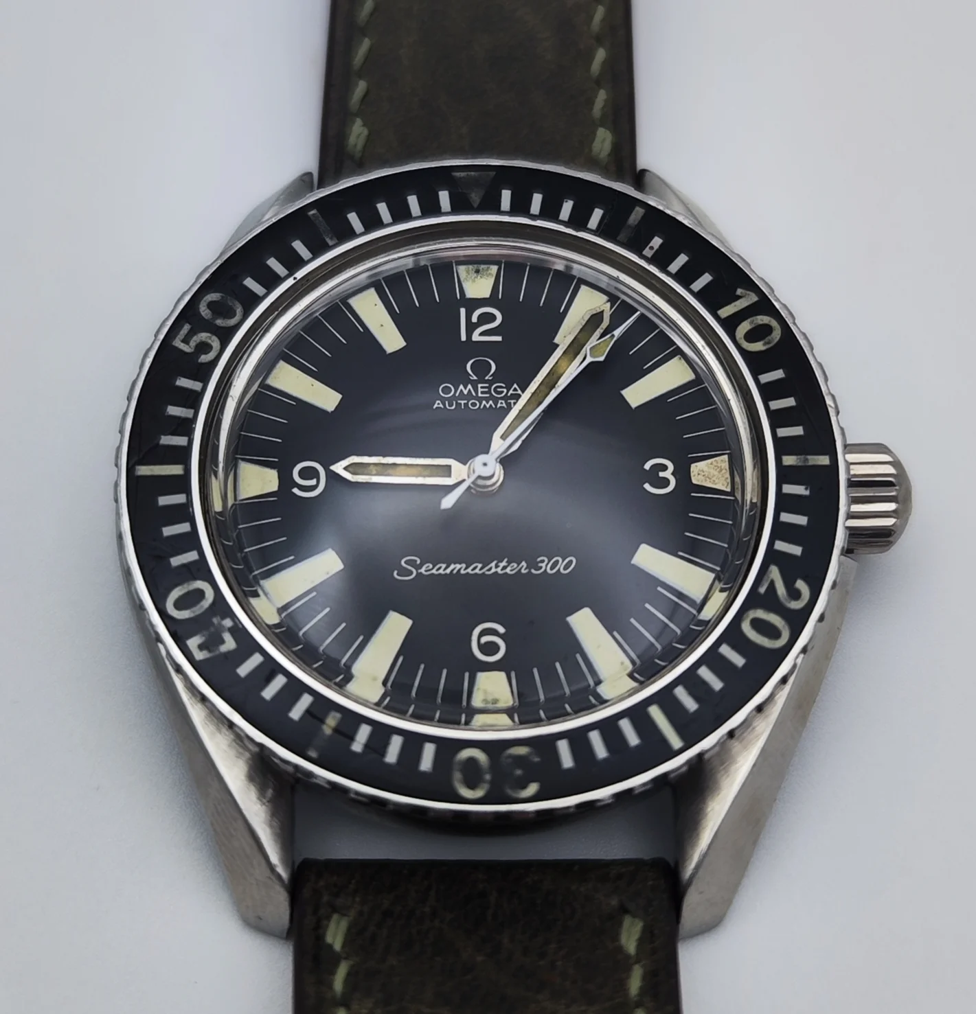

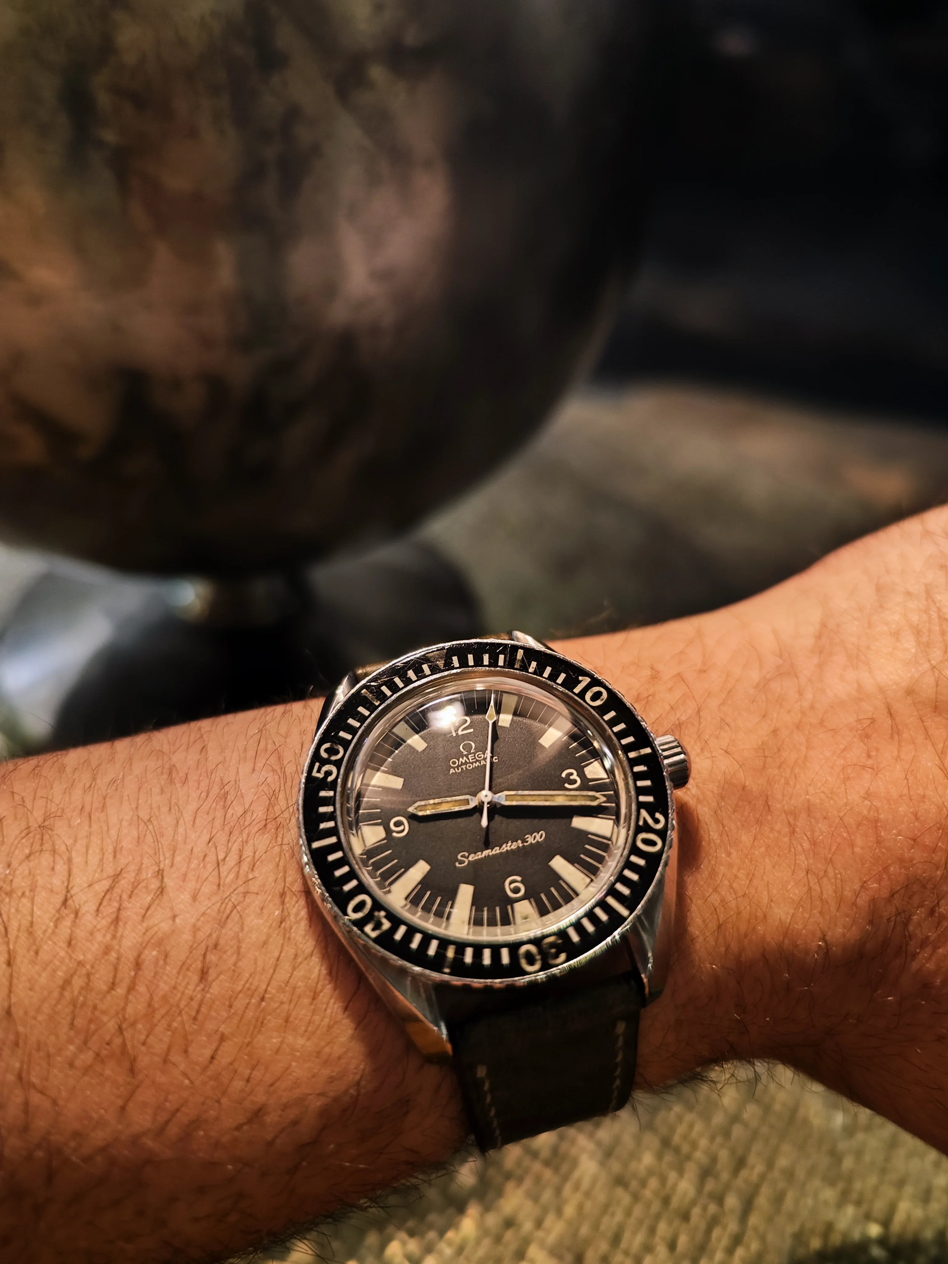

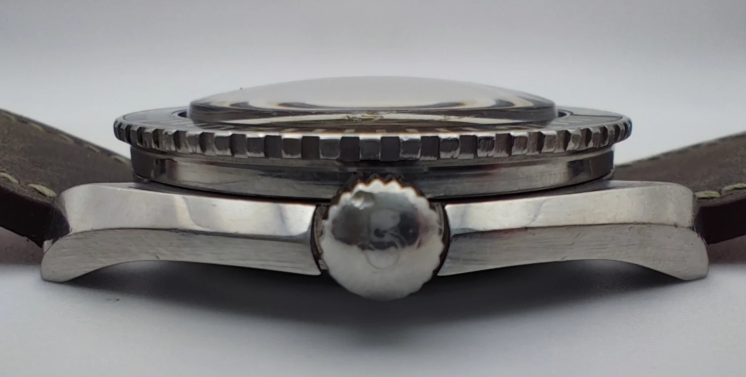

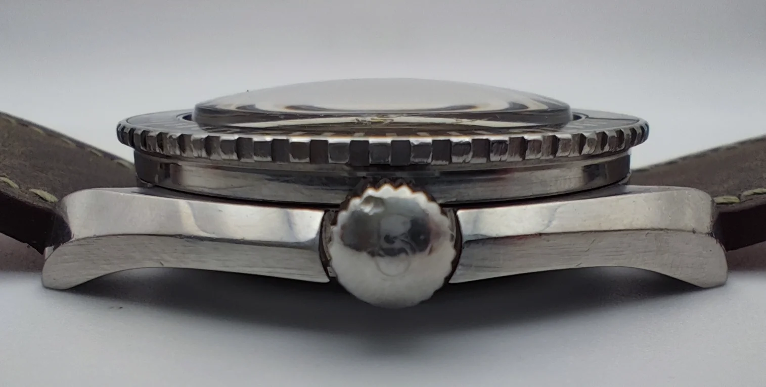

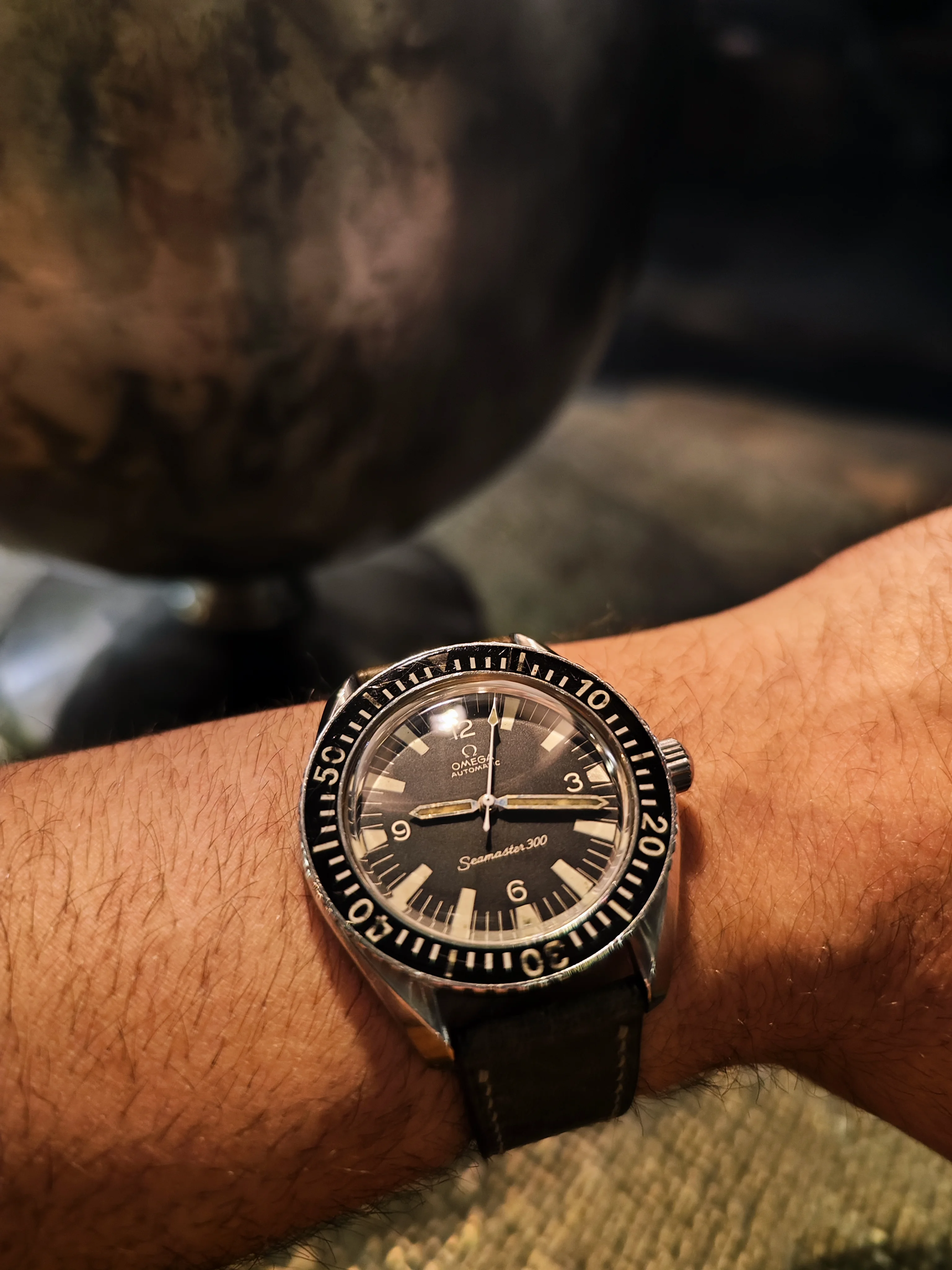

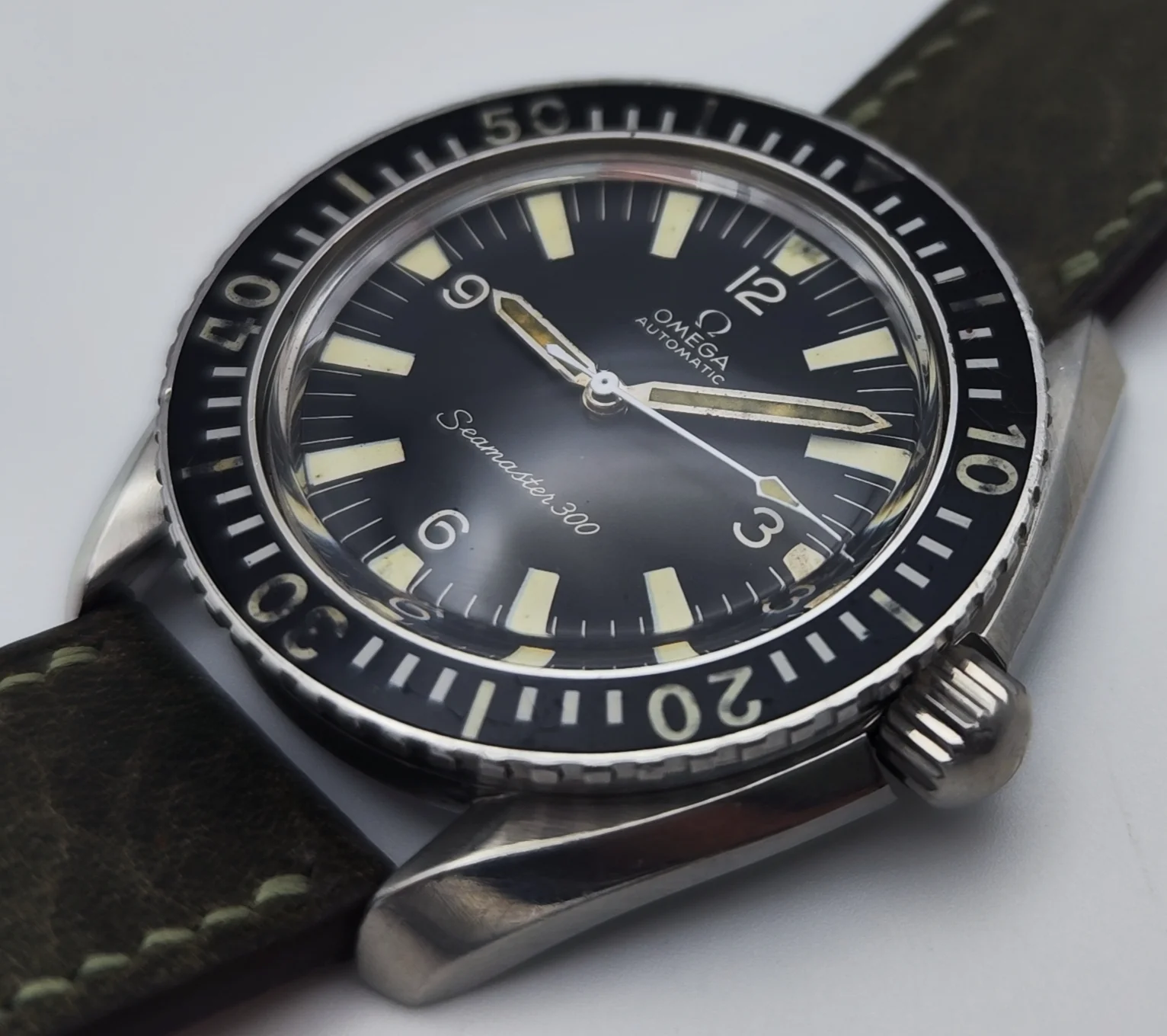

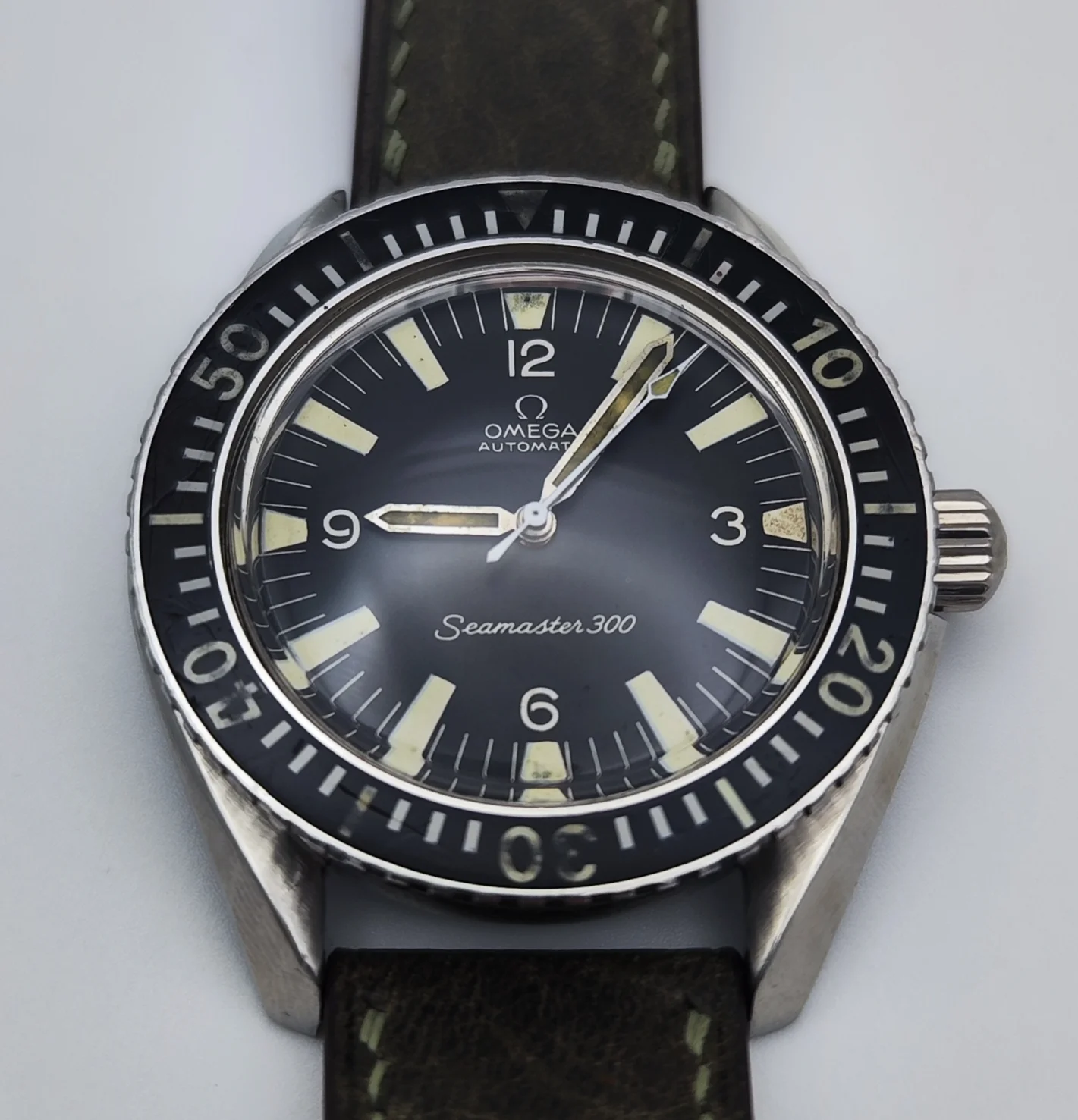

I couldn't help but pull the watch head apart again tonight. Then spent an hour going through 800, 1,000, 1,200 and finally 1,200 wet. Finished with Polywatch. Managed to get all the deep scratches out and finish on a nice sharp edge. Then just finished it with a micro bevel.
Can't believe how good a result I got and certainly no more need for a new plexi.
Some better pics:-

Nice looking watch, you did a fabulous job of cleaning it up. 👍🏻

Thanks! Well clearly the dial and perhaps the case are '67' ish onwards and the movement bridge isn't. I suppose that's all we can say.....

This is a parts watch. Serial is way to early for 165.024, CB casesback is late, Sd crown came also at very end of production... bezel off, hard to date the watch... would stay away, util you fell in love and desparete....
