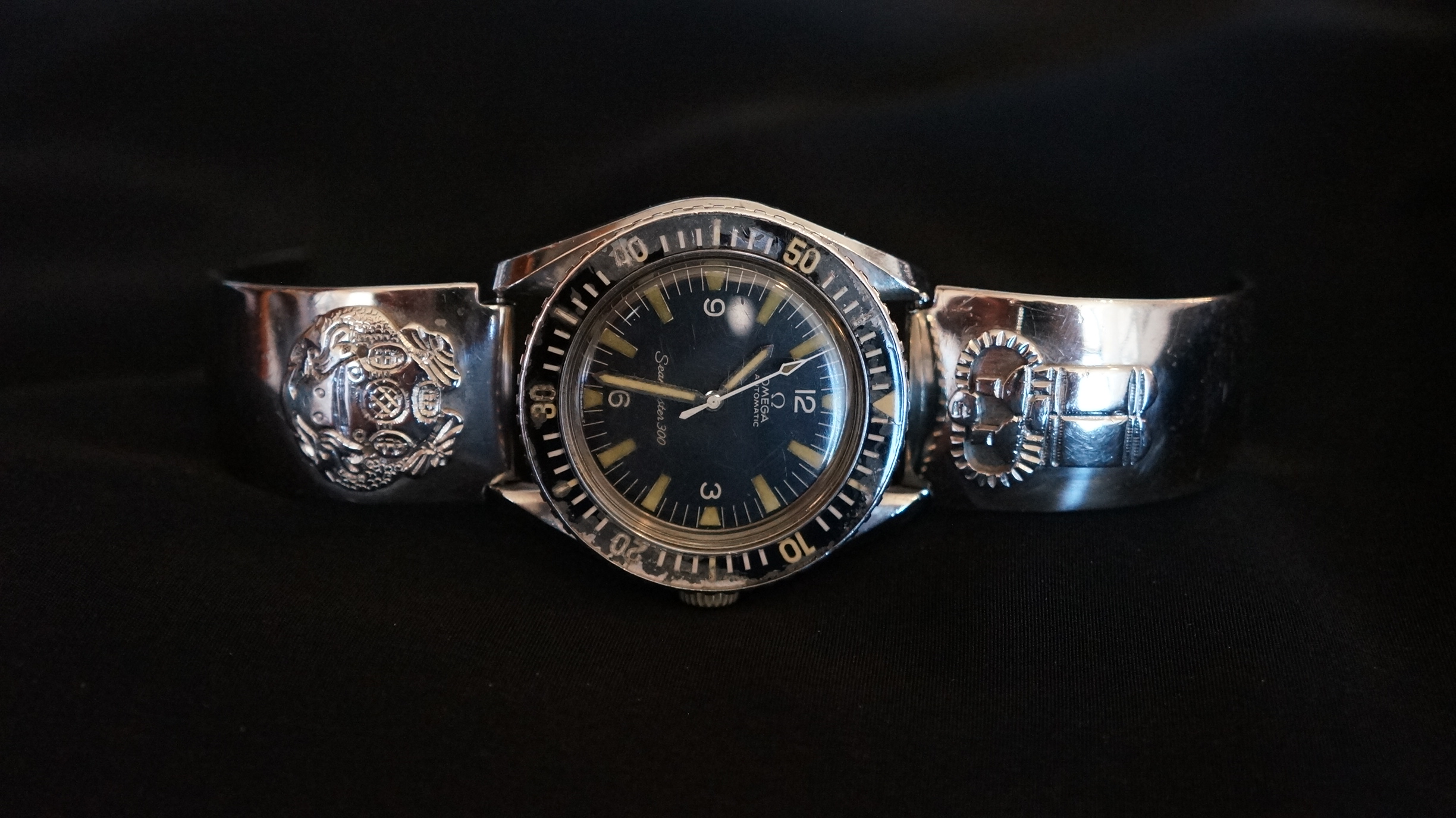

Omega seamaster 300 - fake or not?

Serial number puts it in a 1966/67 production range, so that fits perfectly to the bezel... but the dial from that period should rather be a trapezoid style, not a big triangle So both, dial and hands were maybe changed during a service. At least to original parts. So still a nice found.

Sounds like it passes muster. I’d keep it as a family heirloom and get an appraisal for insurance purposes. A watchmaker could give you a good idea of the value.
I’d have the independent watchmaker service the movement and clean it, but not polish it nor replace hands/dial/bezel.

other dial and hands, circa 1/67 per extract.
