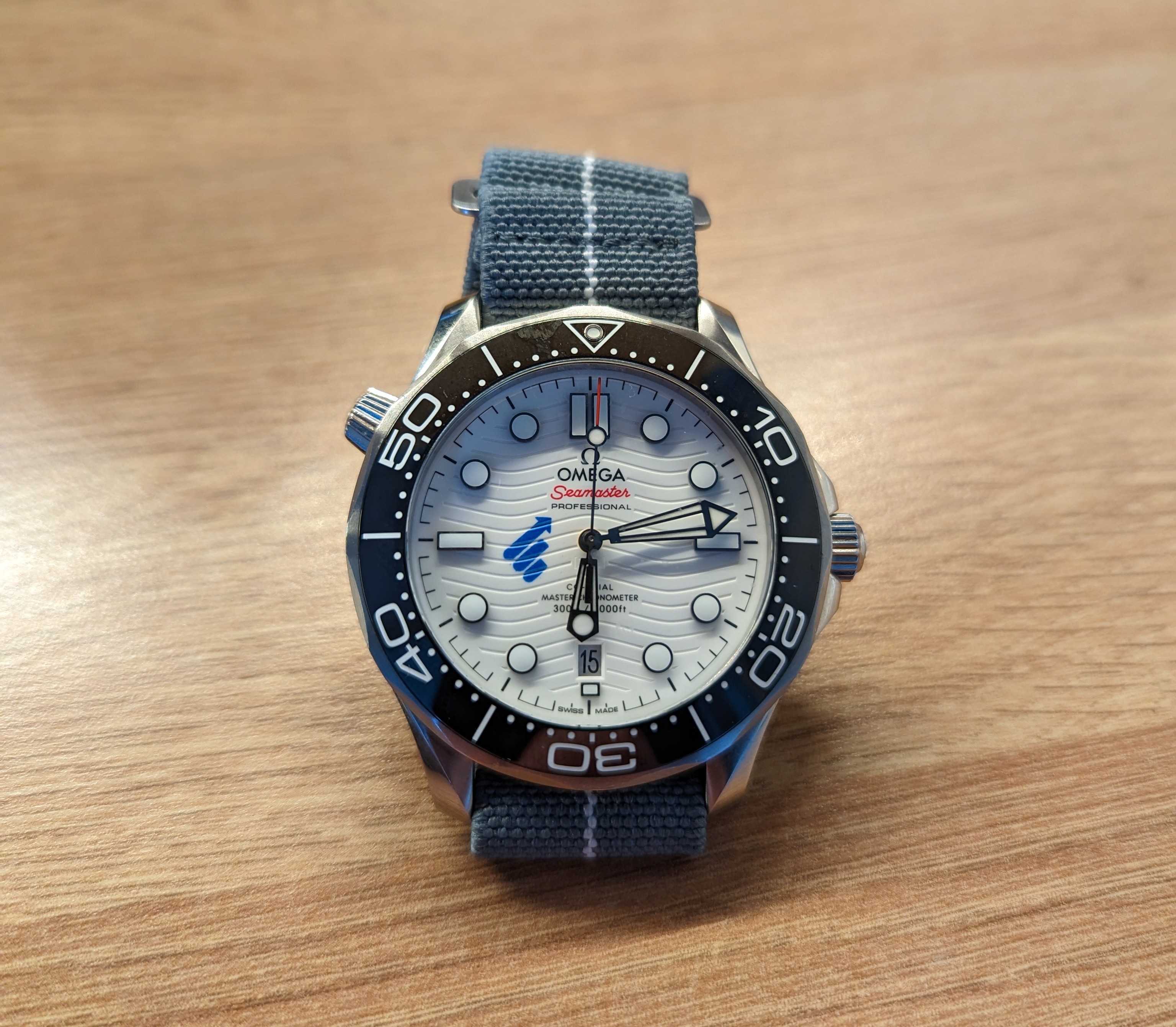

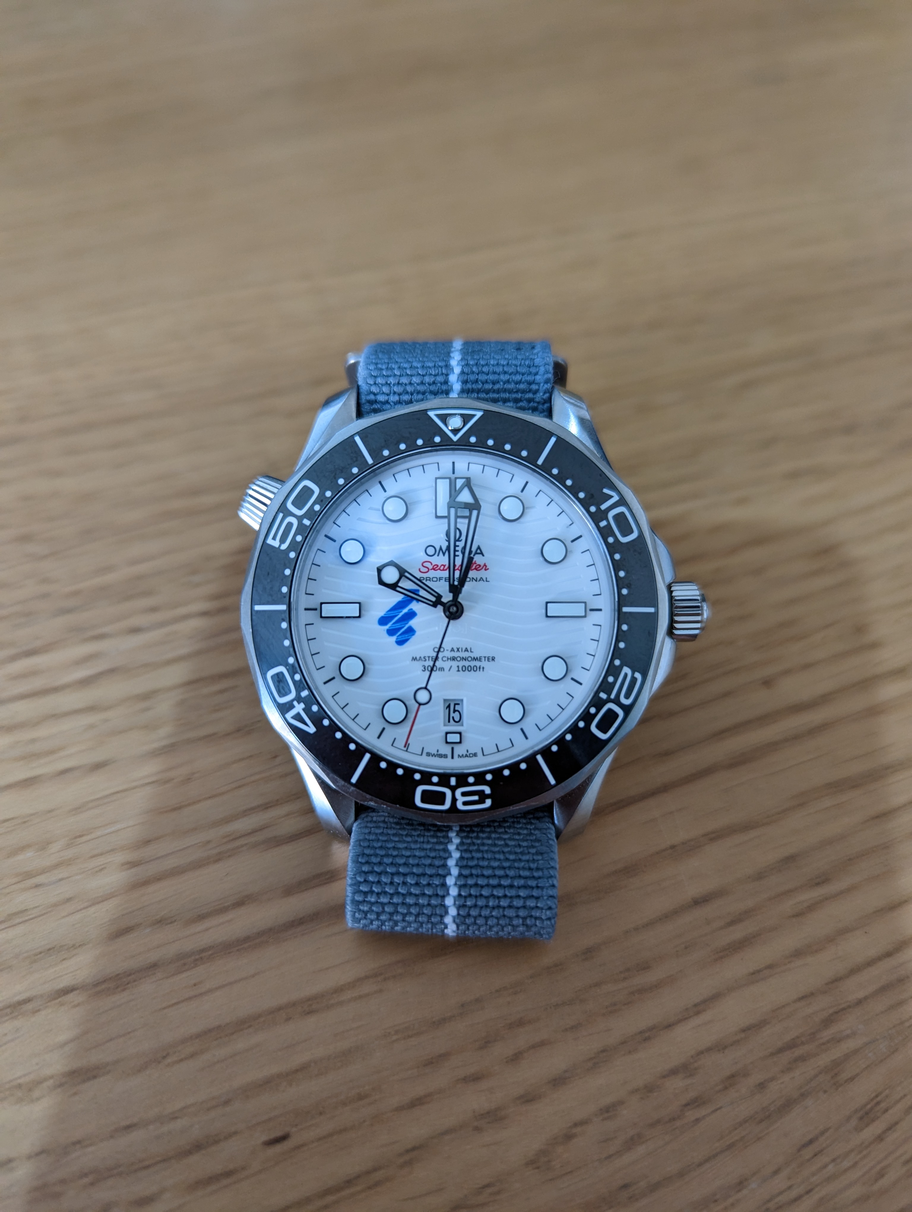

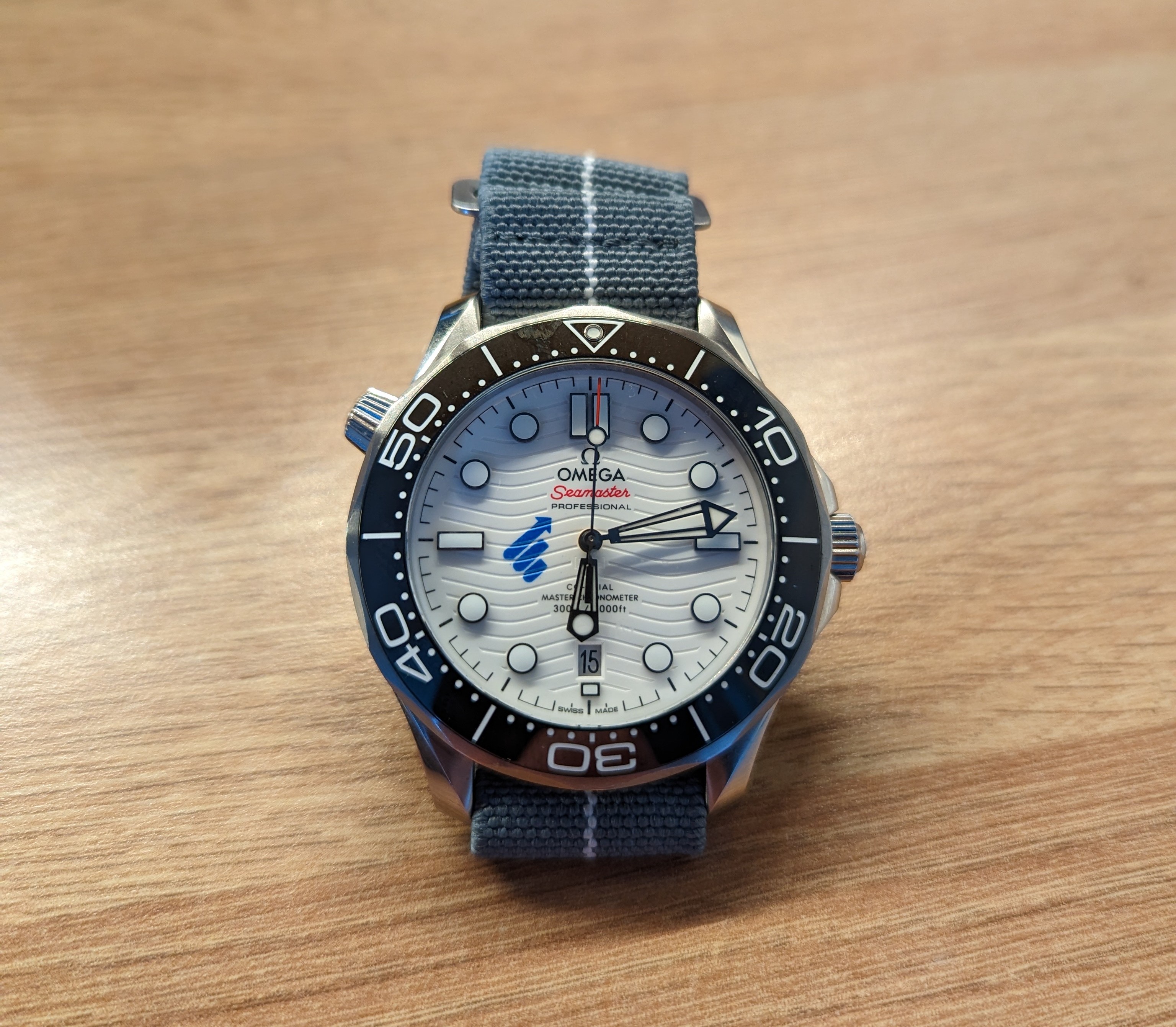

Can you post a picture of the dial but not with the second hand at 12?

Can you post a shot of the dial (just like above) when the second hand is stopped?

I will do...it's currently moving, so I'll have to wait for it to stop again. It might be some time (typical!), but as soon as it has stopped, I'll post the photo. Thanks for the help so far!

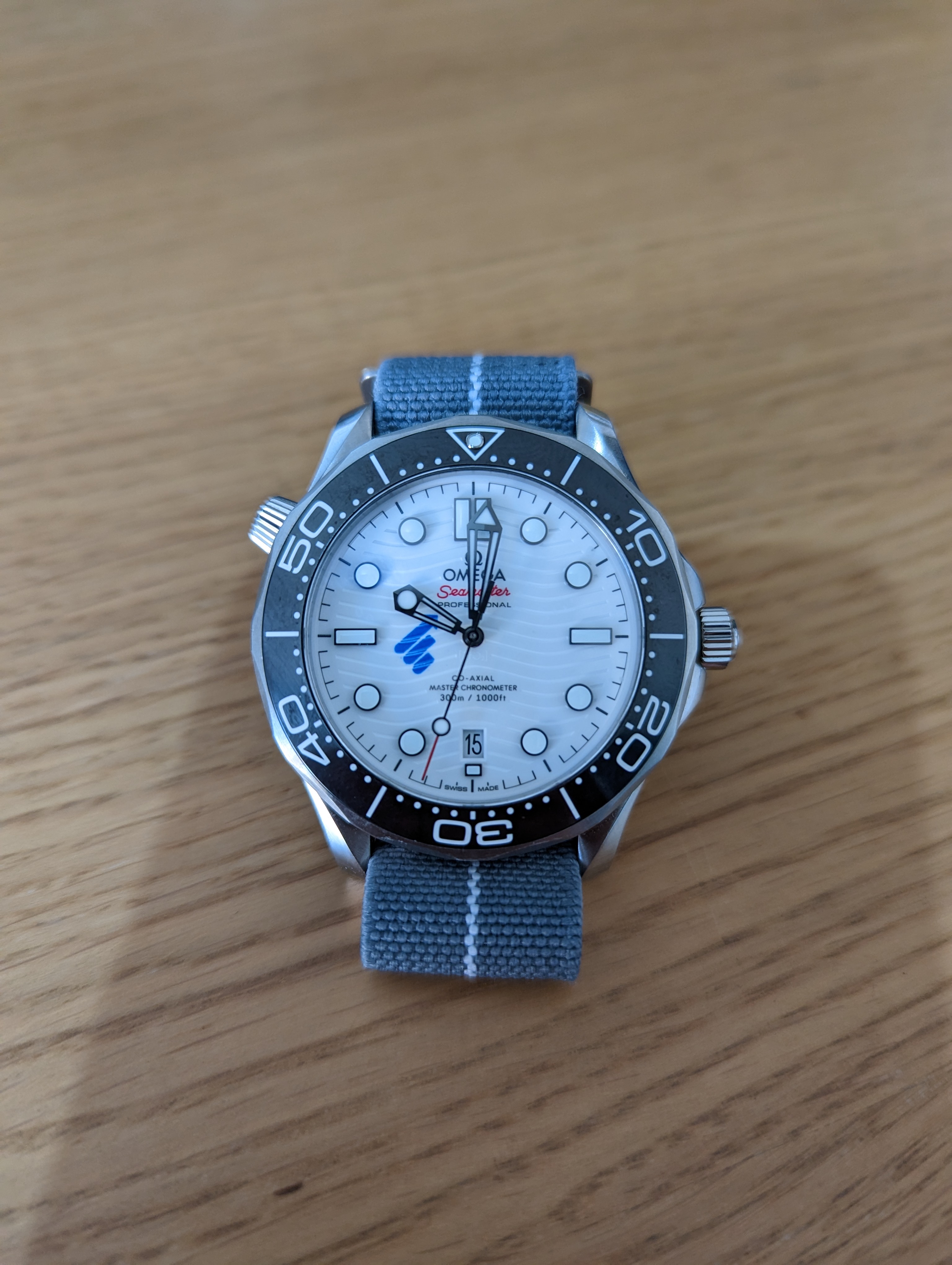

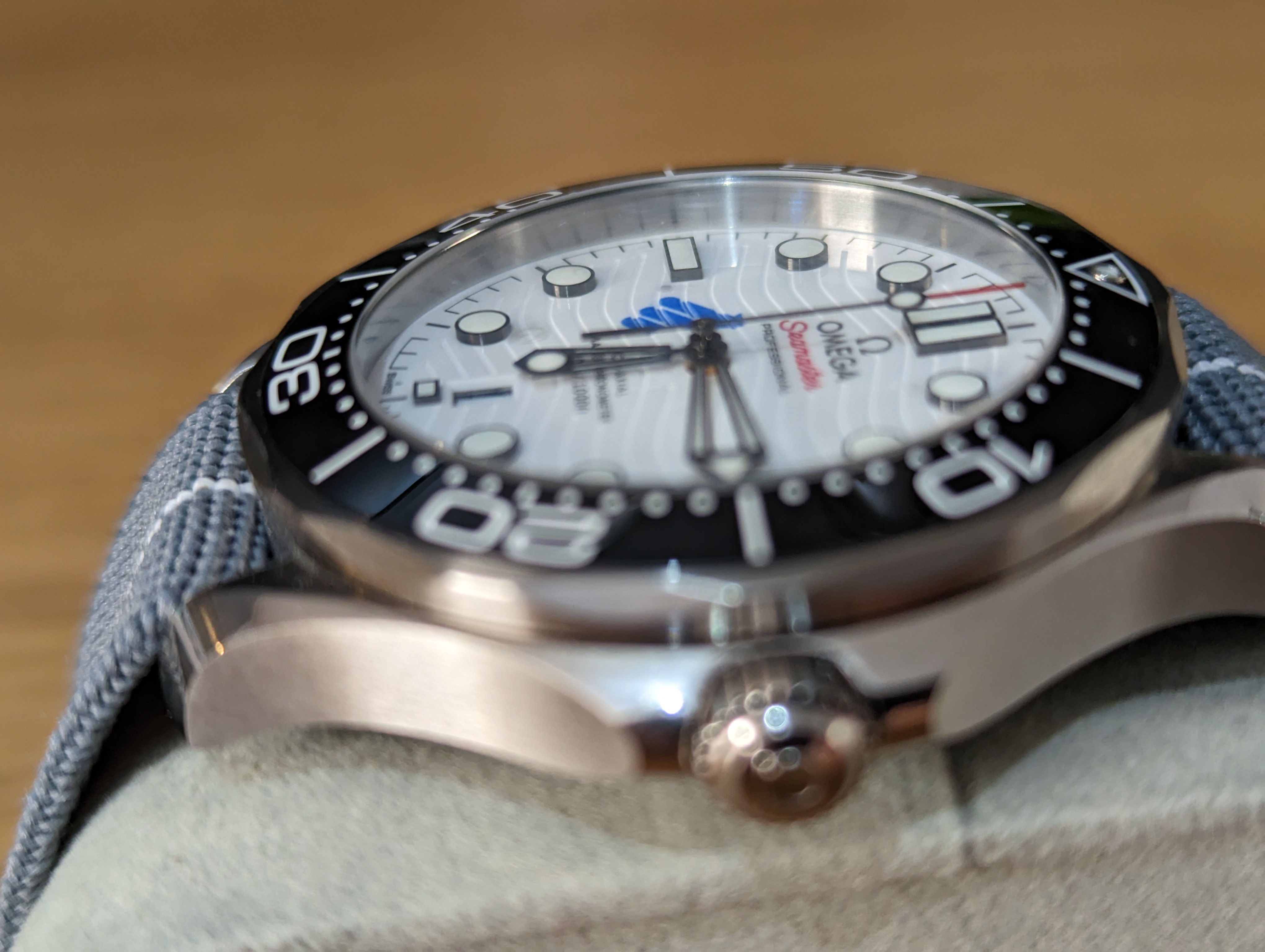

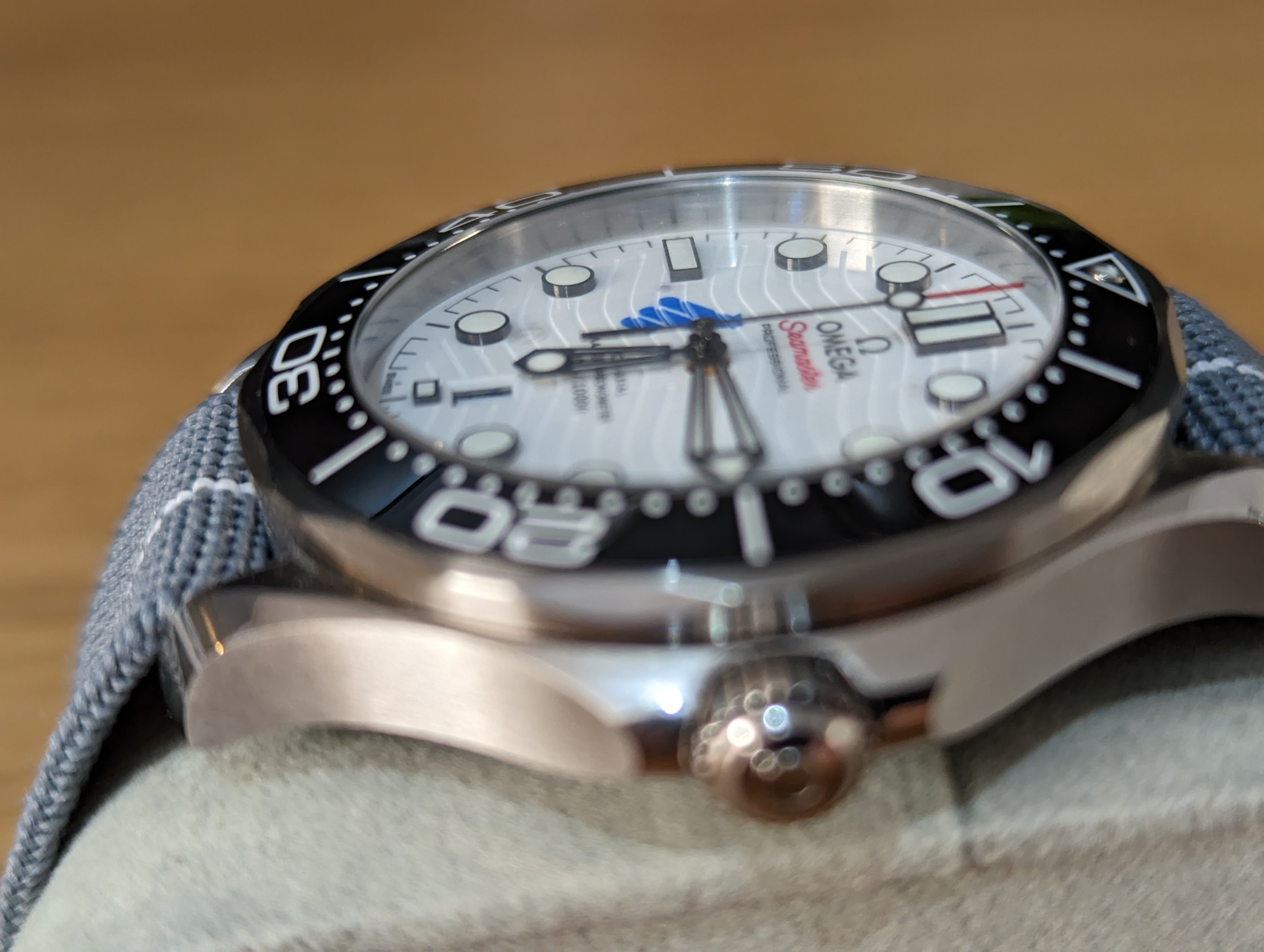

Here you go
1,957
5,922
Perhaps the second hand rubbing against the hour hand... when it stops where is the hour hand typically?

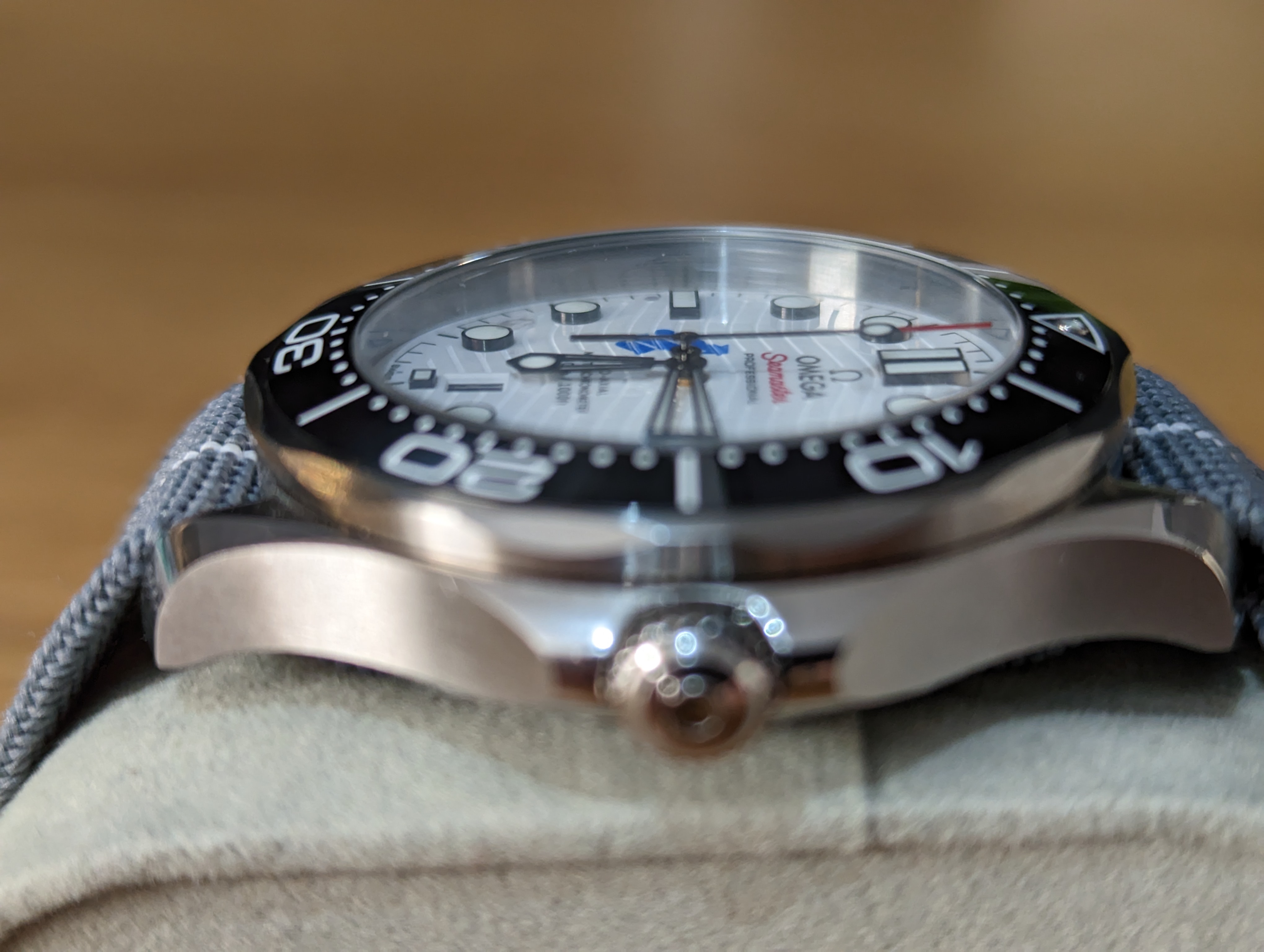

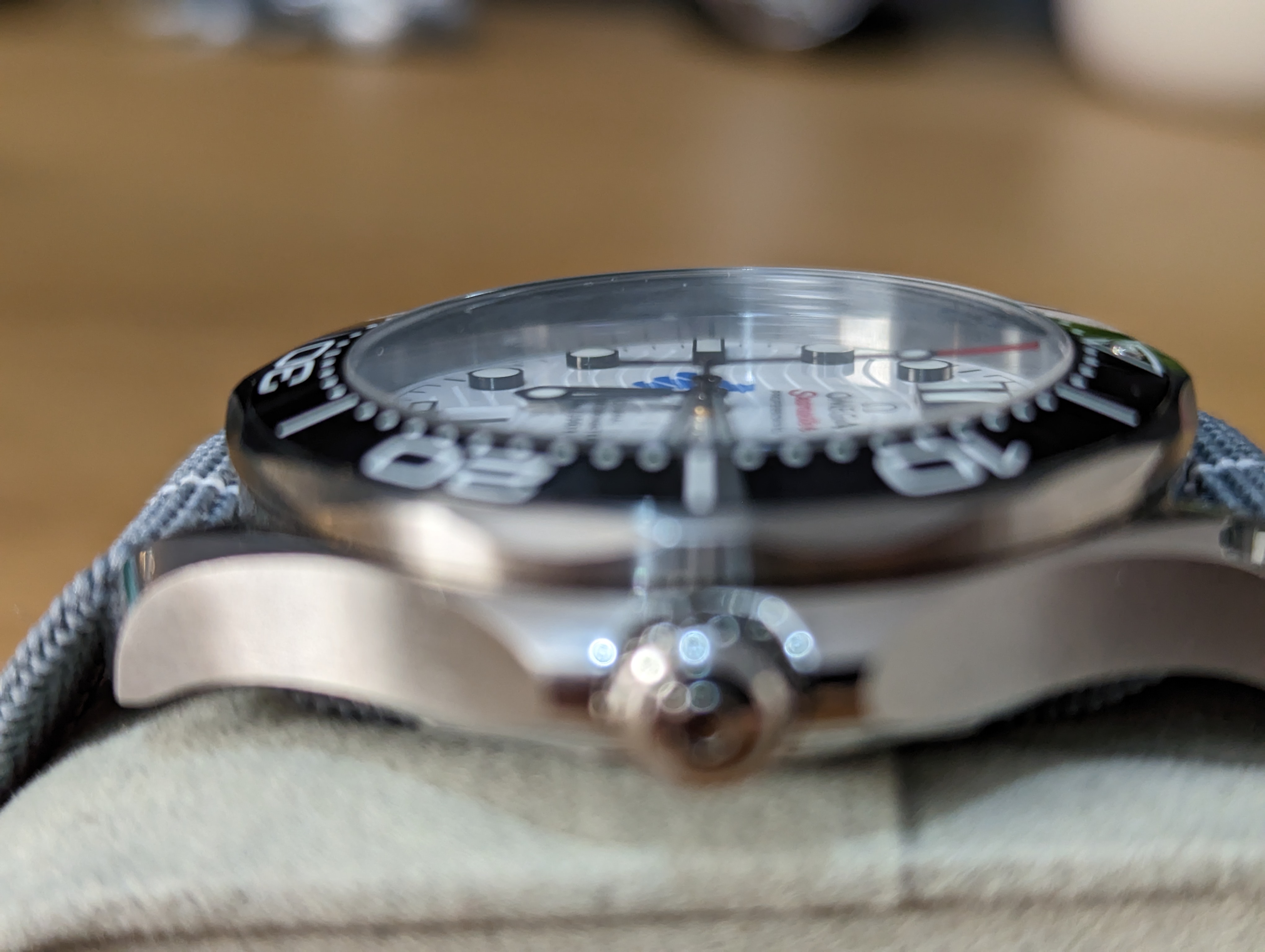

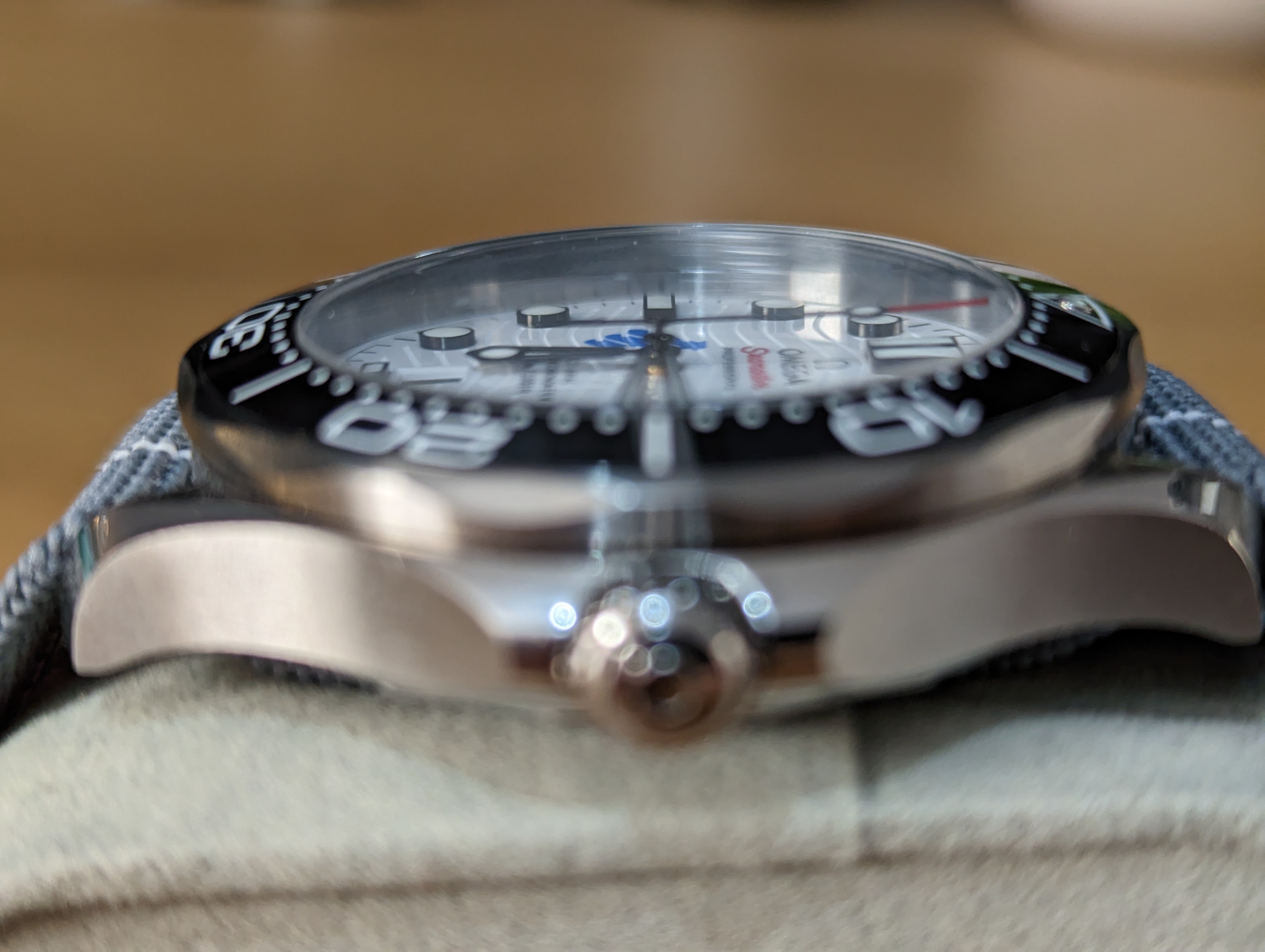

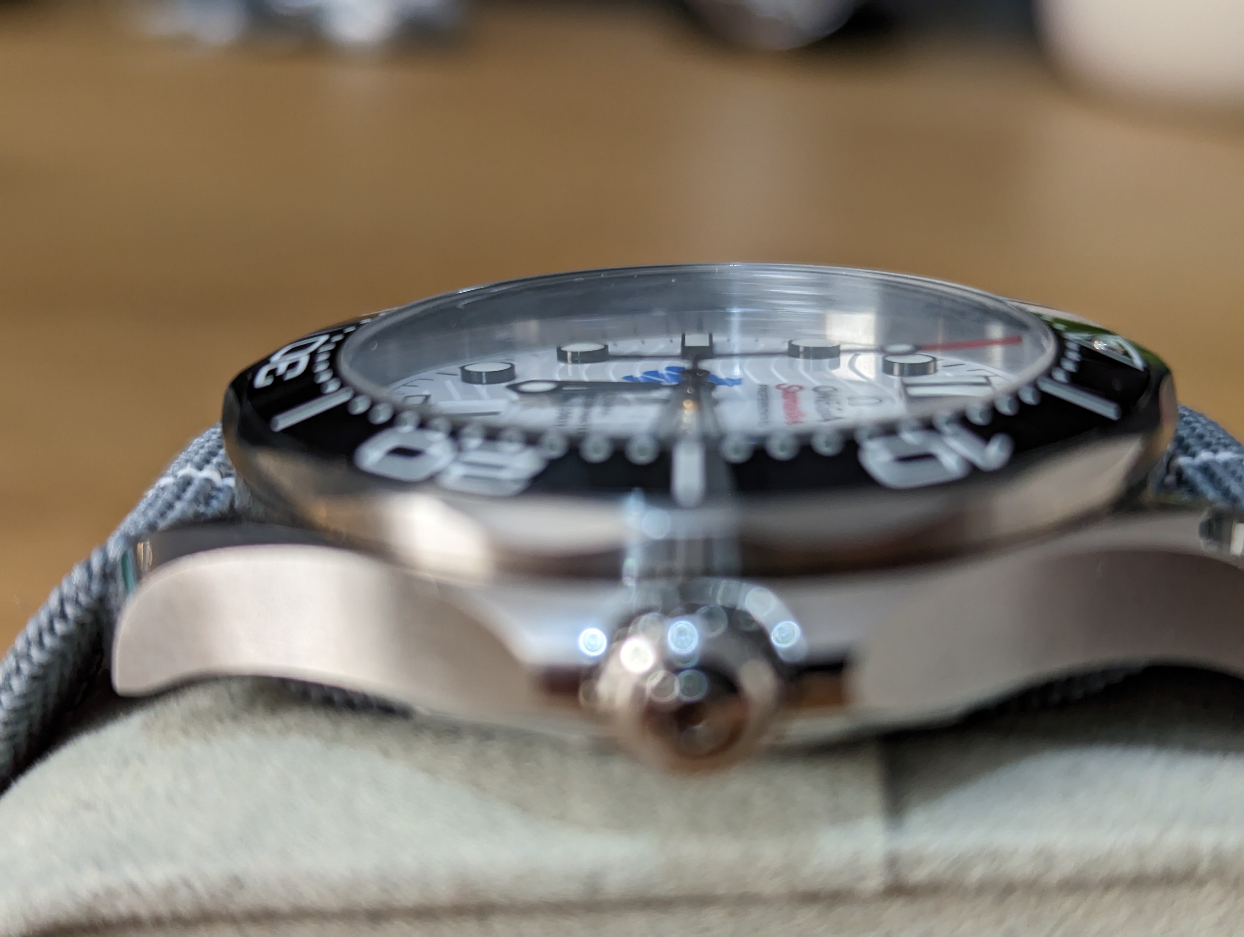

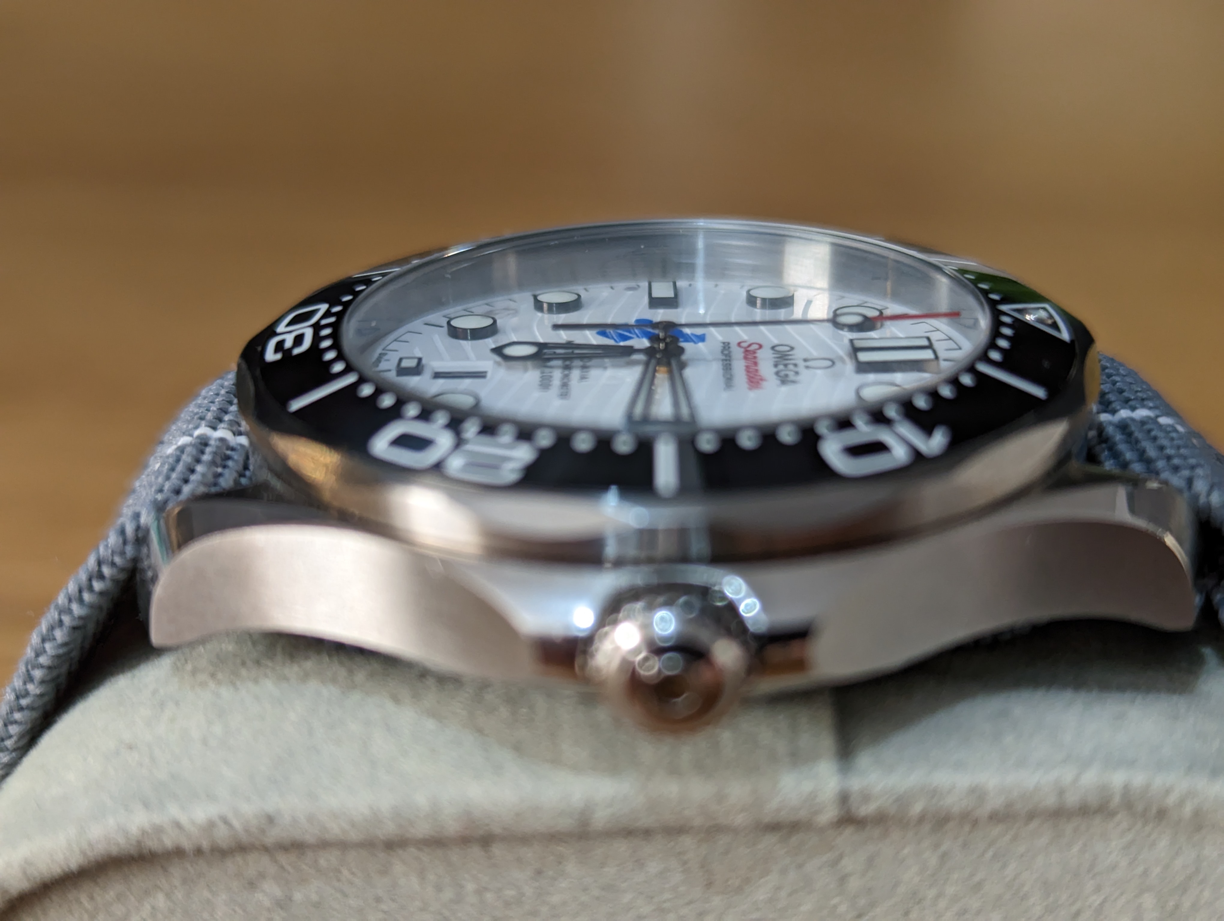

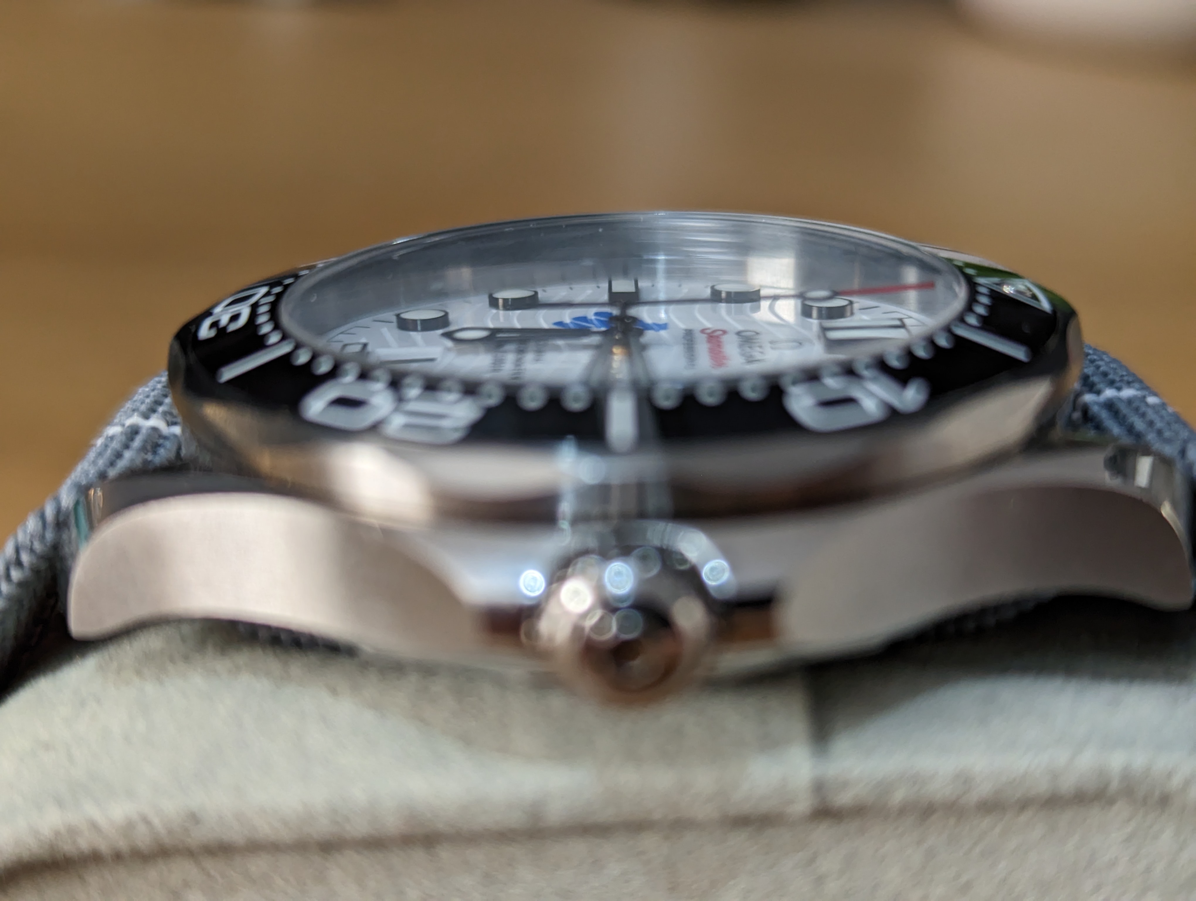

My money is on the second hand very slightly rubbing against the bottom side of the crystal. Can you get a good shot from the side and see?
There's no real rhyme or reason to it. The hour hand could be anywhere, really

The seconds hand tip does look like it has an upward curve to it. It’s plausible the hand is touching the underside of the crystal; however, the crystal looks evenly pressed, so if the hand is touching the crystal, I would imagine it’s dragging along the entire circumference of it. For the hand to habitually stop in that location there is a reason, but I’m not confident the crystal is why.
