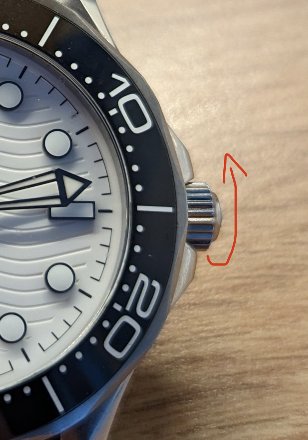

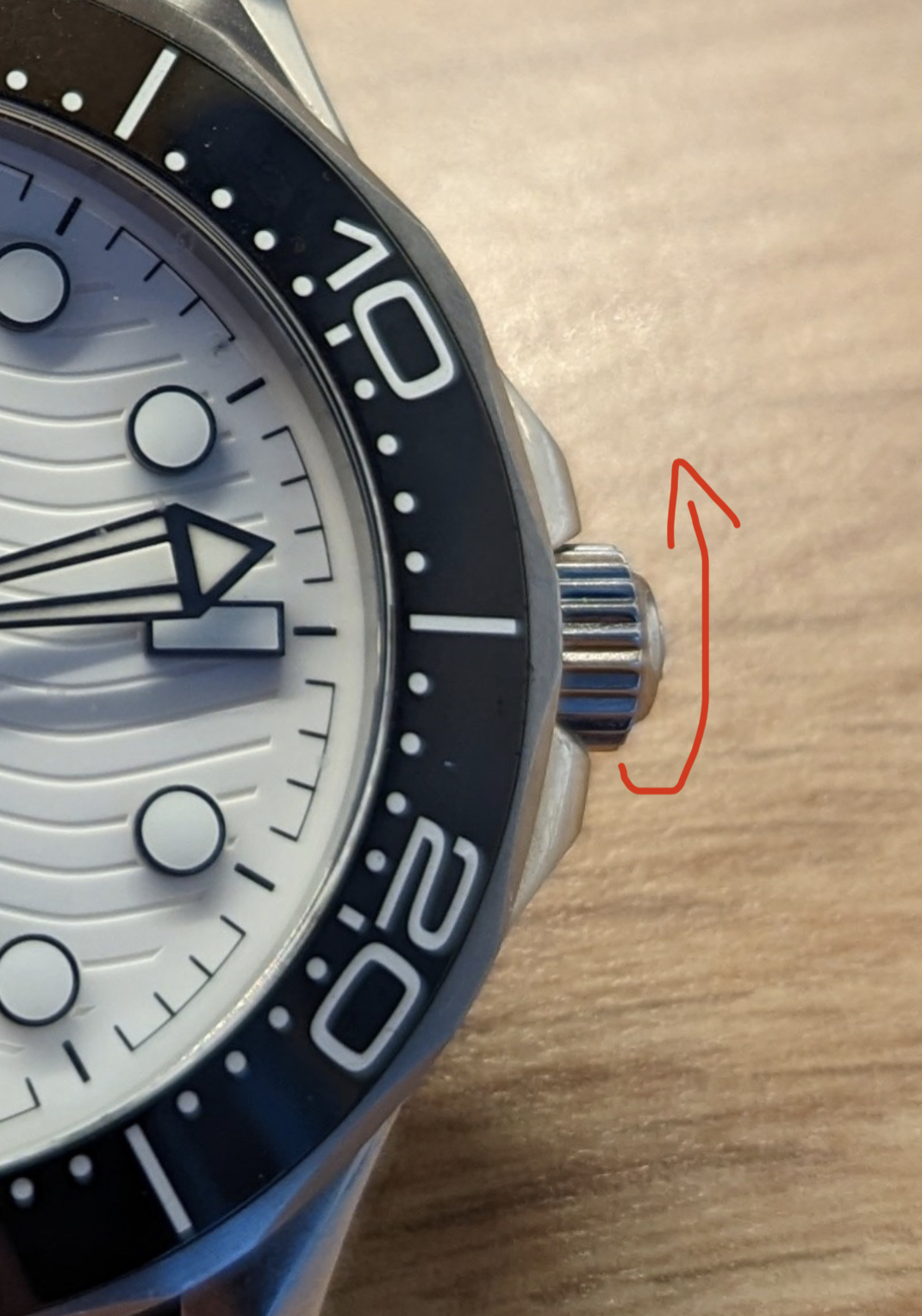

When you unscrew the crown completely, it should naturally be in the position for winding. Position one would be for time setting and position two for date change.
With the crown unscrewed, you wind it this way
You don’t need to fully wind it with the crown. A handful of winds is enough to get it going and then once on the wrist, the automatic rotor will help you from there and keep it topped up. We can’t say for certain what could cause these issues, but they can be addressed by Omega. The dial modification would have voided the warranty, so any repair would be out of pocket. As mentioned earlier, you can always bring this to the attention of the employer to see if they will help.
