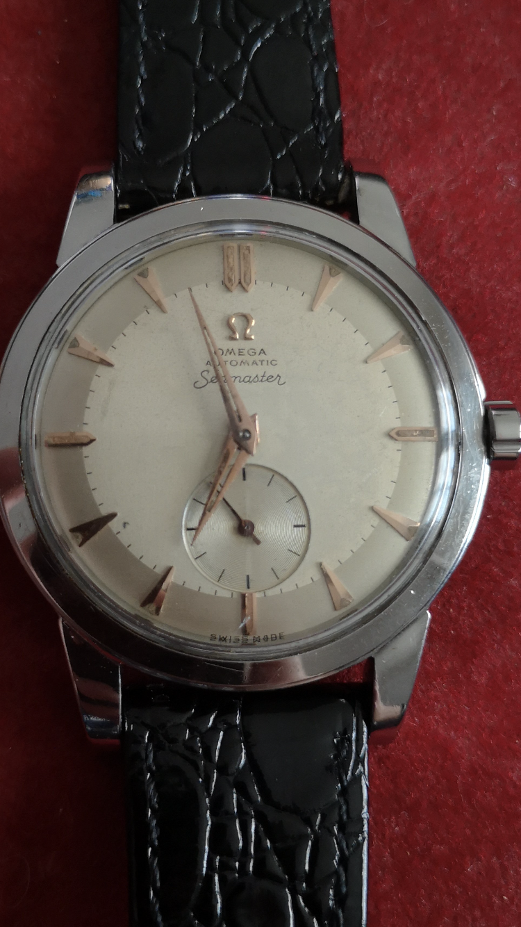

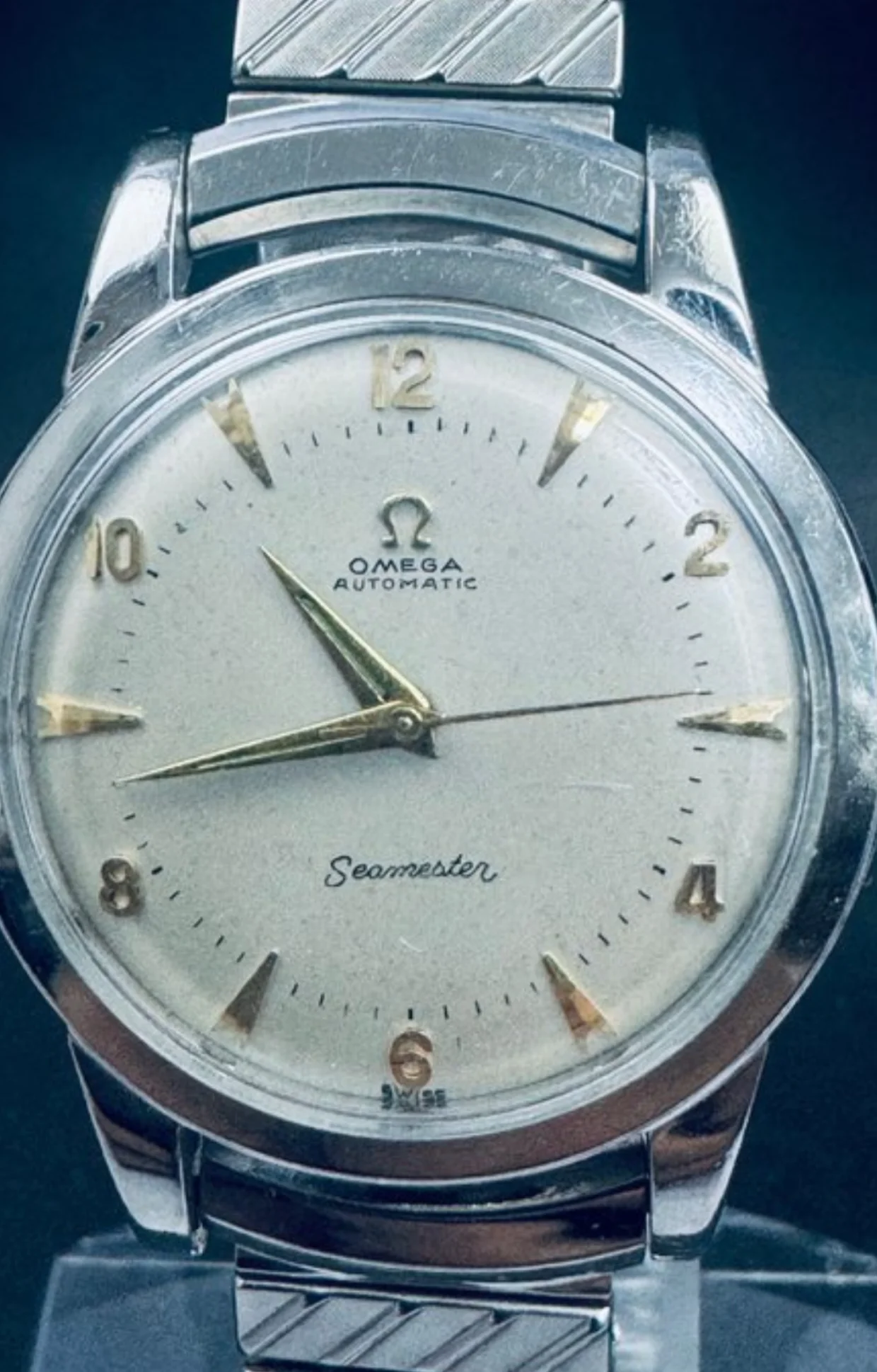

Hi all,
I’m about to buy a seamaster 2657-4.
I don’t think it will be a keeper but am curious to try a bumper for some days 😀
I did not find another model of this ref with the same dial.
Does anyone have it? I would be happy to compare with another one 😀

There were many, many dial variants for these 50s Seamasters. Finding another of the exact one isn’t easy, especially with rose gold markers.

I have a doubt about the word “seamaster”, because there is a space between the “s” and “ter”, that is why I’m trying to get picture of same models 😀

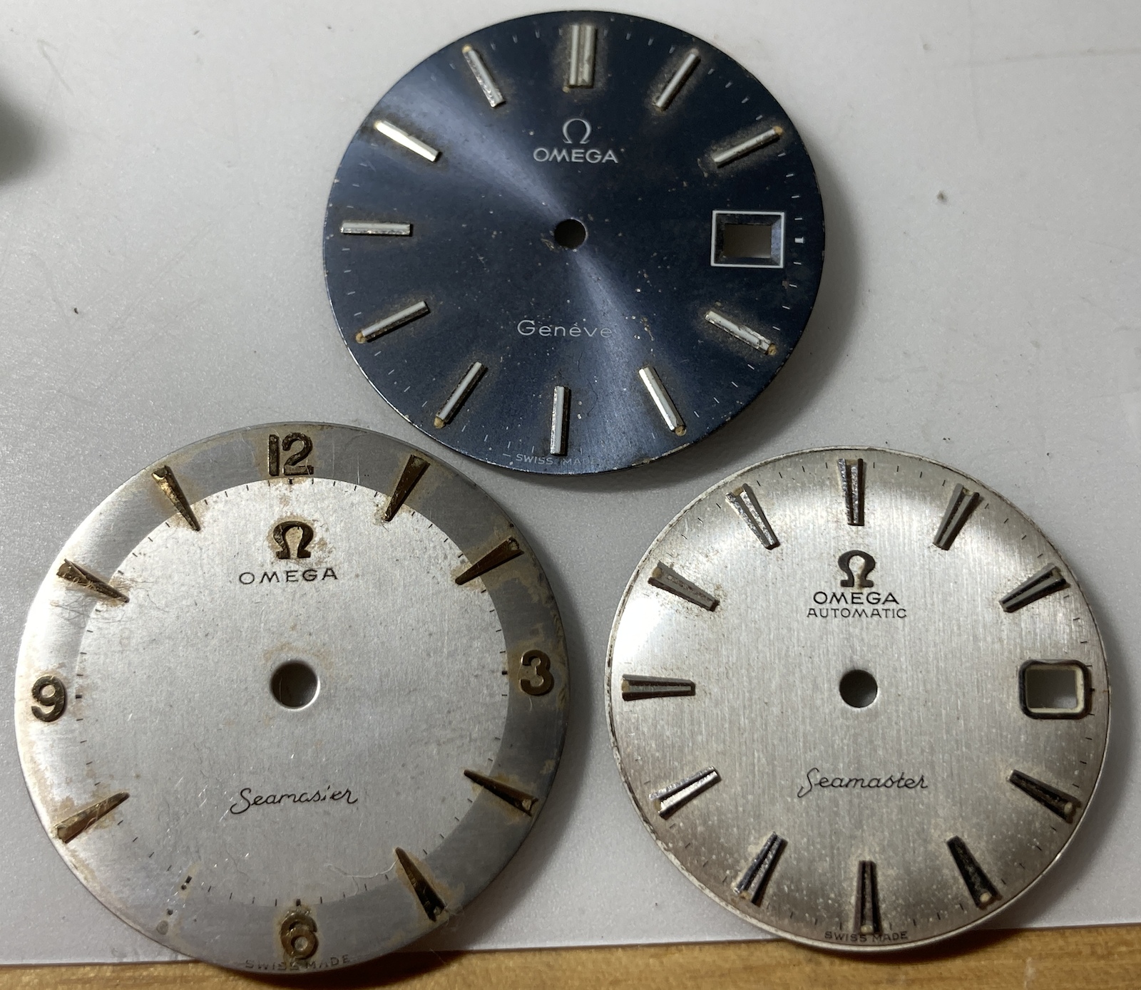

It looks real to me. Here are two Seamaster dials to compare the font:

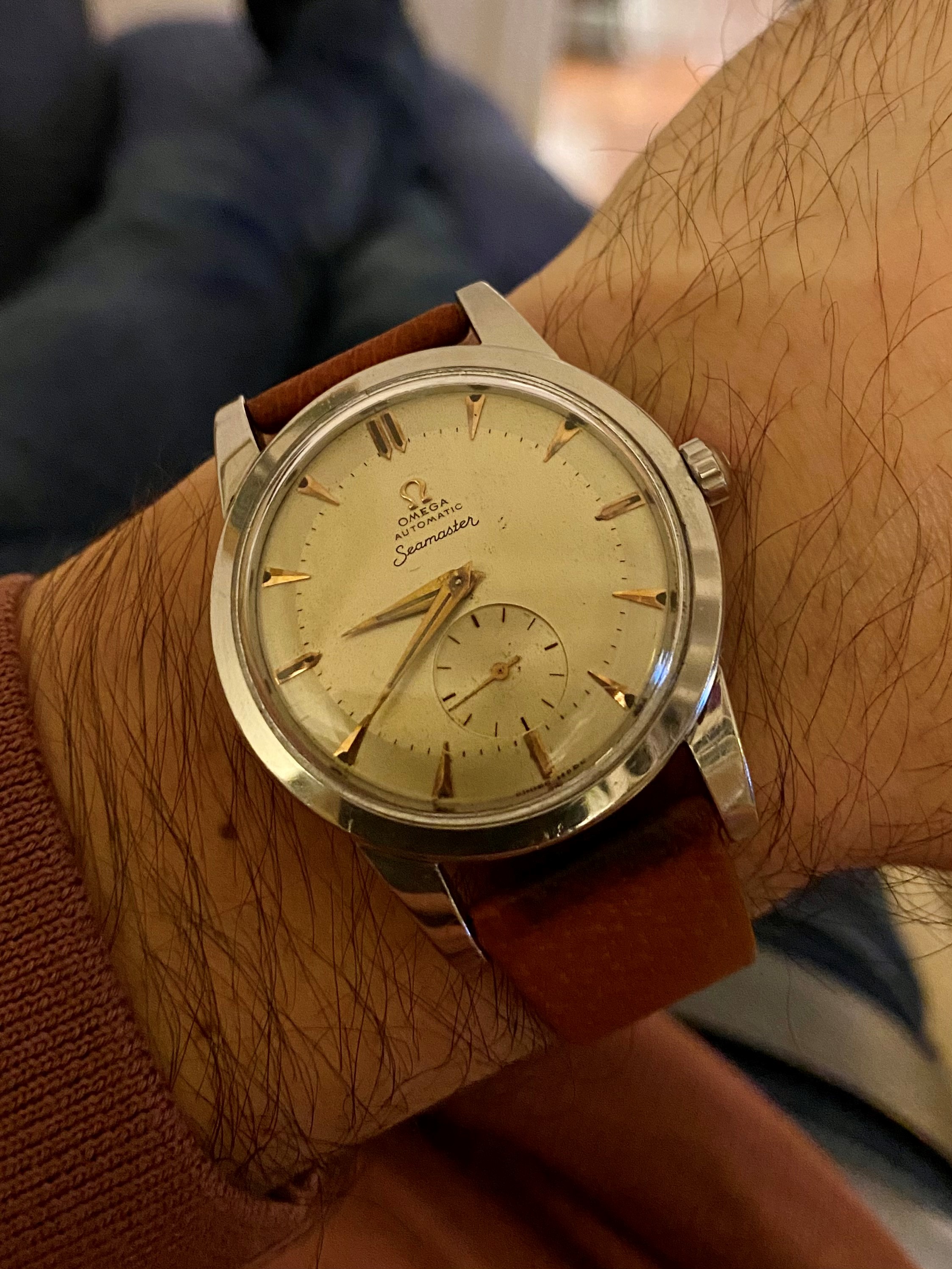

I got this one back from restoration from Omega. I just need to pick it up at the Boutique.

The dial is original, in nice condition, and an uncommon variant with the rose gold markers. Not sure exactly what you need, as both @ConElPueblo and I, who know these watches very well, have already weighed in on the legitimacy of the watch:

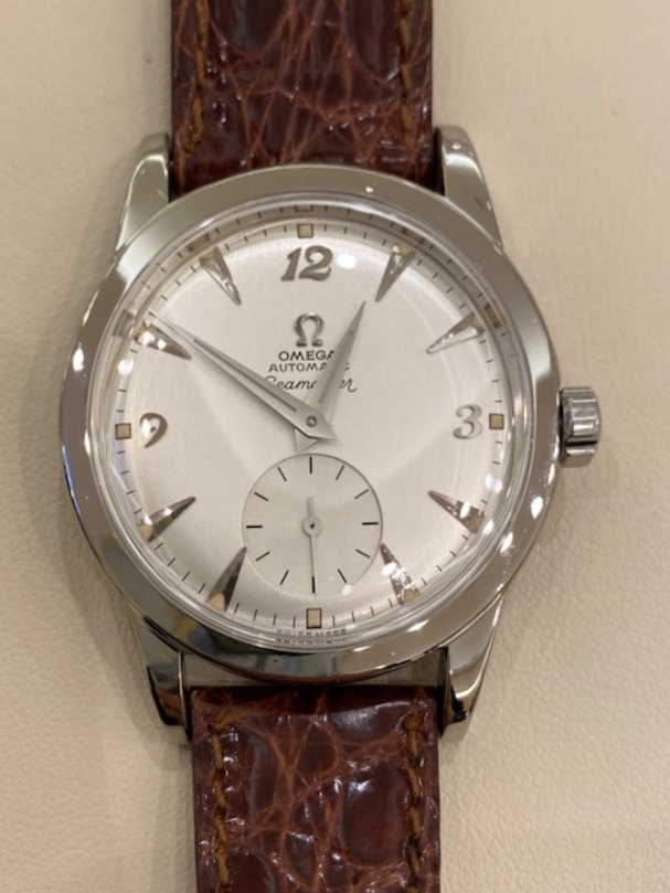

I do have the same watch, ref 2657-3 / 2494 in mint condition

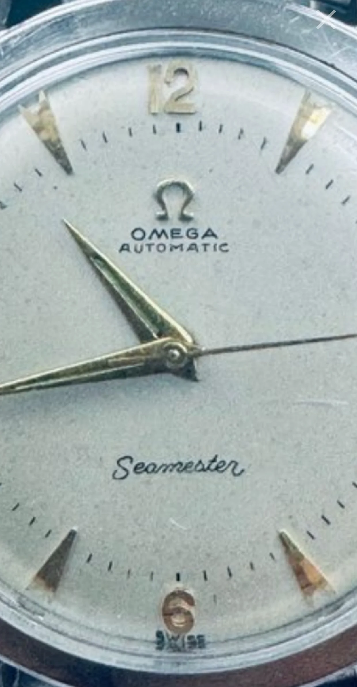

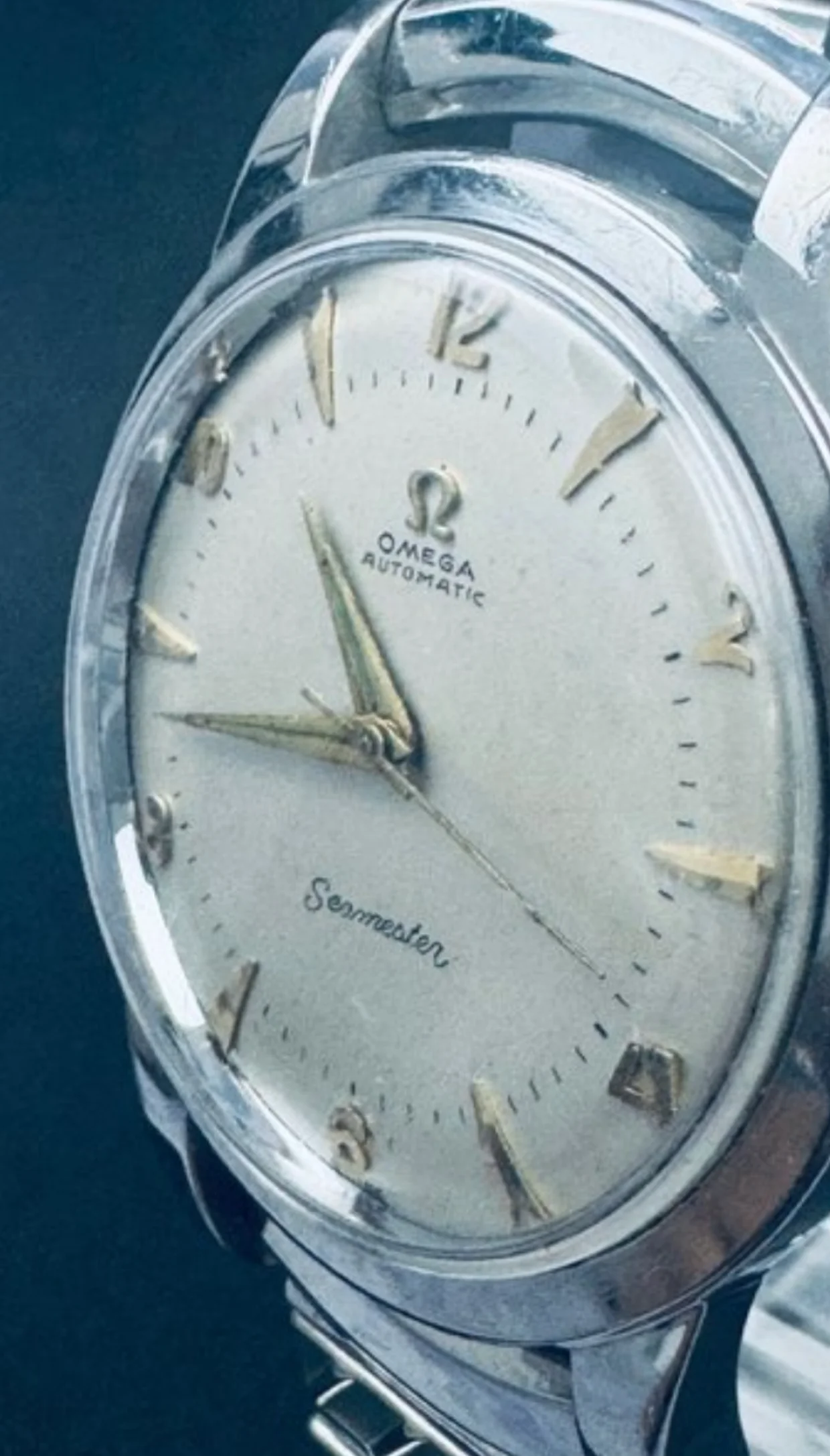

Anyone knows what's up with this dial? shitty restoration job? or just how they varied in the 50's?
I literally read "Seamester"
2657-4SC, 1952
Omega Seamaster Bumper, calibre 354
96
156
It does say "Seamester", which is kinda hilarious, but also just one of the red flags on that dial. Variance does not account for that😀
