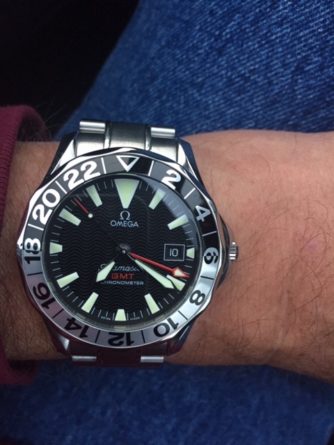

Hello everyone!
Sorry to dig this up. I am relatively new into watches and looking for an everyday and travelling watch. Recently came across this piece on the pre-loved market (ref 2234.50). Loved the black/silver bezel so I went to do some research on this and came across this issue in the 1128 movement.
I would like to ask if this issue affects all 2234.50 watches, or only a handful? can it be totally repiared by omega service centre, or it will always come back every few years?
It seems there are quite a number of reports of this, yet some owners seems to have owned the watch for years and never happened. Based on what I understand, this seems like a parts design issue and should affect all, but I ain't sure.
This will be my first Omega and it is a pretty exciting experience.
If this can't be resolved totally, are there any Omegas with GMT/worldtime alternatives that I can consider, in the similar price range in the used market?
Thanks in advance to all the experts here!

It appears the problem was in the earlier models, I'm guessing the 60XXXXXX series serial numbers. Production ended ca. 2007/8 timeframe with 815XXXXX serial numbers.

There are two different issues in this thread. One is the failure of the hour wheel, and when this happens the hour wheel doesn't have the one hour clicks anymore when you set it. It can also result in the hour hand not moving at all when the date change begins, and that looks like this:
This problem results in the hour hand stopping and the watch not being functional, so it's more obvious and common. It's a failure of a part from wear.
The second problem is very different, and honestly I've never seen the one that is listed in that bulletin. It is a design issue that only affects very early versions of the movement. In that scenario, the watch will loose time at random, and it won't be as obvious as the situation with the hour wheel failure.
Cheers, Al

Eventually, yes the part will wear out. When the watch is just running normally, there is no wear on this part, so the wear only happens when you pull the crown to the second position, and use the jump hour feature. How fast this happens depends on how much you use the jump hour feature.
Note that you can move the jump hour forwards or backwards, so if you need to change the sate take the shortest possible path - forwards or backwards - to minimize the amount you have to use the jump hour.
Generally speaking, this part fails if someone is using this feature a lot, or they have not had the watch serviced in a normal service interval.
3
Thanks for your detailed explanation Archer!
I guess I will give this watch a miss. It's a shame, such a nice bezel.
