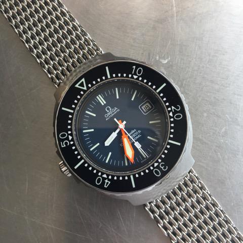

Well it’s worth more with the original hands and crown..the crystal is irrelevant so unless you have an objection, restoring it to full authenticity is the best course of action to maintain its value
There are 4 different hands sets so if you have a chance it would be helpful to have a photo of them and also when the case is opened to return it to left crown assembly it would be nice to get a photo of the serial and movement numbers it should be a 1012 caliber with about an 38 million serial number

The dial is original but the hands are decayed
Did they swap the dial at some point

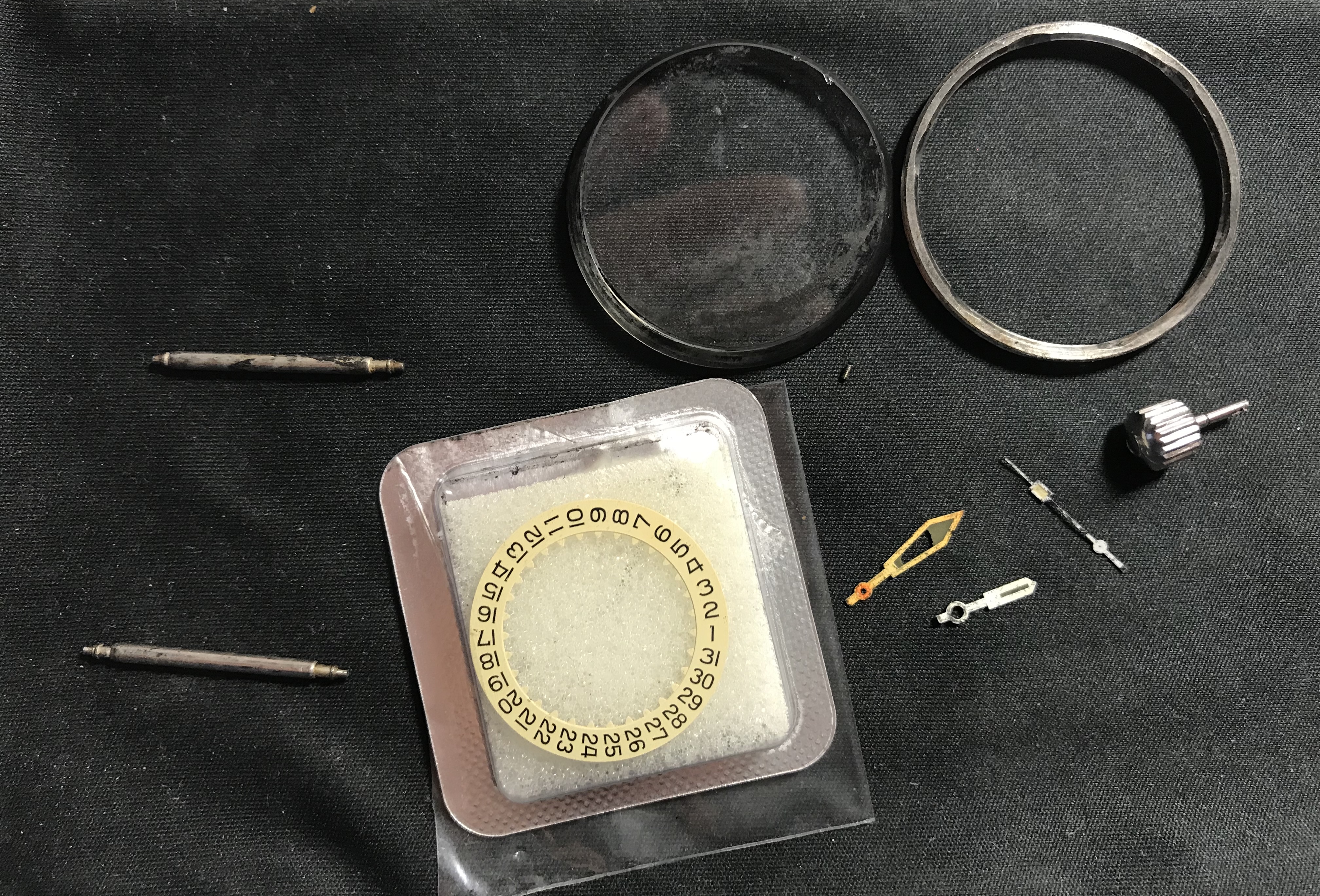

what is in this picture is what they have changed after the fisrt service that they changed the side of the crown and damage the dial. thanks

Excellent work thank you!!!
Unfortunately the archives do not recognise this watch movement number as being correct for this model
It may have been swapped at service
Is there any numbers on the outside of the case ...it’s a shame as the watch is otherwise perfect

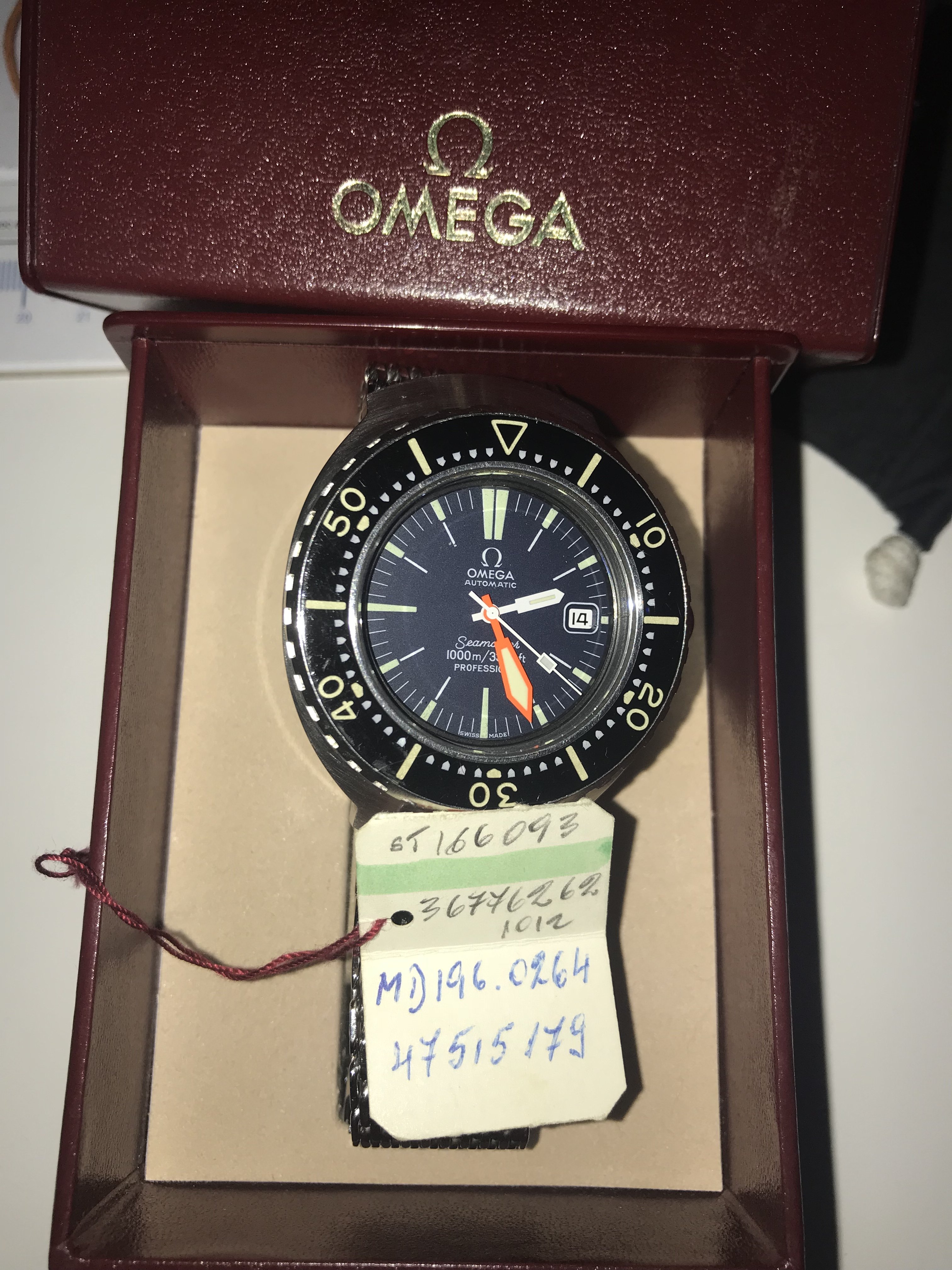

Which number you mean? In the photo Ive send you? Is there any other way to communicate with you fb for instance?

The tag on the photo with the box with the number ending 6262 is the number I checked for you

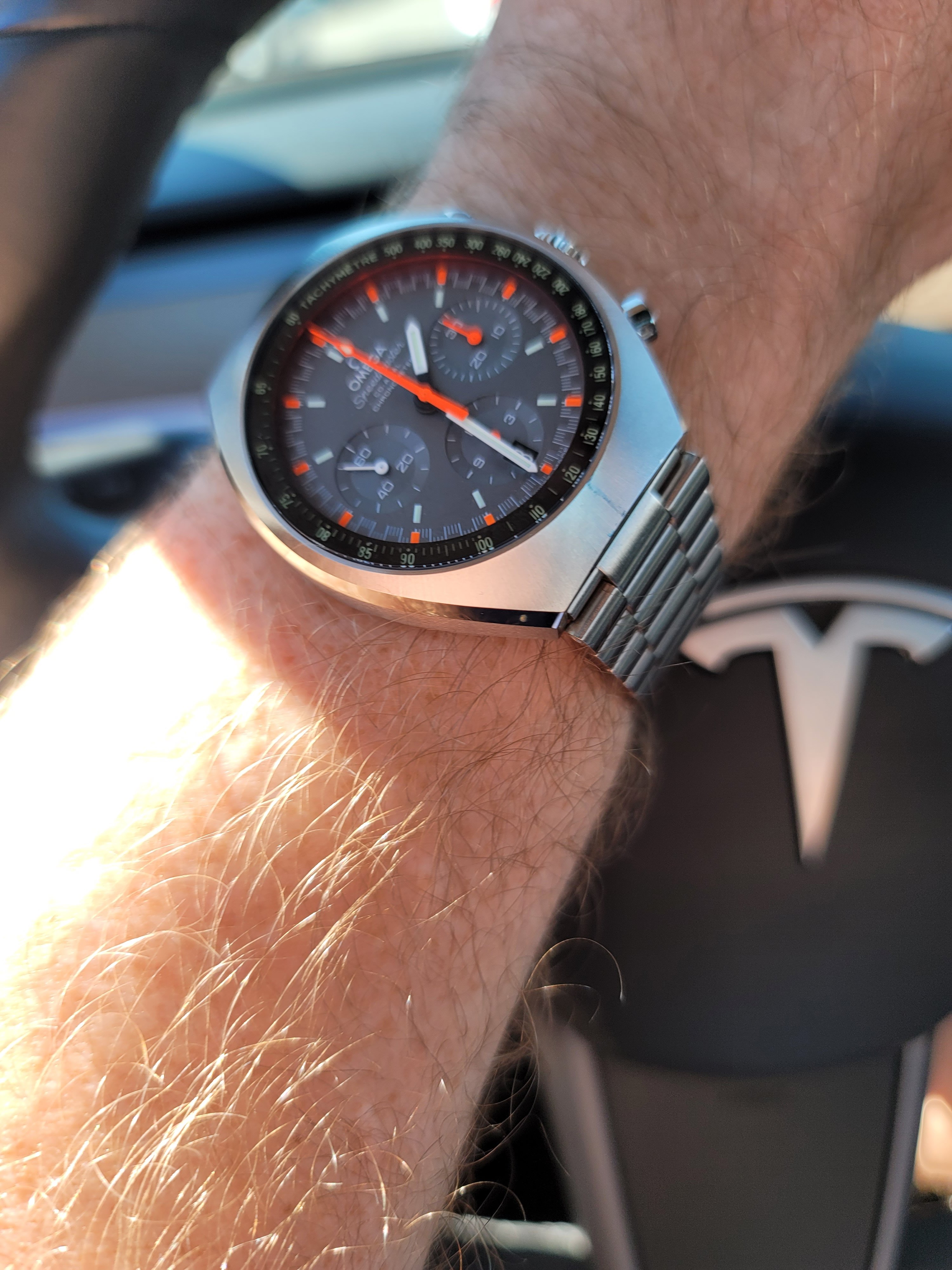

Hey guys I'm about to pull trigger on this. I have a 7 inch wrist... Will it work? I wear a mark ii usually. Thanks! Wrist below for reference!

This watch looks big on every wrist (though not as much as the Flightmaster I think), I am sure you’ll be fine.
