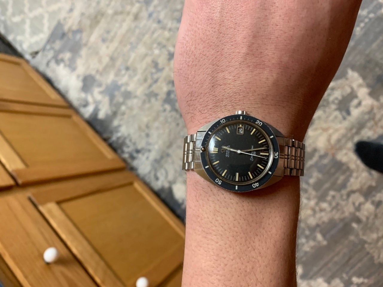

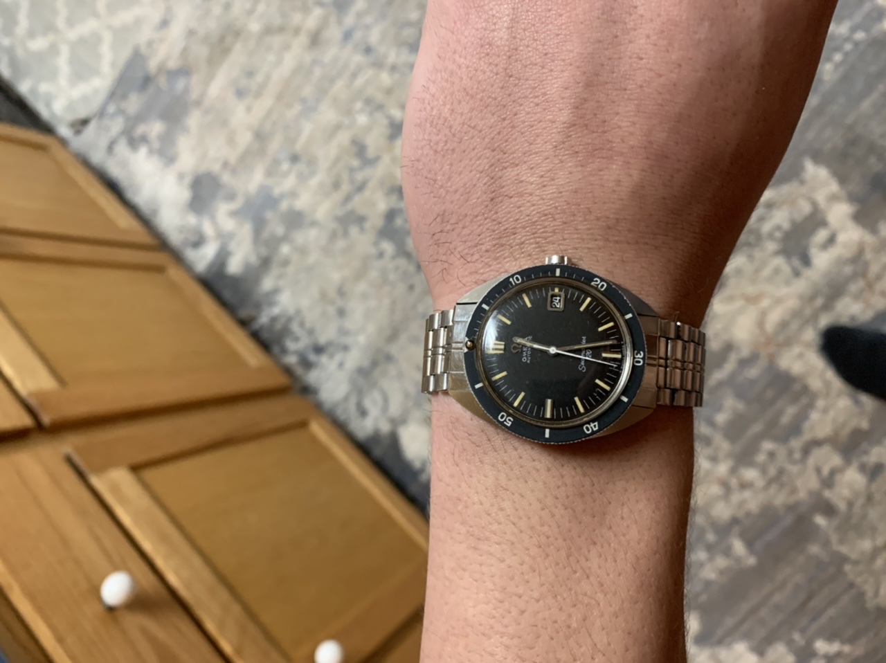

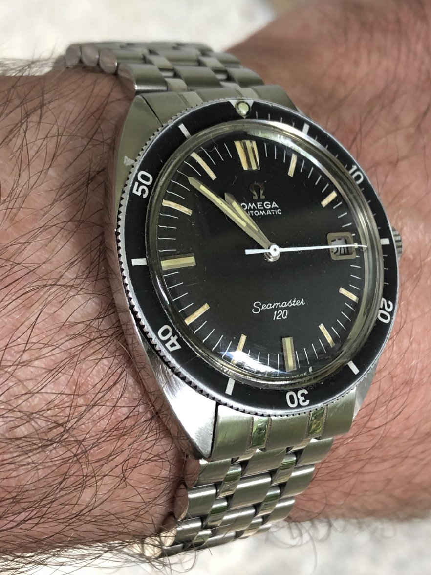

Hello Omega Community,
This is my first post so please let me know if I do any wrong or should be posting this somewhere else.
I have vintage Omega Seamaster 120 I was gifted by my grandfather when I was young. He has since passed away and I want to wear it. I was hoping to gain some more insight on its authenticity. I had the case back opened and noticed it has been serviced at least once in 1997 according to a marking on the inside of the case back.
17 jewel, 563 caliber to avoid tax on higher jeweled watches
Upon inspections I notice that the crown is not original and the bracelet fits with the 1968 production year that I was able to determine using the serial number. Though I feel it may have been changed out given the missing “1069” marking commonly found on that bracelet. Instead it has the No. 12, Omega, and says stainless steel.
The dial is in extremely good condition and I even notice some tritium lum that may still be present. I have had this watch in my jewelry box for the past 15 years and it sat in his for a number of years prior.
I was hoping anyone could provide some help on whether it seems authentic or provide some piece of mind on my theory regarding the changed parts during the servicing.
Any insight helps, thank you.
I also have struggled to find a link to make the bracelet longer. It is sadly too small because I have a slightly larger sized wrist. I can get it on but can’t close it. I’ve checked eBay, chrono24, and a few other sources. Swatch group wanted me to buy a whole new bracelet that doesn’t have the lines.
regards,
Jay

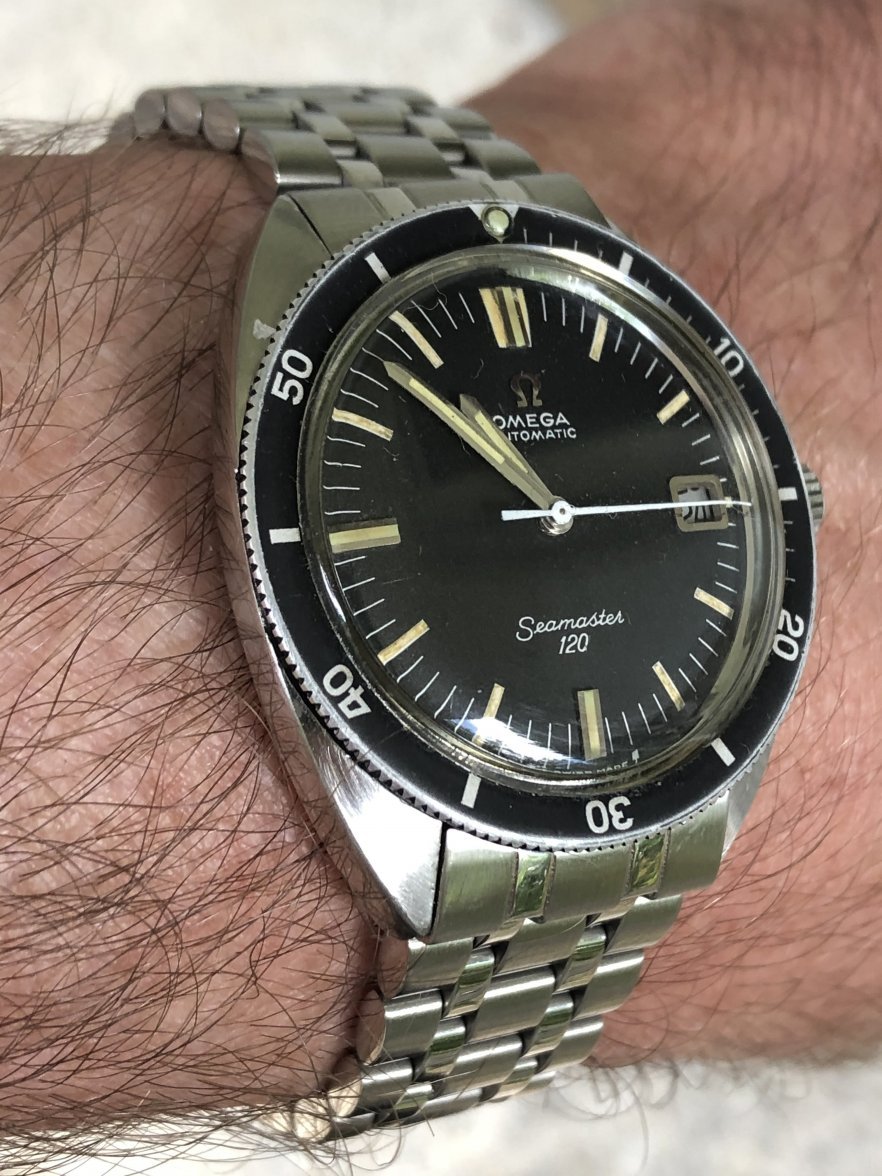

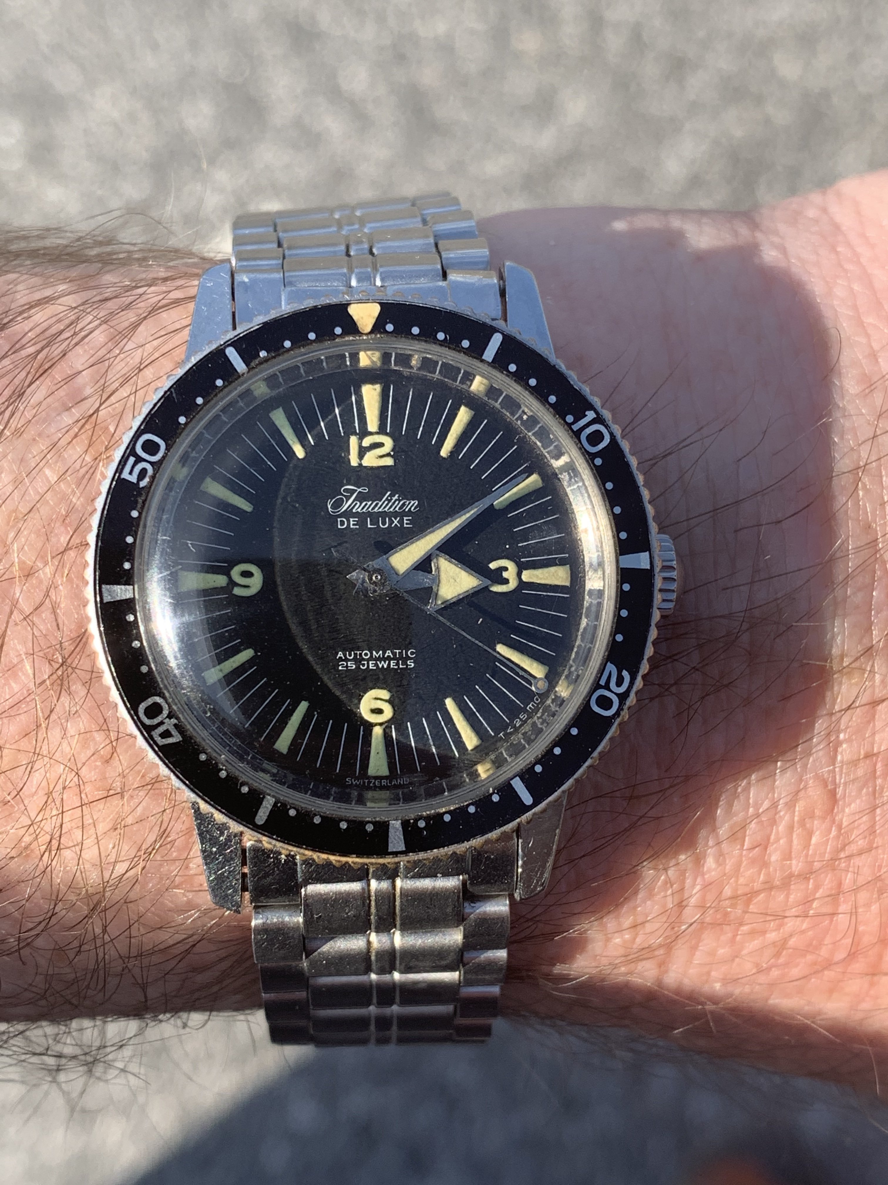

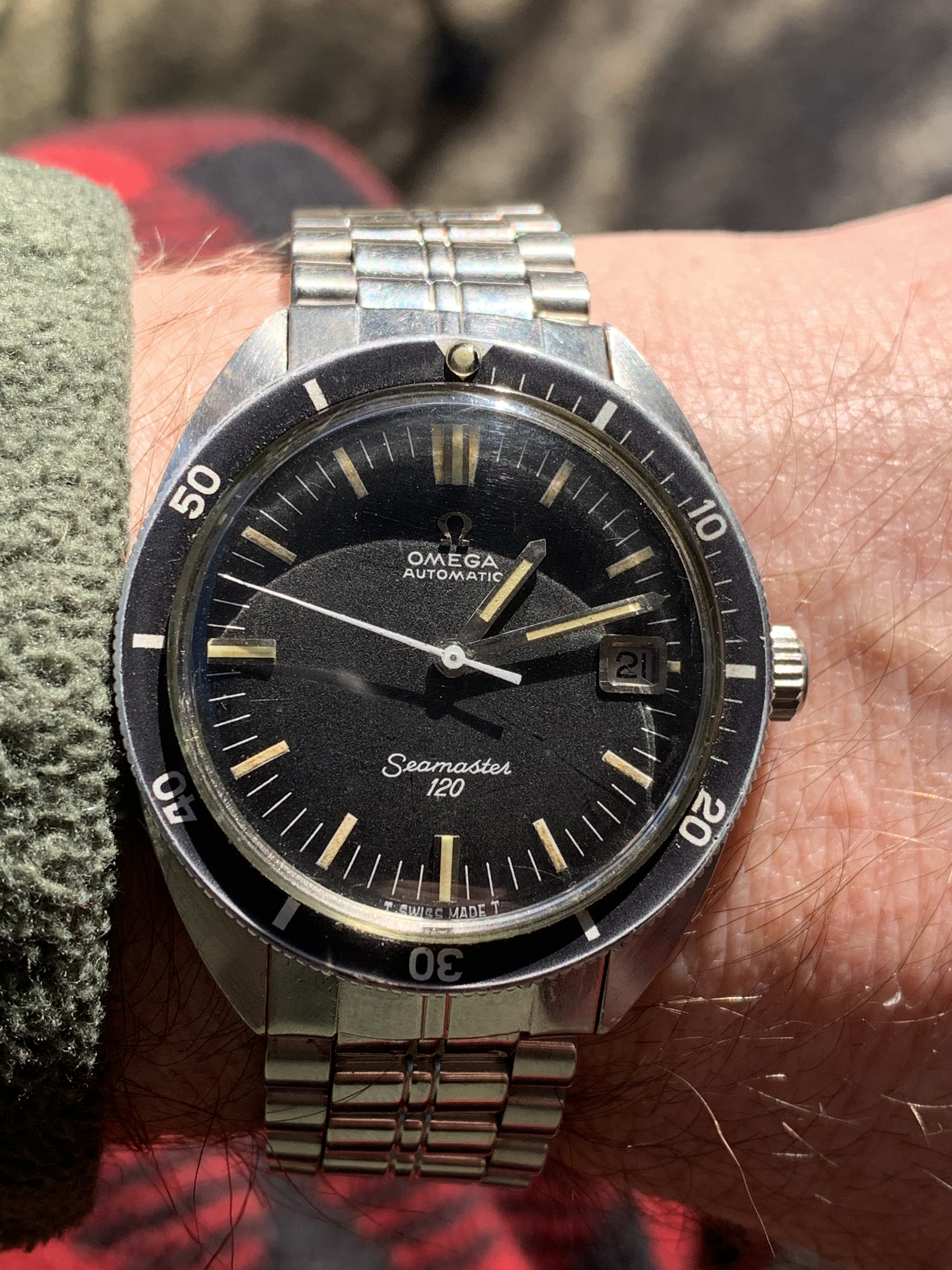

Better pics always help us determine condition (take it outside and zoom in on it) but I see nothing glaring on this as incorrect. The crown as you suggest looks like a clover style which was for the earlier Seamaster’s- so you are correct that it is not a appropriate for this watch. But crowns are commonly changed out at service as they are a wearable part so it’s not a big deal. Getting the correct service crown would be the only thing I would change in this watch- when you get it serviced next.
As for the bracelet, it is indeed a 1098- some were stamped with the number, some weren’t (mine isn’t stamped either).
You are in luck though as the 1098 was made by JB Champion for Omega and this bracelet was also used by other companies at the time, so finding a JBC stamped version of this bracelet can yield extra links if it is long enough (that is how I got my extra link).
Search for “JB Champion bracelet” on eBay and eventually one of these will pop up. You may get lucky and find someone selling links, but most likely you will have to buy a whole bracelet.
An alternative in the mean time is to find a longer clasp. There are modern made cheap extensions for clasps, but I have found the holes commonly don’t line up with Omega or JBC clasps, so finding a longer clasp cover could hold you over

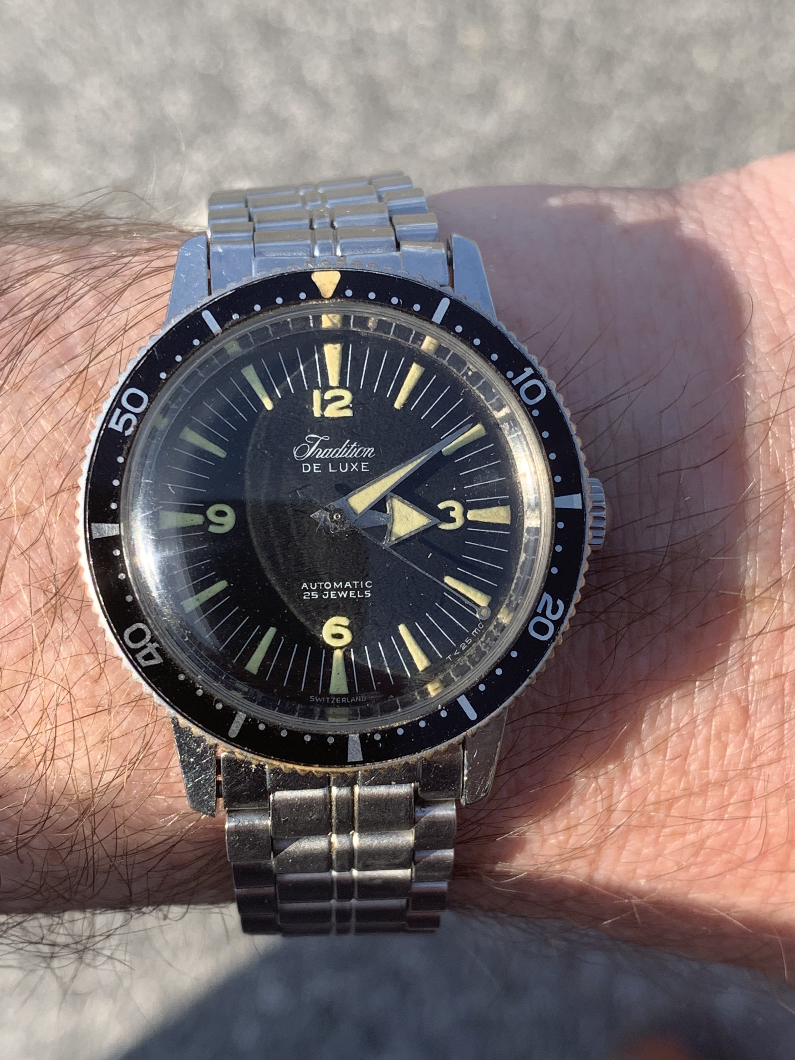

As for the bracelet, you can wear it on a leather or canvas strap or use an aftermarket bracelet until you find the correct links for your 1098.
Before I tracked down the correct bracelet for mine, I wore it on an Uncle Seiko 19mm Holzer bracelet. It took a little tweaking of the endlinks for it to lay flush to the case, but was an excellent fit

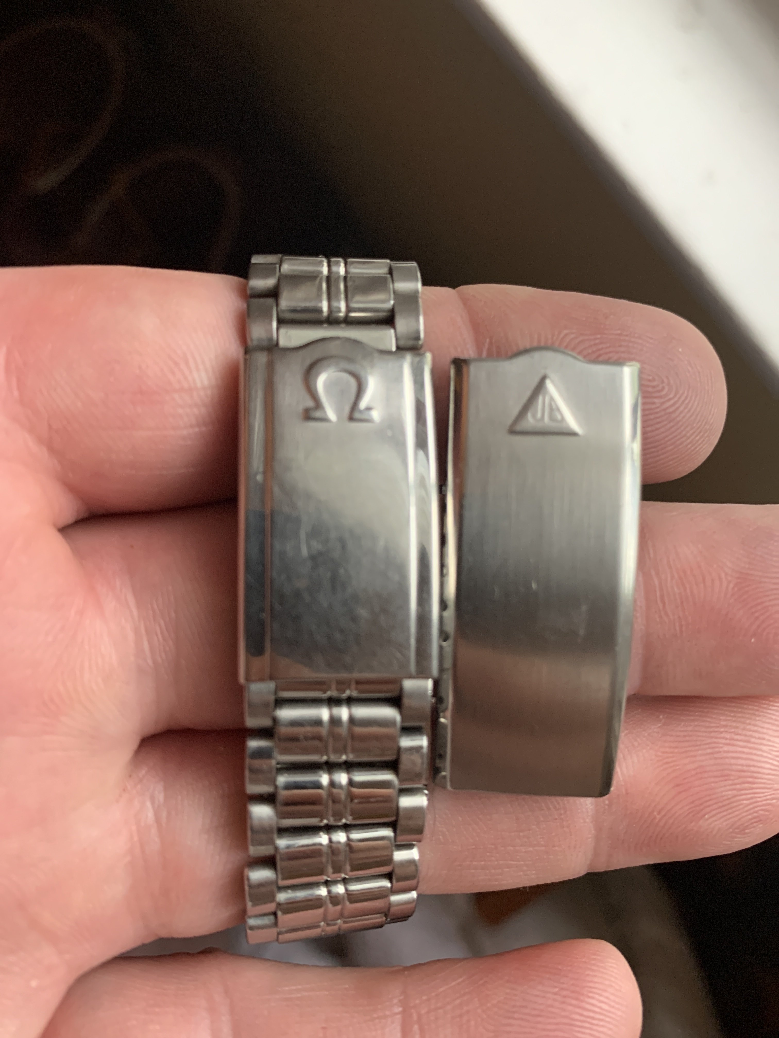

Thank you so much I really do appreciate all the input. I definitely get what you mean and I think finding a good watchmaker to service it will be the best thing to maintain it’s longevity while keeping it made with original parts. I did find everyone’s suggestions helpful in the post so I’m truly grateful.

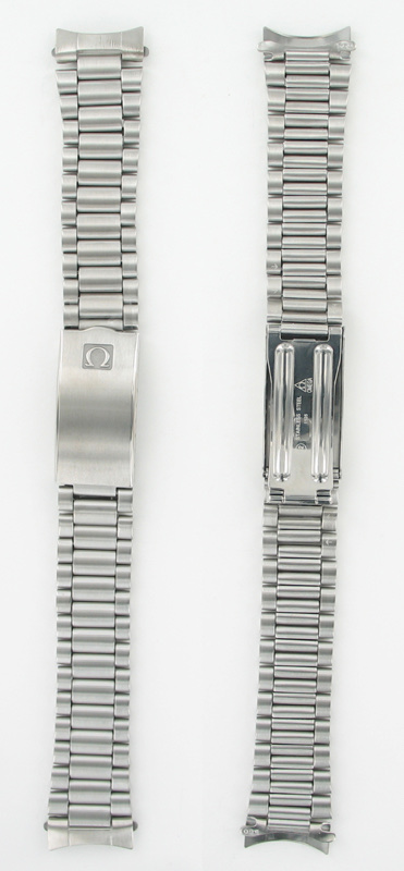

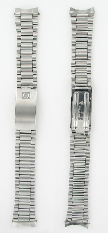

One other question, more so pertaining to obtaining parts. So I did originally try to reach out to Omega and was forwarded to swatch group I’m kind of curious because I talk to somebody from swatch group and they offered me a bracelet that was their replacement to the one I had but it was manufactured in 2007. Which I found out after I got some more information from one of their representatives it looks slightly different but I was curious about what/if any the experience is sourcing parts from them? I did consider purchasing it for the mean time. Any thoughts?
After doing some online reading I wouldn’t send the watch to Omega or Swatch Group for any kind of servicing though. I feel the type of servicing they provide is not something I would want to have done on this watch since it holds sentimental values and I worry they would probably change it a bit to much for my liking to bring it as modern as possible.
I’ll included a photo of the bracelet.
