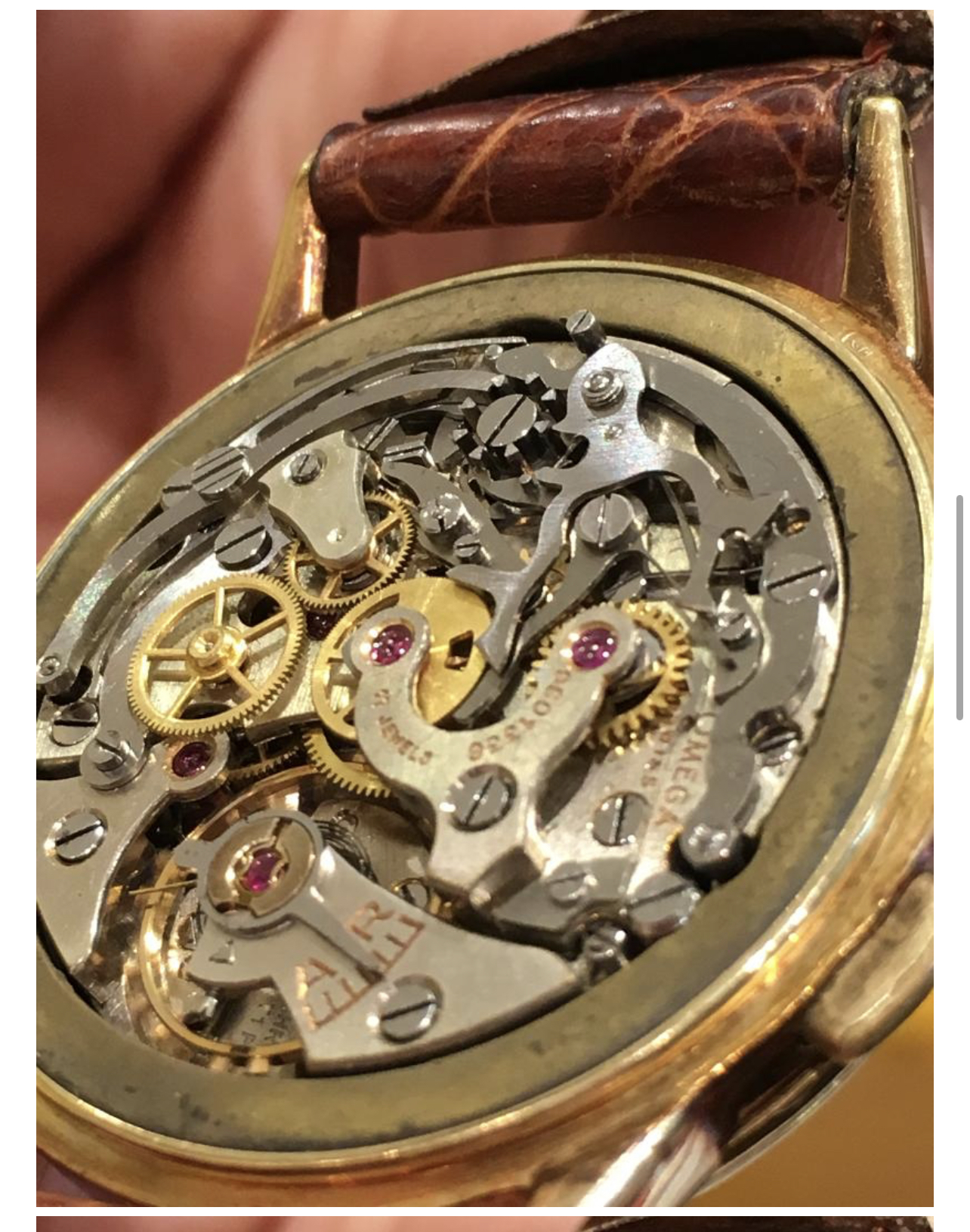

Ok. That is much better. Whatever happened in the past, forget it. Get your watch back as soon as you can. Don't let these Texans touch the movement. ( Sell Texas back to Mexico....) Judging by the movement screws heads, I'd not expect that the movement service needs parts. So, let the USA members here give you the best local watchmaker for the job. I'd expect the costs for a service only to be around half, what the Cowboys wanted. I'd somewhat expect the whatever " Vice President" come back to your Father and tell him, that After close inspection it can not be repaired ( too old, too worn, too something...) But from the Goodness of his heart he will buy it off him for the absolute maximum of $1900..... Get it back. Quickly.

Omega would be unable to operate a caliber 321 when it is again part of their catalog? I don't really believe it. it's such an iconic caliber.
First 321 parts from the new 321's are not exactly available for the older pieces, 2nd the movement is not a 321, but its predecessor the CH27 C12. It is not a 1 to 1 parts match for a 321. It will be a better match to early 321's but not later 321's as there where updates in that time period.

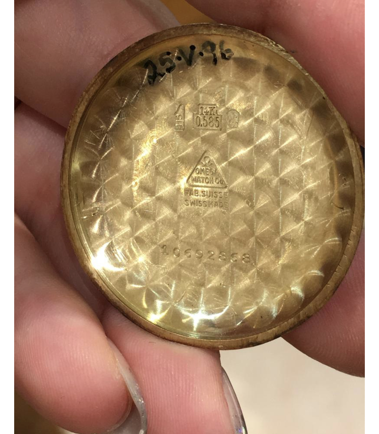

1) the watch shown at the beginning of the thread, which should be representative of the watch of the opener, is a reference 2468 (with a repainted dial);
2) the case back shown later does not belong to a 2468;
3) the movement shown later, as well as the case band (see the lugs) does not belong to a 2468 either;
4) Omega at Bienne can restore any 27CH or 320/321 and Vice Presidents do not overhaul watches.
In conclusion, the whole story is about a mysterious watch which has never been exhibited. 😉

Please when ready post a picture of the actual watch dial, the movement and the case back
