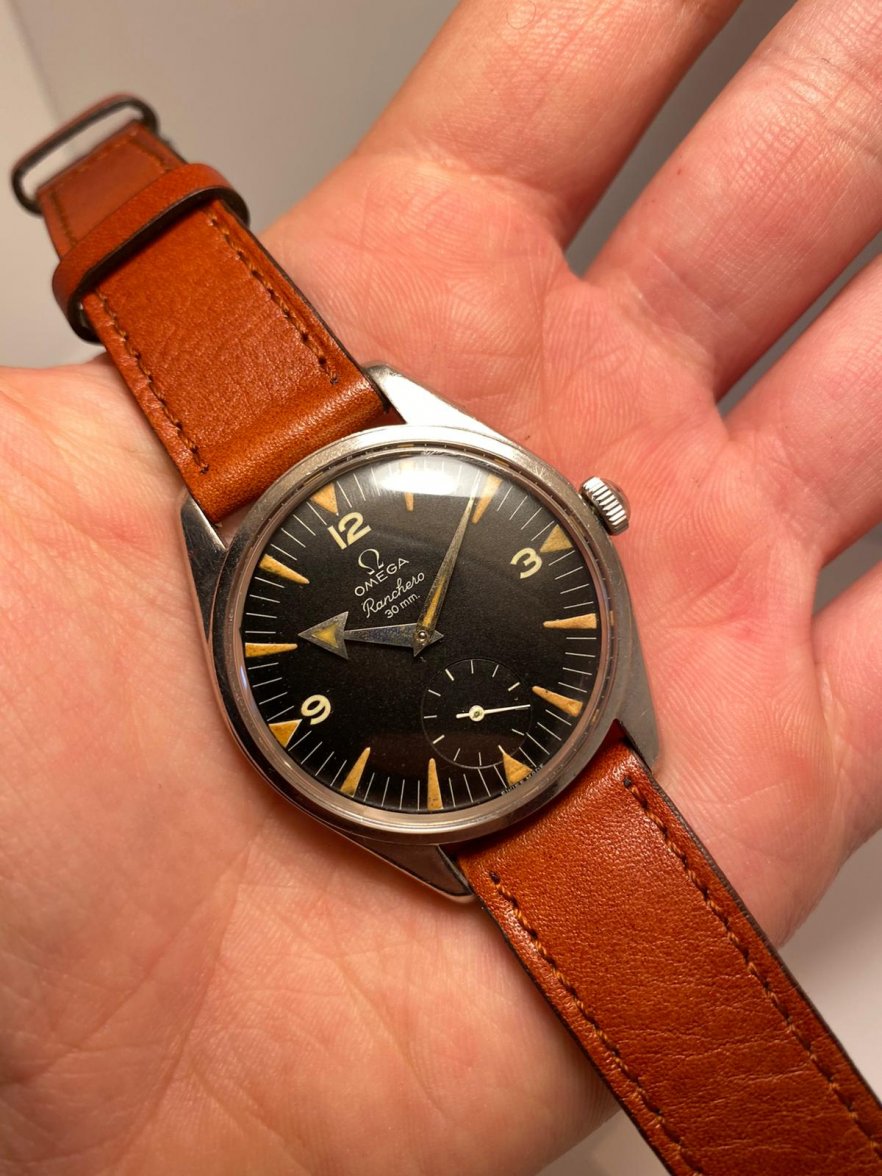

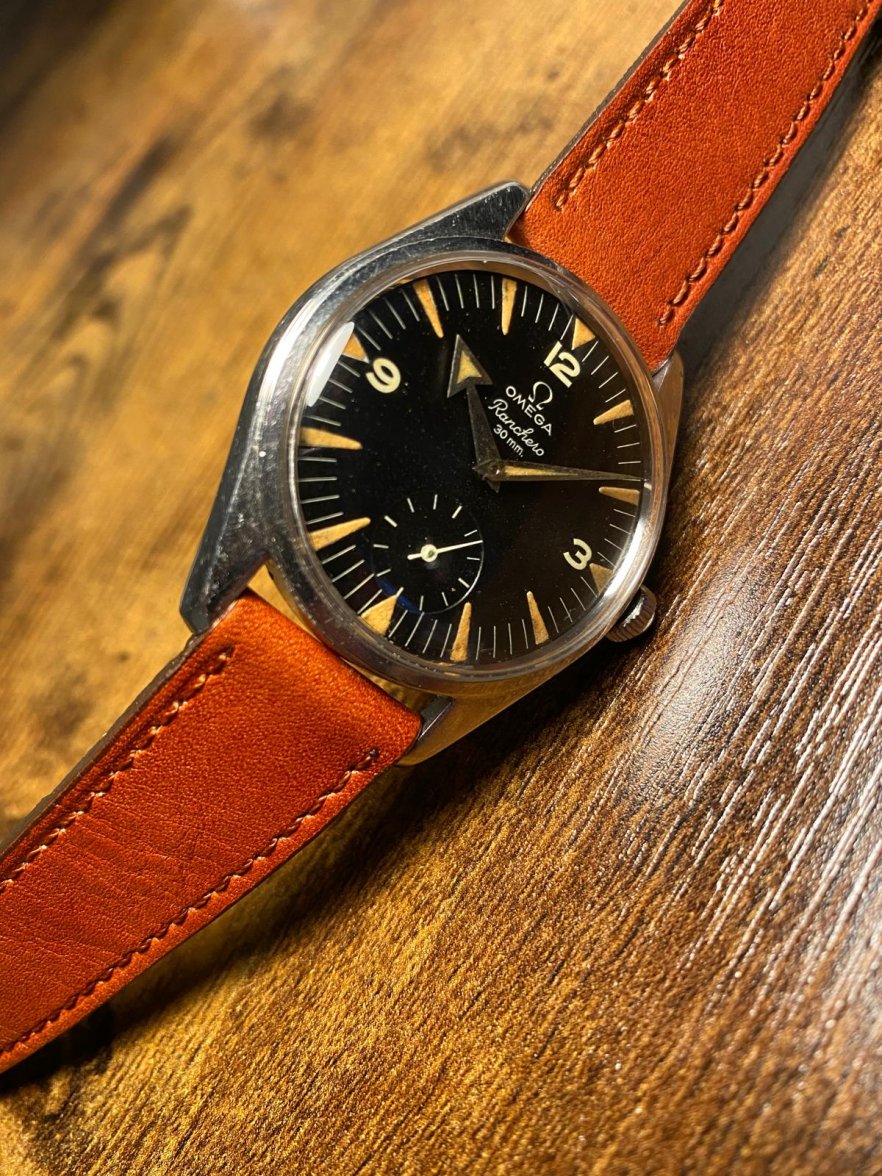

Hi guys, I am looking for a vintage Omega Ranchero with black dial as a cool and pretty rare watch imho.
I stumbled upon a good example and wanted to know your opinions about it.
Although I cannot upload any photos as of now, I was offered a trade: my Rolex 1601 w/ sigma linen dial, matching Jubilee bracelet with big crown clasp, Indo-arabic date wheel and original warranty + 1500 euros for the Omega.
Please note that the Ranchero comes without accessories neither original bracelet, featuring just a leather band.
The watch which I am trying to purchase is actually 100% original and period-correct as far as the seller is concerned (obv).
I know the lack of photos may annoy someone but I wish you could give your advice on the trade.
Thank you!

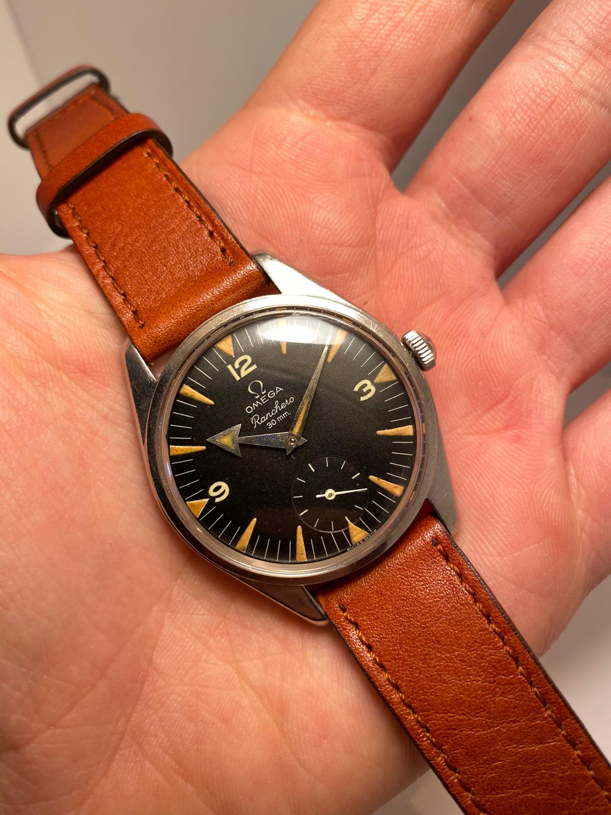

Looks legit to me and is in a very good condition.
Lume seems ok at first sight, at second probably a relume. It is a bit sloppy (4, 5, 11) perhaps you can get a UV shot of the dial to have more certainty about that.
Crown looks original.

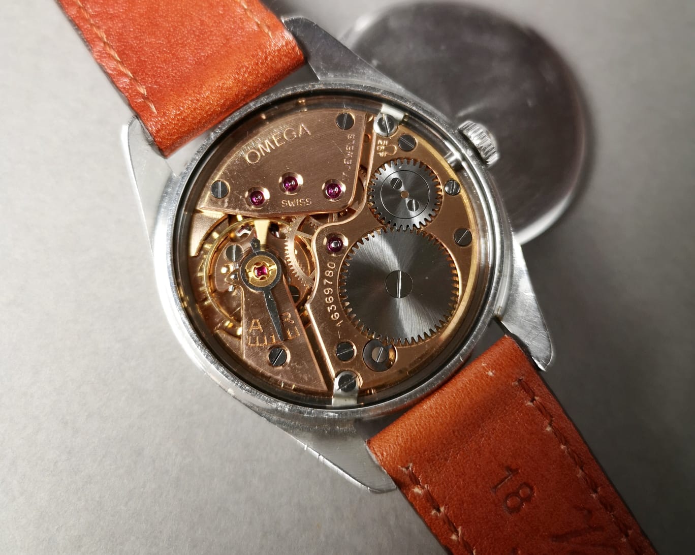

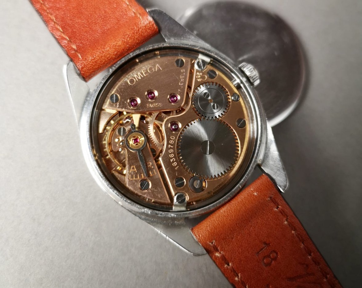

Has been serviced at some point and movement looks decent as well.
I guess around 5k EUR for that Ranchero would be the amount I would consider for that.

Thank you for the replies!

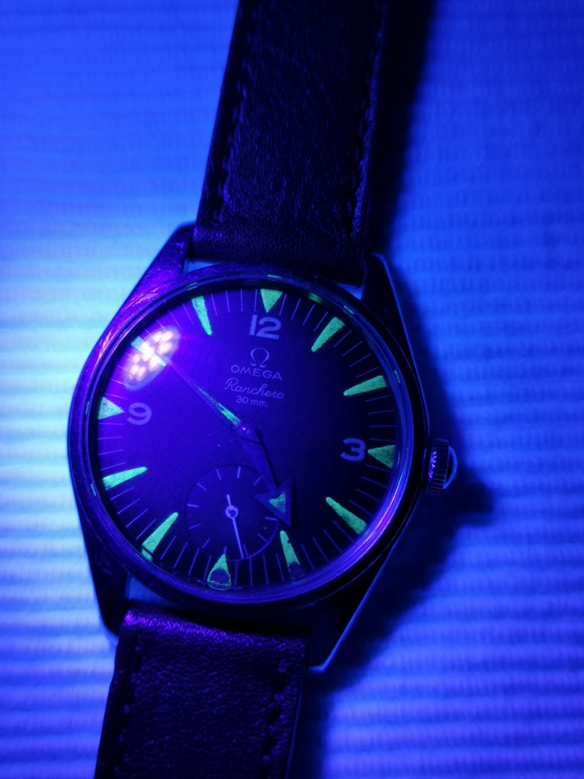

Why do you recommend a UV light shot?
I cannot understand if the dial has been relumed or not.
Given the photos, how do you consider this Ranchero?

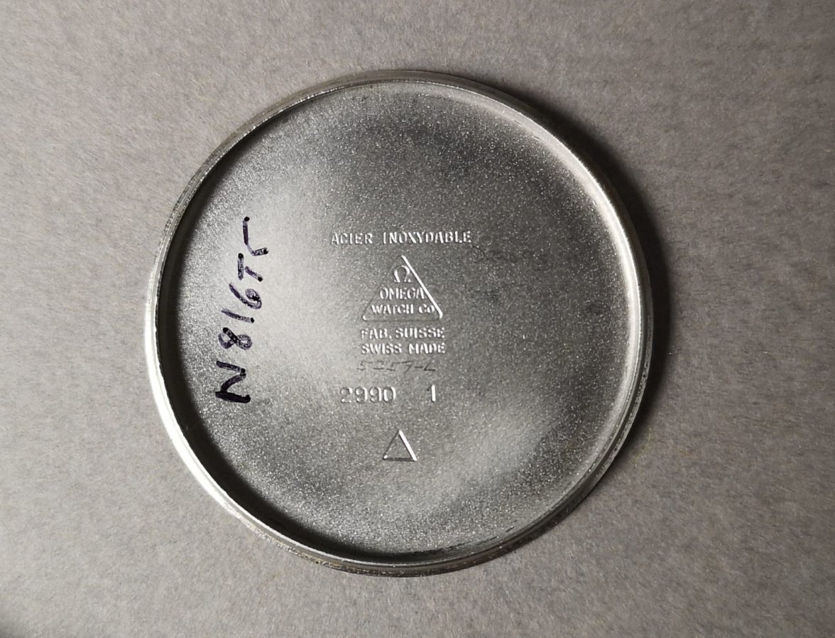

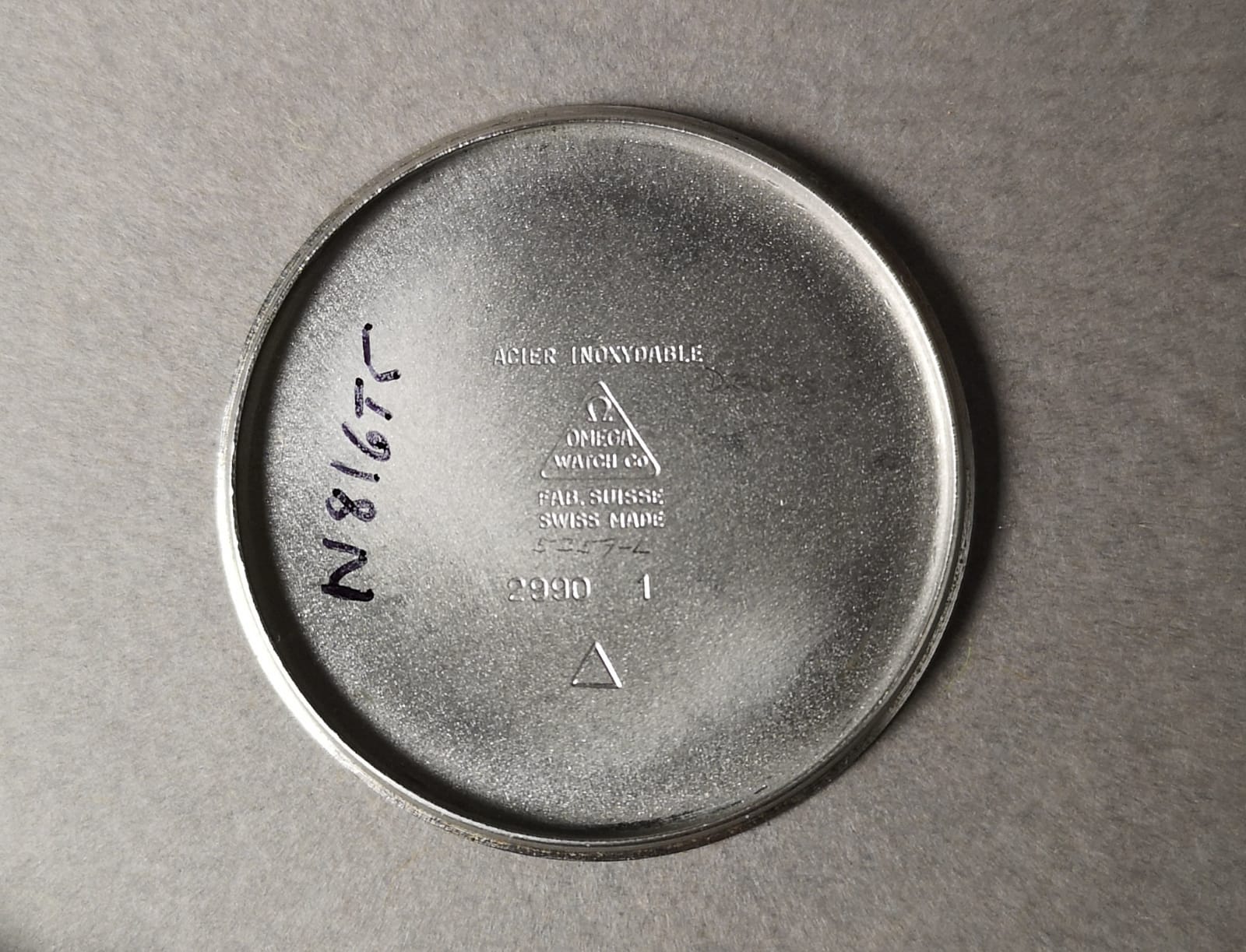

Looks fine to me, is there an Extract from the archives that confirm that it is a Ranchero?
The caliber and serial is in the range for Ranchero's but other models used cal. 267 in this period so even the rest is okay the movement could be from an other Omega.

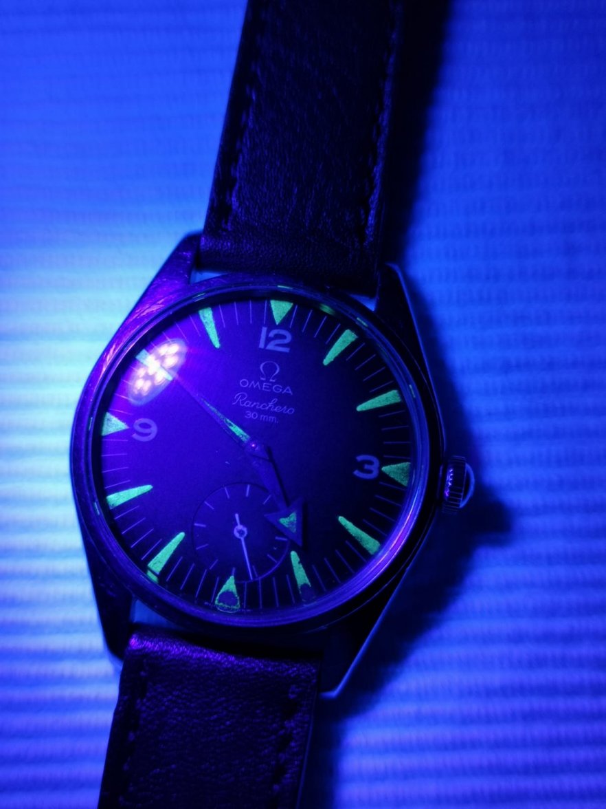

For me it would help showing any differences of the lume which could be an indication of some partially resuming.
As @tdn-dk said, using a Geiger would show if it is the original radium lume.
However I don't know if the seller has one.

Unfortunately there isn't any Extract from Omega, I've just asked the seller if he can get one because it's important to have it.
Later I will upload photos of the dial under UV light.

I think a UV test would tell you what you need to know about the lume (a UV light is cheap)- even if he hit it with a bright light for 30 sec and were able to take pics of it dimly glowing should show you the rate at which the lume dies and would show if any of the indices had been relumed (they would glow brighter than the rest).

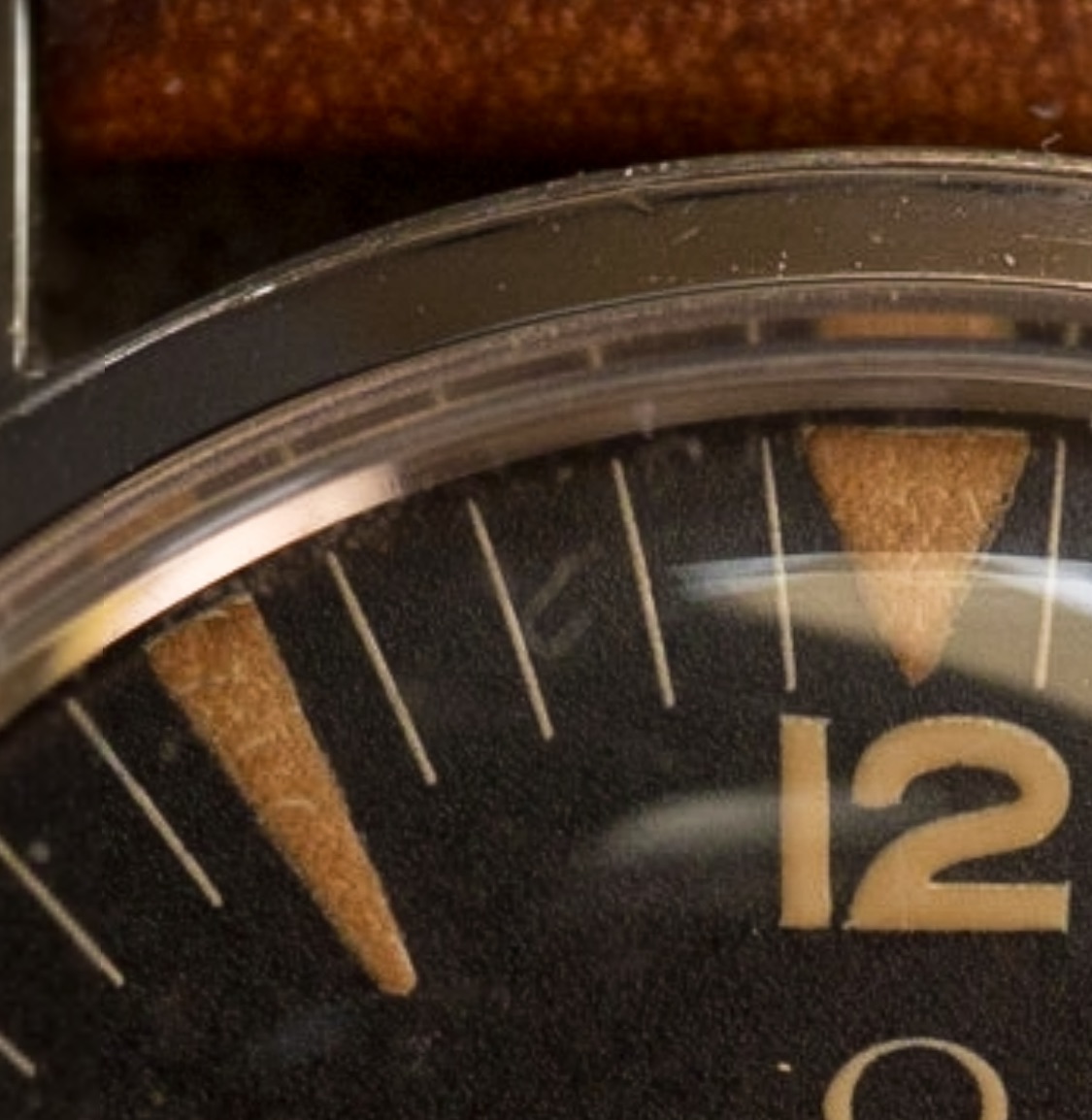

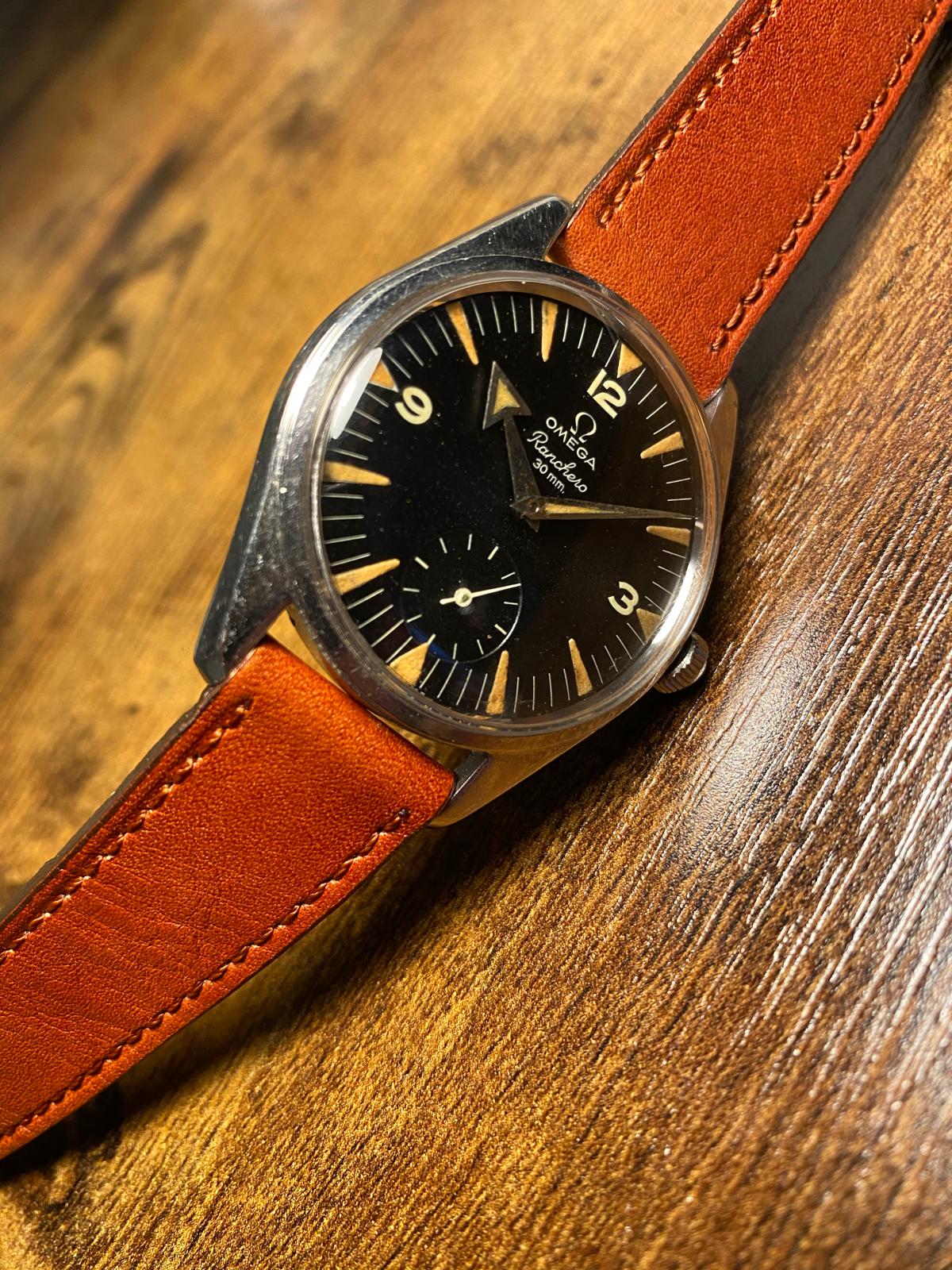

Isn't unusual to see the dial between the tension ring and the case?.🍿

The movement number looks fine to me but these have been seen nicely relumed. I would rely on a GC for both the hands and dial.
2,720
5,554
The silver ring that provides tension for the crystal and keeps the dial seated. There is a gap/space that starts at 11:00 and continues to 5:00. You can see the the lume in the gap. Not good. If the ring is loose it can damage the dial/lume and create all kinds of problems.

I can't give you an opinion on letting it go or not. The problem must be looked at though before it gets worse. If no damage to the dial has occurred then the value should not be affected. the watch may need a new Omega crystal or just reset the crystal if it is the correct Omega crystal. Resetting the crystal may crack it though.
That’s not a gap, it’s refraction from the crystal. The lume just doesn’t go that far back, it stops before the tension ring. Here is the same effect on mine.
I don’t see any issues with the watch.
2,720
5,554
You could be right. I have ever seen refraction like that before if that is the case.
