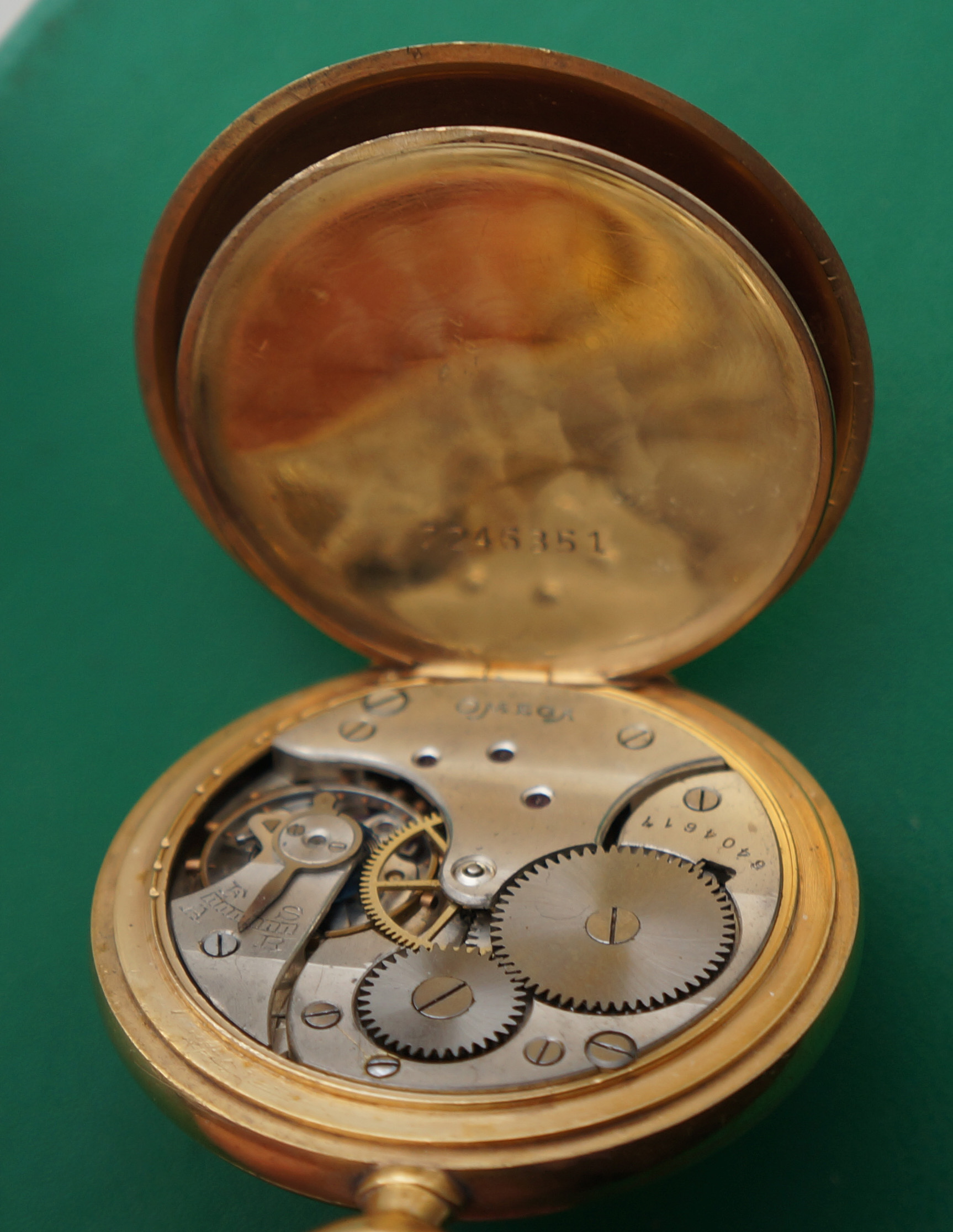

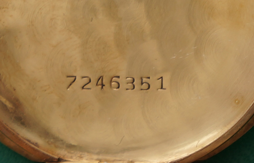

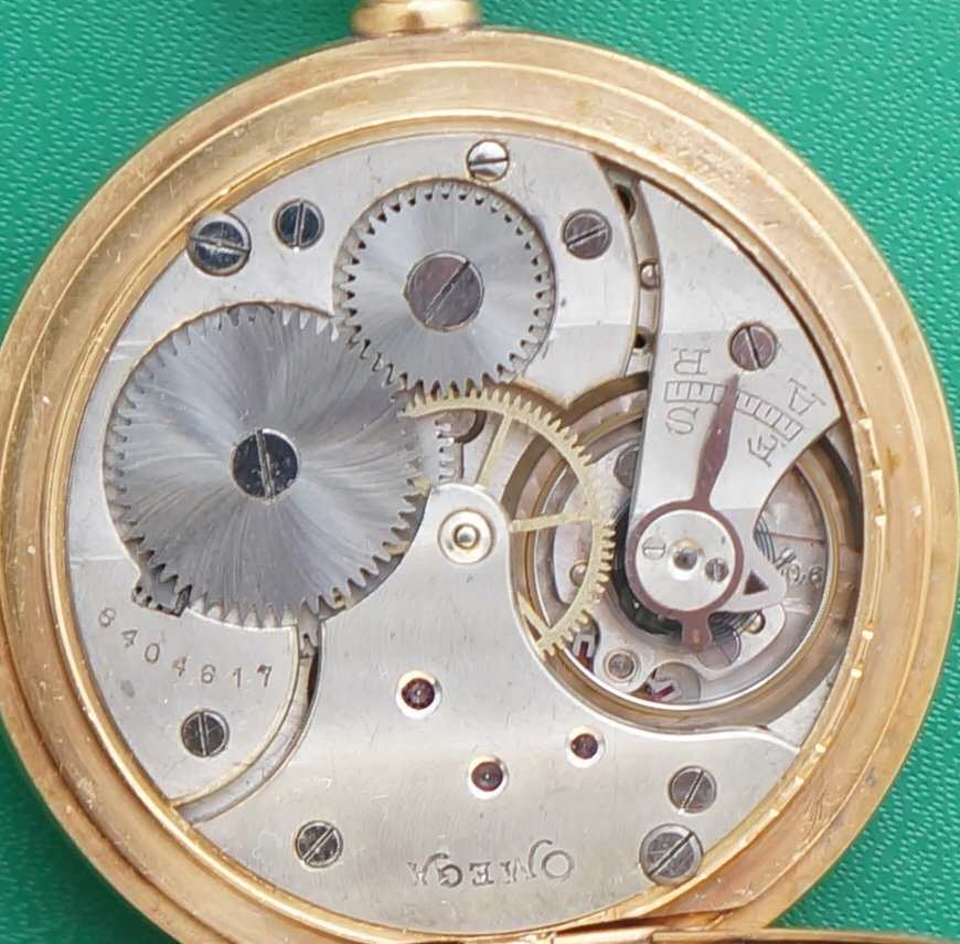

I have a gold plated Omega pocket watch, numbered on the movement 6404617 and 7246351 inside of the case. I'd be interested to know a little more about it, Age Calibre etc. I've looked at quite a few online and all of the ones I've seen have a seconds indicator dial but this one has only the hour and minute hands with no provision of a seconds dial, is this unusual?

Your watch has the calibre 40.6L. In fact, you can see the ‘*0,6’ under the balance wheel on the right side of your first image. Yours is the earlier/original version of the 40.6L - which has the ‘tag’ click: the later (T1) version had a different click.
The calibre started in 1923 - and from your case number (which is usually the sequence for dating in these earlier watches) it would probably date about 1927.
The vast majority of Omega pocket watches did have a sub-seconds dial - but not all. Sometimes, the style of the dial led to it being excluded. As @TexOmega said, an image of the dial might help explain things further.

Caliber ref is engraved under the balance (40.6? would mean a 40.6mm diameter caliber and a men’s watch). Watch from around 1925-26 according to serial numbers. Can’t say more without pictures of the whole watch, front and back. Unusual to have a two hands watch with this caliber…
