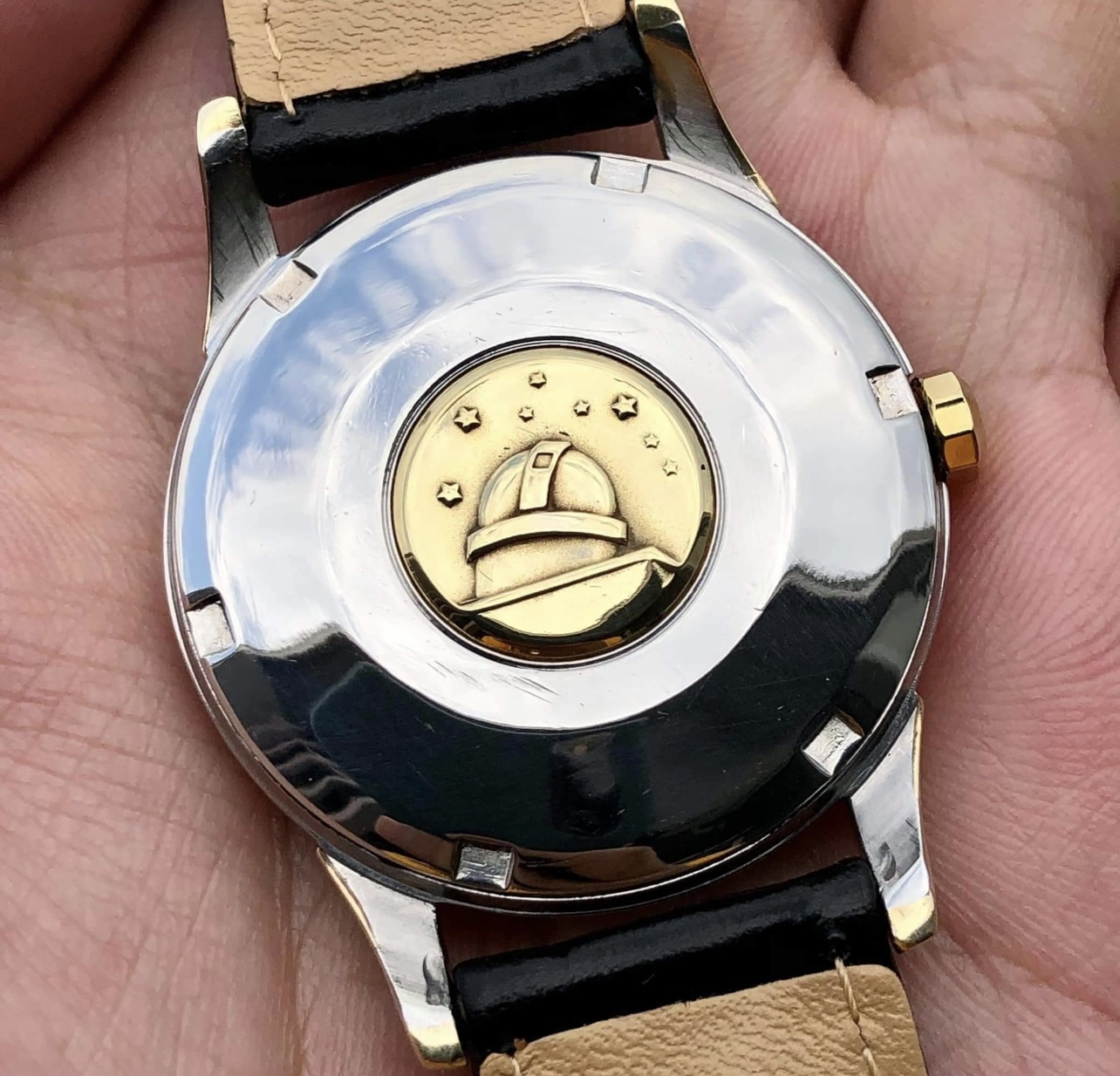

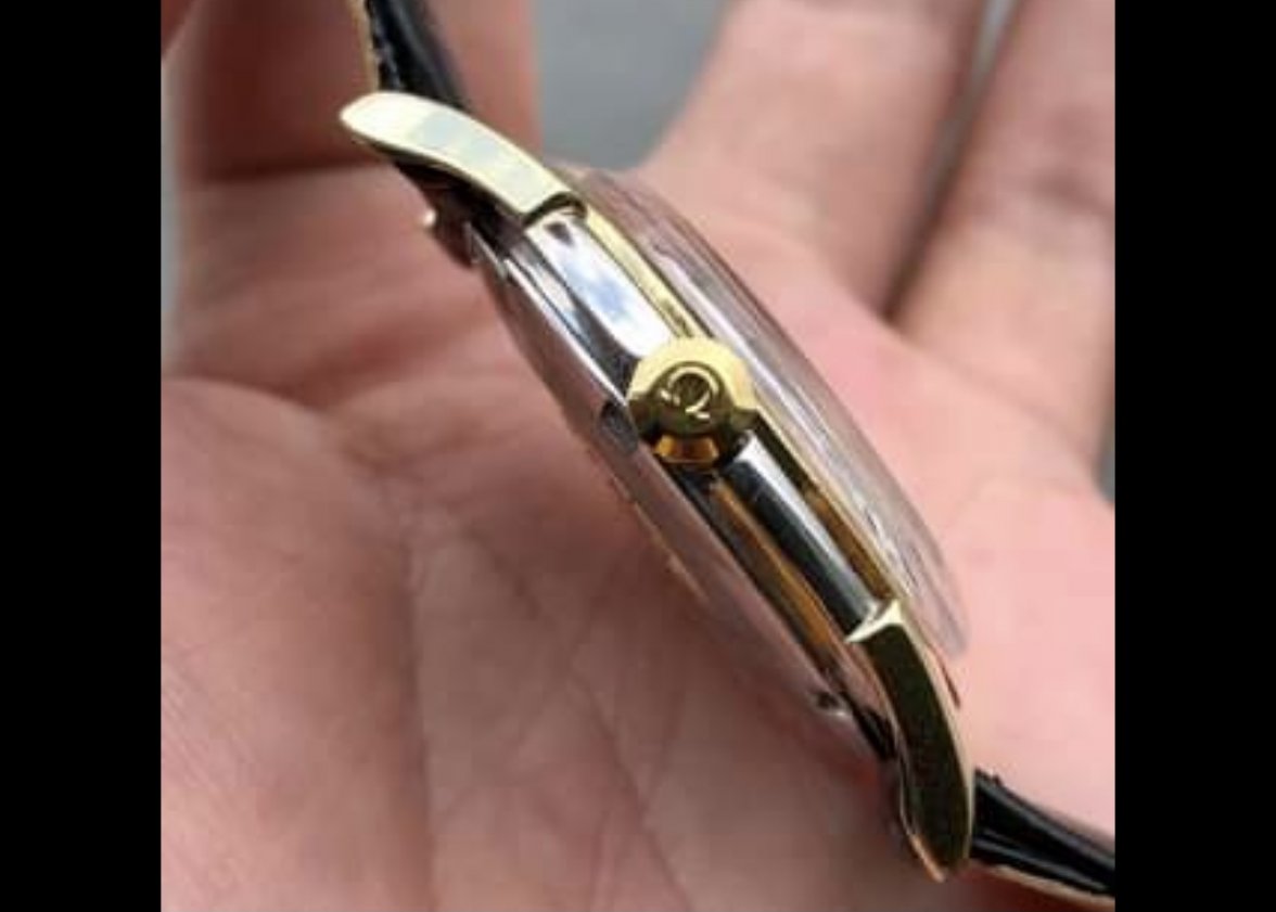

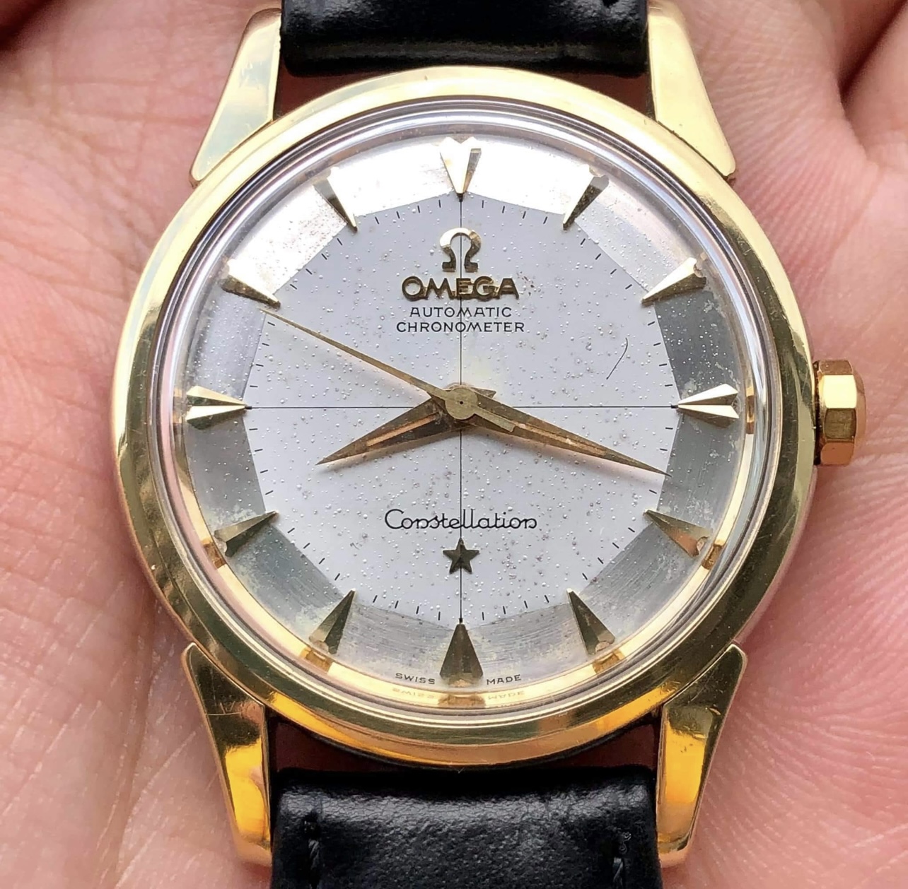

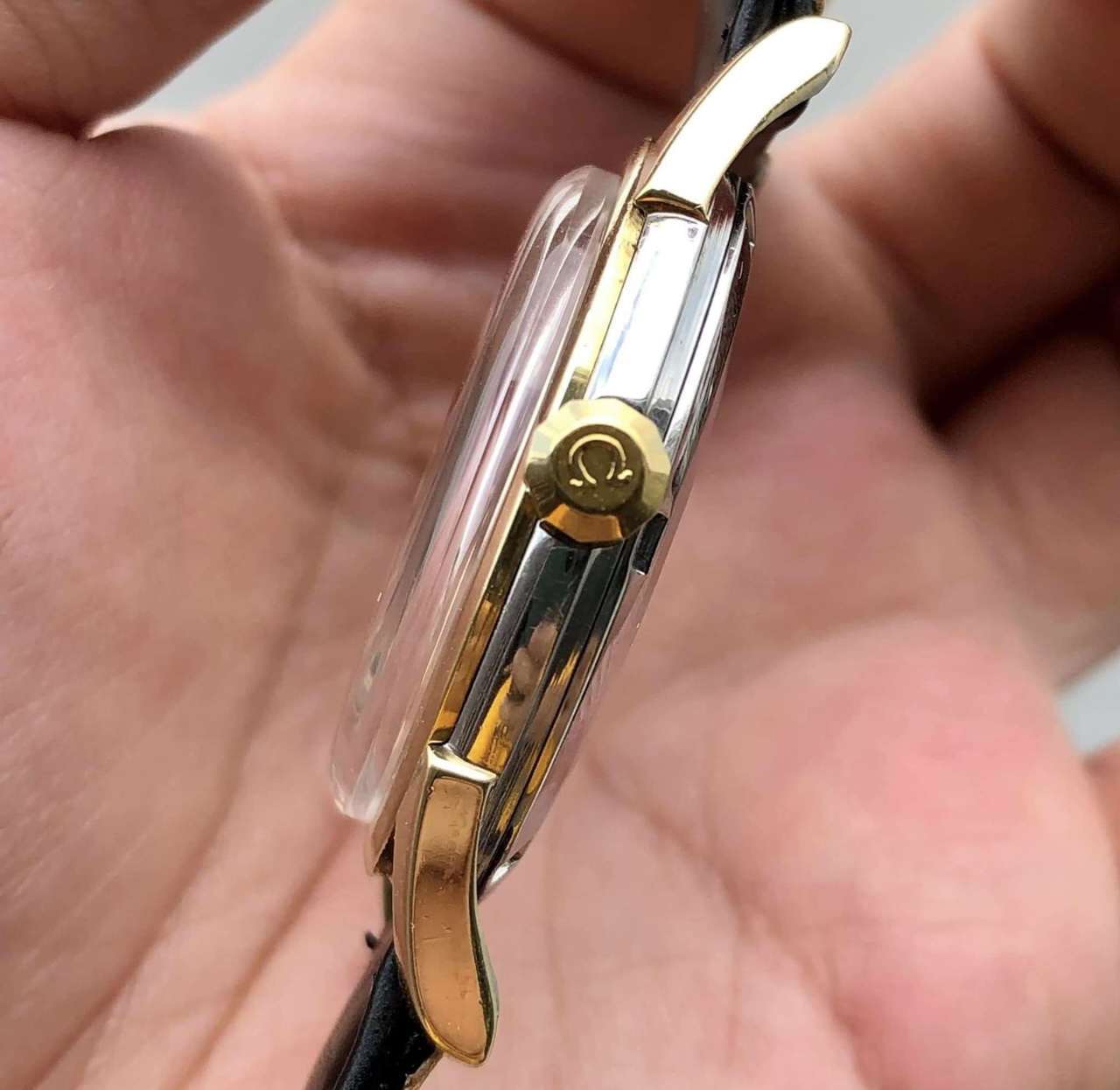

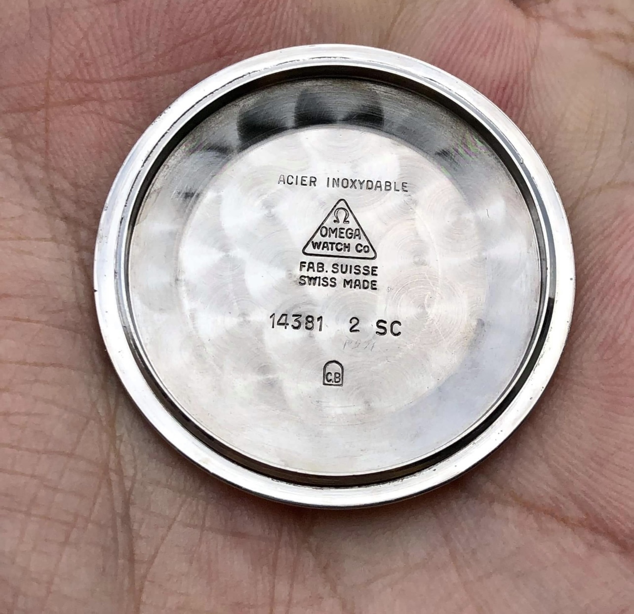

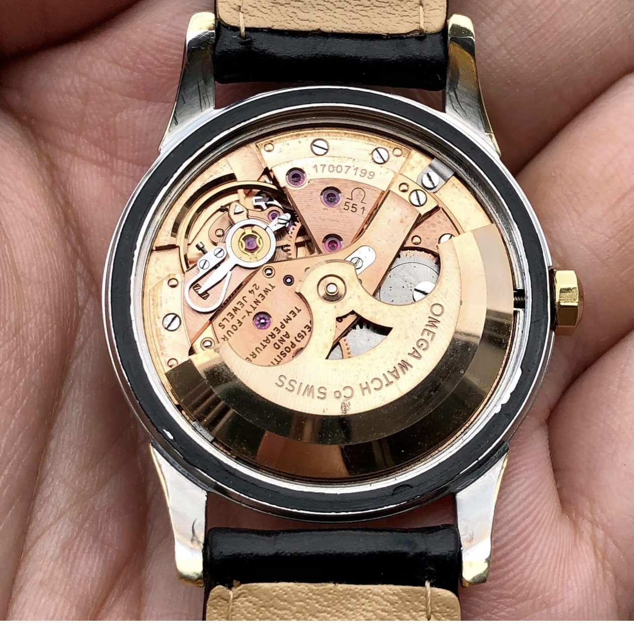

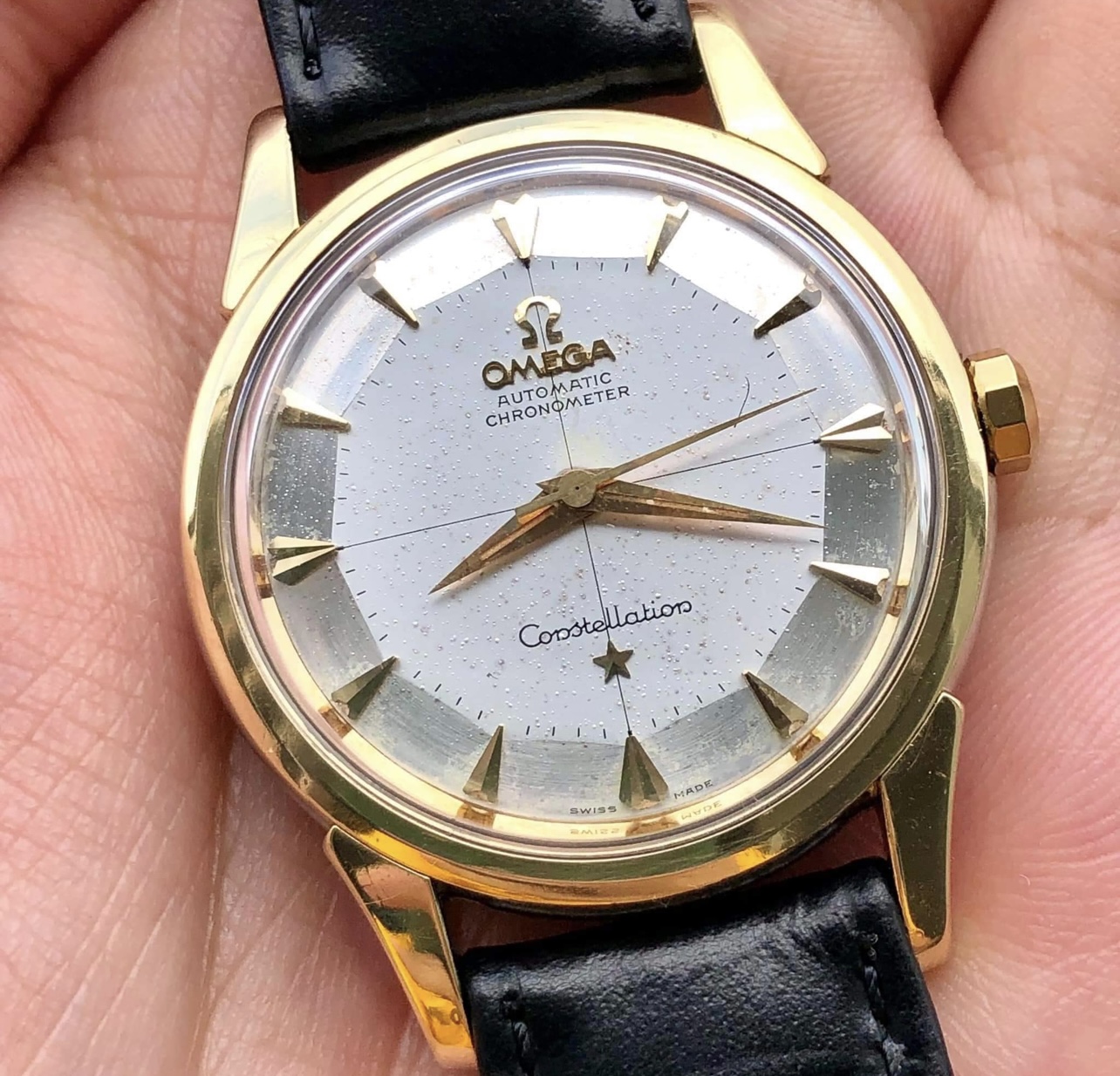

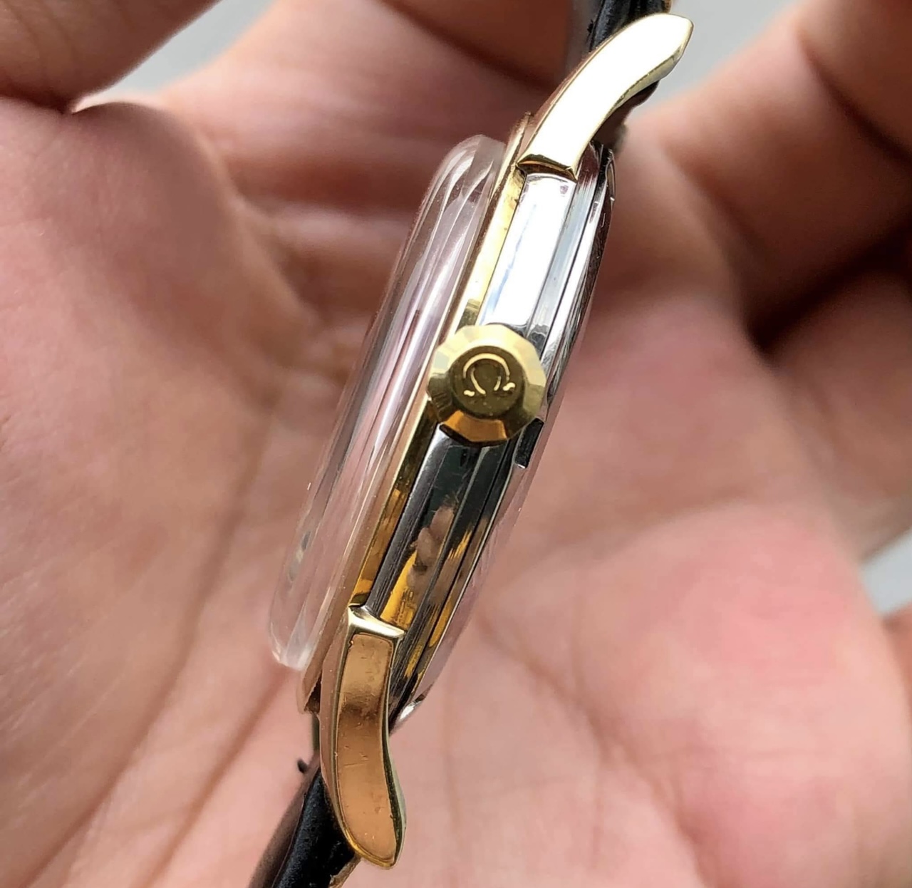

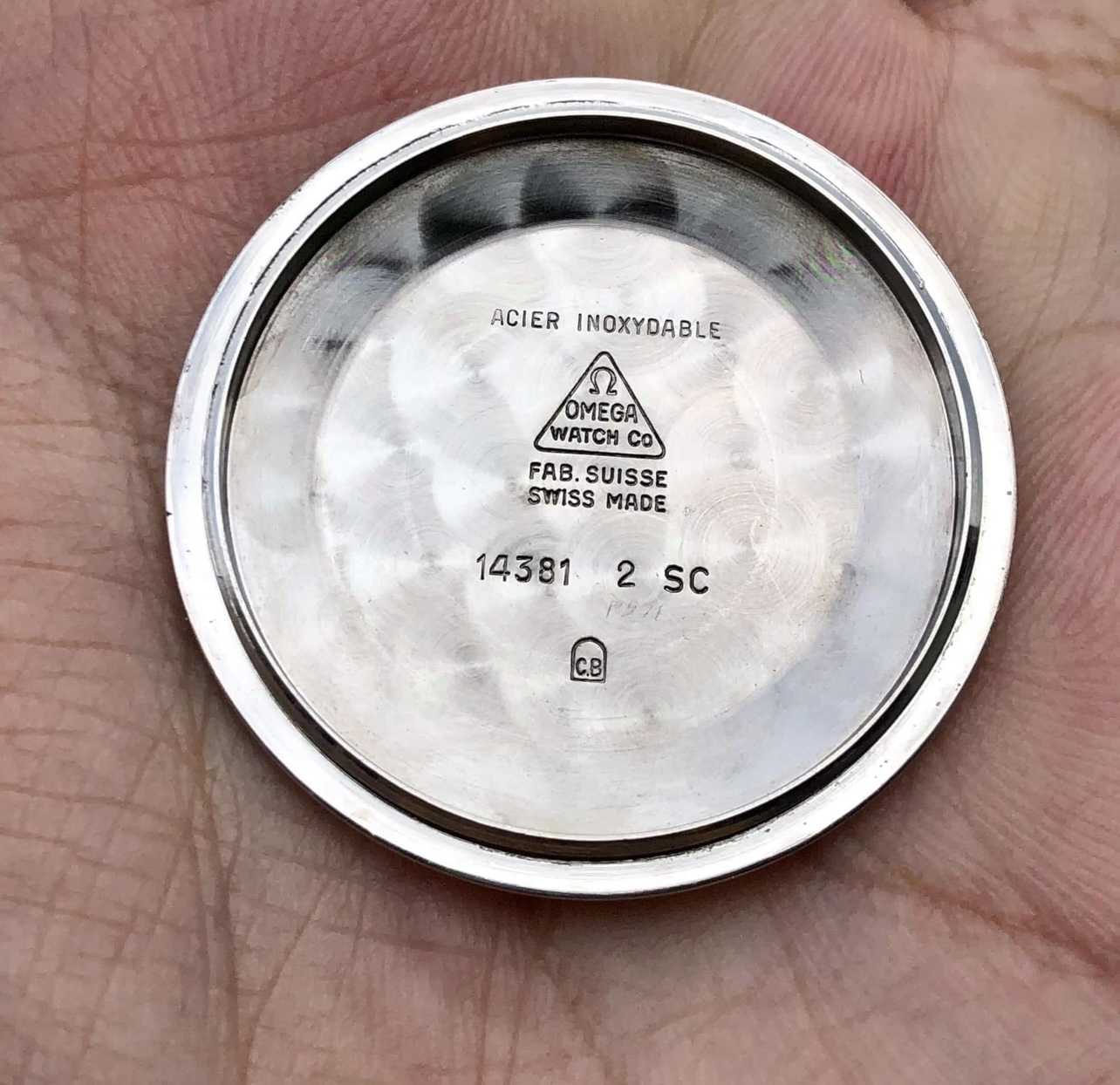

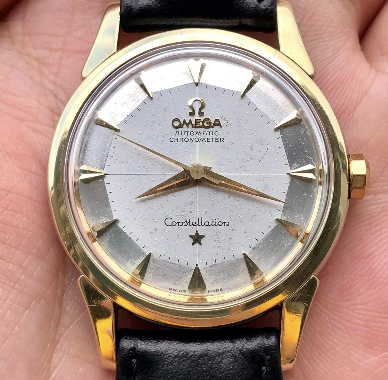

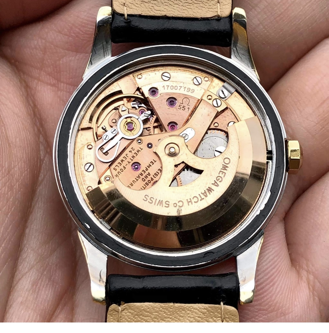

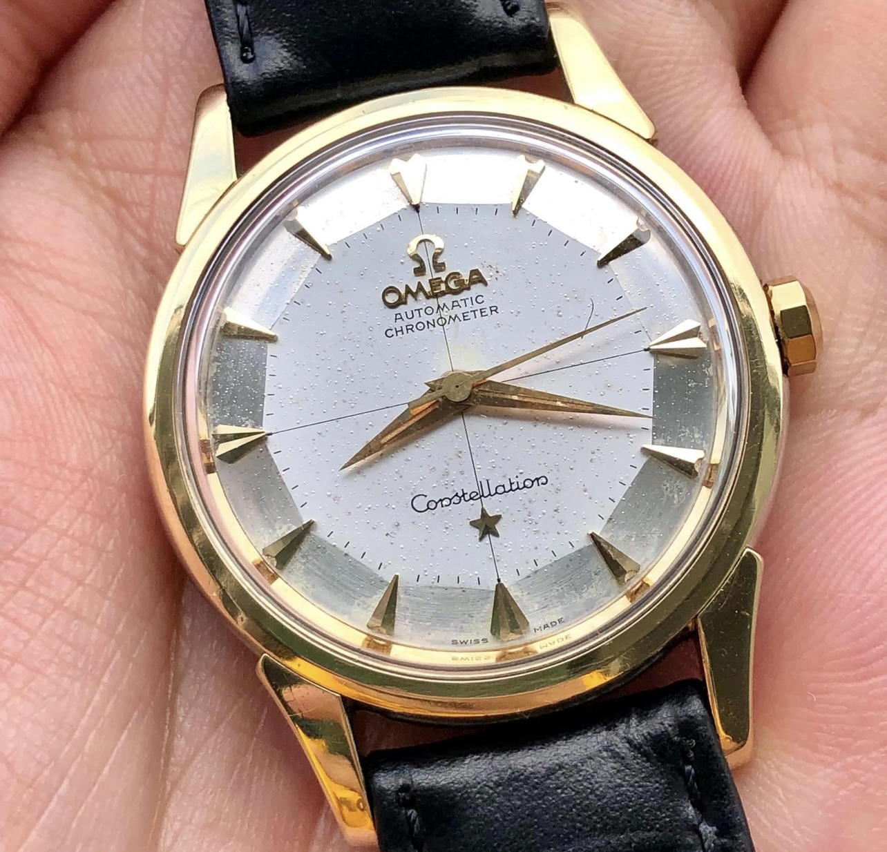

Hi guys,
I have just bought this watch a week ago from an independent dealer in Bangkok Thailand. The price is quite reasonable and based on my own research it looks authentic.
Wonder if you guys think the same. Please comment. Tks ya.

It looks original to my eyes, but the case is a bit over polished.

Hi Tks for your comment. I do agree the case is over polished. Fortunately the stars are still visible 馃榾

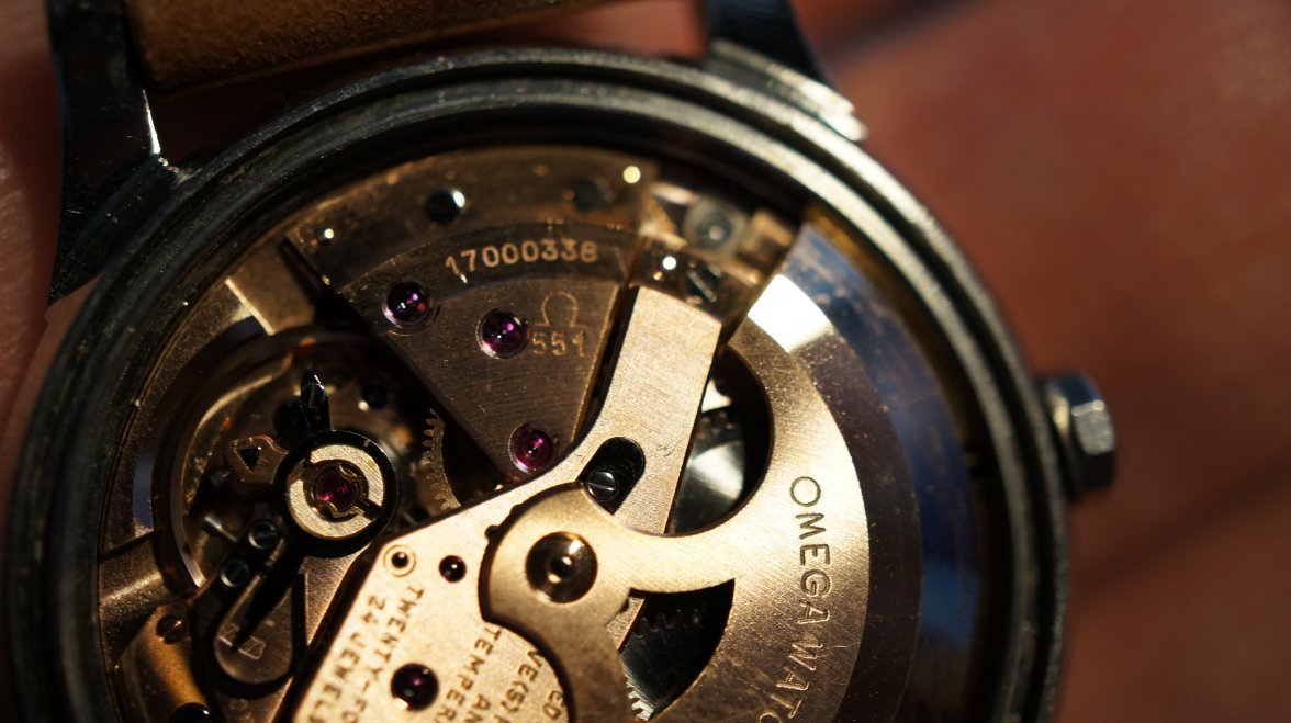

original dial , and I like the serial number range......one of the 20,000.

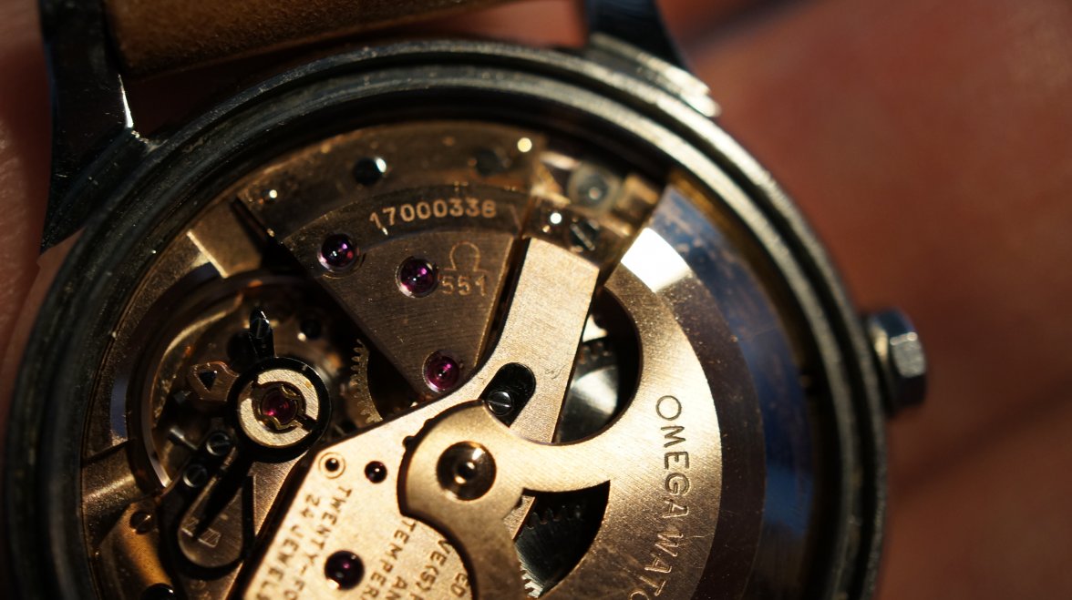

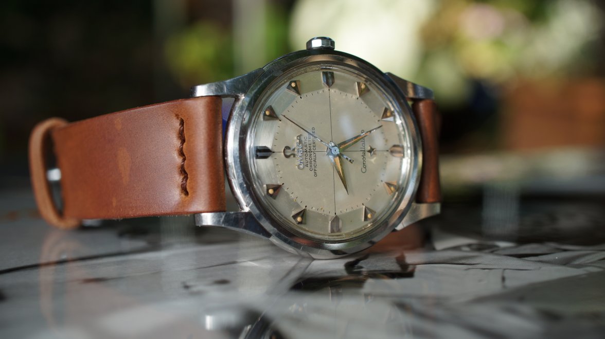

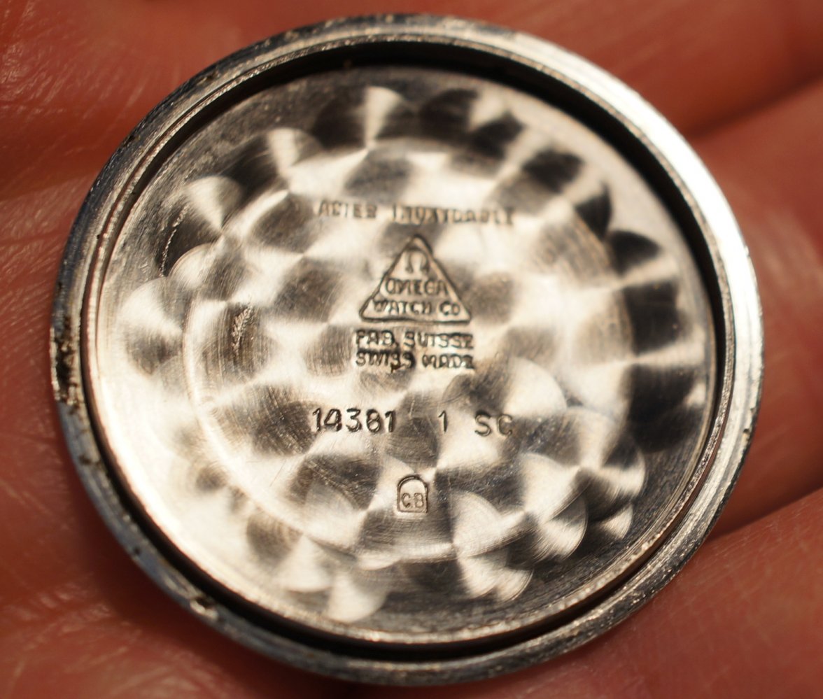

mine with the 3-line VERY early version and Special Order Factory lume plots and hands

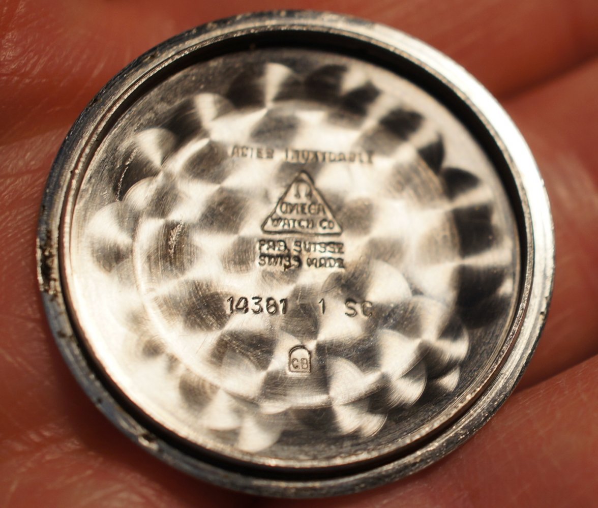

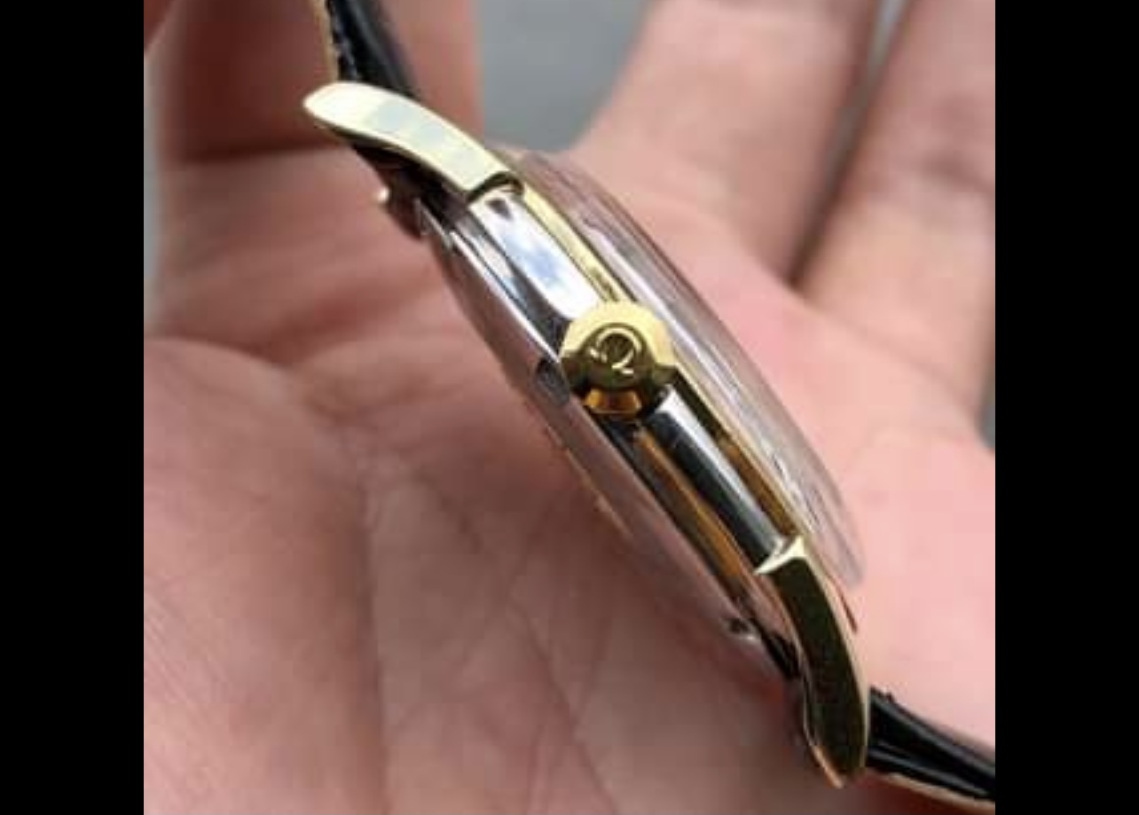

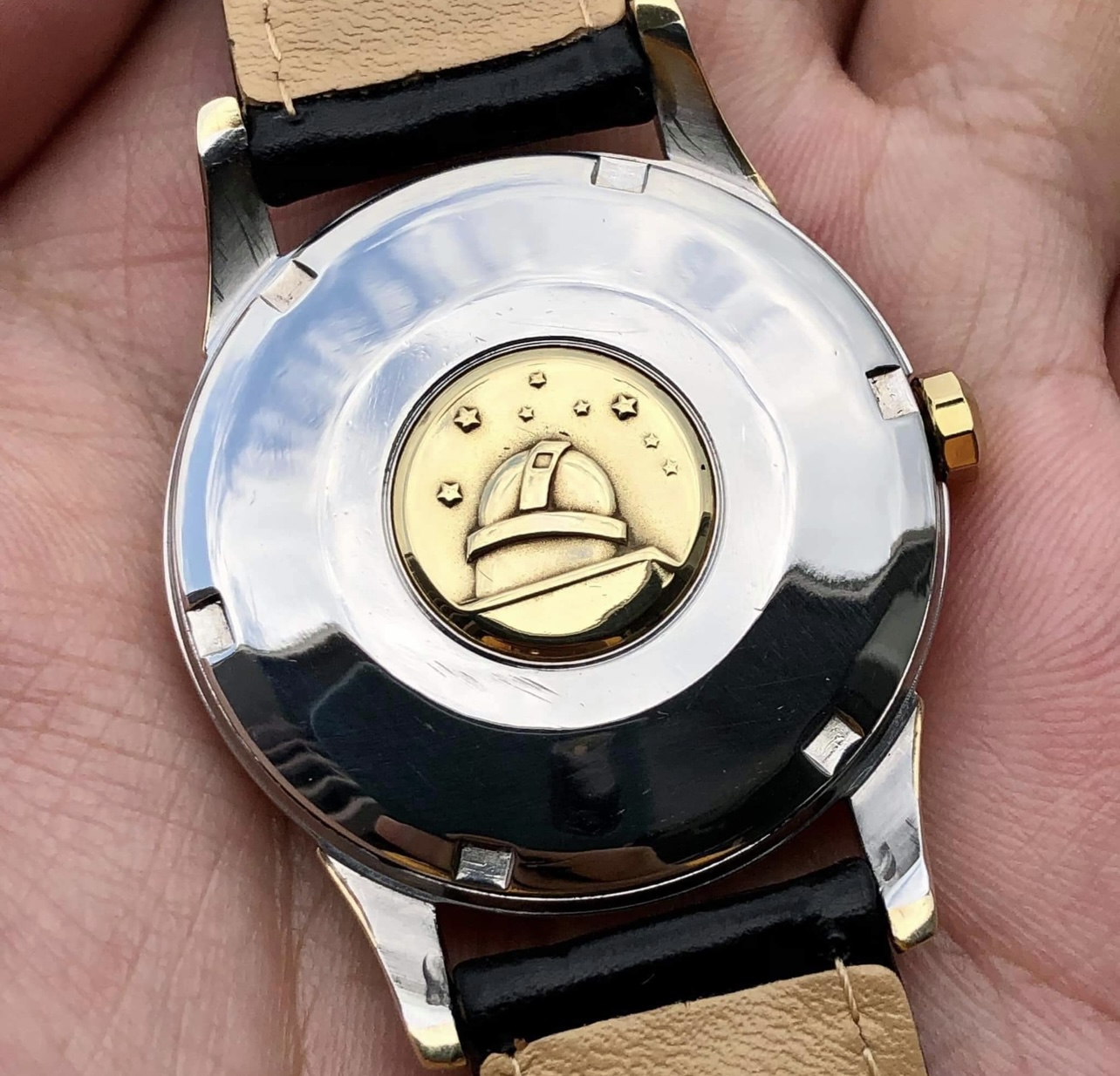

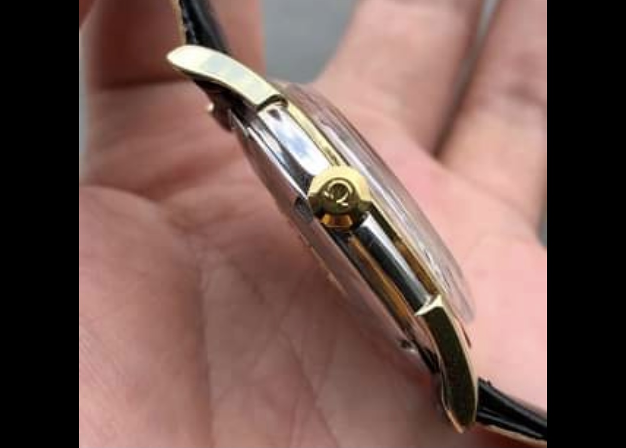

In my experience, the gold cap 14381s often look to have soft lugs, it is a consequence of the capping process. The all steel cases usually show a better defined lug and stand up to wear better.

Guys Tks for your feedback. It鈥檚 good to know it鈥檚 not a fake.
