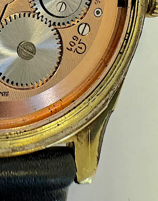

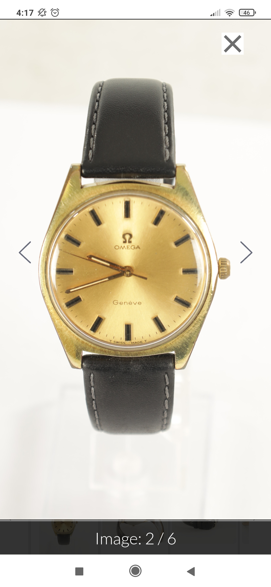

Hi,

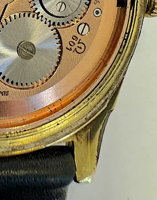

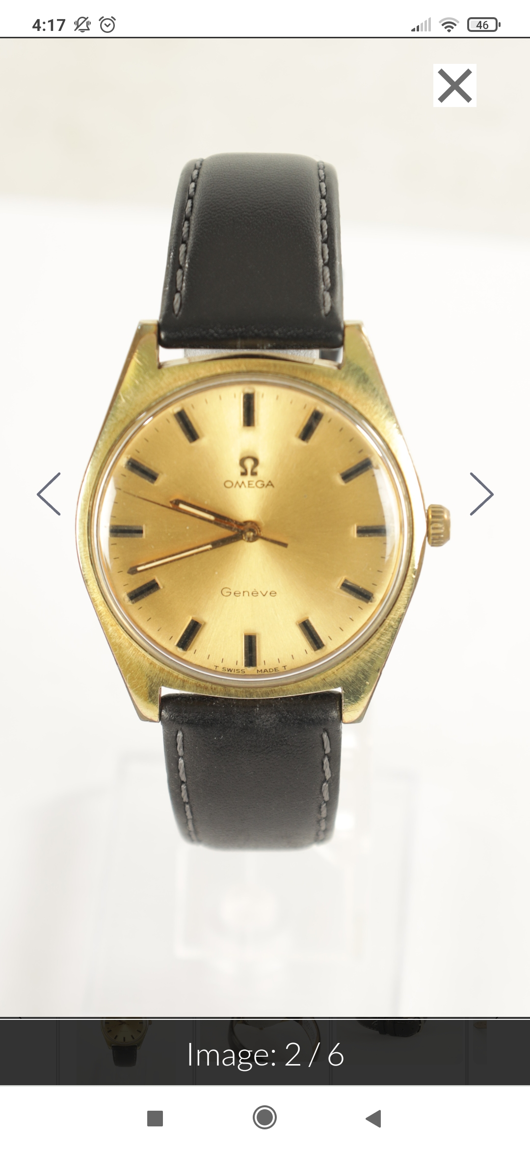

Hope you are having a wonderful Sunday. I collect hand winding watches. I do not have an Omega yet. I have seen the one in the picture and I am interested in it. Could you please kindly provide some insight? Is it real? How much should I pay for it ? (comes without a service)
Thanks a lot
May you be well and happy
18,847
39,198
It's all genuine (maybe the crown is a replacement.
Reference MD 135.041.
The gold plating is worn overall and corrosion has eaten away on the rear of one of the lugs.
Theses are relatively common and the all stainless steel version would be a better option.
As to price.
Depends on your location and how reckless you are with your watch budget.
Search eBay for sold listings for Omega Geneve 135.041
13,559
23,507
I’m not sure I’m seeing any corrosion. A bit of surface tarnish but that’s not an issue.
Entry level watch, maybe £250
13,495
31,815
As noted the case is severely worn, I wouldn't waste your money on this one.
13,559
23,507
I’m still unsure whether it’s corrosion or normal tarnish on the gold layer.
Kinda irrelevant anyway as the wear to the gold cap is severe enough.

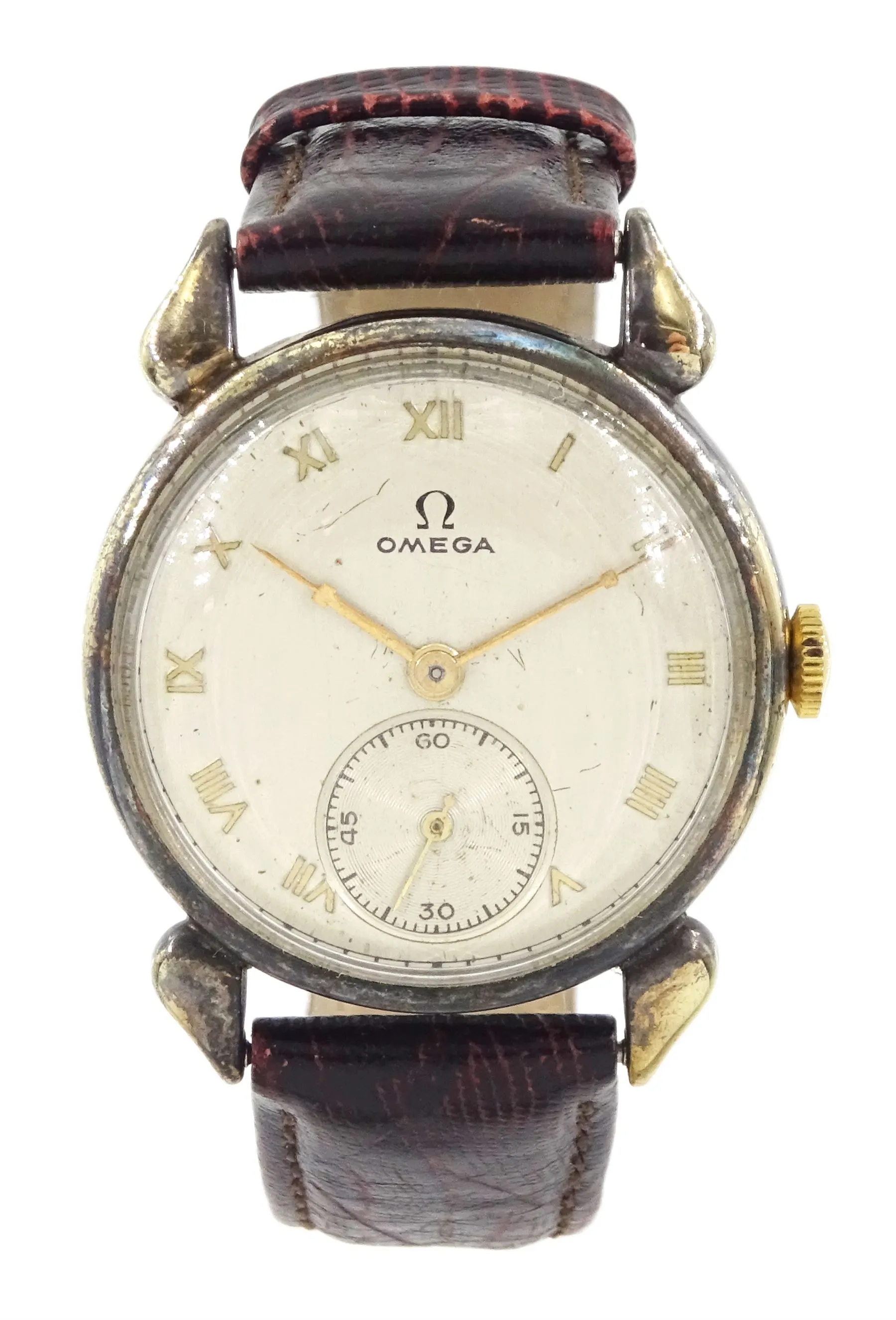

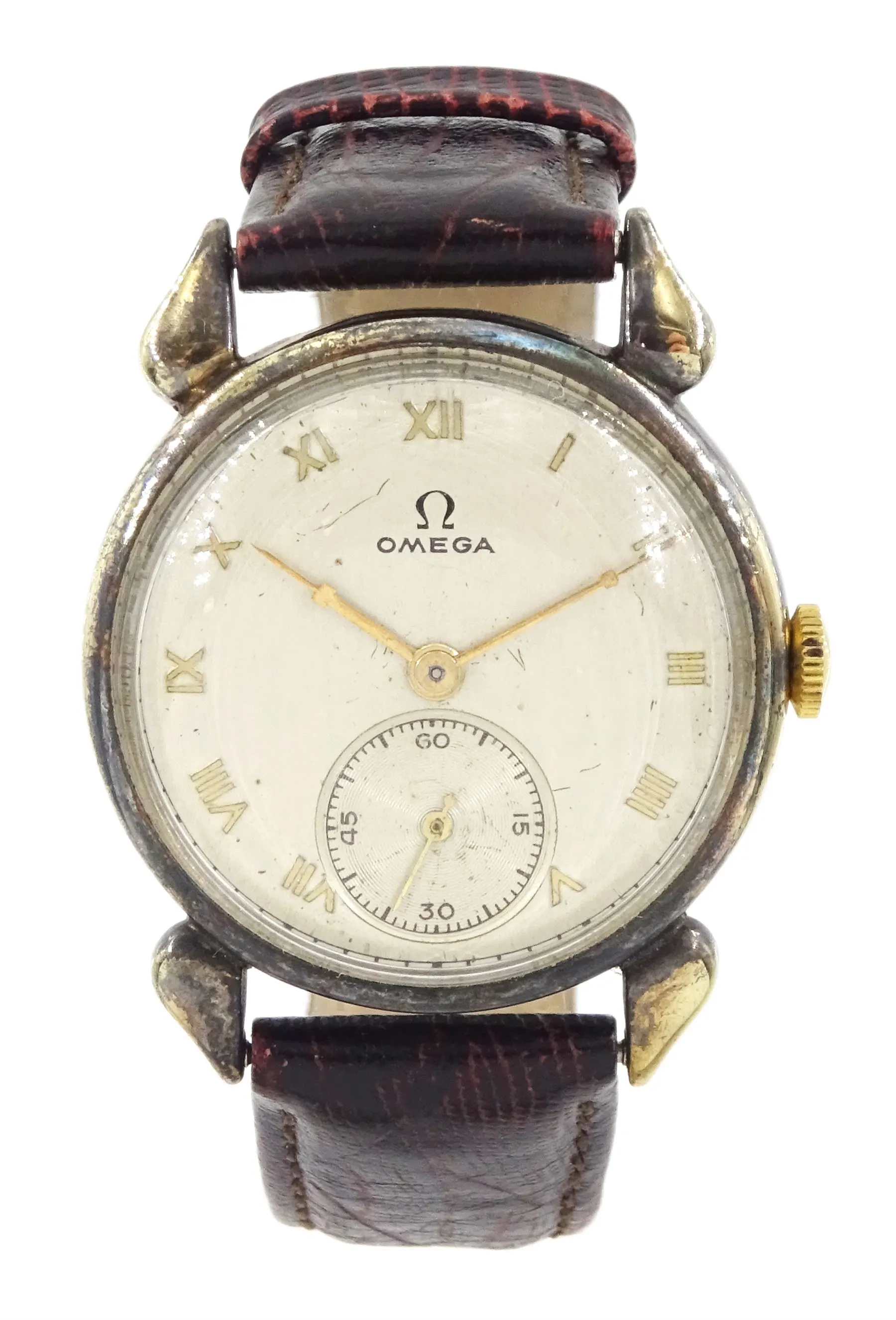

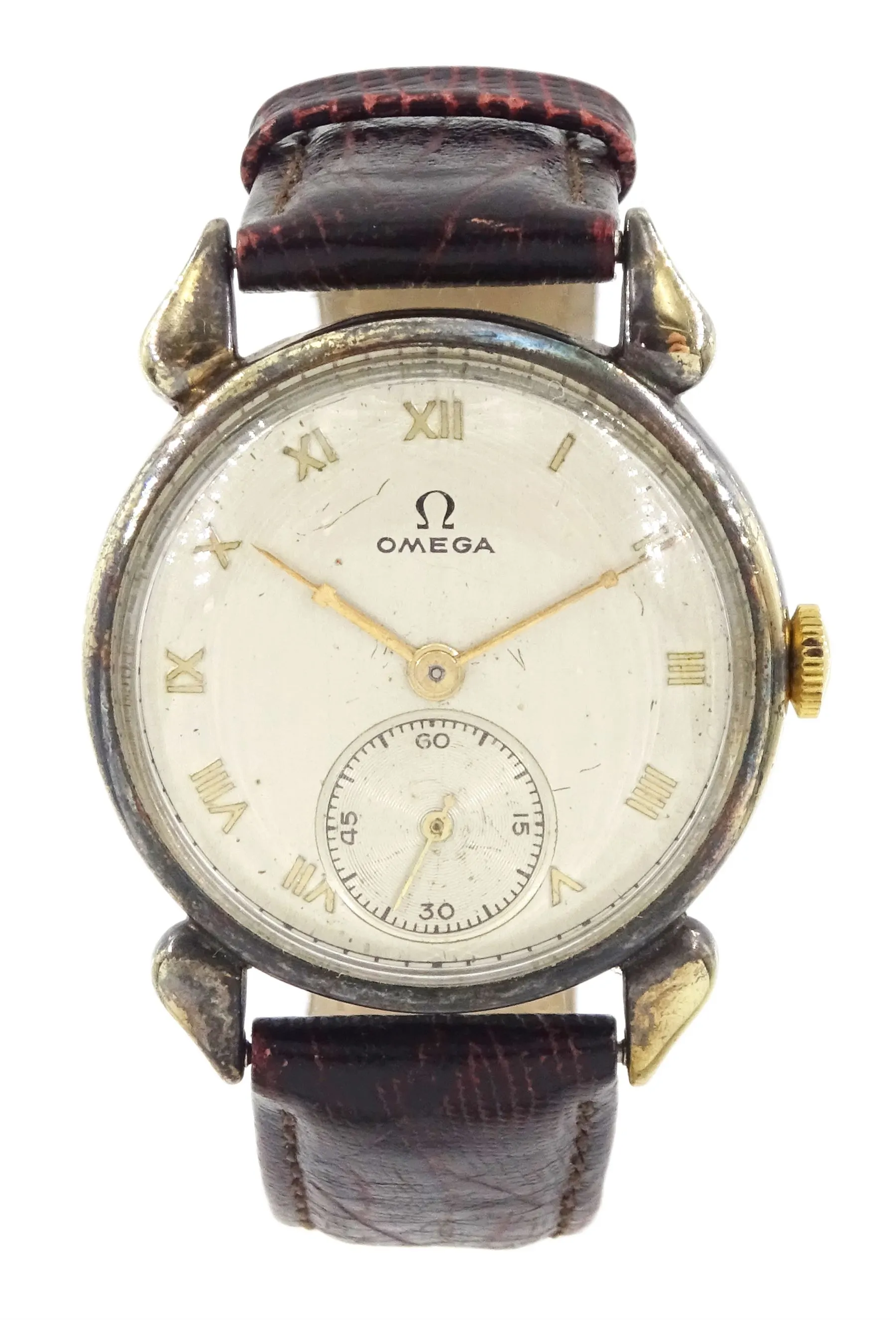

Thanks Jim. I also like the one below. What do you think? Other than it's really old. I am into old watches. I have never seen the one below anywhere else. Is it legit? Thanks
9
Description says "Omega 14K gold filled gentleman's manual wind wristwatch, silvered dial with Roman numerals and subsidiary seconds dial, case No. 13000, on brown leather strap"
9
The above says
Omega gentleman's gold-plated and stainless steel manual wind wristwatch, Ref. 14713-8, Cal. 268, silvered dial with Arabic numerals and subsidiary seconds dial, on black leather strap
Condition Report:
Movement functioning, hands moving freely, possibly replacement crown (not Omega), hairline split to acrylic cover, dial with some discolouration, case with some light scratches, deeper around the case opening, strap and buckle not Omega, case diameter = 32mm (excluding cr own
24,838
55,263
As noted above, the plating on the OP watch is completely worn away, exposing the base metal. It's legit, but a poor example of an entry-level vintage Omega.
The 2nd watch is also in very poor condition, and I'm not sure it's totally legit, TBH.
The third is probably legit, but very unappealing.
I suspect that you are finding all of these unattractive watches in poor condition because you are searching with a budget that is too low to get a decent Omega. Penny-wise and pound-foolish.
9

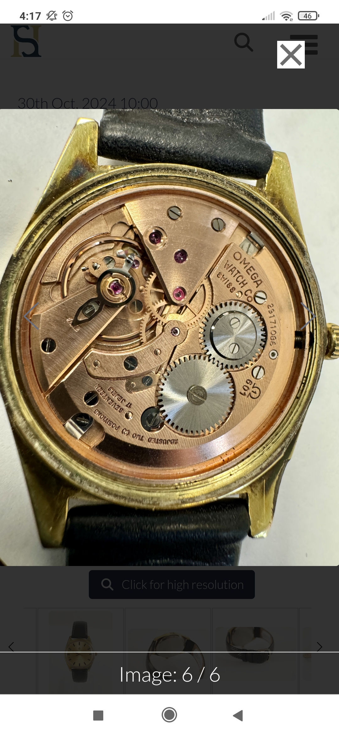

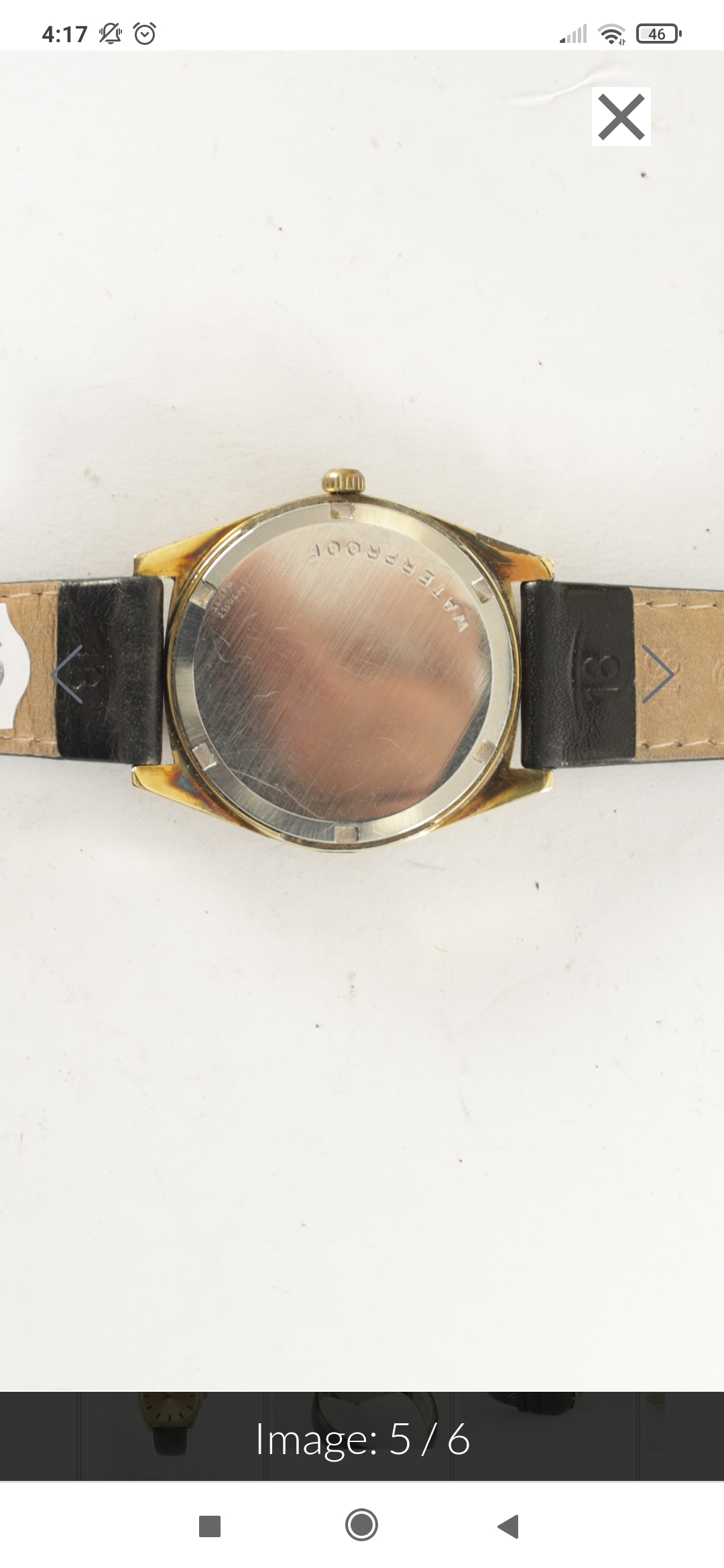

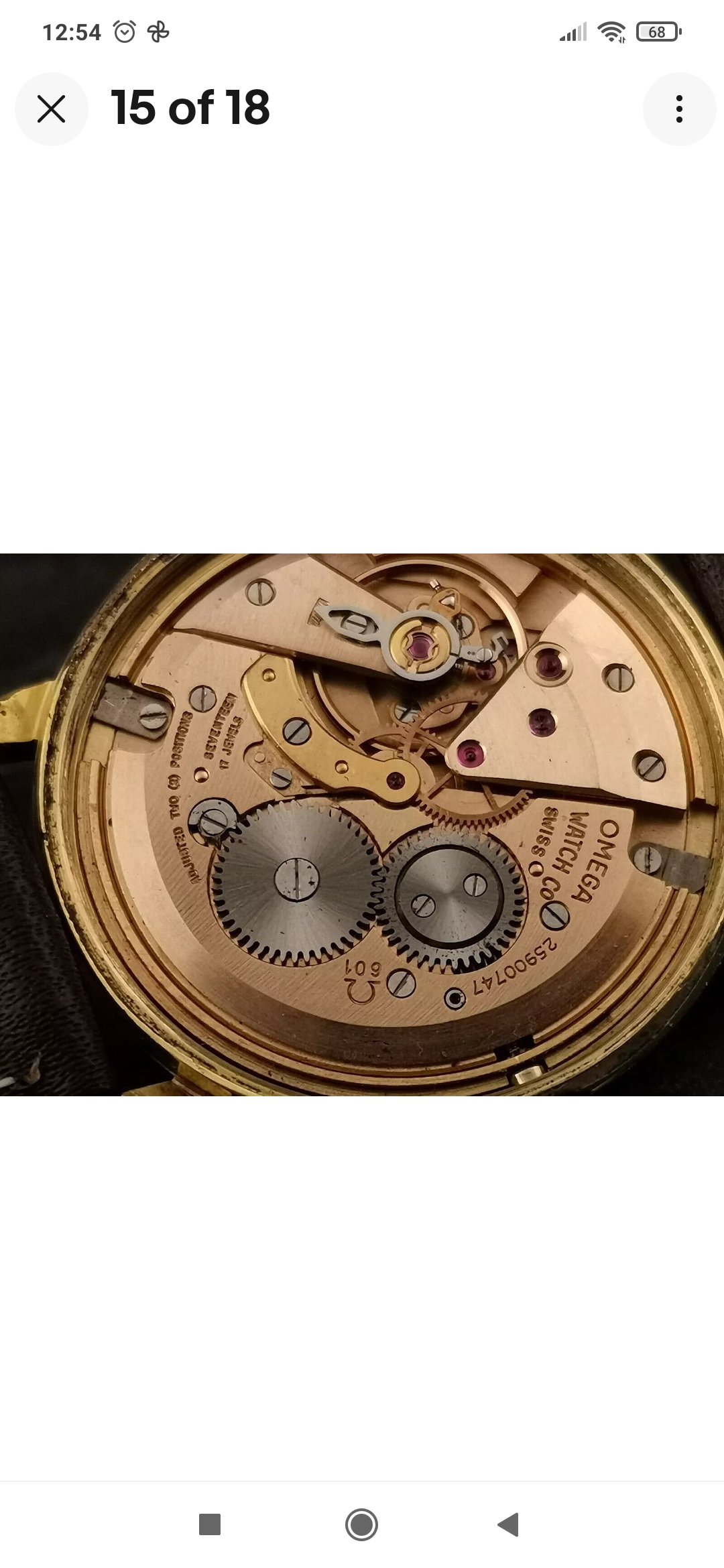

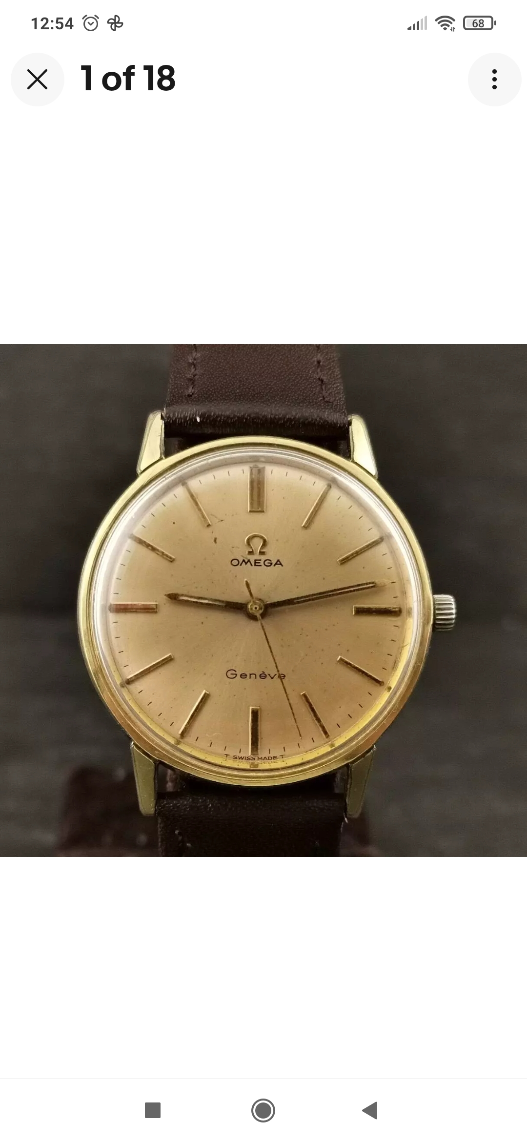

What about this movement? Is it better than the first one? Thanks for your help and patience
13,495
31,815
It’s not the movement that’s a problem it’s the very worn case again.
9
