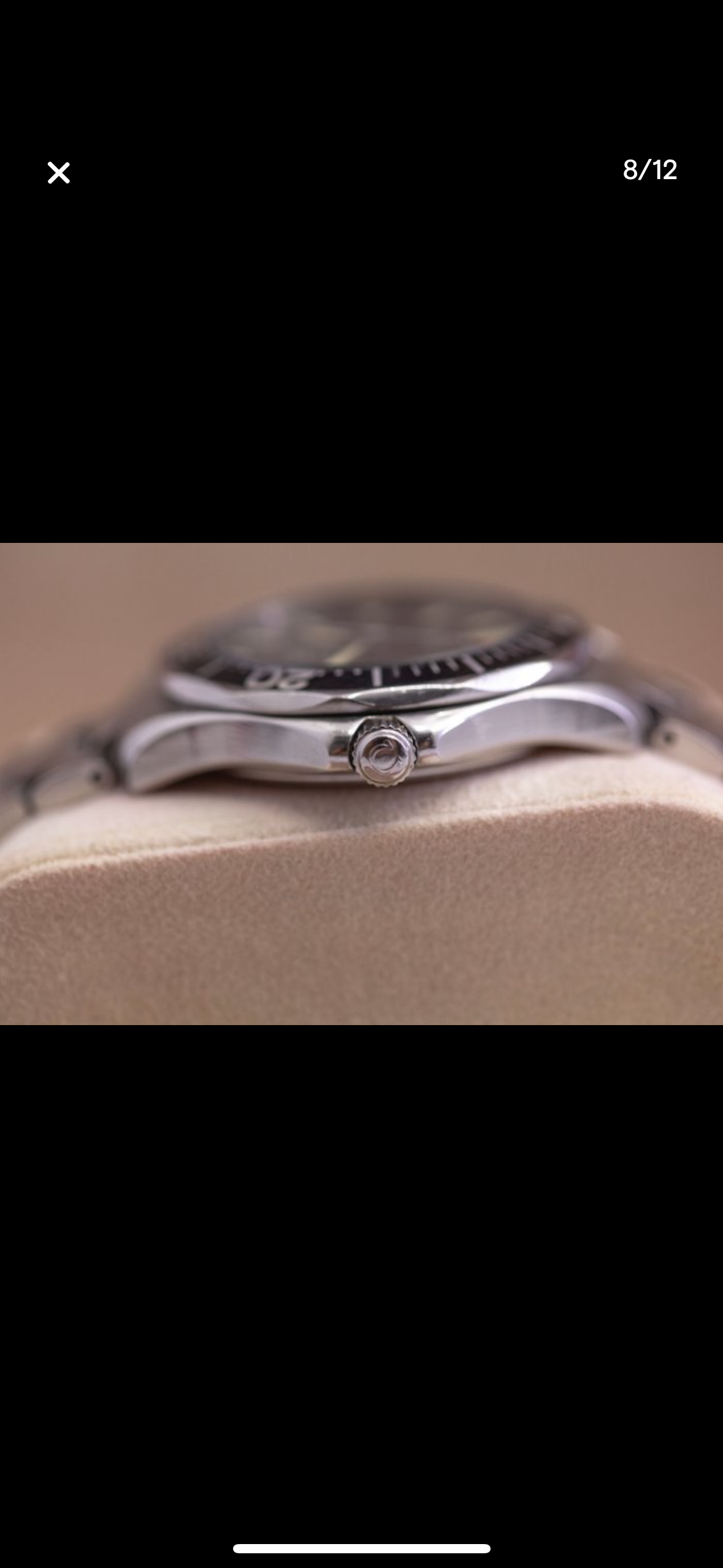

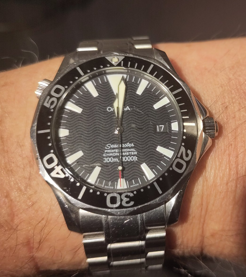

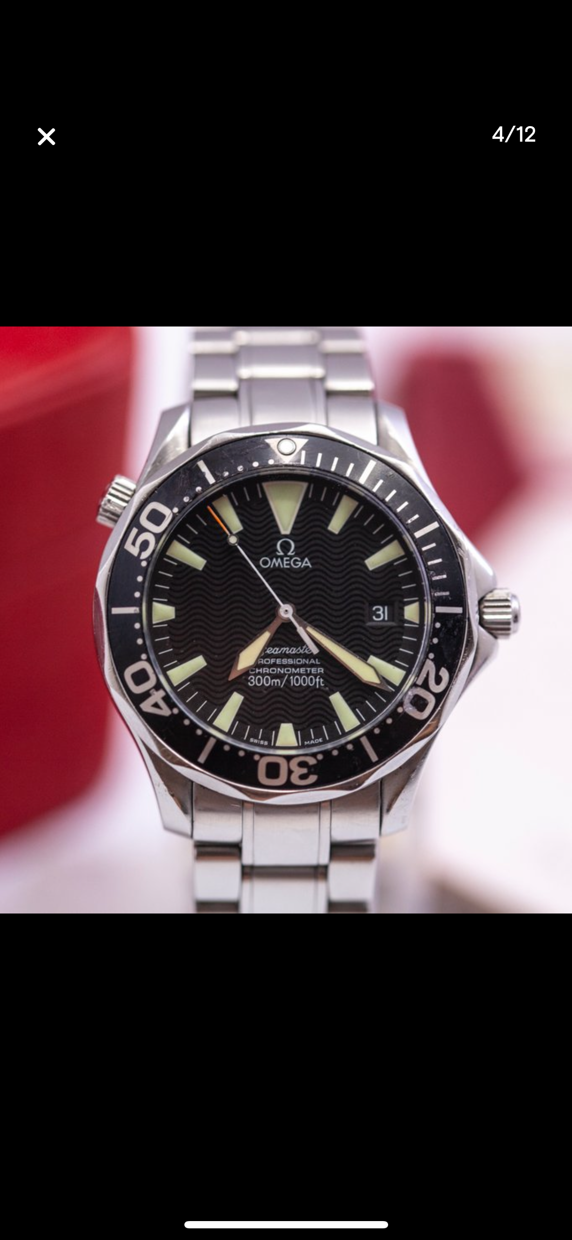

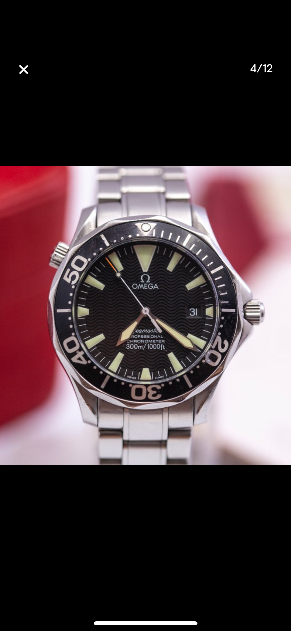

Hi all I have been offered this watch full set

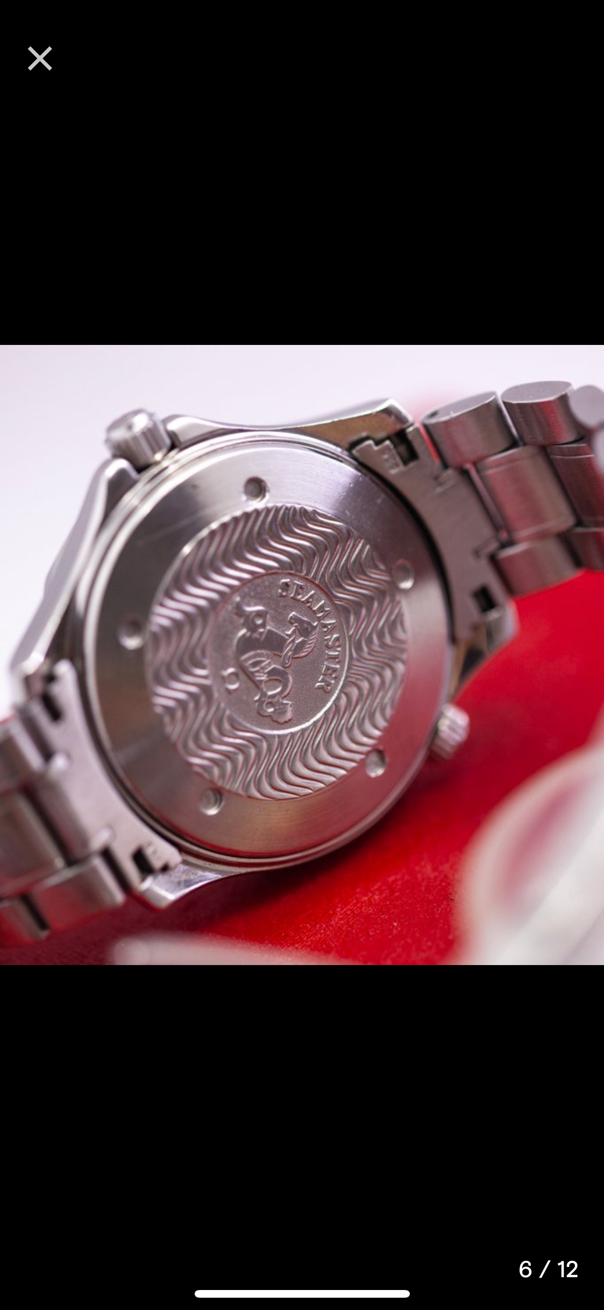

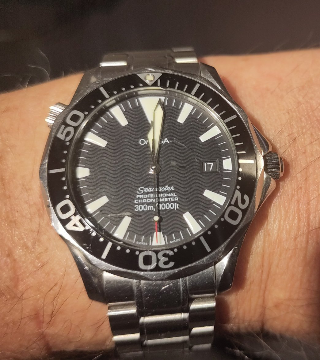

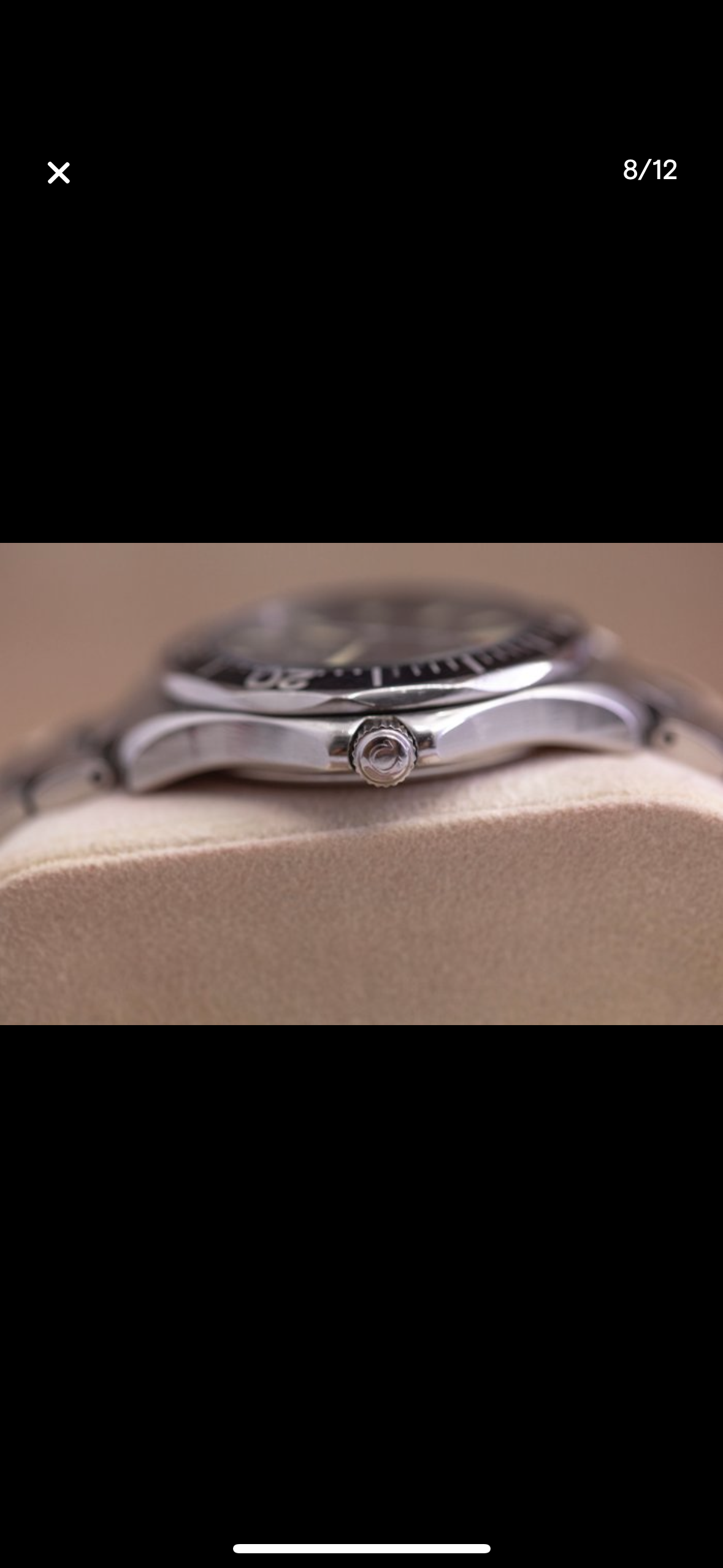

For around 2k which I think is a pretty good price however it seems that the ring under the bezel looks misaligned is there a simple fix for this or am I just seeing things ?
Especially noticeable at 12 and at the crown

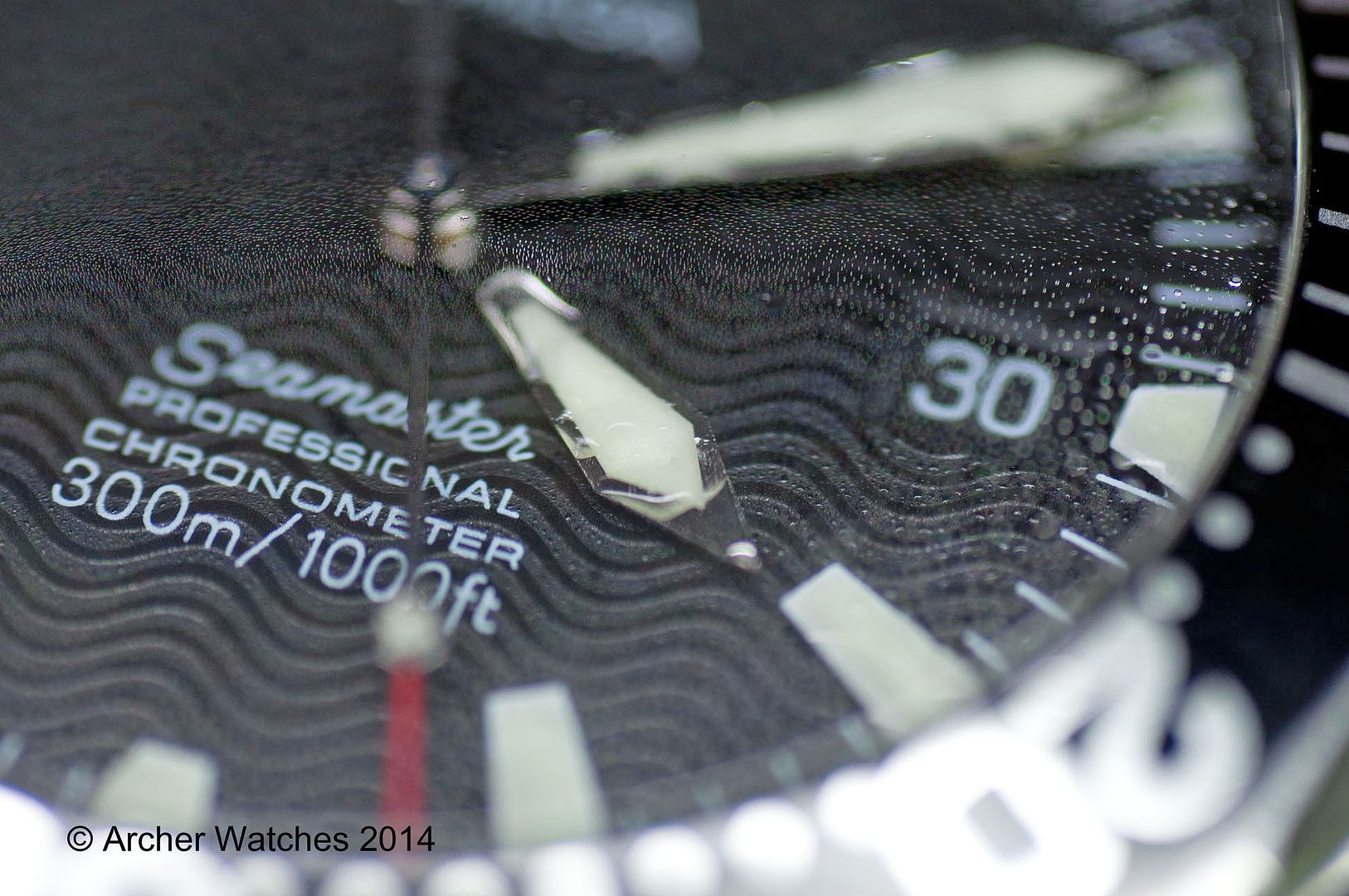

A 17 yo watch will be watertight until it isn't. How's your luck?

Do ya feel lucky?
2,781
4,707
Do ya feel lucky?
Nah That little bit of water won't hurt much....better to wait until it gets some orange crunchy bits and a heap of green furry stuff growing in there!

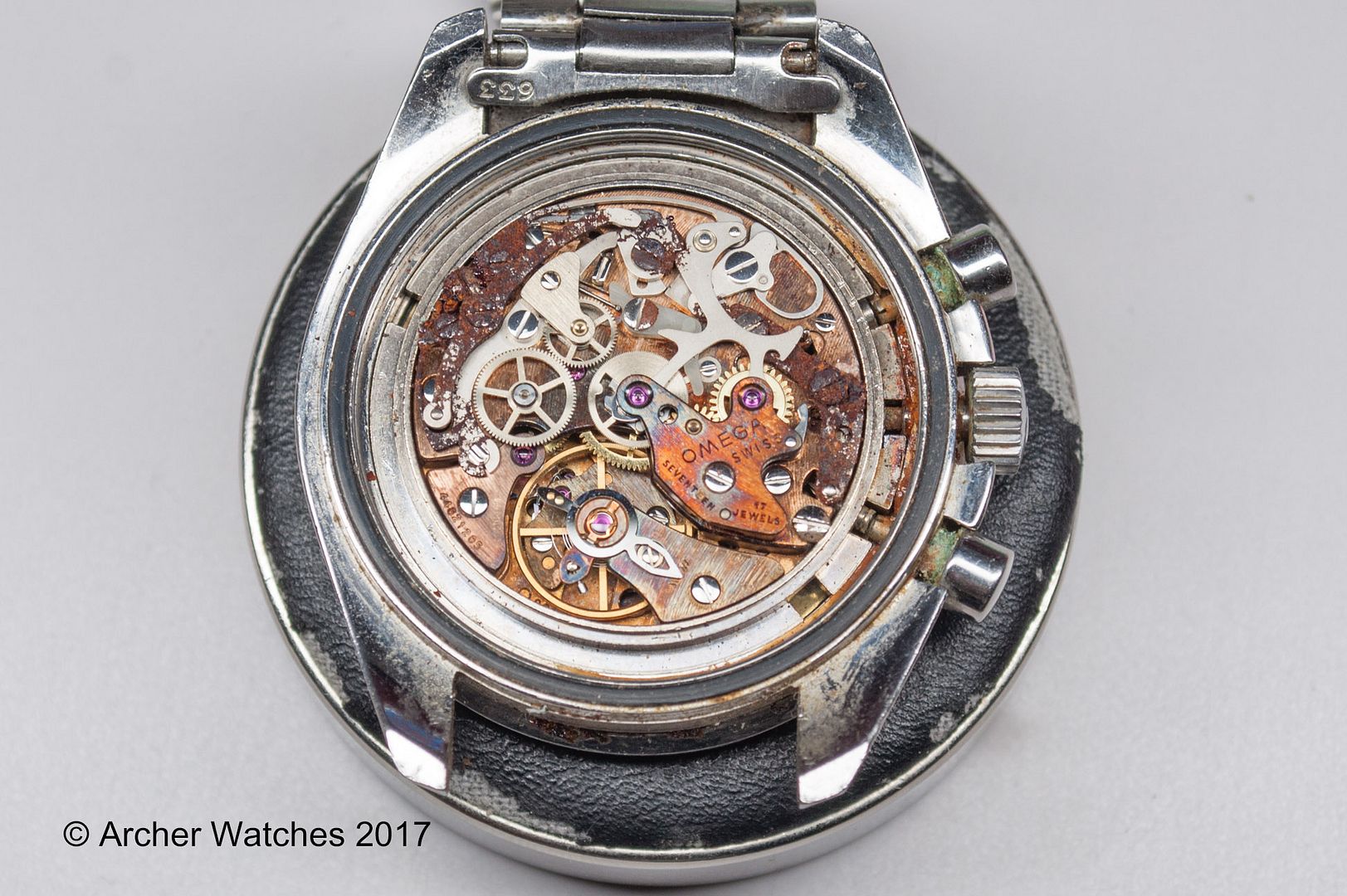

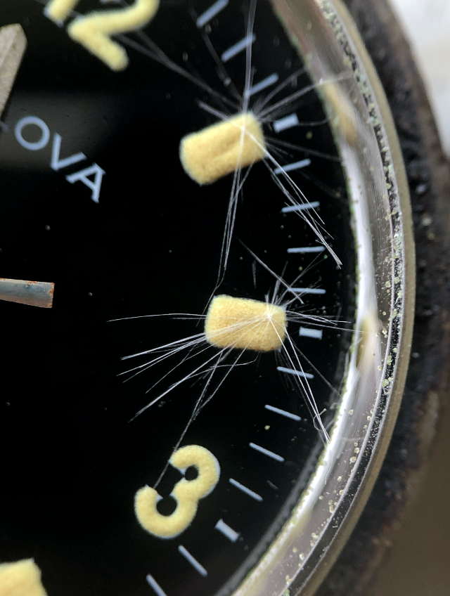

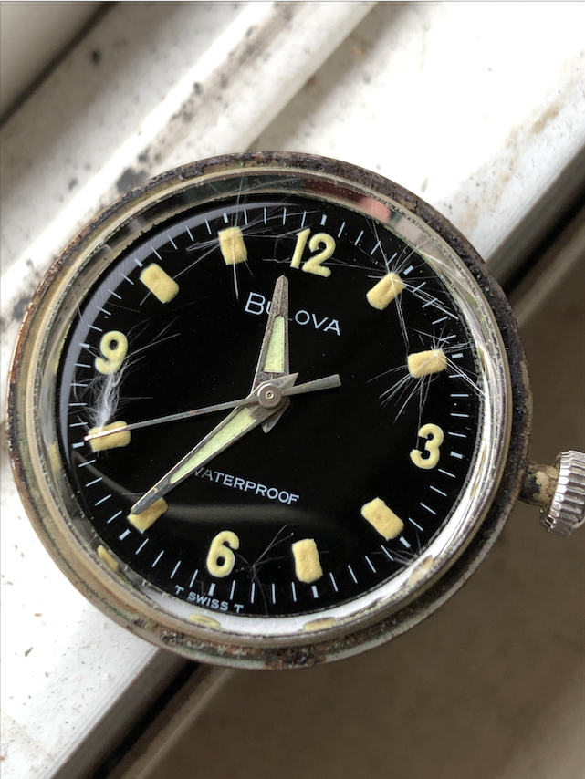

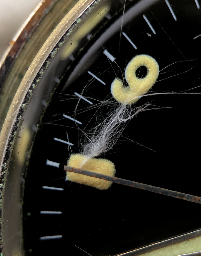

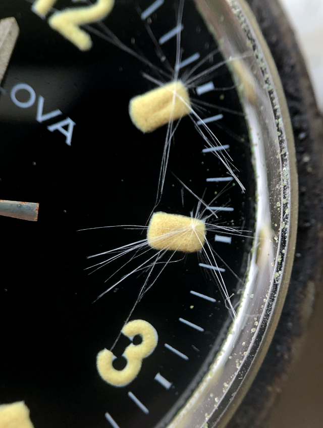

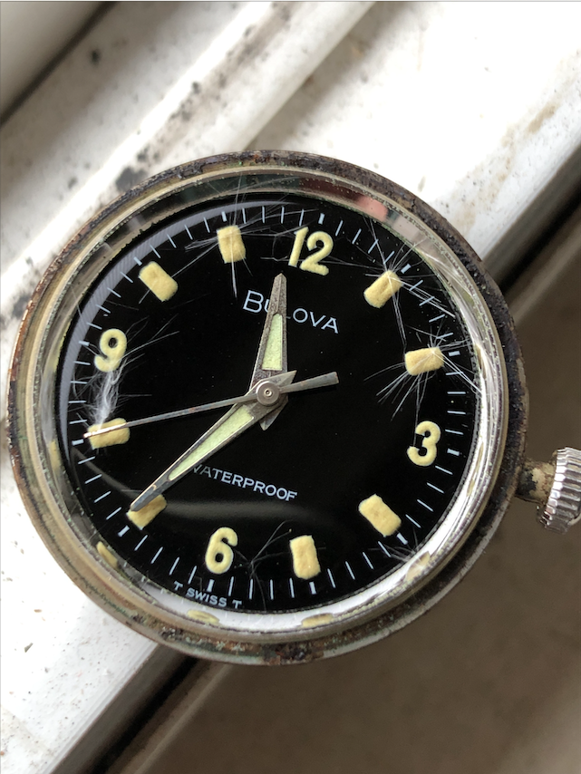

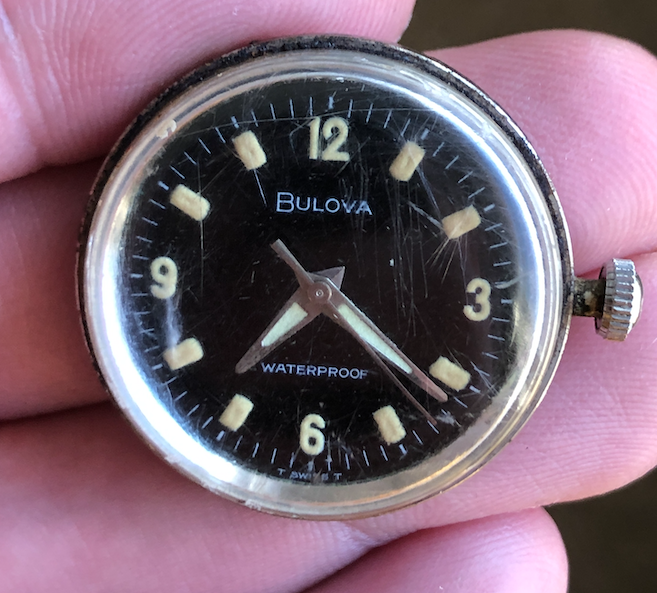

You mean like this?
Or maybe this?
2,781
4,707
You mean like this?
Or maybe this?
Yeah that's got the orange crunchy stuff, but it needsthe green furry stuff growing in it too, not worth doing until that happens!

Having the triangle not aligned is quite often flaw. Pull the bezel from the case and press out the bezel insert. Press back the bezel on the case, give it some turn to seat properly, align the insert in the bezel, so it points directly to 12 index and press in the bezel insert. Done.
Pull the bezel from the case, using the correct tool or you will bend it. Press out the aluminium insert with out bending or breaking that. Use some kind of solvent or heat to loosen it , depending on what type of glue the last "watchmaker" used to fasten it in-correctly. Use the correct press to re mount the bezel back on to the case, after cleaning it and changing worn out springs, without bending it even moore. Align the insert in the bezel and use the correct glue to secure it in the correct position.
Or just go to your watchmaker. Done
You make it sound so easy!

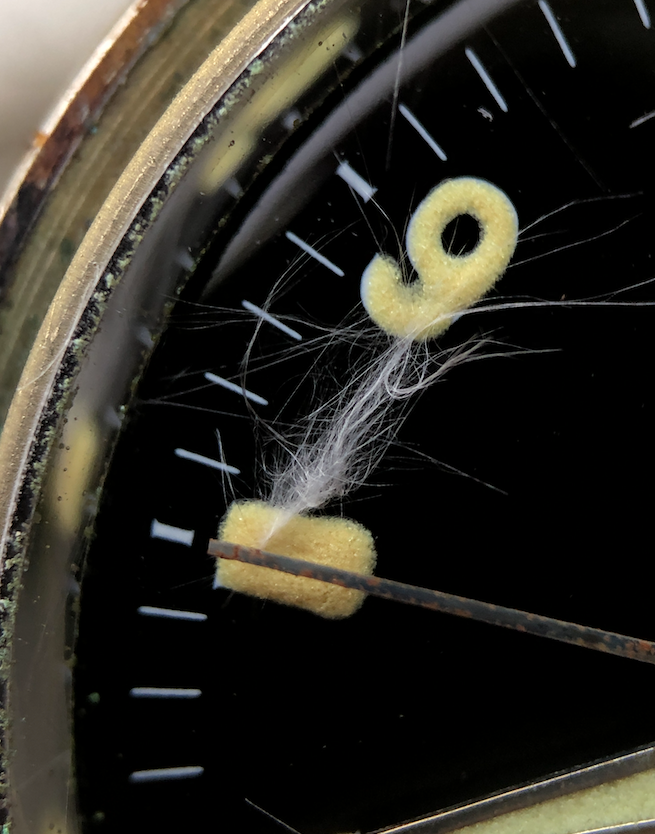

That watch is growing pubes!
Well I assume the ones @ 3 are as they're just above and behind the knob.........therefor the ones at 9 must be arse hairs
You are trying to send watchmaker to watchmaker? 😀 Funny ....
.... the bezel insert is not fixed by any glue...I mean original insert. Glued are usually aftermarket inserts... the original is held by friction, no glue at all...
I am glad I could amuse you, and maybe prevent someone from following your "watchmaking" tips.
@napalmsunrise dont mention anything about being a watchmaker and thats probably why you gave him this questionable advise.
How do you know this example dont have any glue?
