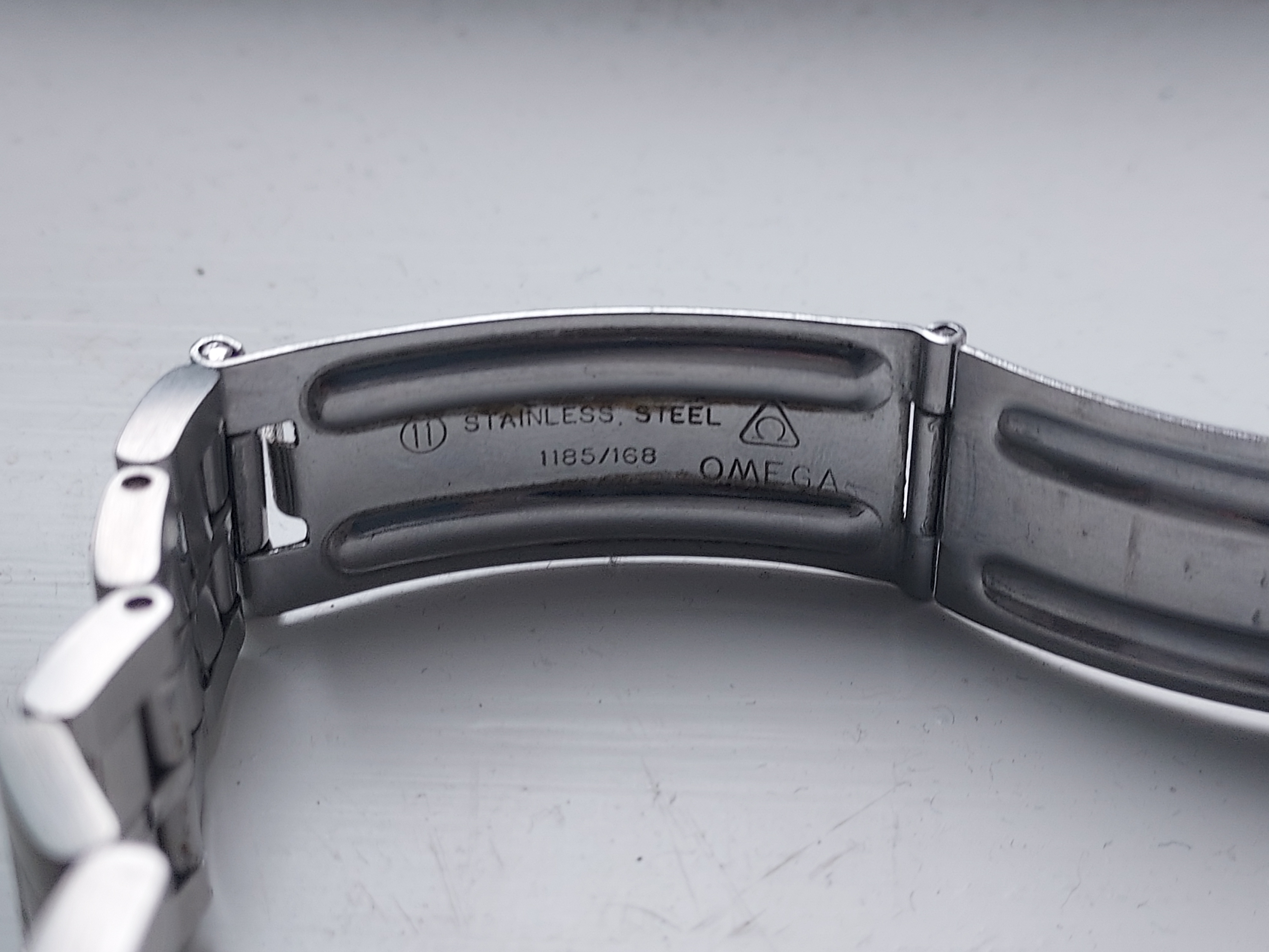

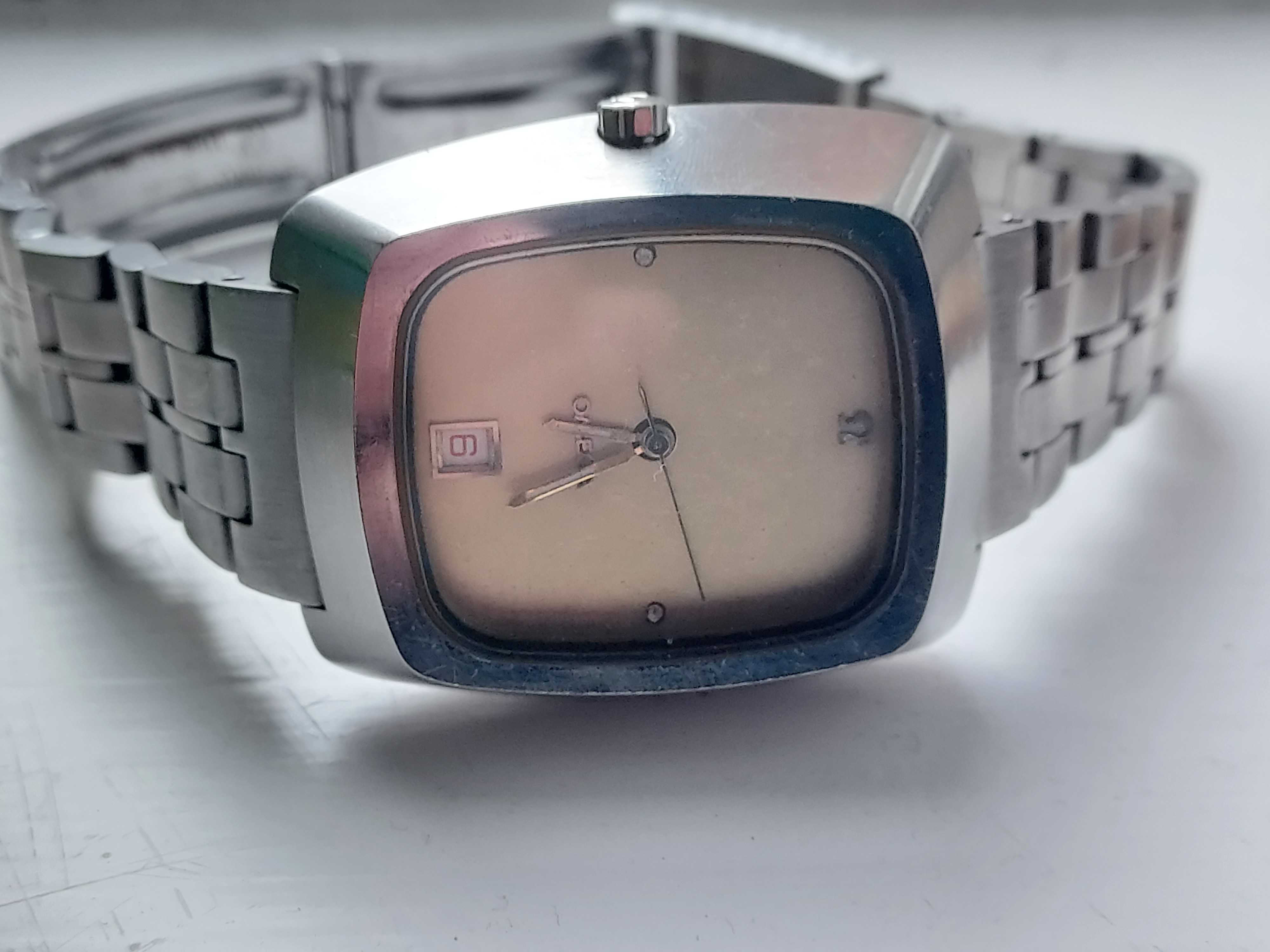

Anyone able to advise on this Omega model, serial number dates to 1970, needs some attention, trying to determine if worth fixing or sell as parts, bracelet number 1185/168

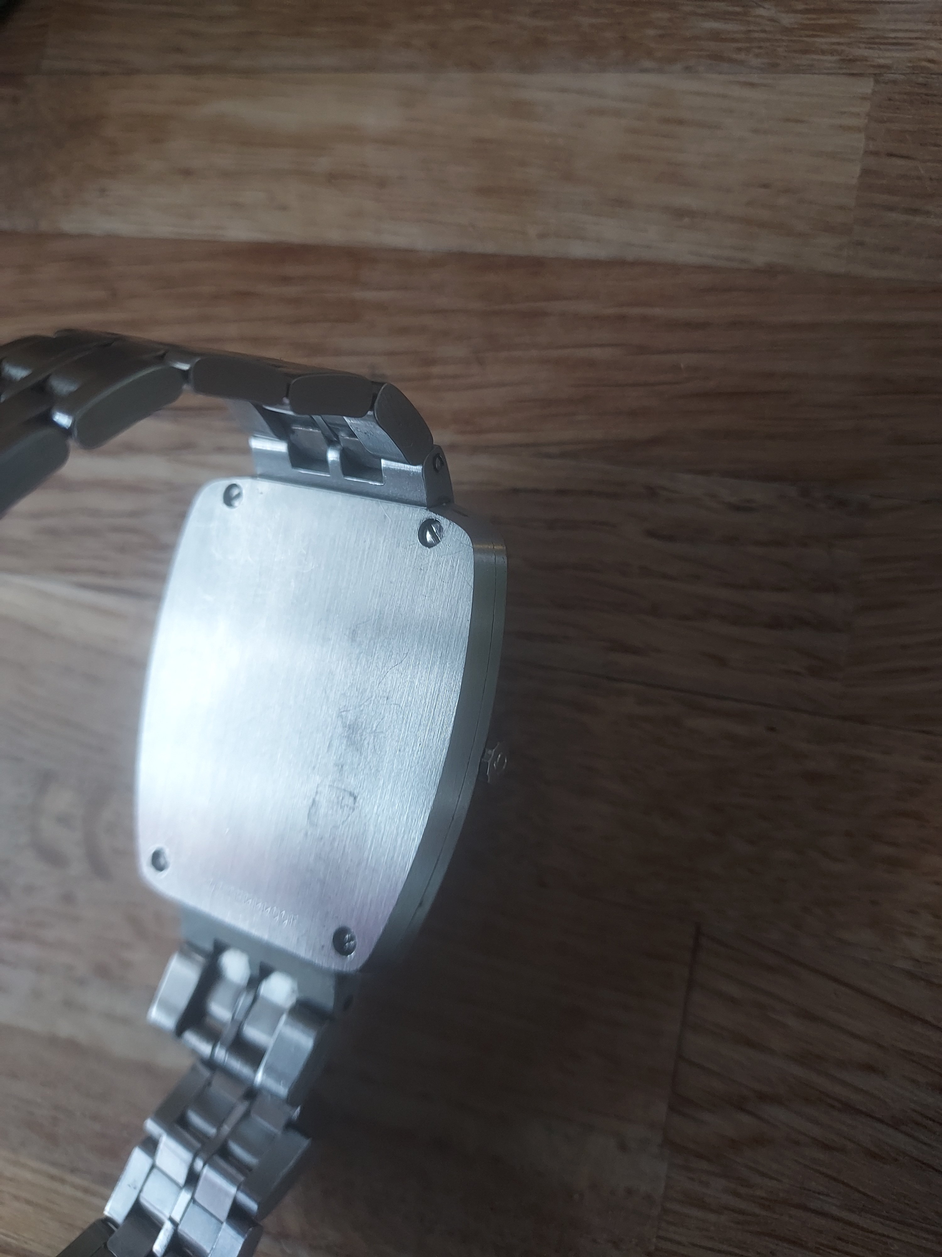

I have a lot of questions about the watch. The best place to start is take the back of the case off and take clear photos of the movement (include all numbers) and the inside of the caseback. A photo of the outside of the case back might tell us a lot.

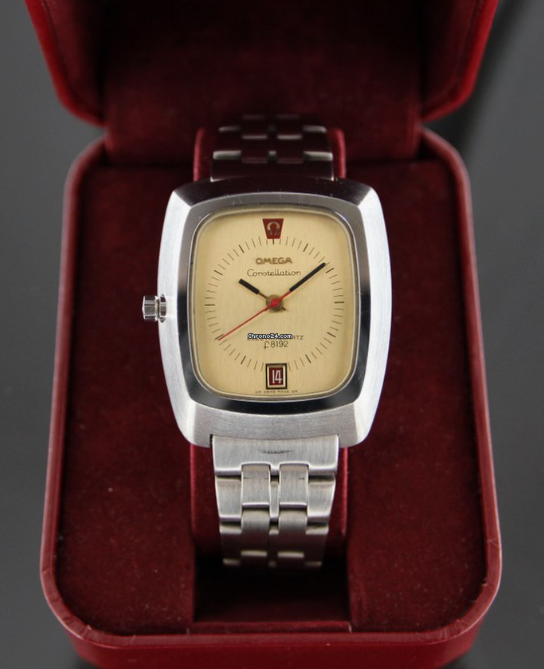

This could have been an Omega Constellation Electroquartz f8192 in its former life. Dial is damaged/ looking strange. Case, bracelet and crown might be correct. Datewheel should be red. Maybe another model?
Caseback fixed with four screws? Open it and use Google for further information.

Left handed? This one was at Sotheby’s.

I think, they are all left handed. Did not see another yet. Just like this one:

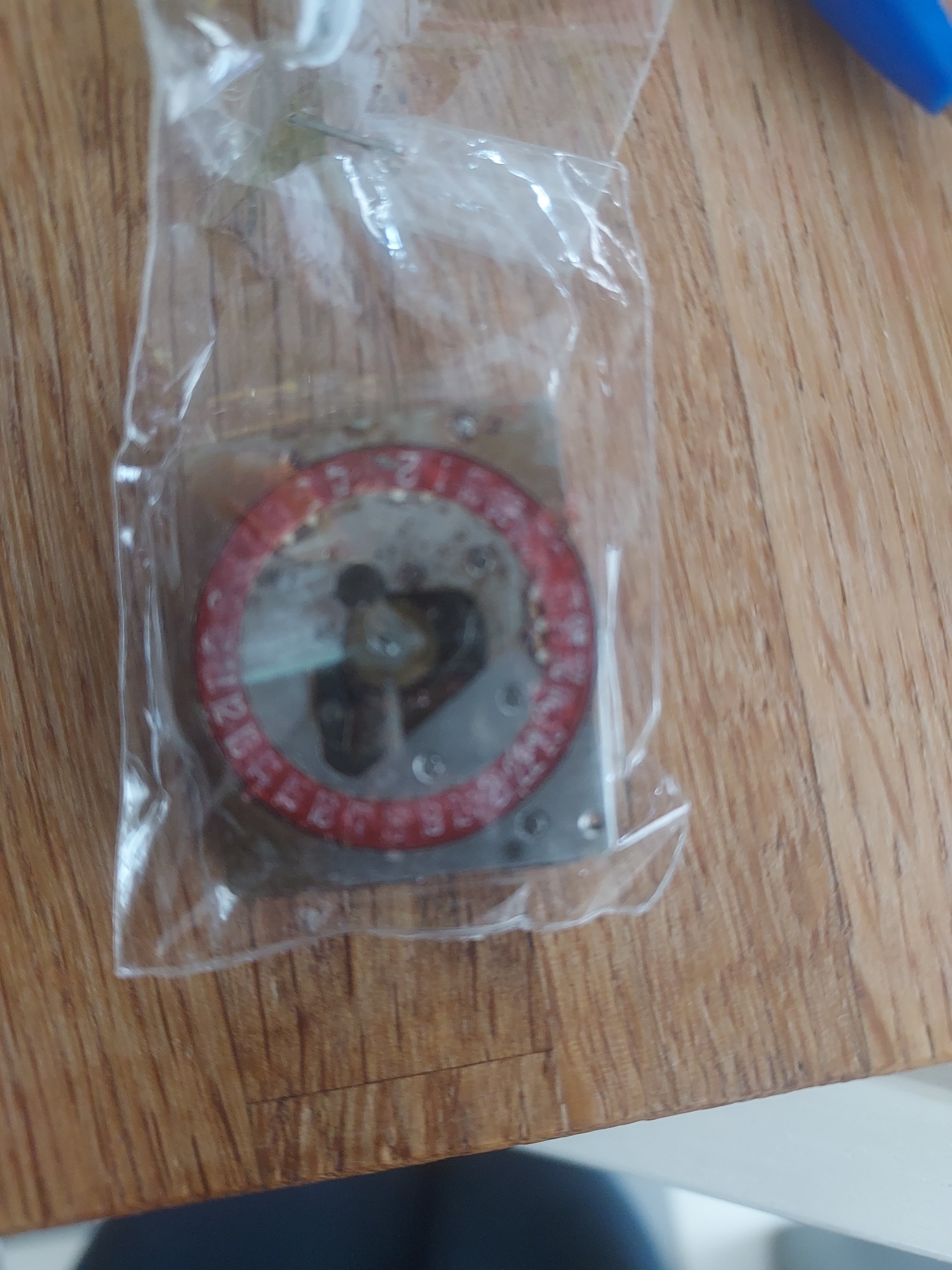

Thanks all, 4 screws at the back, think your right on its previous life as an electroquartz. Got the watch at an auction as a project, was water damaged in 2010 and a horrendous fix job undertaken, previous quartz was included in sale after i contacted auction house, red wheel. Ill decide on whether ill try and reinstate to former glory, not like parts are easy to come by

Probably not worth the time, effort and cost to restore it unless you really like the original design. Would be a pass for me, I wouldn't need the aggravation.

You could sell it as case/bracelet/spare parts, but not realistic to restore it

Yes, a lot of examples with wrong bracelets outside. Try to sell as parts, start with the bracelet. Love these ones in general. But not this one🙁.

I do not think it worth to restore it as long you do not have "feelings" for that watch.
