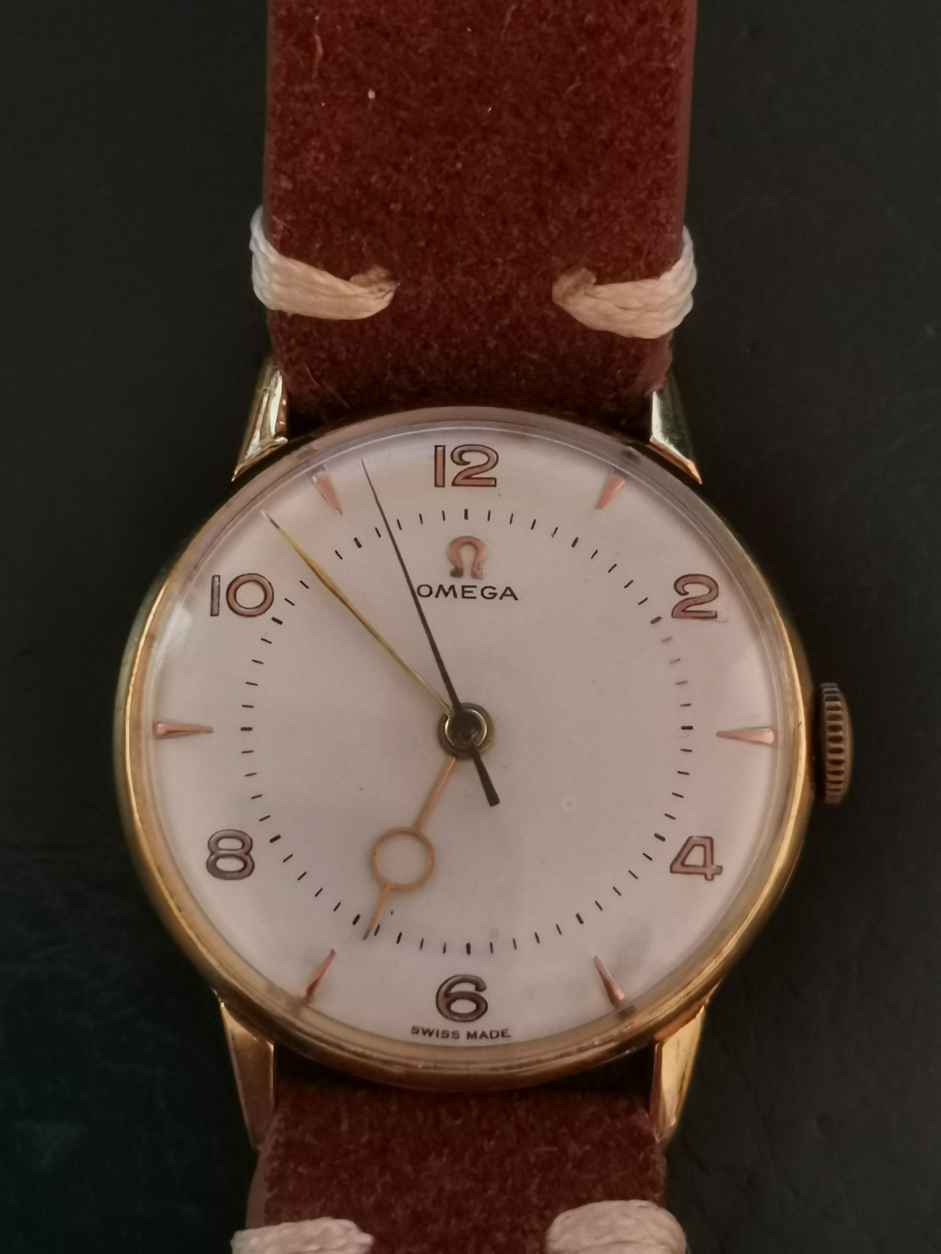

Hello Forum members.
I'm looking to identify the Omega I own.
Can anyone give me a help?
13,506
31,844
Based on your one poor photo I'd say it's likely a locally cased watch with no Omega reference. There may be some identifying information marked inside the case back and on the movement.
13,506
31,844
We need large in focus photos to help.
Front, back, inside and movement.
6

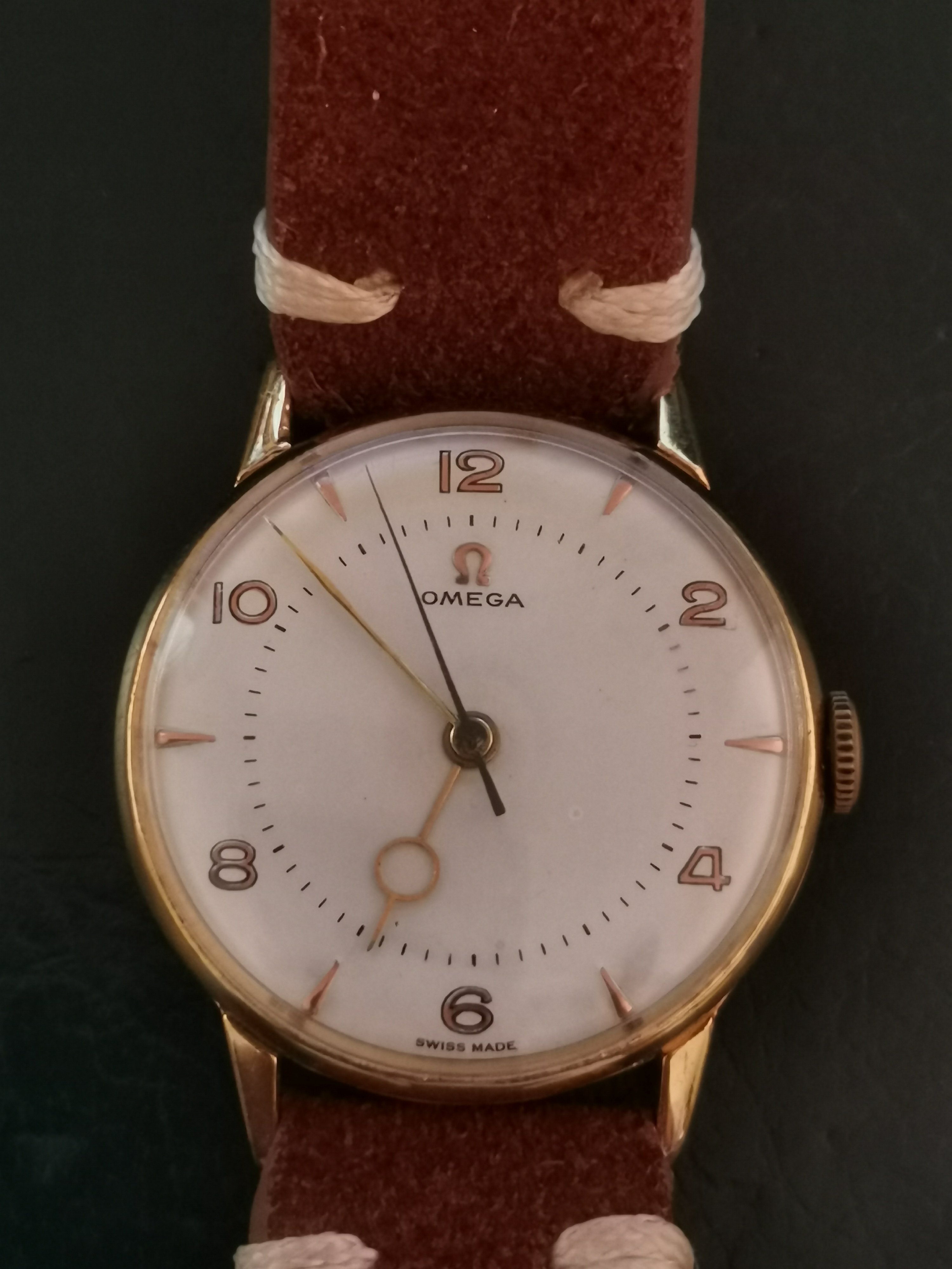

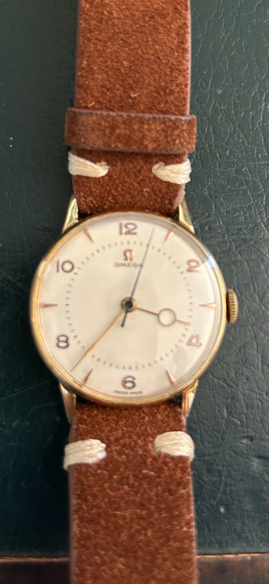

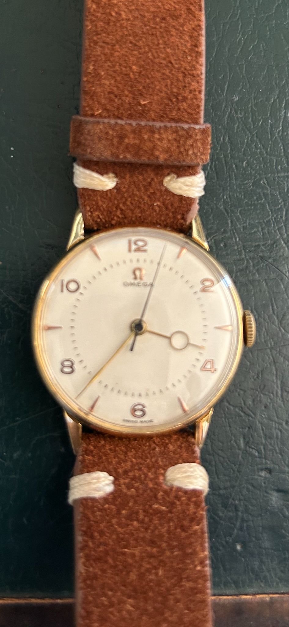

Manual Winding Cronograph - No date - Golden hands - Monocle hours hand - 1945 model
10,829
16,847
Chronograph? With no way to measure elapsed time and no pushers. I think not. How do you know it is from 1945? Show a pic of the movement and inside the caseback and you'll get an answer.
10,829
16,847

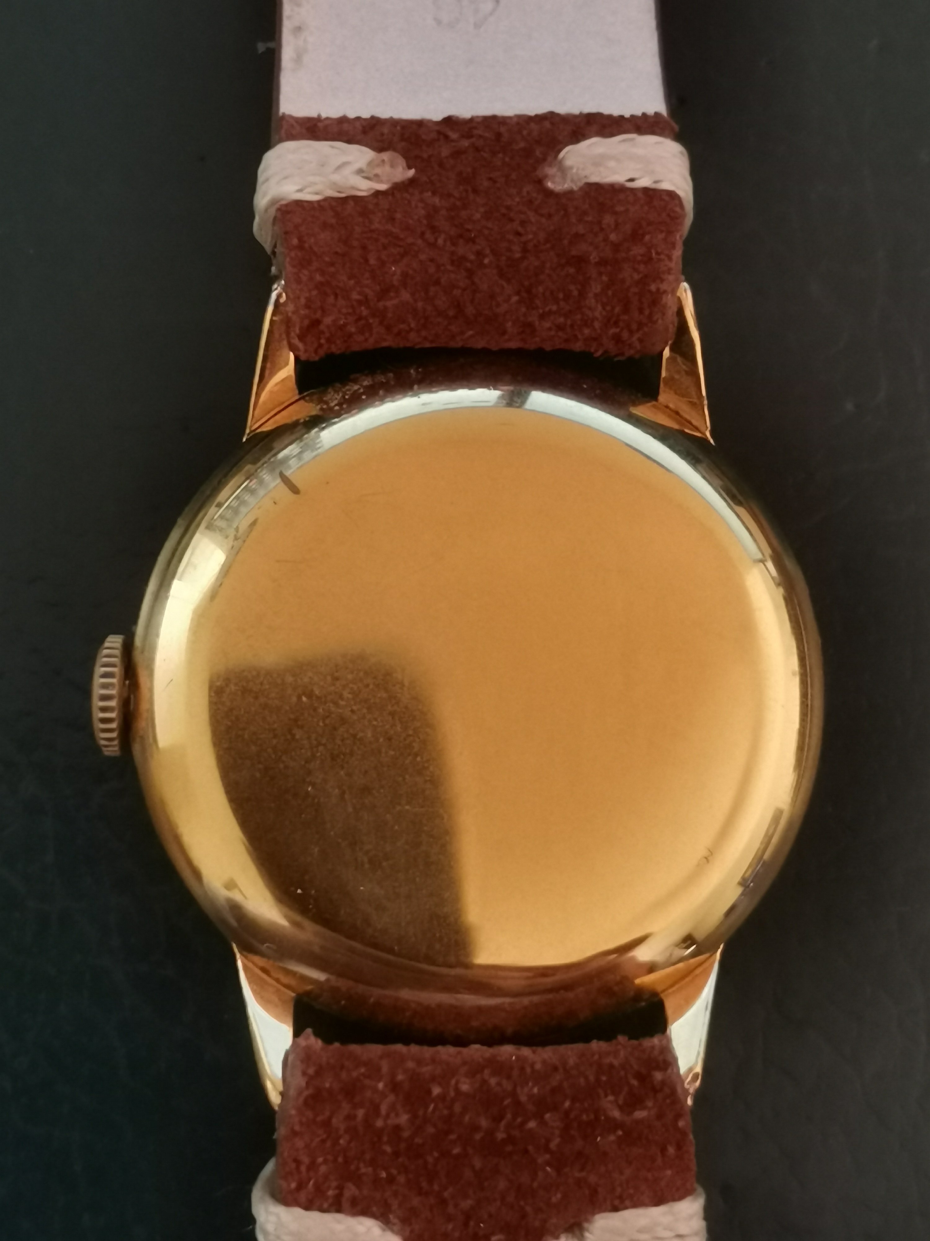

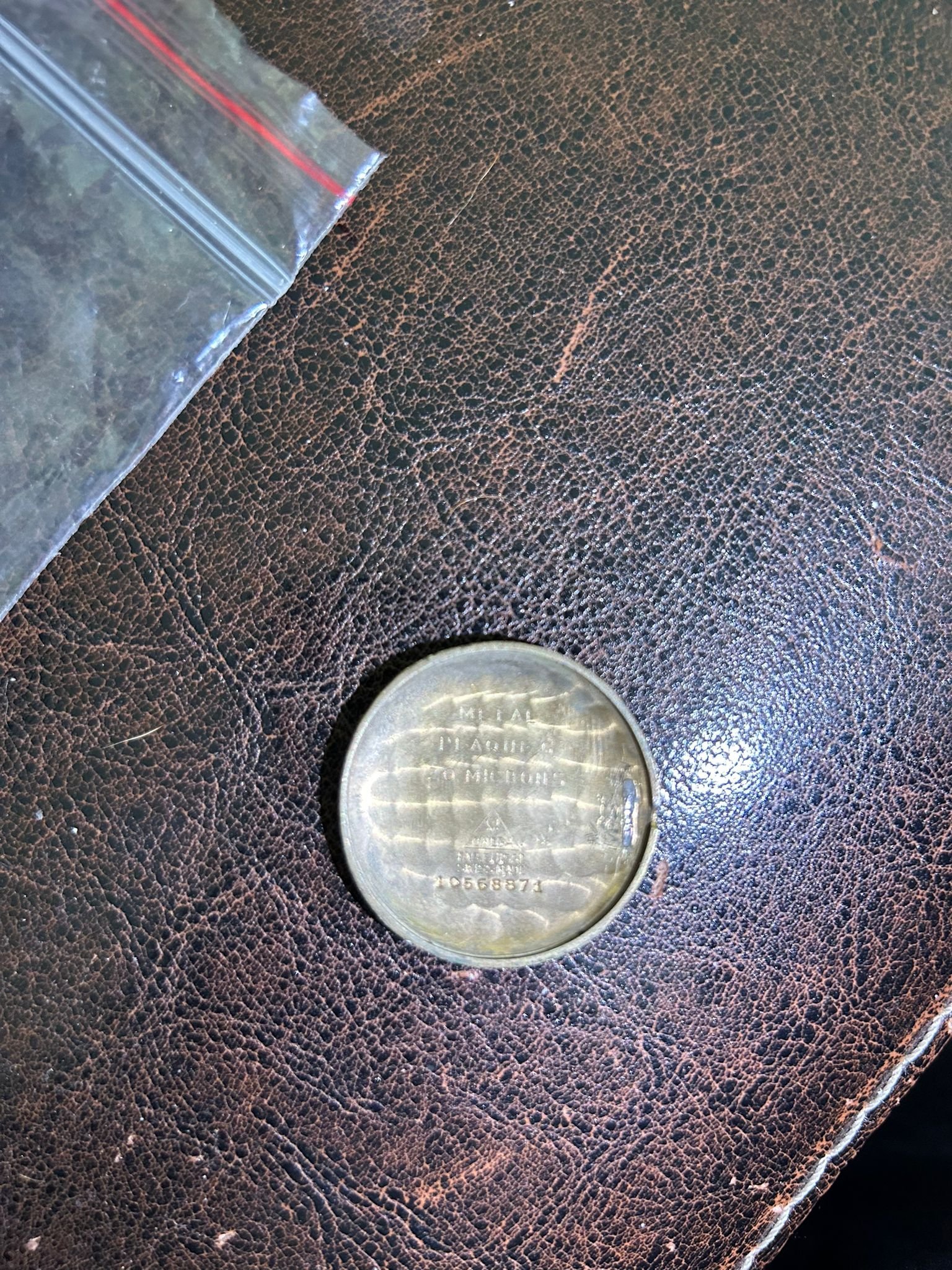

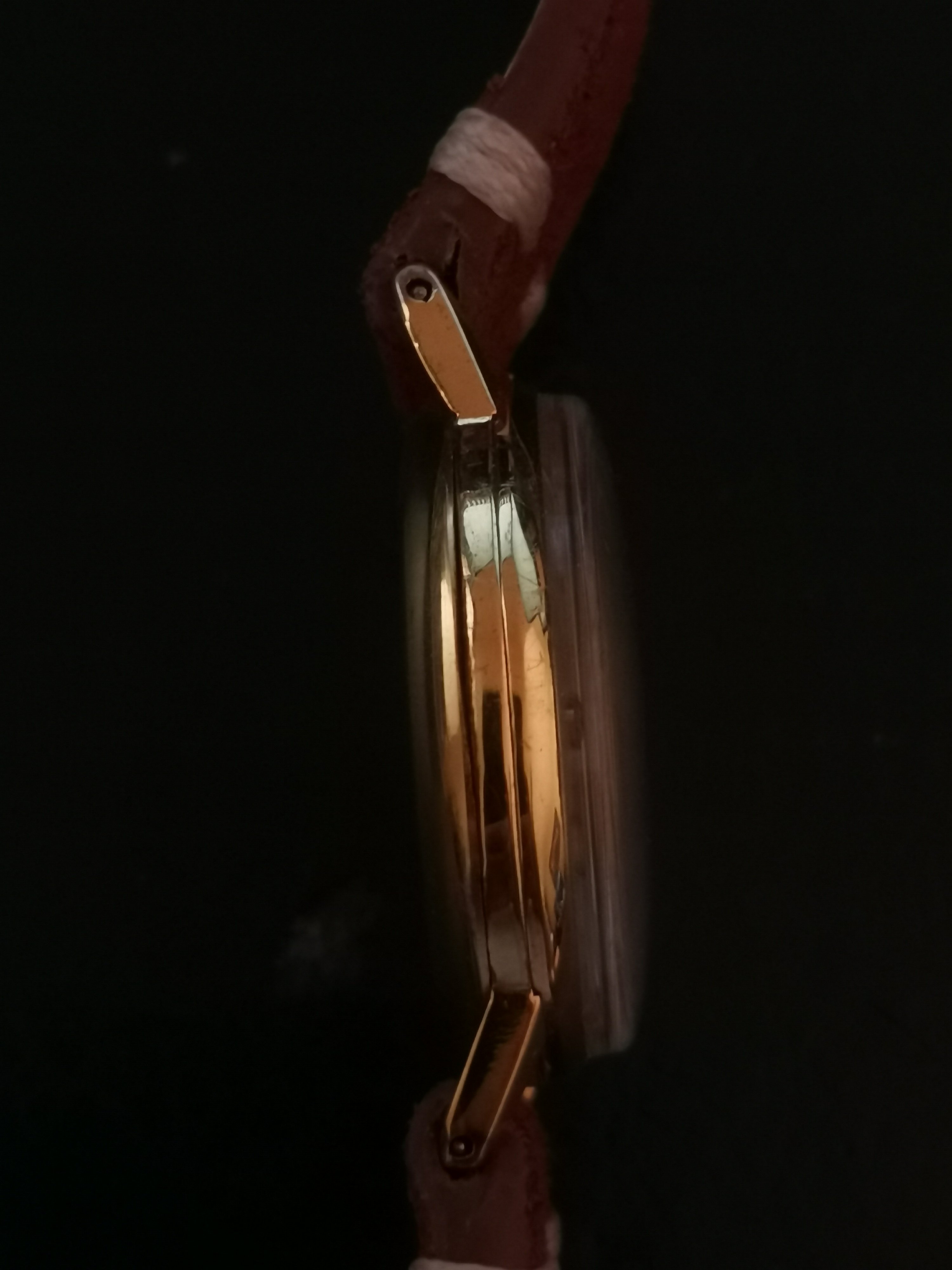

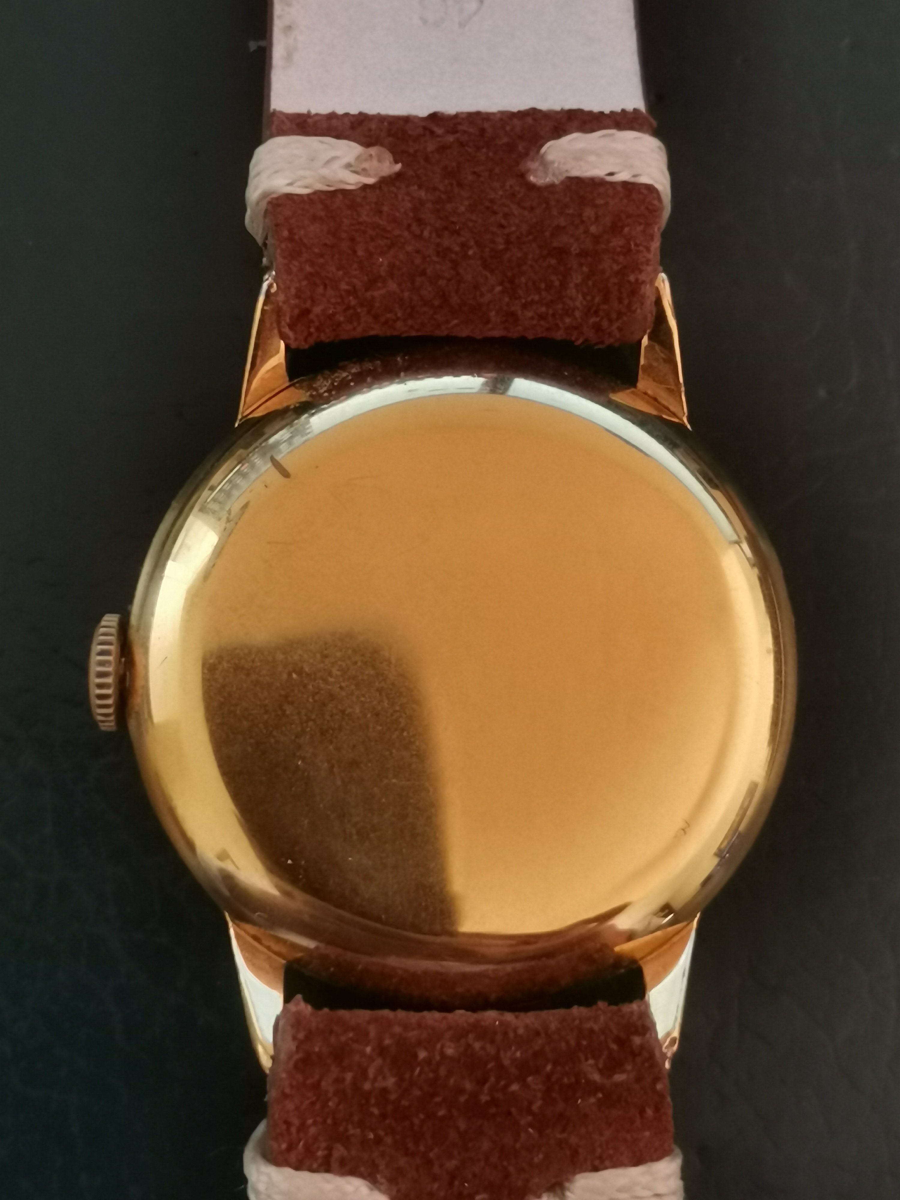

OK so the only thing I can make out there is that the case is gold plated not solid gold. There is an Omega symbol in there but I can't make out the 2 lines of text below. Can you read them?
Do you have a photo of the movement?
18,862
39,236
Either the hands are incorrect or the dial has been redone. There should be a minute track at the periphery of the dial.
The hands are actually "Pontife" style, although the minute hand looks to be "Leaf"style, but it's hard to tell from the photo.
13,506
31,844
This, and they look like different shades of gold.
