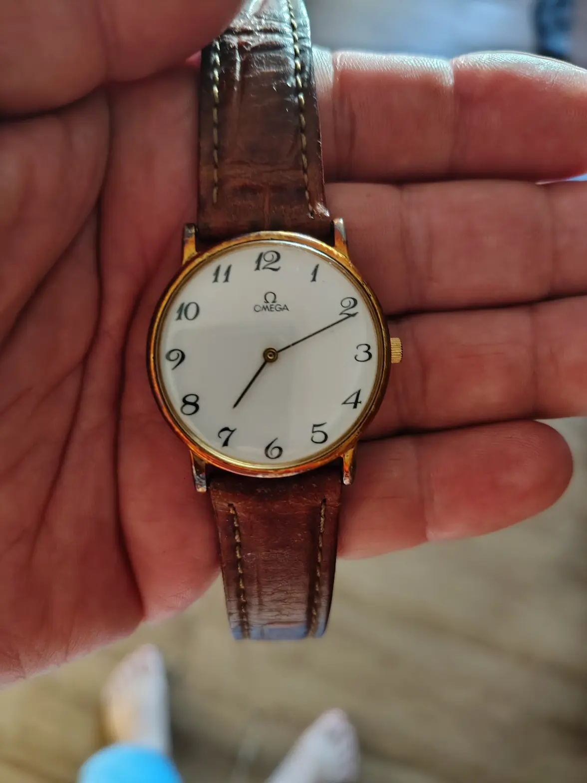

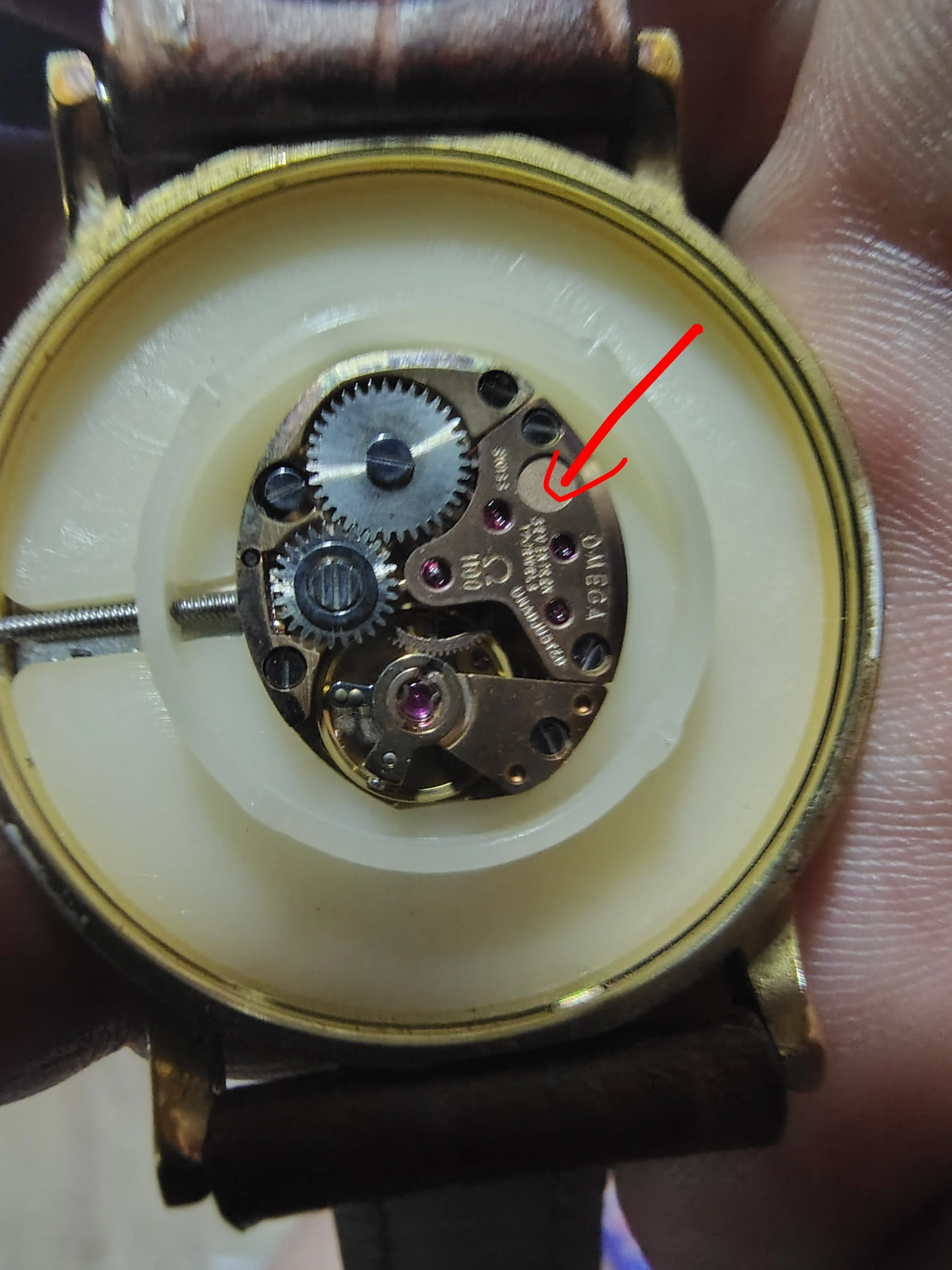

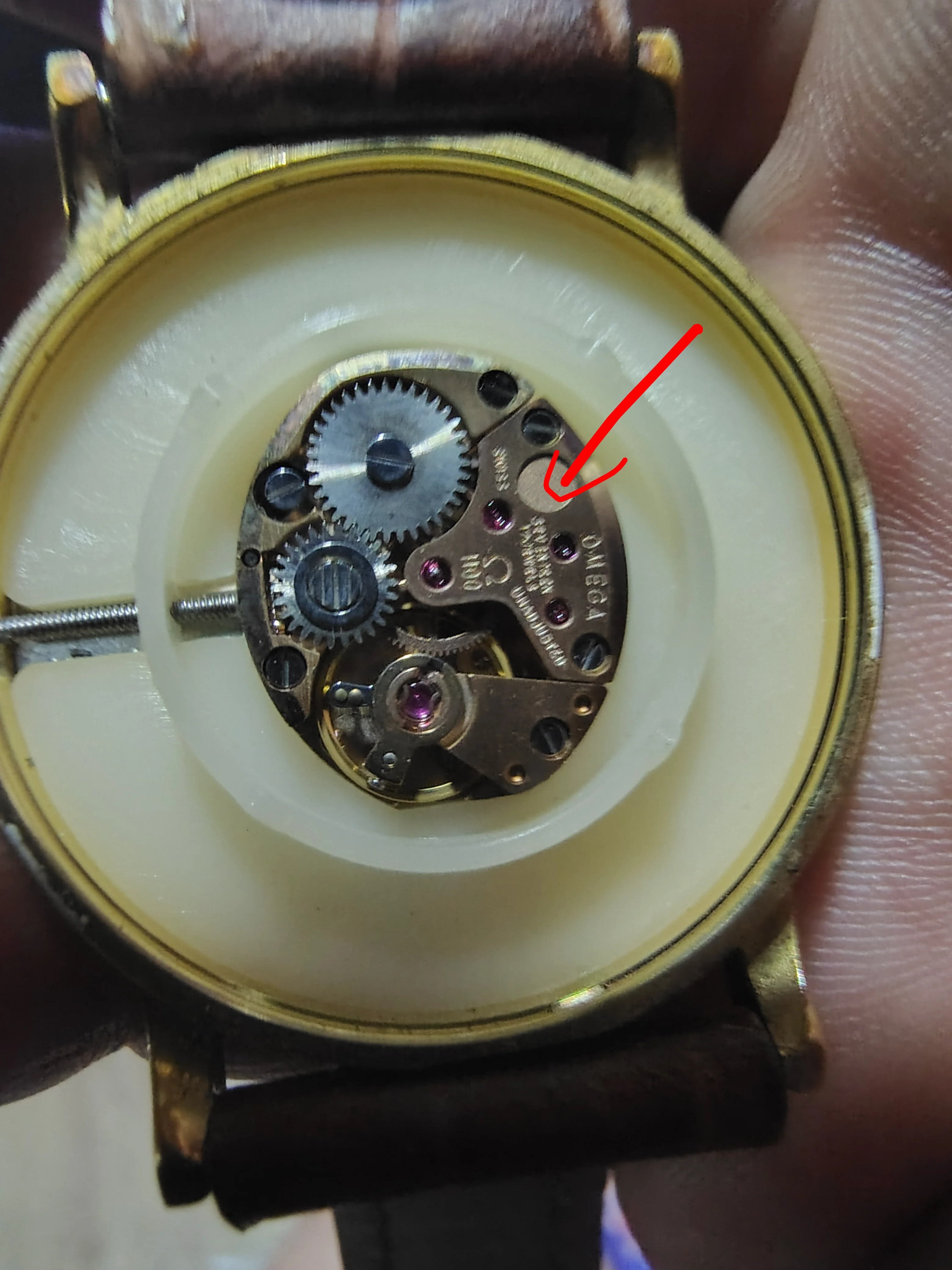

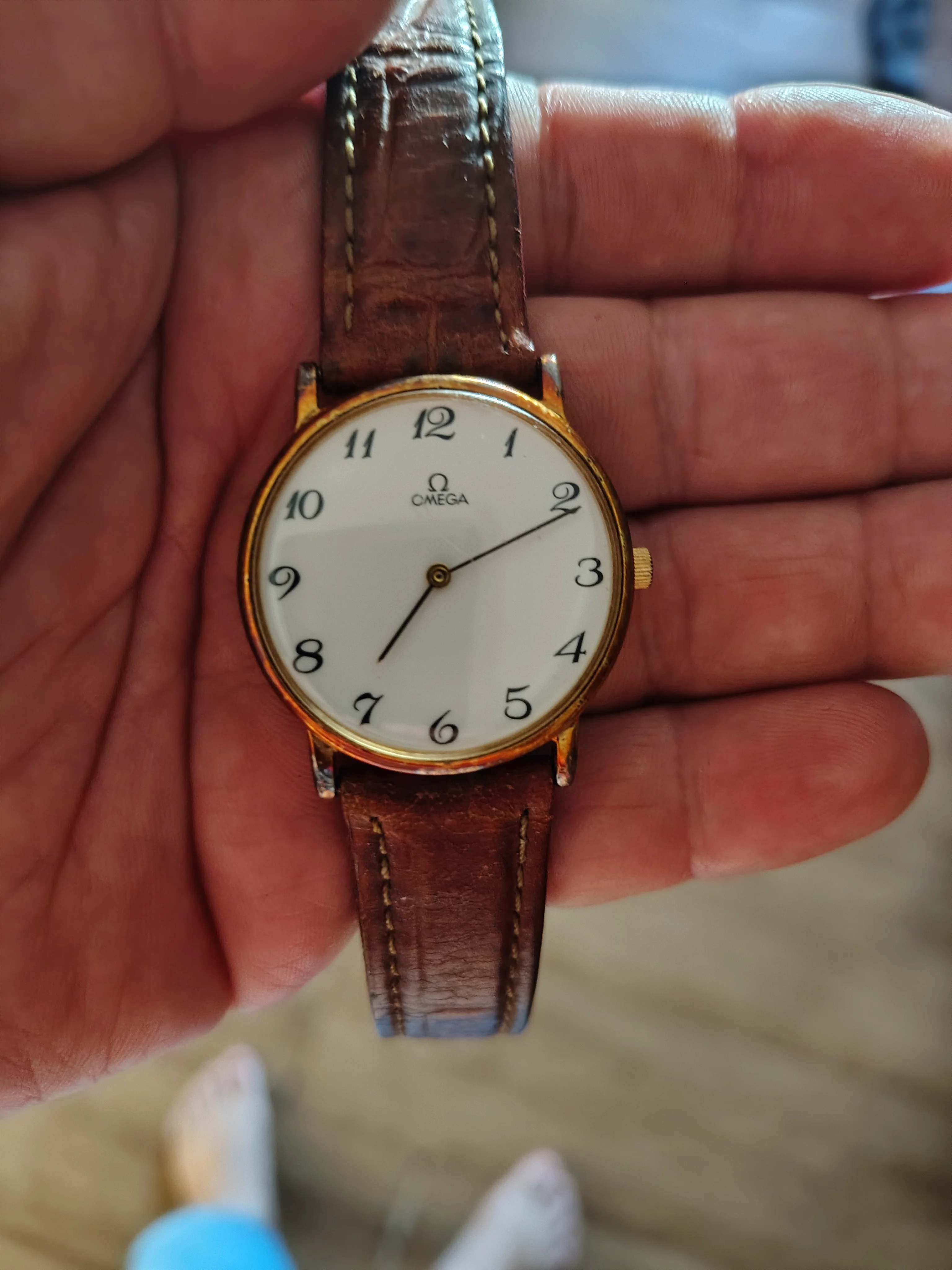

I've had this watch for many years, and out of curiosity I opened it and noticed that it doesn't have a serial number in the indicated place. Could it be a replica?

The sticker fell out.
Yep, for some stupid reason (read: to save money), Omega switched to stickers instead of engraving. Oddly small movement + huge plastic spacer are other cost cutting measures.
I've only had 2 sticker movements on my bench, 1 the sticker fell off in the cleaning machine, the other was gone by the time I got to it (likely in ANOTHER watch maker's cleaning machine).
IF you didn't find the sticker, it means at least it was serviced once before 😀

Thanks my friend.
