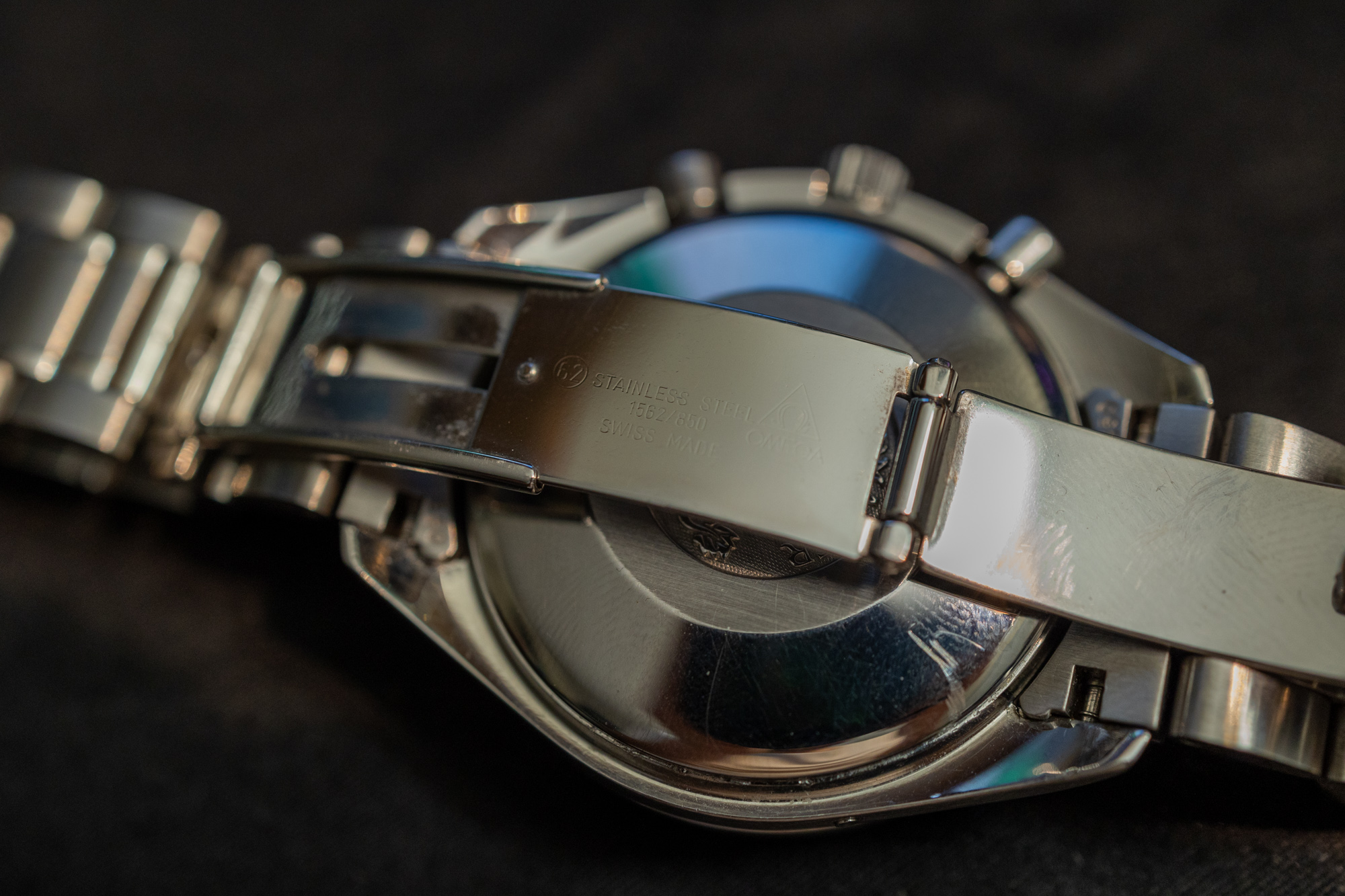

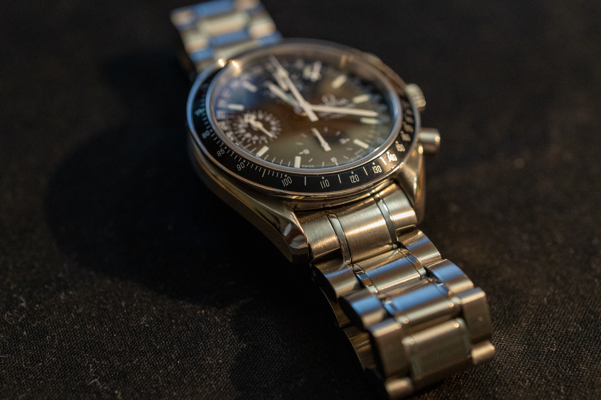

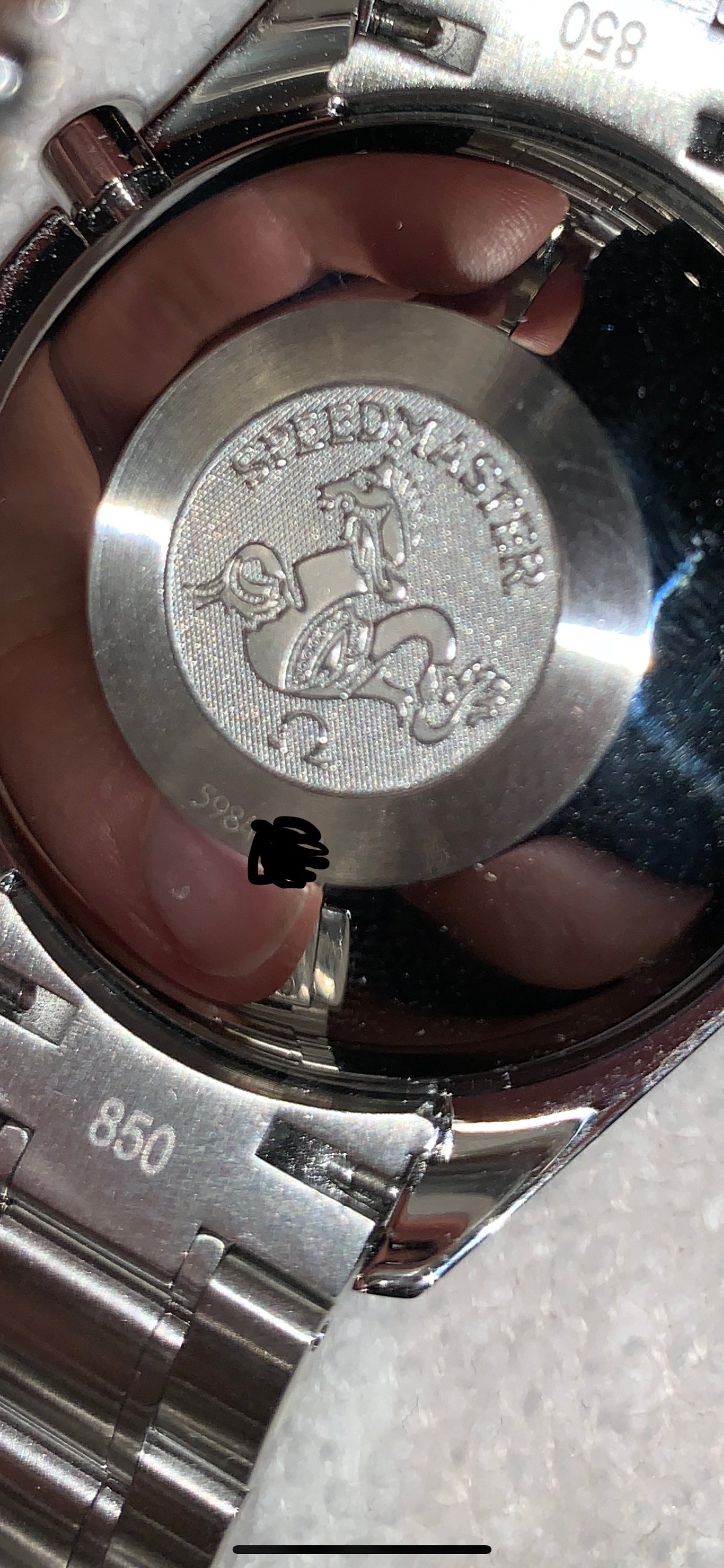

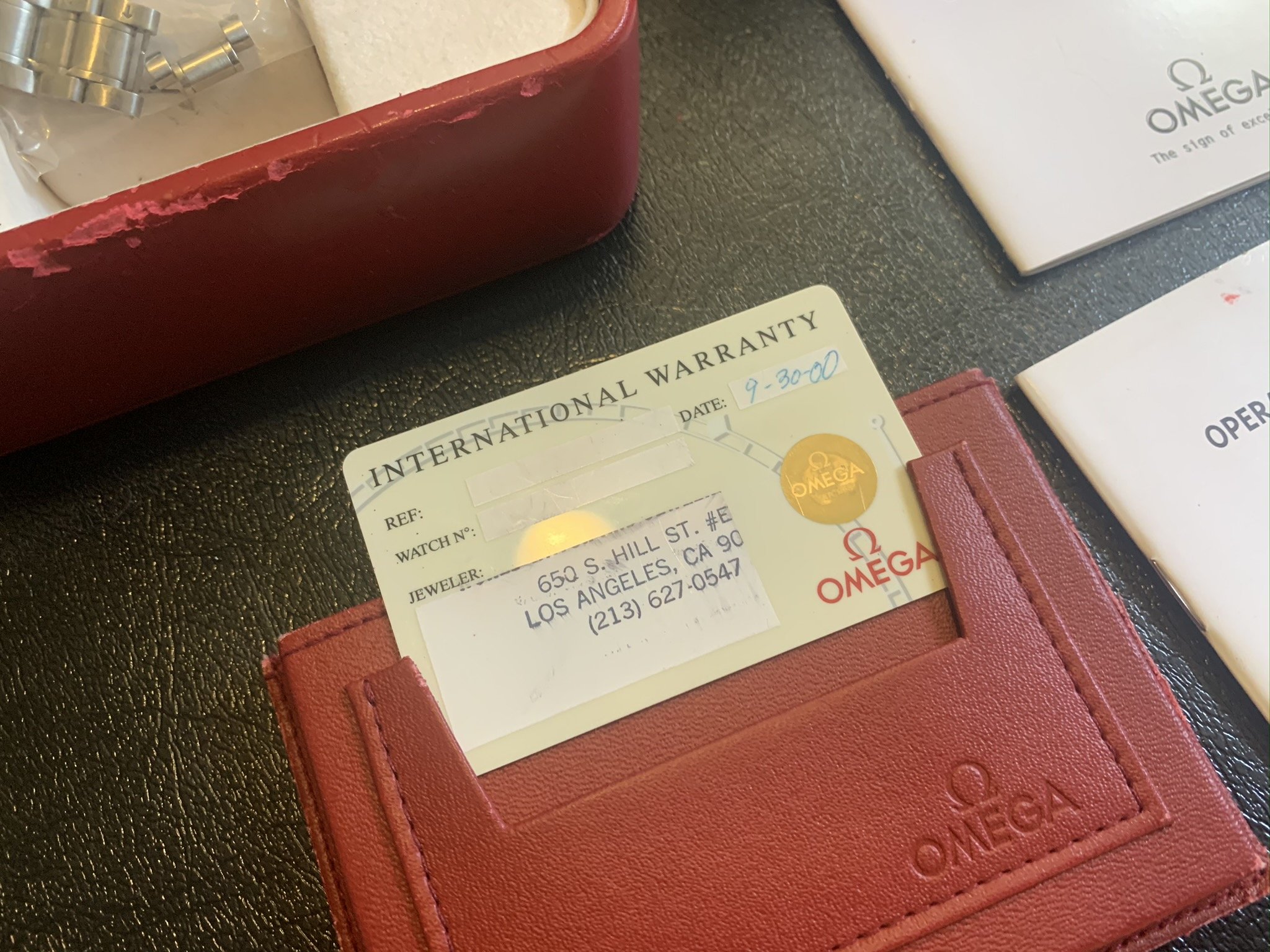

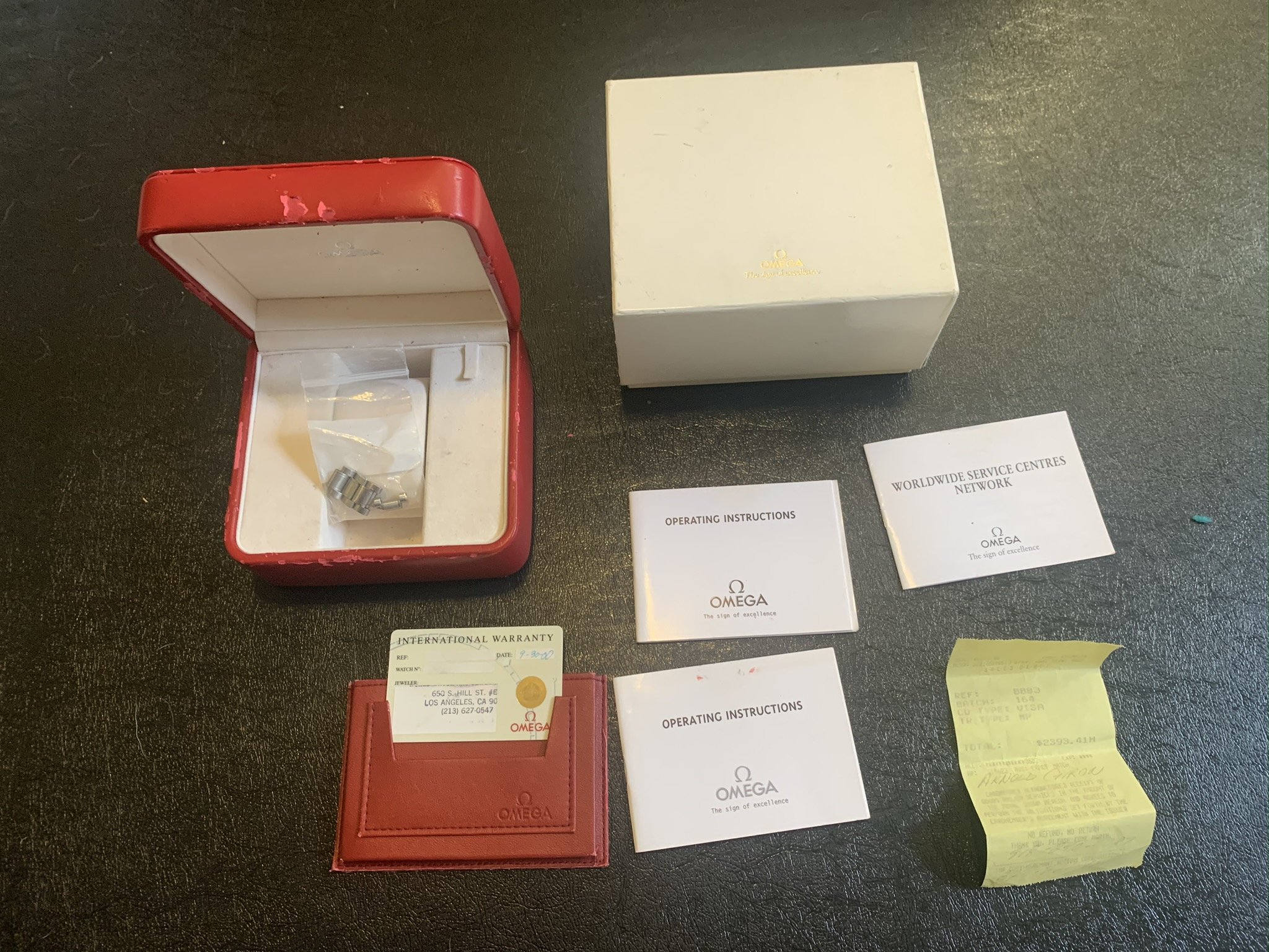

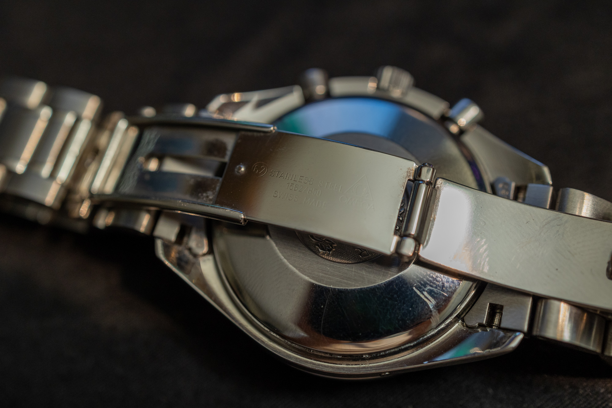

Hey everyone,

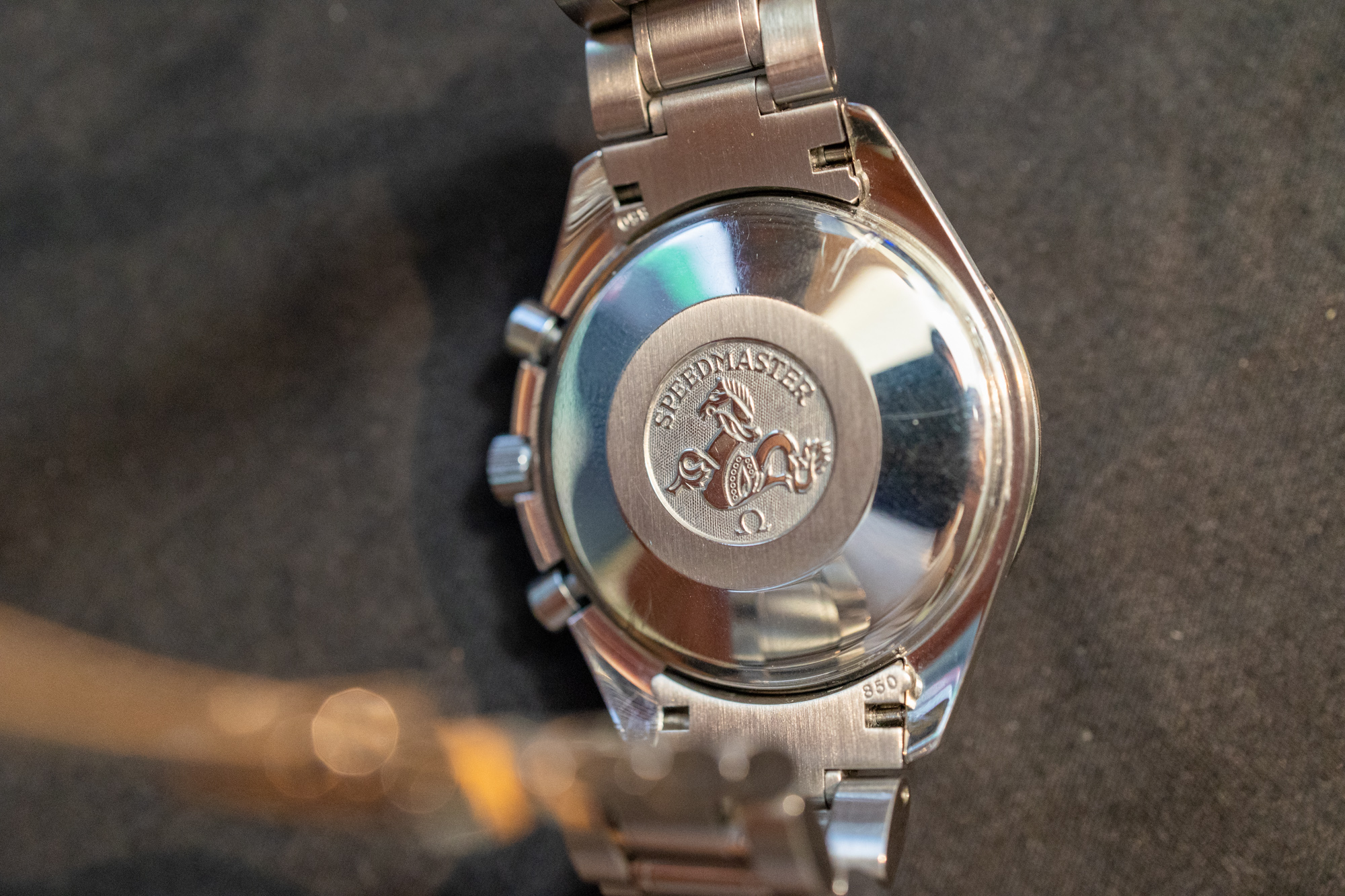

I just dove in head first to my first Omega purchase. Last Tuesday I purchased a vintage Speedmaster Mark 40, Ref 175.0084/375.0084 from a local watch store called Vana Watch and Jewlery. Although I did a fair amount of research before hand I did overlook one important thing before I bought the watch, it was missing the case serial number.

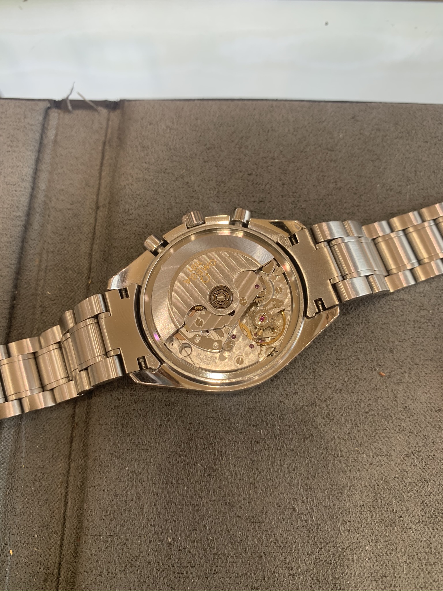

I have spent the last few days trying to get more information from Omega about the watch in order to confirm it's authenticity and serviceability. I even drove all the way down to Costa Mesa to have an official Omega tech open it up and look. He thinks it's original but doesn't have any experience with that exact model. He also mentioned that Omega may not service it with the serial missing.
Today, I spoke with the Swatch Grp and they said it can be serviced so long as the watch is authentic. The watch had been serviced when I bought it so I'm not going to send it in now. I have a small window here to return the watch but I really don't want to. It is in beautiful condition. What do you all think? Is she real? Will I have any trouble getting it serviced down the road? Should the movement have a serial? There isn't one clearly on the back. Should I keep it?

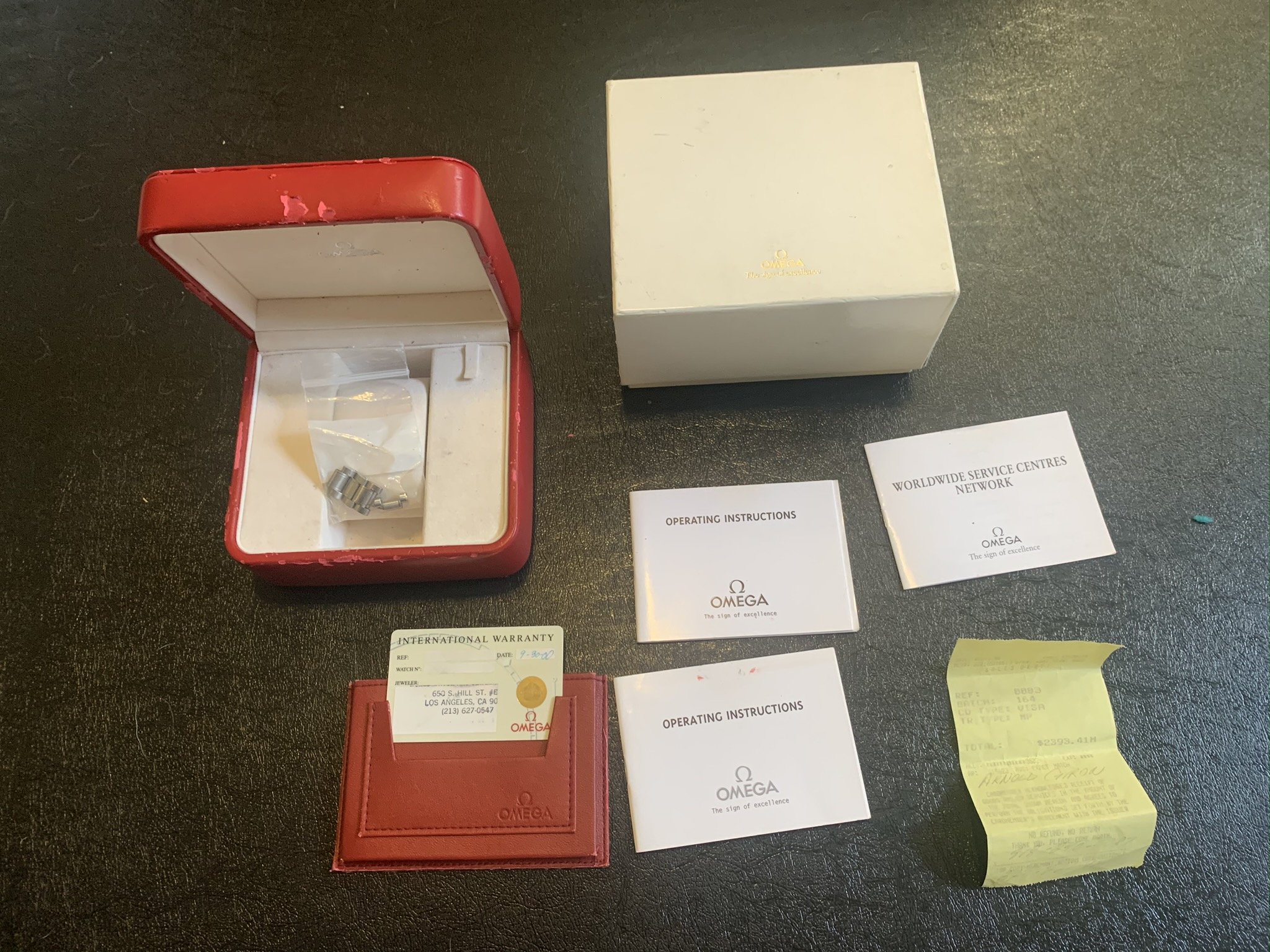

I paid $2900 for it. It came with box and papers but the warranty card was missing the ref and serial number. It looks like they were written in pen and smudged off.
Thanks
Drake

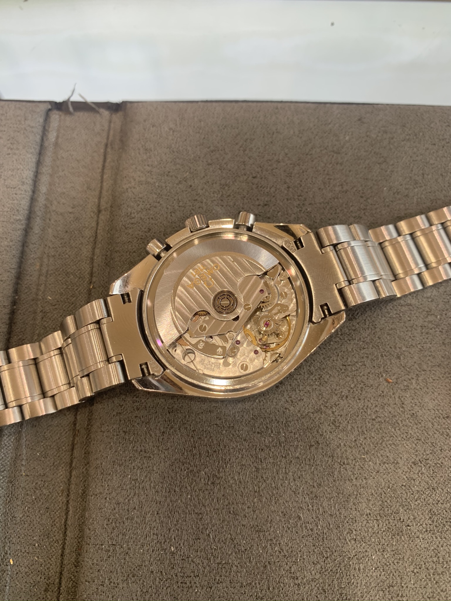

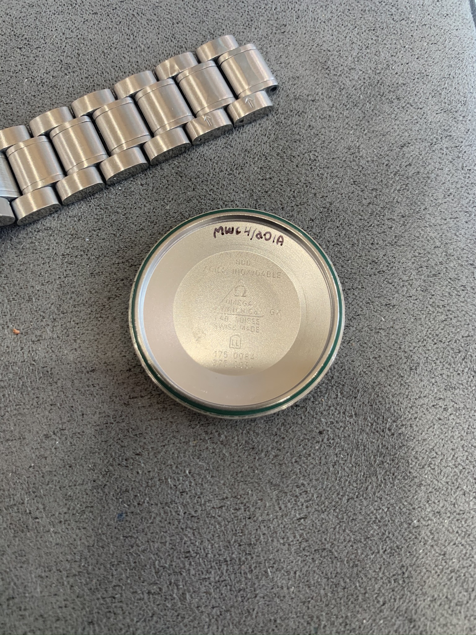

These watches did not have serial numbers on the movements, but only on the outside (and possibly inside) of the case back.
In this instance, the serial number being gone from the case will not mean they won't service it - they will as long as they can confirm the watch is authentic as they told you.
Now if this has been a watch that did have a serial number on the movement, and it had been removed from both the case and movement, they would refuse to service it, but that's not the situation you are in.
Cheers, Al

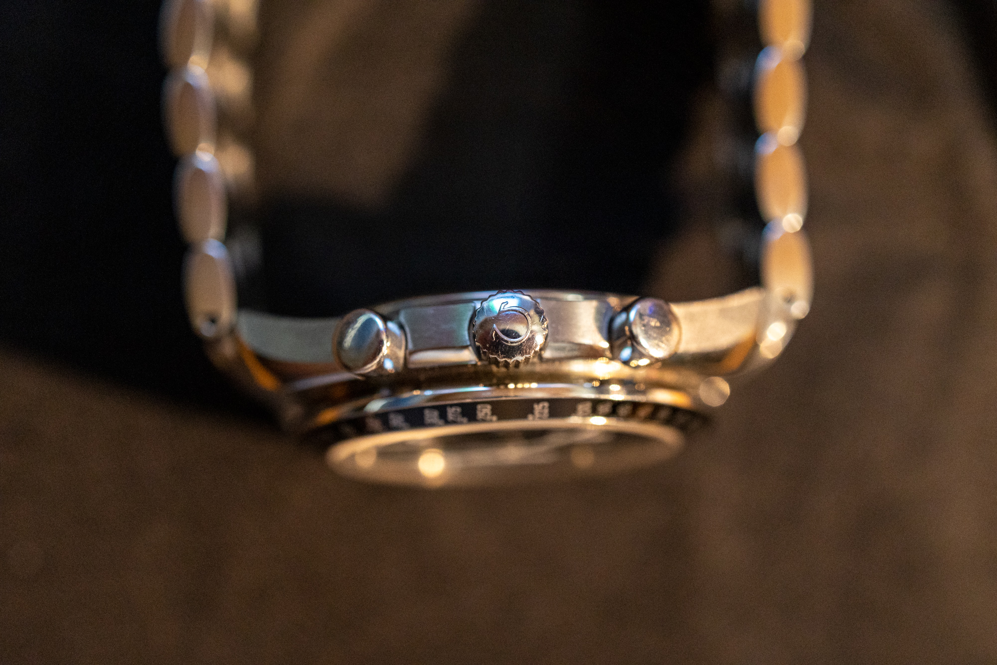

Archer is correct. On this model the serial number should be on the case back. Couldn't find it myself the first time either.
Cheers

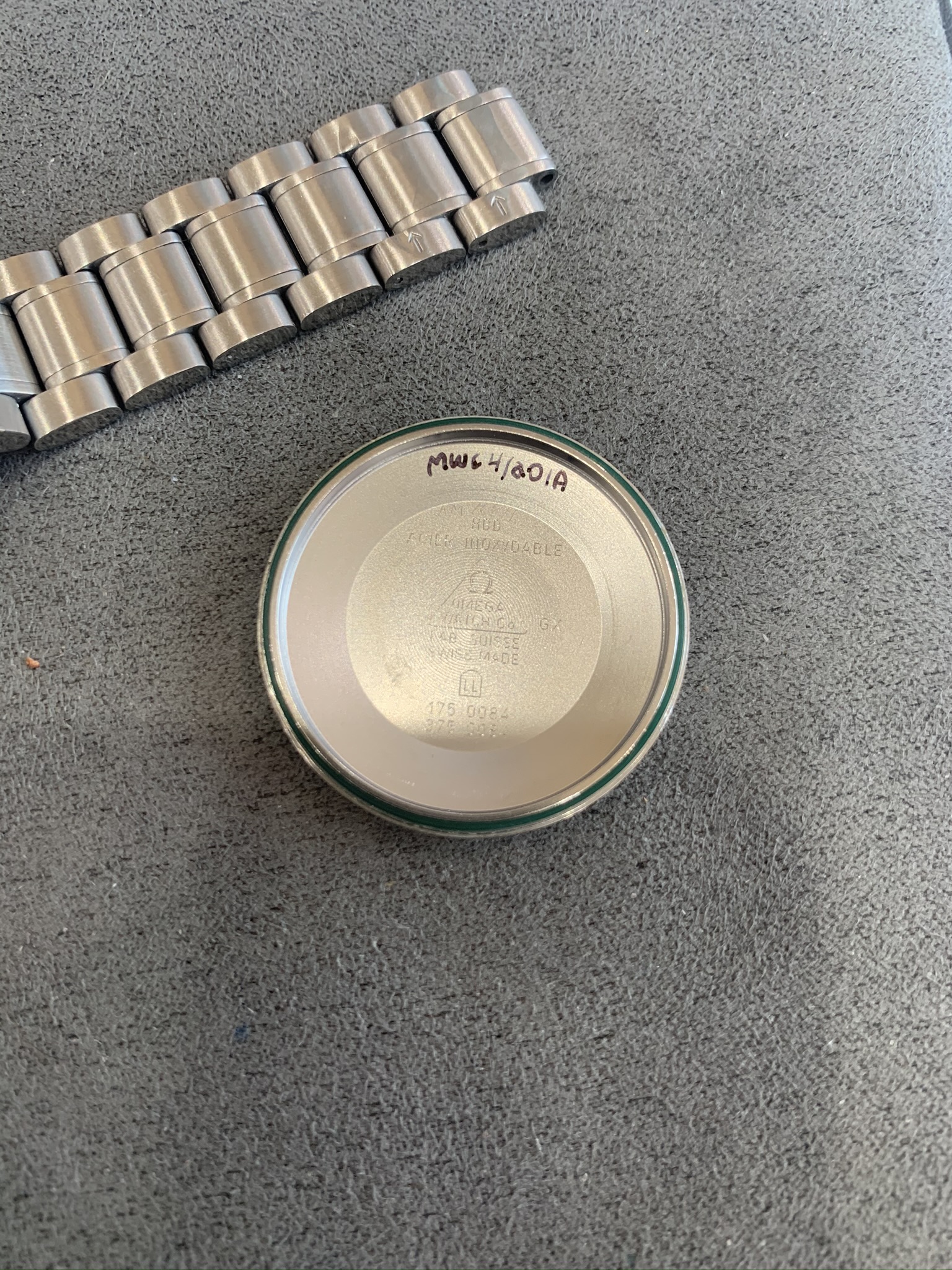

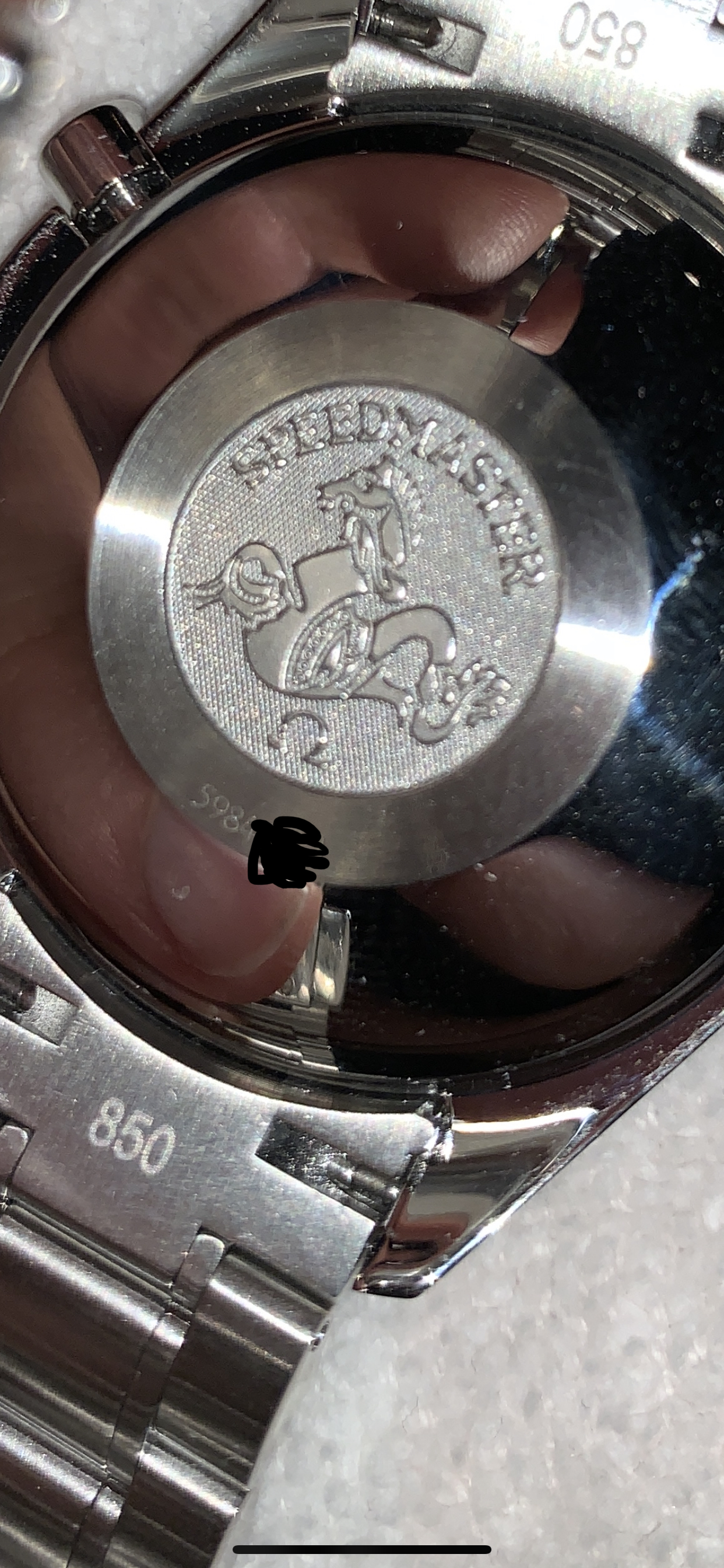

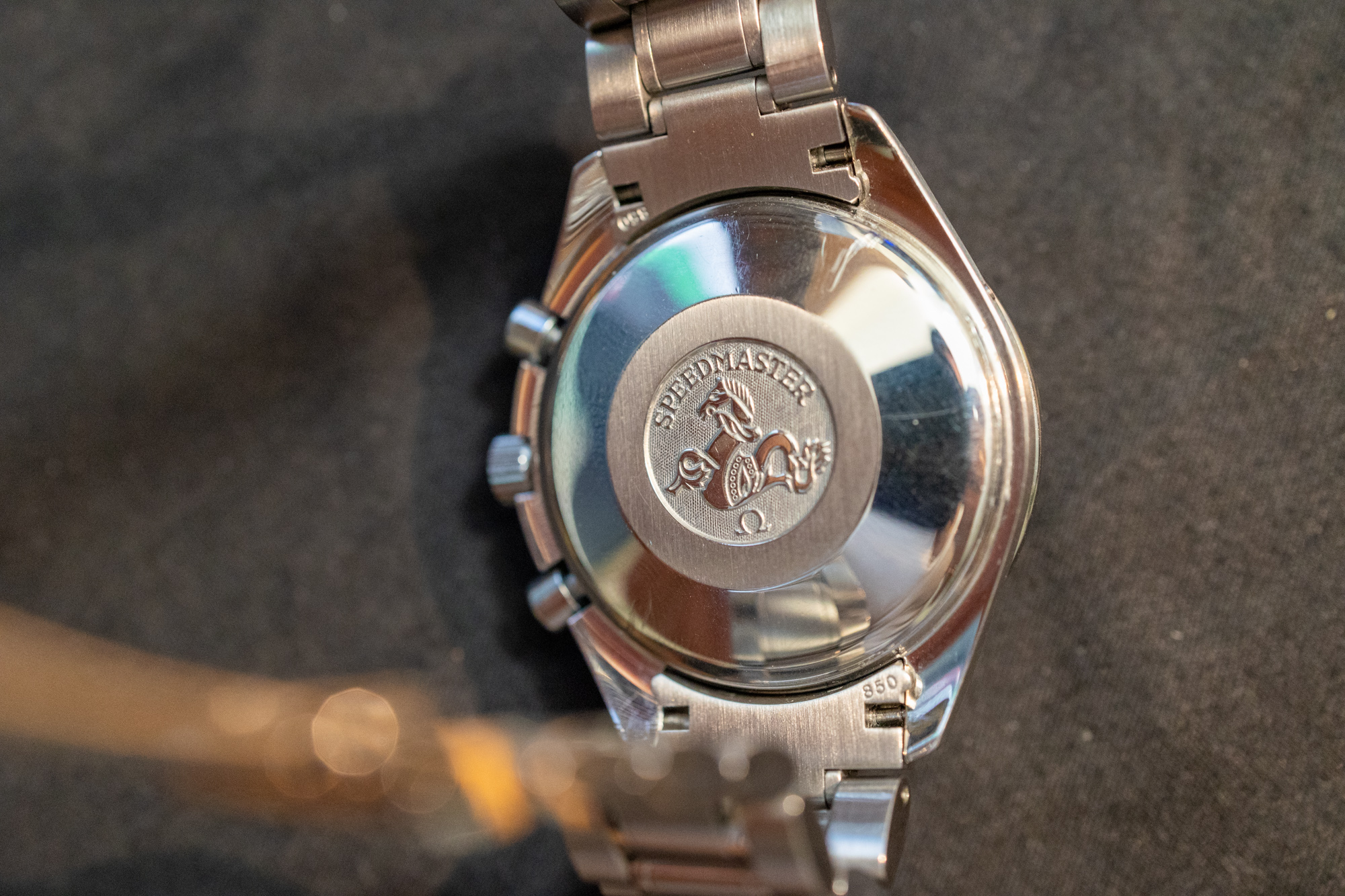

Hmm, does not look to be polished off either. On mine it is here (from Japan):

Have a closer look. Do you see any difference in the finish of that small ring where the serial number is between yours and the OP's? I certainly do...

Look at the brushing on yours. It's circular. Mine is strait.

I'm well aware that the serial was brushed out. I believe the watch was engraved and the engraving was removed. I do not see any other signs of polishing or finishing changes. My concern was with authenticity, serviceability and value. I have spoken to the Swatch Group a couple times today and they will service if it is authentic. If the watch is authentic which I believe it to be, how does the lack of serial affect it's value?

There was a period where grey market dealers online were removing serial numbers on watches they were buying in bulk and re-selling, this was during the same era these MK40s were being sold so its possible that this watch was one of those grey market pieces originally. Authenticwatches for example even had a disclaimer in the 2000s stating that all serial numbers would be removed from the watch before it was shipped to you. This was during the time Omega was engaged in legal action against Costco and the grey market dealers were trying to protect the ADs they were getting stock off.
If I had to guess I’d say this is the most likely explanation for your watch and that it was removed intentionally for that purpose.

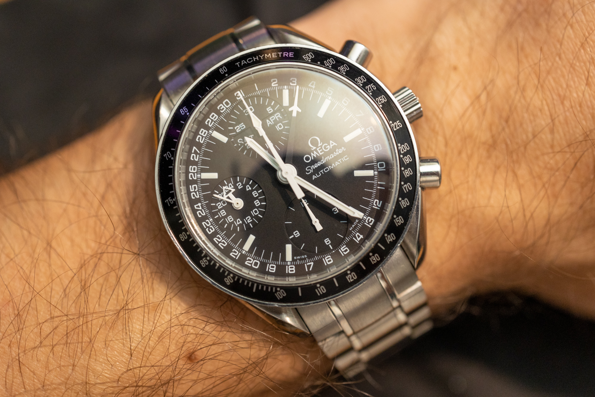

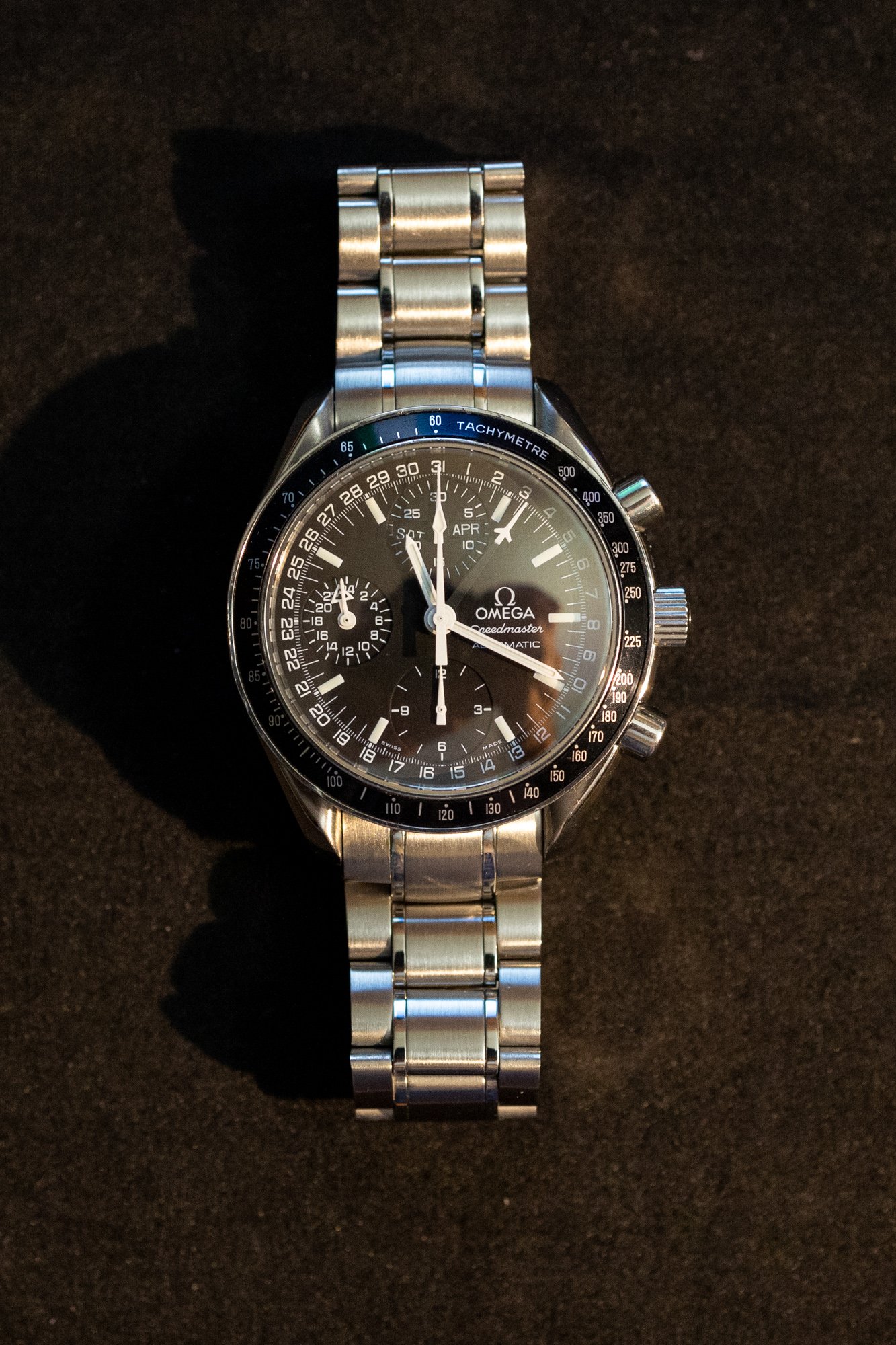

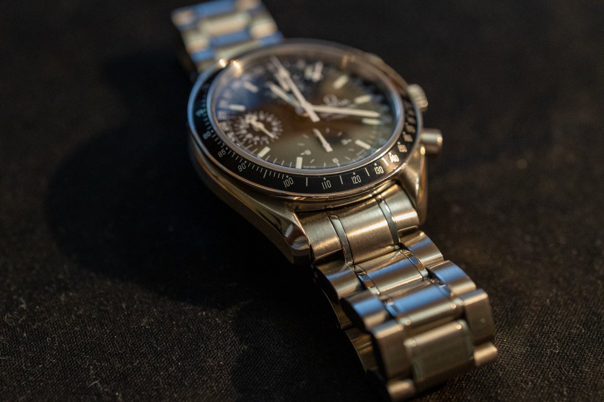

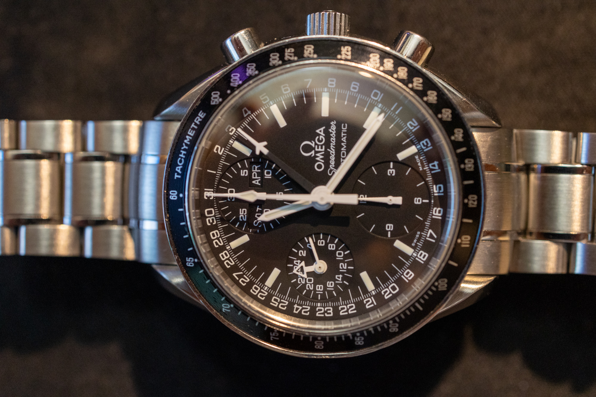

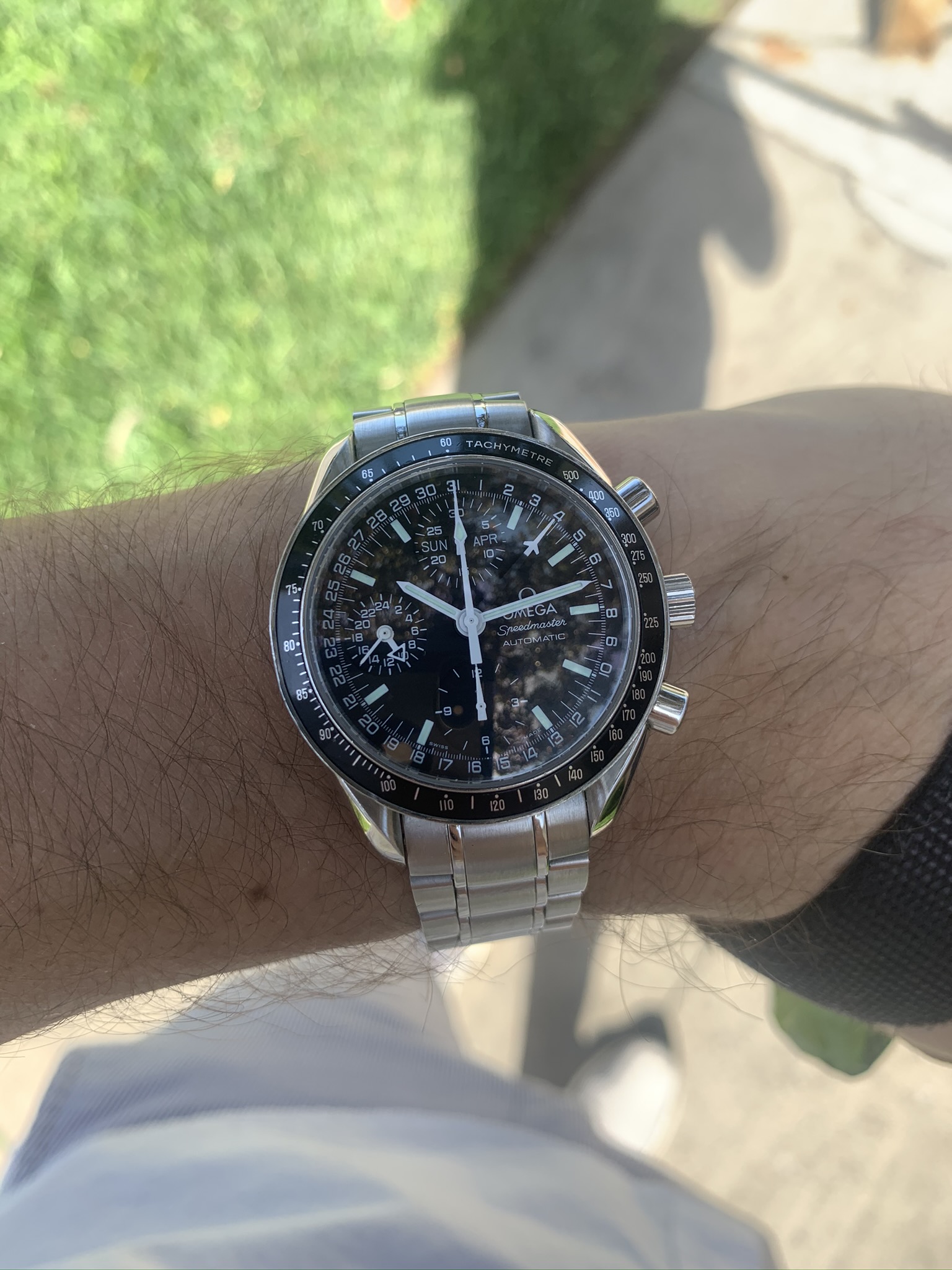

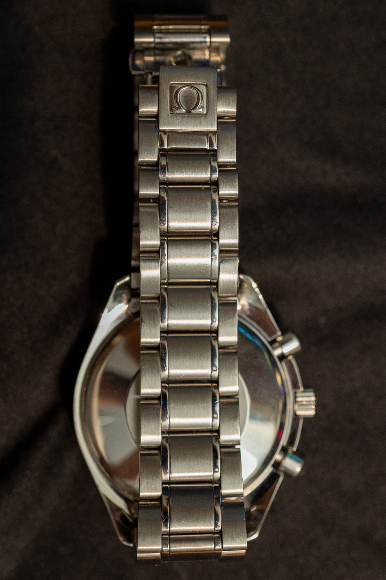

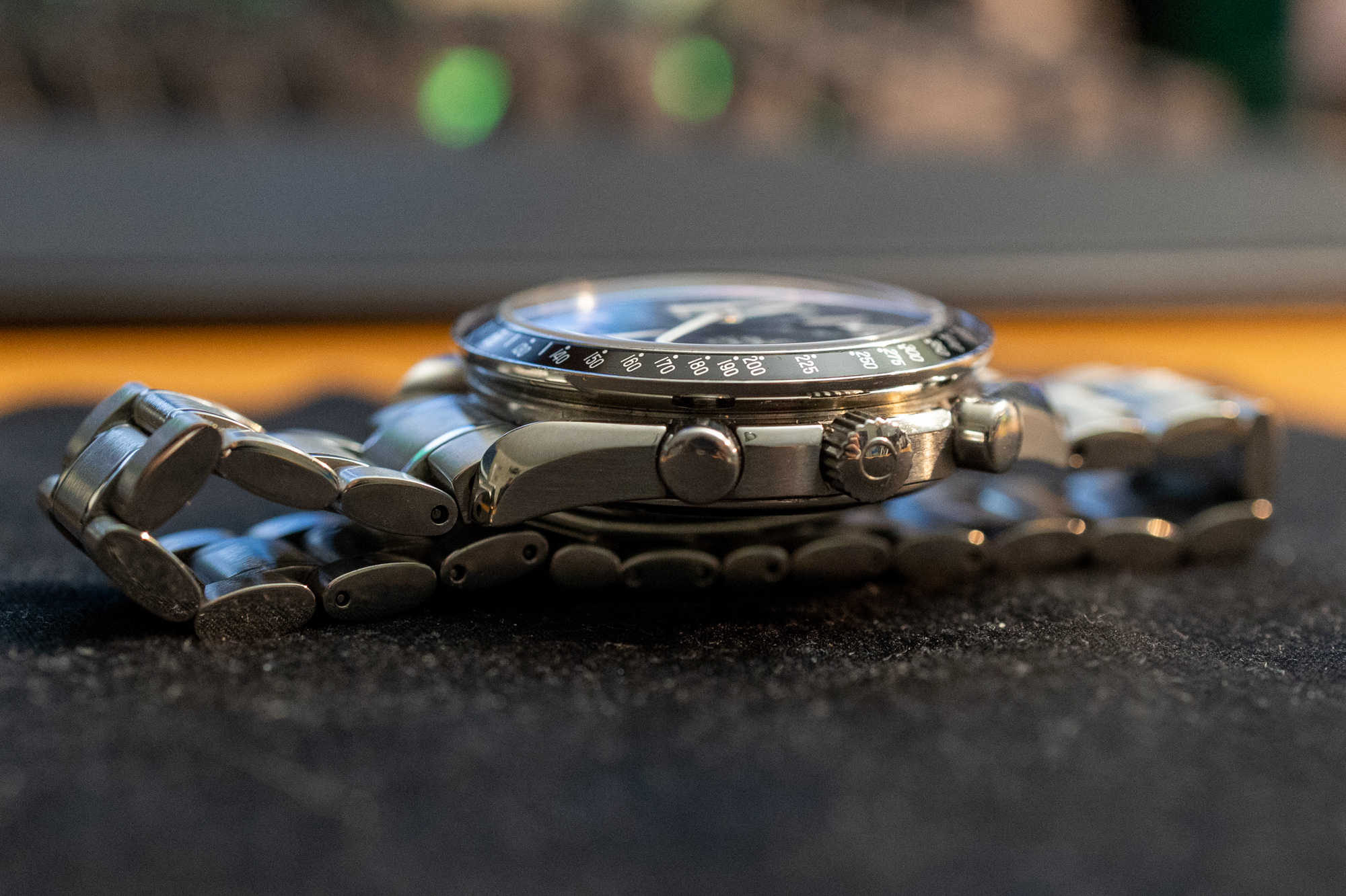

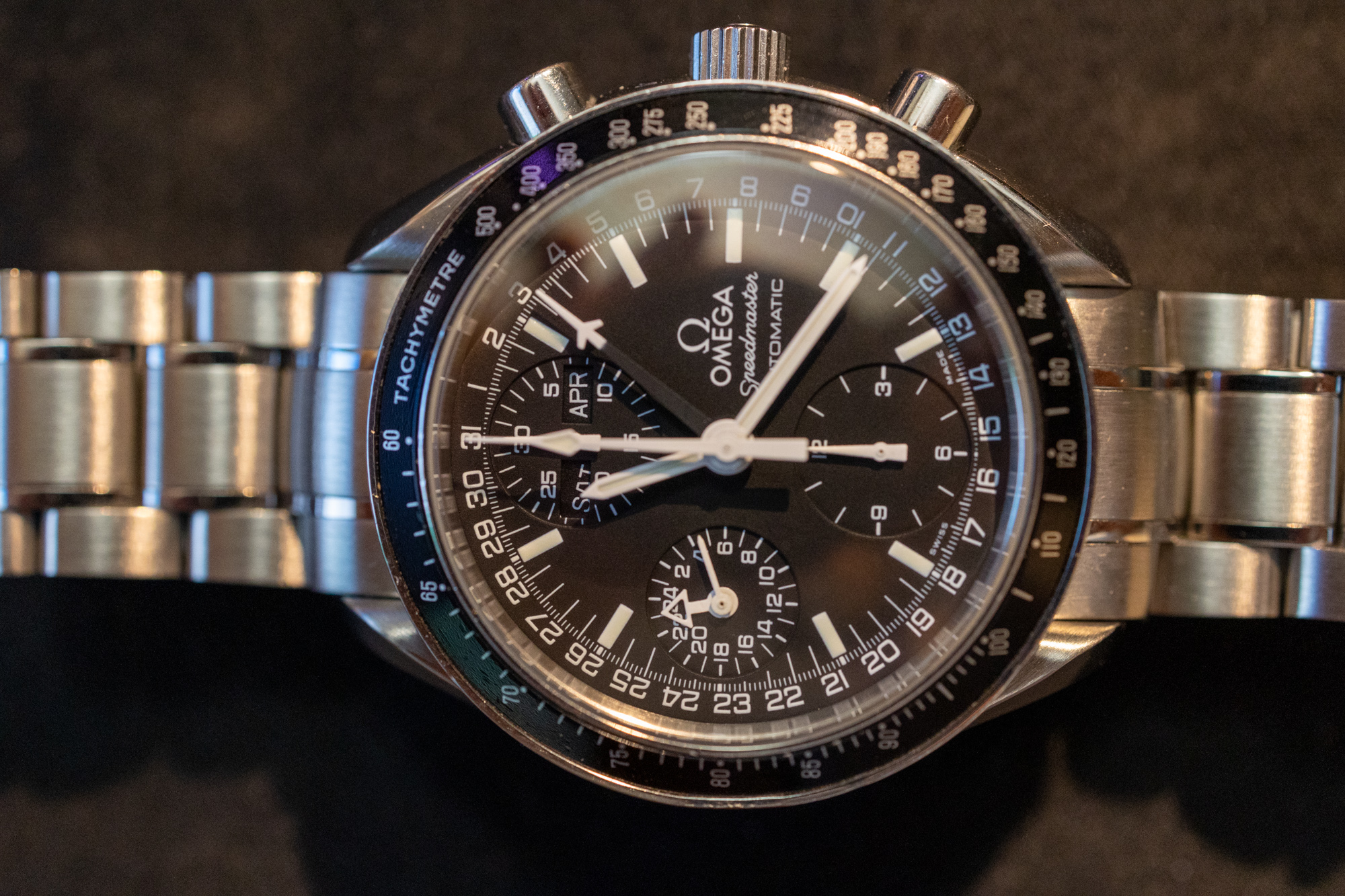

Thank buddy. I appreciate the feedback. It is a pretty awesome watch. I love the size. I'm sure the 42mm moon watch is nice but my wrists are a little small and this guy is perfect. Plus it can be dressed up better than the 42. I just put a black leather strap on it and it looks awesome!
The watch was serviced by the seller and it is working great. The date isn't miss aligned. It's the start of changing over to the next day. As you can see it's 11:30pm. I don't see them finding a serial. It's definitely been removed but I'm cool with it. Omega will still service it. Everything else it in good shape. These photos don't really do it justice. The minor scratches look much more pronounced through my Canon r6. As far as the value 10-20% makes sense. I paid $2900 which if you include a service cost close to $1k for this complex movement it was valued correct. Most of these that I see online are $2-3k and they probably need a service.

Value wise these tend to be a bit cheaper typically although yours does look quite nice and is one of the later models, Ive helped friends buy them for under $1000 usd off ebay and servicing is actually quite cheap as the movement is an ETA 7751 base and while it adds some complications they’re still an easy to service movement that tend to be fairly trouble free. The last one I had serviced was about $350usd at my local watchmaker who tends to be pretty good.
If it has been serviced and you have a warranty I wouldn’t be bothered by the amount you paid given its a good example of one of the later variants of the MK40 though.
