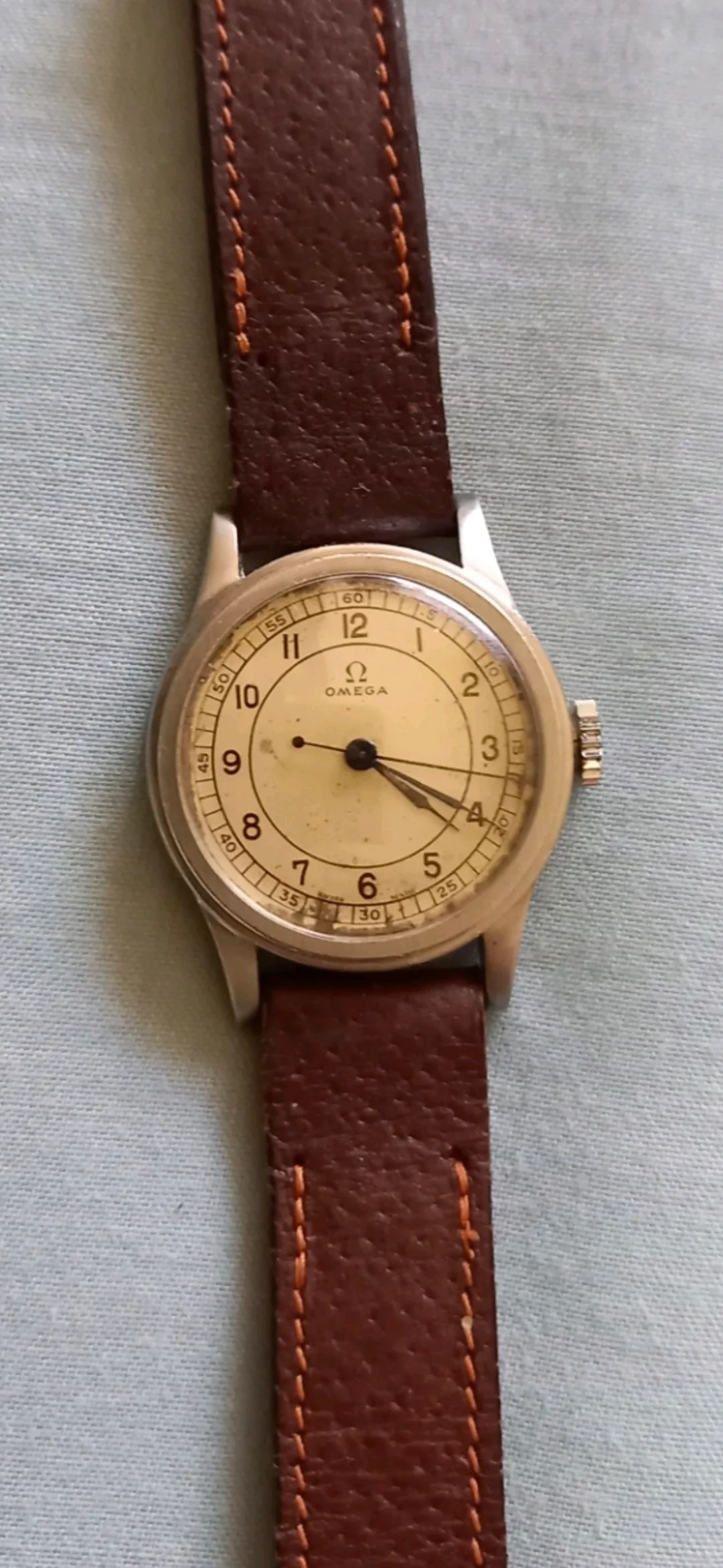

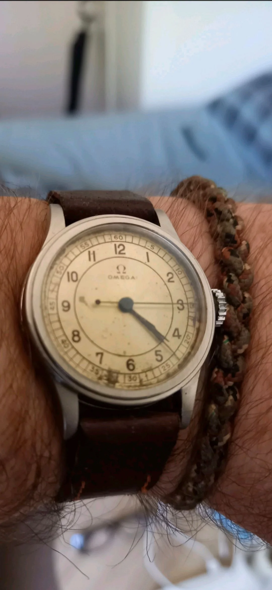

Hi Revo 馃憢,
It's been a while hope you're ok?... 馃
Last time I was intouch was about my dad's legacy, his Naiad Medicus and the wrong crown was on it originally, Thank-you for all all help then 馃馃

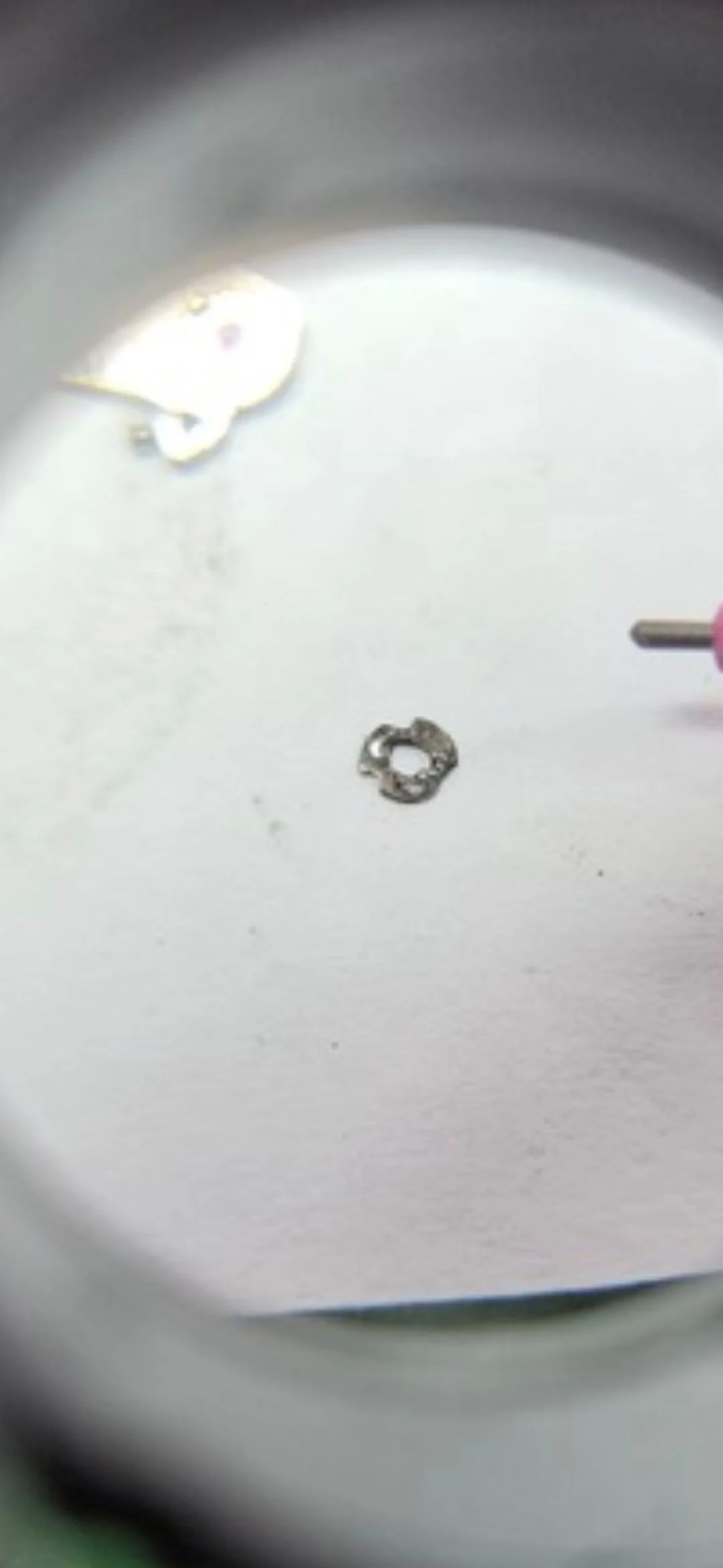

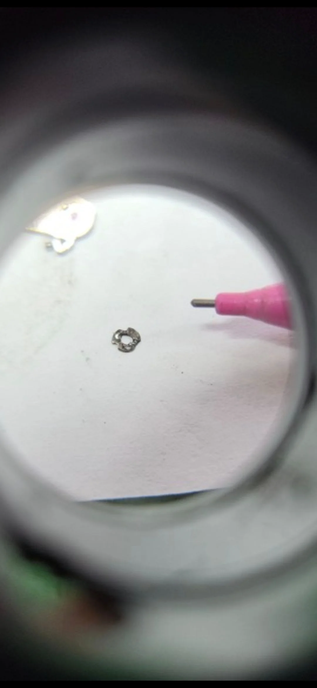

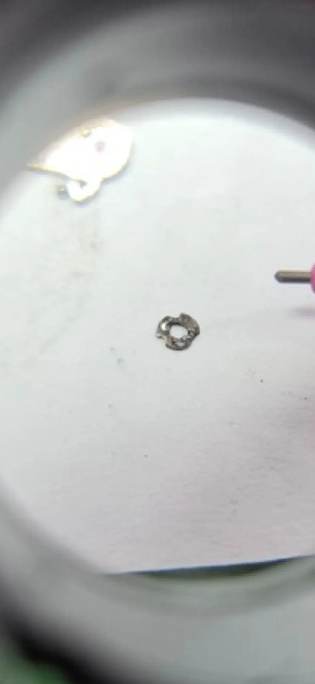

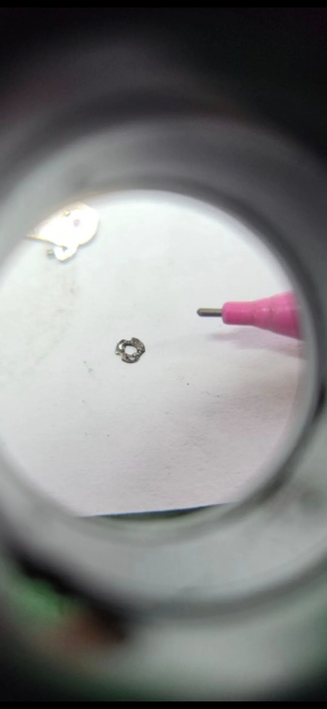

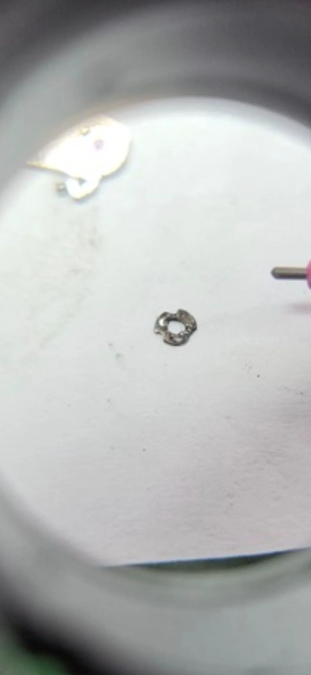

Now I have a really big problem I'm trying to source a "Endstone Locking Mechanism" but I dont know thee exact name of the part but it has totally failed and I can't wind my timepiece up anymore, hopefully you'll be able see by my attached pic, of the part and what I'm trying to find 馃
Hopefully you can help me or to know who to reach out, anyone who maybe able to help me 馃檹馃
Hopefully I'll hear back from you very soon 馃 馃槈

This watch has I believe a Cal. 23/4 SC, so that would be a Cal.. 231 in modern numbering.
The only description that makes sense is this:
72202201335 | END-PIECE BOLT FOR BALANCE
It is discontinued, so you would have to find one on the open market or from a donor watch.
61
48

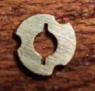

Not sure about this, but the part in your photos suspiciously looks a bit like this:
If so, this is 23.4SC 'jewel lock' or Omega part M/203 (or 1335/OME 220). I had my Naiad serviced couple of months back and this was one of the two parts we had to replace (found it from Ebay).
29,820
77,177
Yes, that's the part. Of course these places make up their own part number sequences, but the numbers of the actual part number are there (220 for caliber and 1335 for the part) from the actual Omega part number I've posted.
143
1,087
Didn't realize this. And the 'end piece for bolt balance' (which I assume is an actual correct Omega part name) in Ebay yields many more listings than what I got (using the name from Emmy watch link) when I was looking for the part.
