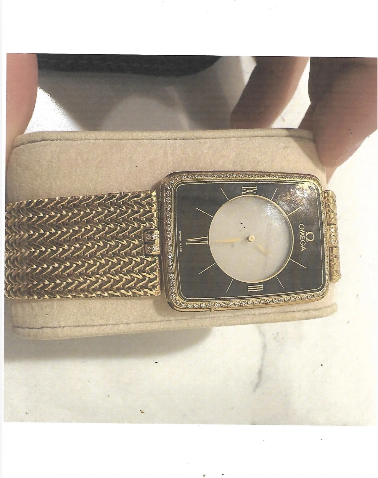

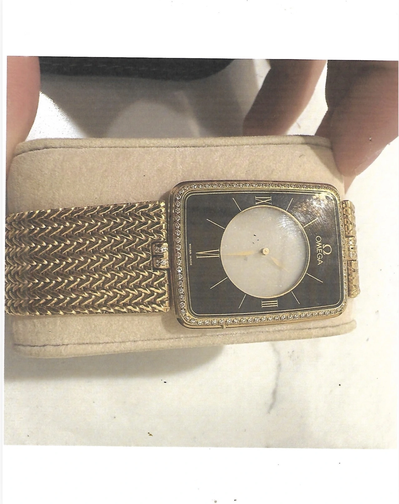

I am new to the forum. I have inherited this watch. I spoke to Omega UK who say that they no longer have spares for either of the quartz movements it may have fitted. I am unsure if it works but seems to have no damage and has been stored in dry conditions. Is it a lost cause if it’s not running when and if I can get omega to fit a new battery. Is it likely to be a different answer from Omega in Switzerland.
Thank you in advance for any advice.

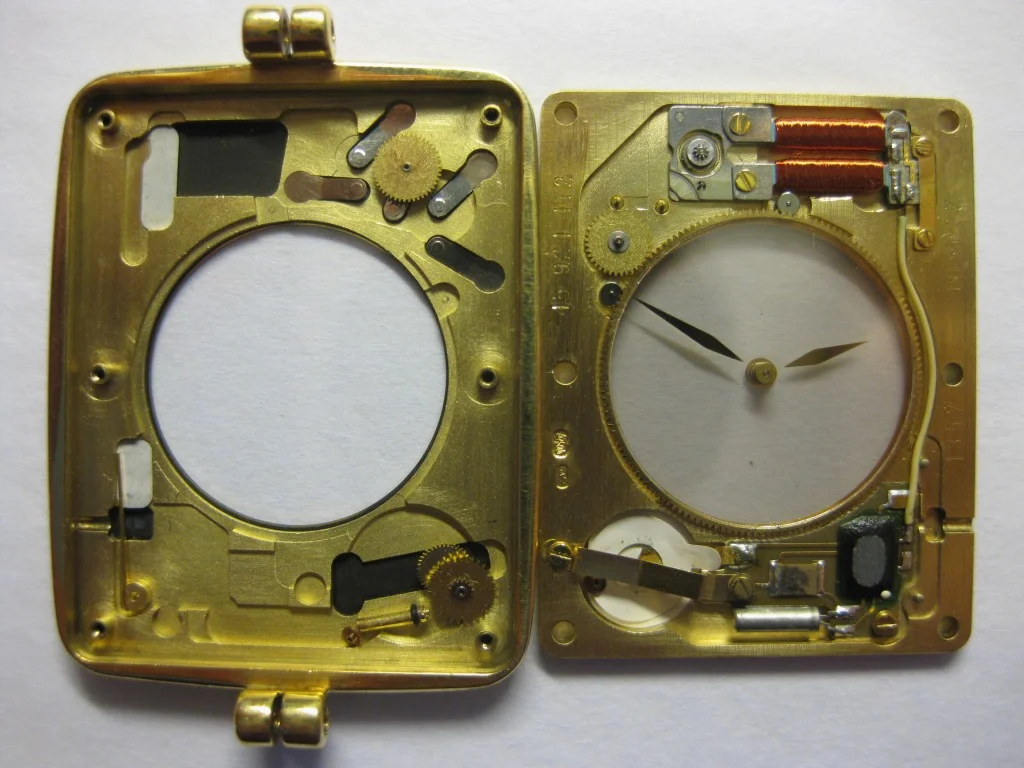

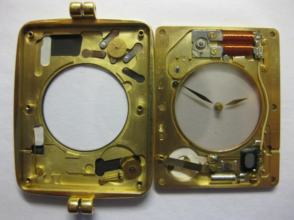

I found a photo of the inside of the watch
So there is not really a movement per sea as it is pretty much integrated into the design.

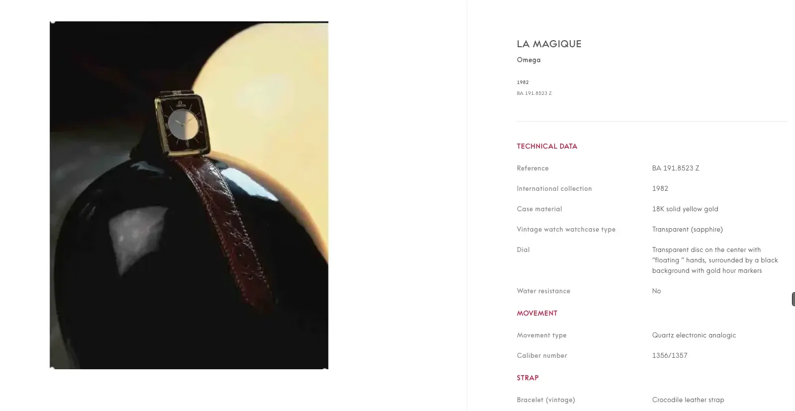

There is a thread that the search turned up on these forums https://omegaforums.net/threads/1-261-produced-omega-la-magique-de-ville-18k.46379/ which give some details including the caliber number 1357. I do not see that number in the usual datasheet download sites. I did find the 1355 which is a quartz tuning fork movement.

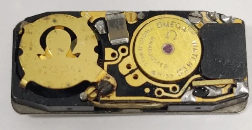

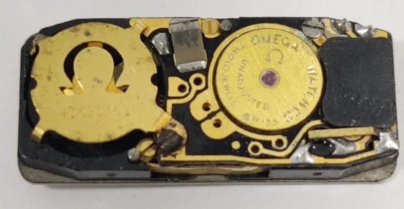

Mostly I play around with the 1342 quartz movements. I have some background with micro electronics (I design pipe organ relays.) The main problem is that the chip factories used to make the time control chips have long since crumbled to dust and the designs shredded.
In theory a modern general purpose micro controller could drive the stepping motor. These can be quite small. Typically though they run at a higher 1.87 voltage up to 3v or so.
The stepping coils can also have issues. The wire subject to mechanical stresses. Or even over currents from back emf and static discharges, which were not as well known back in the 1970s.

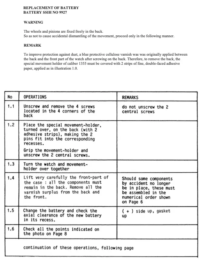

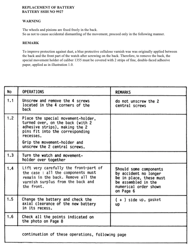

I just downloaded the datasheet, which explains the battery replacement process.
Hit the wrong button creating the link. There are special fixtures. The website where I took the photo described the process. A special tool is needed.

I remember when these watches came out in the early 80's, a very cool design. But like most of the quartz watches of the era they just weren't built to last decades, they were an effort by the Swiss industry to stay afloat. I doubt that your watch will immediately start working with a new battery, as @sheepdoll mentioned the voltage of the old mercury batteries was lower than the current batteries available. The original Accutron had the same issue, but a resistor could be installed that would allow non mercury batteries to be used. Whether this is possible with your watch is unknown, probably not worth the effort.
It appears that your watch has a factory gold bracelet, and that is where the value lies. This isn't a collectible watch, especially if it won't work anymore. Unless it holds great sentimental value you might want to consider the melt value, then buy something else that is more wearable, or put the funds to other uses.

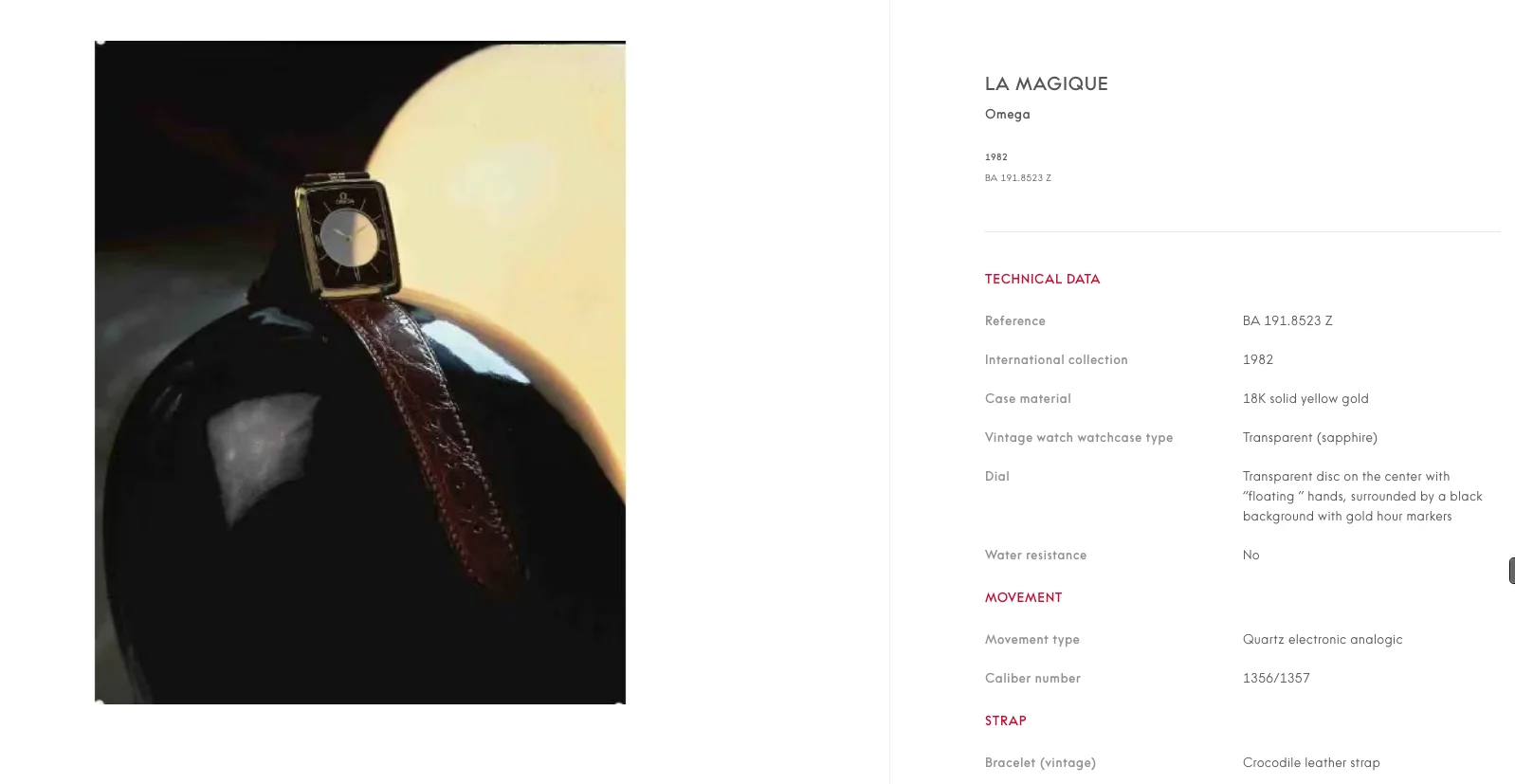

I think I fount the right search term 191.8523 I was looking for a more detailed data sheet. Mostly to see if I could find part numbers for spare gears, movement plates, circuits etc from scrapped cases. I did find this which seems to be the source of many of the quoted reference data.
I also found a way to old listing here. This also quotes much of the same info.
While most listings of this reference do include the word Scarface, Most recent research indicates this is not the watch used in the film.
The best I can figure is the caliber on these is 1355 or 1356/1357. The problem searching auctions for these parts is that the numbers overlap some of the escapement parts and jewels. 1350 is a small ovaloid watch. I did find a listing for a way overpriced ladies movement what claims to be 1355

Replicating an electronic module is not difficult. Getting it to run on a 1.57 cell is a bit tricky as the little micro controllers prefer closer to 3V. I did dismember a stepping motor, which was a bit too small for the optical flow scanner. Other project take priority to that one.
