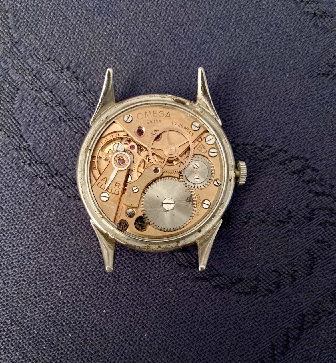

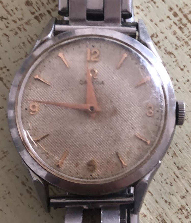

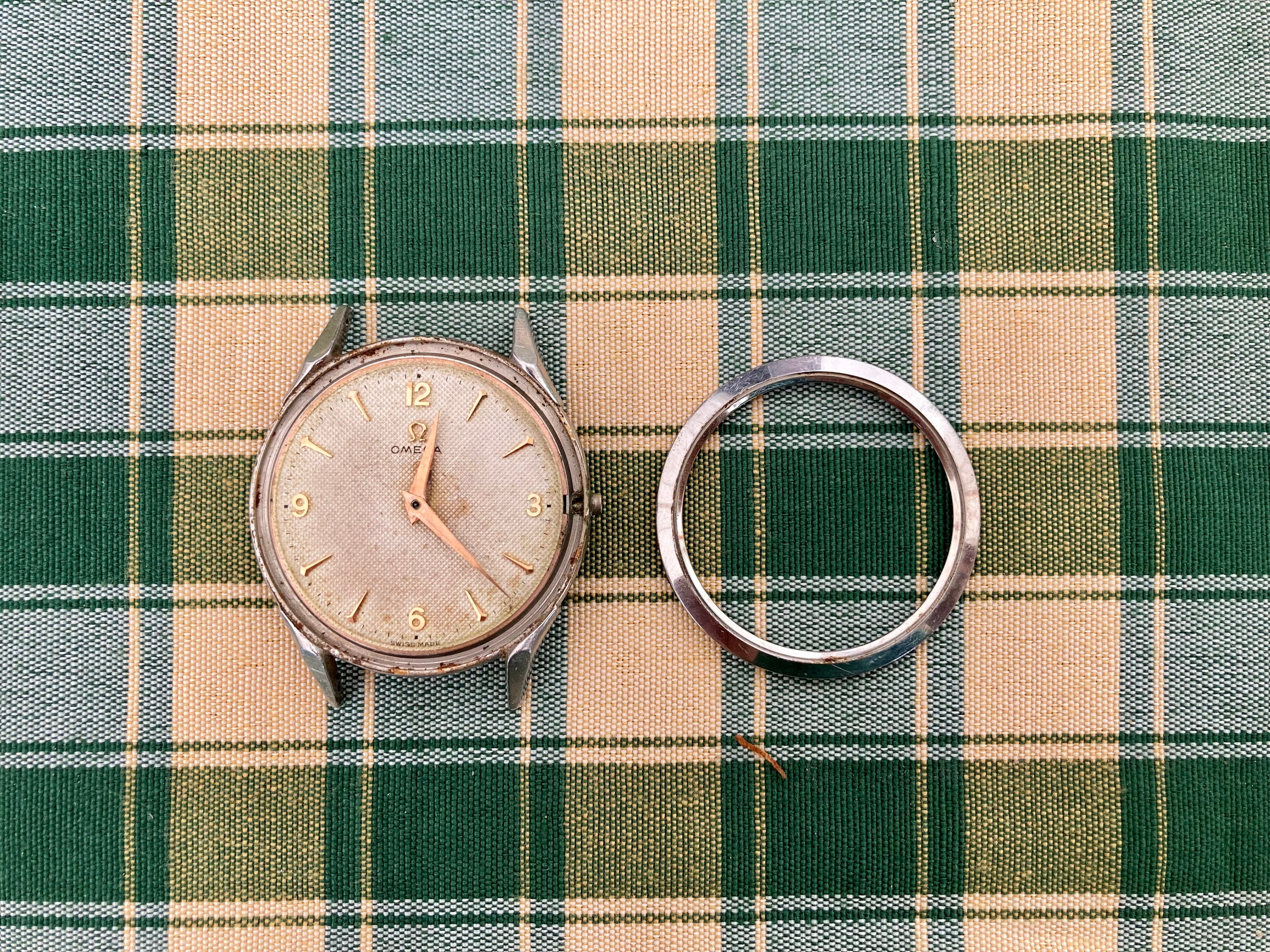

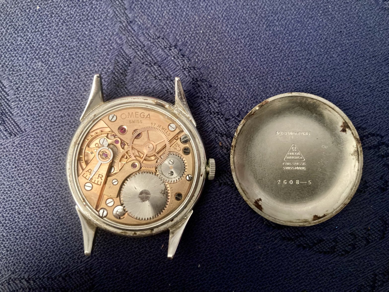

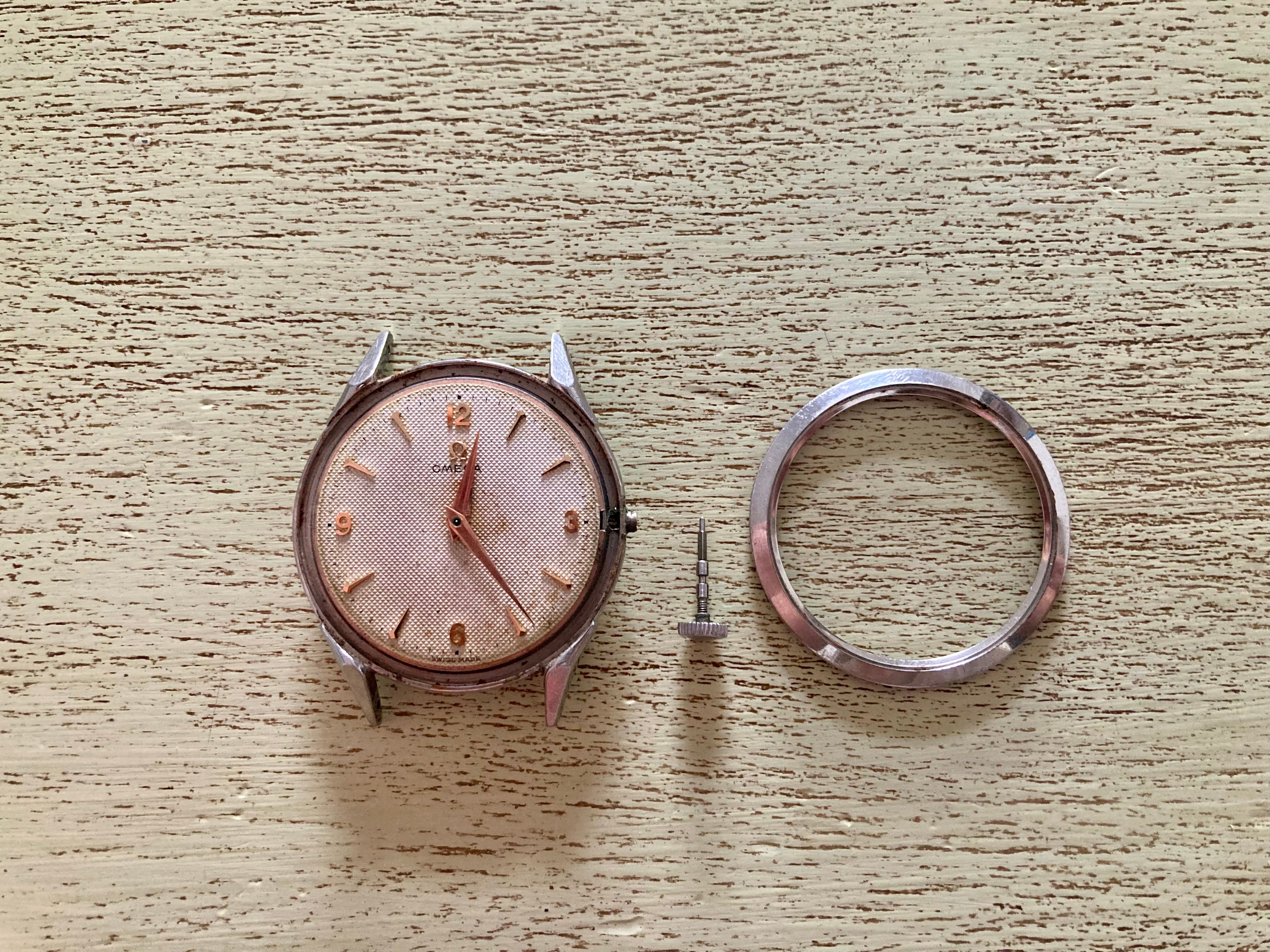

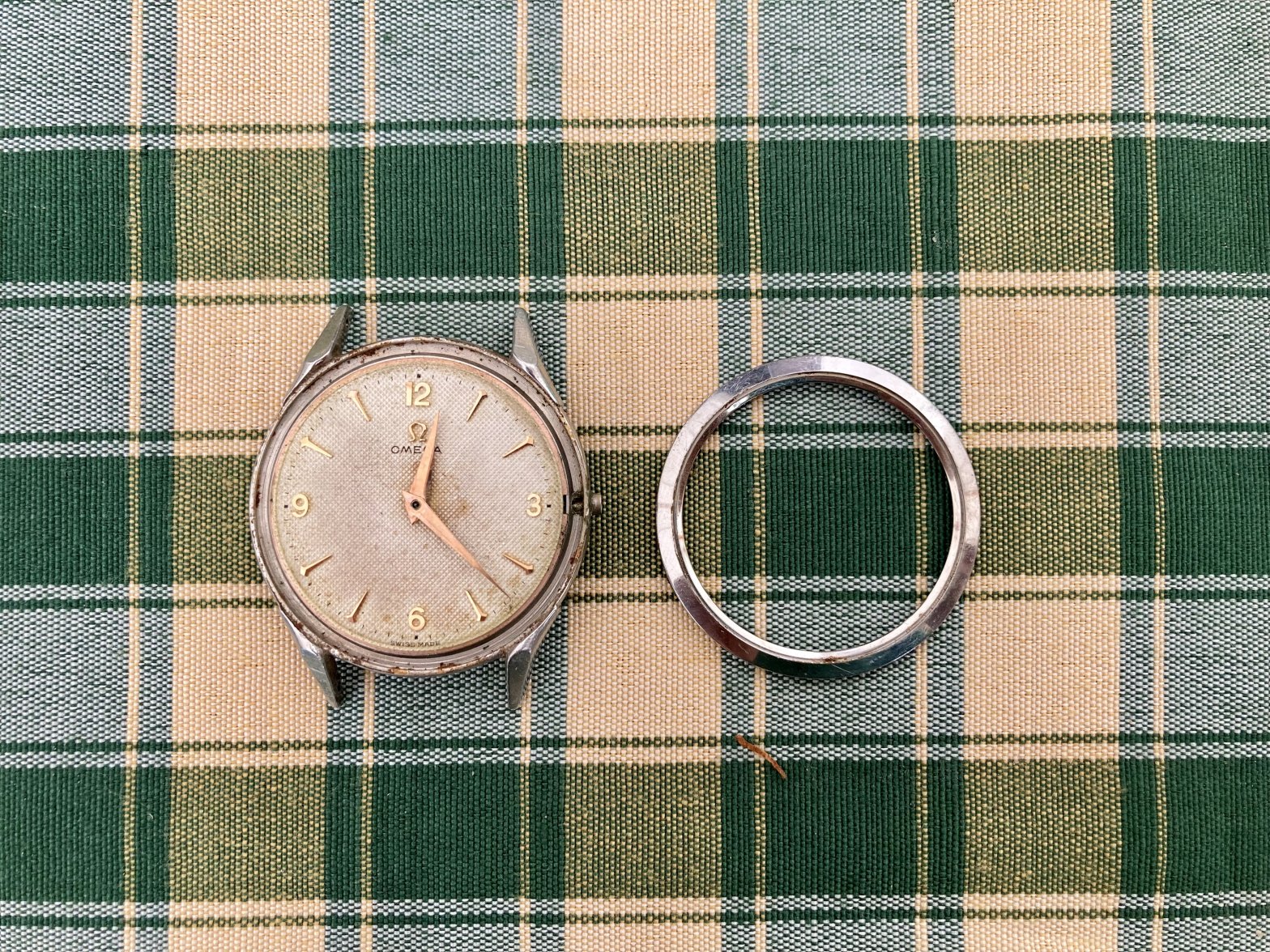

Hello everyone,
I am a neophyte in the world of watchmaking and I would like to introduce you to this Omega from the 50s. I am thinking of having it restored and overhauled, what do you think? For the information that I am posting here I must thank the participants of an Italian forum (O&P) who have provided me with great help. Here are the data of the Omega and then my questions and images:
Omega Honeycomb dial, year 1952
material: steel
On the movement: Omega Swiss 17 jewels / 283 / reference 13092715
Inside of the caseback: reference 2608 - 5
What do you think of this Omega? Is it worth restoring it? Can you provide me with information on its history, availability on the current market? It seems that the second hand is missing and therefore I should find it.
  • was this watch sold with a leather strap? What should its contemporary buckle be?
  • could this watch be paired with a steel bracelet? What is (or are) the contemporary Omega bracelet?
here are the photos

Hi, welcome to the forum.
It would help if you could provide some guidance as to what you’d like to do with the watch (sell, wear, keep etc.)
The answer partly depends on whether you paid for it (or inherited it) and what you’d like to do next.

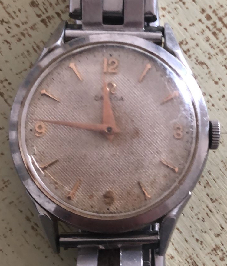

A service of the movement is recommended if you plan on wearing it often. However if you plan on selling it, it might not be worth doing. The hands are probably not original, and the second hand is missing.
Usually there is no way to restore a dial other than repainting it professionally. This diminishes value, as it’s no longer original. But value is also dependent on the condition of the dial, and this one has some stains. Yours seem original (others might chip in to validate the statement) so the question is how much do you care about originality, and can you wear like this? Do you like it? If you want to sell, best to leave untouched.
If you start adding work to the watch, and have some money invested in it already, it can become quite expensive. So this would only be worth if you’re wearing it and do not care too much about resale value (ie. it has sentimental value).

Hello and thanks for the welcome. I found the watch at home, I intend to have it fixed and recover some pieces to restore its originality (seconds hand which I have no idea what it might be, buckle or bracelet). I don't want to sell it but wear it and enjoy it.

P.S. I am here to receive advice from the most experts to guide me in making sensible choices. I don't want to repaint the dial.

To be honest, given the dial damage, the missing sweep hand, and the pitting/corrosion, I would probably choose to put my money elsewhere. But that's just my personal opinion.
