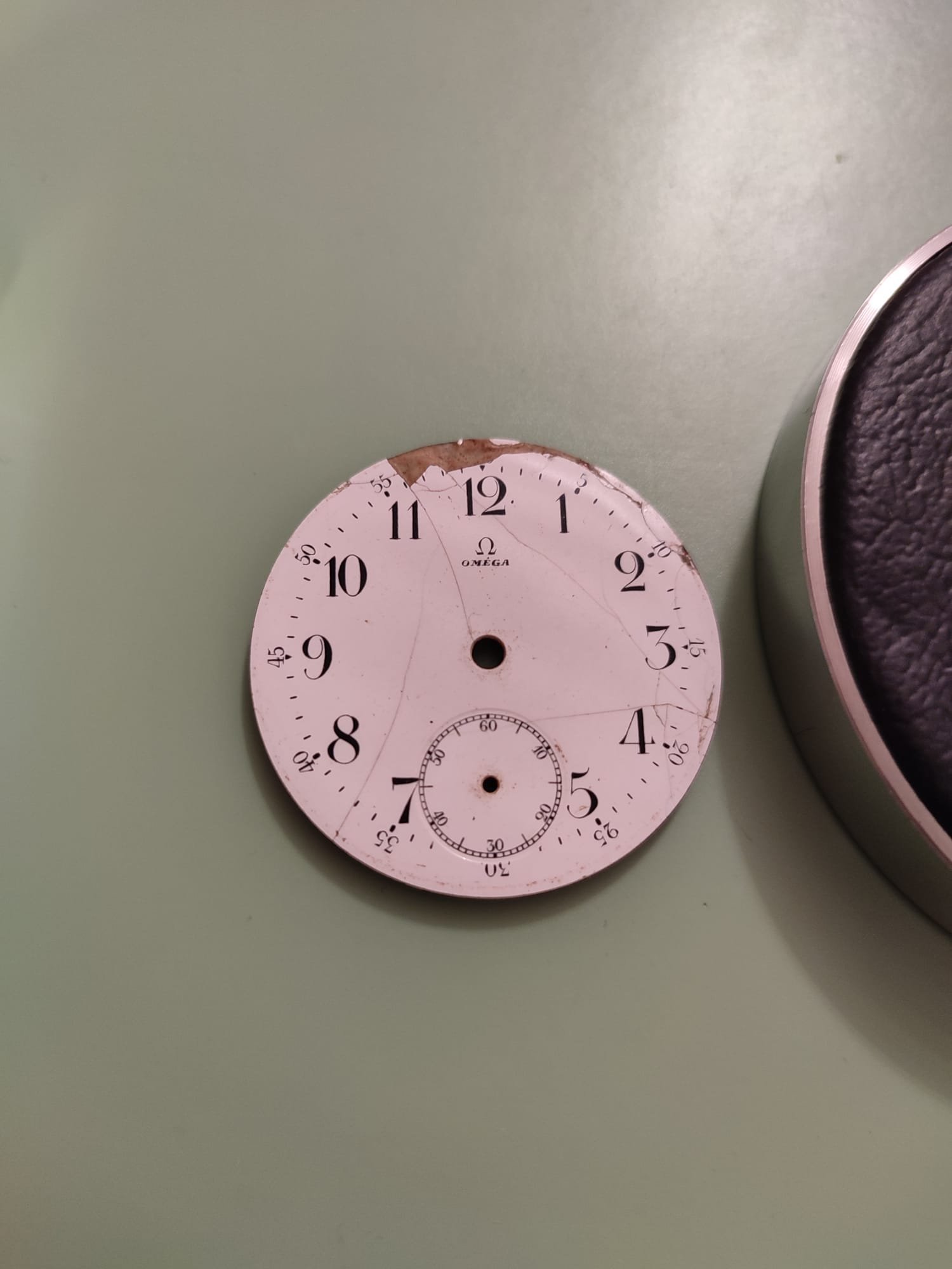

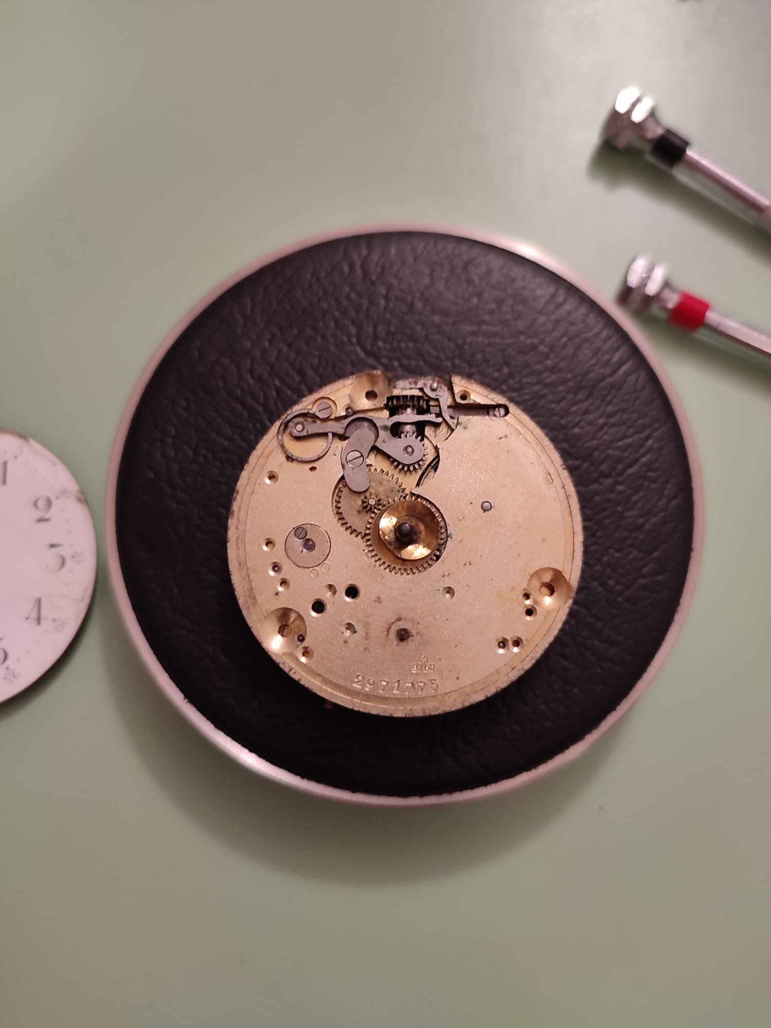

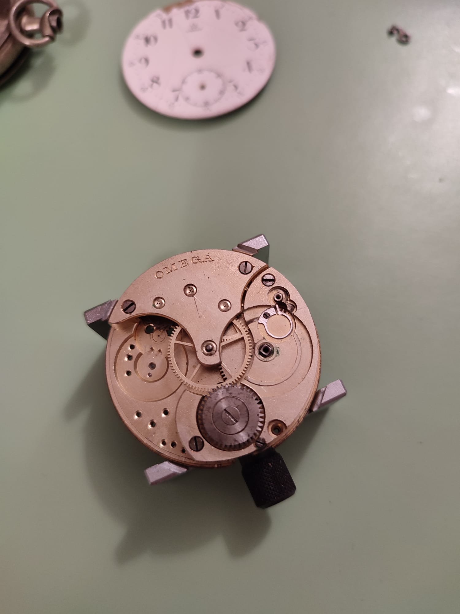

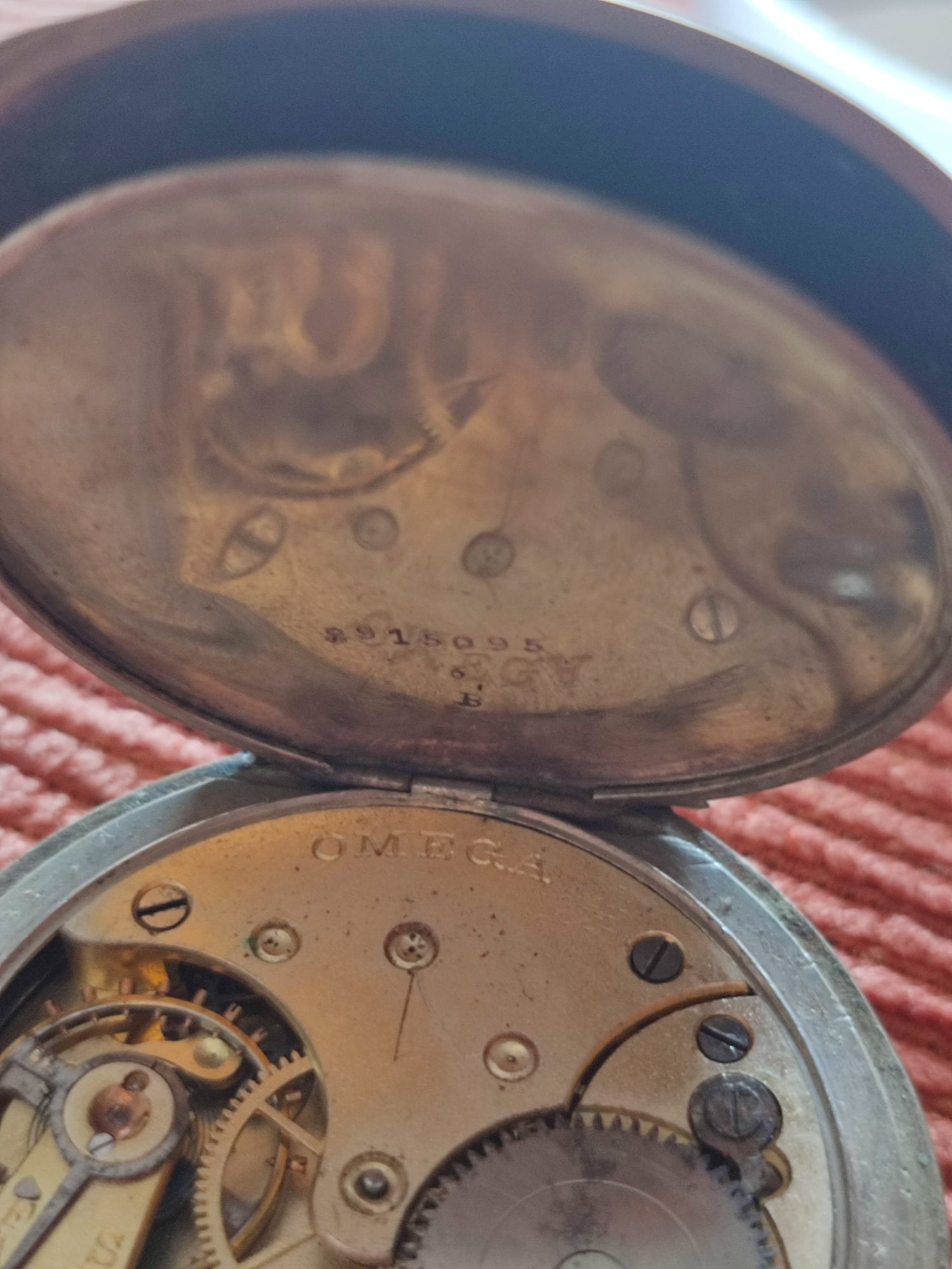

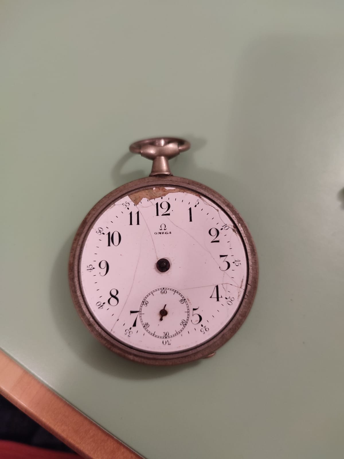

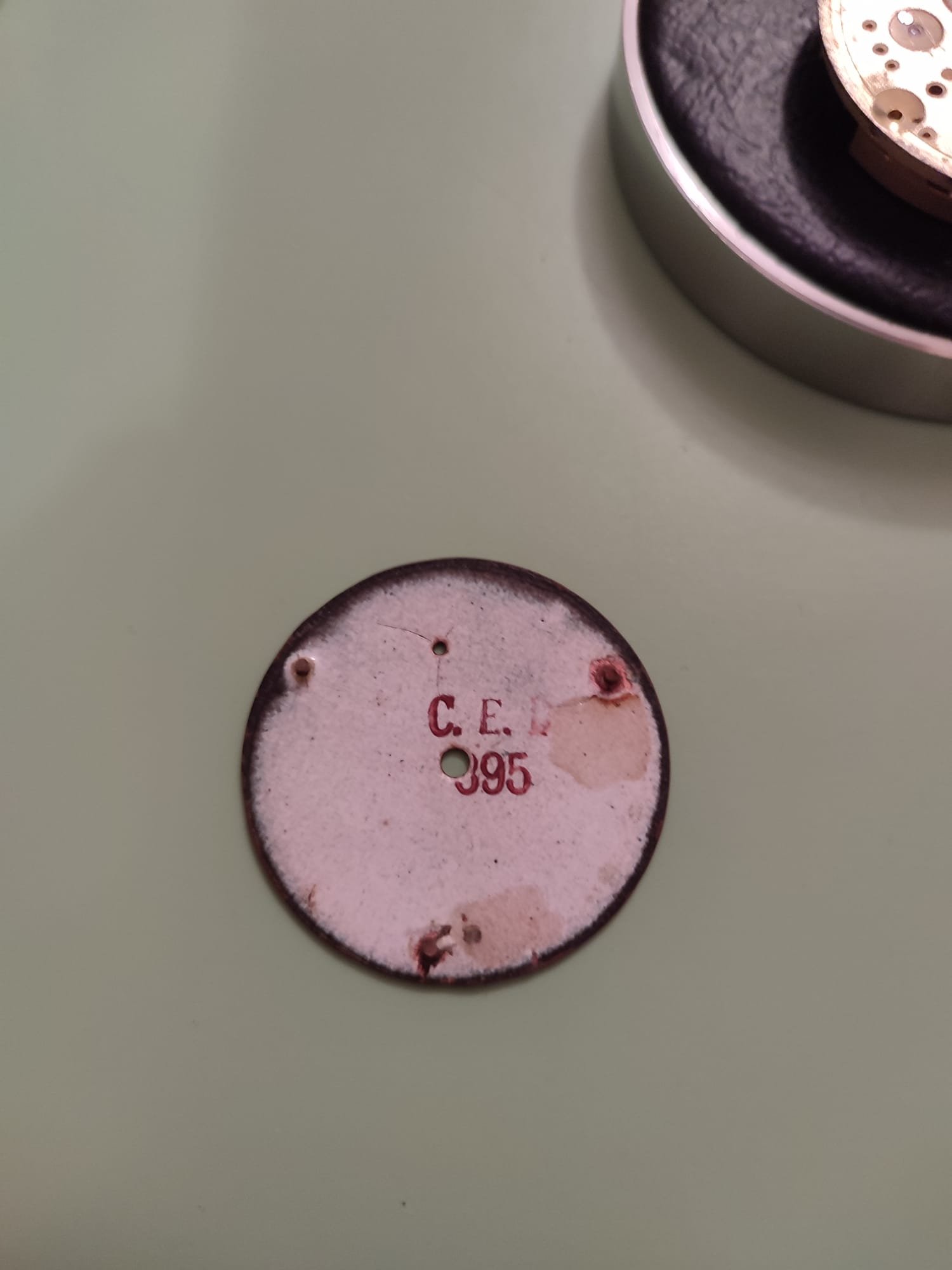

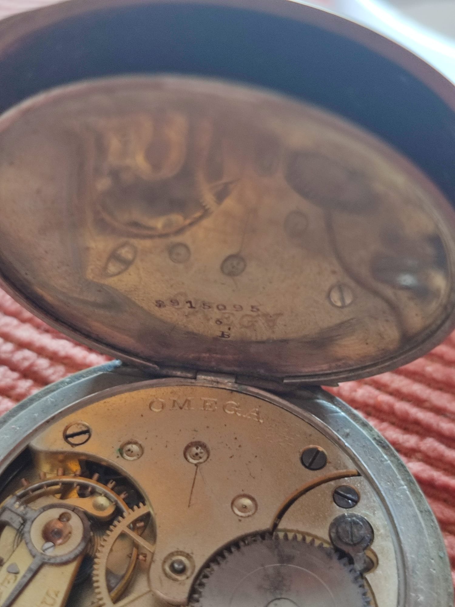

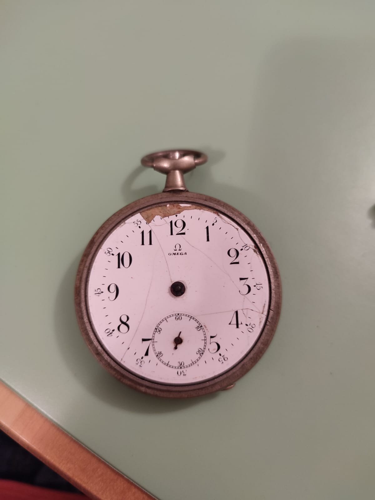

Dear Forum community,
I come before you seeking help with the identification of an Omega pocket watch that belonged to my great grand-father.
My mother recently handed me this watch which was in a drawer for more than three decades. This watch was supposedly bought in Italy in the beggining of the century and ended in Brazil where it remained until now.

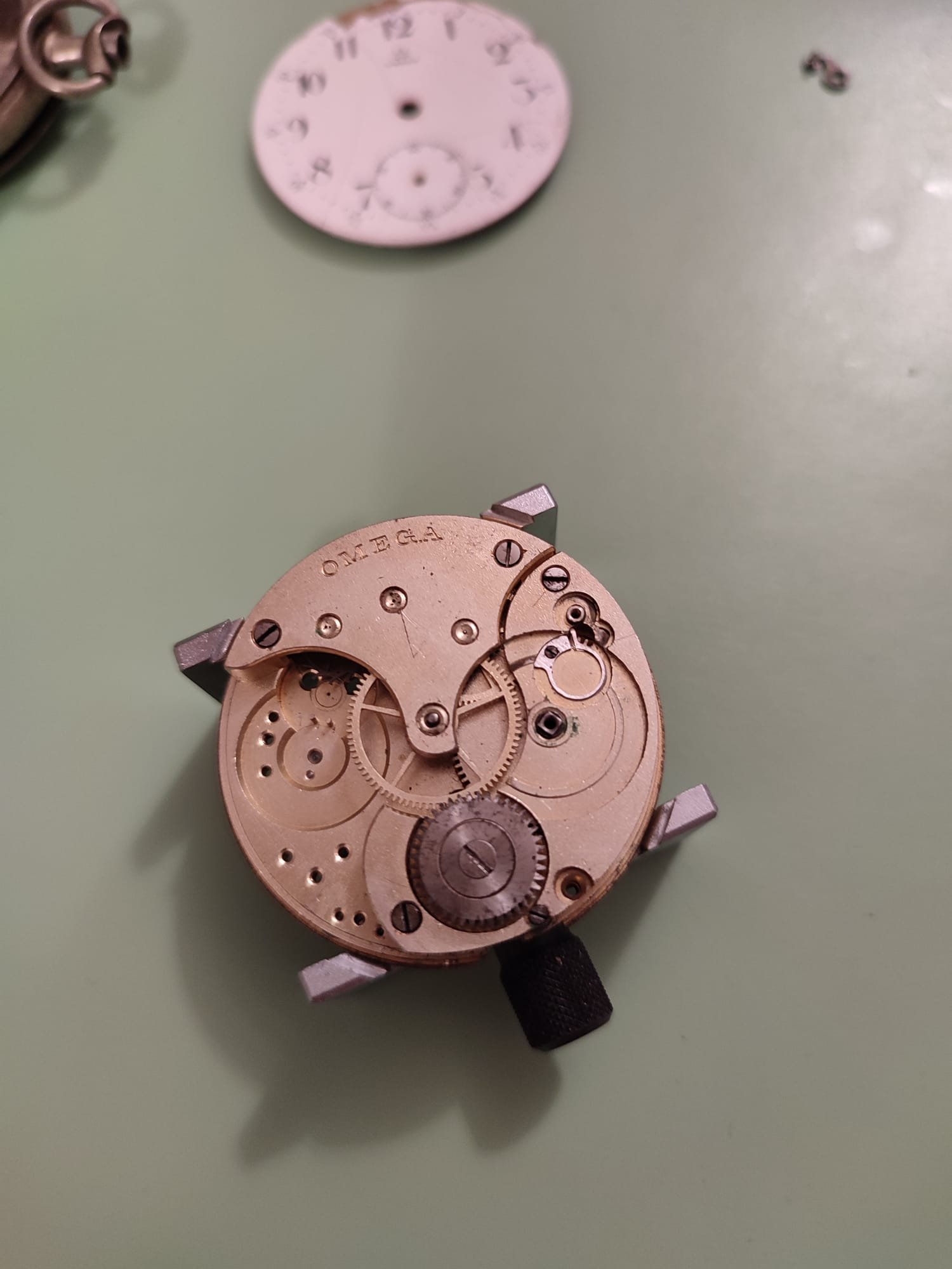

I have opened it to inspect the different pieces and found that the balance spring is broken. In order to be able to eventually find a replacement for the spring, I think it would be nice to (at least try) to identify it correctly.
Here you have some photos and some informations concerning the case and the mouvement:
- case number 3915095

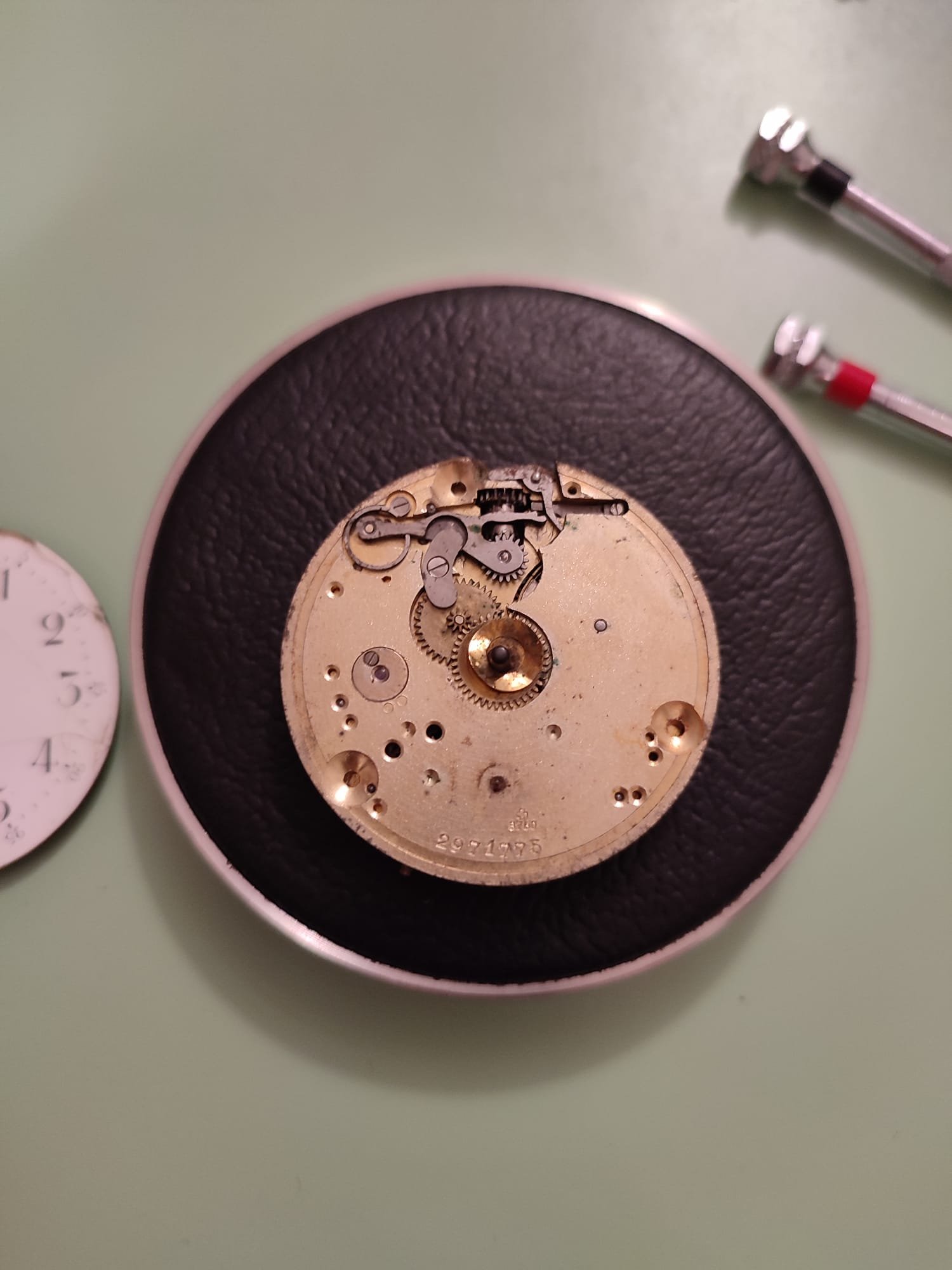

- caliber number 2971795
Any help would be much appreciated.
Thank you in advance.
Rebutini
16,002
48,155

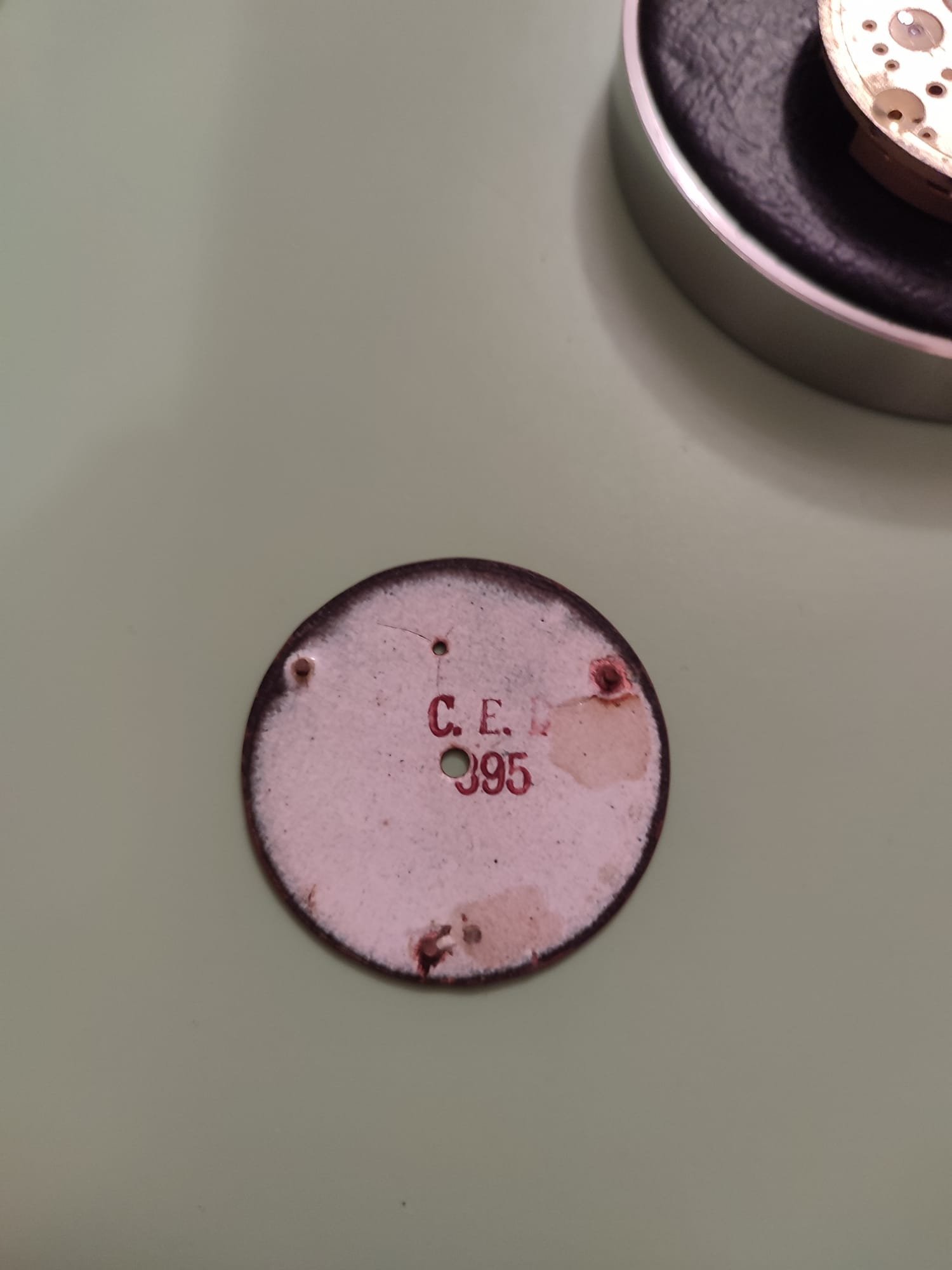

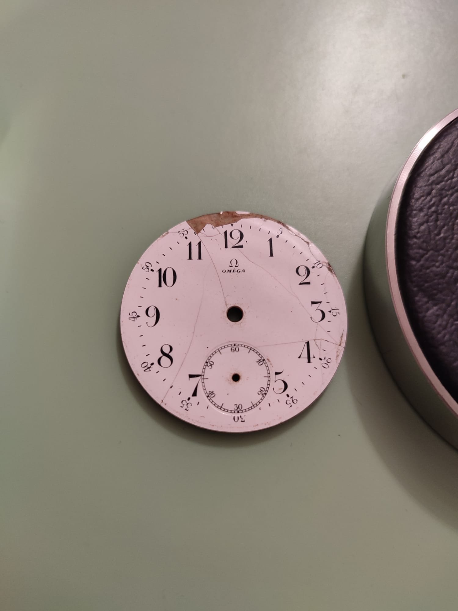

Enjoy it for its heirloom aspect, but with a damaged hairspring (your words), missing parts (ratchet wheel, stem, crown, hands), and a distressed enamel dial, (apart from the fact that it is a low quality 7-jewel movement), it is not a good candidate for an expensive restoration.

Agreed. It’s a great heirloom, but it might be best to buy a display stand for it and enjoy the memories that way.
if you wanted a functioning pocket watch to wear out of respect or in kinship, you can find a nice one for not too much money

If that's a complete watch shown in your photos, I have to agree with @Canuck.

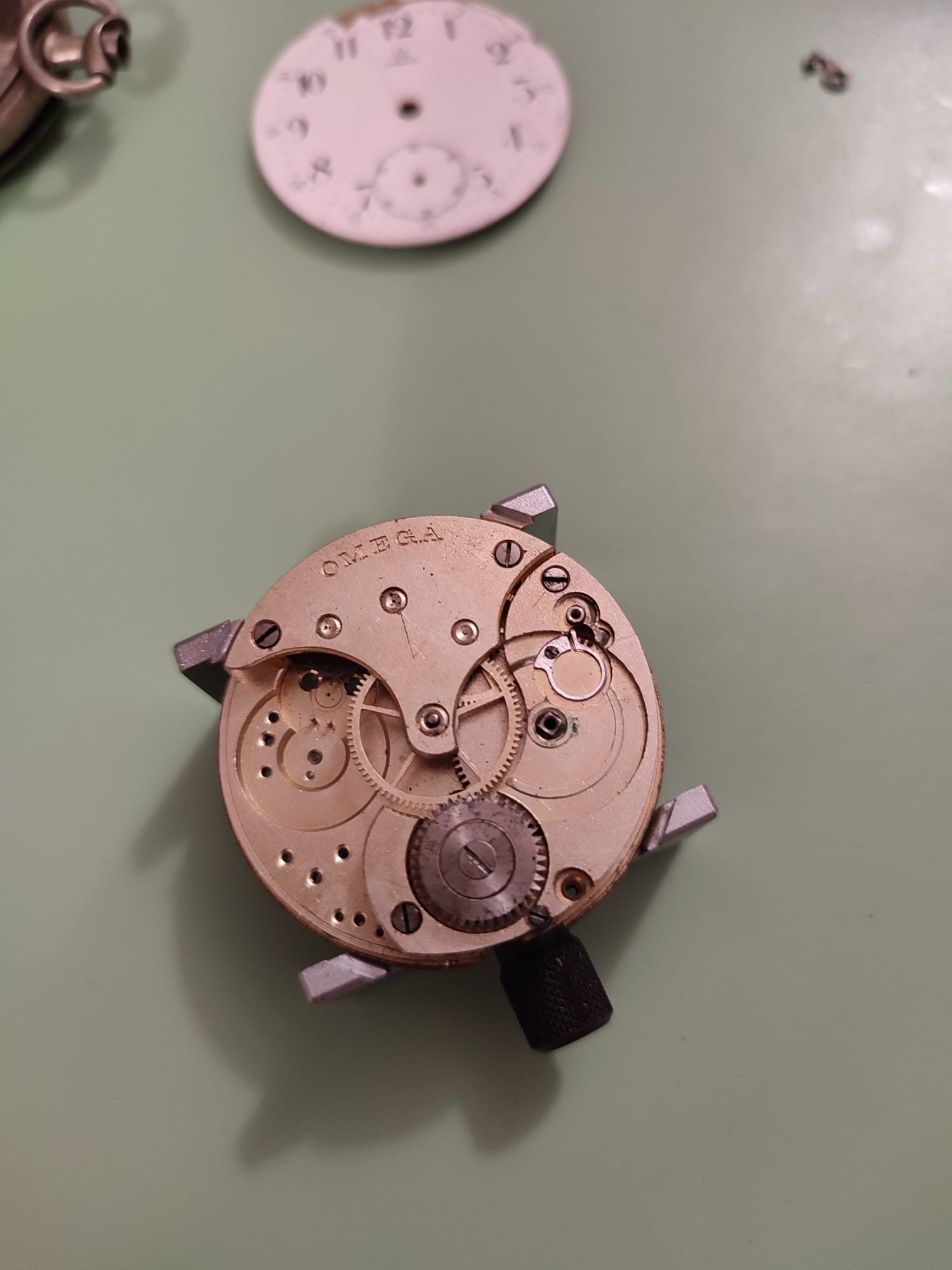

Dear all,
First of all thank you very much for the advices.
Indeed, the dial is in pretty bad shape. Nevertheless I was not planning on restoring it, I would like to enjoy it just like my great-grandfather left it. The only thing I am planning to do is to have it working again.
All the other pieces (of the movement), except for the hands (missing) and the broken hairspring, are present and in good condition. I have disassembled the watch, cleaned it and checked all the pieces under a microscope. After assembling it, and after giving it a little winding, the pallet fork shows clear signs that there is tensions. So, the only thing missing is a functionning balance wheel.
That is why I would like to find (if possible) the exact model to maybe try and find a donor movement before an eventual and very difficult endeavour (maybe impossible) of repairing the balance wheel and hairspring.
Any (more) help would be very much appreciated.
Thank you!
16,002
48,155
I’d suggest replacing the movement rather than moving Heaven and earth to try to return this one to health. If you find a donor movement which has the parts you need to return this one to health, the donor movement will be a much better prospect for a restoration. Why wreck a good movement for the sake of fixing up a wrecked movement?
