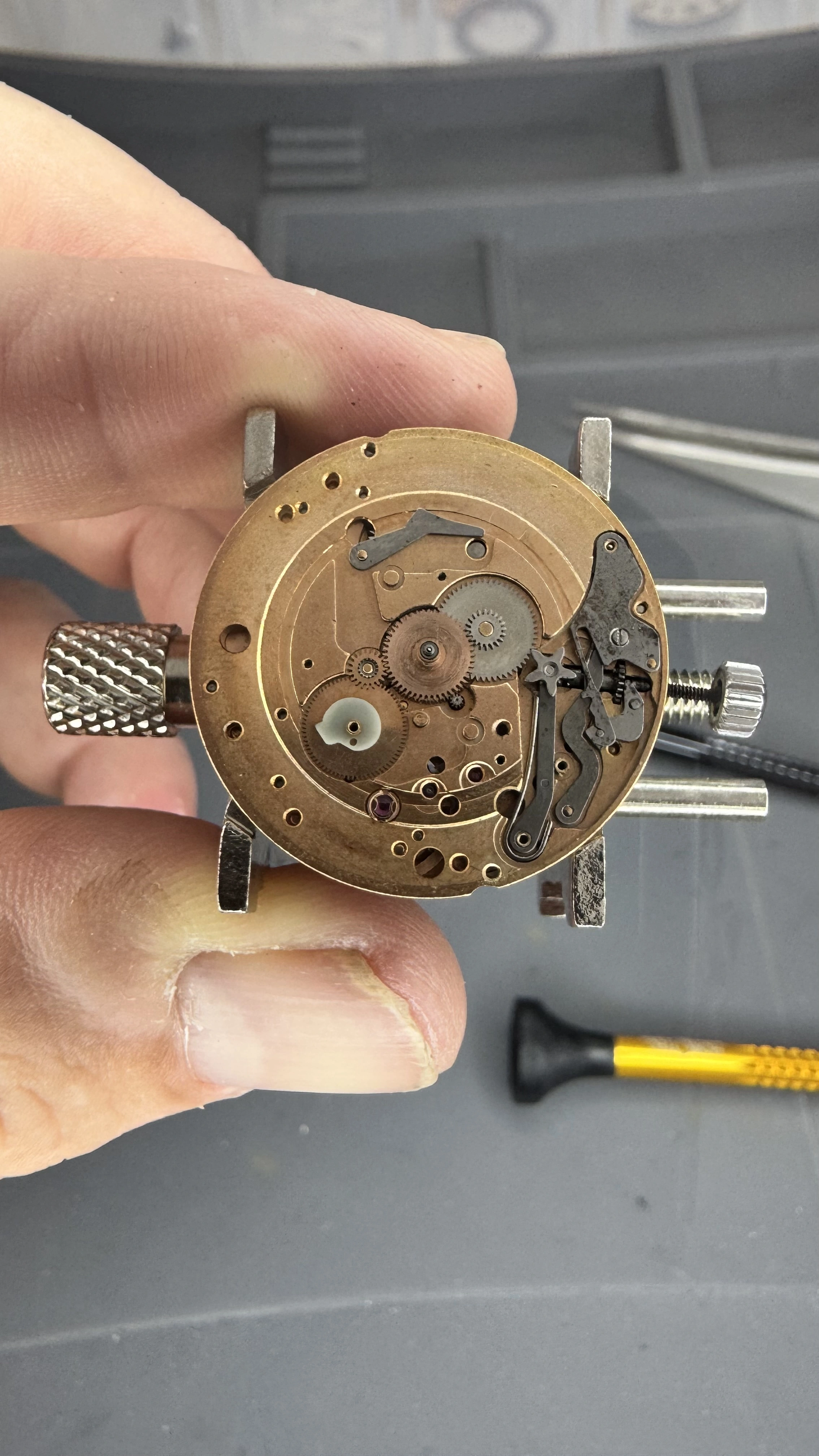

Sorry to resurrect this thread but I’m an amateur I have a similar problem on a 1012. Watch keeps excellent time, but when I go to set the time, the minute hand slips. Hour hand and date can be set just fine.
My initial theory was that the minute wheel was being pushed up and disengaging with cannon pinion by the date corrector lever. My thinking is that it has to be something to do with date corrector/ minute wheel interaction as the watch is fine on its own steam. Or could it still be the cannon pinion?
Photo shows where I’m at with the investigation.

Did you pull the cannon pinion apart before you cleaned it? Then did you lubricate it when you assembled it?

Hi Al, I did but am going to re visit it and have a closer look, I automatically discounted any cannon pinion problems because it had no problems outside of setting the time.
