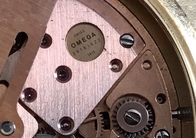

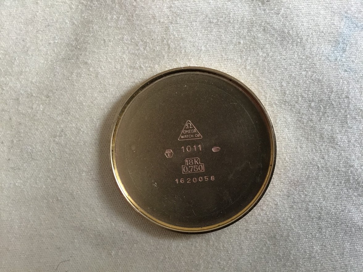

Greetings all,
Pardon my ignorance, but I noticed that my 1973 Omega has a 1012 movement, whereas the caseback says 1011.
Doing a Google search I found a similar watch with the same situation.
Is this a mismatch between case and movement, or is there a valid reason for this number discrepancy?

Thanks for your reply, but do you mean to say that it is correct for a 1012 movement to be located in 1011 case?

You are reading too much into the caseback markings. It is not normal for Omega to stamp the movement number in the back. It likely has another meaning altogether. They have on occasion stamped it on the outside, particularly on 1970s quartz pieces but not to my knowledge on the inside.
I'm saying it's not a 1011 case...

105
440
1011 engraved inside the caseback is not related to the movement, but the code for Spain. This case in gold was produced locally under the supervision of Omega’s agent for Spain, Roberto Carbonell Blasco.
191
167
Absolutely right. I also do not recall any Omega case in which the Caliber would be incribed (besides maybe some quartz watches?).
In this case it was just a confusing incident for OP.
