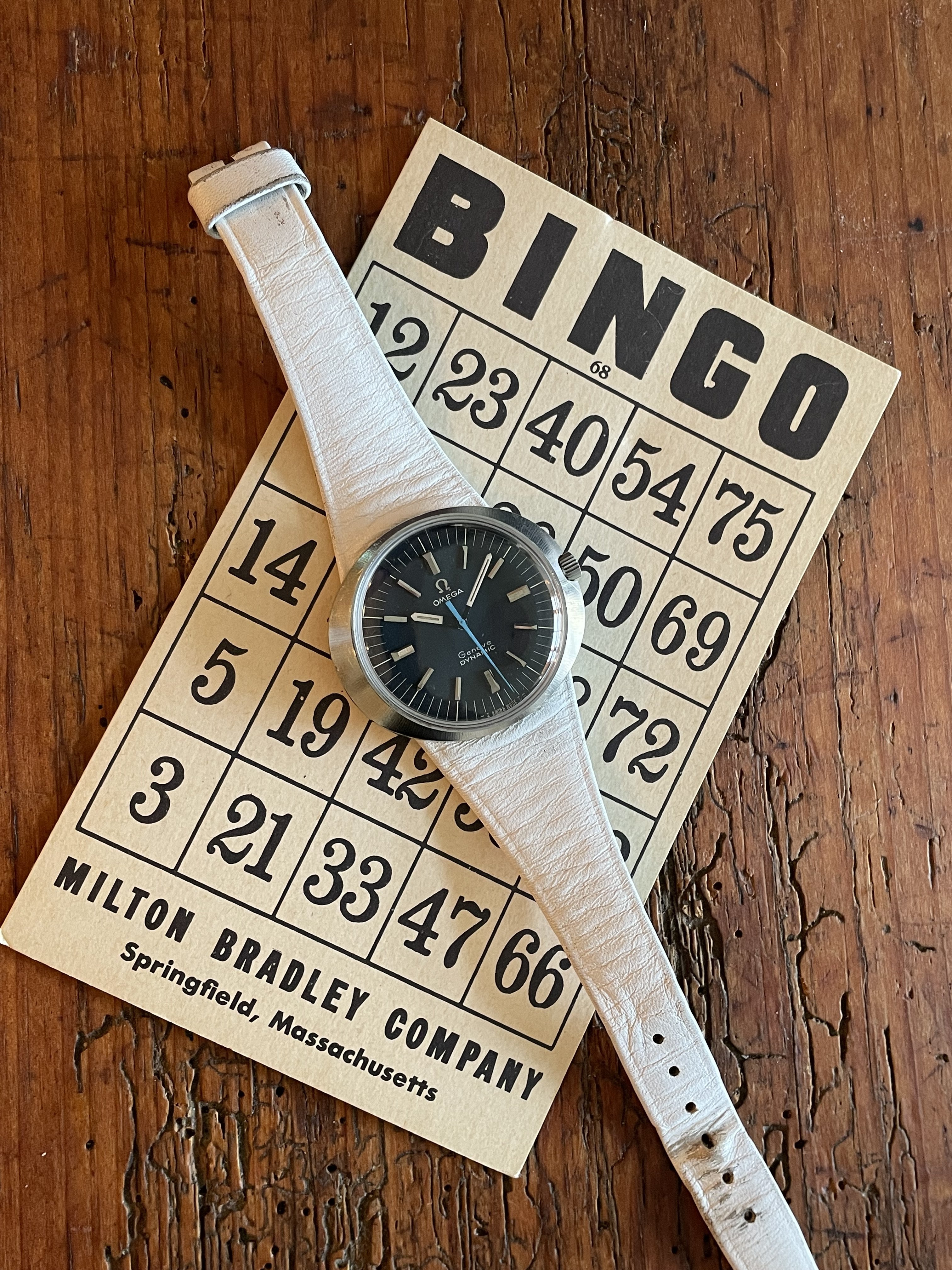

I'm new to the forum and hope that someone can help me.
Has anyone seen an example of Geneve Dynamic similar to the one in the attached pictures.
This one is for sale locally, but I haven't been able to find one that does not include "Dynamic" beneath Geneve. Also, I haven't been able to find one with indices similar to this one.
I love the look of this one but without a reference number I haven't been able to track it down and because I haven't been able to find another example without Dynamic on the face, I'm just a little concerned.
Has anyone seen something similar?

To me that looks like someone stripped off the paint on the dial, and drew some lines on the bare metal with a fine sharpie.

If it's £50 or less go for it and then put it straight on eBay starting at £125. Looks like a bad attempt or got bored halfway through redialing
504
259
Then put that money towards a better one.

Unless it's really cheap it'd be a hard pass for me.

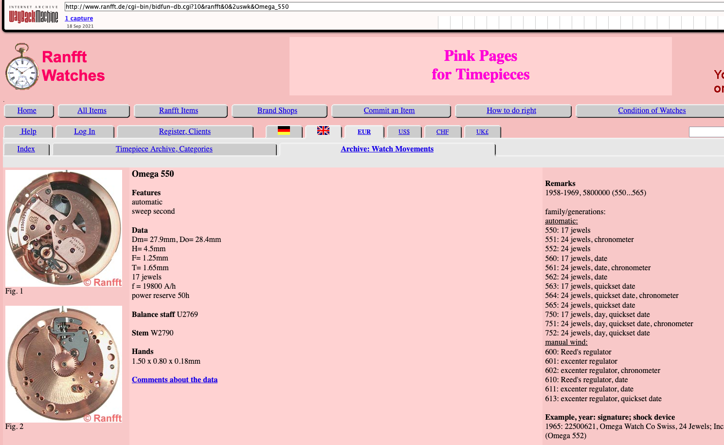

I did a check of ranfft. The new site does list 550 as the base caliber. So I pulled up the archive.
So 613 should be manual wind quickset date.
Trying to figure out all these variations is a challenge. Especially when Ranfft is spotty. At least is shows the dyle side without all the date stuff.

The no date automatics, 550, 551 and 552 all have the same dial foot positions as do the hand wind no dates and IIRC the same holds true for the date references, additionally no differences between the QS and non QS versions.
Thanks.
5
Thanks Winston. I appreciate it.
5
He's asking $550 CAD. Lot's of other good options out there.
Thanks @rendo. He's got it listed for $550 CAD. I'll definitely pass. Lots of other good options out there.
