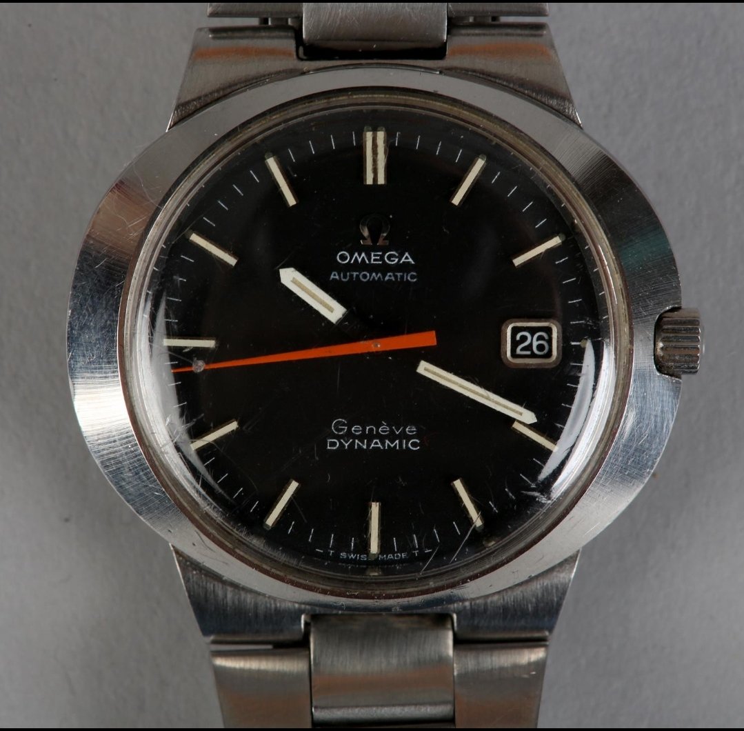

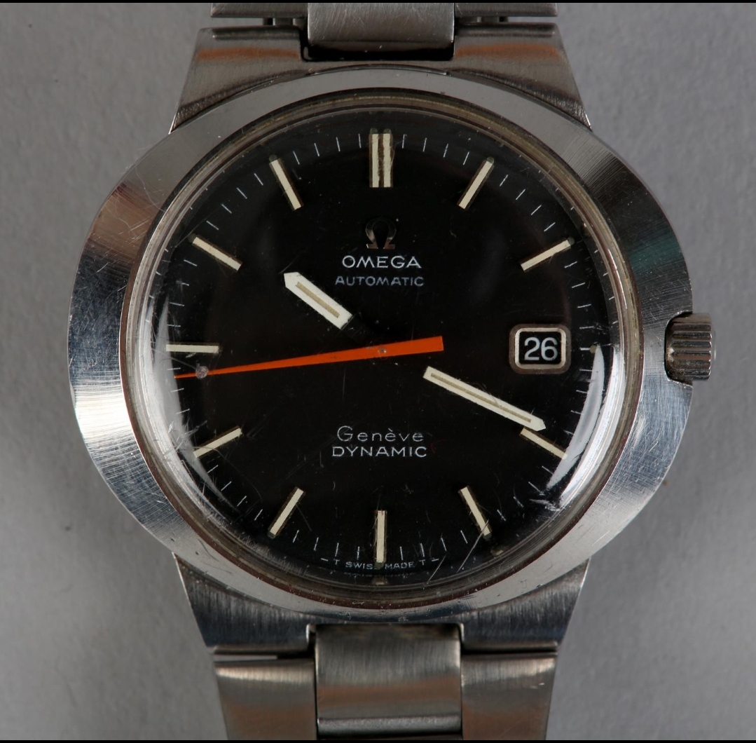

This watch is up for auction and tempted to leave a bid.
Before I do I have the following concerns:
Are the words Automatic & Dynamic slightly off centre?
The serial suggests '69' but the movement and cal date from '67' (166.039 Cal 565). Would it be reasonable to suggest this is just a watch from the end of the run with that cal, or would it be a red flag?

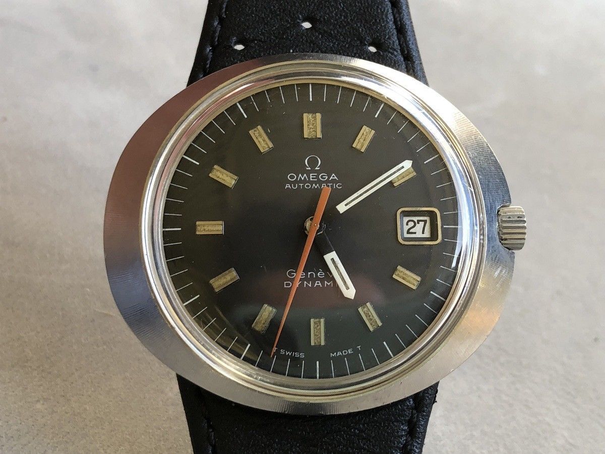

The lighting on your photo isn’t great, but I don’t see anything immediately amiss here. I’m not at home so can’t take a decent picture, but here is my MkI for comparison:
Cal 565 should be fine for a ‘69 Dynamic. Mine's a 1968 serial and also has cal 565.
Maybe just me looking too hard after reading up and trying to educate myself with varying degrees of success!!

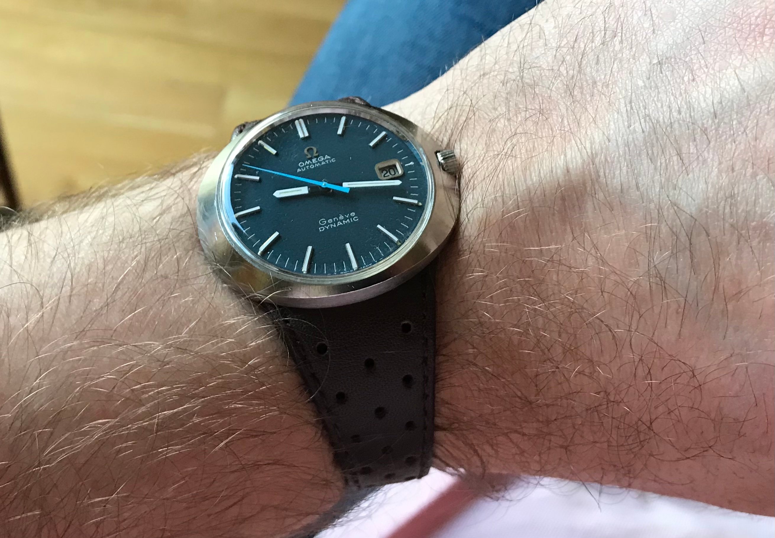

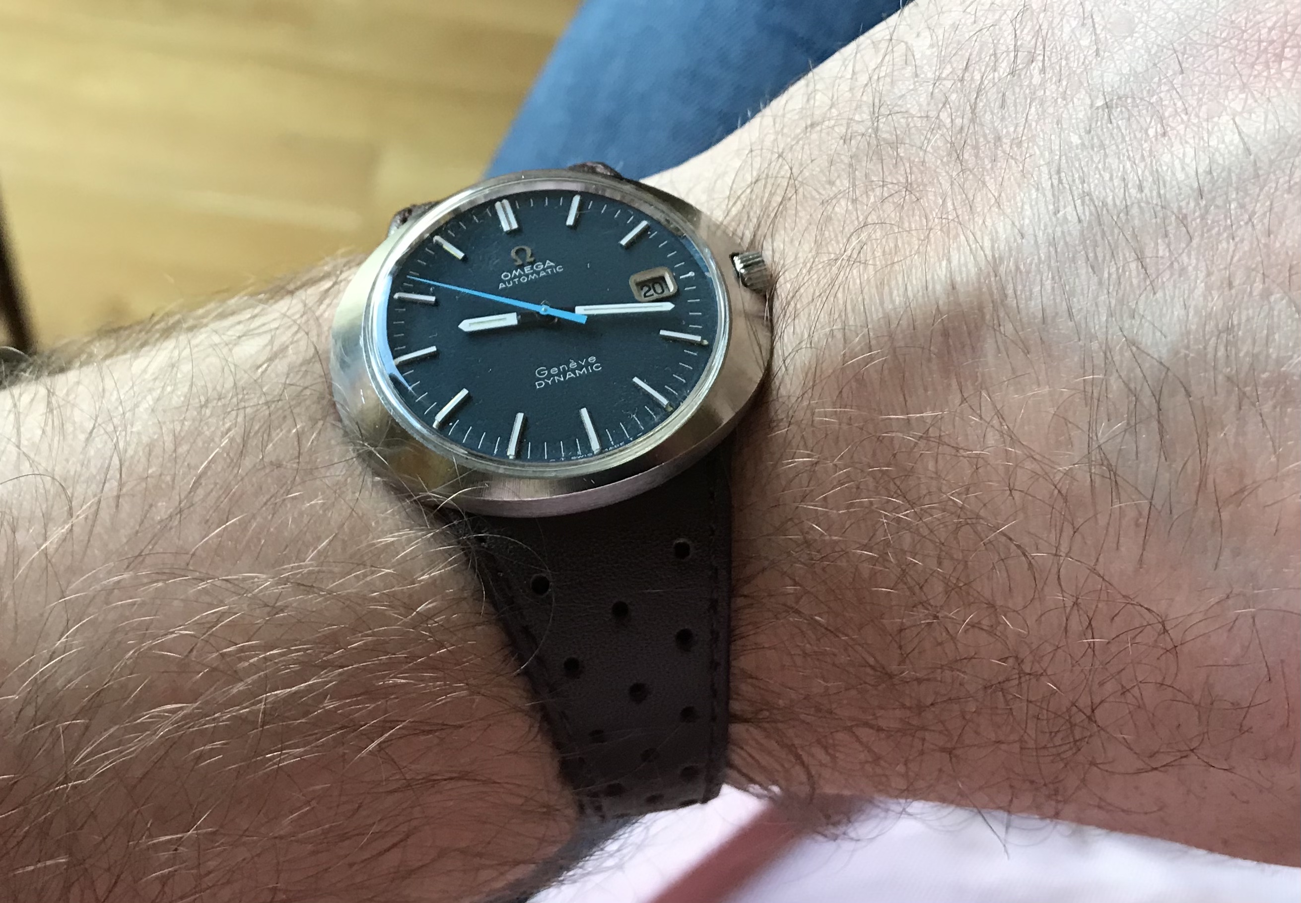

It all looks good to me. I bought mine in 2018 and wear it often. It fits so well on the wrist. The next year I got a blue dial for my birthday. Here's my black dial saying hello.

Letters are not off center. Sometimes the head of the watch will move within the bracelet’s ring and it makes the dial look crooked. All you have to do is loosen the watch lock ring re-center it and tighten it. Best of luck! I love all Geneve Dynamics! They are great pieces.
