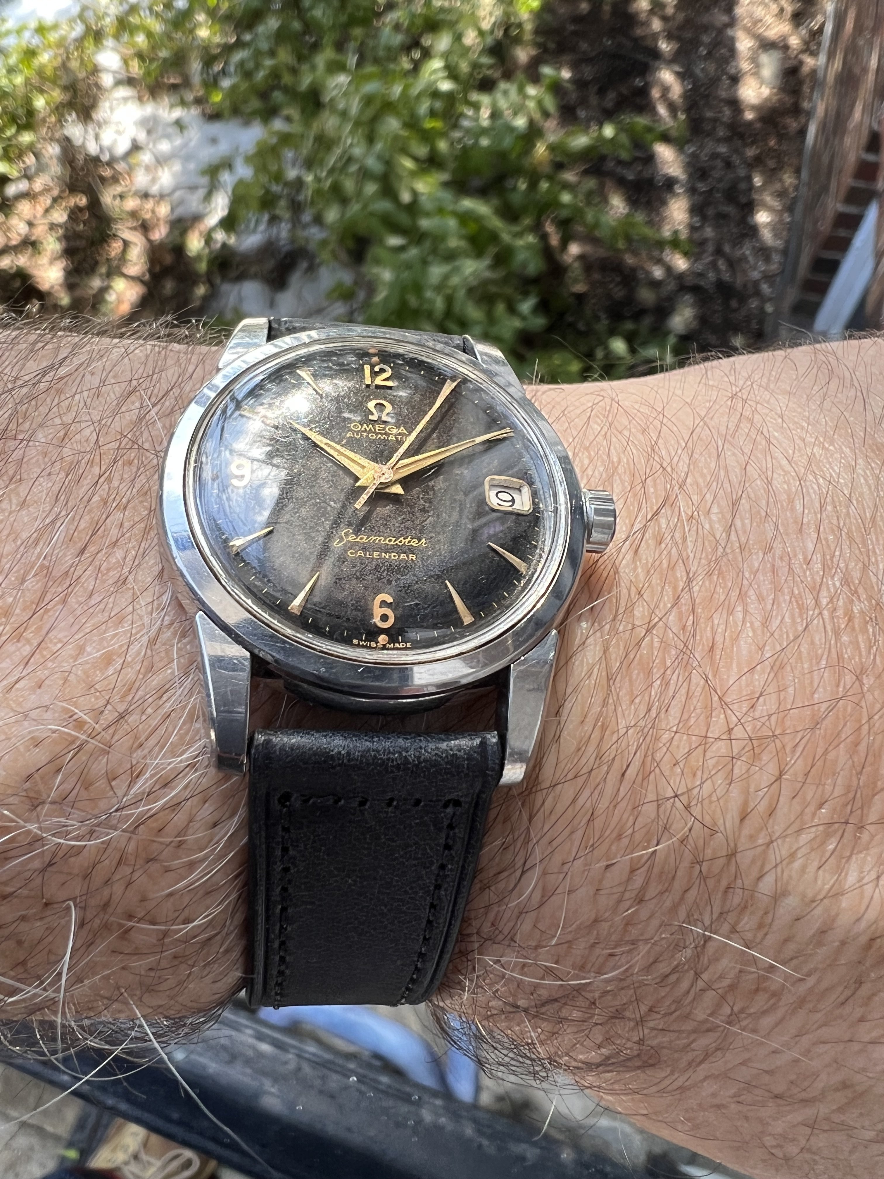

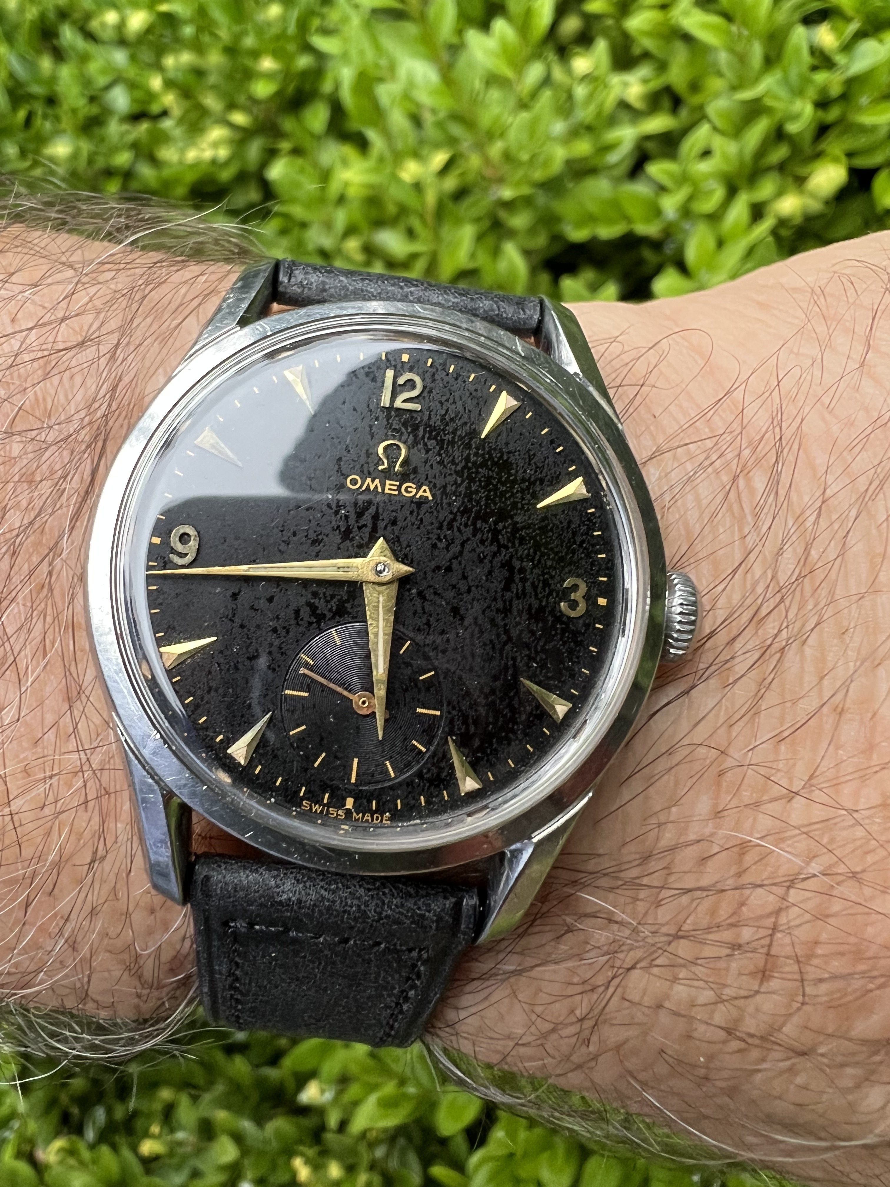

2 50s era black dials with normal dial patina visible with closeup natural light, not so much on wrist.

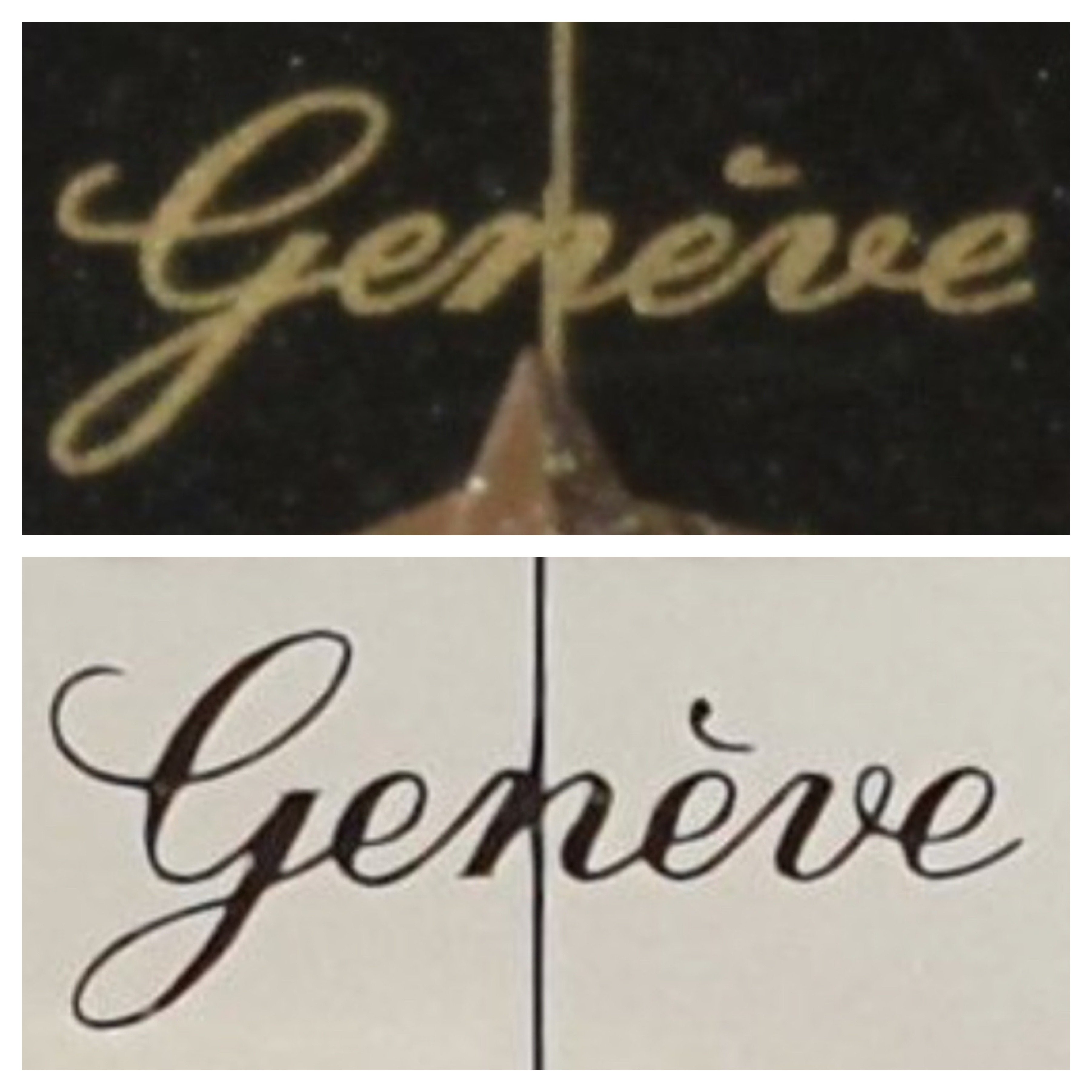

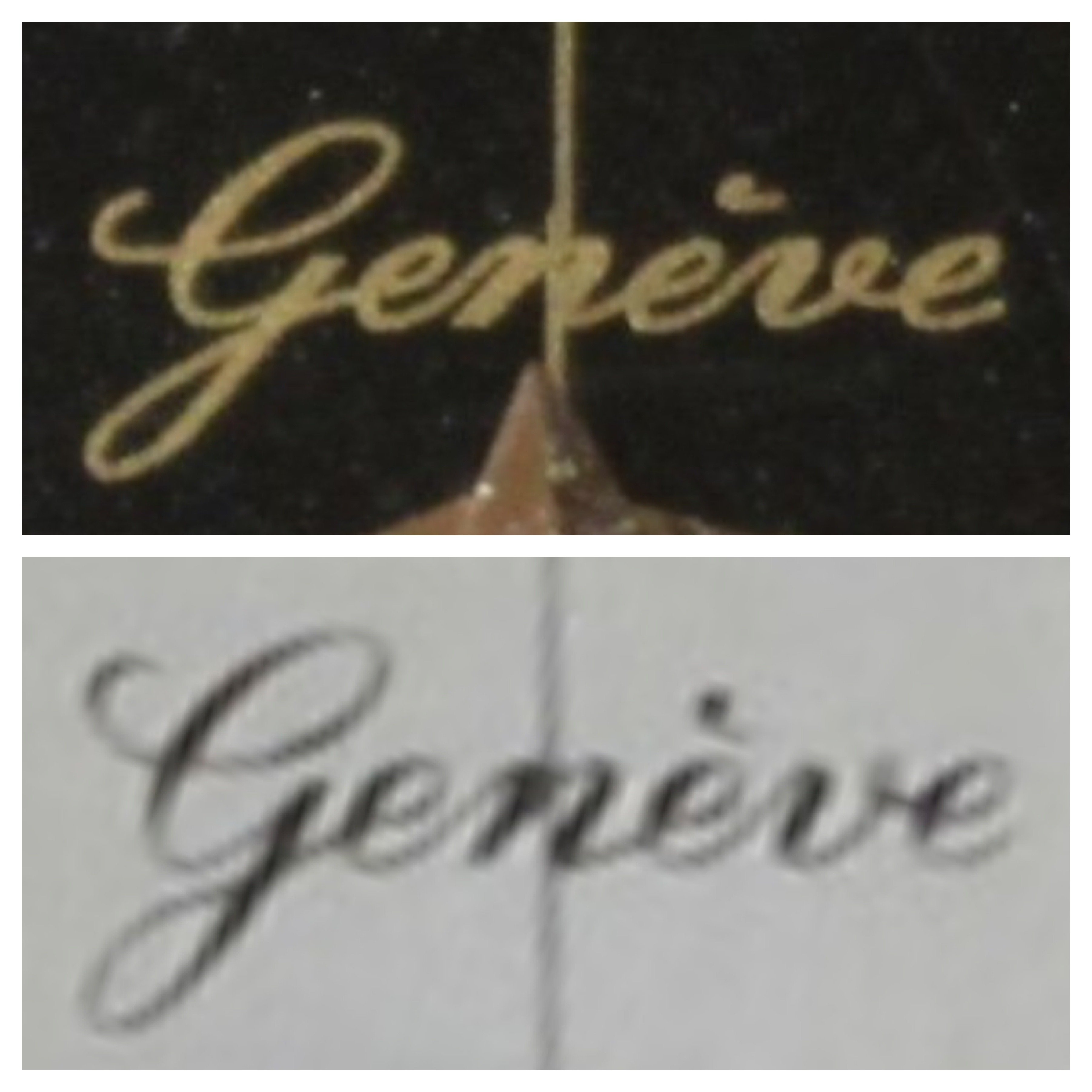

+1, I don’t really have doubts. Look at the comparison, despite the low quality of the pictures the differences become apparent. The swirl at the left of the G, the e is rounder, the n in a different angle, the accent at a different position, etc etc. Black (top pic) is the OPs watch, bottom are two of the users’ watches:

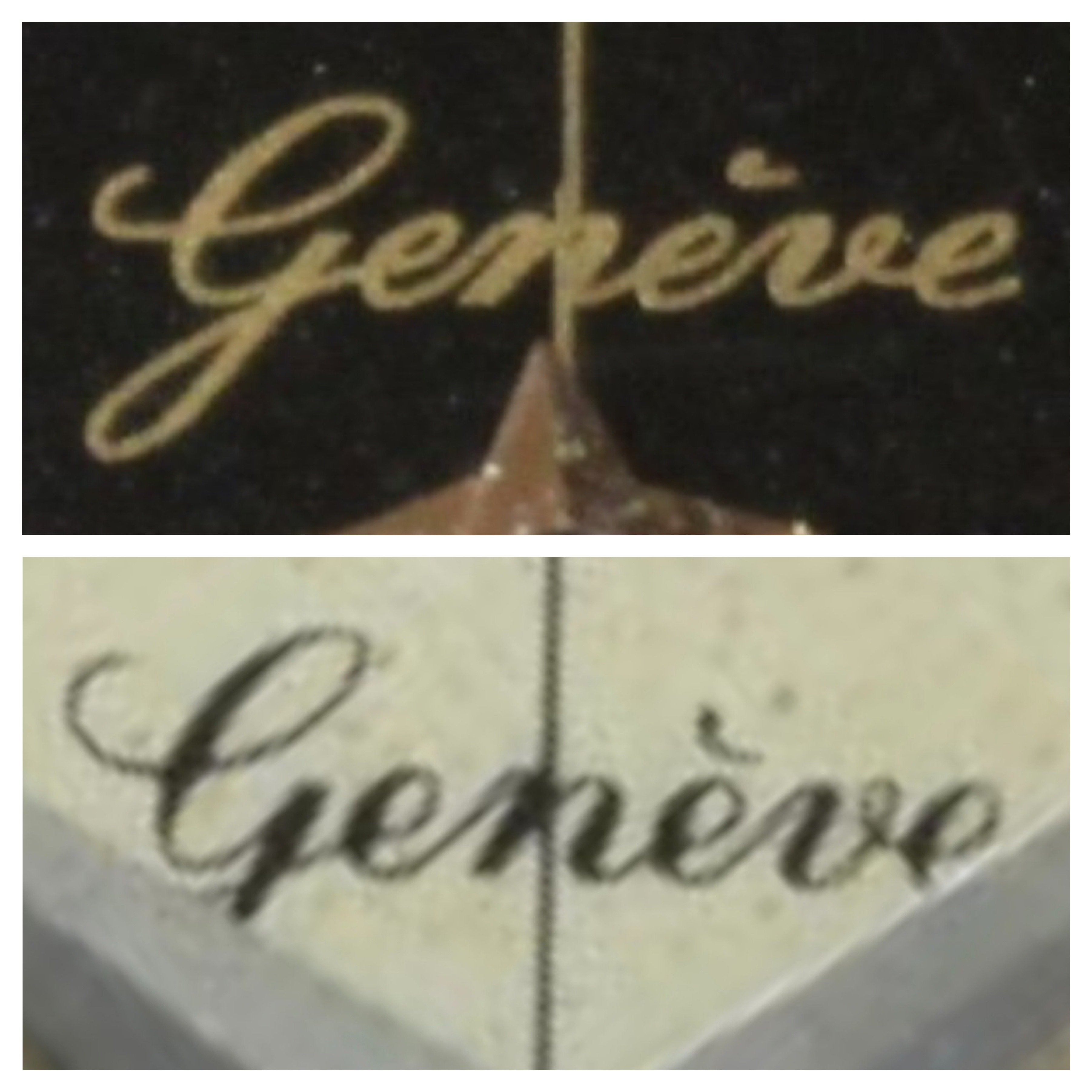

Here’s a comparison to another one:

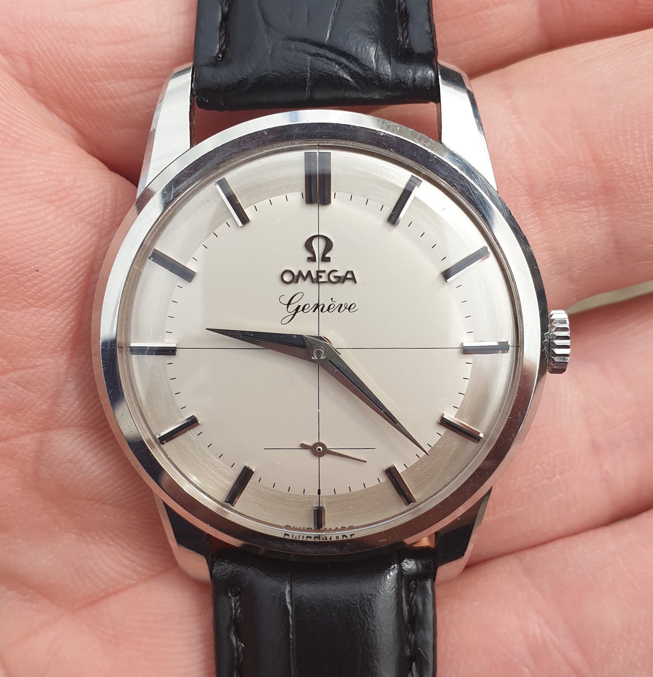

My white dial.
No reason a black dial should be much different.

My white dial.
Is that my old Geneve? Sharpest example I’ve ever seen. Really beautiful.

Thank you, that picture makes it even more obvious:

In my experience, this is how original, early, black dial Geneve dials typically patinate. I have already posted that one that I owned, which is broadly consistent with these:
Note that there are some very well preserved silver dials on early Geneve examples, but I would argue that they typically mask the degradation associated with finishing lacquers much better than black dials. Note also that I find this to be true for many other brands and models, including, for example, the first generation ref. 666 IWC Ingenieurs.
