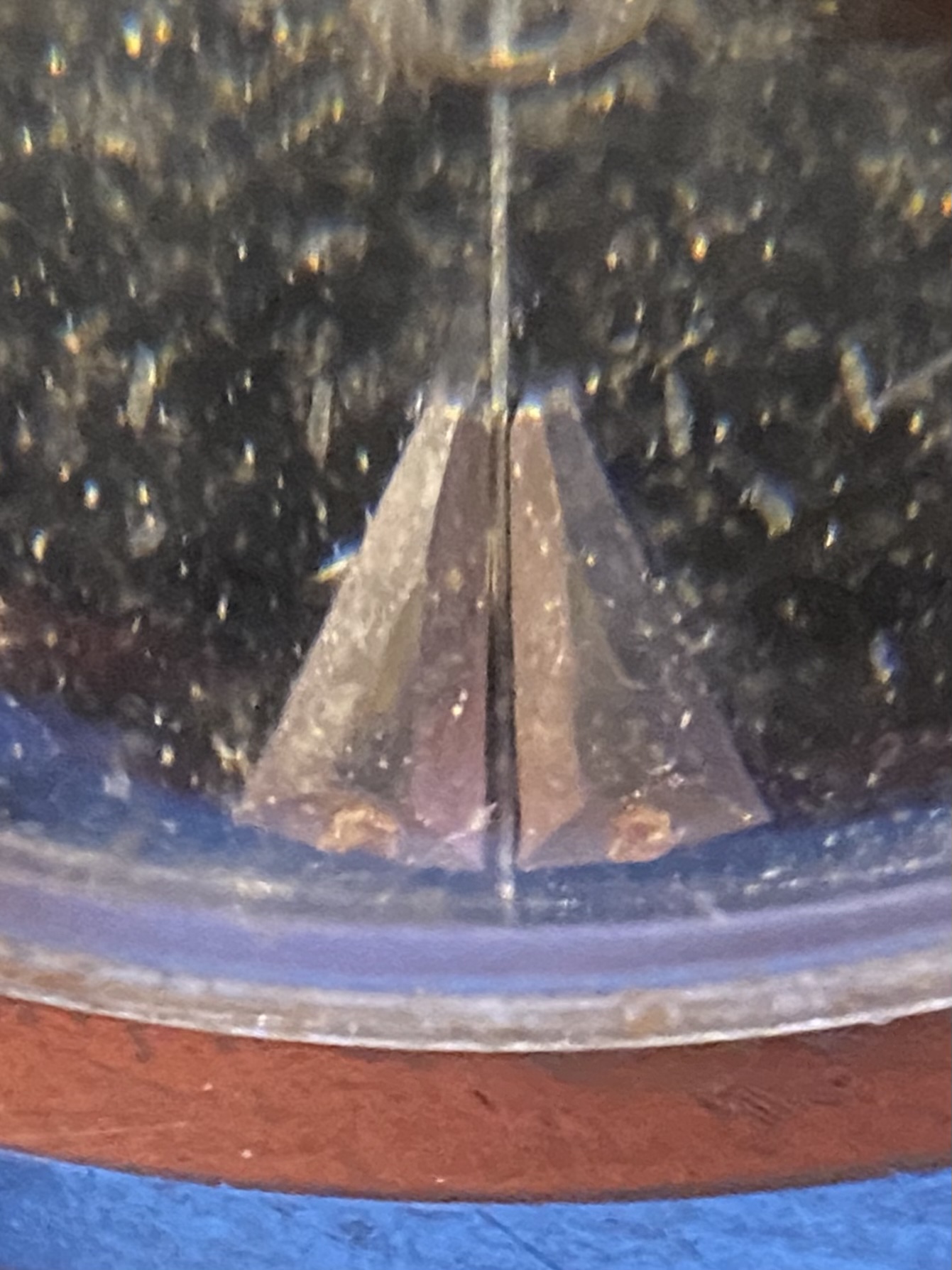

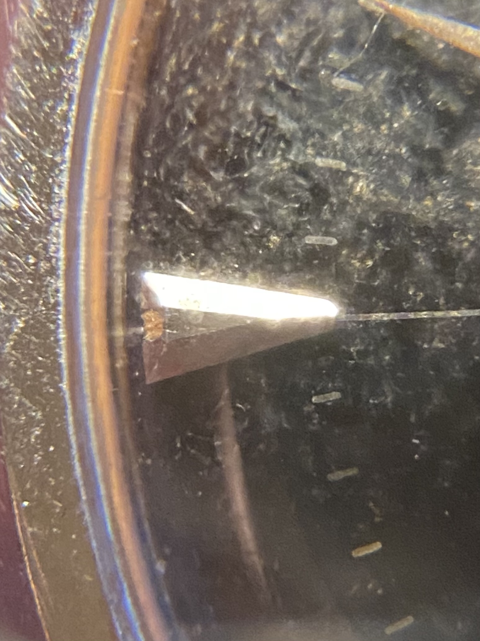

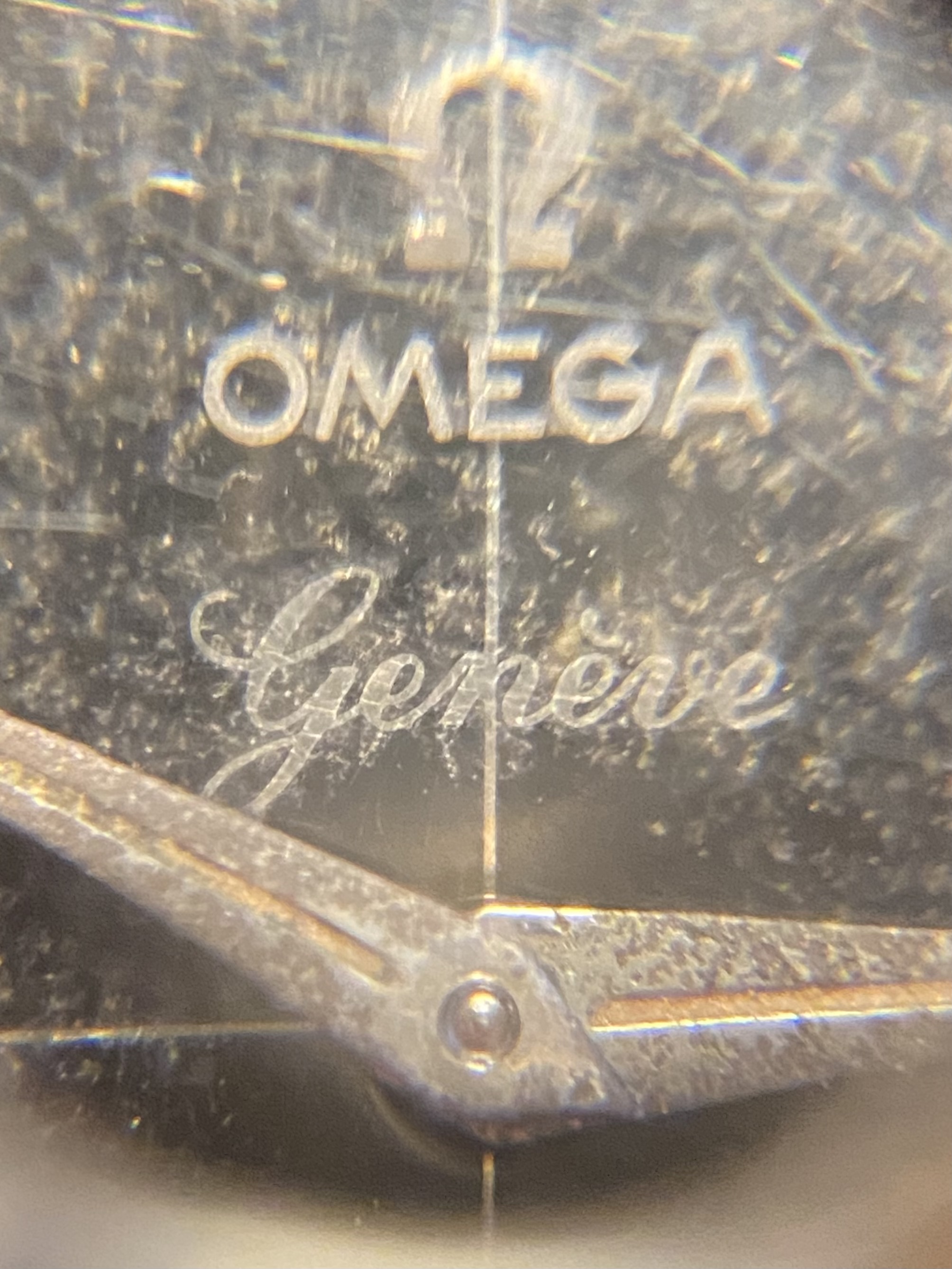

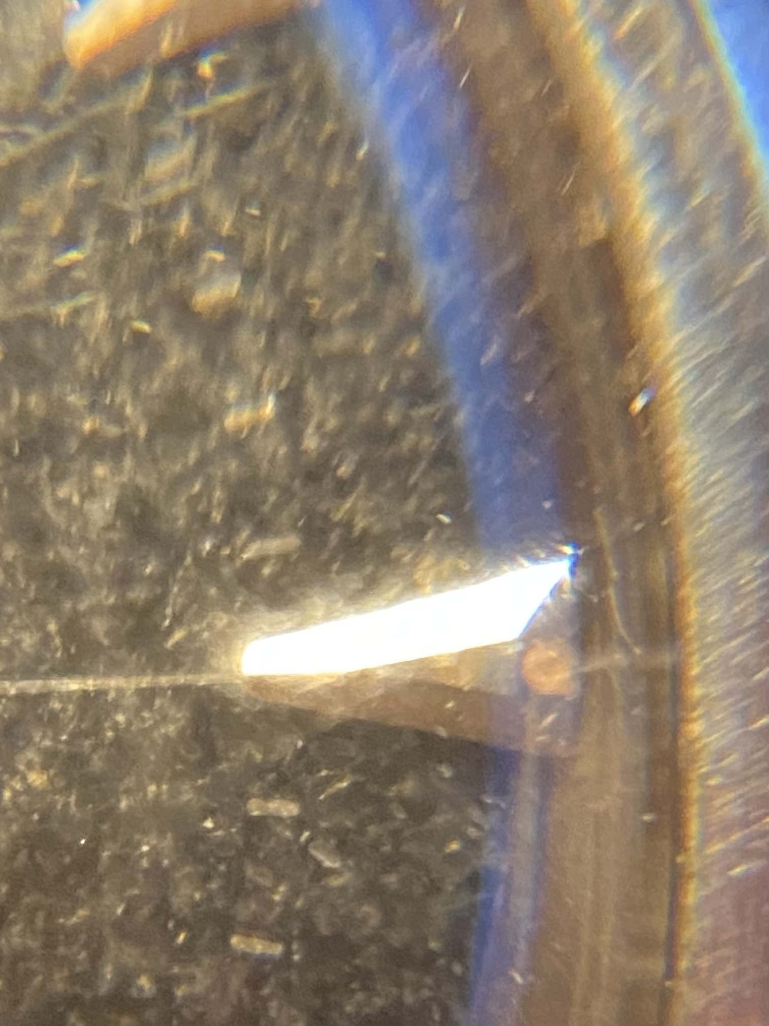

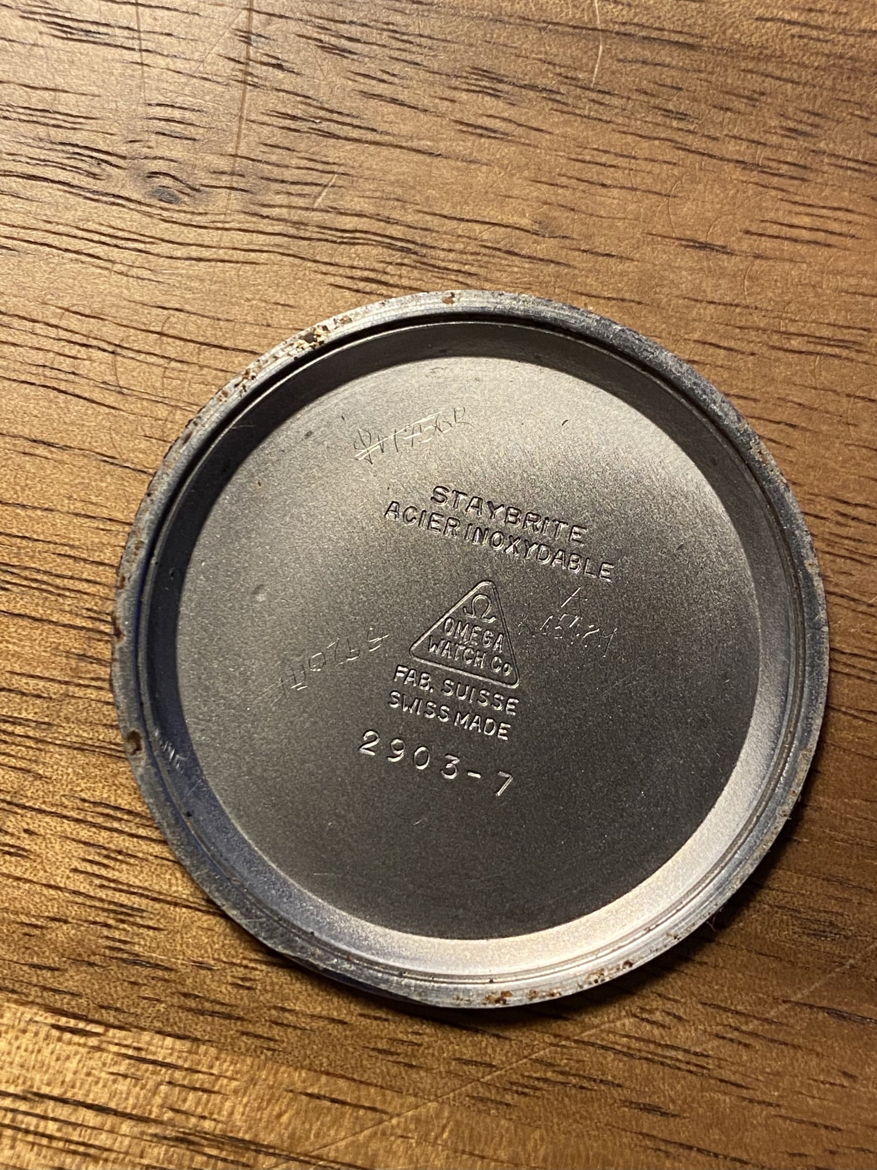

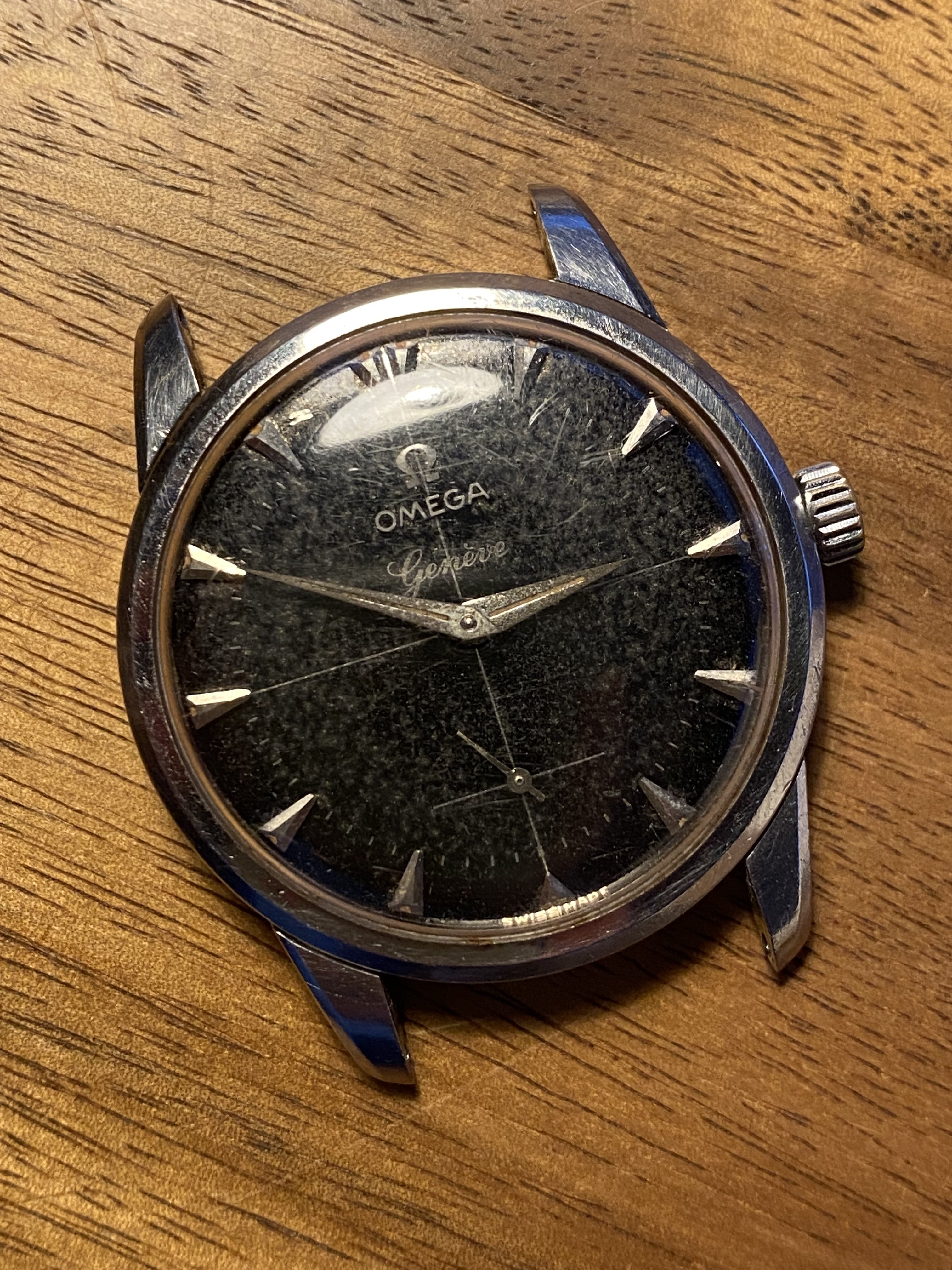

I’m aware this thread is over a year old, but since there were doubts about luminous example of 50s Genèves I was asked by a fellow member to add pictures of an example I got today, to add some proof to the pool of knowledge. It’s the only topic I found searching for lume and 2903, so I hope this isn’t considered highjacking the thread. Also: bear with me, it’s still in “as found” condition, eg a little rough, but I have no doubts about originality:
And here are some close-ups through the scratched plexi. The radium plots have a color I’d consider realistic and it seems to have aged evenly on the markers and in the hands:
They’re indeed minute, but recognizable. Still, the majority of these came as non-luminous, of course.
The doubts - or at least mine - were specifically related to those examples with gold cases.
3,595
13,551
The doubts - or at least mine - were specifically related to those examples with gold dial furniture.
Got you. Alrighty - in this case, ignore my post and just consider it as doubtful eye candy. 😁
8,283
29,288
Nothing doubtful about your example, other than the replacement crown. The dial and hands look original, and very nice! 👍
P.S. - when I said gold dial furniture in my previous post, I should have said gold cases, as even the SS cased versions had gold indexes.
