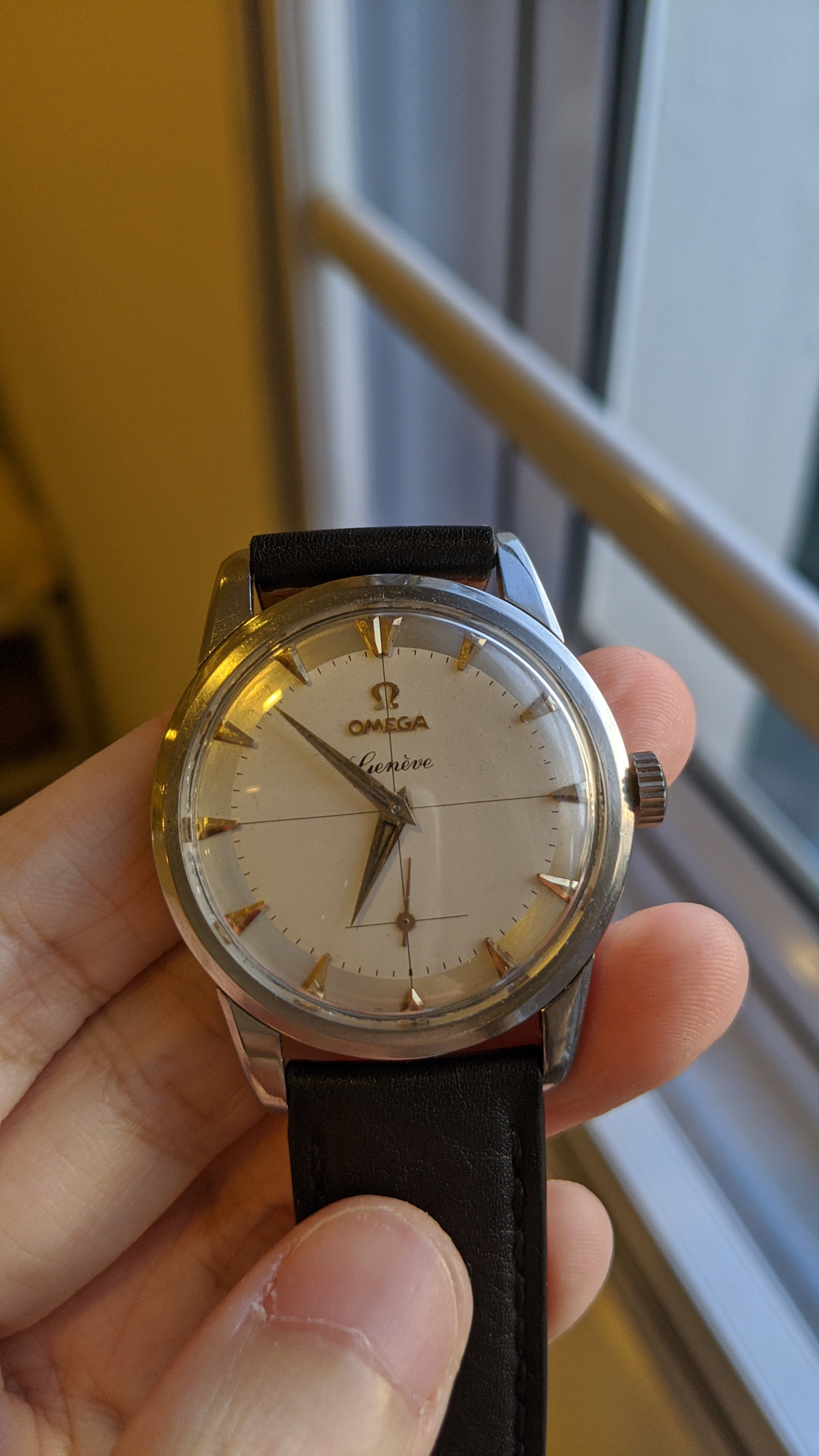

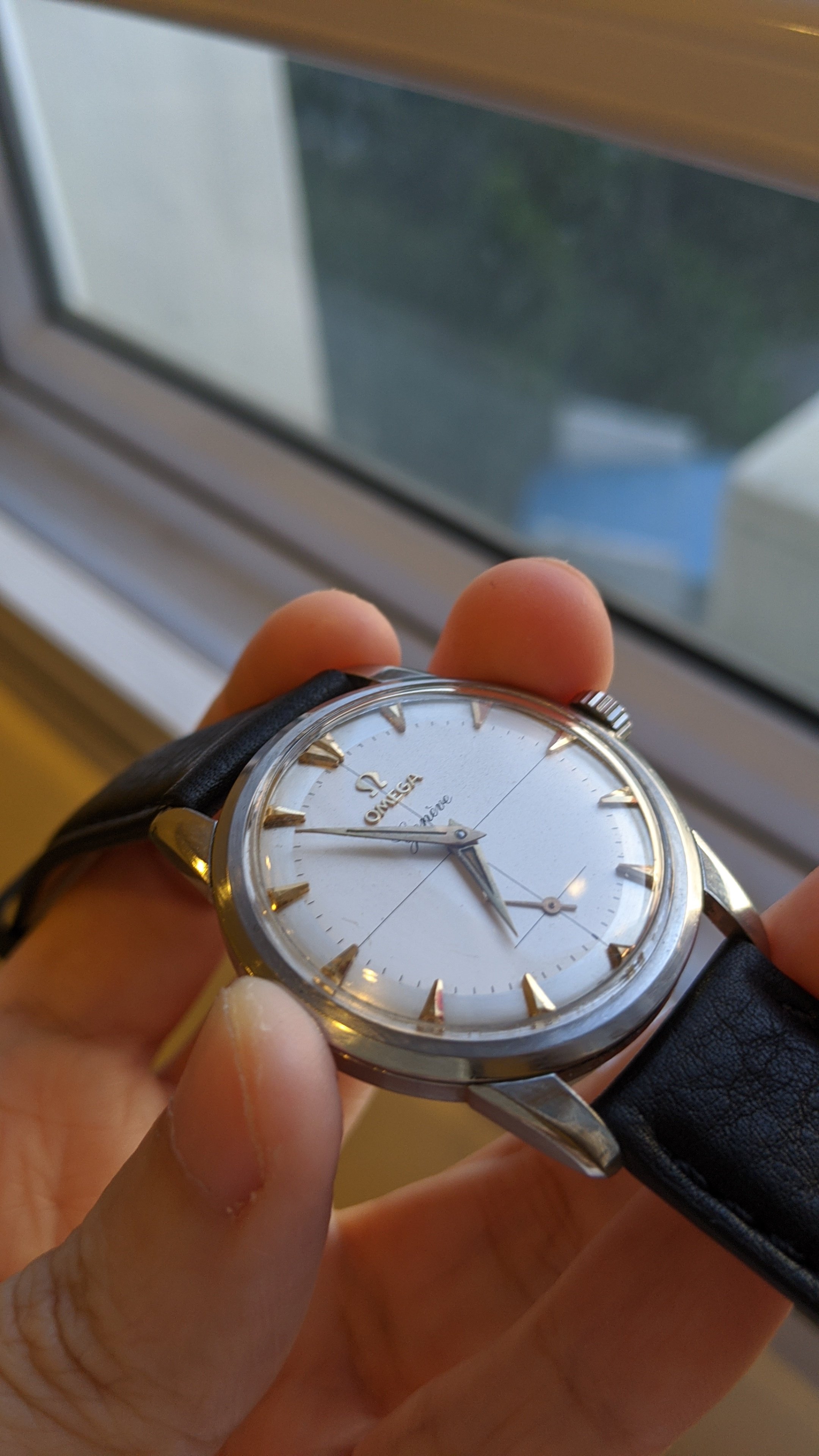

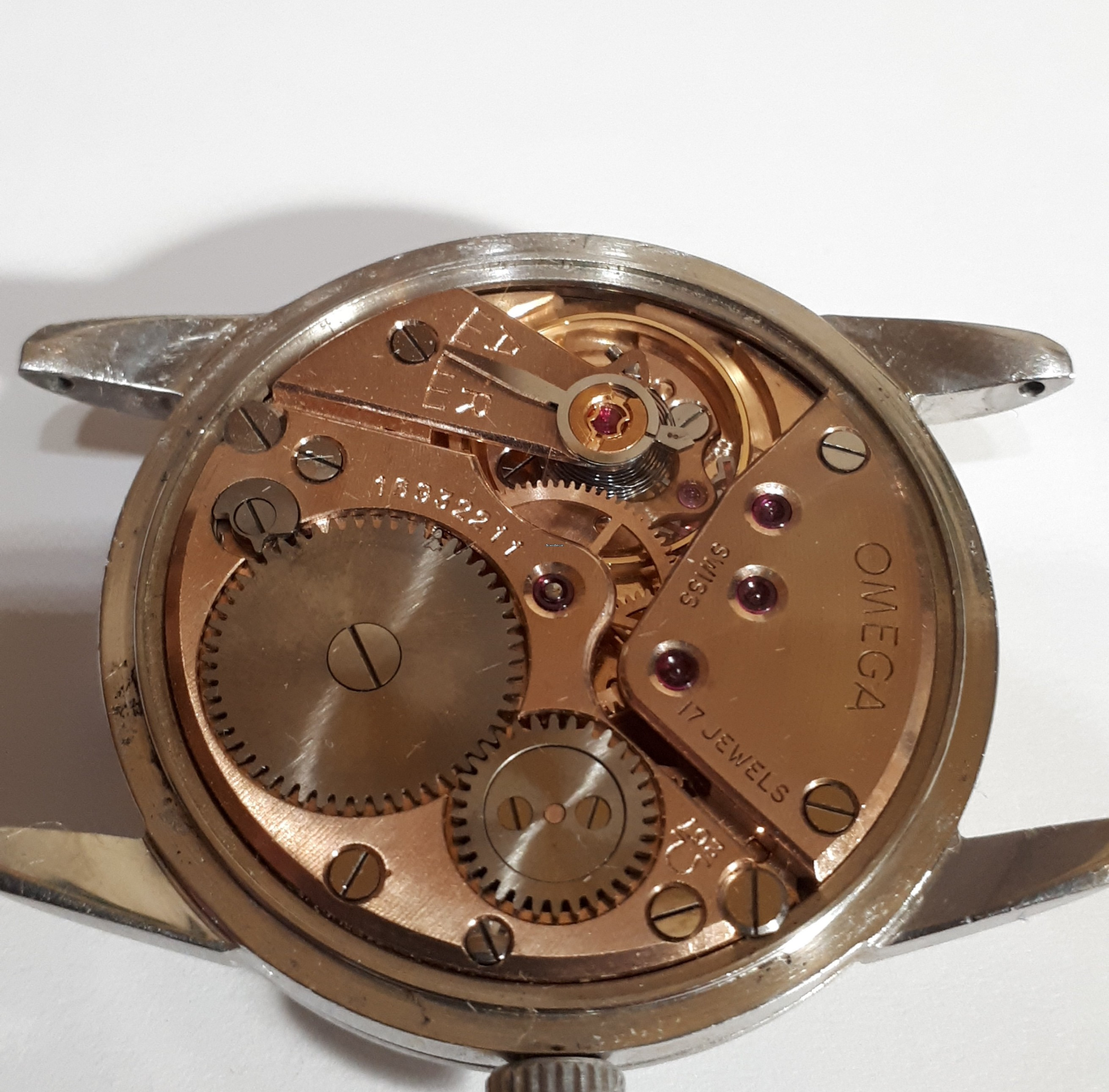

Hi all, i'm new to vintage watch and have purchased my first Omega Geneve. It arrived today and upon inspection, i realized that the hour and minute hands have different styles. The hour one has some kind of triangle pattern.
Does this clearly mean that the hands have been replaced? Any of those is the correct hand?
Also to put things in perspective, i purchased it for 660 Euro. Is this still a good price if the hands not original? Everything else seems fine for me, but please feel free to advise if otherwise. Thank you so much

Yes, the hands have been replaced, and they are not only incorrect because they are steel, but also because they have lume, which would not have been the case with the correct gold colored hands.
You probably paid too much for the watch, in my view, though I would need to see the case back and movement to make a fine judgement.

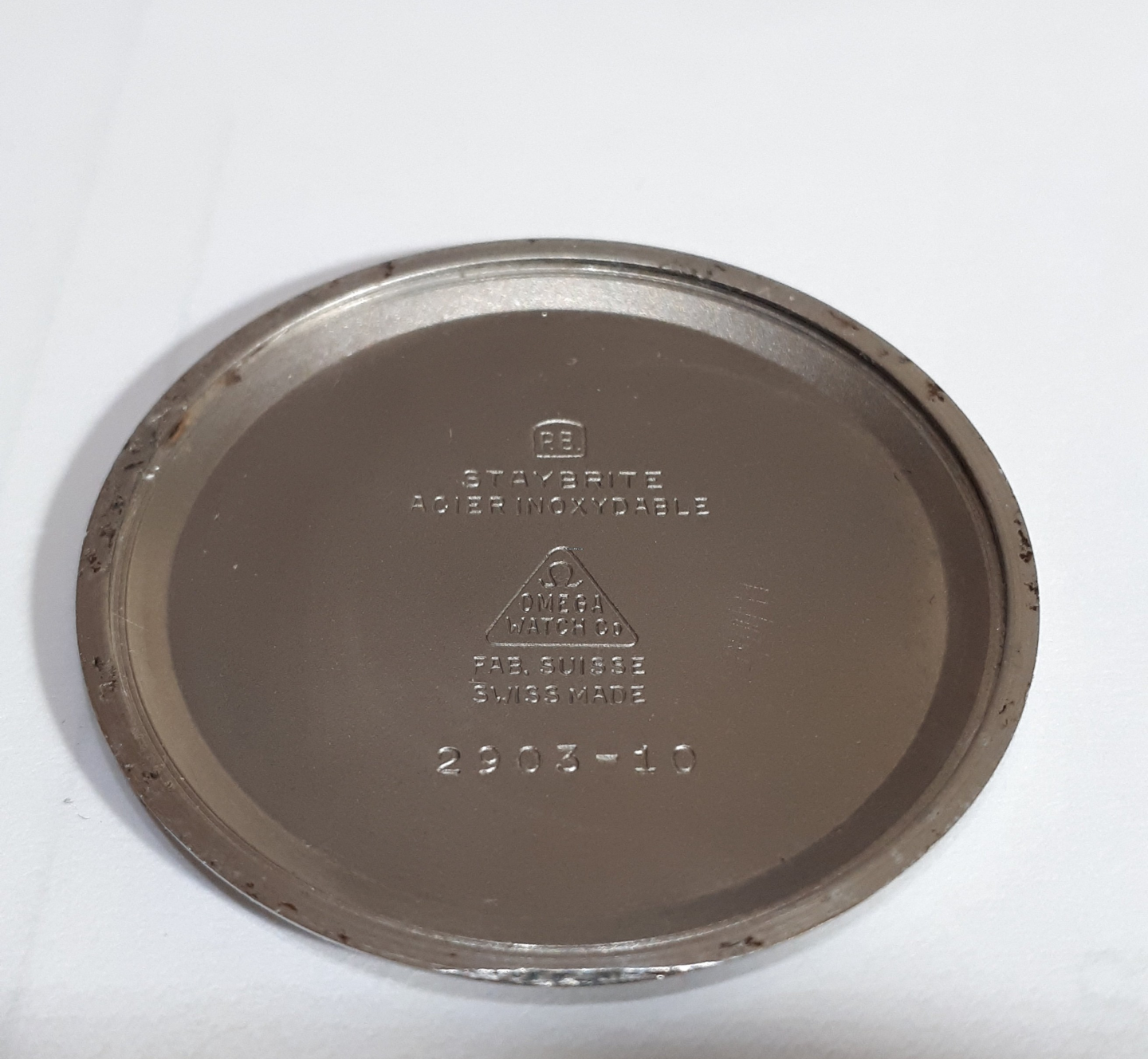

I don't have the tool or skill to open the case back now, but these are provided by the seller

Yes i got what you meant. Thanks for lending your expertise. Unfortunately due to covid19, non-essential businesses are not allowed to operate, so i can't make a visit to a watchmaker anytime soon. Can only rely on the case back photo provided by the seller for now.

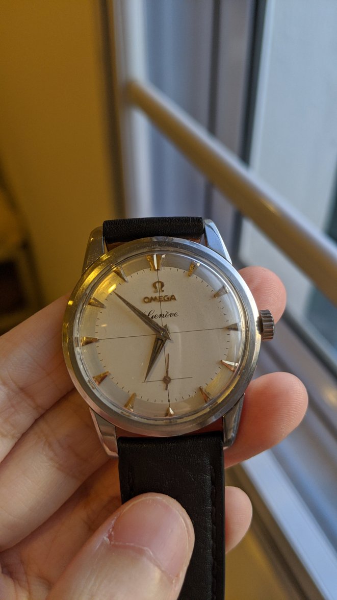

Yeah, actually i began right away to research about the parts. One thing that baffled me is that there are so many variation of hands for this Omega 2903. Mine is 2903-10 to be specific, but i would need to research more to even identify which are the correct hands
13,492
31,811

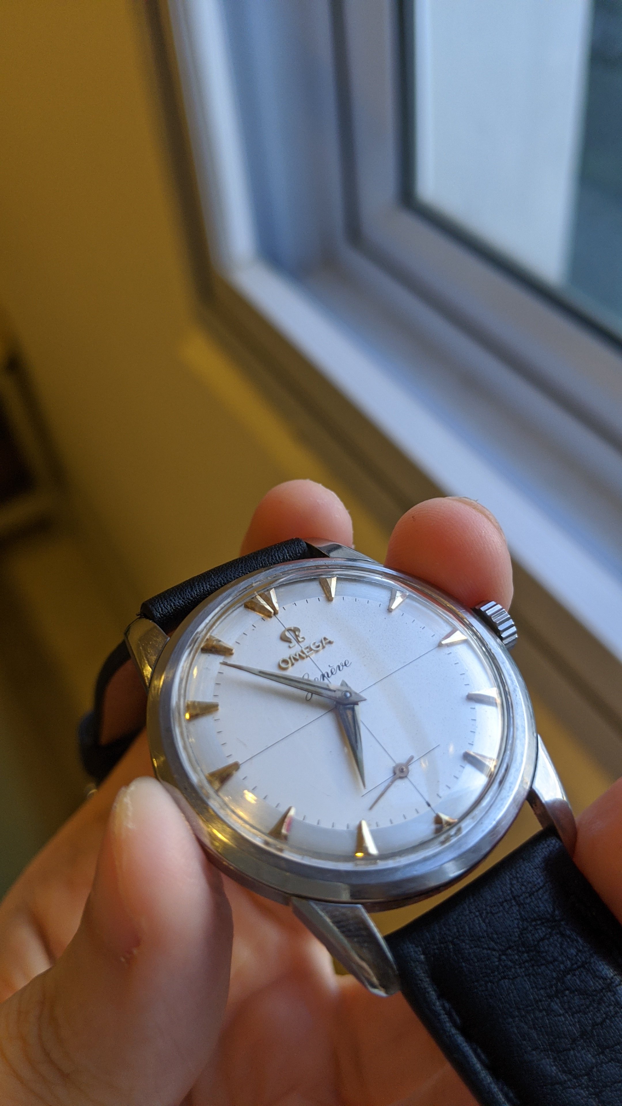

I see lume notches, so the lumed hands which to me appear to be tarnished gold (not steel) would be correct.

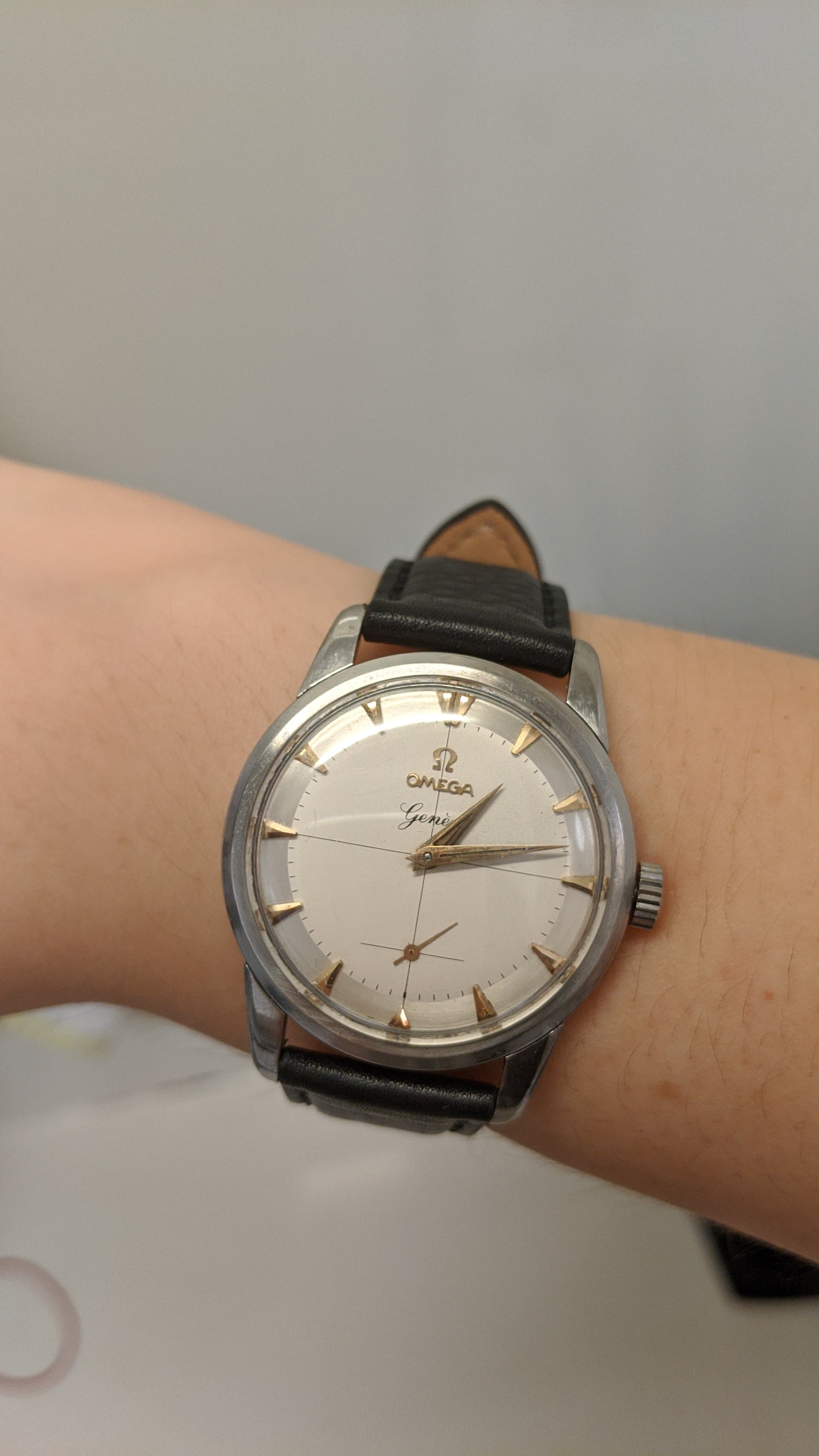

If you have a loupe, take a picture of the hands through it with your phone in diffused outdoor light. If they are tarnished gold, your watchmaker could clean them up without hurting the lume- then they would be a better match to the dial indices.
You have a lot of varying color cast in your pictures so it’s hard to see what color they are.

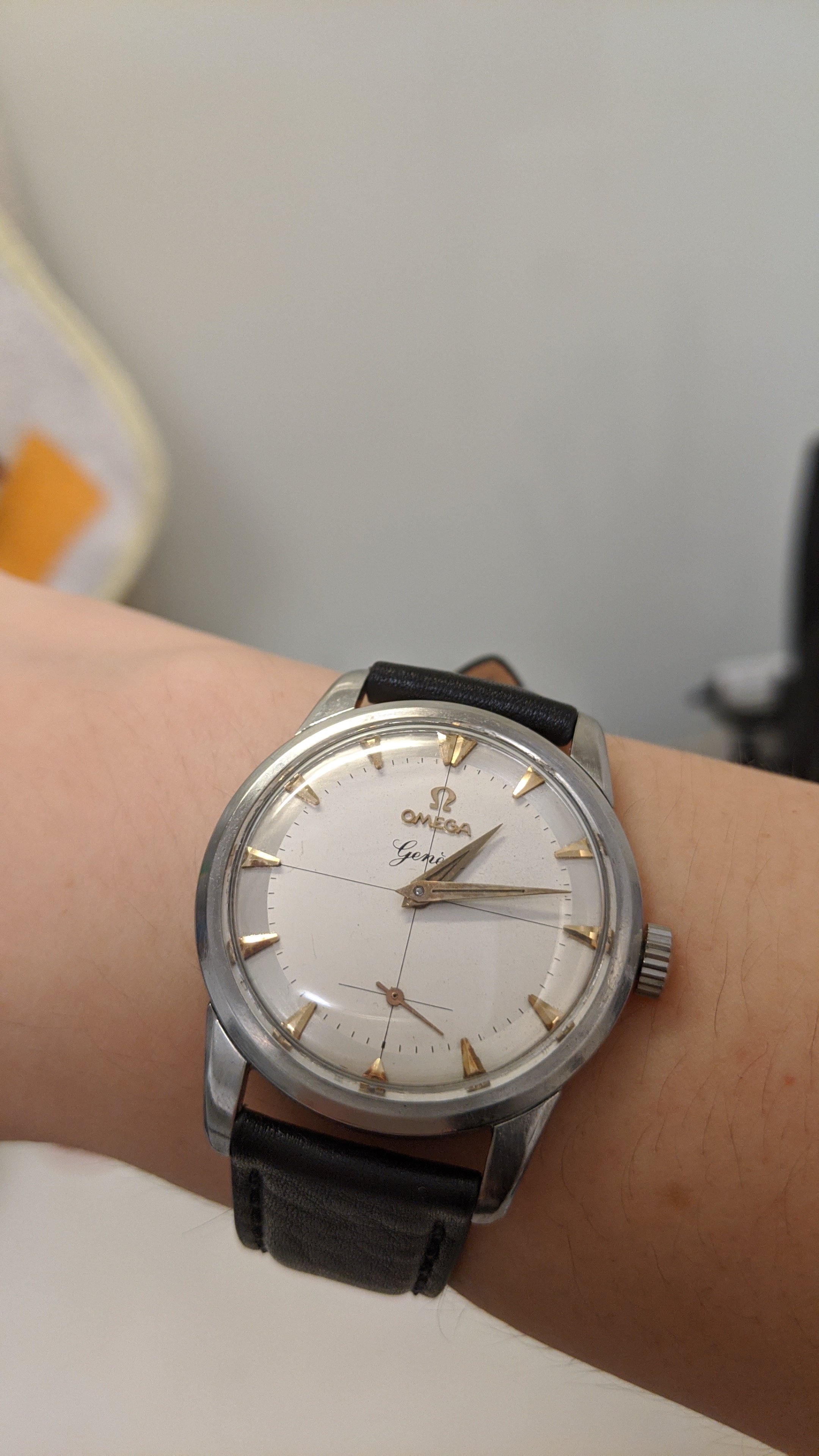

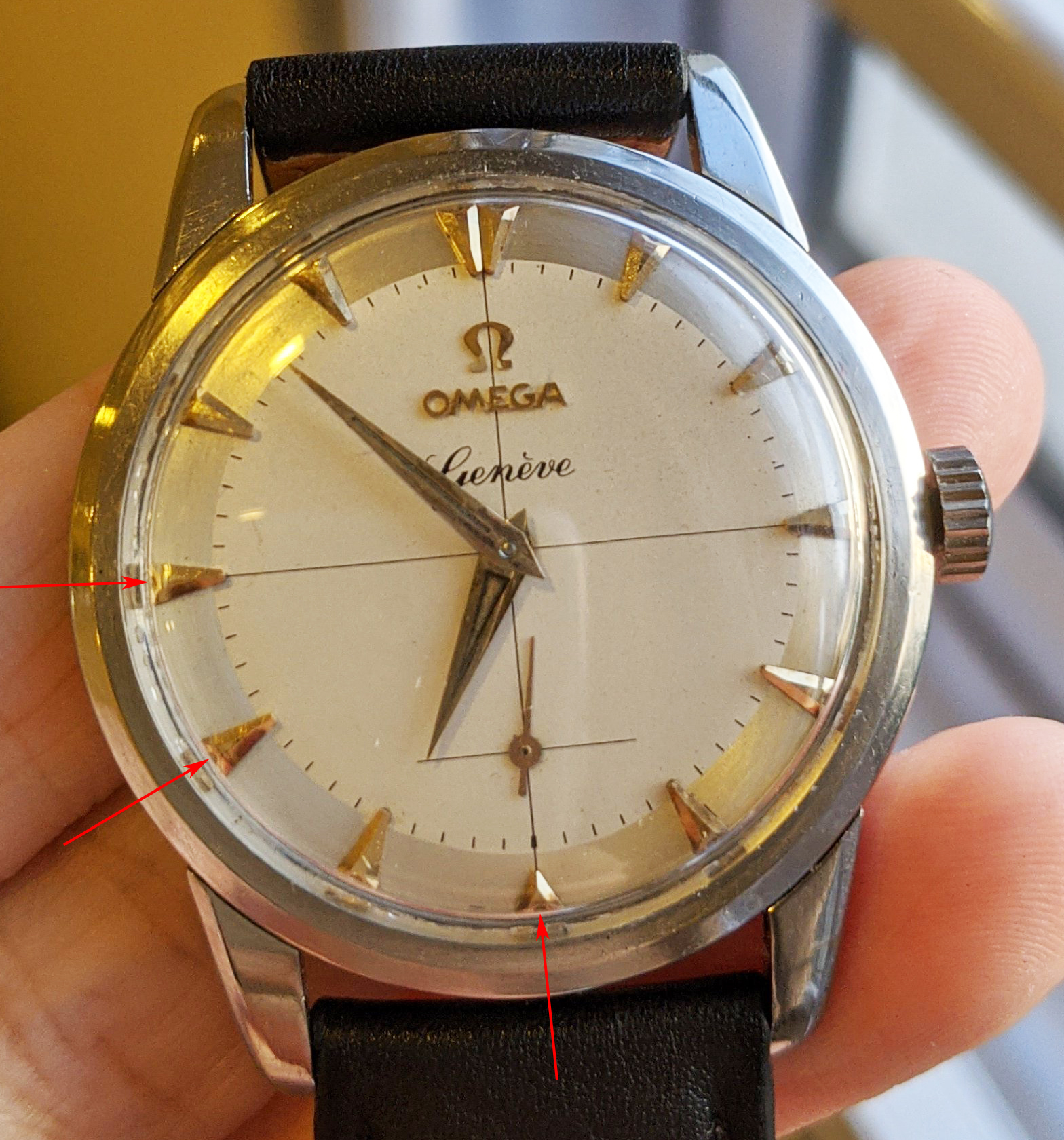

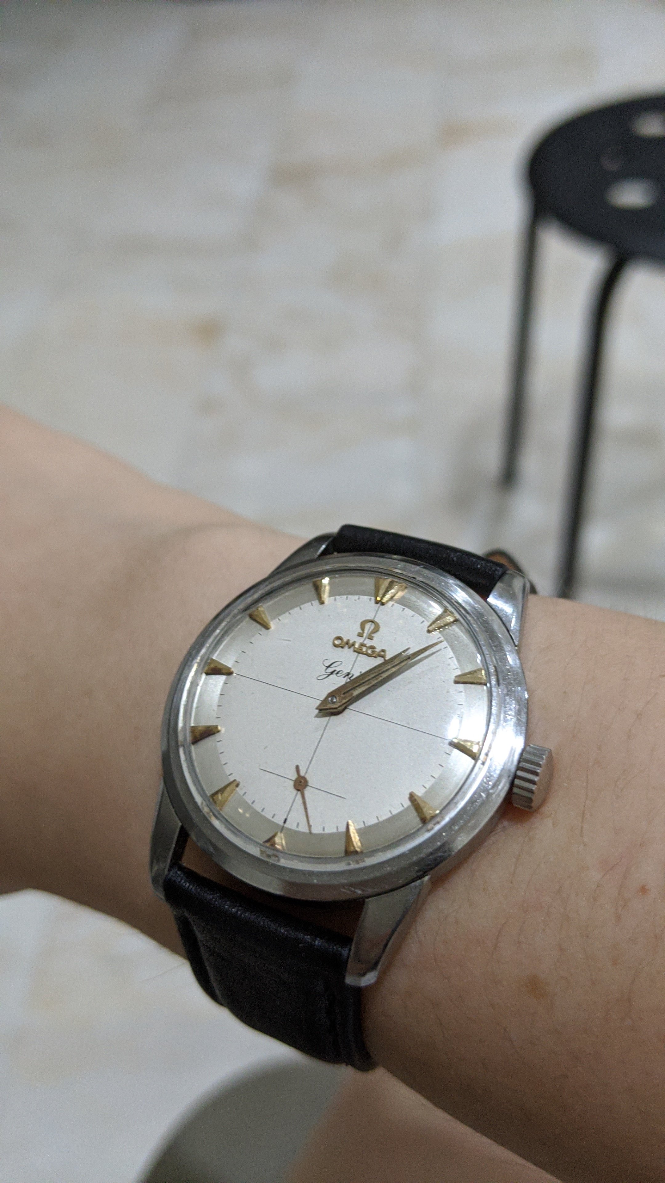

I took a look at the pics i posted and realized indeed they were taken near window, which might affect the colour. Sorry for that. Here i try to take some more under different lighting conditions and different angles.
I will take some outdoor photos tomorrow, it's night time now where i live
It might be.. what i'm most confused about is whether there is such combination for Omega 2903 (different type of hands in one watch). I have seen combination like this in some vintage Seamasters, but so far i can't find any example for Geneve
16,305
45,025

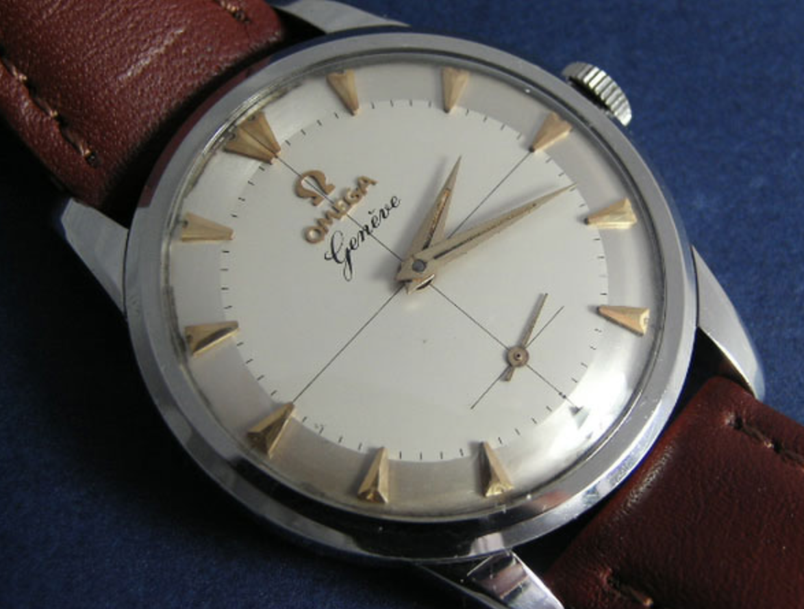

Like Norman suggested, they look like tarnished gold to me. I looked up the reference and get why you are puzzled- the ones with Lume or onyx filled have thin slits and not the big triangle- but that doesn’t mean they aren’t original to the watch or were a factory replacement. The hands shape seems correct.
Good catch, and the new photos support it. Changes the completion of the while situation.

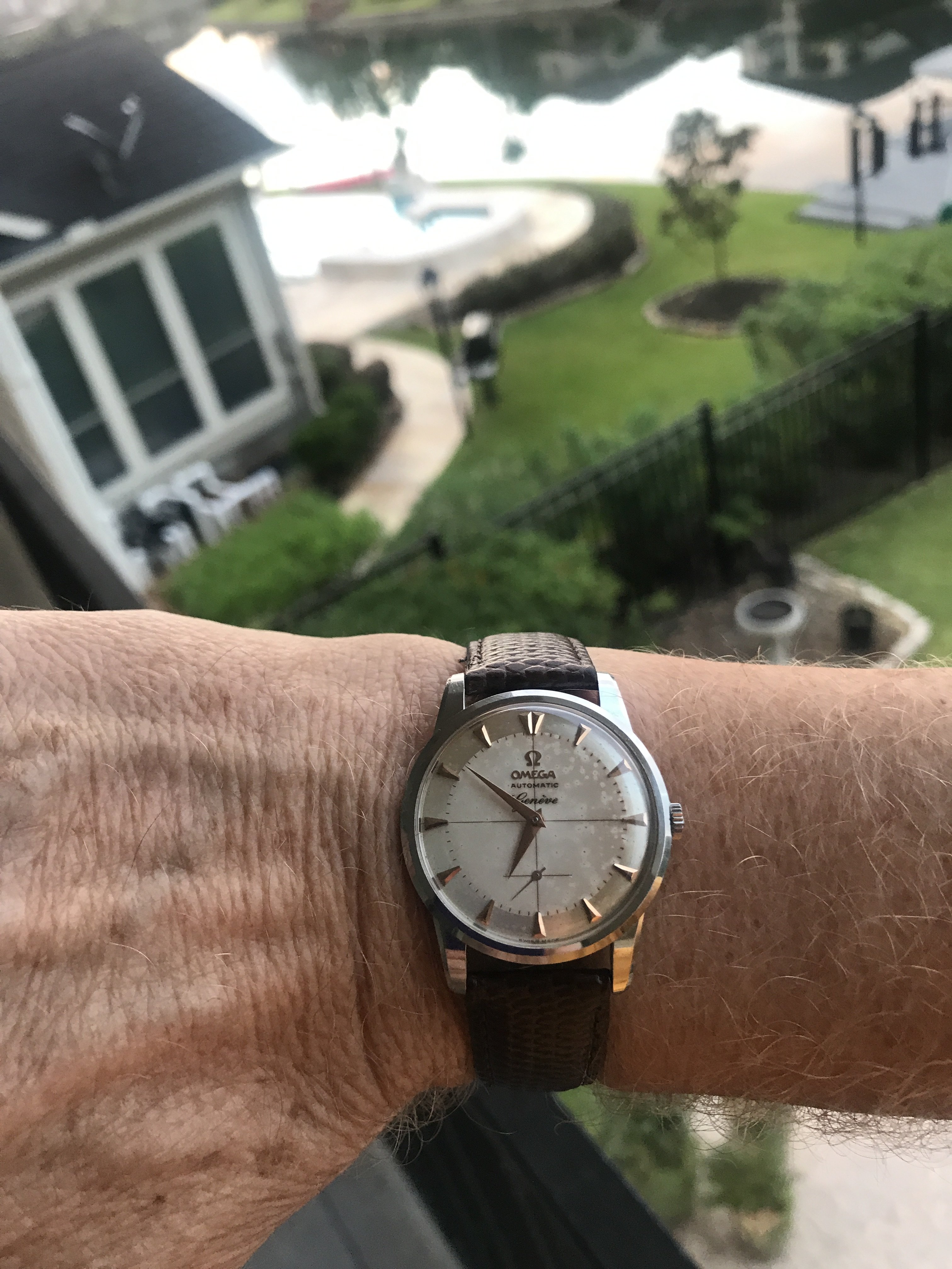

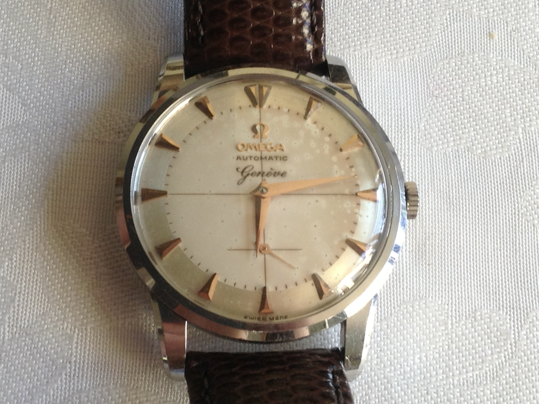

With these early Geneves, the hand should match the dial furniture - so rose gold markers will have rose gold hands
here is mine - 1958, Cal 491, ref 2981 - a nice razor sharp case with an “interesting” Face!
